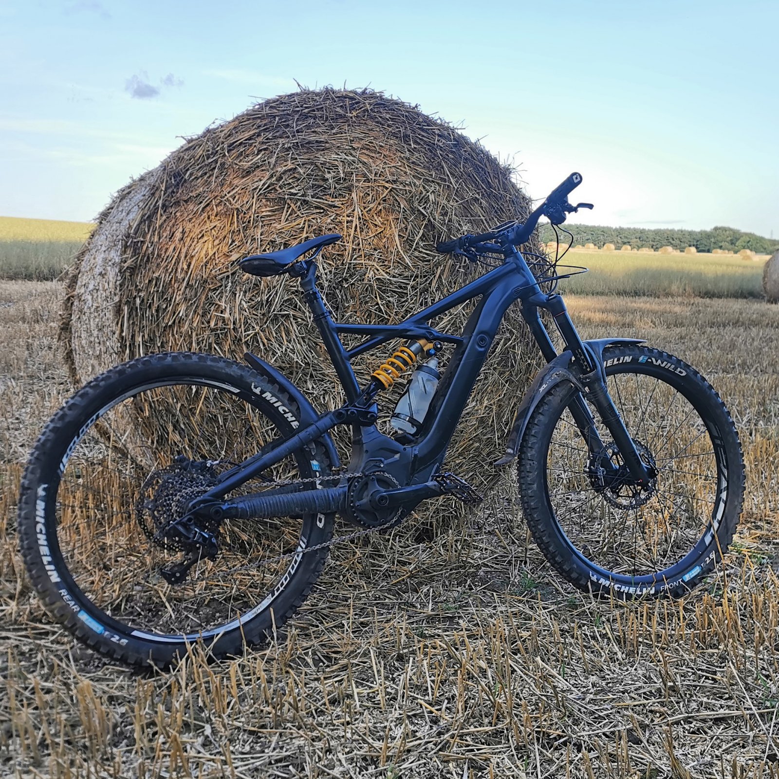

My expert, with the fox van. Just fitted Saint brakes and santa Cruz reserve wheels from my Bronson, as let's be honest, I won't be riding it again!
Had to buy some mich e-wilds in 2.6 as the reserves are only 30mm, they are so much lighter than the stock wheelset. I also had to get a cassette to fit the XD driver, so I've dropped to a 10tooth which will be useful as it felt undergeared.
I kept the icetech rotors from the Bronson as I prefer them, even though I had to drop to 180mm on the back as thats what I had, they just feel better than the SRAM disks. Will get the 203mm once it wears out.
I get around 20miles with 3200ft elevation with my current settings.
EDIT hardest tyres ever to seat. In fact I failed to get them tubeless & put a tube in them. WIll try again once they have stretched a bit.
EDIT 2 I have given up trying to get these Michelins tubeless. Ive done loads over the years but these have truly beaten me. They simply wont blow up on a santacruz 30mm carbon rim. Tried all the tricks. Borrowed an airshot and that wouldnt do it either. Tubes it is.

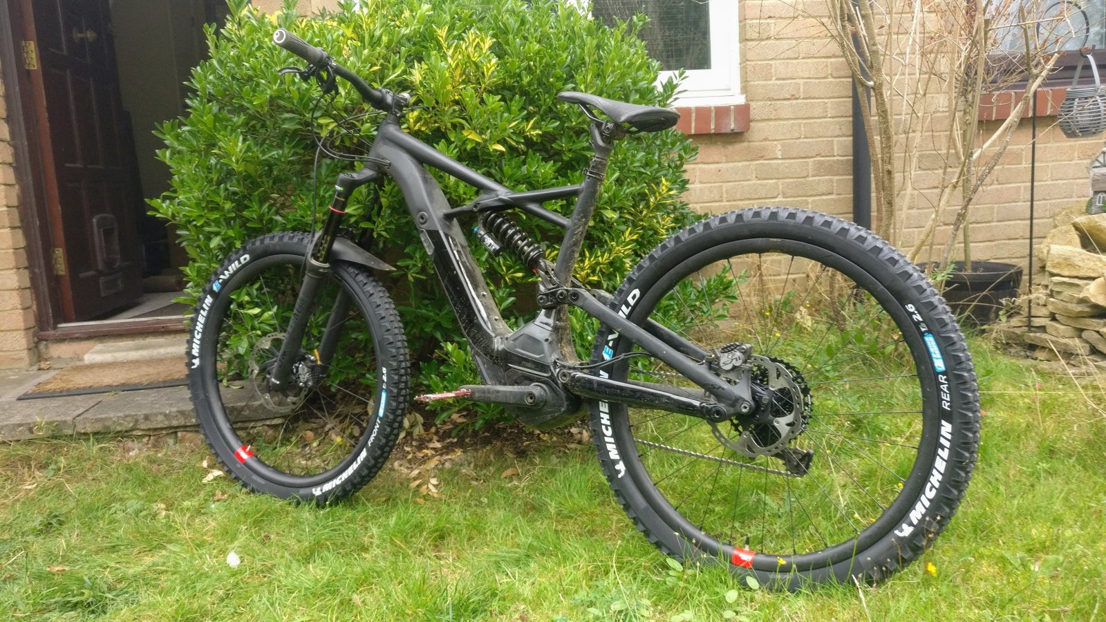

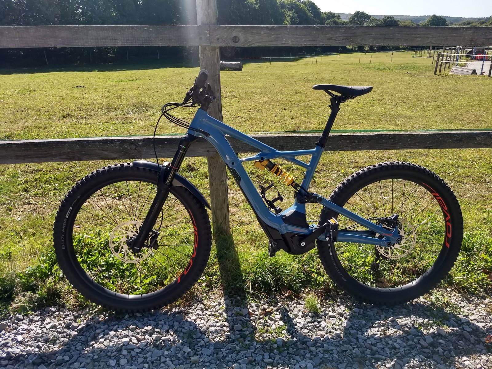

Dunno why but I've not manged to post anything in this thread yet. So here's a couple pics of my Kenevo Expert. Recently just fitted a Hope V4 on the front with a vented rotor, made a huge difference on the steeper stuff I usually ride.

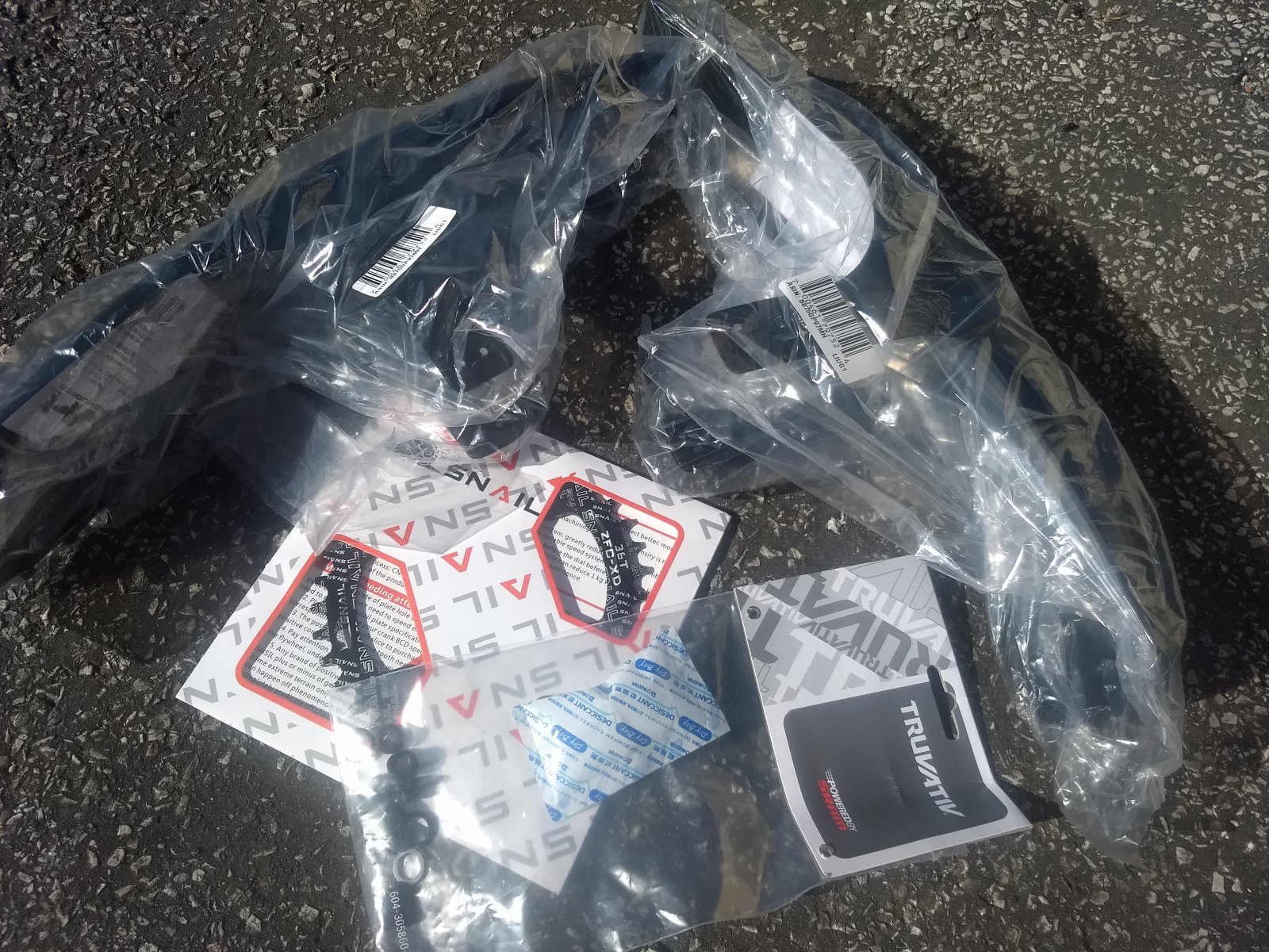

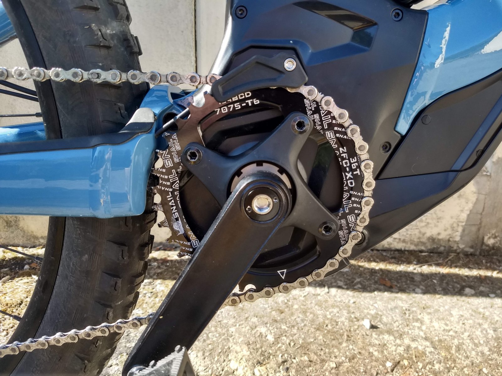

Today's tip is for people planning on changing the chainring ..
The original is steel - like the 2020 kenevo frame :) .. my new one is ally - so not sure how that will wear..
The receiving bolts on the Specialized one are captive. Presumably the same on the levo.

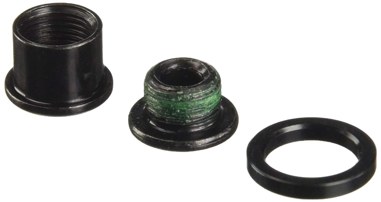

The bolt kit I purchased didn't specify size, but did come with spacer washers ..
Everything I'd read made it sound easy .. tape the receiver bolts/nuts to the back of the chainring . put on viola .. except with the bolts taped on, you can't get the ring on, I couldn't anyway. (because they were too long.....)
Next problem .. I'd checked the lengths before hand and it looked like it should all fit. Couldn't get the outer ones to tighten, not helped by the fact that it's difficult to hold the back ones in place. Eventually sussed that they couldn't tighten anymore because they were at their limits.
So removed, started again with the spacers at the back . Which doesn't work as a 2mm spacer causes the receiving bolt to touch the motor casing. :)
So took it all off again and reduced the receiving bolts to 4mm bolts/nuts instead of 6mm bolts/nuts - whatever you want to call them.
It's now on. :) I think to take it off again, I'll need a tool to take the spider off ... wadza that called ?

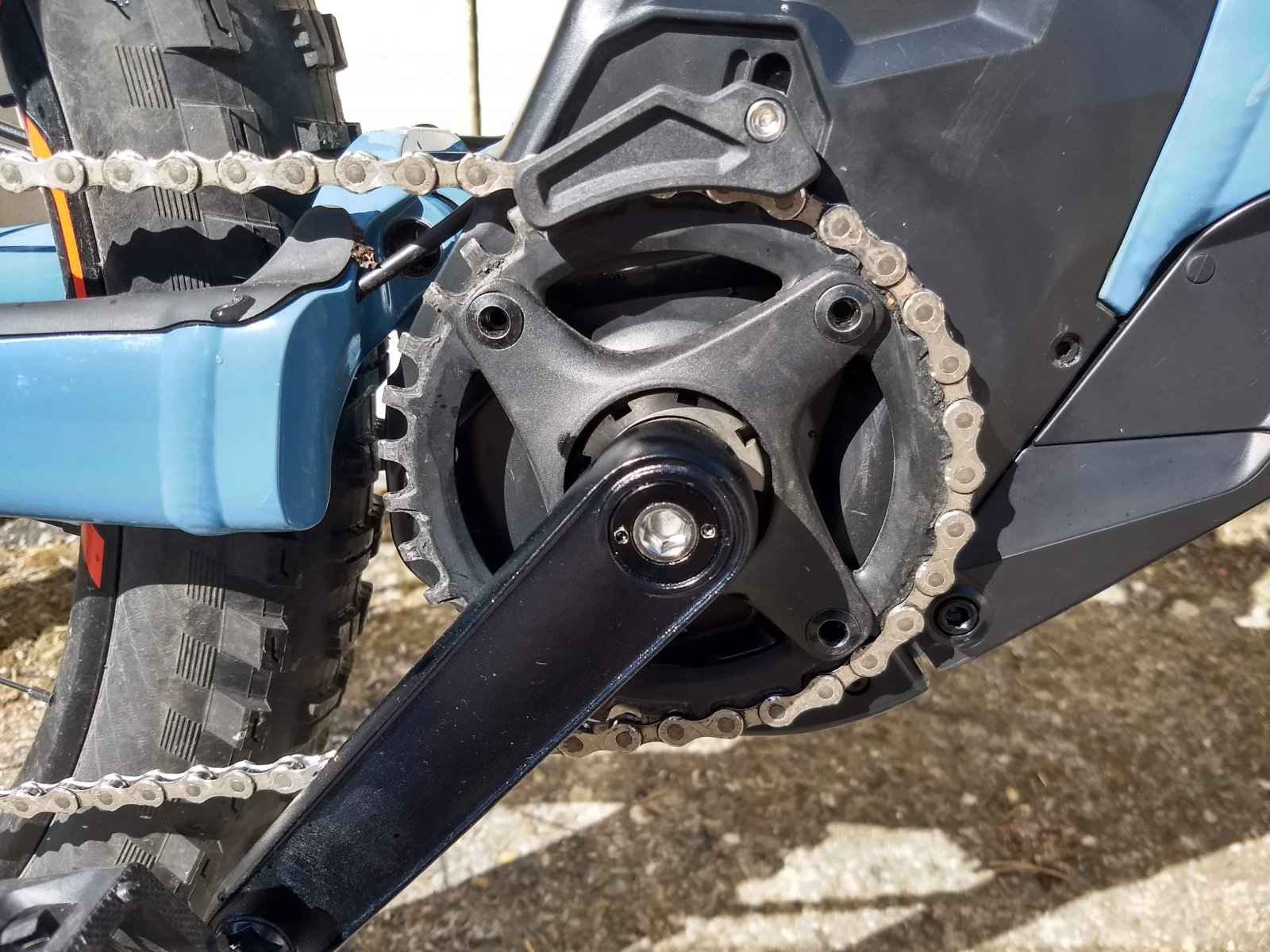

Before : 32 tooth Factory :
After .. cheepo 36 tooth .. on a size "L" there's about 3mm clearance between teeth and rear triangle.

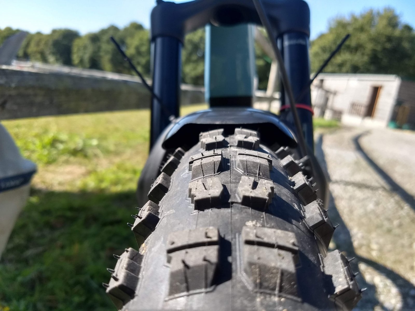

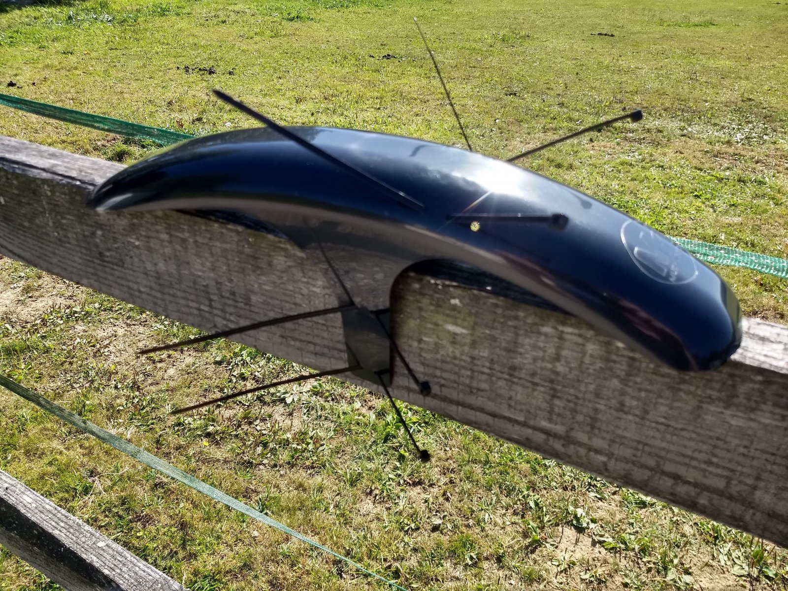

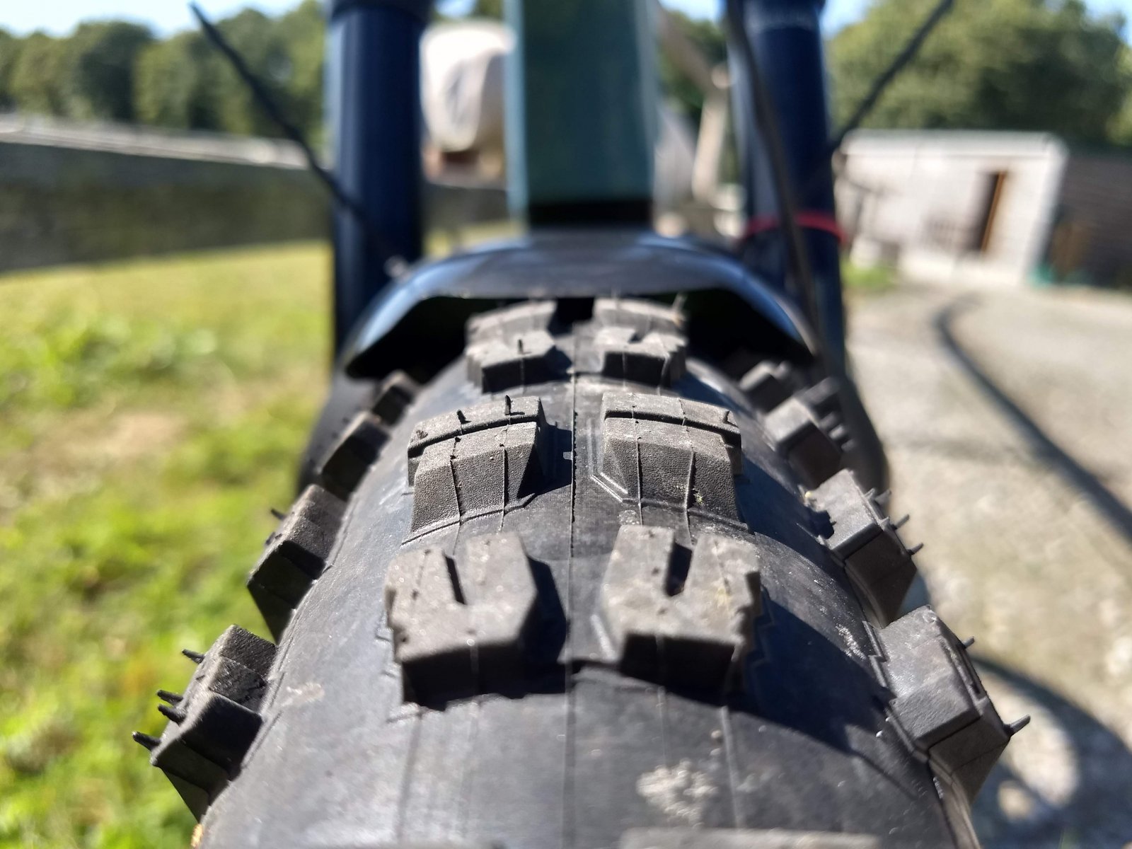

Front mudhugger . Comes with 4 zip ties, but I've used 6. Test fitting showed holes 2/3 on the top sits ok. If you use hole 4 (back), it's too far forward and the nose catches the tyre - or looks like it will .
On, with the top ties done up and the lower fork leg ones .. it ALMOST touches the tyre - which is similar to other pictures I've seen ..
Tighten up the upper fork ties and it lifts it a couple of mm.
I personally think the other ones a couple of posts up look aesthetically a little more attractive for some reason .. maybe they follow the wheel shape better ? .. Should keep things dry/eyes more protected and the plastic is much more supple than the cube ones. I don't think any mud guards look very nice ... maybe that's just me ... but they don't look too bad.

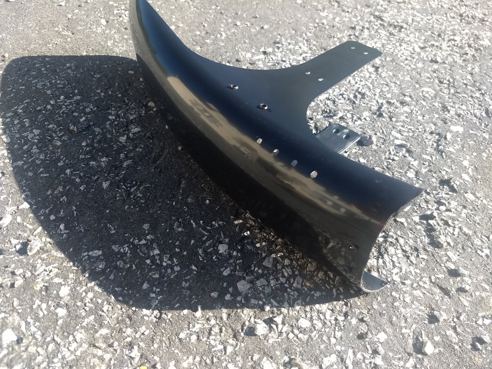

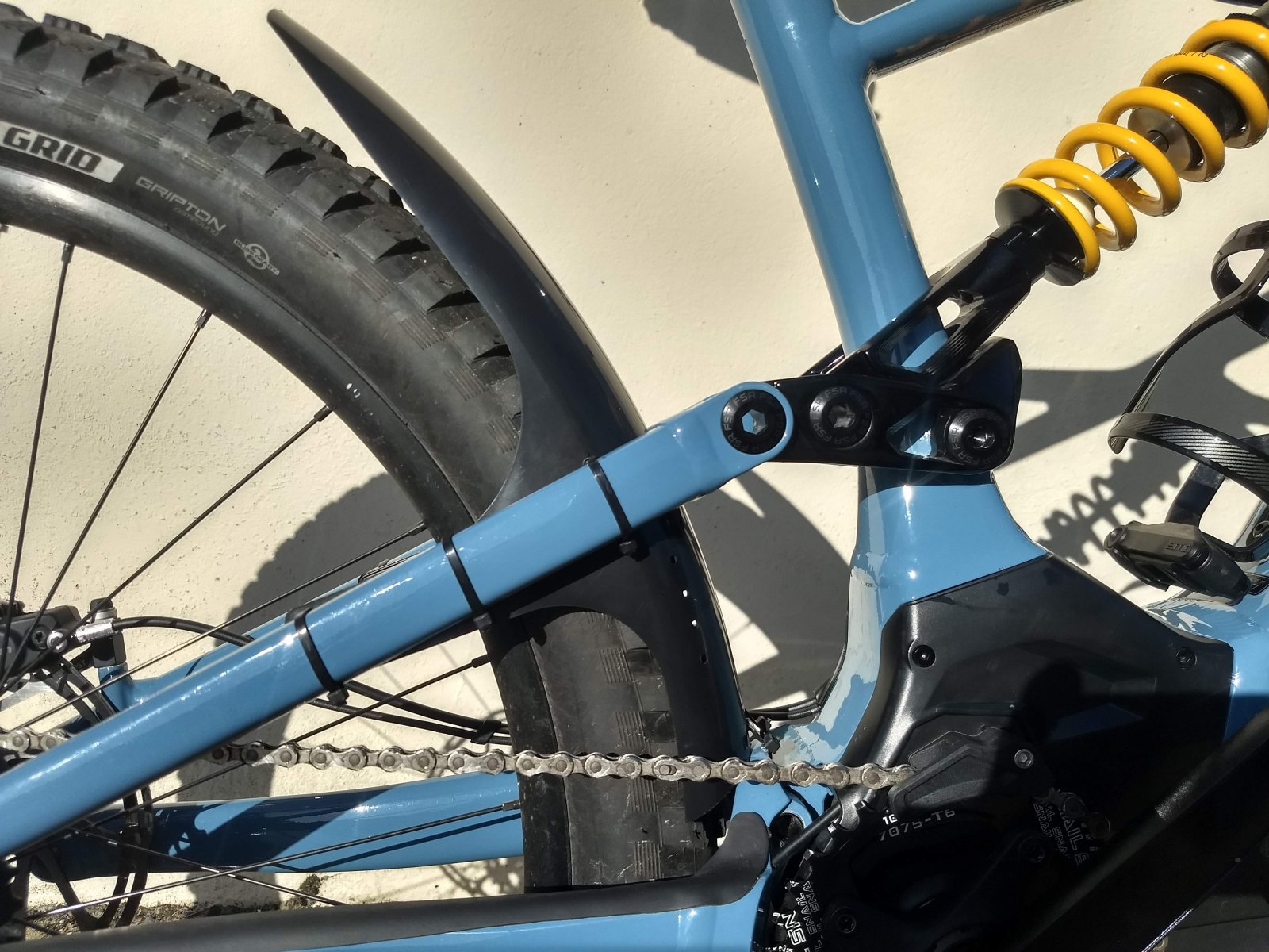

Mug hugger rear ..
Chopped the nose off to the correct shape .. ish ... Two extra holes either side, higher up than the existing fork leg holes and two more to fasten it near the hinge to stop it moving about/flapping ?! (edit - these two didn't work, the tyre/linkage snapped them straight away)
Now all I need is an advent 9 and an external cable ..
Quick test ride round the Sand MTB school ..... (OH isn't here...)
The two rear zip ties near the pivot pinged off, so either I didn't have them tight enough or they get pinched or something ...
Doesn't look too bad ...
