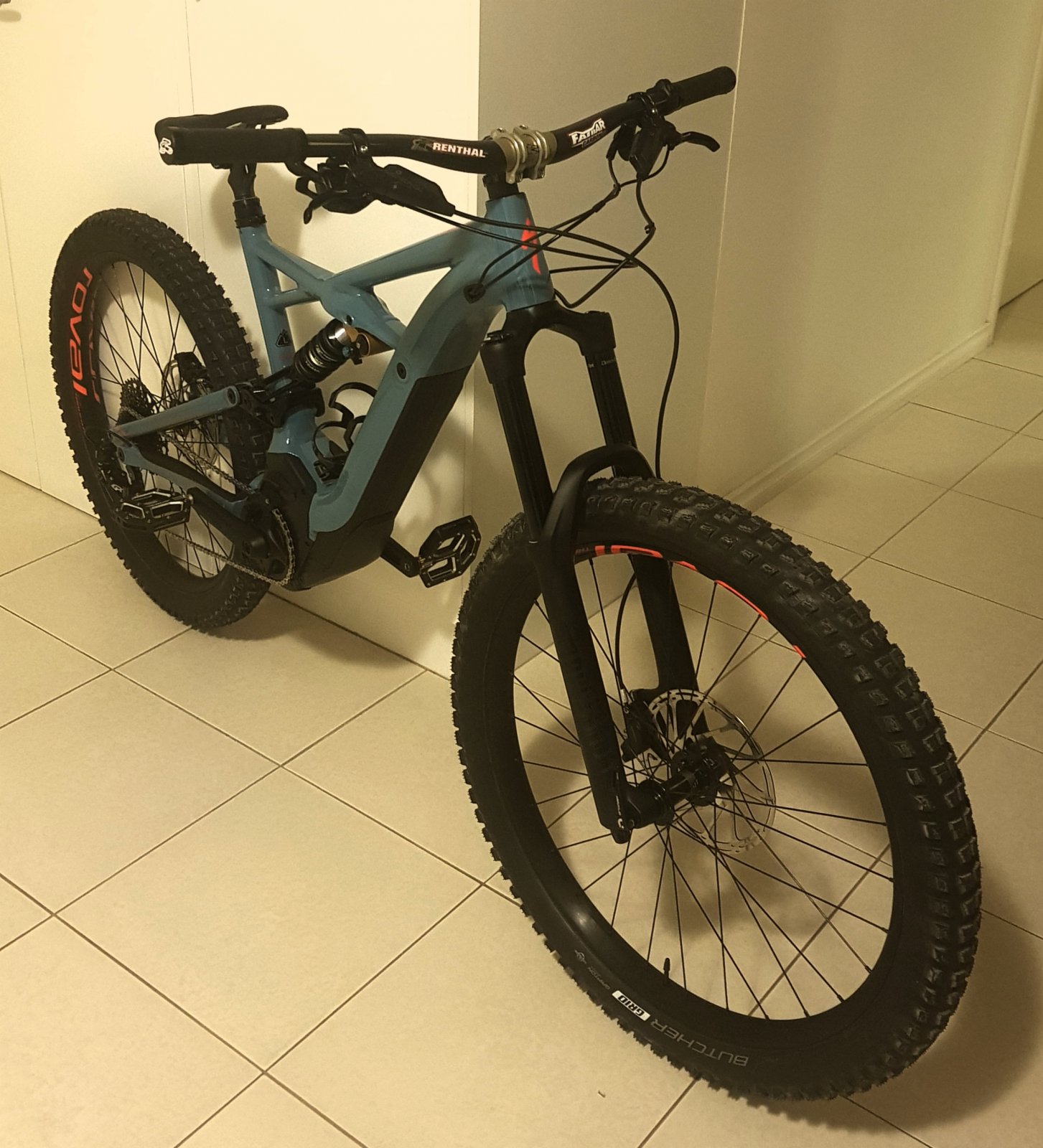

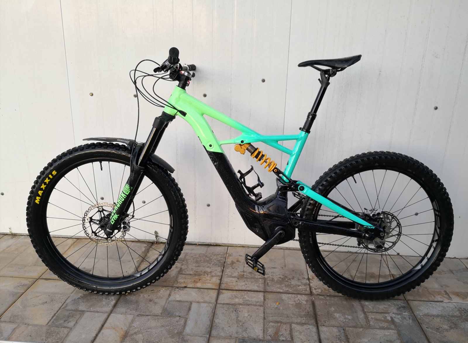

New bike day ?. What a day I took my new kenevo expert out to the local trails which have a great variety of climbs, DH and plenty of trail in between. The kenevo blew me away, I racked up just over 100kms for the day, 85 on the trails and 15 on the road. Lots of playing with the suspensio setup and tyre pressures but I think it's feeling sweet now.
Overall the bikes amazing for my riding style which is heavily gravity orientated. I did find the brakes a little weak but got used to them, and the dropper was annoying, slipping, dropping unexpectedly and the front tyre wasn't as grippy as I would like. All things that are easily fixed.
All up I'm loving it. Bring on tomorrow ????

How good are they!
Change the tires and go tubeless if you haven’t already. Makes a big difference.
Enjoy that beautiful beast!

Wow! What a beauty! Nice Renthal bars!
Enjoy your new love!
I know I do...
The brakes are crap.. true. Get some Hope's on there w/floating discs... And you will never worry about brakes again!
I didn't like the dropper at first, but once used to it.. I love it now. Just have to learn where the three "stops" are... You get used to it.
Get a narrower grippier tire for the front... Like a DHR.. and a set of cushcore inserts, so you can run lower pressure without risking damaging rims.. a
nd your set to go!
It's a real mean machine!
Oh... And install BLevo! If you haven't yet..
Tim

Thanks for the tips, tyres and inserts are definitely next on the list. I will run the dropper for a bit to see if I get used to it. As far as brakes go I have had a good run with both my RSC and saints but will also look in to hope's.
