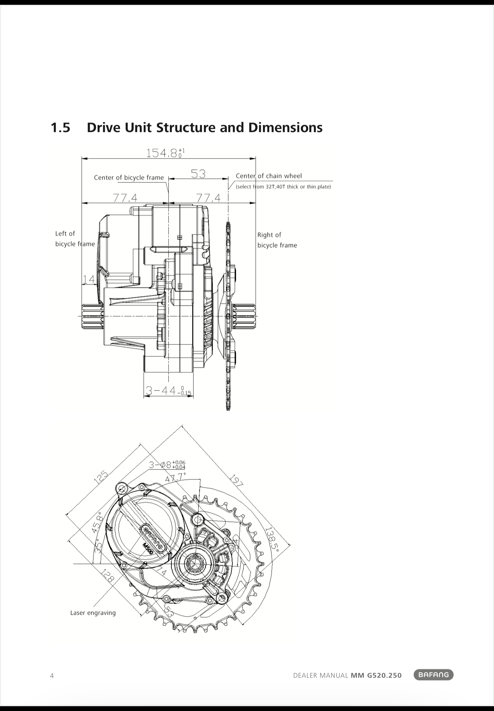

Hi all,
New member here! I'm excited to be designing a new custom frame based around the pending M560. I understand this has the same chassis as the M600 and others. Does anyone know where I can find a drawing of the bolt pattern for either this motor, or the mounting bracket? I've hunted all over and had no luck yet.
Thanks!

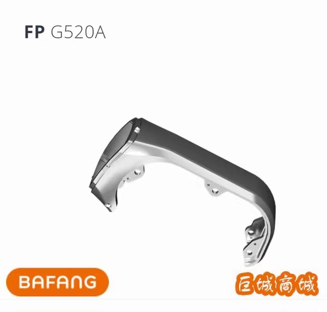

I have an aluminium mount FP G520A for the M600 if you want to experiment with it.
There are drawings out there though, the ones I have maybe good enough but sorry I don't have them as a CAD file.

Thanks. I'll see if I can reproduce the geometry from that - don't suppose you have the widths or a bottom elevation? The frame will be Titanium. I expect the frame builder will have a bracket, but I need to design around it.
Cheers,
