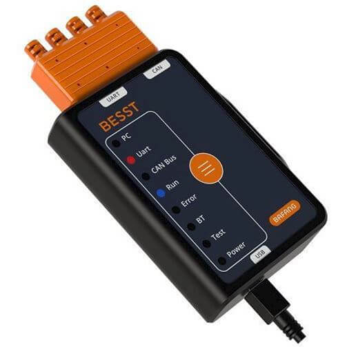

This is the Bafang BESST Tool

My experience with the Besst tool is that it's a bit fiddly to get working... Lots of disconnect / reconnect , and power off / power on cycles to get it to read the serial number but once it reads it, the firmware update is pretty easy.
You can change the speed limit and wheel size for tuning the display speed.. there are some diagnostics functions. And lots of info about the operation..

do we need to ask Bafang permission for this?
Animalector
Jan 2, 2021
53
83
Cairns, Australia
Bafang resellers can create accounts for customers, so you can ask whoever you purchase your motor from for an account. Or you can ask Bafang but there a chance they just won't respond, or they'll direct you to your retailer.
