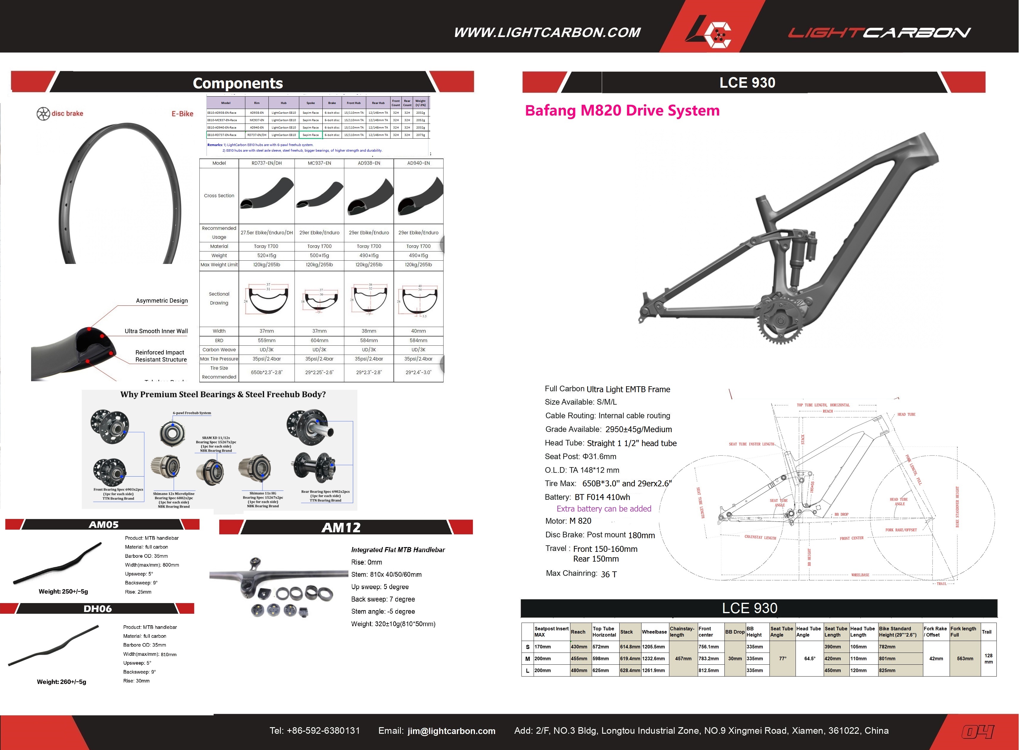

M820 Bafang - LIGHTCARBON LCE930 Frame (lightweight)
A very interesting frame from a well-known brand. Why is your frame so heavy? What is the weight of the frame without battery and motor?
I should have copied that info from their website. The weight is 2950g. I updated the first page.
 H
Hey Jim, what's the rear travel max on the 185 x 55 shock for this frame? Do you have a graph to illustrate the leverage curves? Thx
front travel 150-160mm, rear thravel 150mm, the leverage curves need later, We need to wait for the complete vehicle test of Bafang Company. They chose our frame and used it to assemble their products as exhibits in March. Their engineers made some small suggestions for our frame.
A rough calculation of the weight after spraying the transparent paint is 2950±45g/Medium,In fact, the weight of the frame could be reduced by 500g if more control was used in the weight control, but doing so would cause some parts of the frame to be weak, so we strengthened these weak points. This is the best cost performance for the factory, and it will not increase the cost due to after-sales service.

What kind of riding style is the frame designed for? Is it possible to jump and ride it in the enduro style as on the dengfu E10 frame?
it's all-mountain, The main feature of the ultra-light EMTB is its all-terrain ability and multi-style play. It is not a dedicated enduo bike. Therefore, although it can jump, it is not recommended to be used exclusively for downhill and jumping.
1. Because the motor and battery are relatively light, so need keep the center of gravity at a reasonable position.
2. Ensure the pedaling frequency of the motor in assist mode.
3. In the case of no electricity, it can be used as an ordinary MTB bicycle for uphill traffic.
4.The BB height of 335mm is not short for AM,
Why didn't you make a small cover on the pipe so that users could change the battery? You have seen the new dengfu M820 frame. Dengfu made a removable battery.
The auxiliary battery is not connected to the main battery, but used separately, and the auxiliary battery is directly connected to the motor, and only one of the two batteries can be used at a time.
Not sure yet, our biggest difficulty is that the Bafang battery is 43V, so the motor is also 43V, which requires the backup battery to be 43V, but, the battery manufacturer said they only supply battery 36V. the battery box only can put 10*2 cell, 36V*10AH, not 12*2 cells, 43*10ah,
