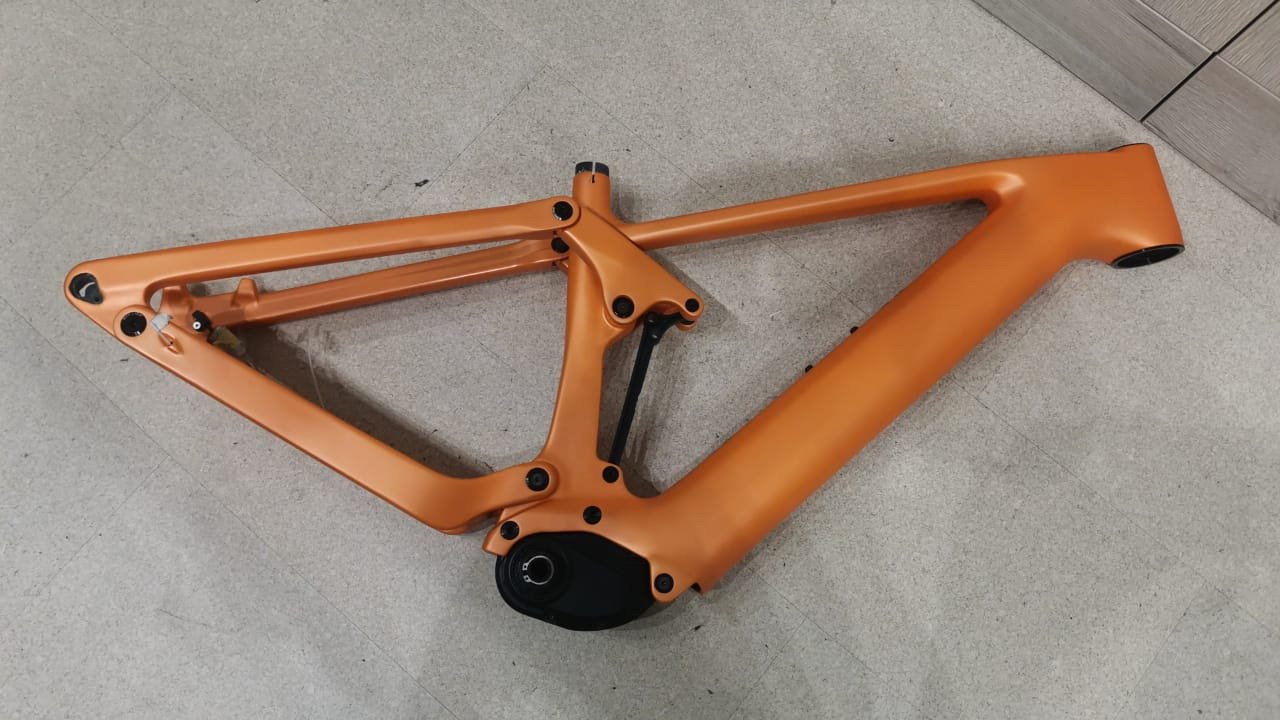

Just ordered my CEF50 frame, 720W battery and m820 motor. Anyone have a build spec they would like to share with links for parts. New to start collecting the components. Shooting for ~40lbs build.
Thanks.......dp
Scroll up my build. And it's impossible to build 40lbs with 720Wh battery. With better components than me I think U can get around 42-43lbs.

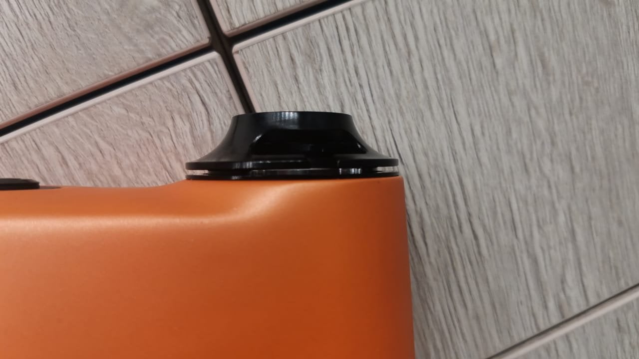

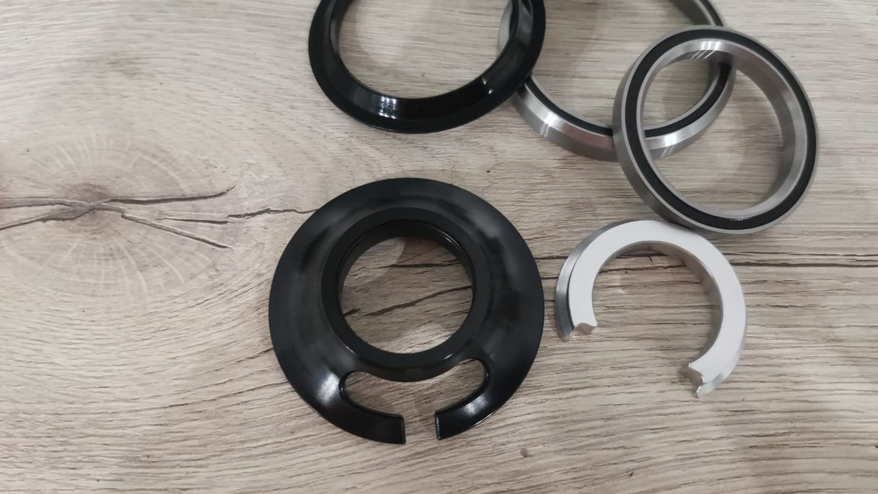

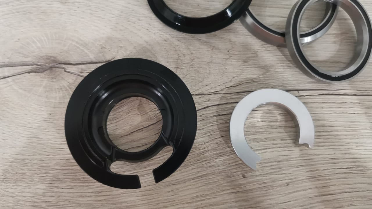

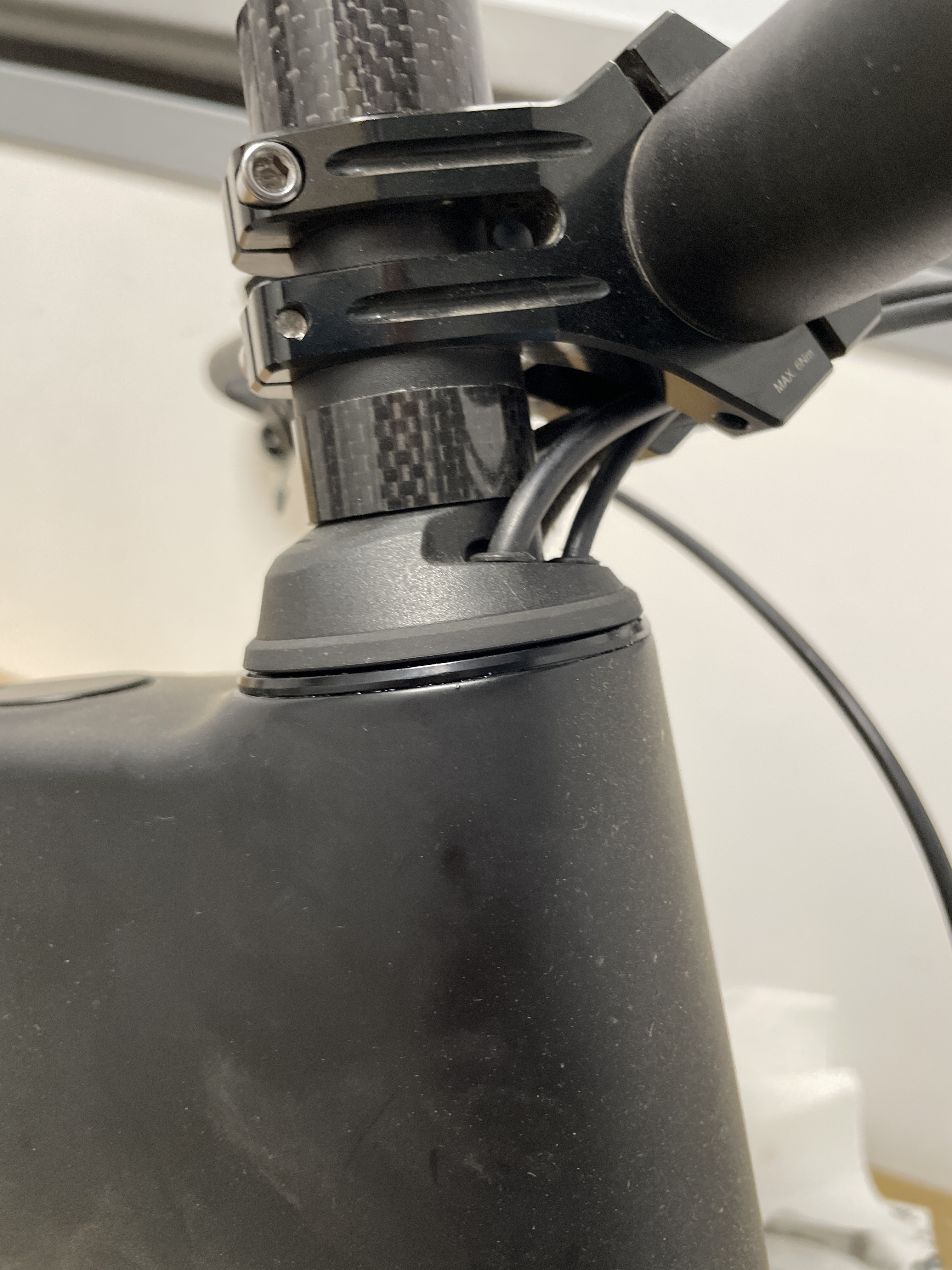

Please take a photo of the headset, a photo from the side. Is there a gap between the frame and the top cover?
@LAnton could you have been sent the wrong bearing? Diameters inside and outside ok but the thickness/height is wrong?
The Nukeproof/Token bearing is 7mm thick.

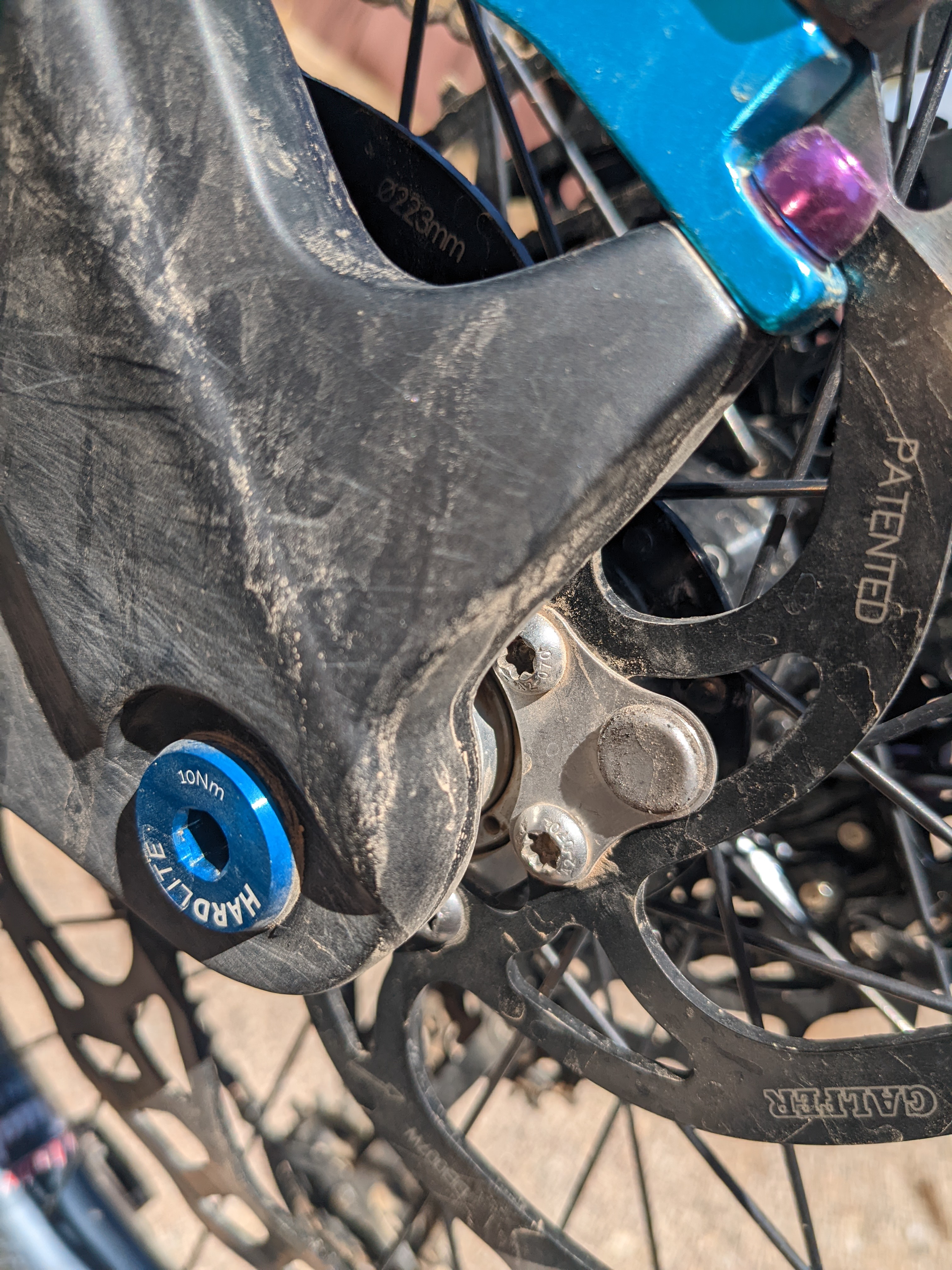

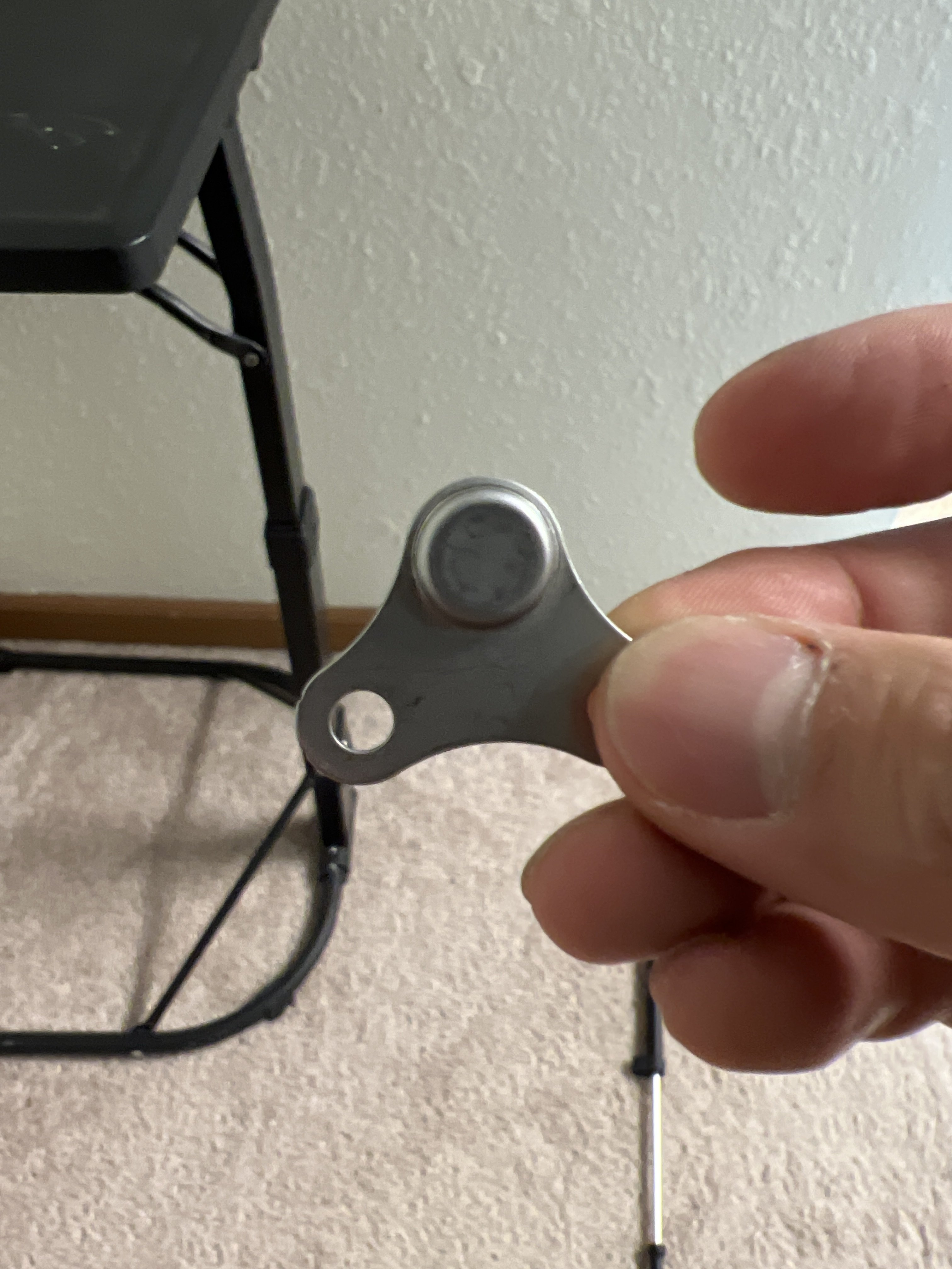

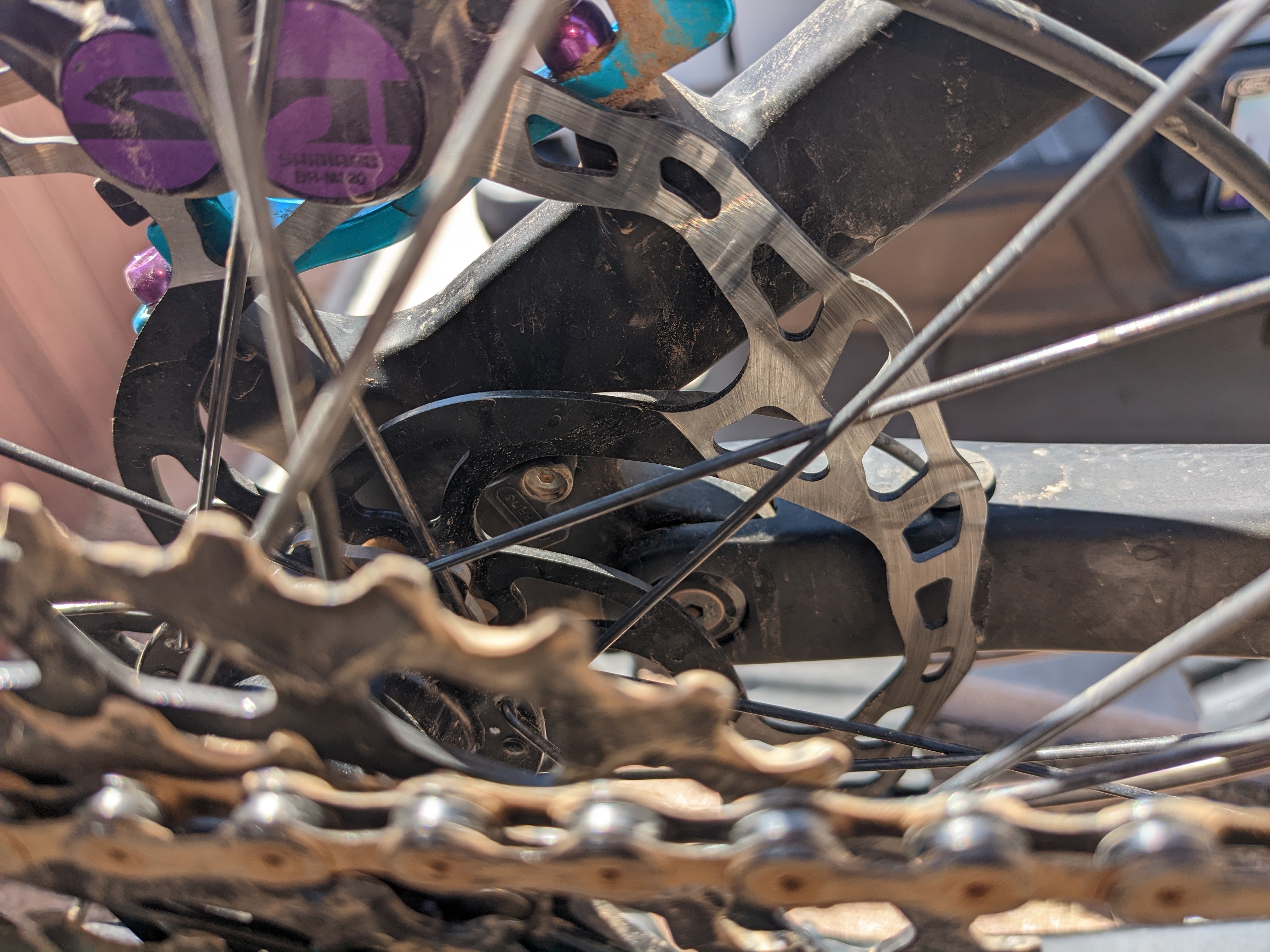

Anyone have pictures of how they installed the magnetic sensor? Not quite sure how this thing even works..
Btw is this the sensor? It doesn’t look anything like what is on bafang s website.
Kenk3589
May 5, 2022
61
39
Usa
Doesn't that mount to the brake rotor? Looks like the pickup magnet for the sensor
Lol it does. Thank you!
So now my bike turns on and the motor starts for like 2 seconds and then the motor power shuts off. The handlebar component is on but motor just doesn’t go.. anyone have experience with this?
TCFlowClyde
Feb 26, 2022
1,227
789
Mesa, AZ
Probably your speed sensor.
Bolt on rotor magnet.
Adjust frame sensor to make sure lined up.
Keep adjusting alignment as needed.
