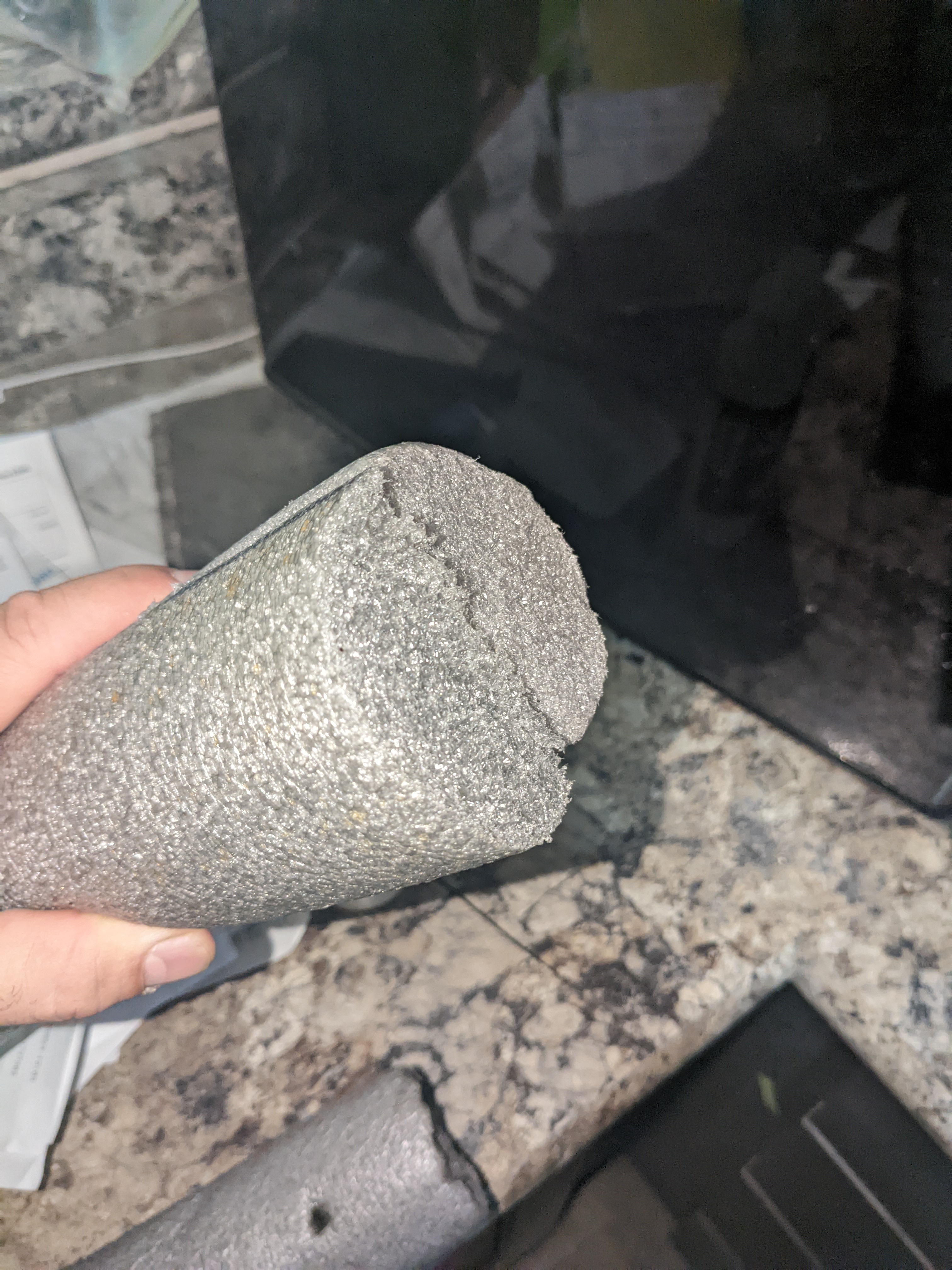

Could be. But the original mount holes will give easier access to the target areas for spray. And the toptube cover will give a little better spraying access at the top of the battery. Plus, they're tubular, closed-cell foam to purchase. 3-4" diameter could be key. Or use both. Shoot the spray just to hold the closed-cell foam inserts into place? 👍 I like it!🫡

Or maybe you are right...no foam spray...just the closed cell foam inserts. 🤙
There is about about a 4-5" space between the motor mount area where it's locked in. It'll have resistive counter pressure with aerated CC foam inserts. Then at the top, use 6-10" insert in the head tube area. Plus, CC will mold a little better to inner tube contours and cable feeds. Maybe be a tighter fit with some extra water resistance 👍

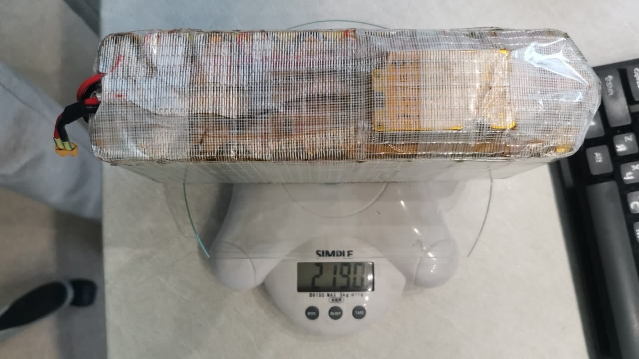

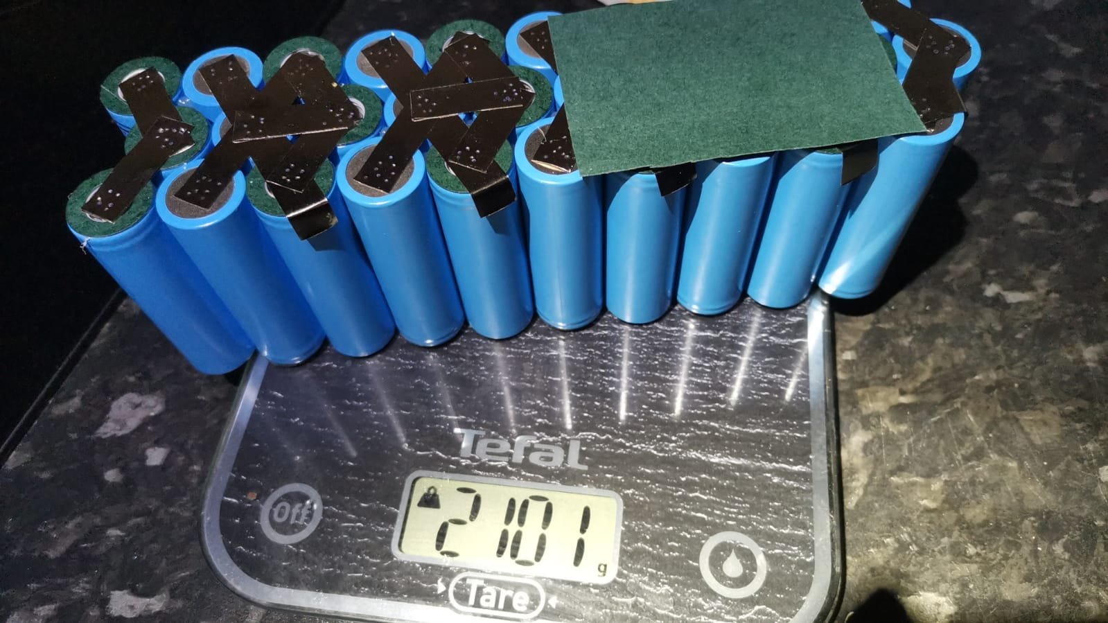

Nice alternative! 2.2 kgs/4.85 lbs. 28Ax3px10s =840 Wh!
Vs. SZZS 720 Wh 4.0 kgs/8.18 lbs.
4.0 kg - 2.2 kg = 1.8 kg/3.97 lbs. Savings? 🫣
Holy sh$$t! I can shave off this much weight?💪
Is the casing really that much extra weight?🤔

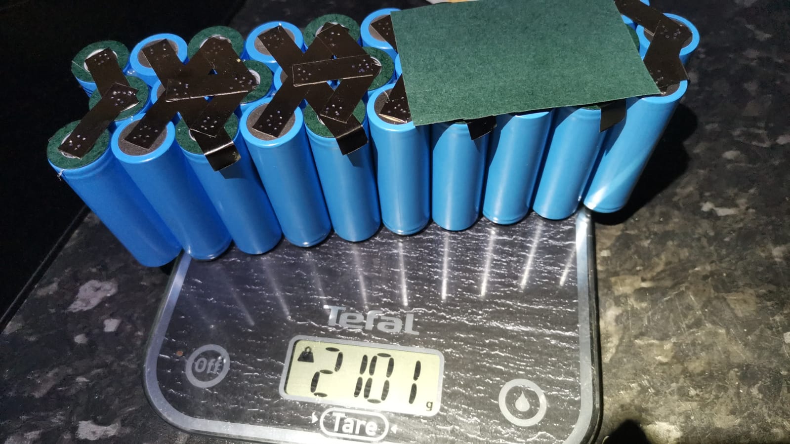

1 x 21700 cell = 60 g.
60 g x 30 cells (3p/10s) = 1800 g + 400 BMS/wrap = 2200 g.

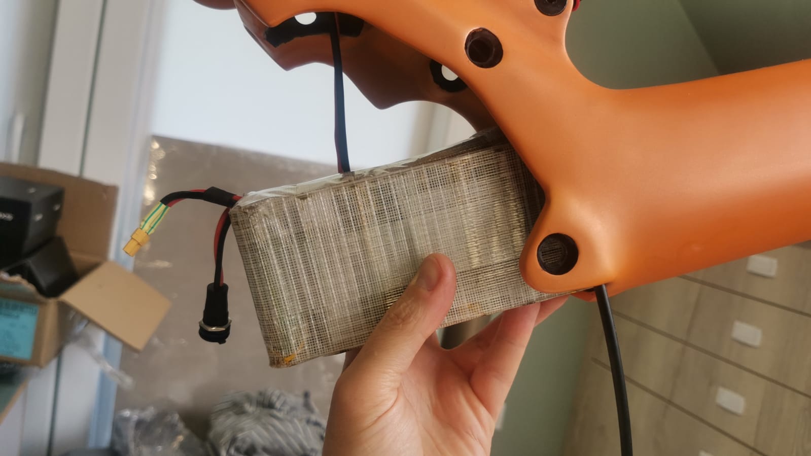

It fits solidly in the frame with no fasteners? Wouldn't you still need a bracket at both ends to plug and isolate movement up and down the tube?
The next big question. How to save that much weight, there must be a light-weight retaining solution to firmly hold the battery in place?
Someone really smart and creative, what are some possible solutions?🍻

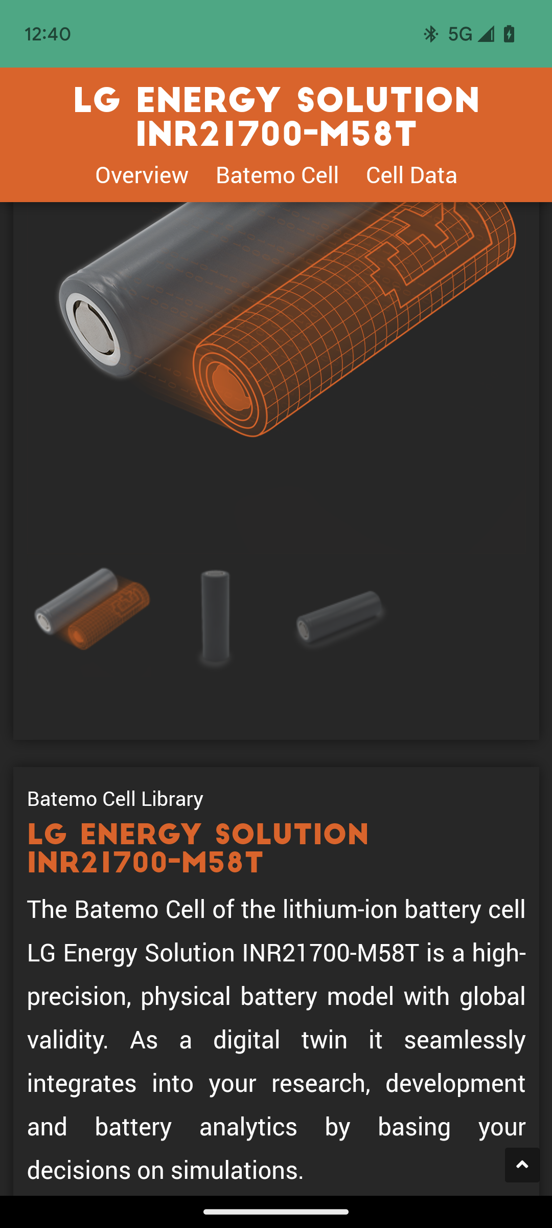

The math isn't adding up with what they claim, with 30 cells total each 21700 would need 28wh. The very best cells on the market only offer 20.88wh right now with your way more common 5ah cells hitting 18.5wh. Originally they claimed it was a 10s6p or 60 cells, that's roughly 4.66ah per cell so way more likely, I assume the 3p claim was a mistake.
Your assumed weight would be roughly 550wh with a common 5ah cell. Get your hands on a lg m58t or vapcell F58 rewrap (5.8ah) and that could be 625wh. Samsung 50e's are around 69g each though, 5.8ah cells are closer to 74g each. So slightly heavier than your assumption.
If you went to a 10s4p pack though that's 740wh for the 5ah cells, at 2760g plus the other materials. Go with the 5.8ah option and you can get another 100wh or 835wh but slightly more weight at 2960g for just the cells.

For sure, although probably close to 2 lbs less once you get the bms and cells all welded together but good amount of weight savings you just need to make sure its well secured in the frame. I know a lot of people talked about not wanting the larger 720wh pack but delays made them choose it. The 10s3p with lg m58t's I think would interest a lot of people, roughly probably 2.5kg once all welded up and still 625wh for a good middle ground in capacity. 1.5kg in weight savings could maybe get some under the 40 lbs mark!

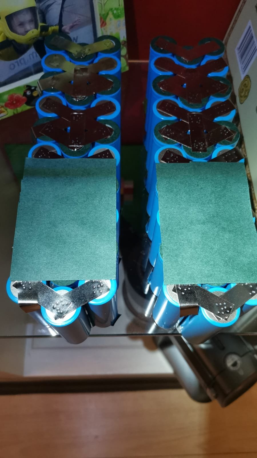

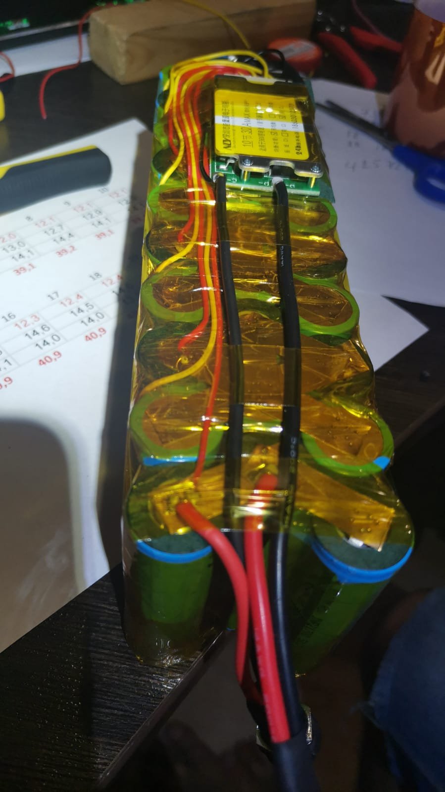

If I'm understanding correctly, you have 2 battery packs.
Each pack is 10s3p 36v 14Ah 504Wh 21700 cells 230x75x60mm 2.2kg
For those of us on a diet, this is fantastic! Bafang F014 410Wh battery pack is 470x63x52mm 2.55kg
Apart from the obvious Wh/kg ratio, I'm as much interested in the weight distribution of LAnton 's package :)
The length 230mm vs 470mm is half the length! This means with LAntons pack, ALL the weight can be mounted much closer to the bottom bracket. This should improve bike handling, jumping, berms etc...

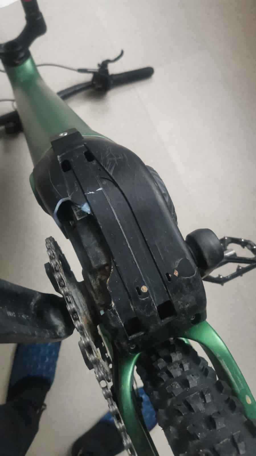

You understand that the manufacturer makes safe batteries. Only we ourselves can make the battery lighter and safer.

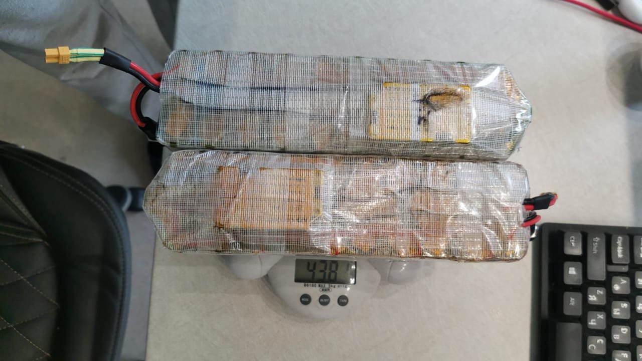

WhatsApp Image 2023-06-14 at 14.47.03.jpeg WhatsApp Image 2023-06-14 at 14.47.04 (1).jpeg WhatsApp Image 2023-06-14 at 14.47.04 (2).jpeg WhatsApp Image 2023-06-14 at 14.47.04.jpeg
These packs not looks safe unfortunately. To prevent wibrarions under mtb ride.. one guy made similar with dengfu frame and catch fire 😅
It's not funny :-( The battery should be made by a professional, not a guy on dengfu. A modern battery can catch fire if it is damaged. Modern cells have protection in the form of a valve. If the battery overheats, the valve is damaged. The battery is also protected by BMS
Yea it was made by customer. Better to let do it by professional than stayed dangerous
