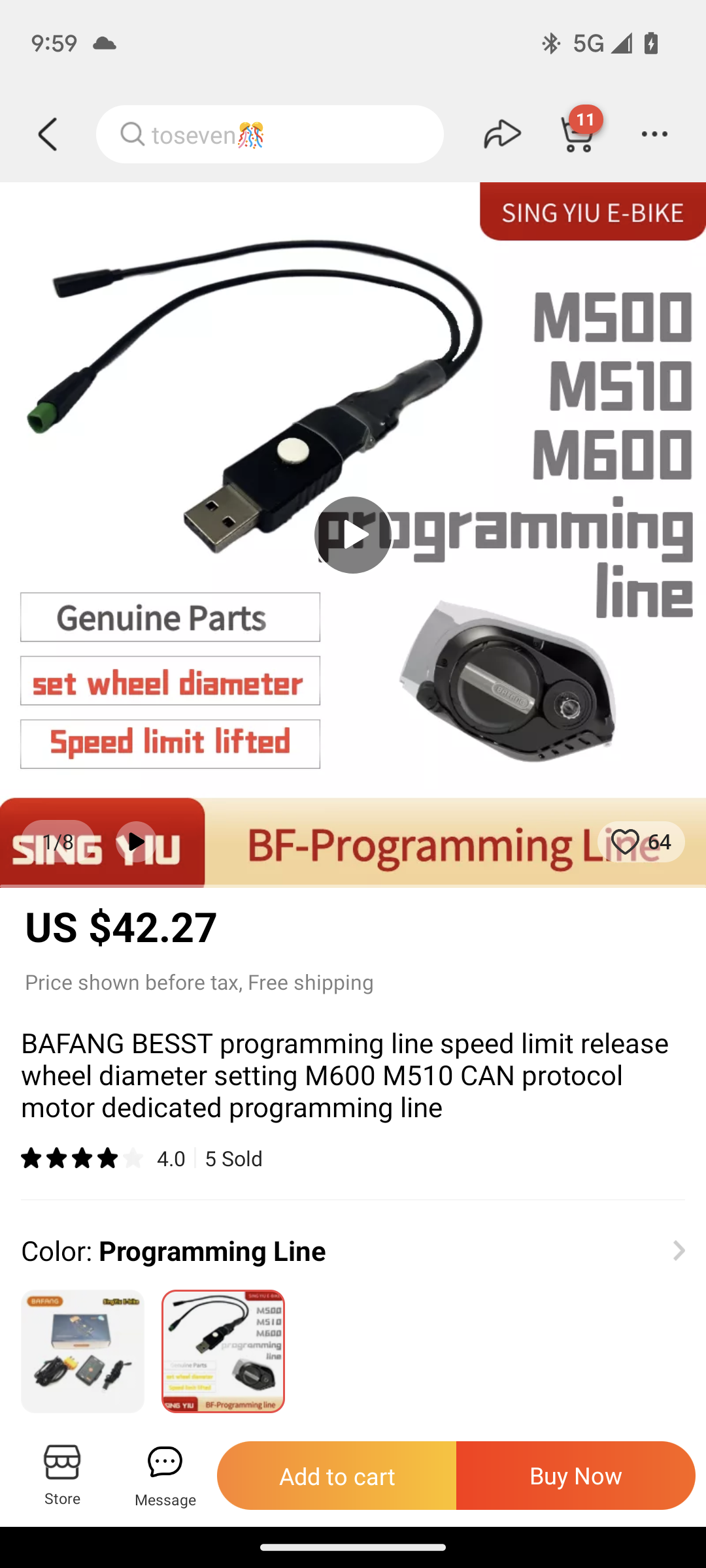

For me it's very useful. Can setup every level assist parameter with our need. Also can recalibrate sensor position, setup speed limit and wheel circumference.
Interesting. So, I CAN juice up the walk mode with BESST then?

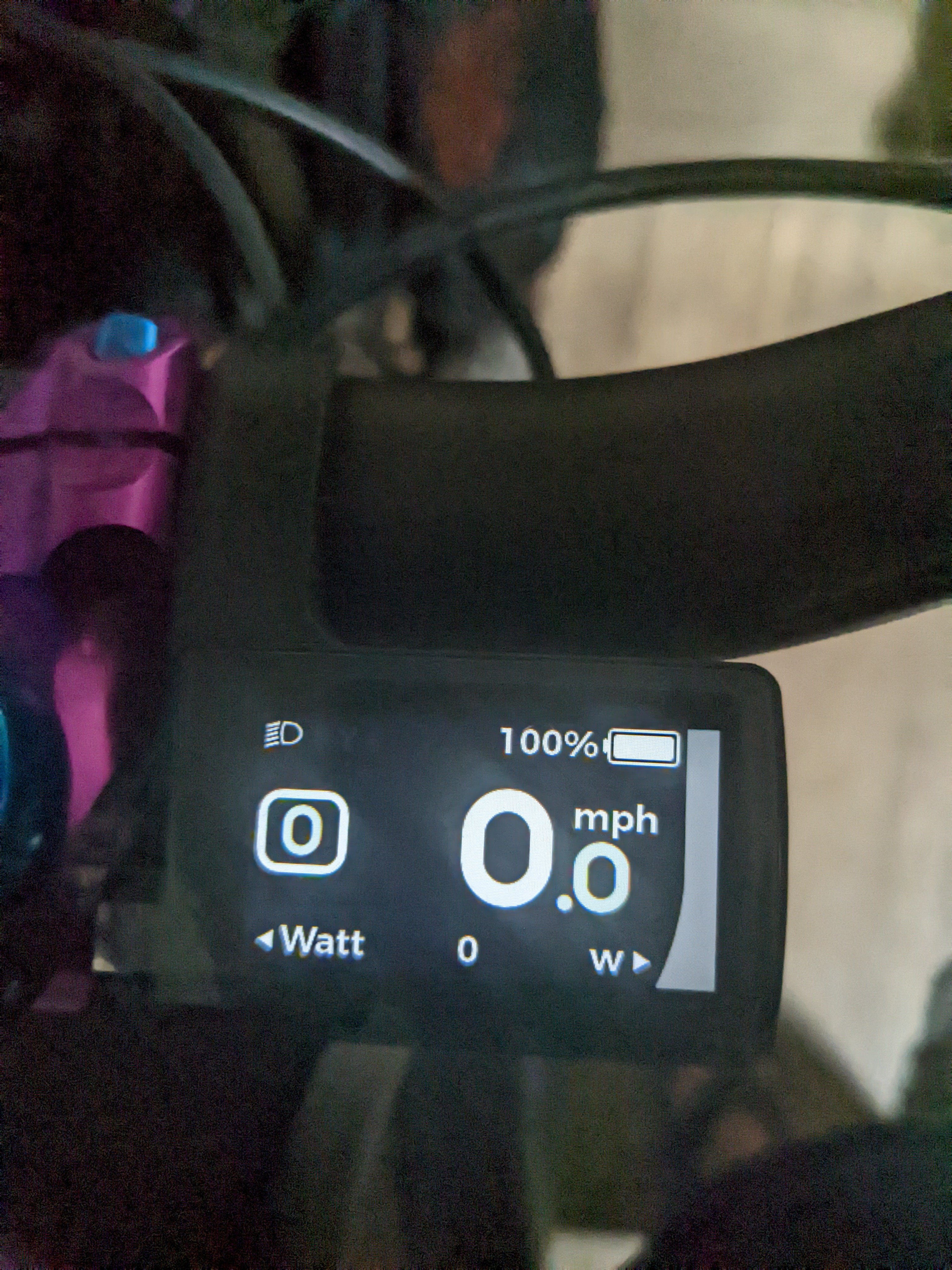

BTW a crude power meter exists in the DPC245. Others may have mentioned already but discovered that Watts units is an option in the DPC 245 just the other day...might yield a basic, metered comparison in each mode for those willing or even caring to tinker with optimal power modes. 🤔
Like I said prior, factory settings seem discreetly incremental and progressive.
👍 Overall, the watt-meter-mode is not quite like a fancy power pedal meter, but it's something useful to compare power output.
Like I said prior, factory settings seem discreetly incremental and progressive.View attachment 118055👍 Overall, the watt-meter-mode is not quite like a fancy power pedal meter, but it's something useful to compare power output.
Have you tried it out yet? What kind output is it giving you?
No...I just scrolled on it by accident two days ago. It's got a lot of functions (9 total) in the power button:
✅Trip,
✅ODO,
✅Ave speed,
✅Max speed,
✅Est. range,
✅ Calories,
✅Time,
✅ Cadence,
✅ Watts.
