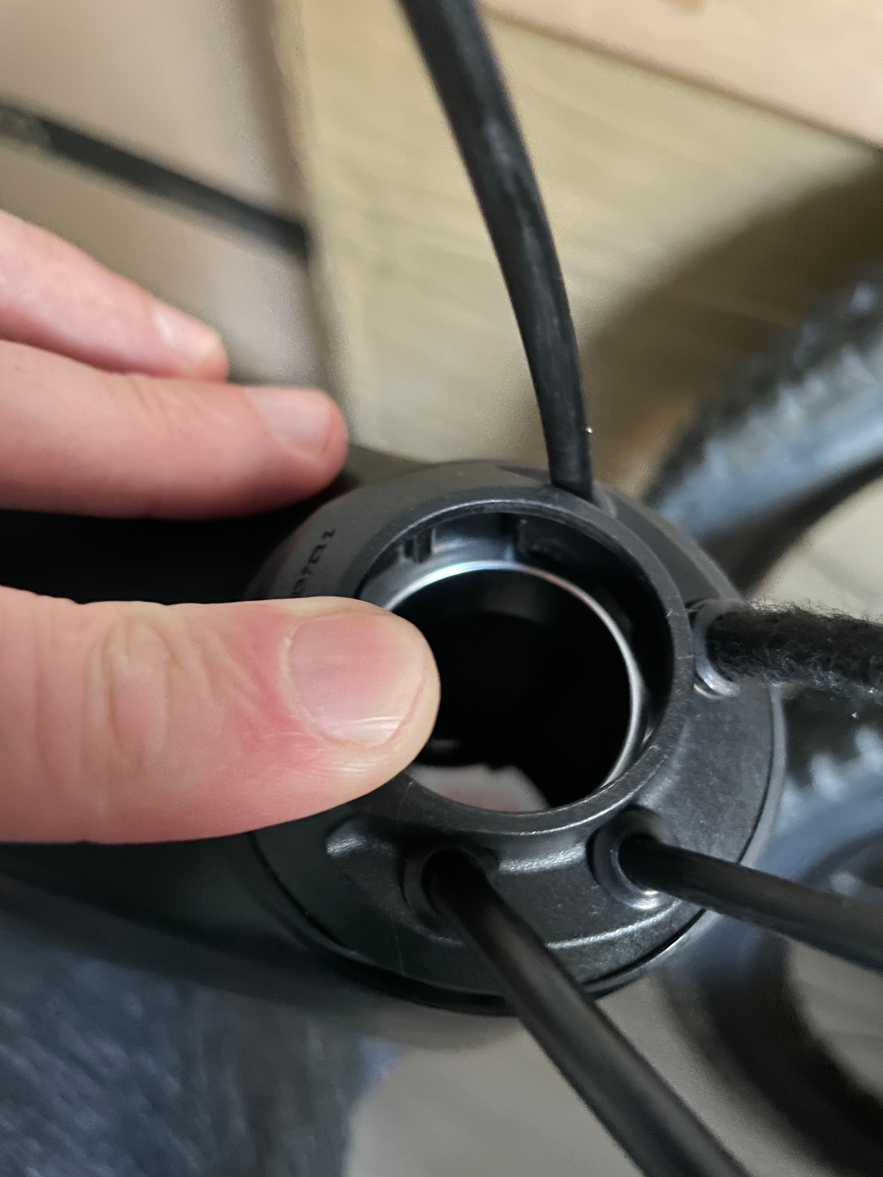

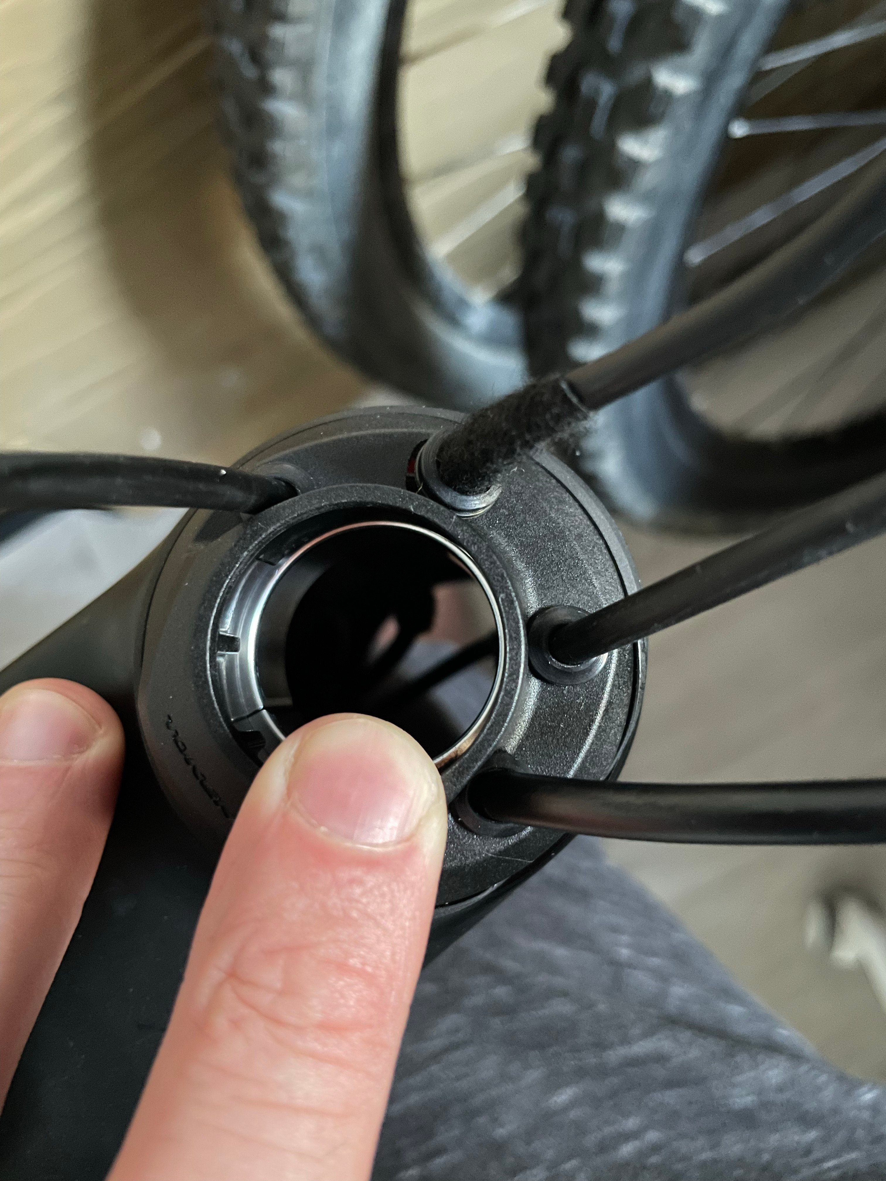

Could the cable, with the cloth tape on the outside, capillary water in ?
Well, thats because it’s the electric cable that connects to the DP E181 control. That wont get visible and the cloth will be under the headset after I install the handlebar to get the correct length
That one will work fine also.
Apart from that a headset install tool if you’re changing the one that came and thats pretty much all its needed apart from allens and a torque wrench
Thanks, I think now I have everything else :)

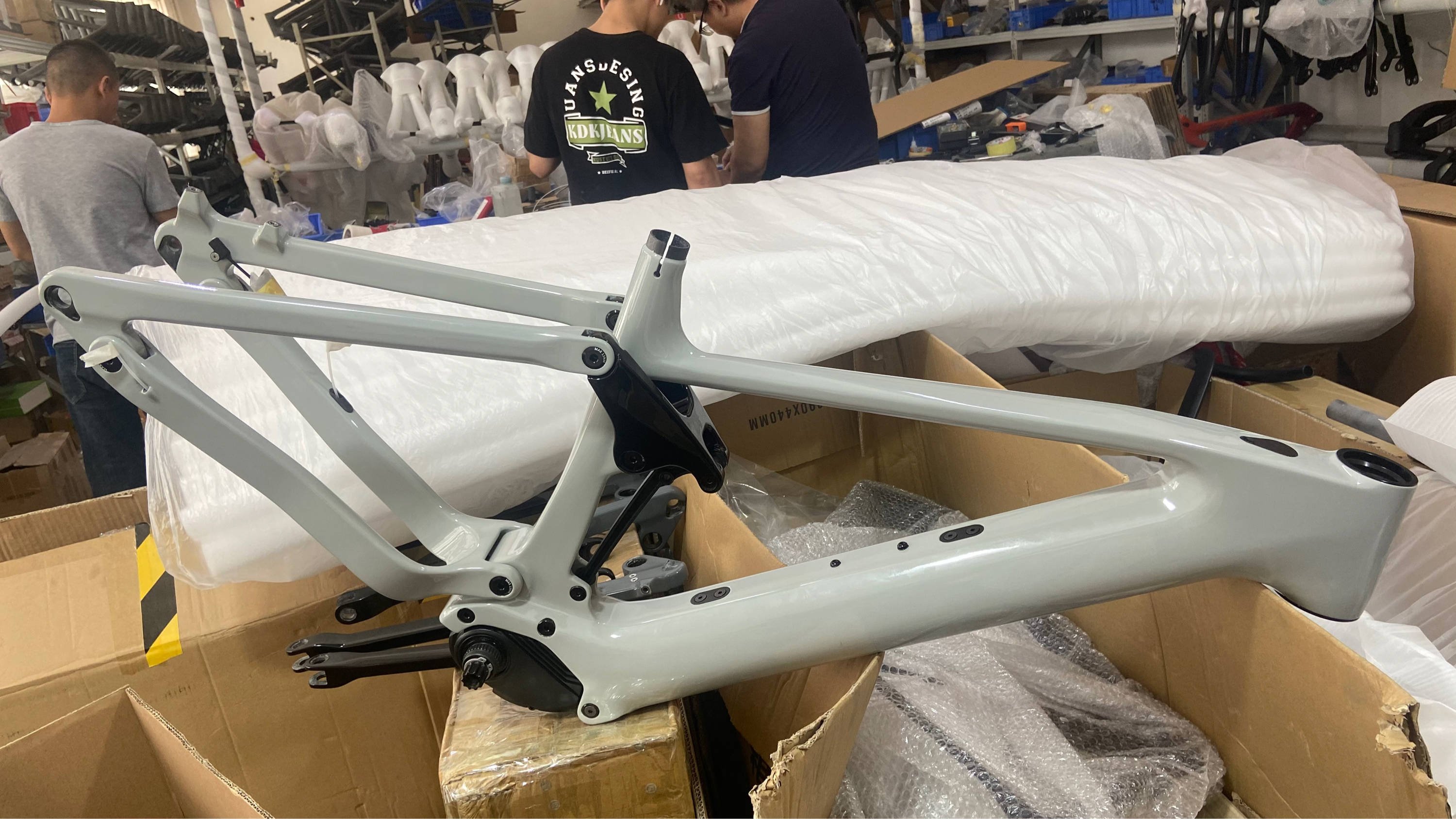

Same here... settled on the 720wh battery as I don't want to wait any longer. It's ready to go but heading out on a different slow boat next week to Canada. For now, all I have is this picture to stare at. At least she's looking good!

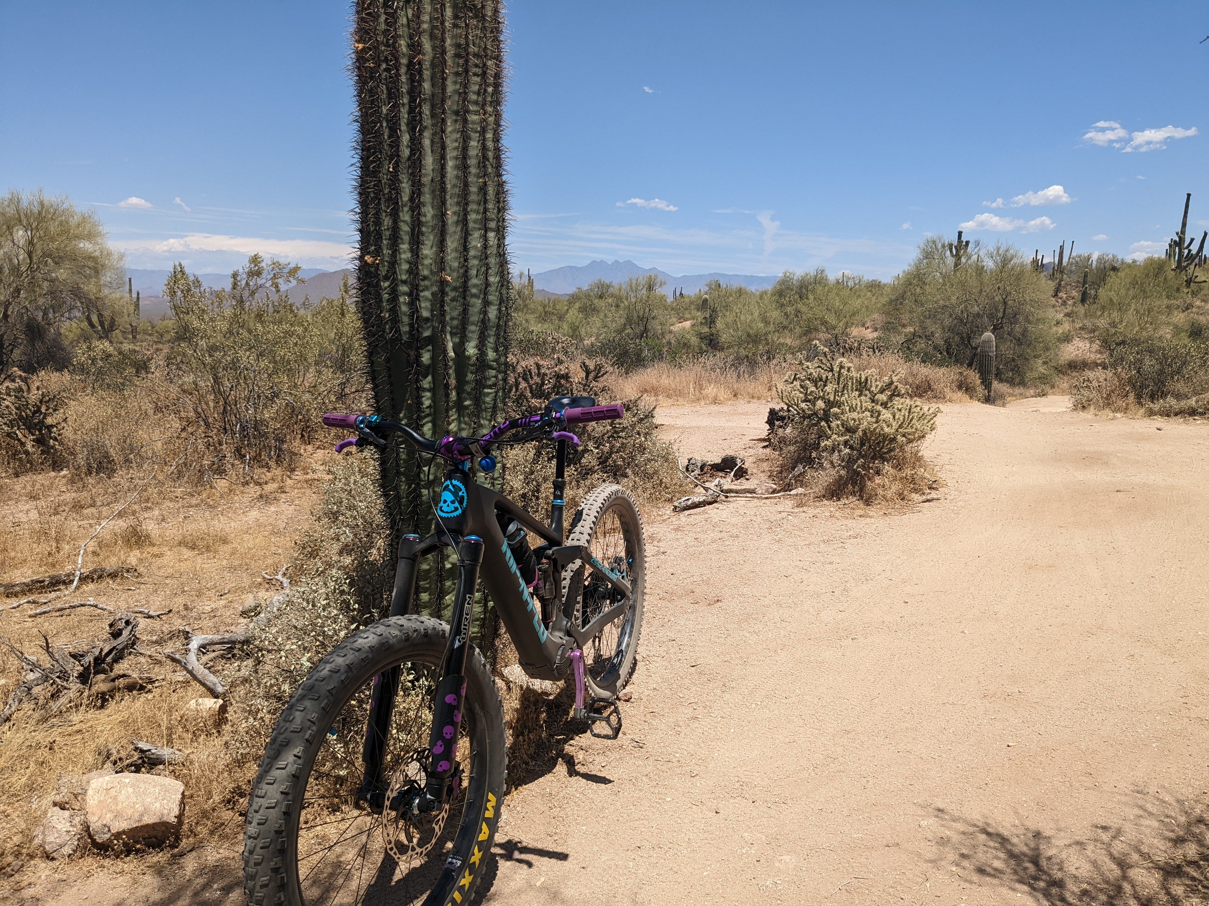

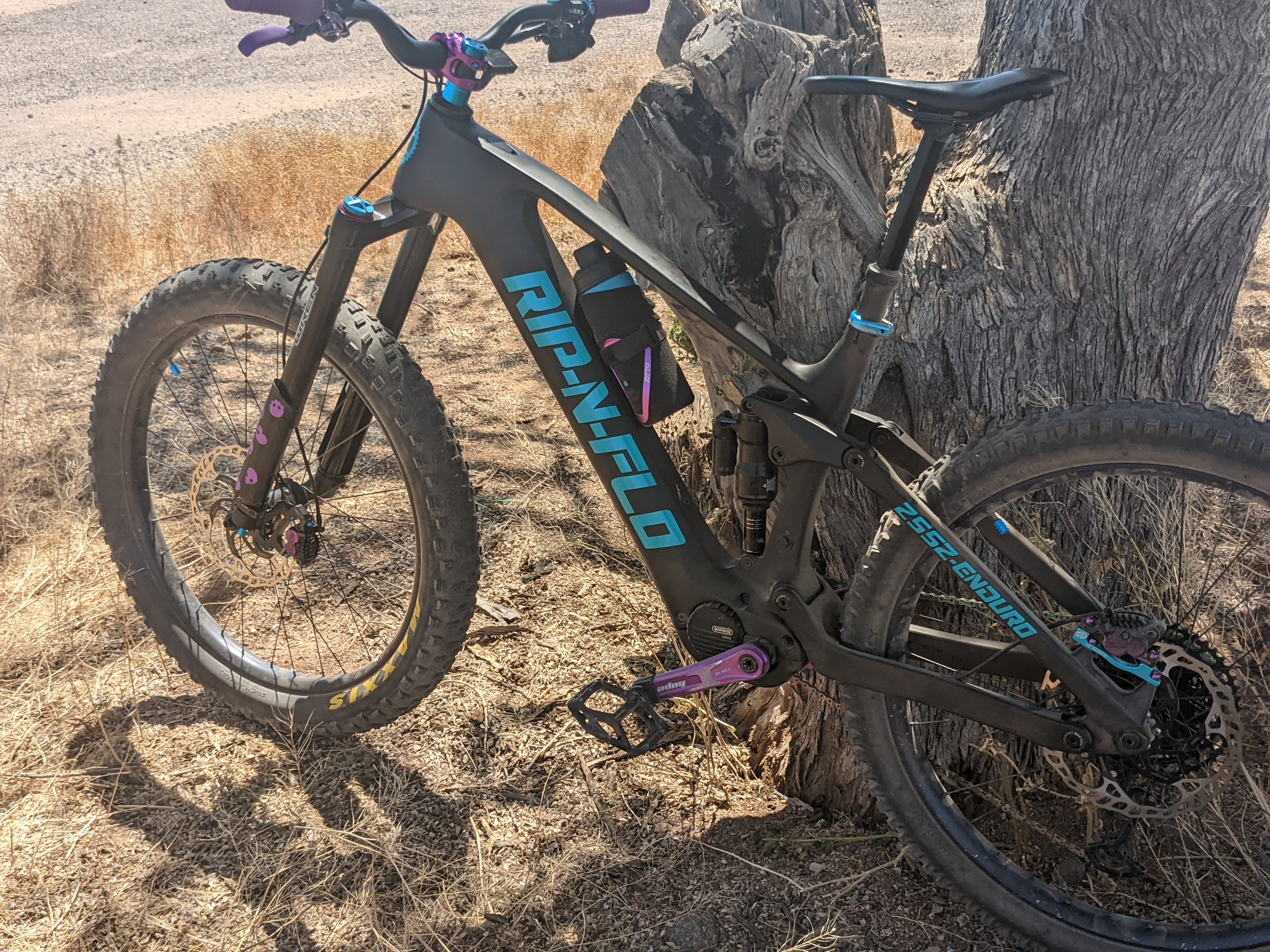

Hey Folks! Hells yaaaa!🤙 Totally worth it! First ride was this morning. Built up a burly trail version 160f/165r for now. It's slightly heavier at 48+/- lbs with big tires, sealant, foam inserts, and pedals.
Waiting on my Zeb 38/180mm upgrades and then I'll install my lighter carbon wheelset, and lighter componentry. But should be 45 lbs soon! 🤞

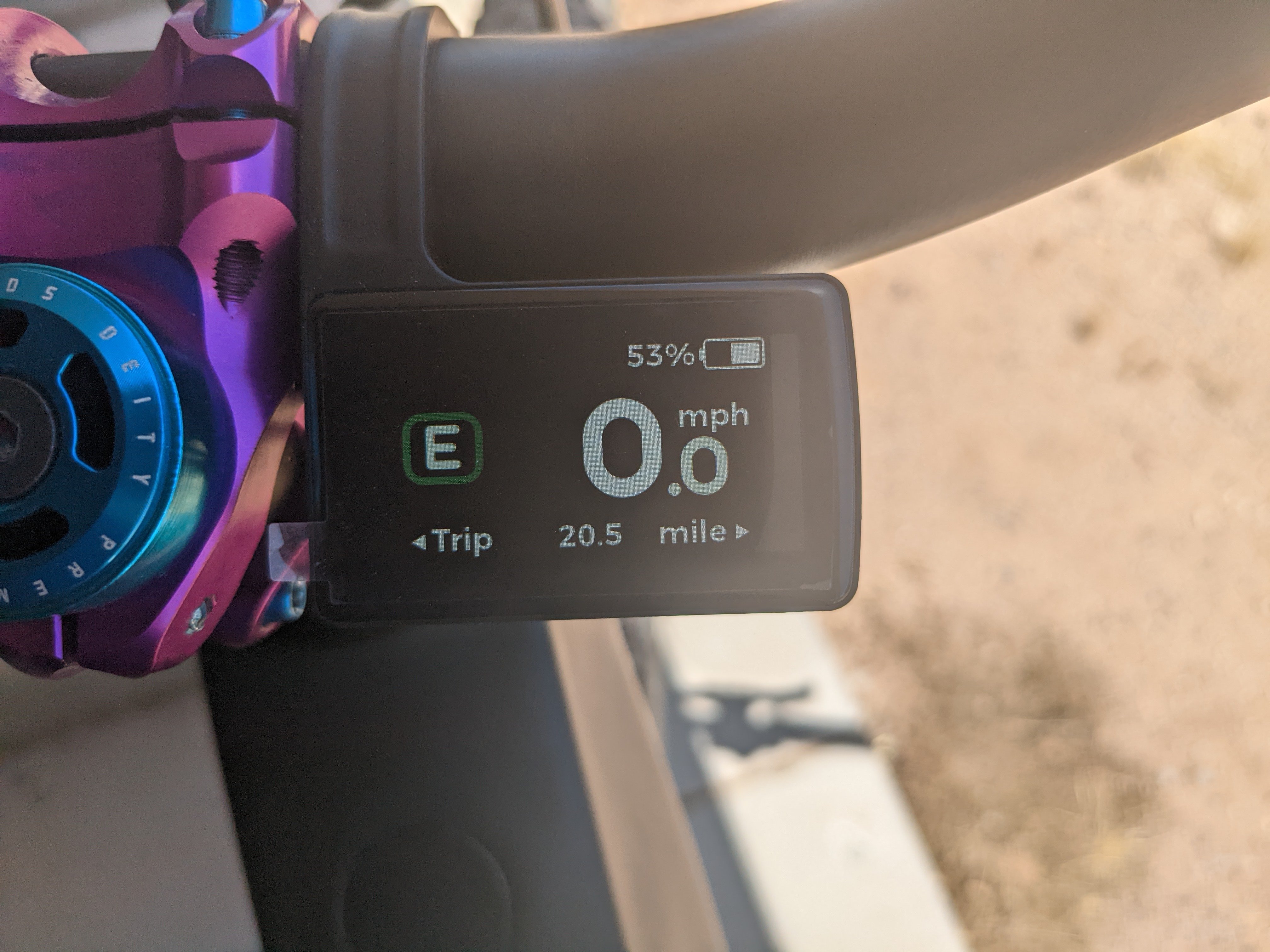

I'm running the 720 Wh battery. And use the 245 color display.
I'm a heavy rider at 285+/- lbs. Did 20+ miles with 53% remaining. Today's trail was flatter choppy, sandy terrain with a few shorty techy climbs.
Stayed mostly in S-power mode (level 3 of 5) 70% of ride with bursts of S+ mode (level 4 of 5) at 20% and B/Boost-mode (5) at 10%.
Pedal drag exists, but it's low. I pedaled on zero mode for 1 mile in sandy, soft conditions...it's doable but not ideal of course.
Superburst "Rocky" doesn't exist for the 245 display. But it's unnecessary. I have a 181 display too, and I'll try that soon to see if it exists there.
Major Pro: 👍 The Bafang-M820 -75Nm power is 3/4 of a full-powered motor. It's by far way stronger than the TQ50, Fauza60, RS60! It really feels more like 75-80 Nm! IMHO😇
Minor Con: 👎 The motor whir is a mild tea kettle-like whistle in all modes. It doesn't both me at all!

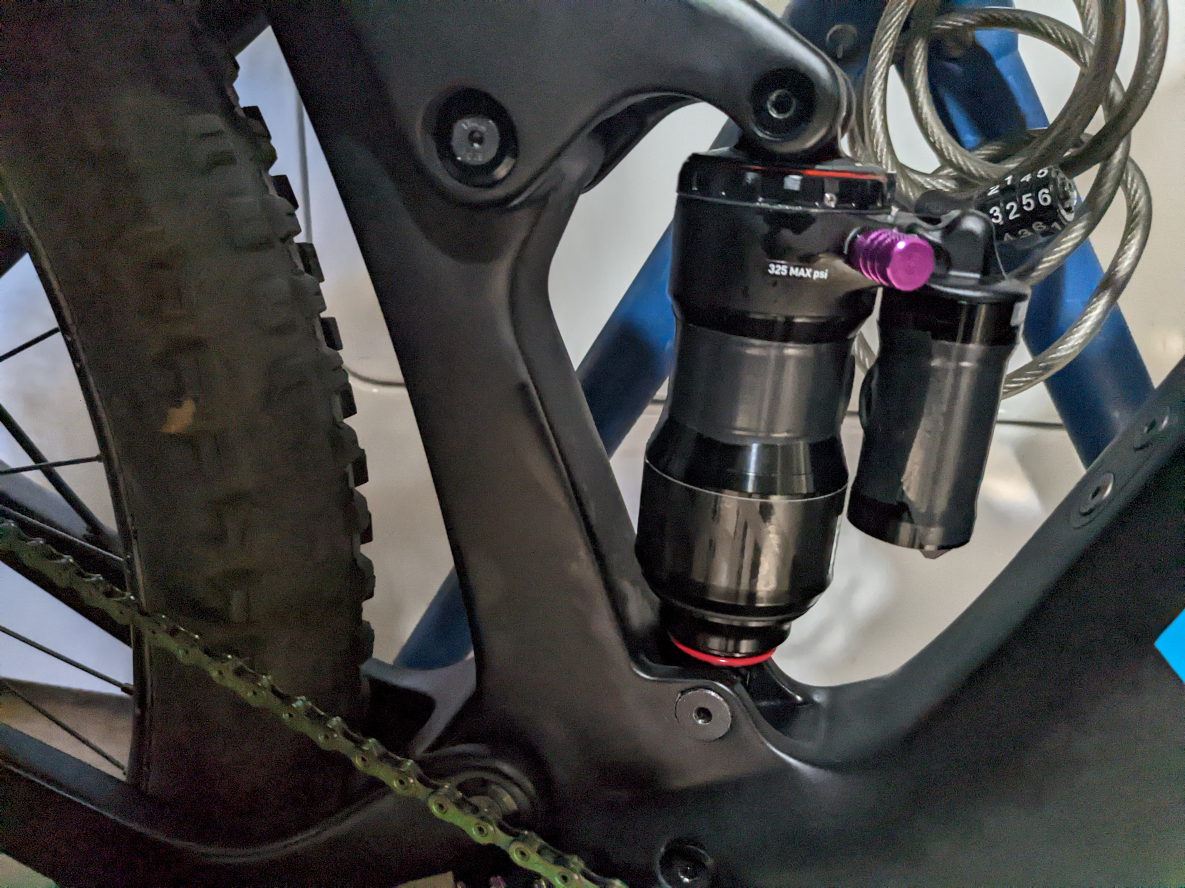

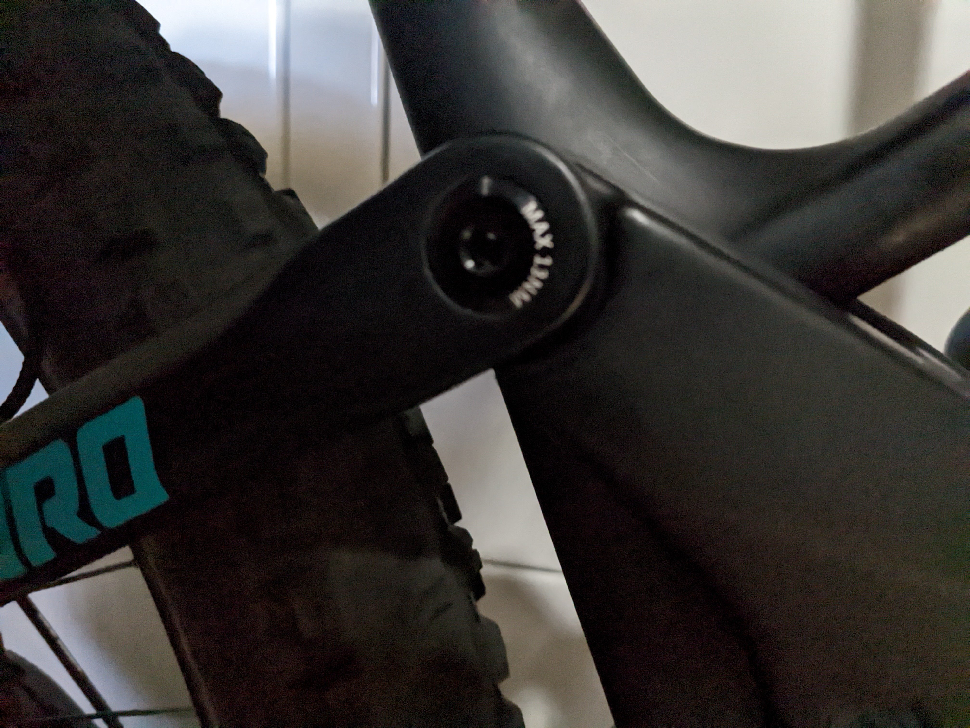

The CEF50 rides well. And I was able to run my fatter RS SLDX MegNeg 210 x 55 for the bigger 165 mm travel. No binding at the pivot/rocker arm but I only did small pops and drops. So, 55 mm big stroke works for me at least!🤙 I'm looking forward to installing a more balanced 180 travel fork soon!
Overall, the maiden ride was impressive!😎
✅ powerful motor
✅ long range battery
✅ big enduro travel 180f/165r
✅ agile with a lighter rig-feel
❌ Minor whistle-noise
❌ Weak walk-mode (good only for shifting gears off the bike for an optimal setup)
❔Long term frame durability.
4.5 ⭐ out of 5!!!

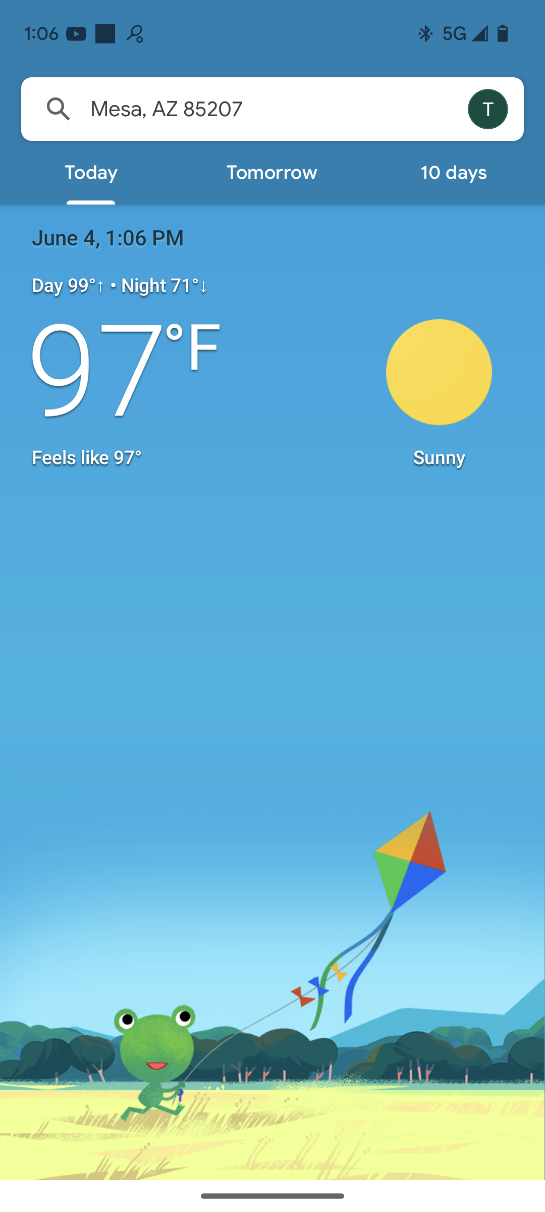

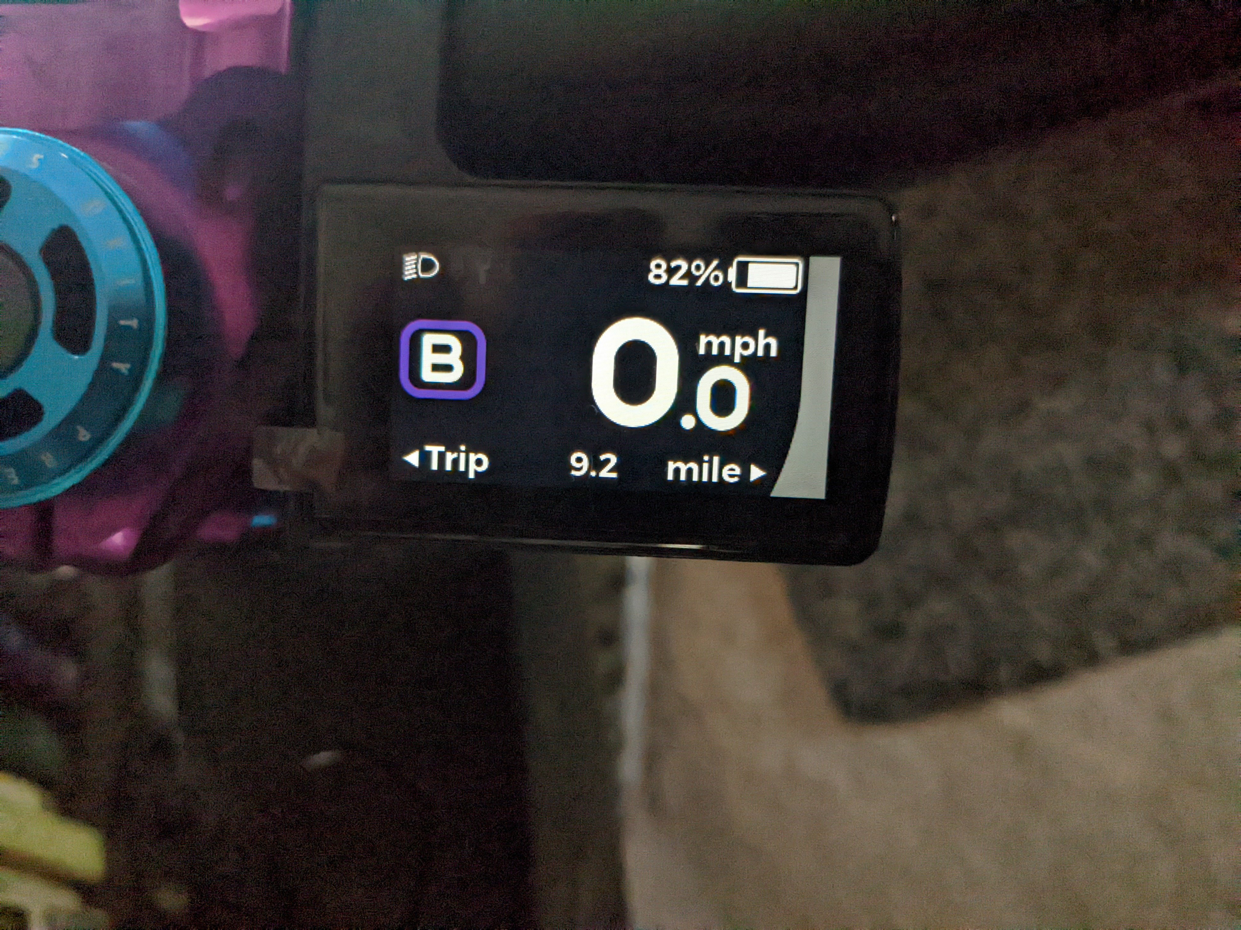

Today was the "hour of power" in decent heat!🥵 97+F°
I went full boost-mode in rolling hills terrain with 65% flowy climb and a smooth, bermed downhill ripper 35%.
Just 53 minutes of 9.2 miles in all turbo to stress test the M820-75Nm performance tolerance during fairly hot conditions. I had 82% battery remaining.
I didn't notice any power drop-off!👍
Personally, I like to climb as an ex- analoger, so I've never been a huge fan of powering up switchbacks moto-style, especially in dealing with strong motor overrun and the drivetrain abuse potential.
The M820 had a little overrun in Boost mode, but it's minimal and can be used smoothly and predictably when climbing most tech. So, it yields a pedal-bike-feel still without being crazy like full-powered or wimpy like lower-to-mid powered motors. IMHO💪😇
Next ride is in the morning for cooler temps and on a fairly steep switchback-oriented mountain climb. This should really put it to the test for my typical riding terrain, and hopefully provide more testimonial feedback!🚵

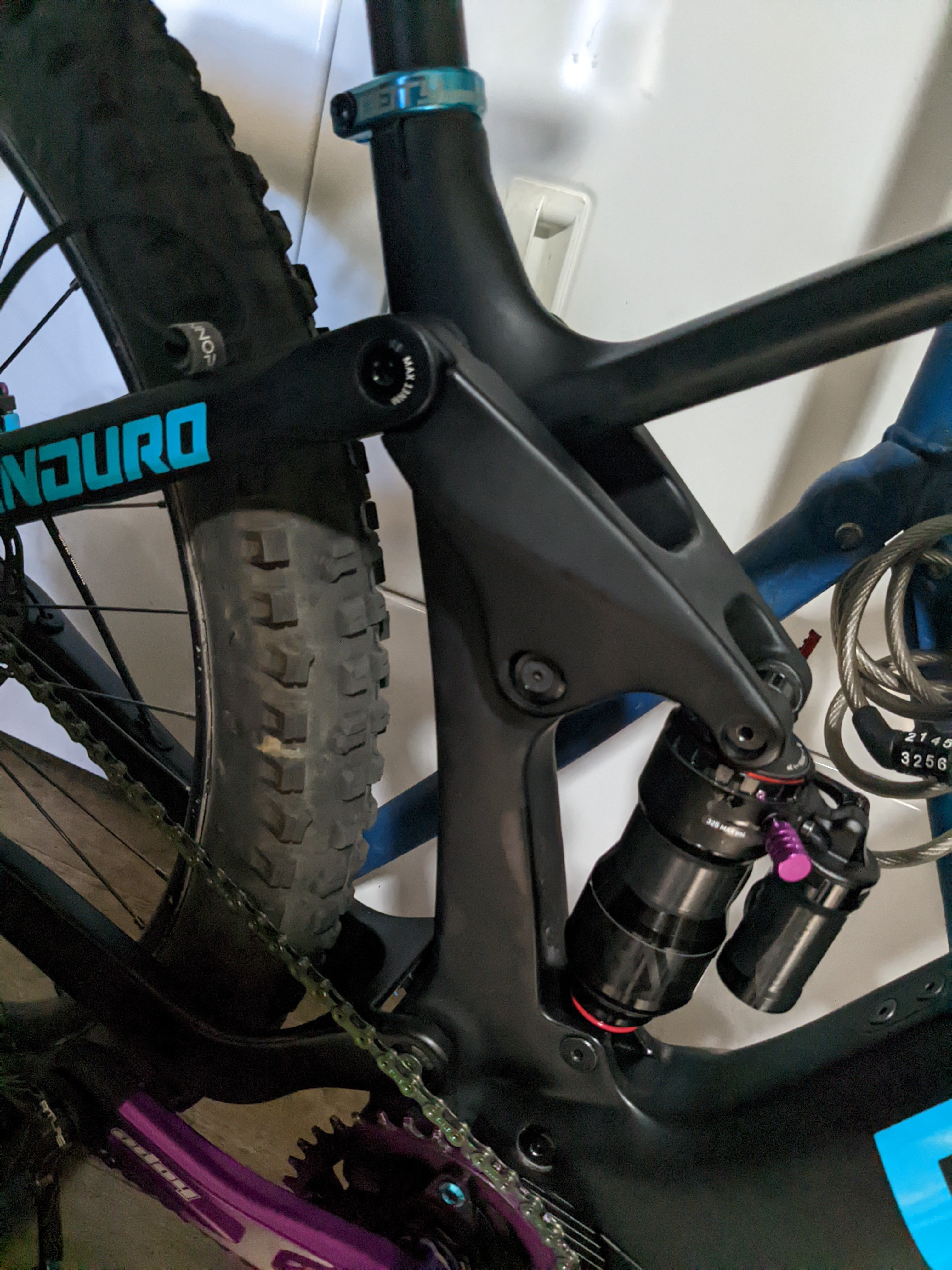

It looks like there maybe clearance for 29 x 2.4 rear tire? what do you think @TCFlowClyde ? 20mm gap from tire to seat-tube? So 210x55 shock with 29x2.4 rear tire?
I guess just try it. If not add, then a travel spacer to reduce the stroke?
My 27.5 + is taller than most 28.6" ish I'd guesstimate.
