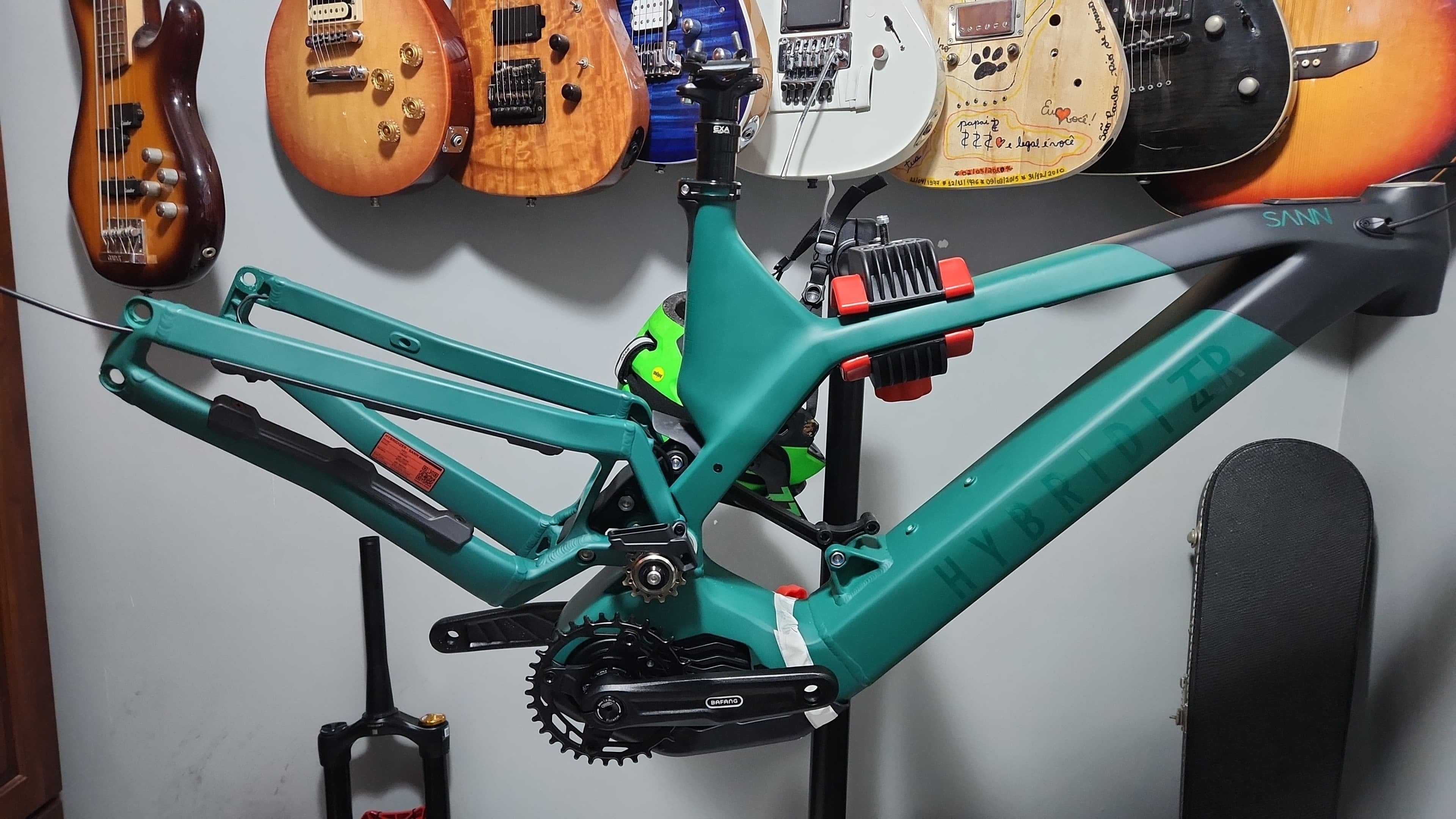

My Hybridizer has arrived.
Now I have to wait for some other parts to assemble it.
I believe mine is the first one in Brazil.

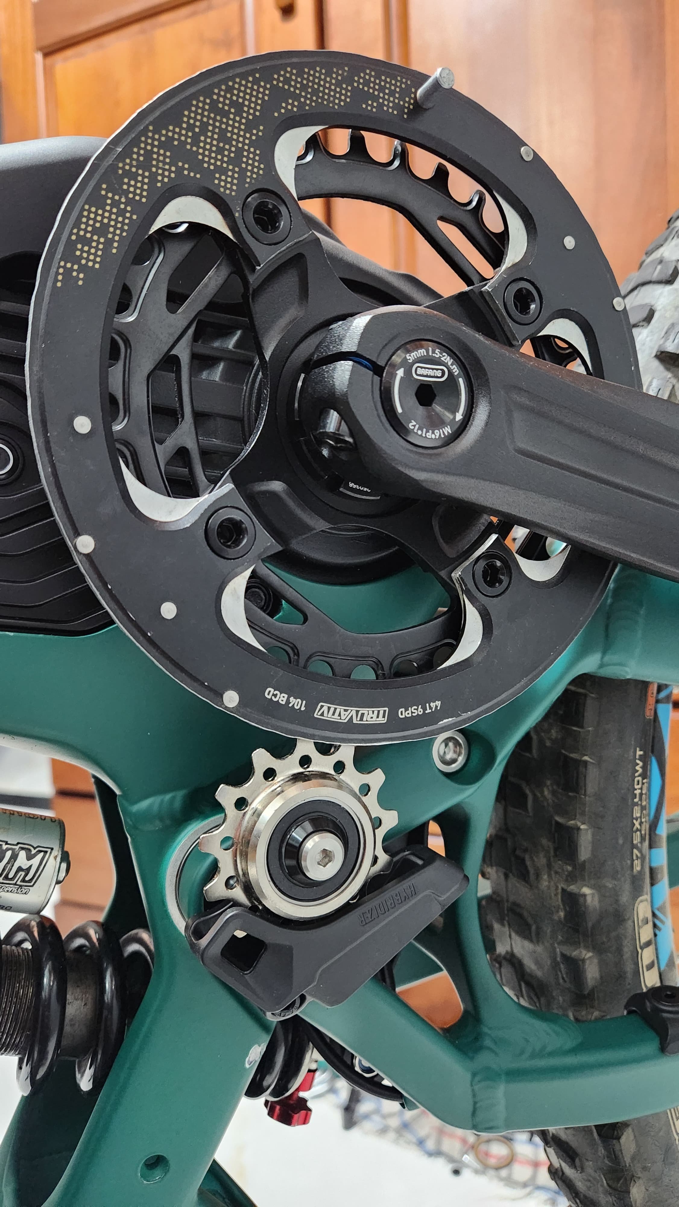

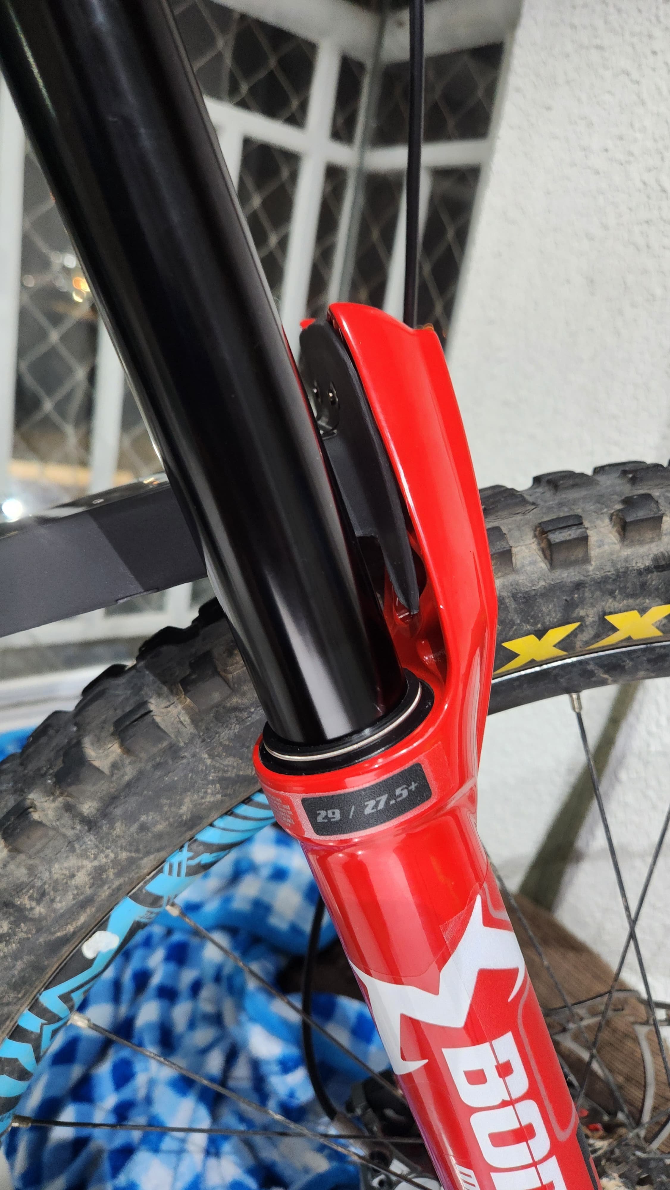

Let me share something interesting. While I wait for the shock to arrive so I can finish my build, I put a protector on it using an old 44T Truvativ. I removed the teeth, and it was perfect, strong and functional. I also bought a mudguard for Rockshox that works on the Marzocchi Z1. Just drill it in the correct layout. This avoids using the locking tapes.
6e411ad0-9eb1-48f2-bac4-ebfb8083ec06.jpg 398cbe44-5659-46d0-923c-8c77a51ccde6.jpg 921cf4c0-c724-472a-b680-d64969fe3ef8.jpg 1d48c3dd-4289-4f29-a729-23e0cb4a1d8a.jpg

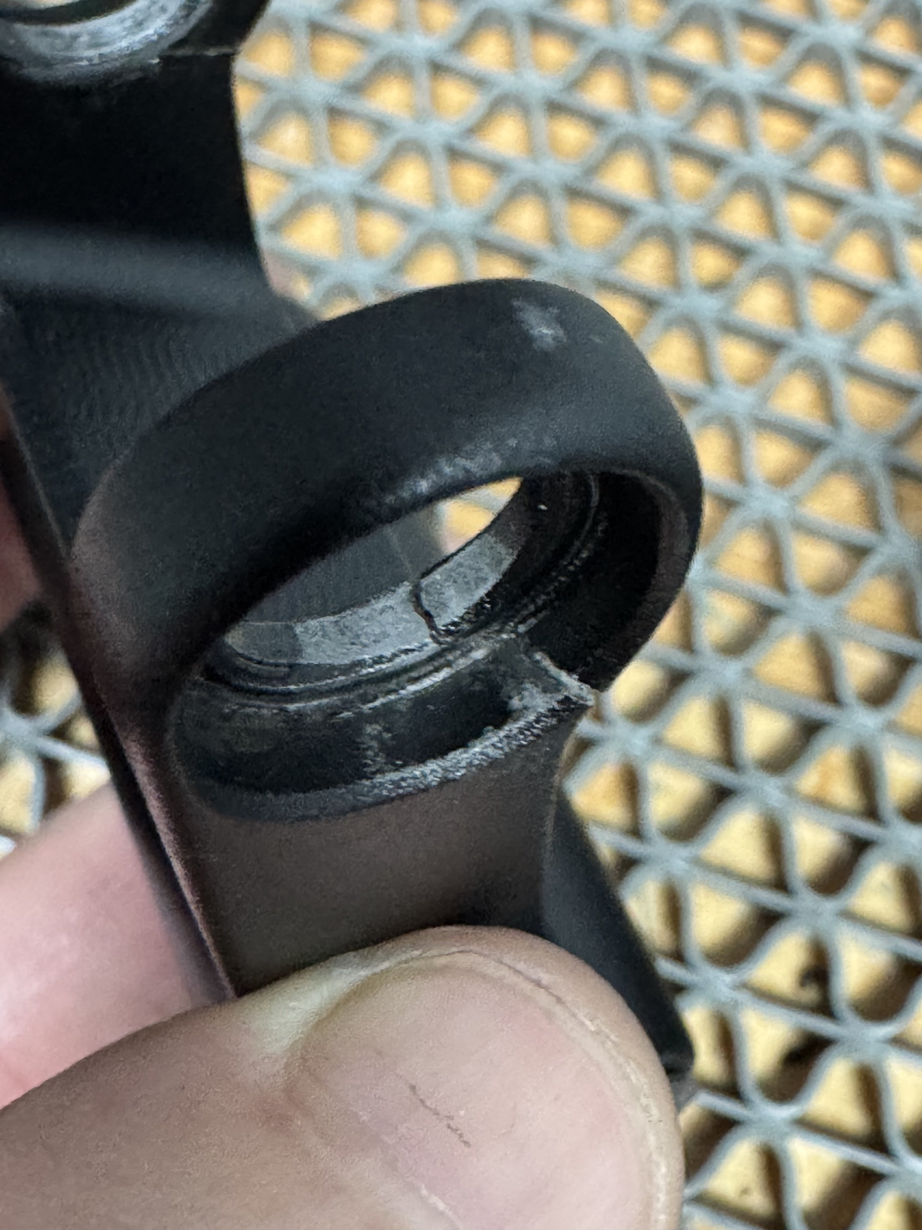

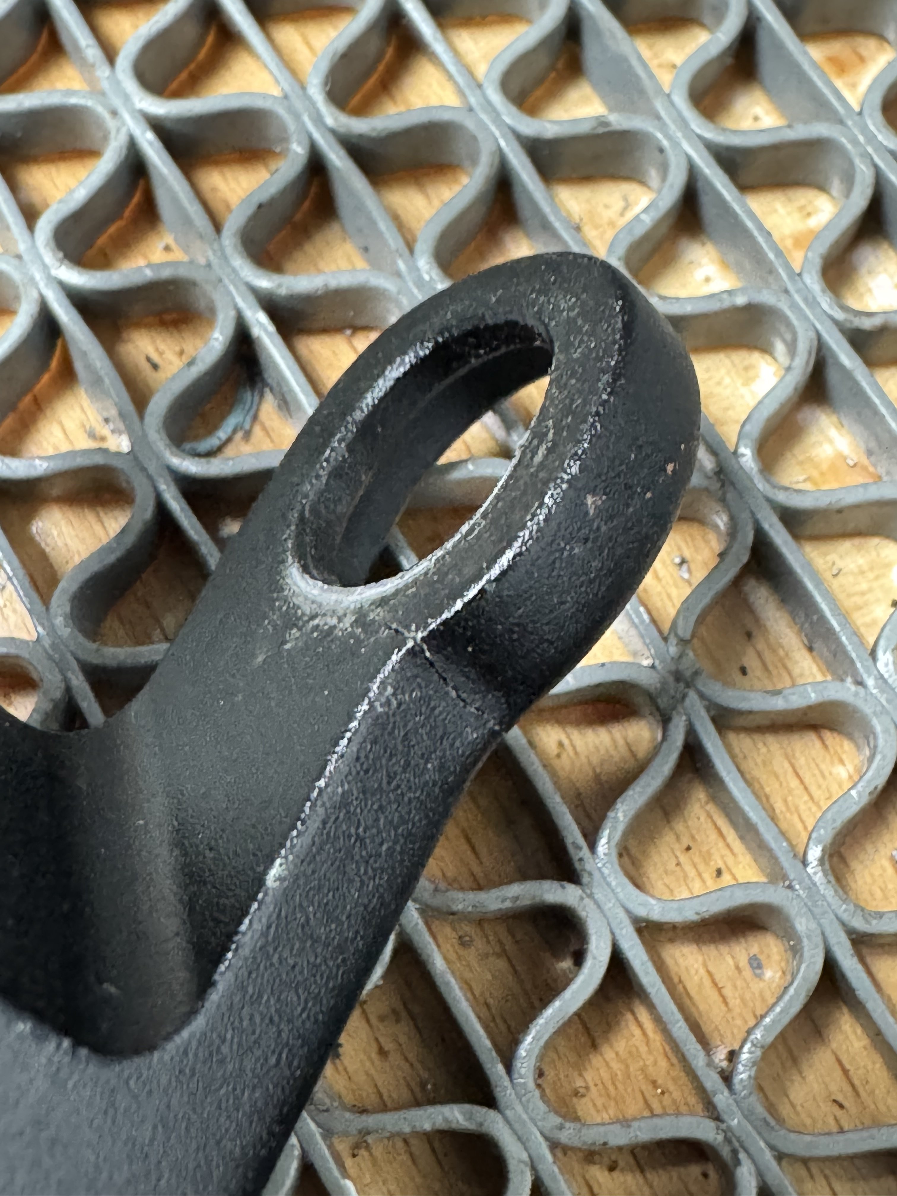

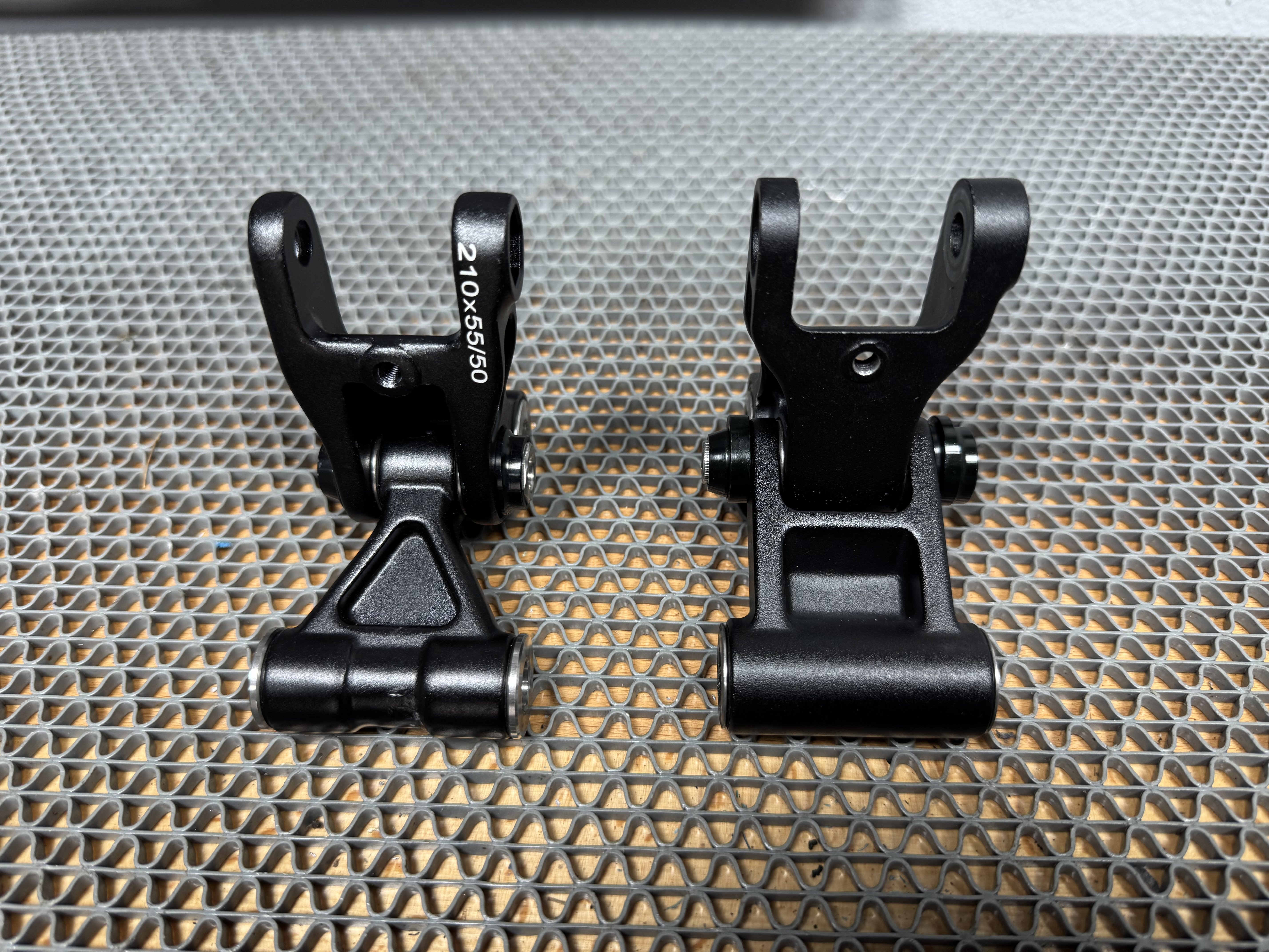

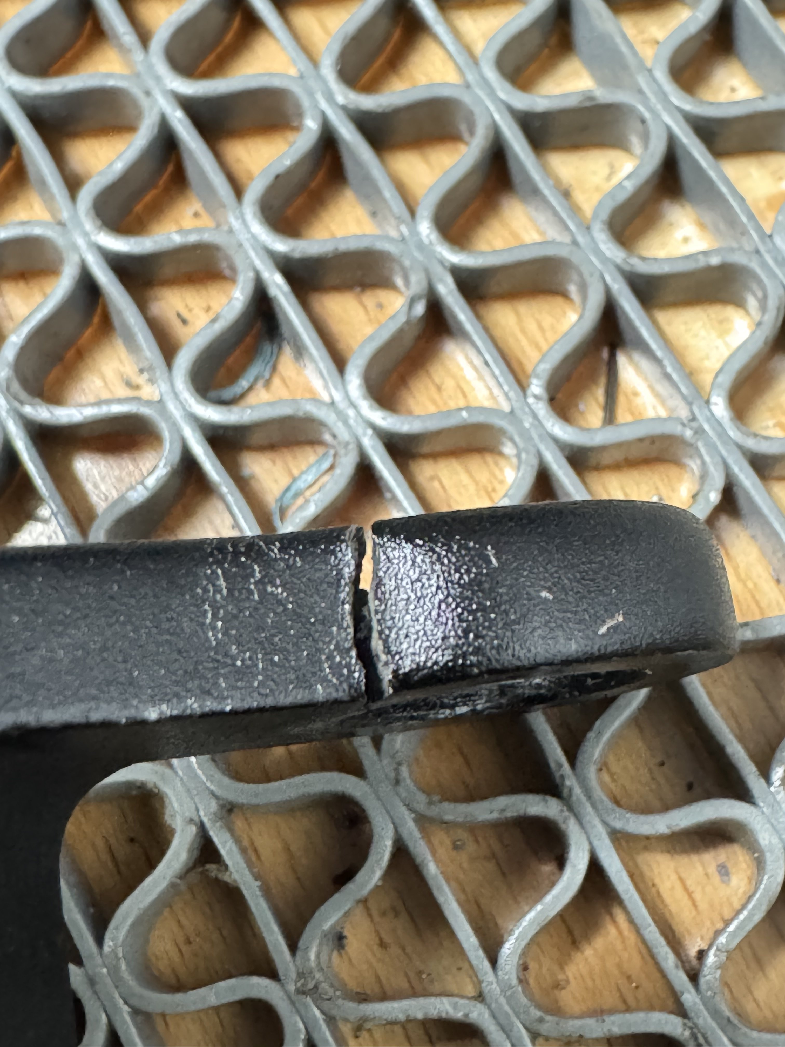

Hi all,

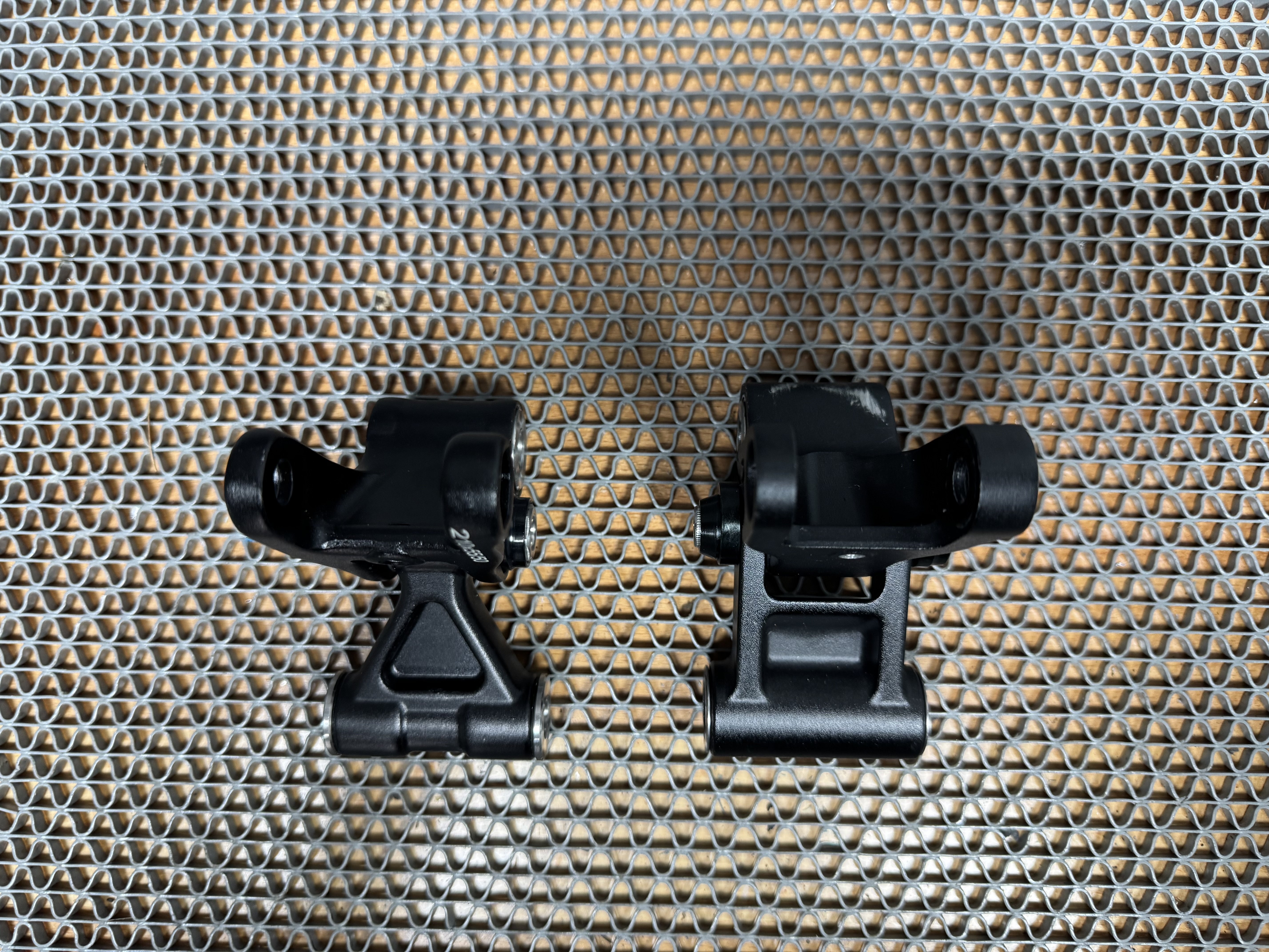

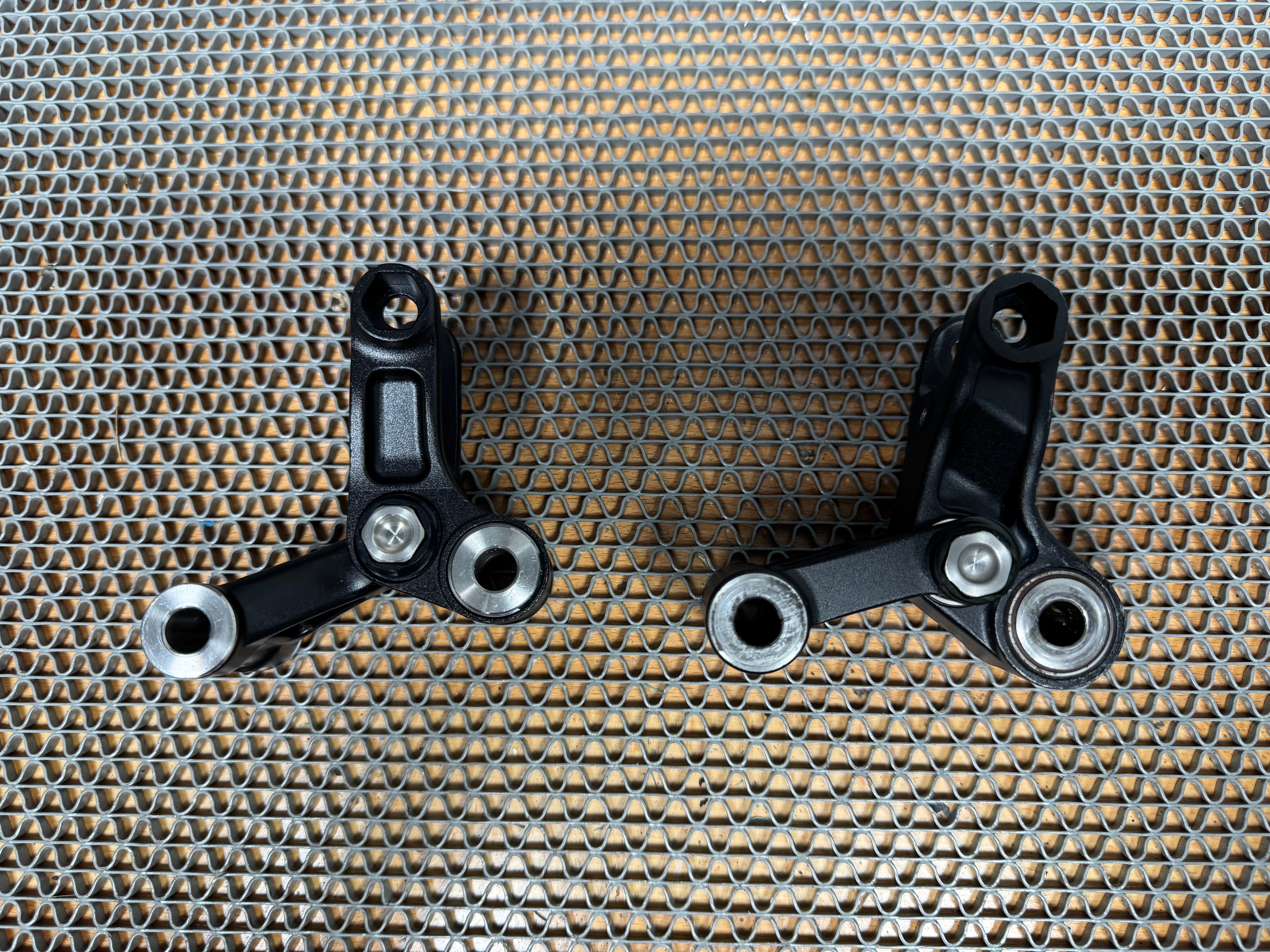

Some of you might have seen my posts moaning about the sloppy linkage on the SANN. Basically from day 2 my bike had lateral play in the linkage and I changed the bearings for higher quality ones and torqued to spec, nothing would get rid of the play. I’m not talking about a few microns of normal play, I’m talking that you can hear the linkage knocking if you de-weight the back wheel and pull it up.
The 2nd time I went to change the bearings, around 800km, I could insert one side of the bearing by hand. I reported this to Hybridizer who said I could “buy a new linkage”.
Not long after this my battery failed so I just made the decision to sell the frameset and move on. More about that in a full review of the SANN and Hybridizer experience coming soon.

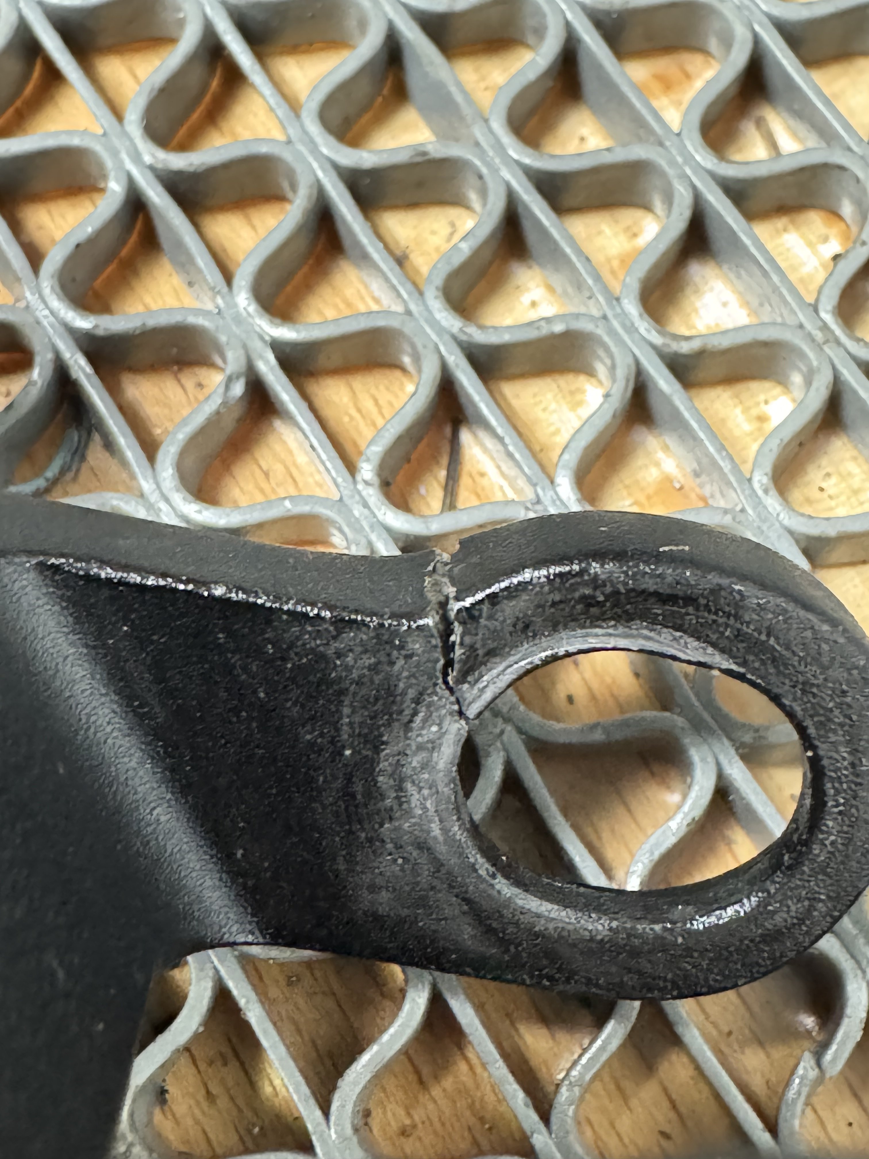

Getting the frame ready for sale I stripped it down and unsurprisingly I saw the linkage had actually failed. Daylight split on one side and crack on the other side of the pivot where the flip chip goes.
After speaking to a dealer here in Thailand (he had 2 other linkages failing) and another moan to Hybridizer I got a new updated linkage replaced. Check the photos for the differences. I think this is now version 3 of the linkage so check your bikes for play, and my advice is to contact Hybridizer to get one replaced while they are still in business, because I hate to say it but I’m not sure how they will survive after all the issues I’ve had and if they do go bust it’s going to be a nightmare getting that part machined.
Cheers
Tom
IMG_7391.jpeg IMG_7390.jpeg IMG_7389.jpeg IMG_7388.jpeg IMG_7387.jpeg IMG_7386.jpeg IMG_7385.jpeg
@Tjhell thanks for the insights. wow this very disappointing. Fingers crossed, this won't happen to my bike or at least they provide replacement by then..! 😮
Can you list the bearing sizes that need to be bought and where they go? I consider replacing them as well, even though I havn't had any issues with play.
Sure thing. 3 parts of the linkage have bushings and the bearing part is 6901RS (x2)
I’d suggest checking and changing the pivot bearings too. I suspect mine were installed badly from the factory as they were notchy and failed at 130km and damaged the frame. Fortunately the damage isn’t visible. I put better bearings in and correctly, and they have lasted well. You need 6002RS (x2) for the SANN Pivot.

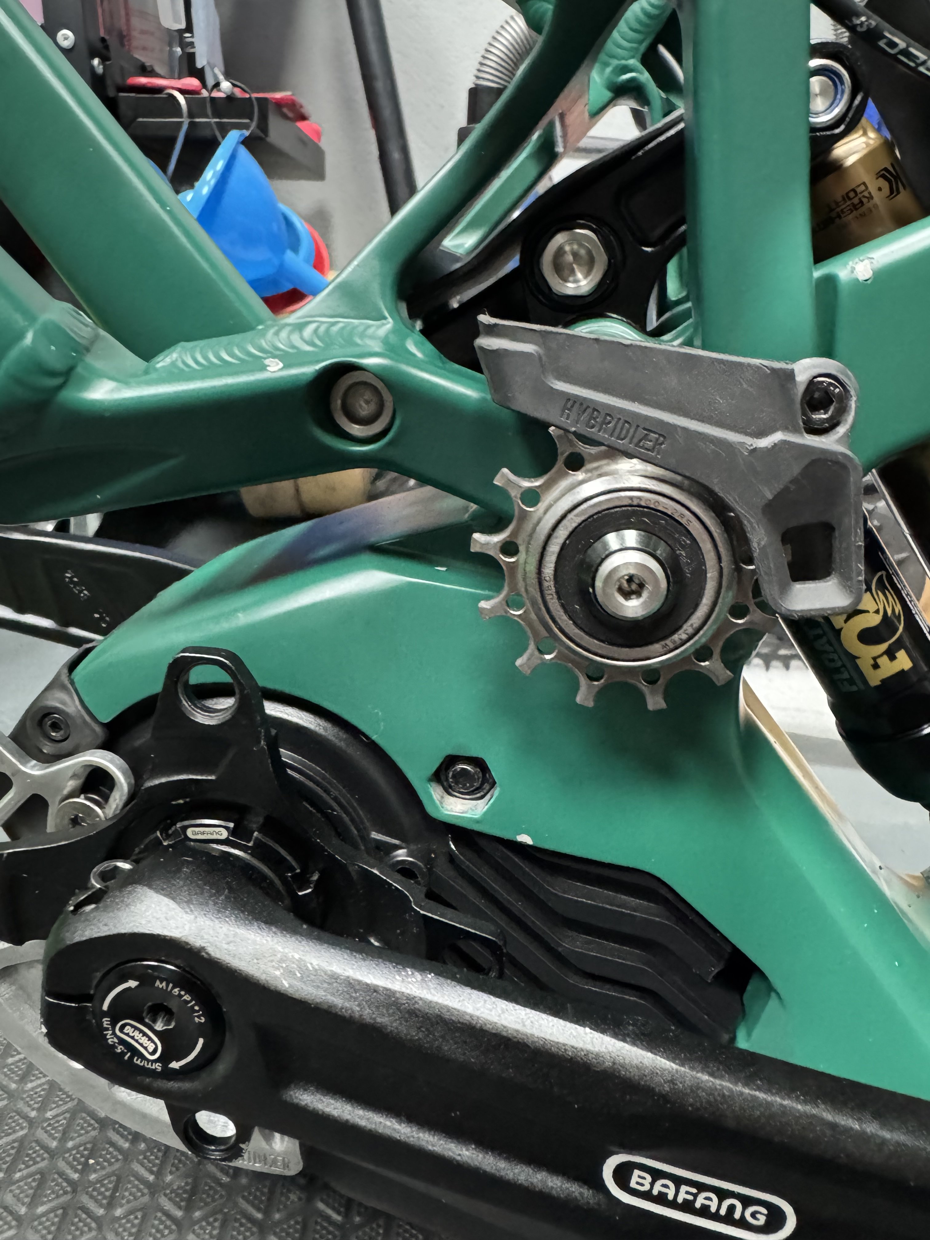

Also check 3200-2RS - SANN High Pivot jockey bearing. I noticed my drive train felt rough and was concerned it was the motor, but it turned out it’s the high pivot pulley/jockey bearing. The bearing wore out around 1200km, from about 700km I was taking the seal off and cleaning and regreasing it. It got rough pretty quickly though. The jockey teeth have worn badly on my bike as of 1700km, I’d suggest buying a spare one.
