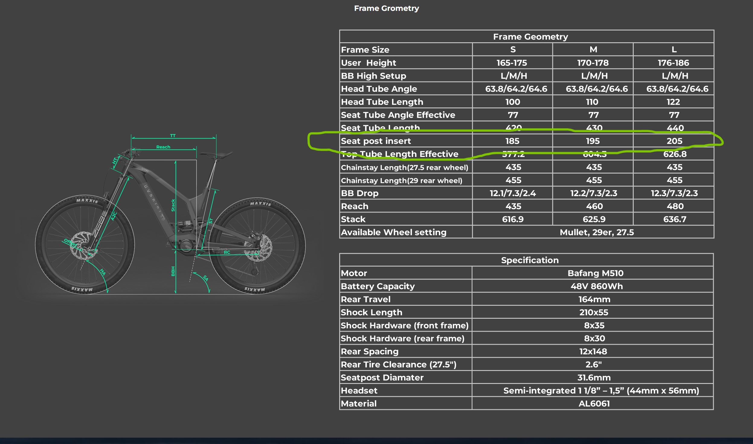

Just bear in mind the seatpost insert length includes the mechanism on a wired dropper. I tested the insert on my size L with a solid post and I got a realistic 195mm from the claimed 205.
Unfortunately the seatpost insert length is one of the negative aspects of the bike for me, along with how the wire routes under the shock.

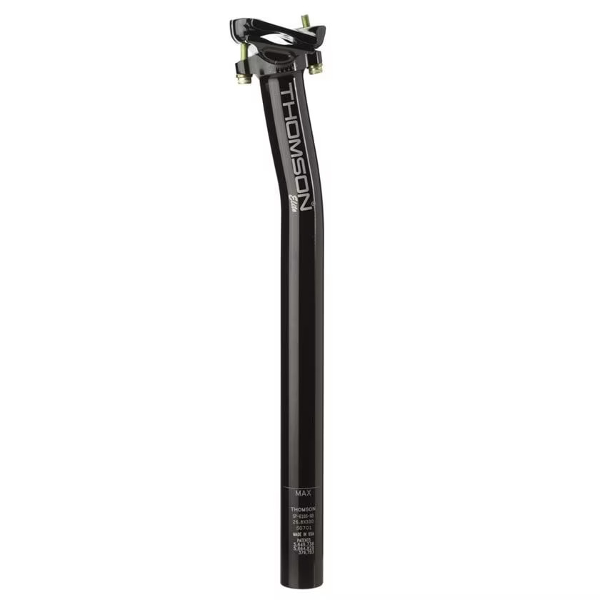

Yes, I read about it.
I'm going to use a regular seatpost, but I'm going to use a curved Thompson model.
Dear God. Why?
Because for me, the simpler the better. In my canyon I have a Rockshox reverb and I rarely use a different position for climbs or descents. So why add components that will cost me more maintenance and more money? This works for me.
Reverb is garbage. I can (almost) understand the keep it simple methodology, but a setback seatpost? Is it 2005?
Unfortunately the seatpost insert length is one of the negative aspects of the bike for me.
It's not great at all. 120mm dropper sticks out almost 40mm on my wifes bike. Also the tariffs makes buying a second frame for me an absolute no go. I've needed a couple small parts that were either damaged in shipping (derailleur hanger), defective (charging port cover) or flat out missing upon arrival (preload cap for non-drive side crank). All of which were met with promise of additional shipping and parts charges when brought to the attention of hybridizer via email. I'll consider myself grateful that this frame has worked out for my wife and stay very, very clear of fly by night chinese manufacturers moving forward. Best luck
I guess you can experiment with what works for you and how the post being curved affects the geometry. The SANN is already quite slack feeling but it’s your ride so get it set up how you want it. I personally couldn’t imagine being without a dropper though, I must trigger mine at least 50 times over a 2 hour ride and you often need to get the post up or down to keep traction with such a powerful motor. I ride steep technical trails as much as possible, so it really depends what kind of terrain you will be hitting.

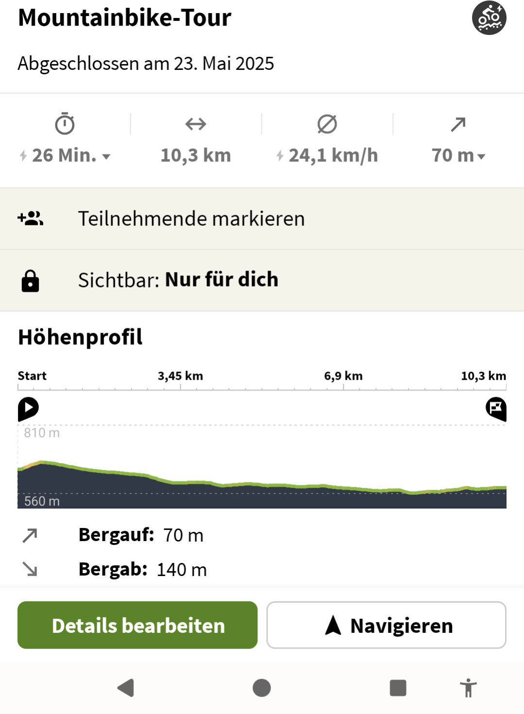

Hallo. Ich nochmal 😀 habe jetzt eine schnelle Runde aufgezeichnet
Bin durchgehend auf Stufe Standard gefahren und habe 22 % Akku verbraucht. Die Stecke geht überwiegend bergab und gerade. Alles Teer. Fahre auf Schwalbe Supermoto.
22% Akkuverbrauch ist zu viel oder was meint ihr?
