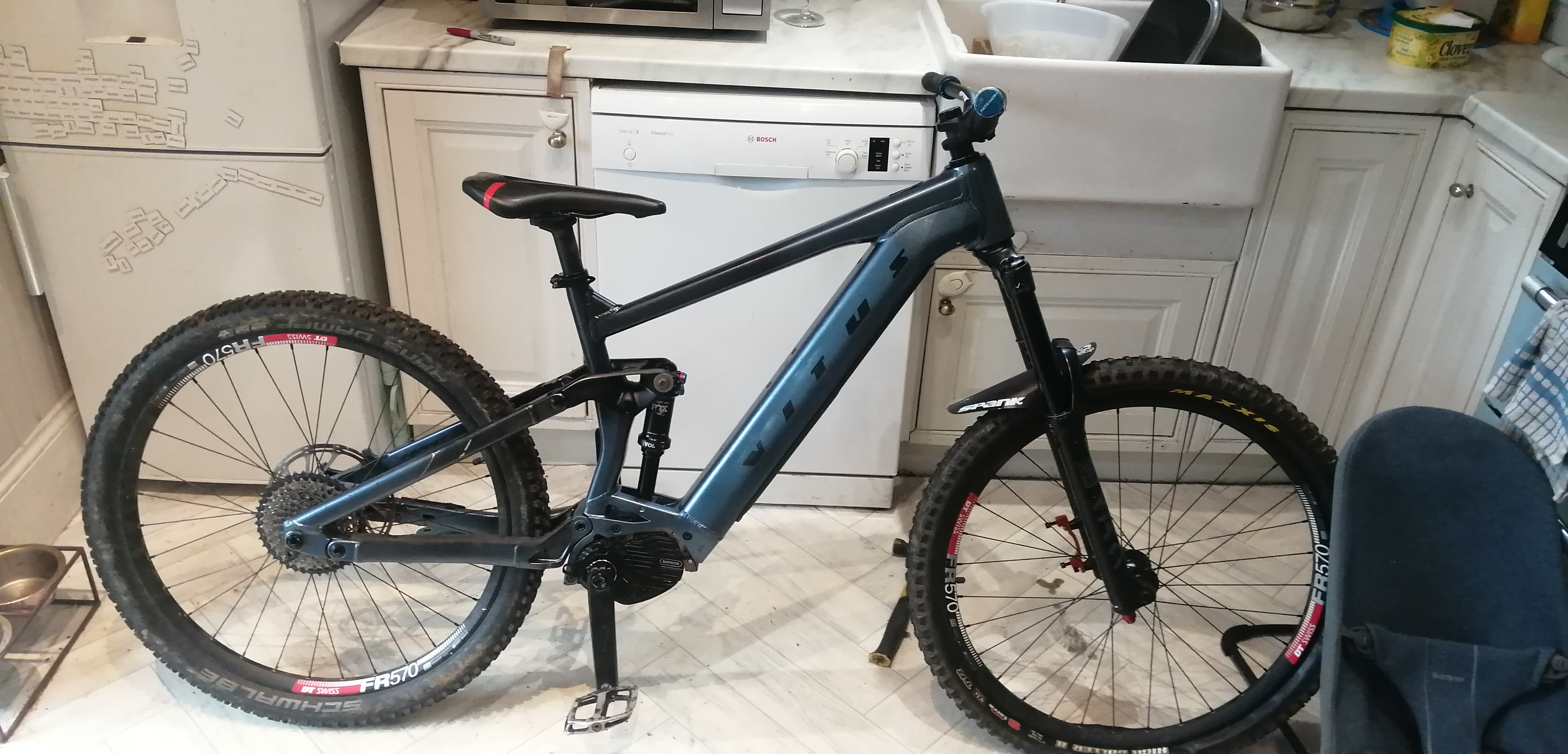

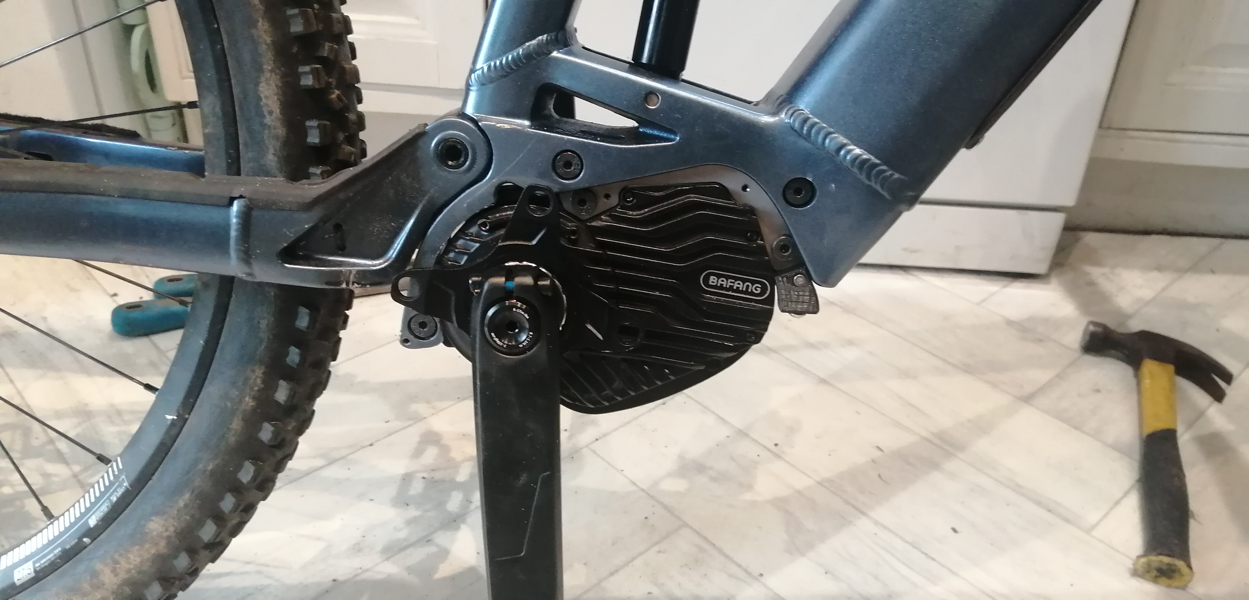

As an owner of 2020 Norco VLT’s both shimano steps e 8000…. I’ve enquired about upgrading with the ep8 s…. or latest and the informations returned to say….

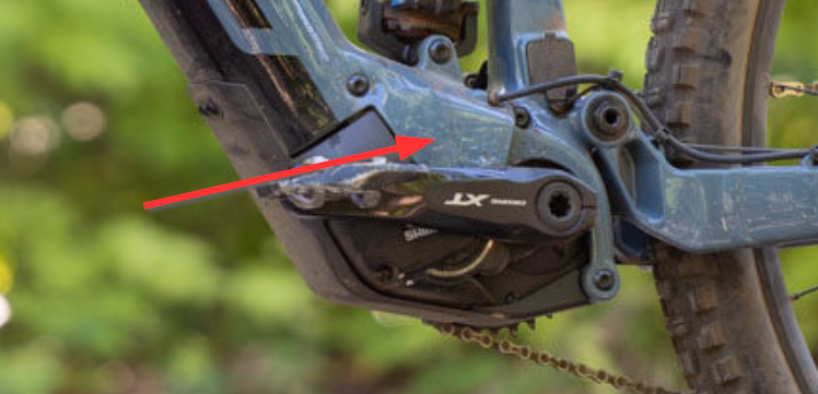

Unfortunately it's not compatible rightaway. You'd need to use an angle grinder to remove or modify this part:
And one more time: You need to replace the Shimano BMS in their battery to use with Bafang. They aren't compatible (yet 🤫).

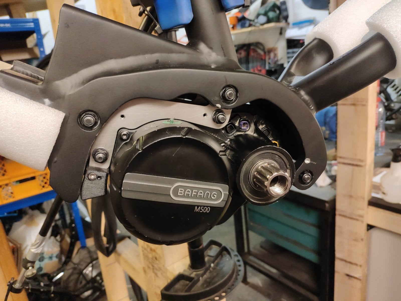

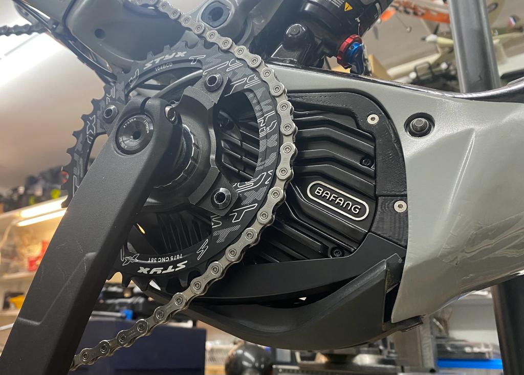

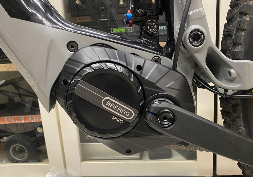

Shimano E6100/E7000/E8000/EP8 [Frame] to Bafang M500/M510/M600 [Motor]
Just a teaser. Fully explaining all details when ready for shipping 😊

Hi Tomblarom, just thought to see wether conversion mounts have taken up with interest for the models 2020 Norco Vlt Range and Sight- Bangfang upgrades.....
l am happy to angle grind whats required for the fit....
Thank you....

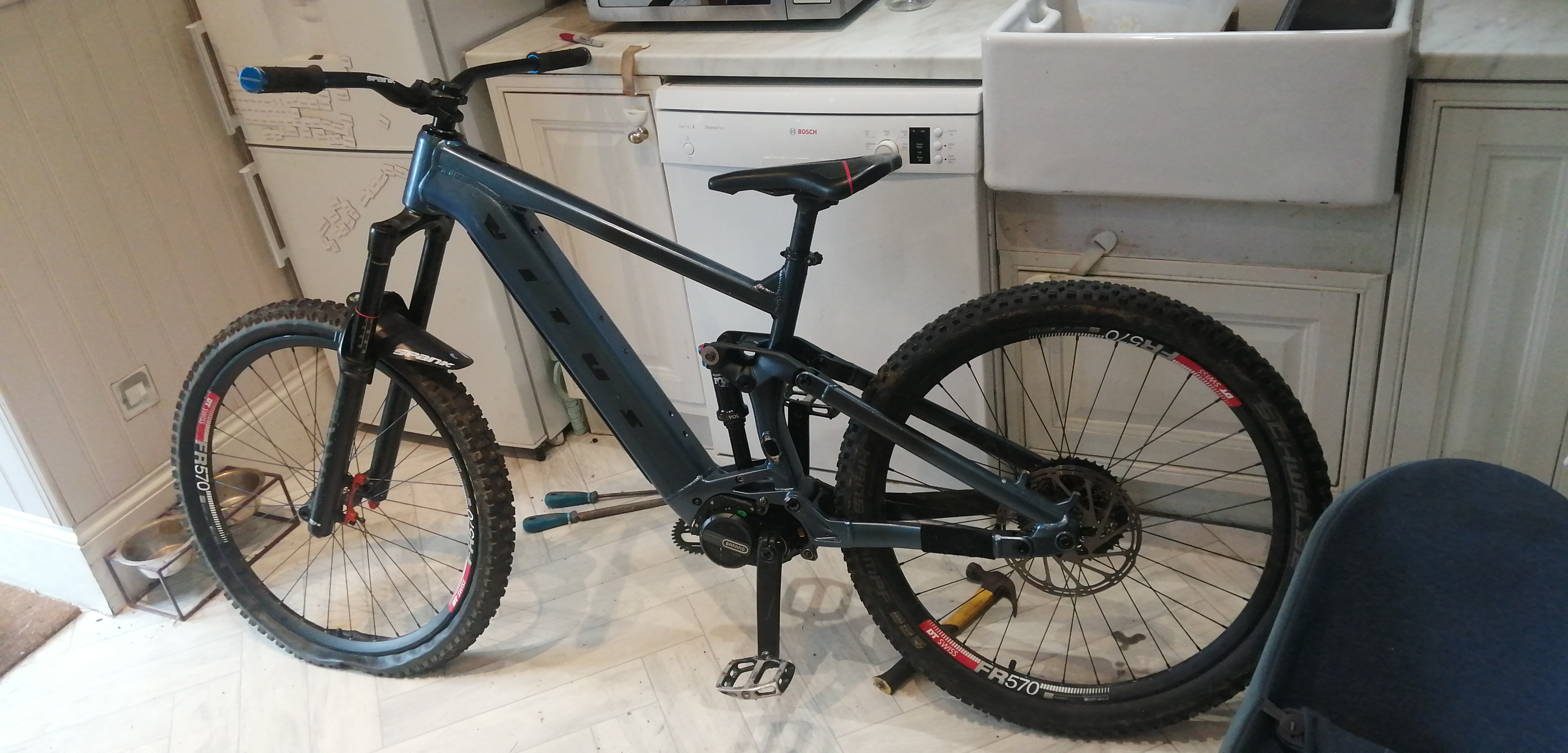

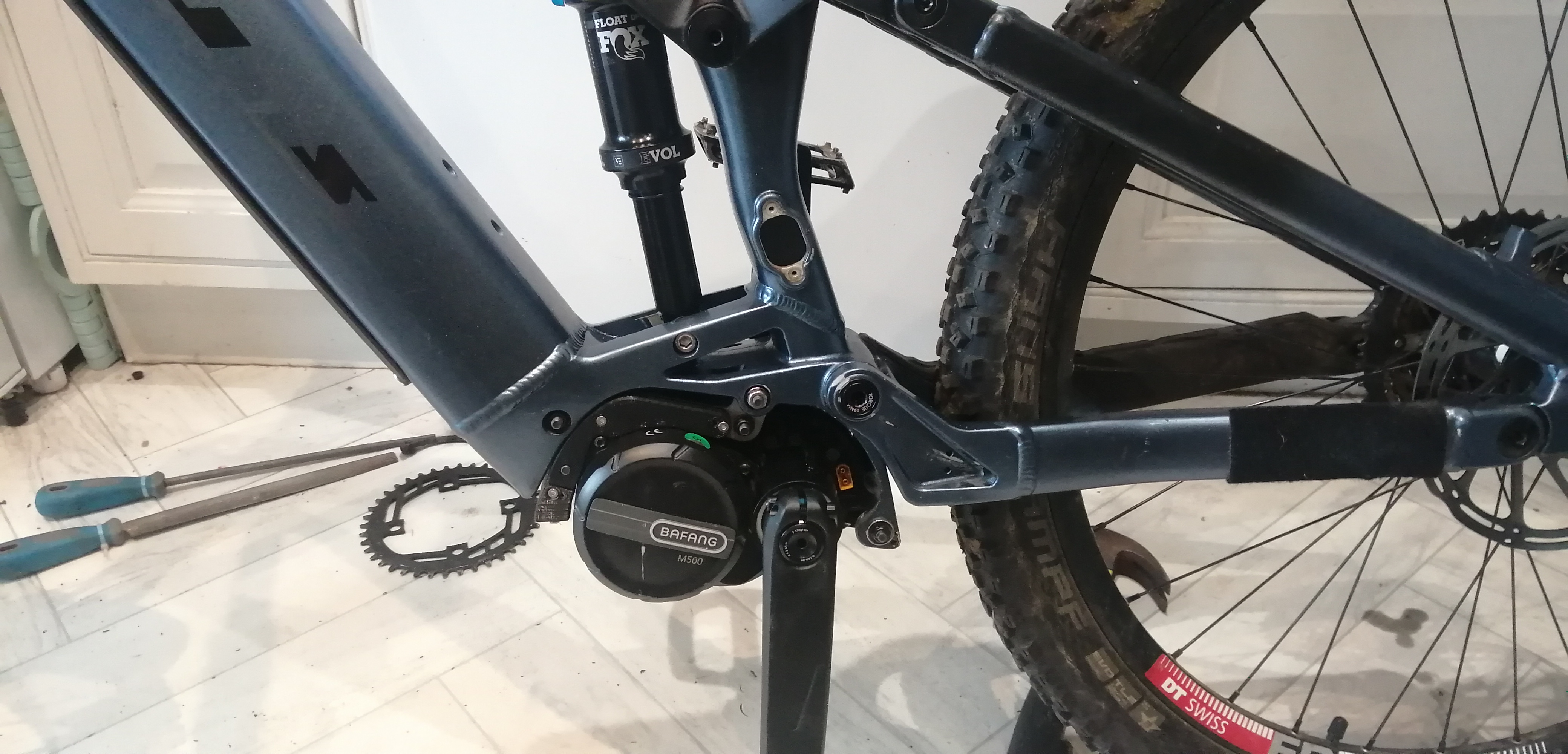

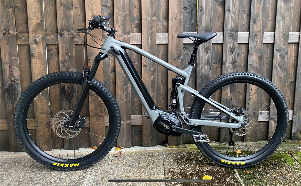

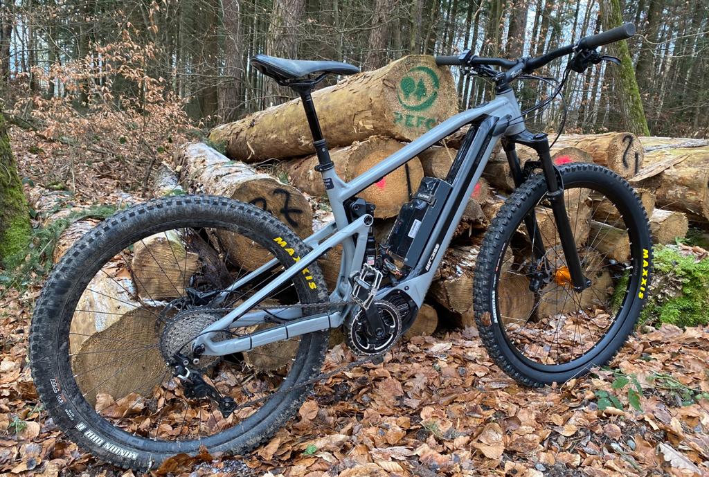

Is that a Focus Jam2? If so, what year? Looks like my 2018 model alloy bike. How did he deal with the battery being that it has 2 x bolts that go through the frame and battery?
I can't tell for sure, because the frame is from a friend. He did all of this. If you decide to buy my kit, I can establish a contact, so you can ask him directly :)
The frame looks compatible! You just need to build your own battery, that replaces the stock Shimano one.. Can't help you with that. I can only supply the conversion. However, I know that some German folks did approach a very similar task: Steps-Akku Eigenbau, Zellen, Gehäuse, BMS

The amount that needs to be cut away is very minimal! I showed it in #40.

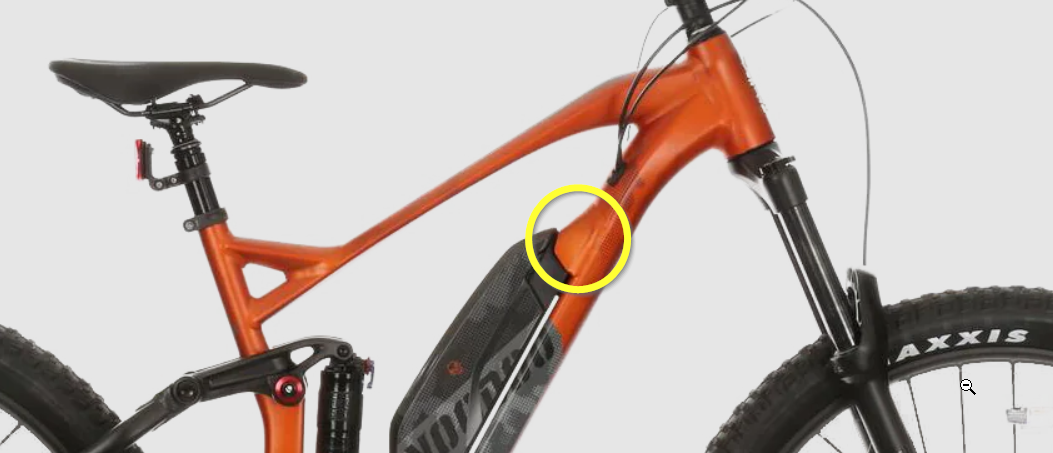

Would I be able to buy an adapter I have a voodoo zobop e (orange one) and it has the e7000 drive unit
My kit would work fine, but the frame has a spot that might collide with the new battery. Bafang batteries like the Reention DP-6 or DP-9 are longer.. In your case it looks like the marked part of the frame does not give structual support, so you could simply cut it away with an angle grinder.

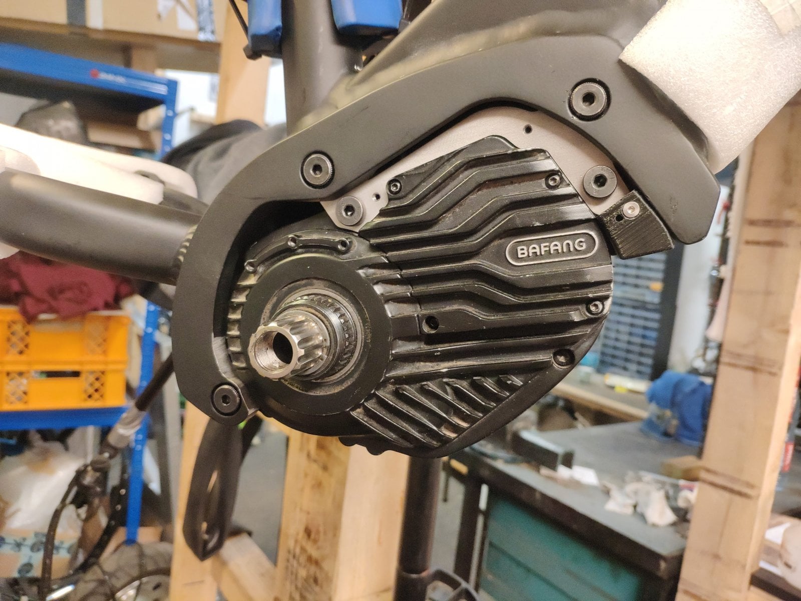

Hello good people. I read the whole thread in hope to find solution. Is there a way to get hold of mount which allows me to fit my bbs02 in EP8 frame? Found a guy named Patdam who solved it, cant pm him cos im new here.
At the moment I do not offer such a solution, but it's on my road map. What @patdam did, looks like a one-time job and I'm almost certain, that he has no plans for his plates. You'd need to make them yourself.
True, only one shot build for my whife (she still using). and y don't make bisness. i drawed plans, but longtime ago and not archived. But not complicated, if you have alloy weelding station and metal lathe ☺️
Hello. I dont but have friend with access to welding machine and lathe. Could you please PM me? I suppose its not just the metal side plates that hold the motor in place. I could really use as much information and tips as possible. Thank you.
