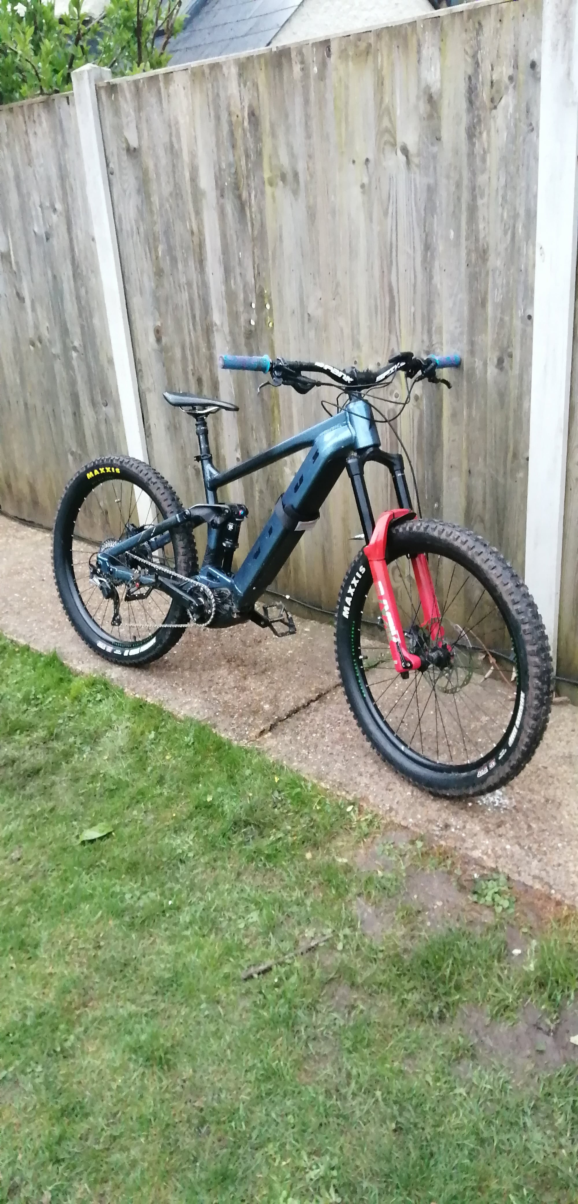

Build update.... Im set this build up for free riding, so far I can jump this with ease and the mounts have held well,. No play as yet and all feeling good, about 3 weeks of riding done on it so far all free ride sessions and very happy with bikes performance
I've got the same bike, so great to see this! What have you done with the batteries to power it all?

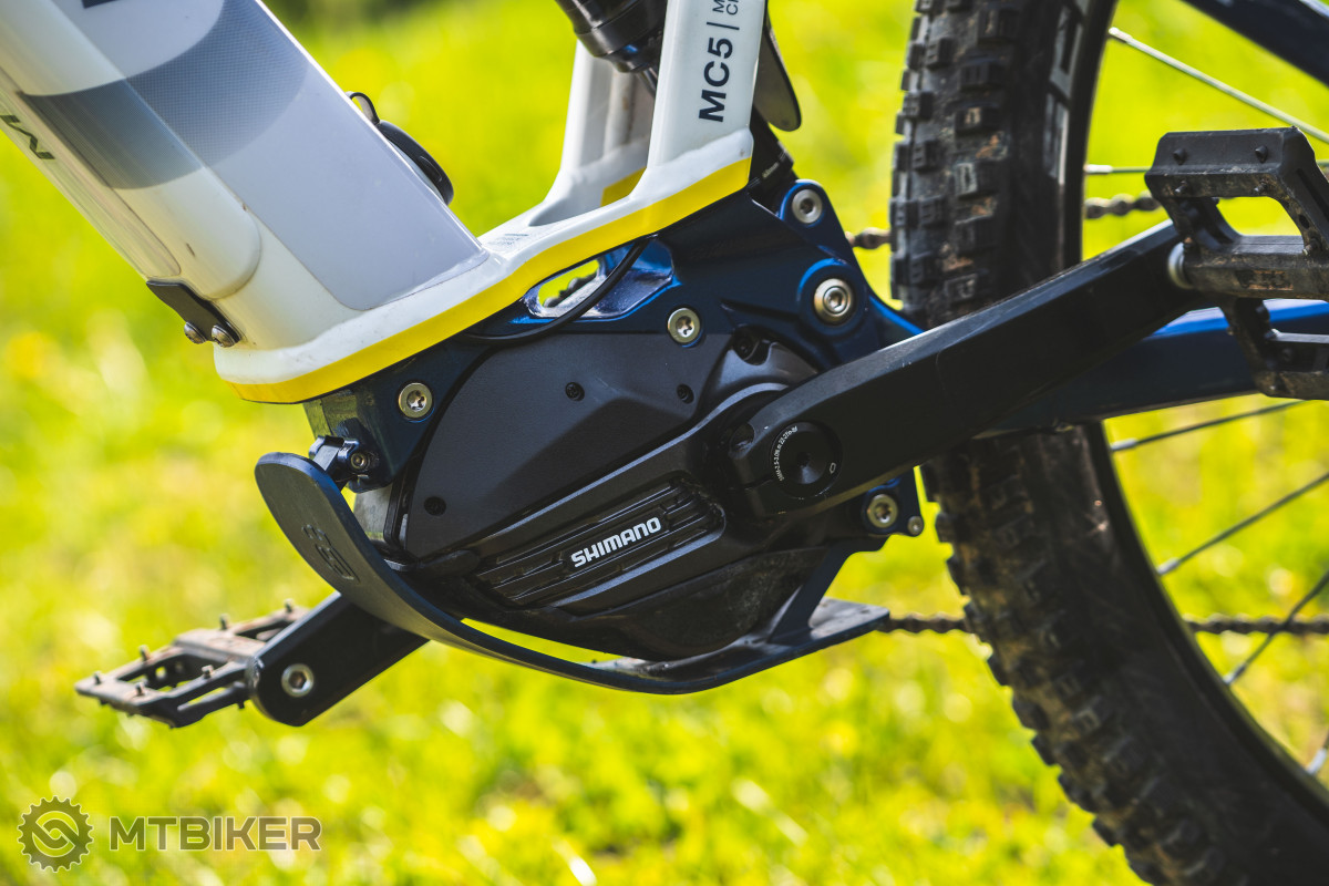

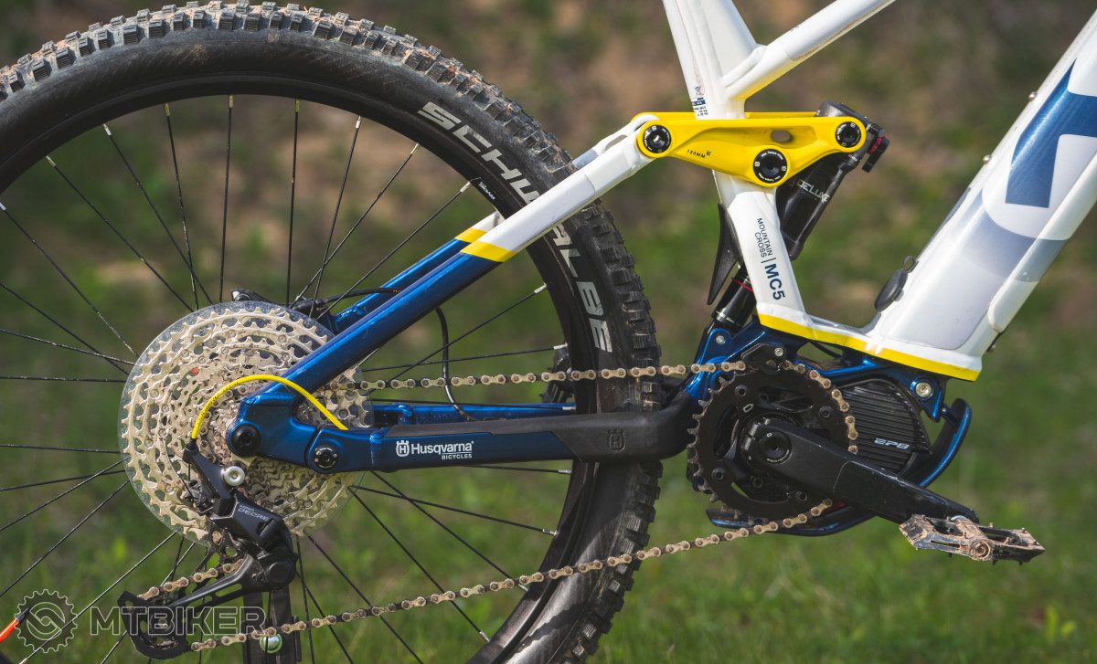

It seems like it should be possible to use your adapter on Husqvarna MC5 2021, it doesn't have a lot of stuff around the motor

EDIT: Adding pictures from the internet for illustrative purposes
@Tomblarom does your adapter fit Husqvarna MC5 2021? Do you still produce them? Also, is there a possibility to make a battery in the same enclosure I have already? Or replacing just the BMS?
Hey, yes I still make them and they are available over this webshop. Your frame is perfectly suitable, regarding mounting the motor. For the intube battery, it might be difficult to solve, but you can try to replace the BMS with a generic one, like this JBD mini BMS. You also might able to find some efforts for fully replacing the battery online: https://www.pedelecforum.de/forum/index.php?threads/steps-akku-eigenbau-zellen-gehaeuse-bms.82527/

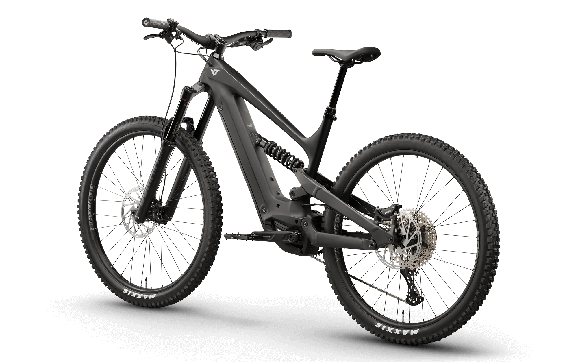

Is this possible to use for YT Decoy 2024 with EP6 motor?
Looks like no, non-drive side looks like it needs to be modified.
Not sure about the exact mounting interface of this exact motor, but if it's identical to E6100/E8000/EP8, then yes. But as you already guessed, I highly assume, that it will interfere with the contour. The motors on most modern bikes are too deeply integrated into the frame. Especially on a carbon bike, this is almost impossible to make it work.
