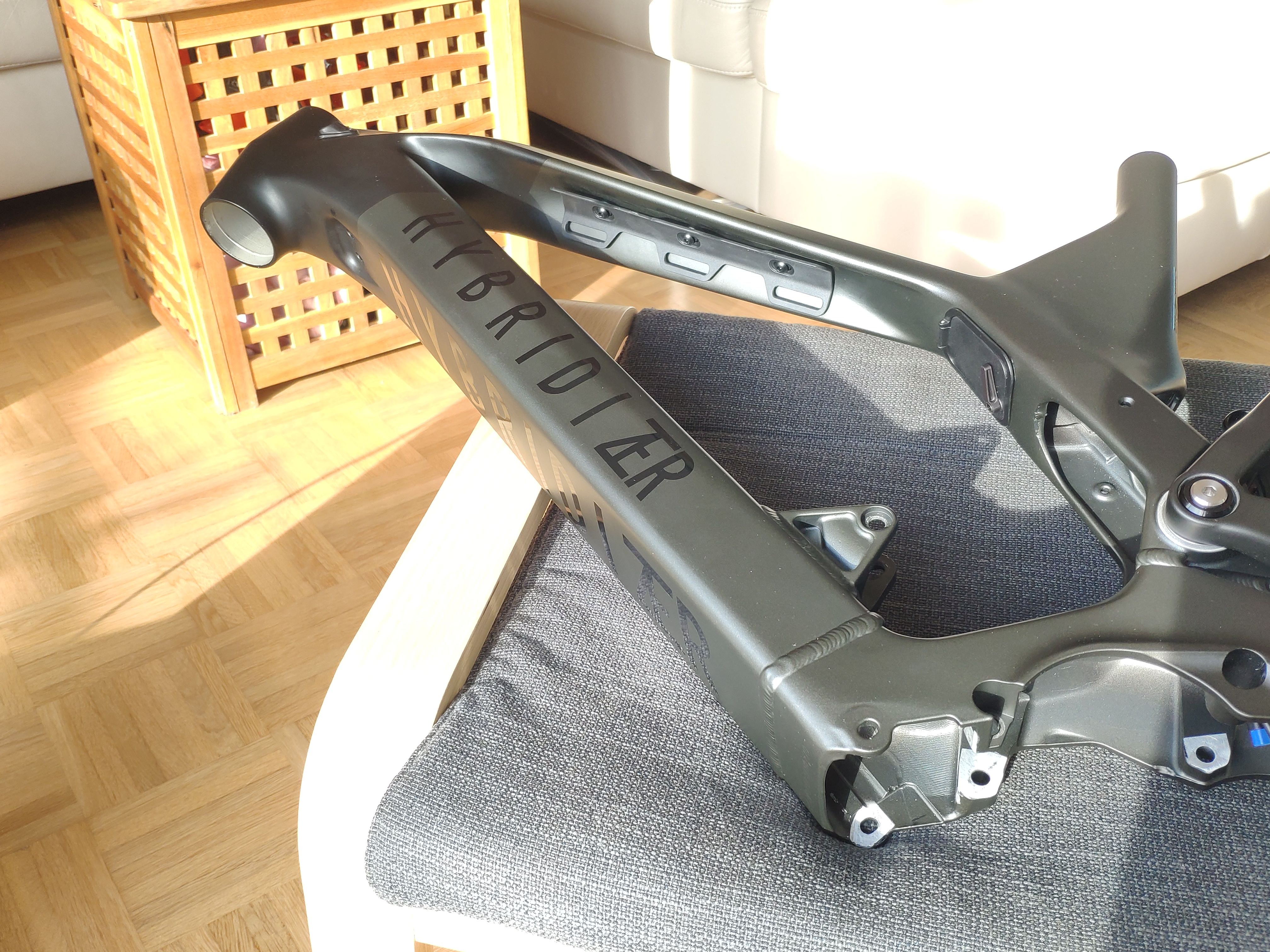

Hybridizer Sann Bafang M500 series Aluminum FS
@D'Apostrophe spotted the new Hybridizer frame!! Source: Bafang Facebook Page
An employee of Hybridizer is also there. 😁

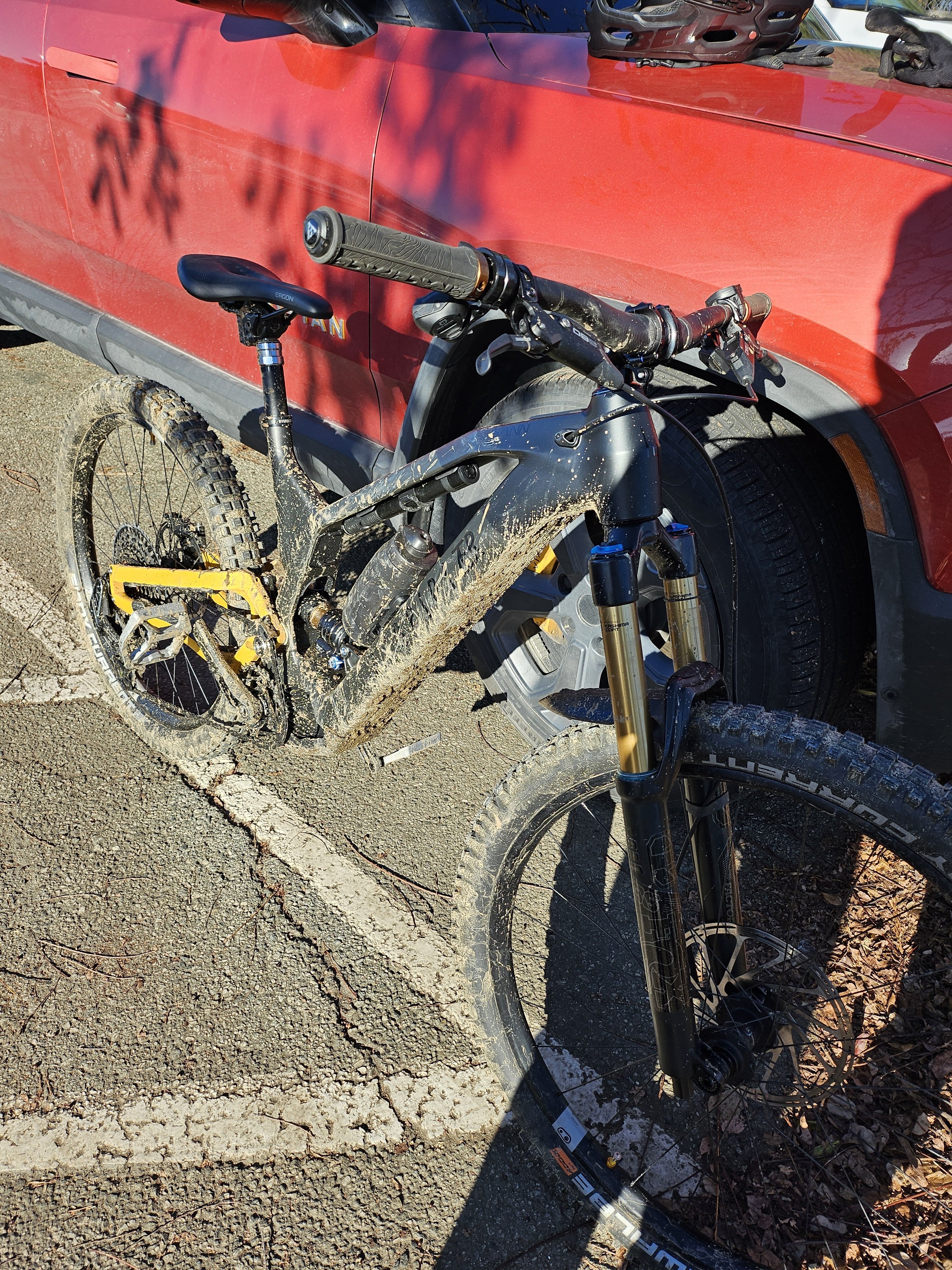

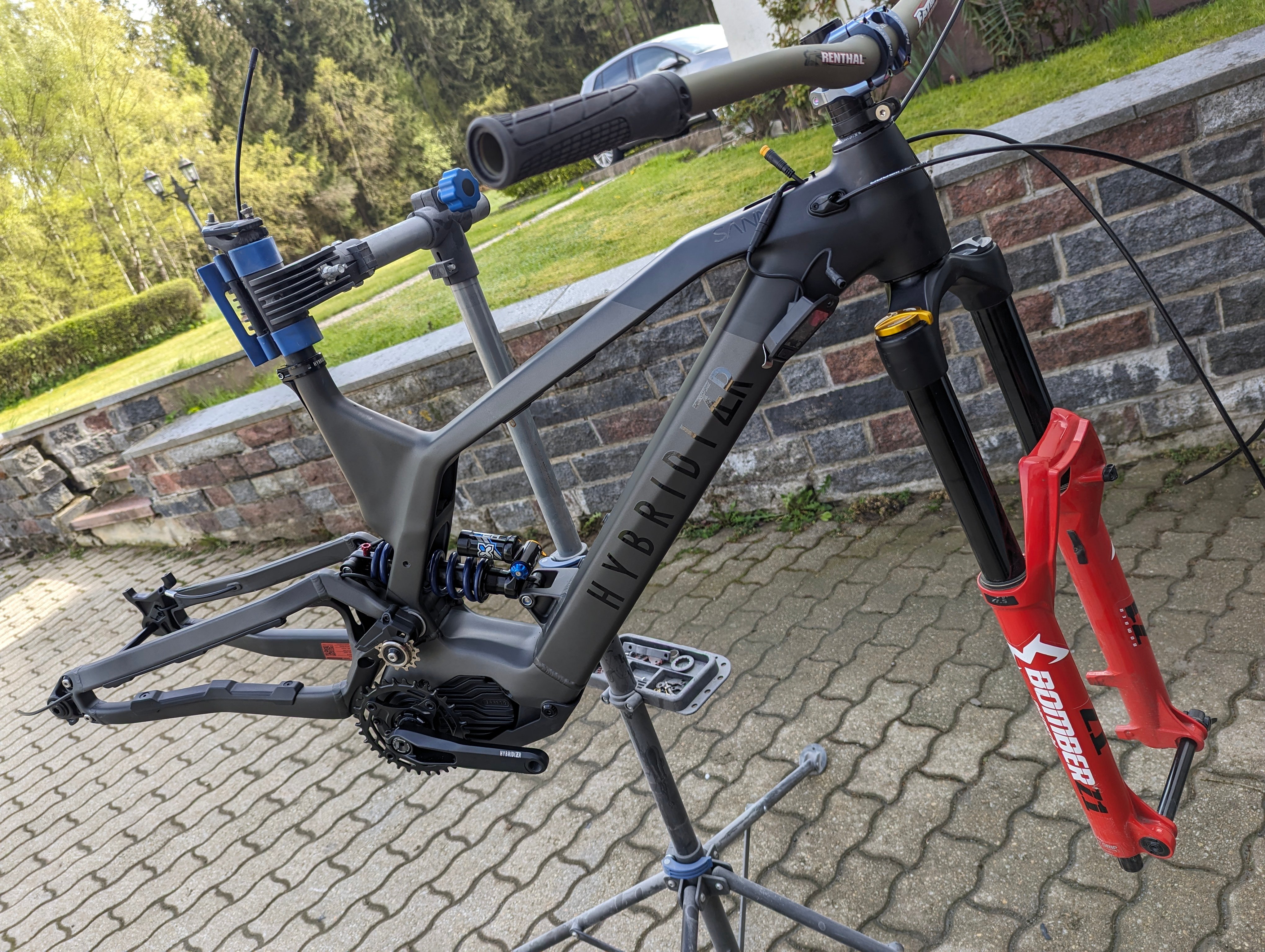

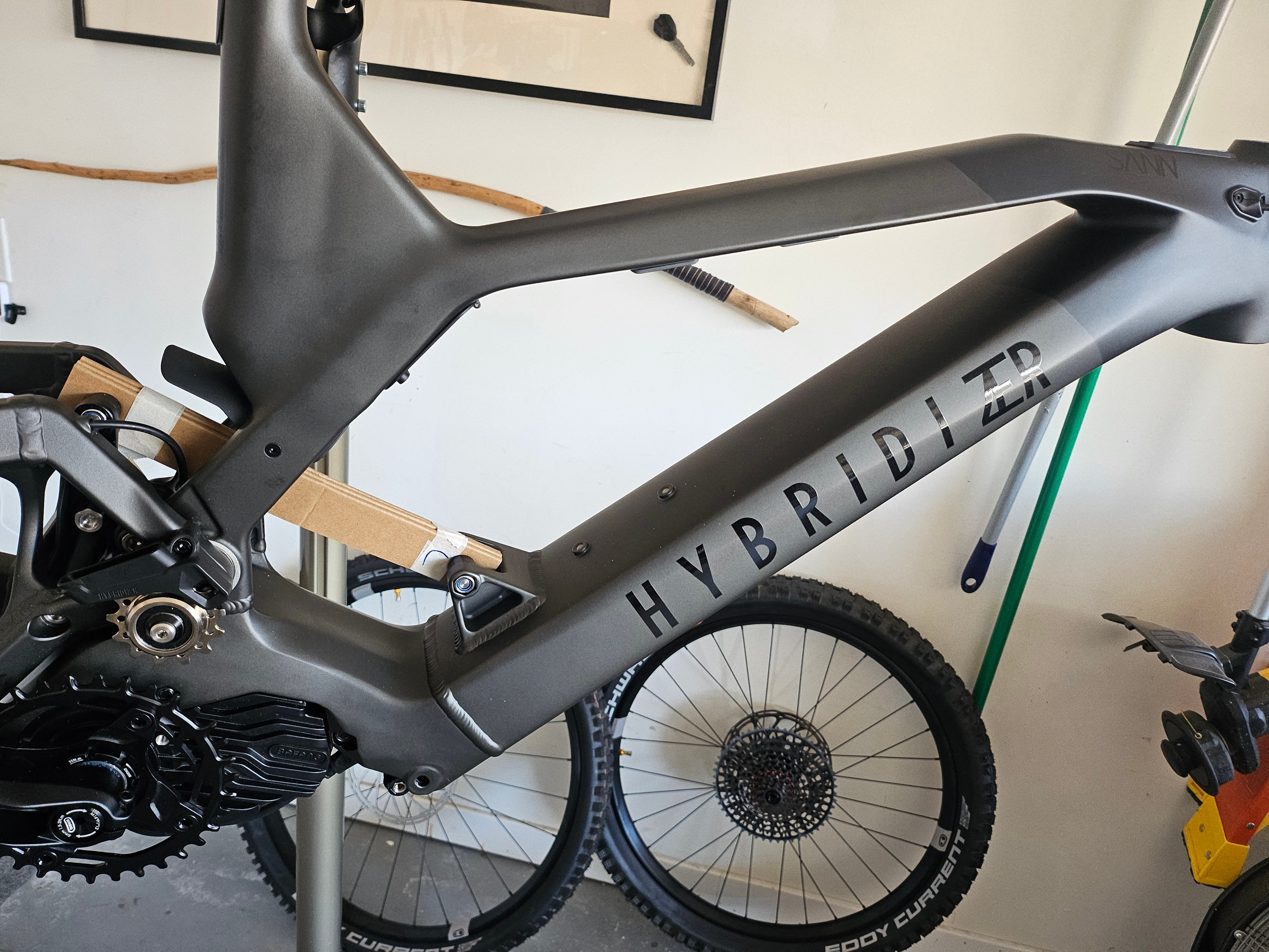

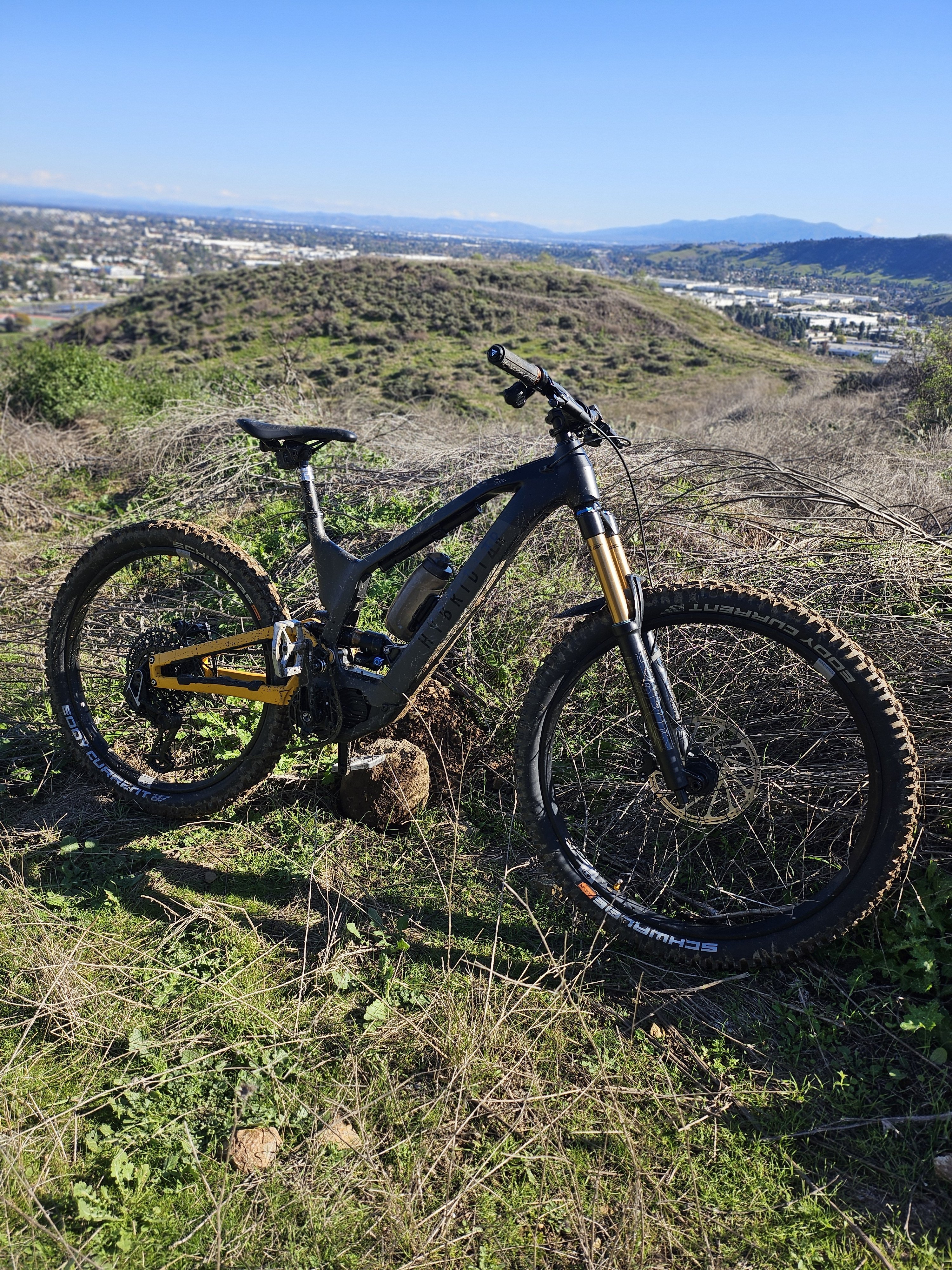

What is your current build and weight? I'm curious how light they could get an aluminum frame.
I threw caution to the wind when it came to weight. I'm 220lbs (99kg), so a light weight bike doesn't really matter.
The build is 58lbs (26kg)
27/29 crankbrothers synthesis Alloy wheels
Schwalbe eddy current tires 2.6 and 2.8
220/203 rotors
Sram db8 brakes
Fox 36 fork, Fox dpx2 shock
Sram XO axs t-type
Rockshox reverb dropper
Ergon smc large saddle
Crankbrothers stamp 3 pedals, large
Raceface turbine stem and aeffect bars
Cane creek headset
Fidlock bottle

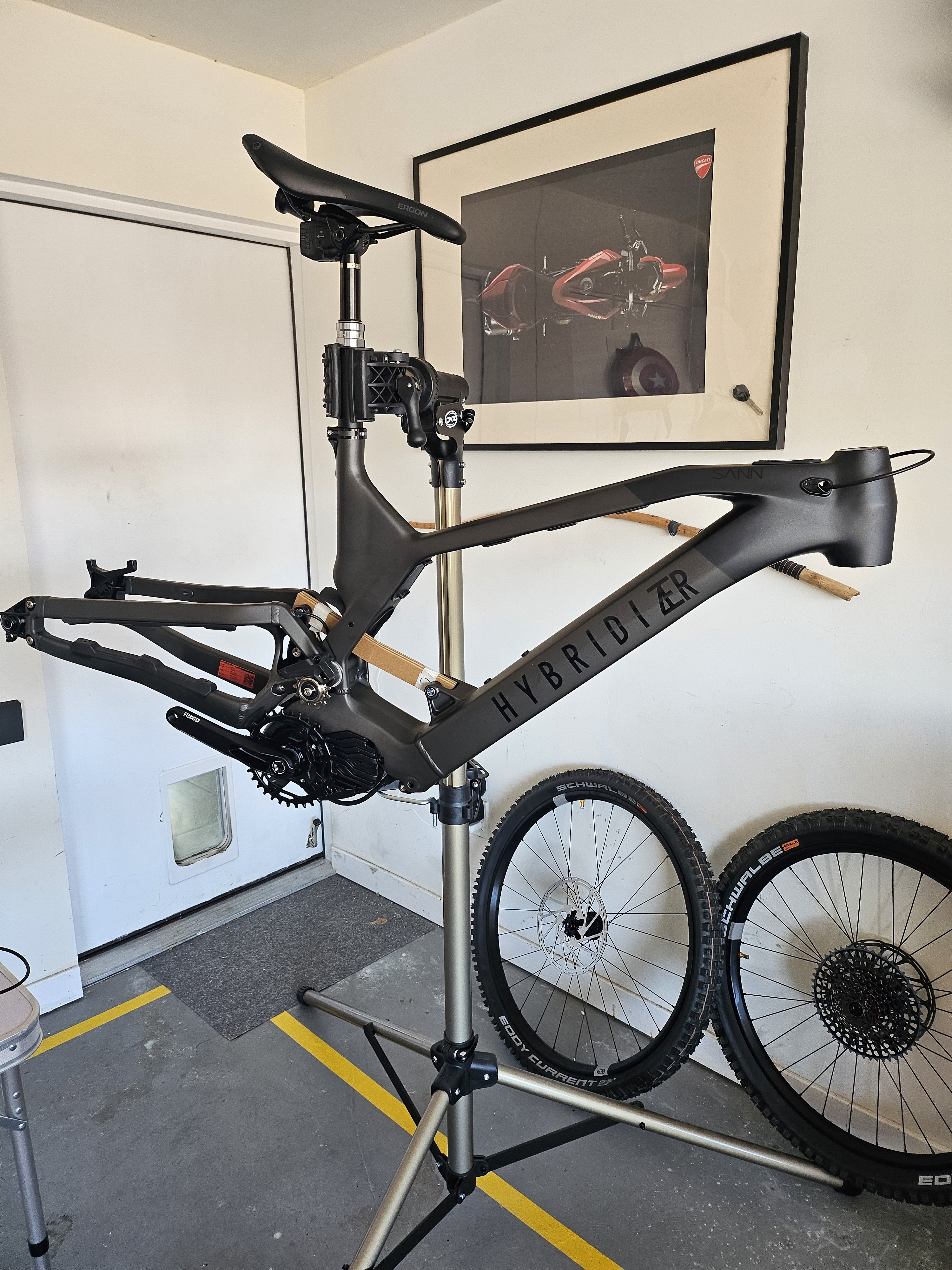

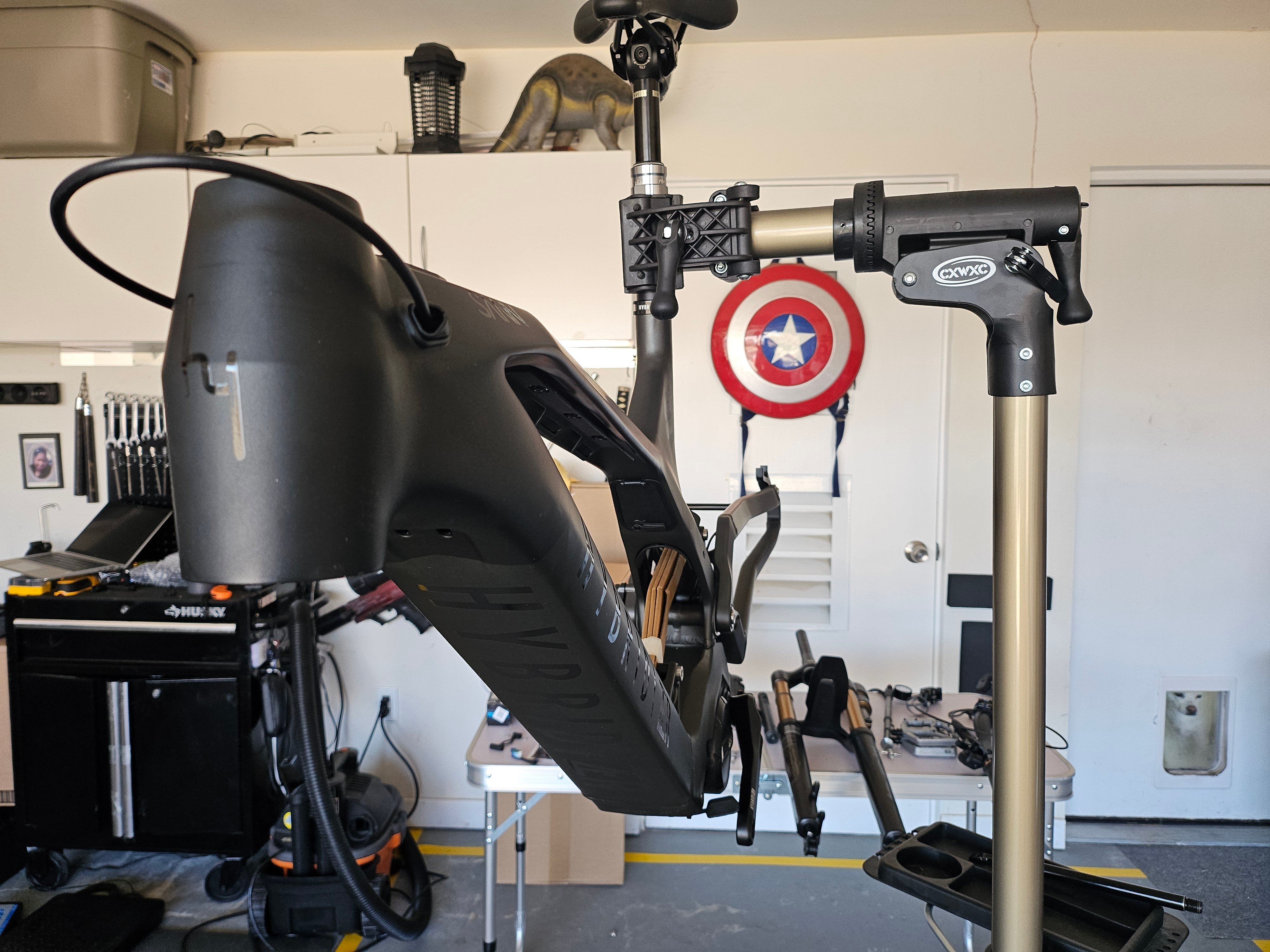

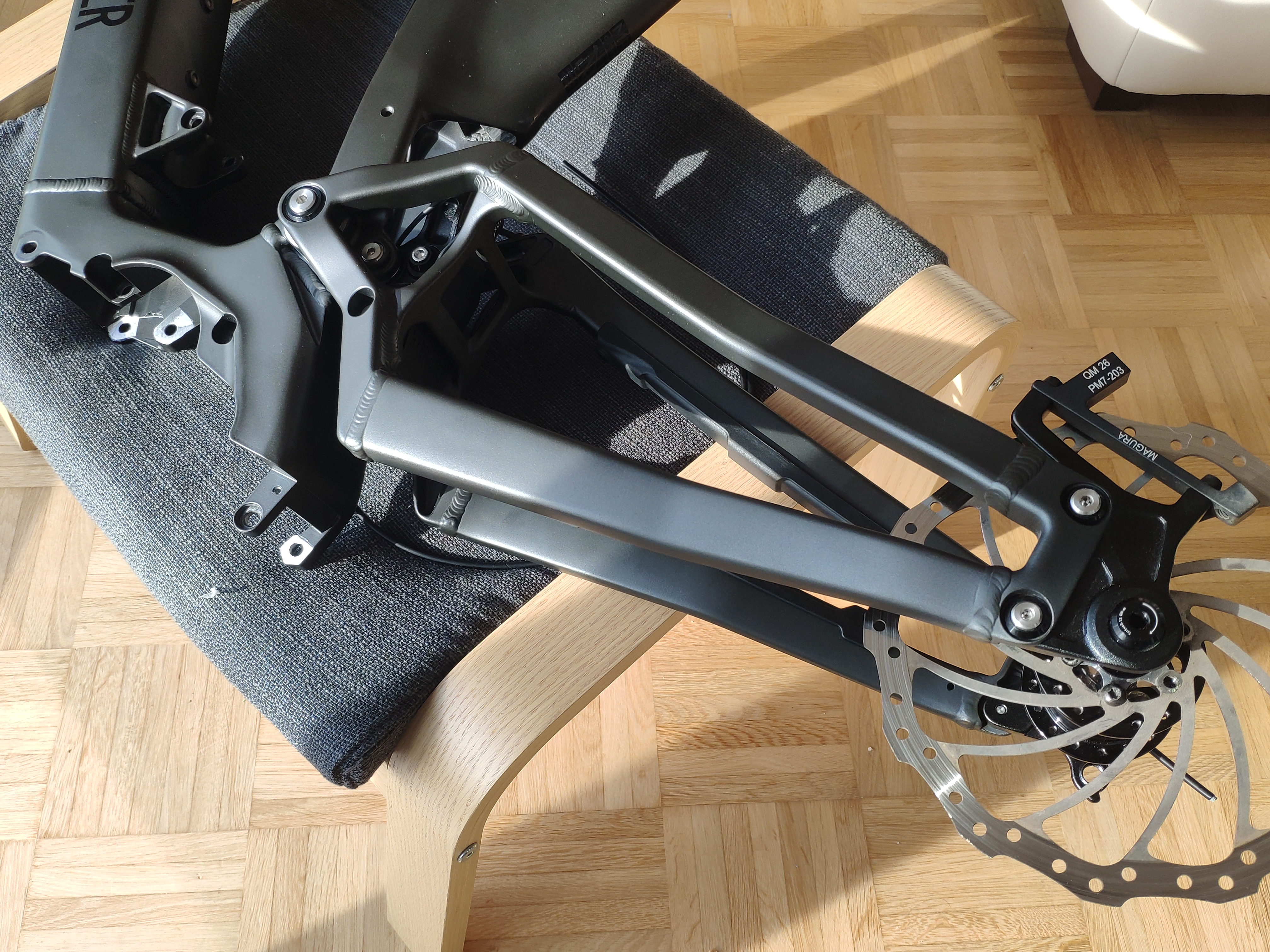

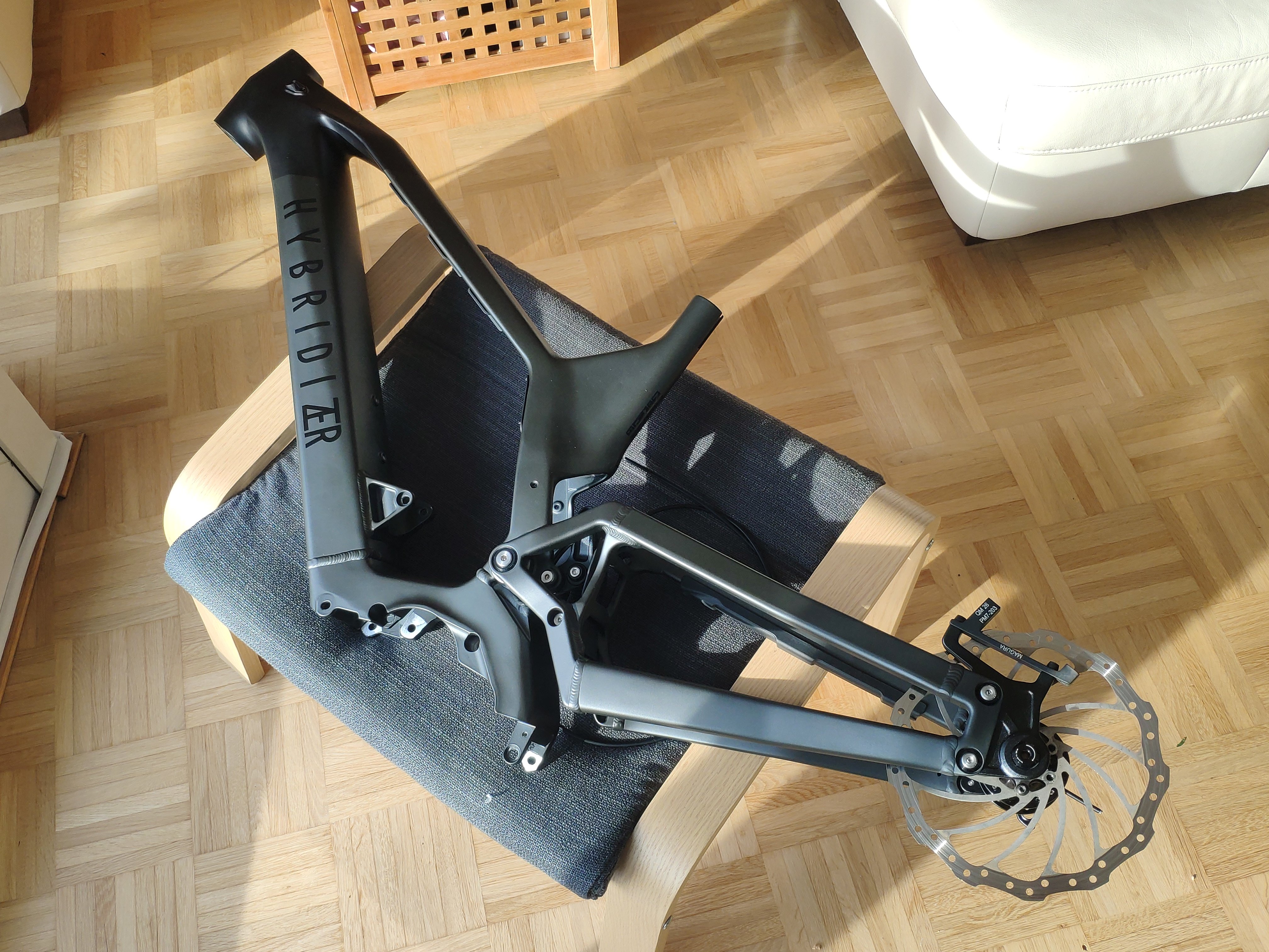

Received mine a few days ago. I'm amazed and very excited, to finish the build.

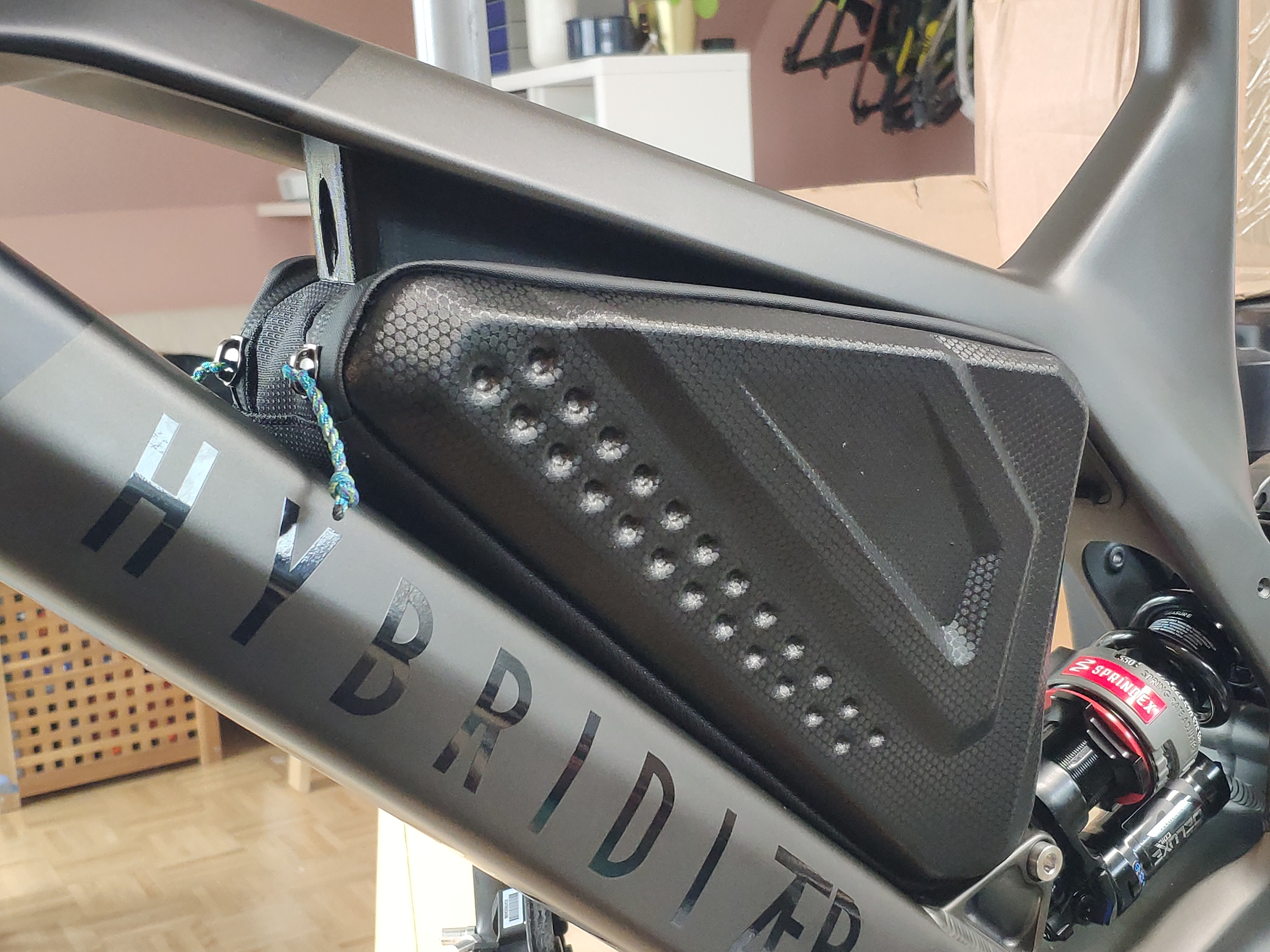

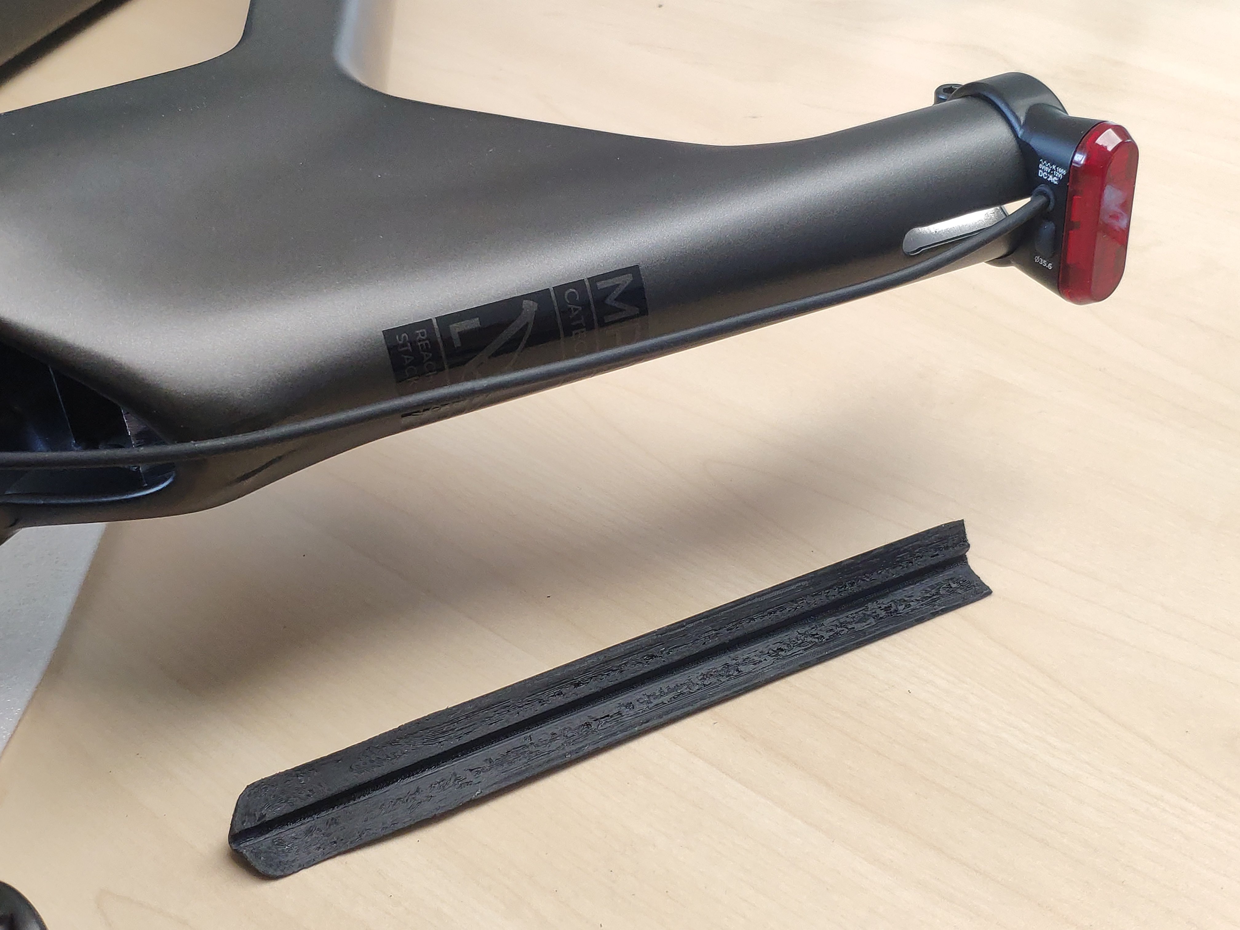

However I'm working on some custom features, like cable duct for the rear light and custom wiring so I can attach Lupine SL X + Lupine C14. It's a rather slow build, but I try to post images regularily.

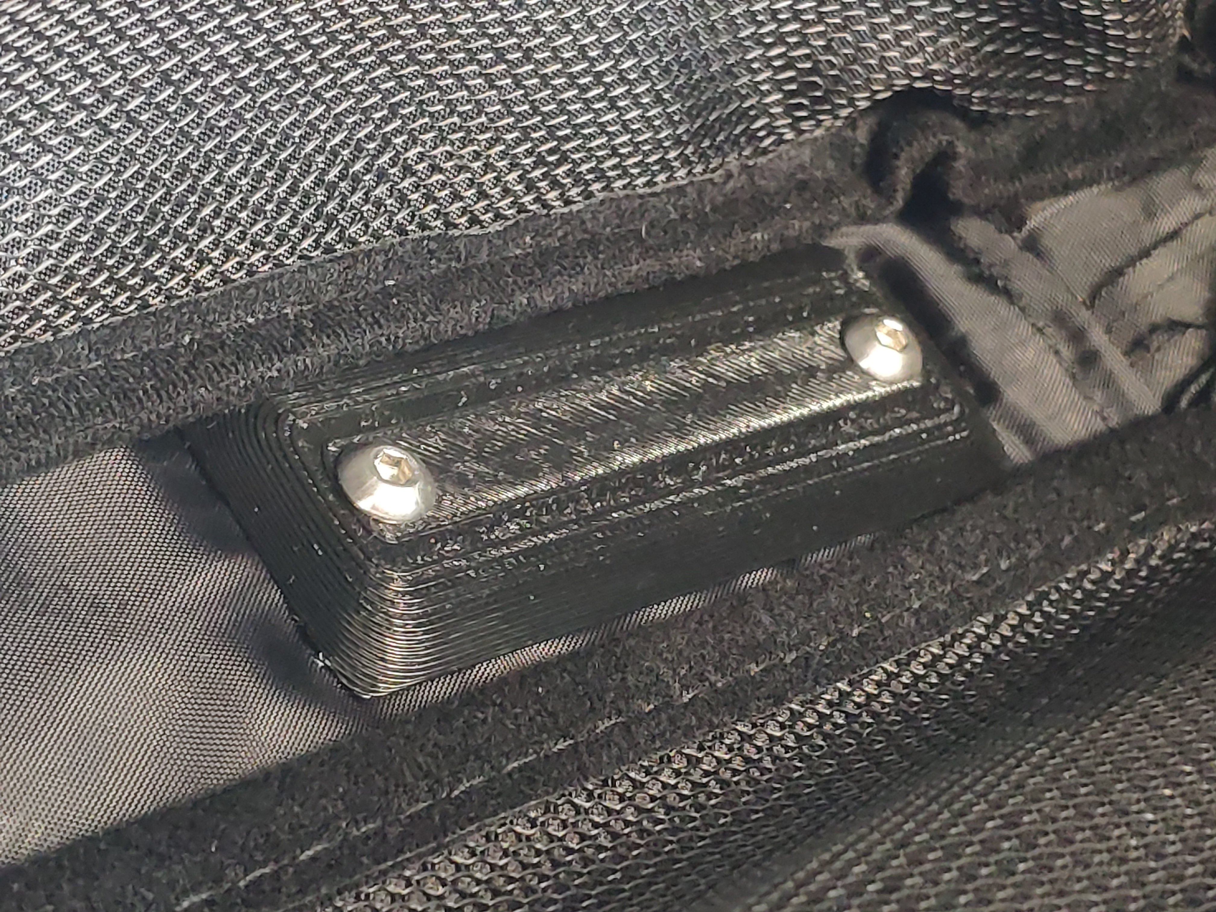

I got this "WILDMAN" bag from Aliexpress. The ugly reflective logo and straps can easily be removed. For mounting I made myself some 3D-printed parts, that screw into the exisiting screwholes of the frame. The zippers had to be replaced with cords, since it's hard to get around the corners otherwise.

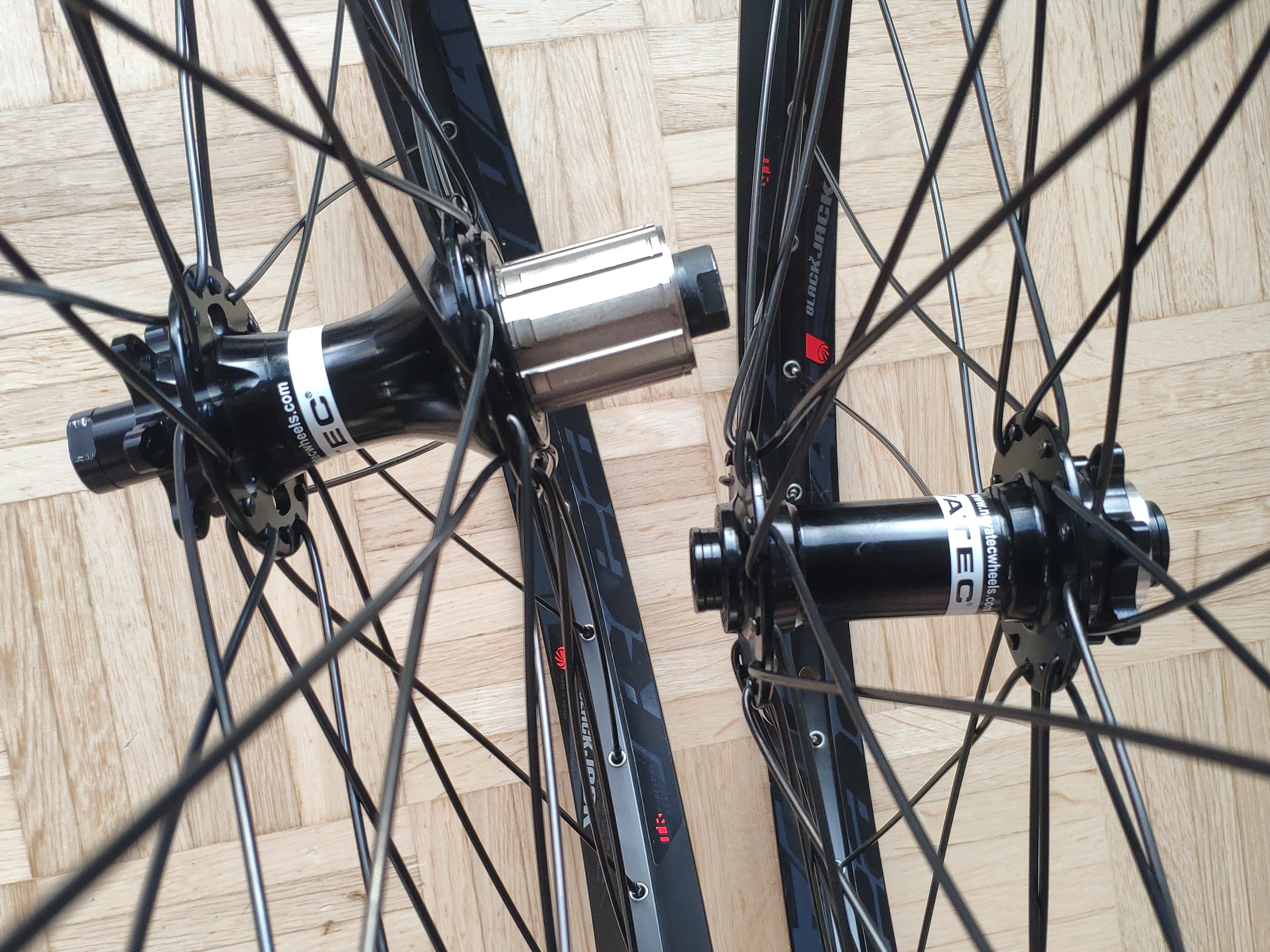

Just finished building the wheels! It's down to centering them now.. :)
Front: Novatec Hub 110mm Boost 32H 6-hole [D041SB-B15]
Back: Novatec Hub 148mm Boost 32H Shimano-body [D462SB-SL-B12]
Rims: Rodi Blackjack READY40
Spokes: DT-Swiss Champion 2,34mm

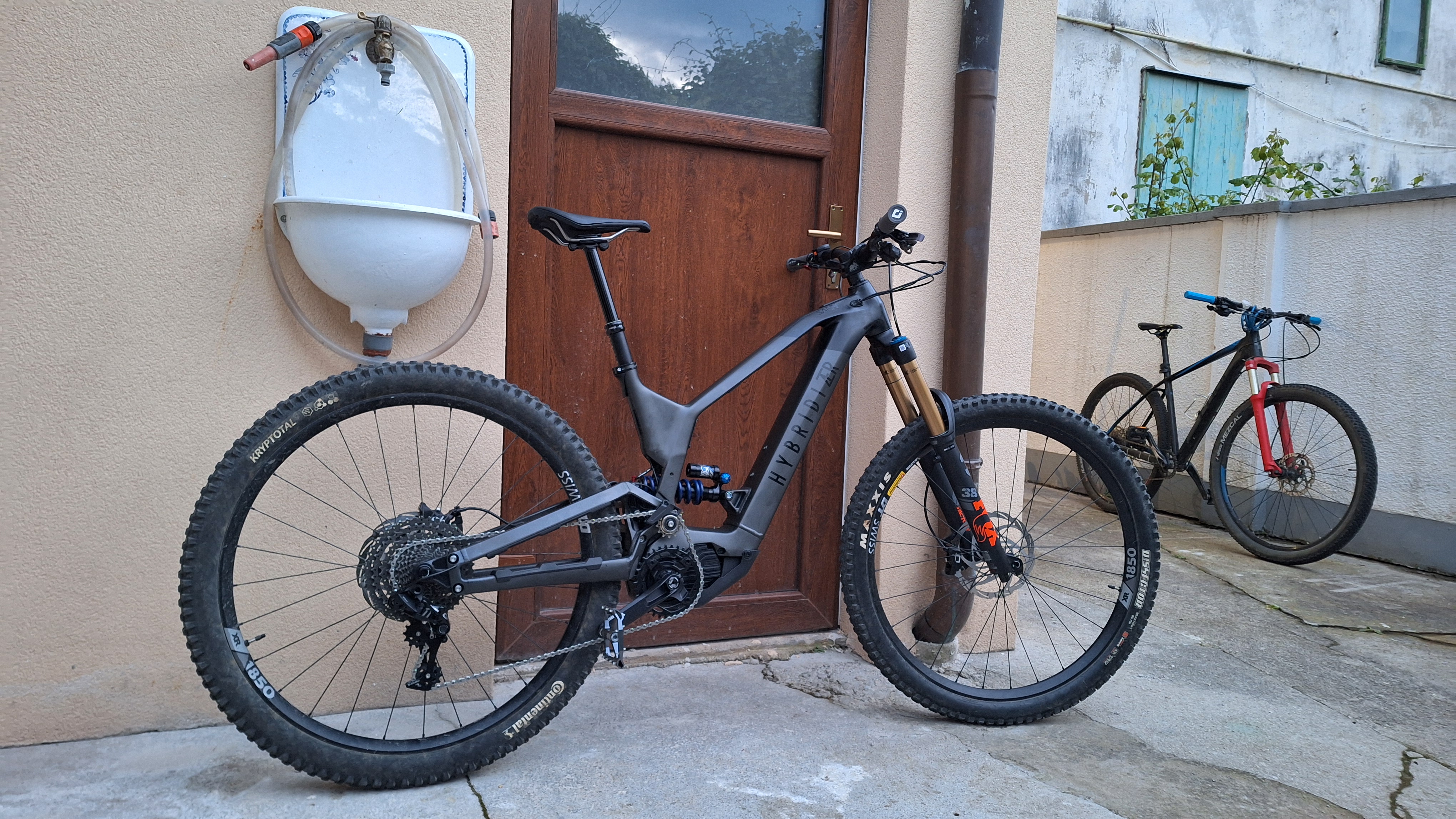

I finaly build my bike. It is verry nice bike frame, and works very good.

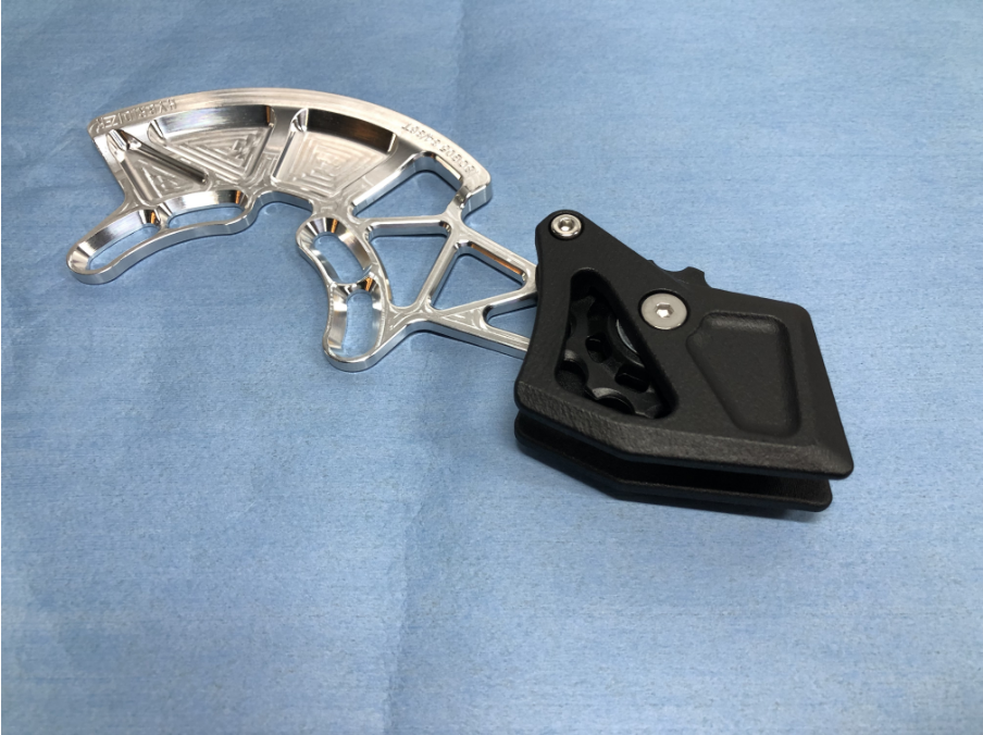

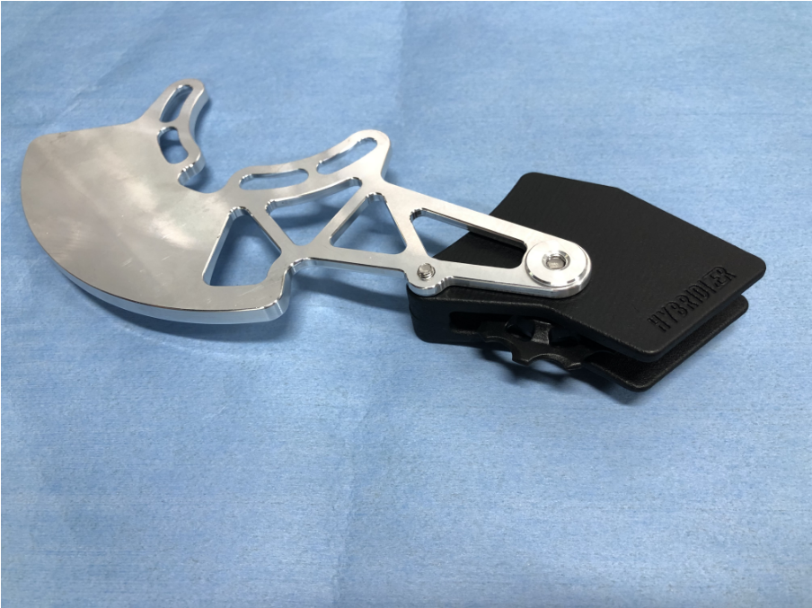

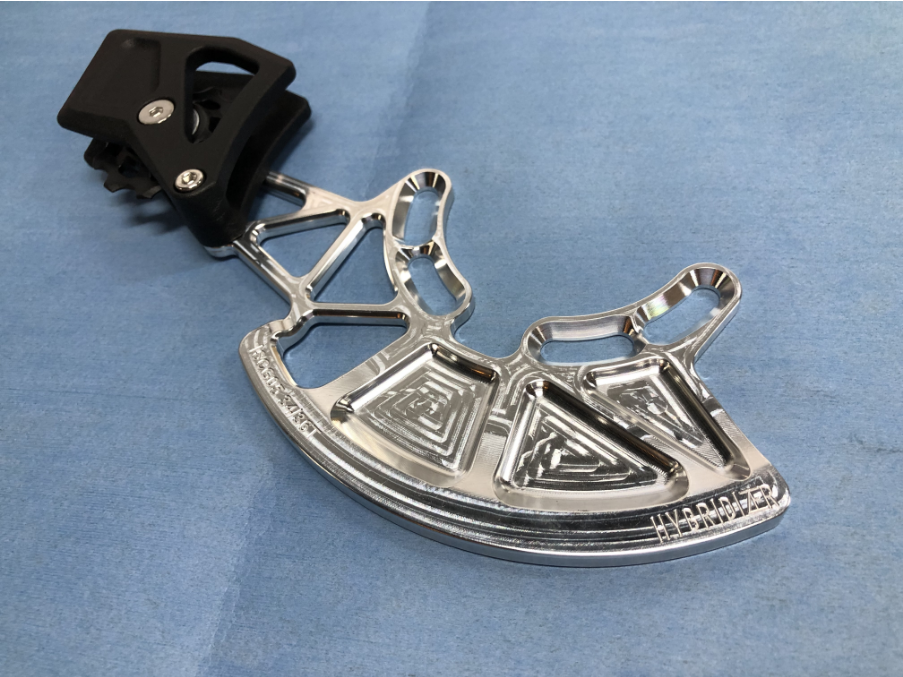

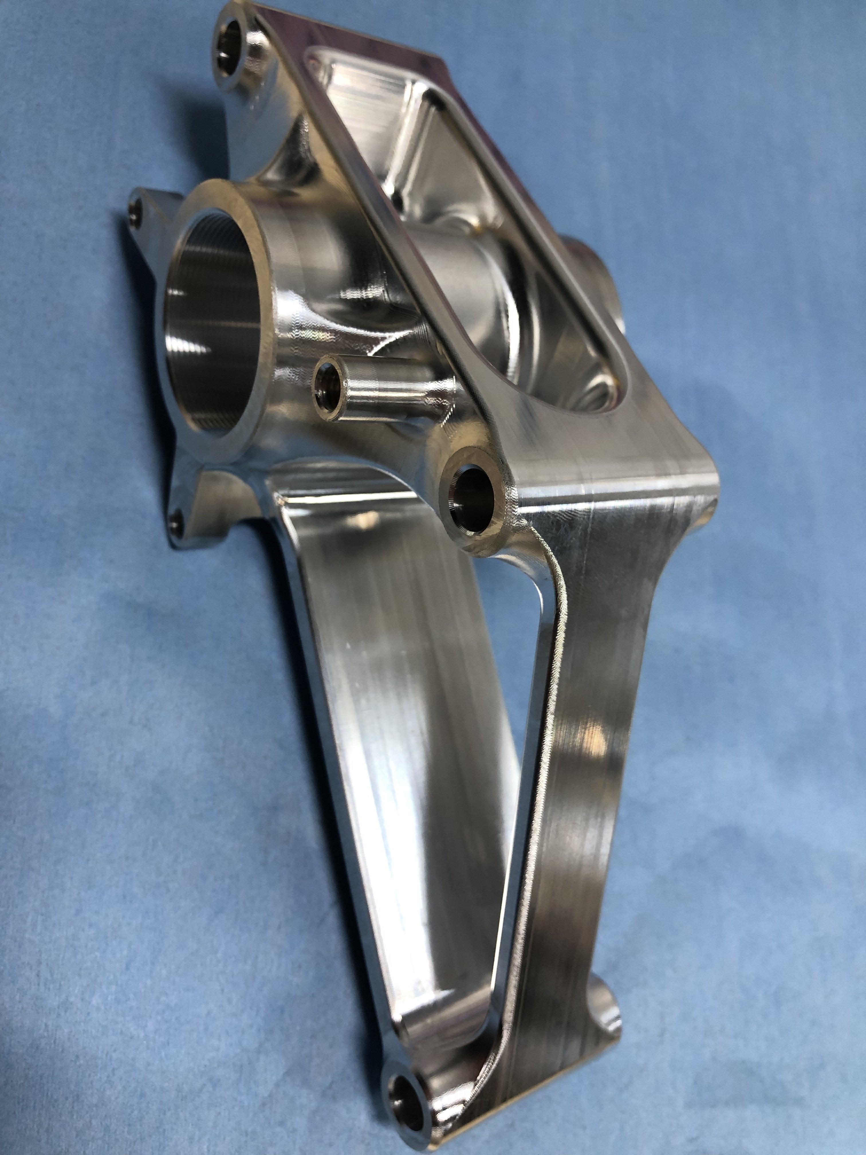

I have ordered bashguard and adapter for accustic bottom bracket (to make non electric bike bb92).
Price for chain guard is 52$, price for bottom bracket adapter is 100$, shipping to EU is 45$. And they gave me free jersey😁.
I think all parts are super nice.
Have a nice day. 1713515814066.png 1713515779245.png image.png 7fd6c19c95ea4ea360e703535df30d8.jpg 3a46e1ef9e7ef8968bb3fcdd3242aee.jpg eb9354e504e6b08099e94e62b0fc24e.jpg

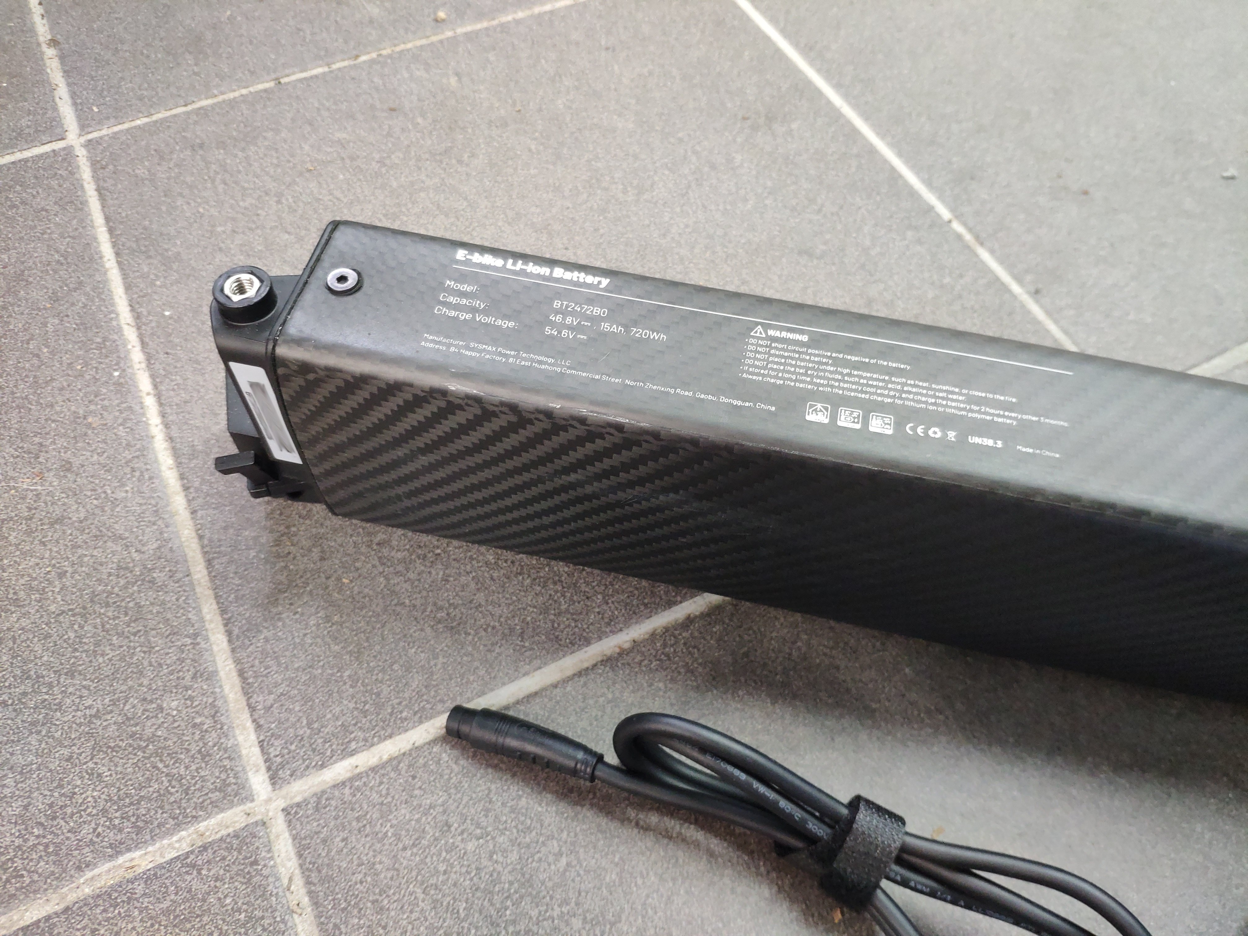

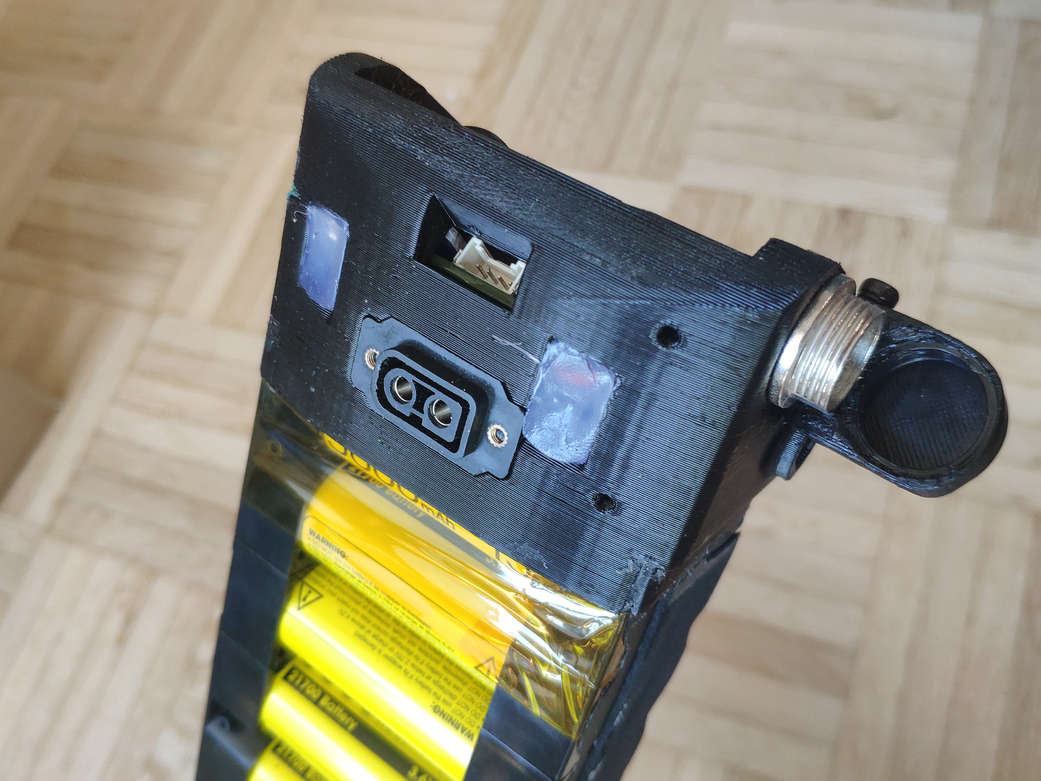

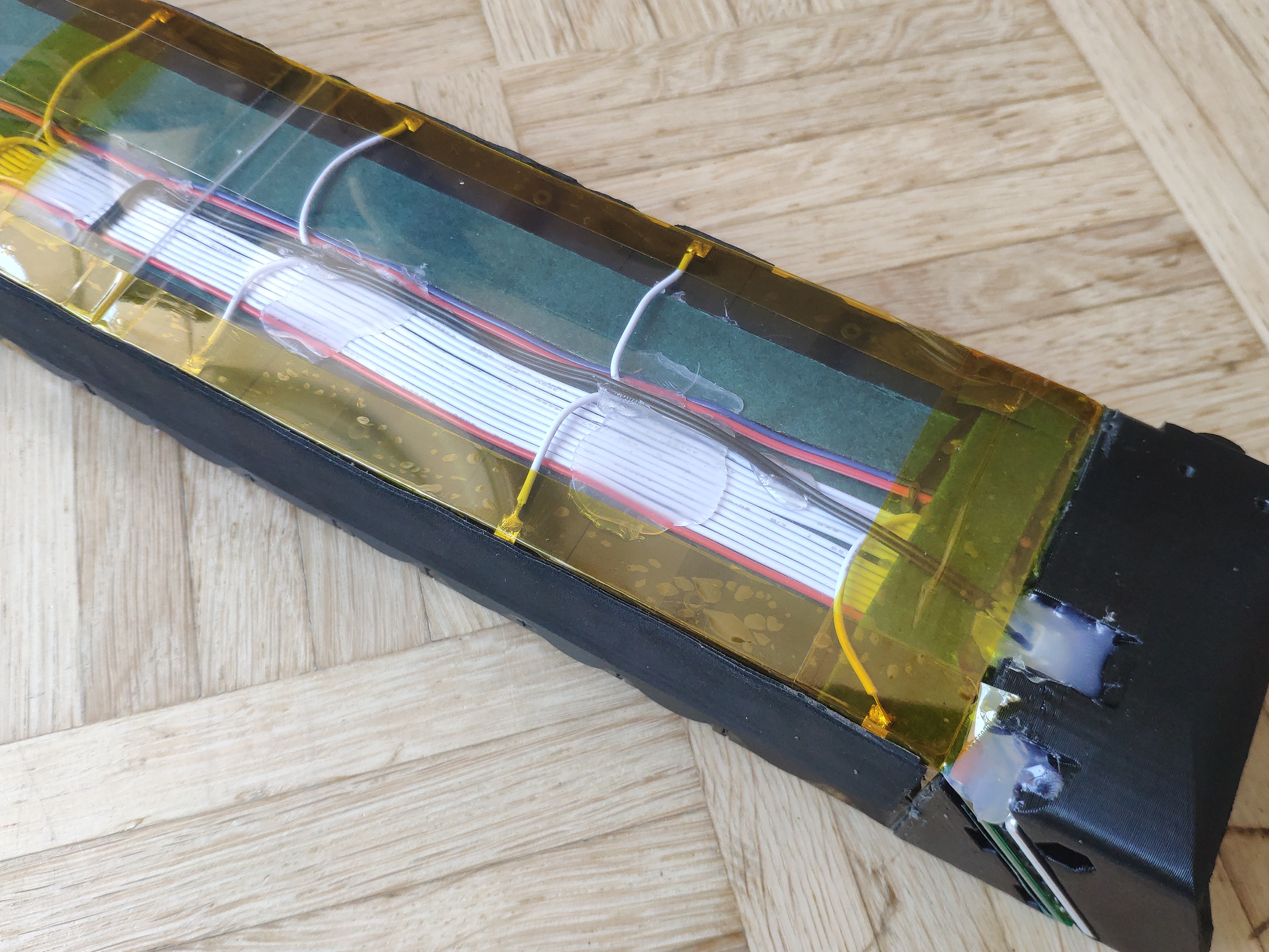

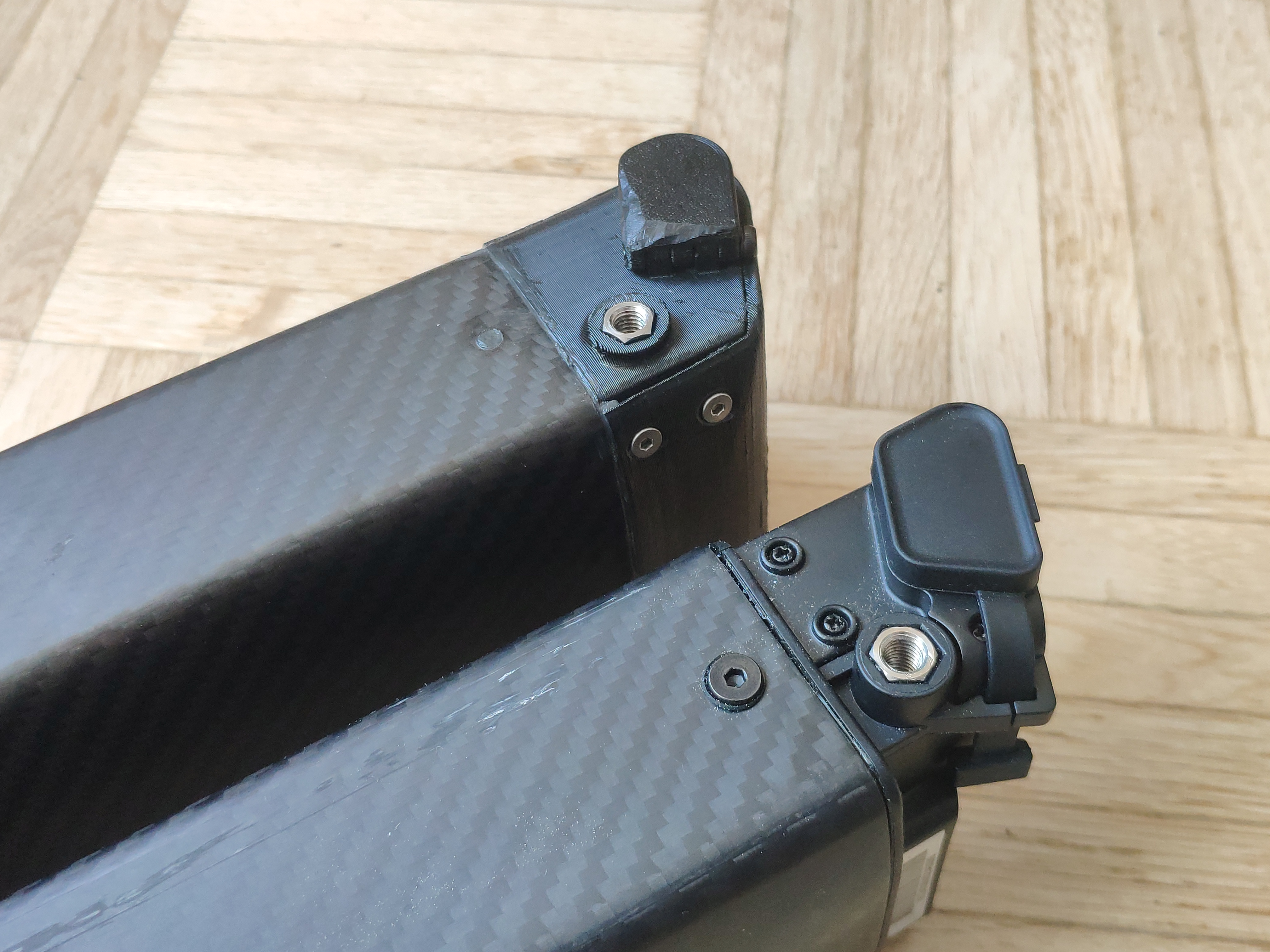

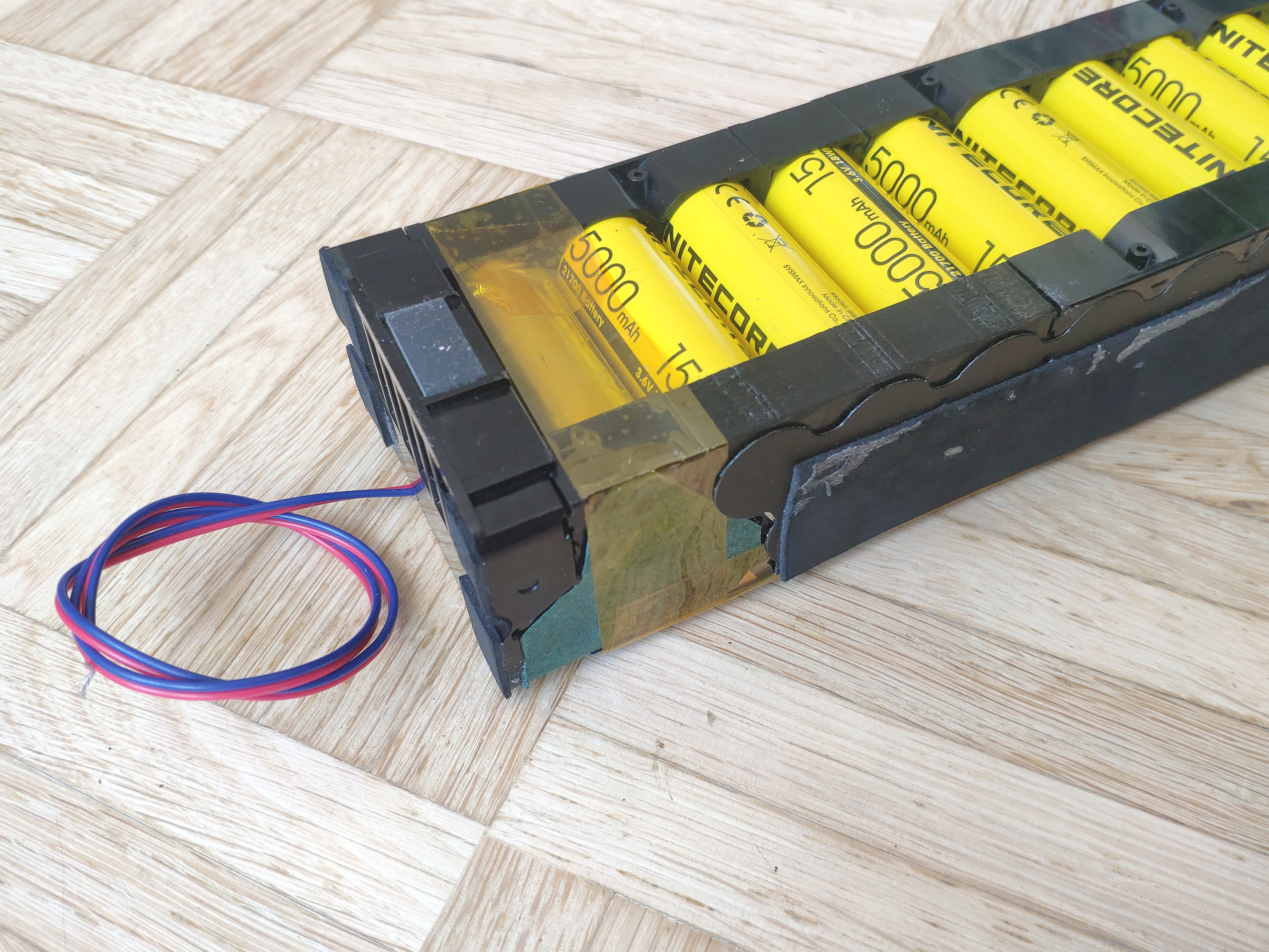

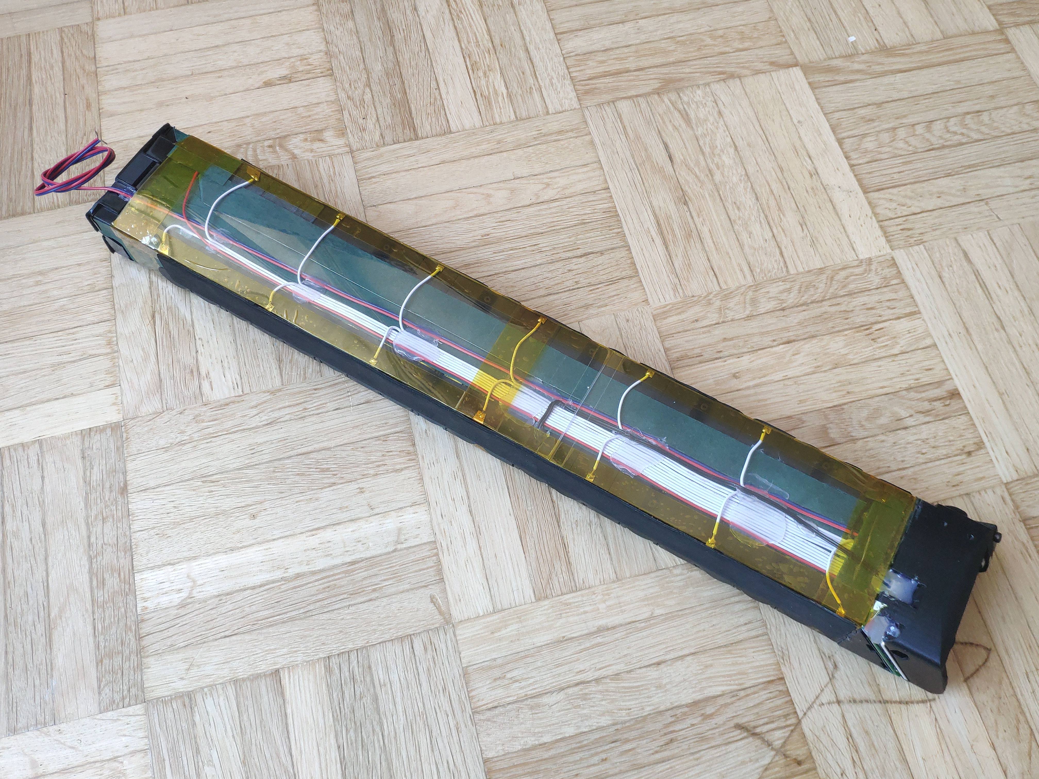

I designed it so that it fits the carbon tube and replaced the lower part with a 3D-printed part to fit the new BMS and charging connector. I used silicone to glue it back in. Here is it compared to the stock battery.

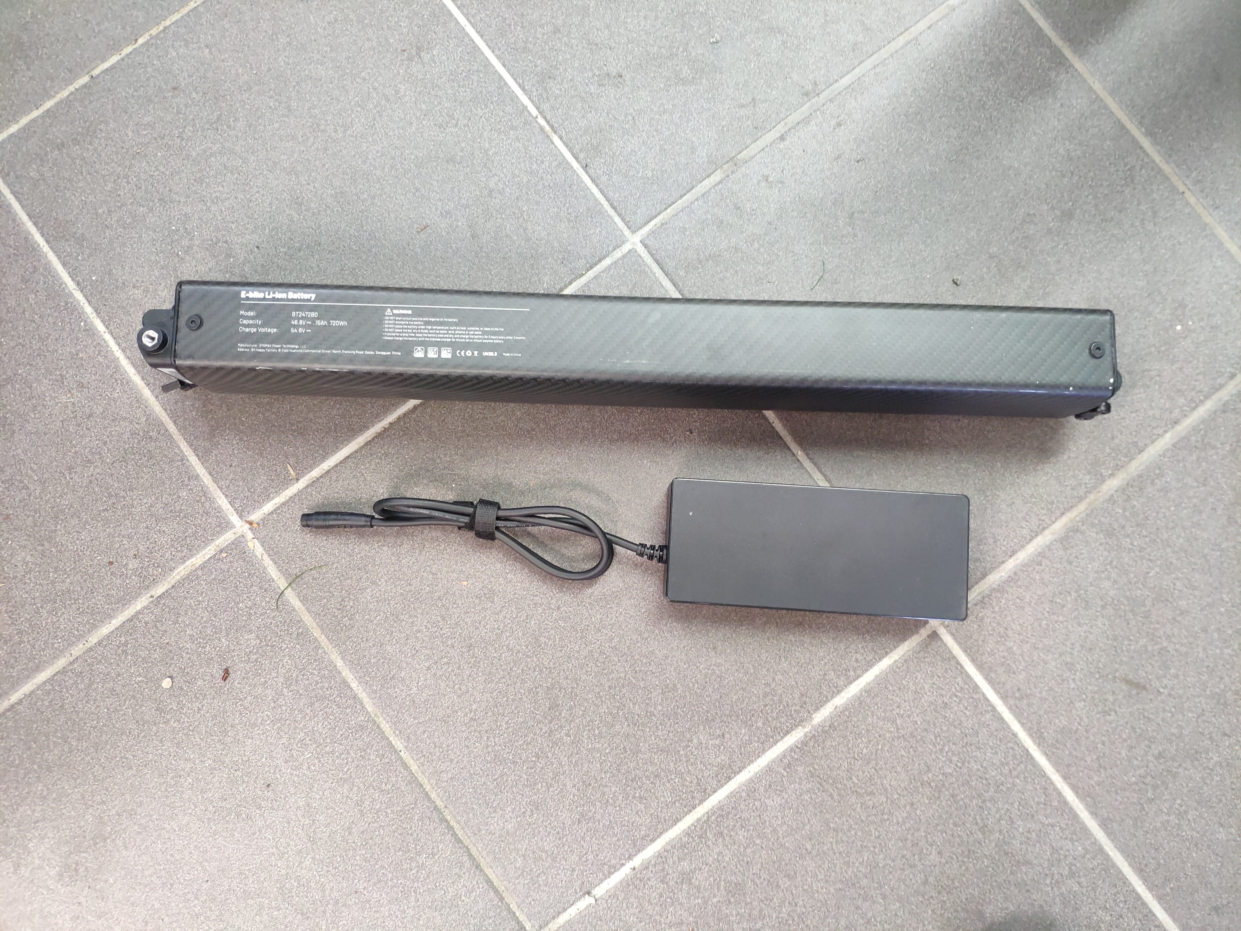

Does anybody need a backup battery? Since I built my own battery, I no longer need this one. It was just for backup. 😊 I'm asking for 650€, which includes charger + battery. Send me a message if you're interested.

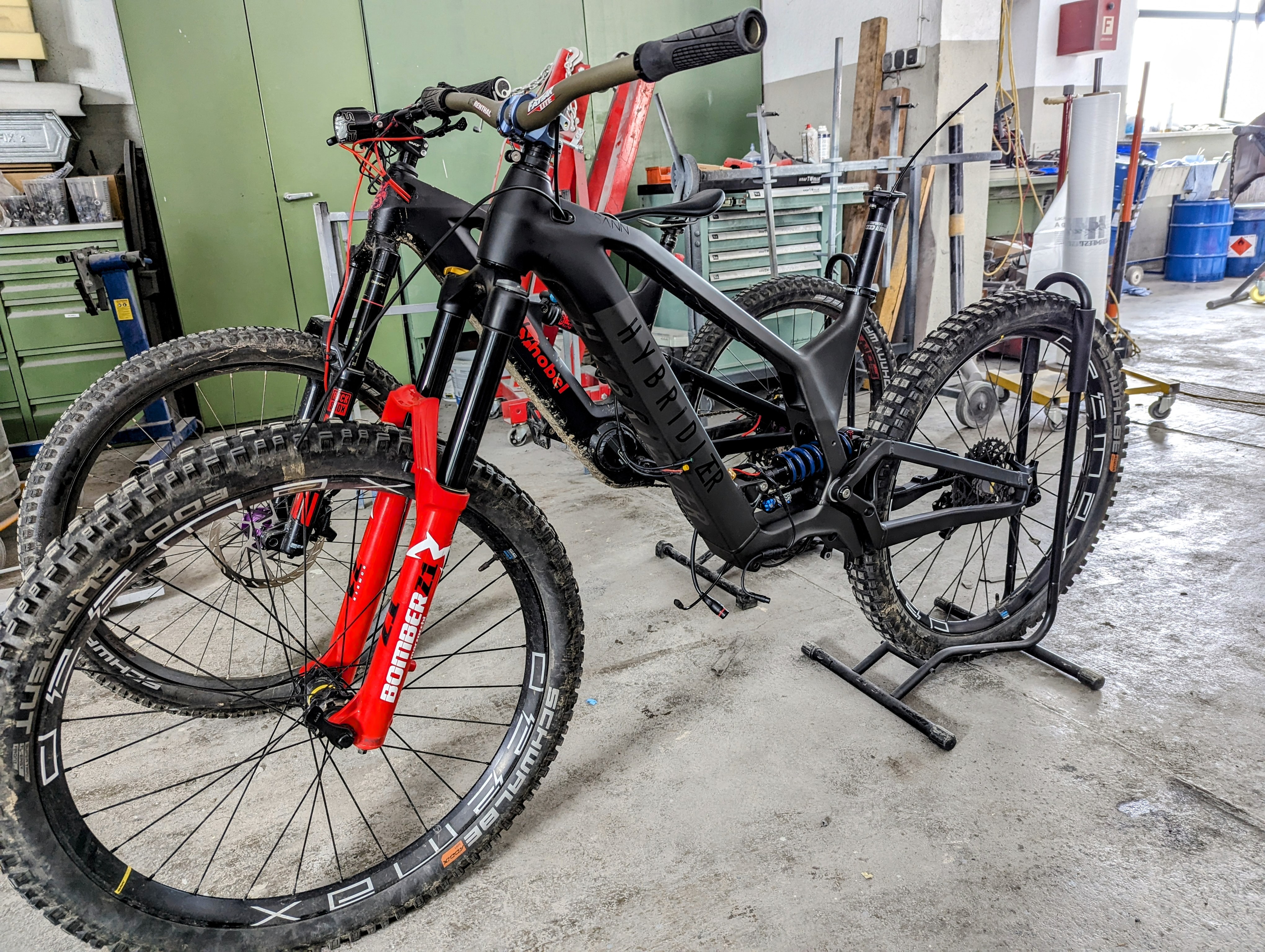

Marzocci Bomber Z1 180mm
SRAM GX 11 Speed groupset
Fox dpx2
SRAM code silver stealth
