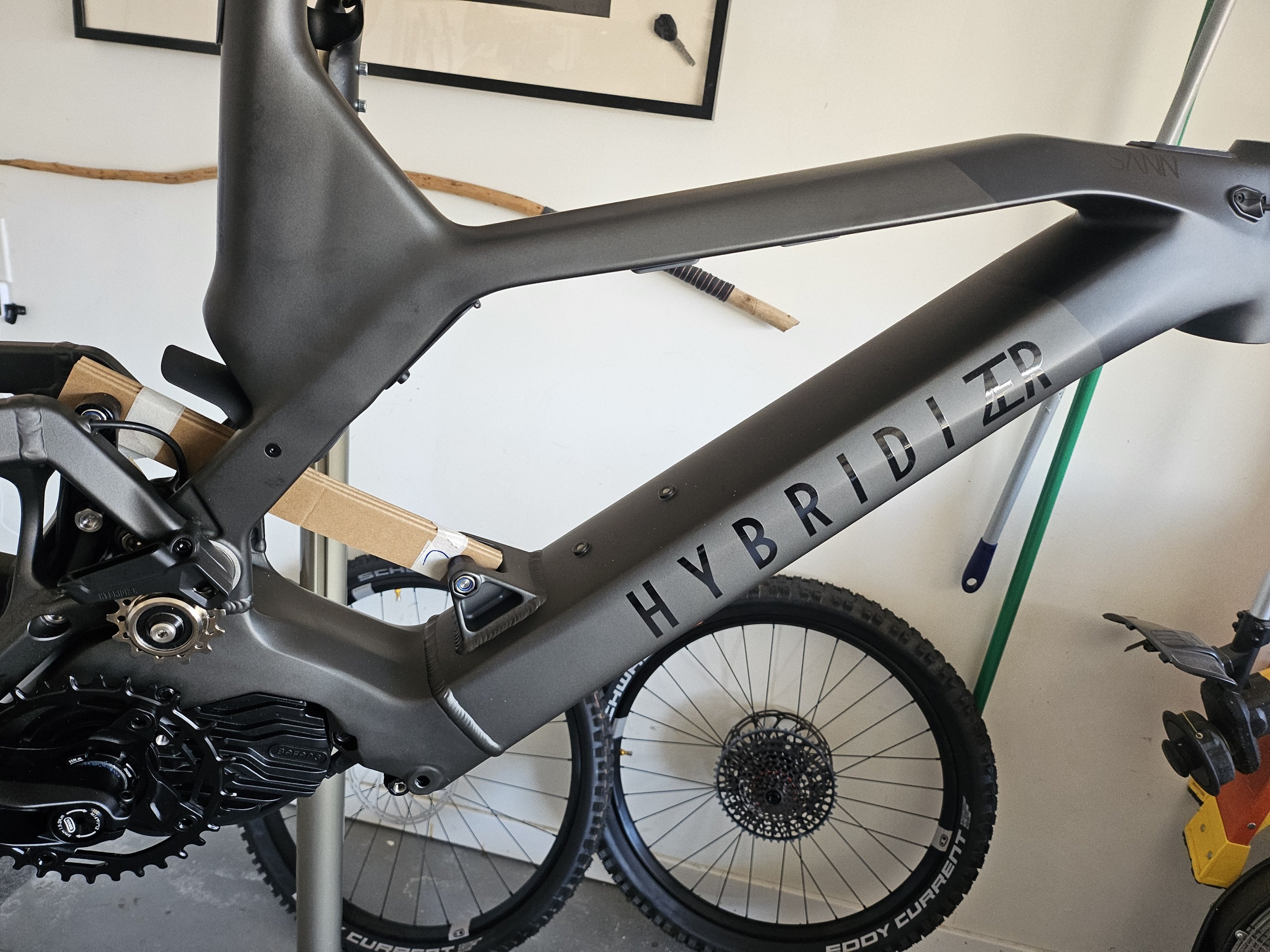

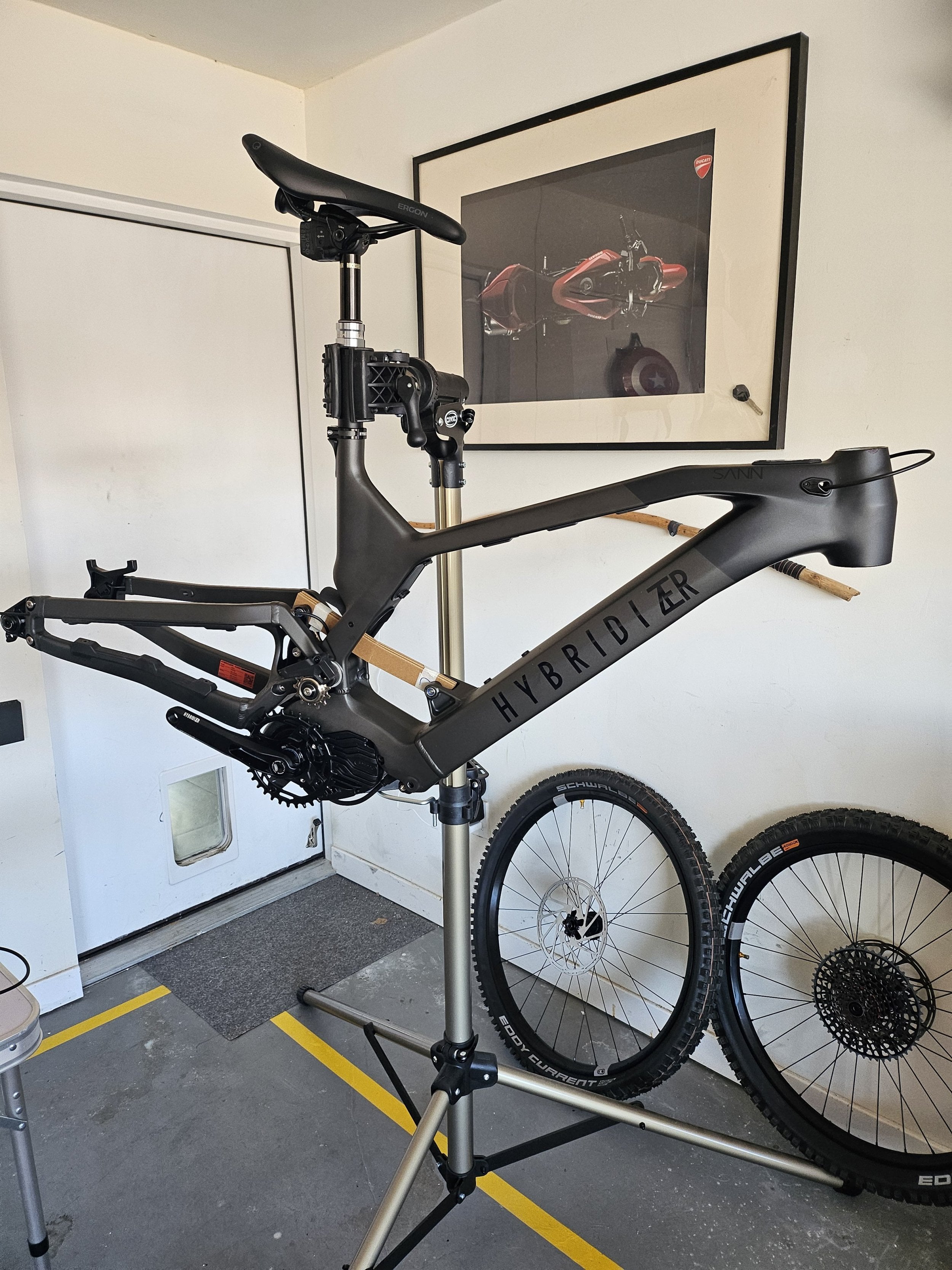

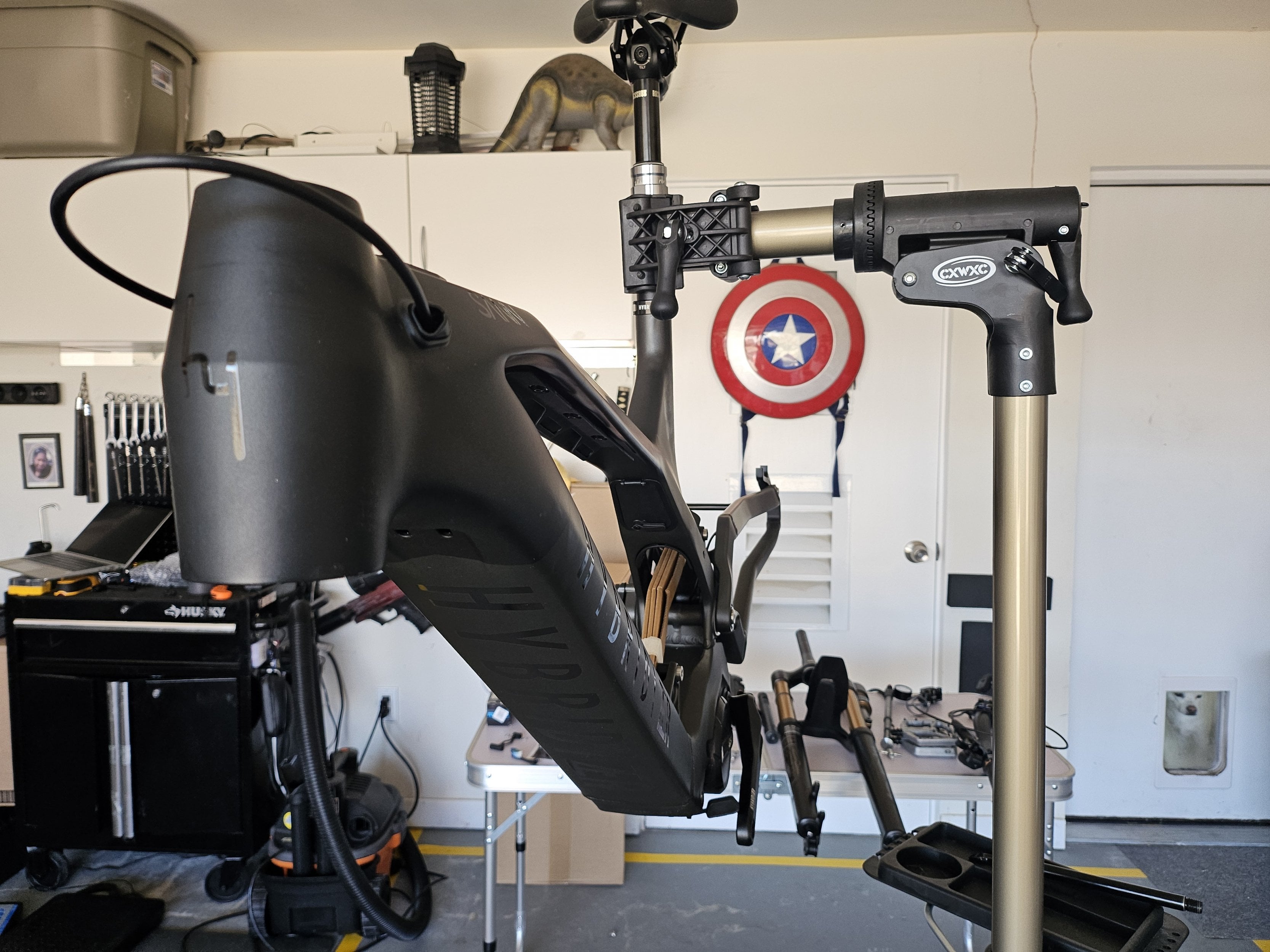

So my 2x batteries arrived this week (still waiting for the frame to be released by customs 😪) and I'm finally able to take a closer look at them. My ultimate goal is to make them 52V and I'm very determined to do this 😉 Things I've noticed so far:
They waterproofed using glueing the endcaps in with silicone 😐 This means it's not a very friendly repair, if it's needed one day.. The screws were tighend kinda loosly and torx would have been a better fitting screw for a battery enclosure. (Hex tends to strip when it got rusty..)
The cover that goes on the charging port is black rubber and the button underneath is pressable, when it's closed. However the LED is not visible through the rubber, which is unfortunate.. Can't tell whether this is important during normal use.. The connector that's connecting to the motor, inside the frame is a HIGO Z718AM C 03 GH 0300. (I suppose it's original or a very well-made copy). Only 4 pins are used for B+, B-, CAN-H and CAN-L.
The manufacturer of the battery is nitecore (SYSMAX Power Technology), a very reputable and esthablished battery and flashlight manufacturer. The overall quality is decent, however, I hadn't had a look inside yet 😉
SANN is showcasing a 720wh Carbon Fiber "battery" which I imagine is referring to the case. Unclear yet as to what cell they are using? I passed on what was available to my battery contact at DT battery and it wasn't familiar with him and he is going to check into it.
The cells are from NITECORE and labeled as BIB2150. Best guess from Mooch over here, was that they are rewrapped. I contacted them, to get a datasheet and some info about their max discharge.
Do you paid customs @D'Apostrophe? And how heavy is the frame itself, without the battery?
No customs. I've never had to pay on anything aside from the sellers shipping fee from China direct. (Alibaba, greenbike kit etc.)
The weight for the front triangle without motor is 3.4 kg (7.6 lbs).
I can't weigh the swing arm at the moment because it's undergoing a custom paint job.
One annoying thing is that the motor has to be removed to take out the battery. Also, if your bottle cage screws are too long they will impact the battery case.
Be aware that there's no, or very little grease on the swing arm pivots.
