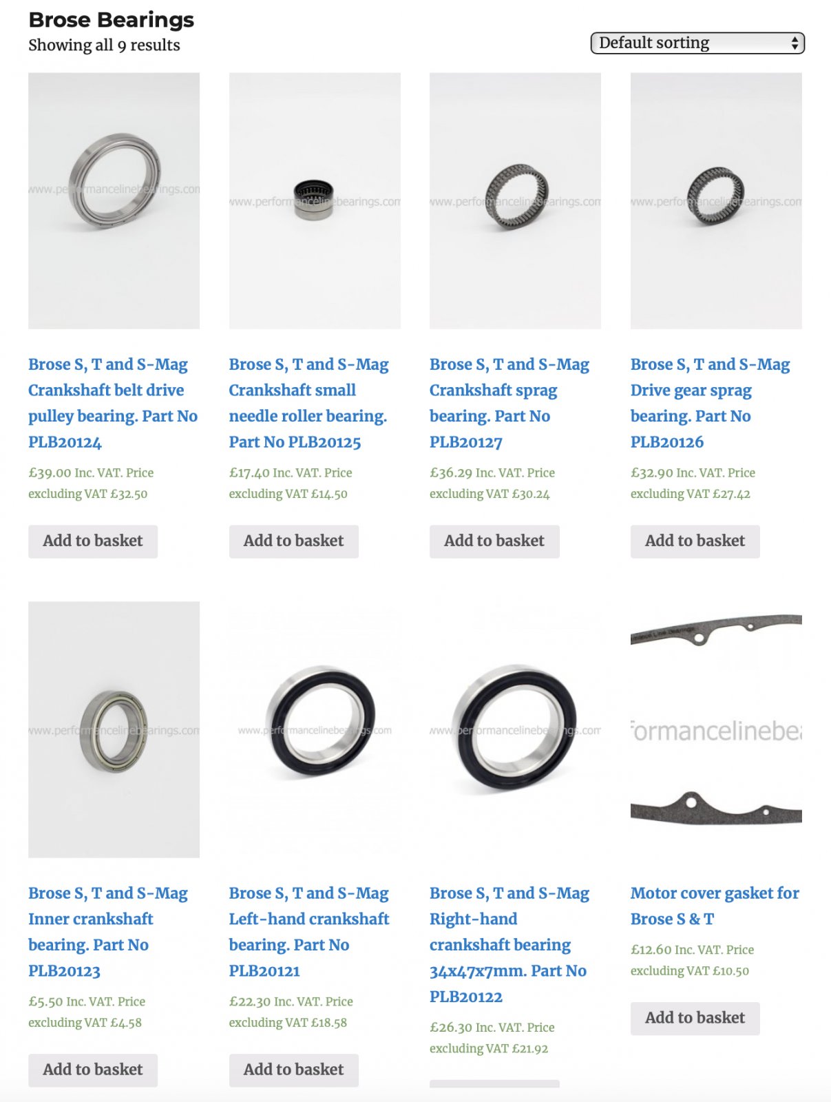

At present there is no need to as they are getting replaced under warranty so there's no market for it. If a sprag clutch fails in 4 years on that motor and Spesh won't warranty it, maybe third parties can deal with this cost-effectively.
Exactly yes specialist motor repair services will hopefully provide fast repairs. A service industry that will experience growth both in demand and opportunity. There aren't many obstacles, parts are available.
Brose Bearings Archives -
PLB20121: left-hand crankshaft bearing.
PLB20122: right-hand crankshaft bearing 34x47x7mm.
PLB20123: inner crankshaft bearing.
PLB20124: crankshaft belt drive gear bearing.
PLB20125: crankshaft small needle roller bearing.
PLB20126: Drive gear sprag bearing.
PLB20127: crankshaft sprag bearing.
Genuine Brose belt kit to change a damaged belt. This kit include the original Brose belt, gasket, bolts, seals and instructions. The belt is the new 2020 model, more robust than the original. Please, select the Brose motor model (S-T, or S Mag).
