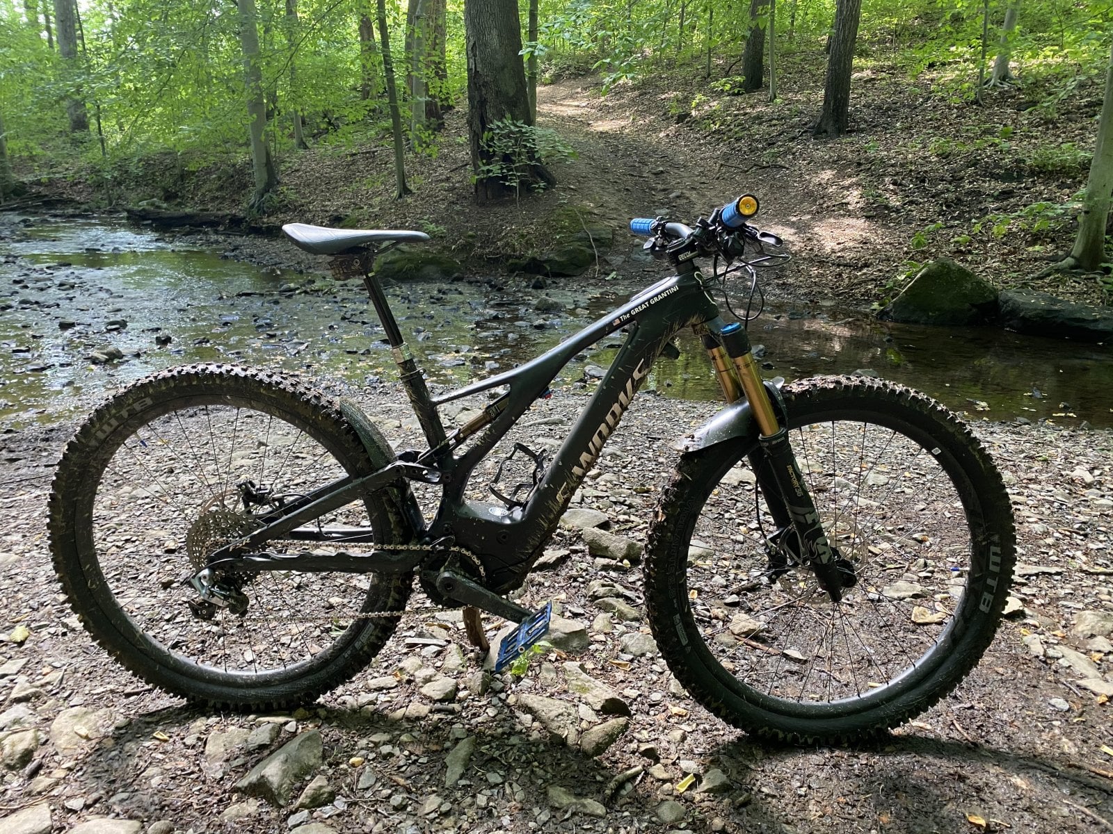

I will say this, having had three Levos and having motors warrantied on two of them. The service is excellent. Brose just shipped 1500 motors to Specialized, and I believe the first half are already here. The four warranty issues I have had were resolved quickly and painlessly. 1) the handlebar control unit on my 18 was replaced 2) the motor on my 20 comp went and was replaced 3) the power cable on my 20 comp frayed and was replaced and 4) the motor went on my 20 Sworks and the motor is enroute. The new motor has a kevlar belt which replaces the problematic original belt. My guess is that this motor then becomes bullet proof. Specialized has also created an Ebike program for their dealers which, if they commit to buying a specified number of units will give that dealer a parts package to maintain and update from. So in theory, if your dealer participates and your motor goes you can drop the bike off tonight and pick it up tomorrow. This is a GAME CHANGER for the ebike world. The reason I ride Levos is because they are head and shoulders ahead of all the competition. My long time LBS doesn't carry specialized, but he does
ed but does carry Pivot and Santa Cruz. I was going to switch over to the Heckler or the Shuttle, but frankly, they are two years behind Specialized so I couldn't do it. My Specialized dealer has been great and I'm committed to sticking with them. I would also note that in our extended riding group there are probably 25 guys with Ebikes and all but one are Levos.
