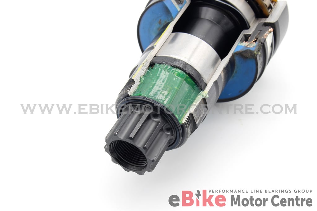

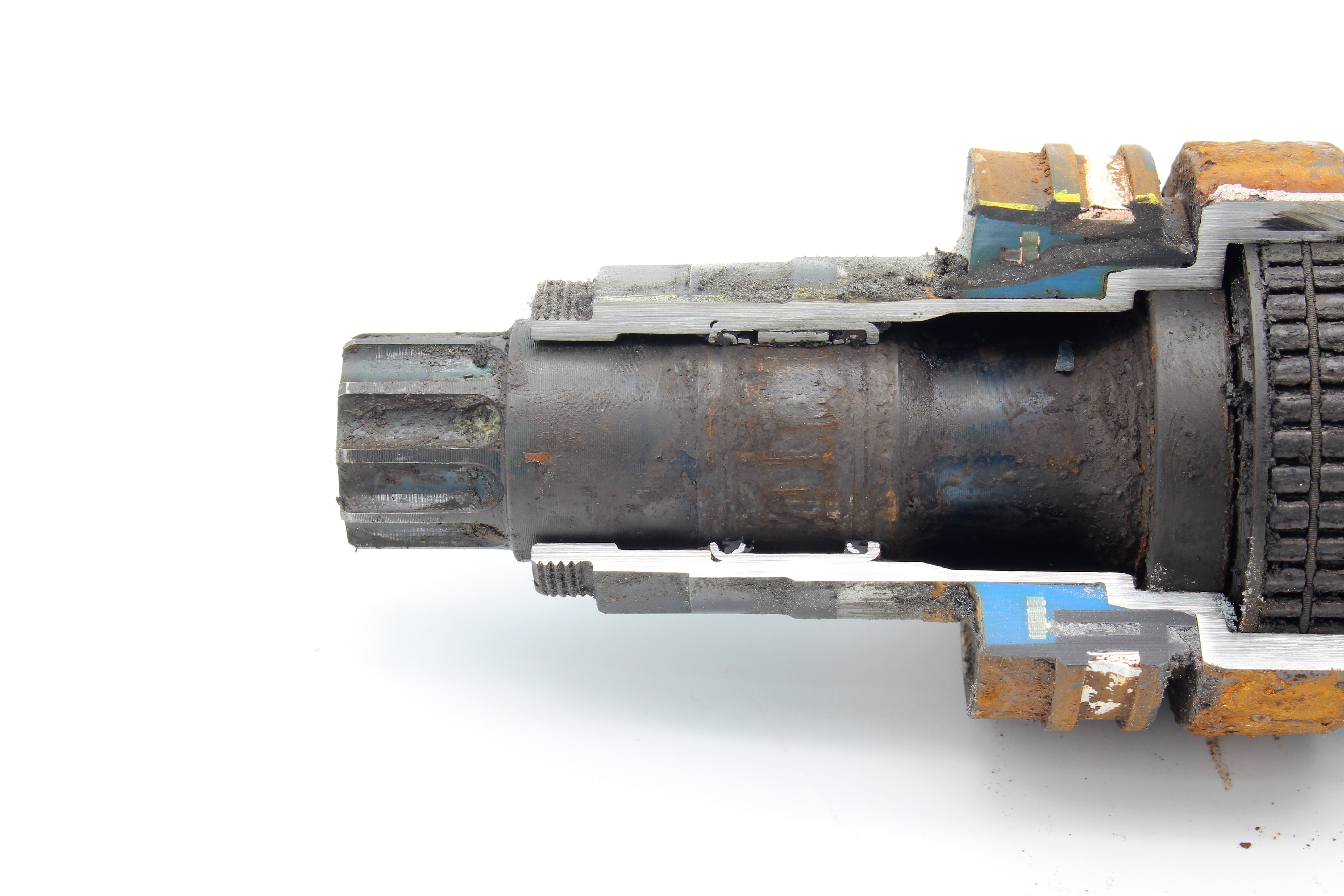

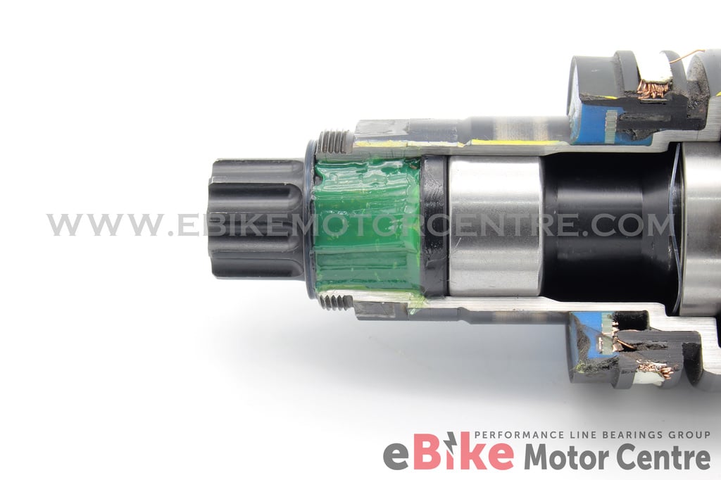

Fitting a seal is now standard practice for us and all our partners worldwide, including Michael in the US who made this lovely video. We always add this and several other layers of sealing when repairing these motors.
The picture below shows a cutaway of the crank assembly where you can see our X-ring outer seal a layer of waterproof grease, then our rotary shaft seal, followed by the internally sealed needle roller bearing.
You can also see at the bottom, the gap that the grease fills and what happens to a motor without this sealing.
