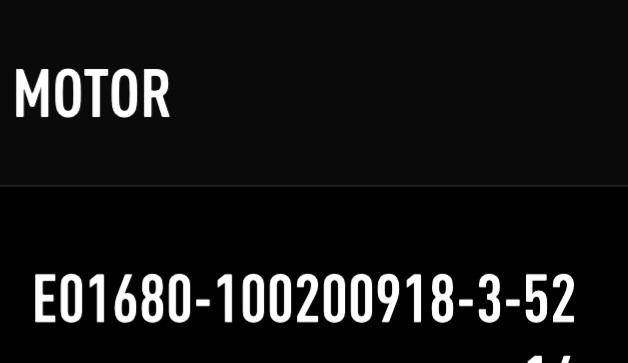

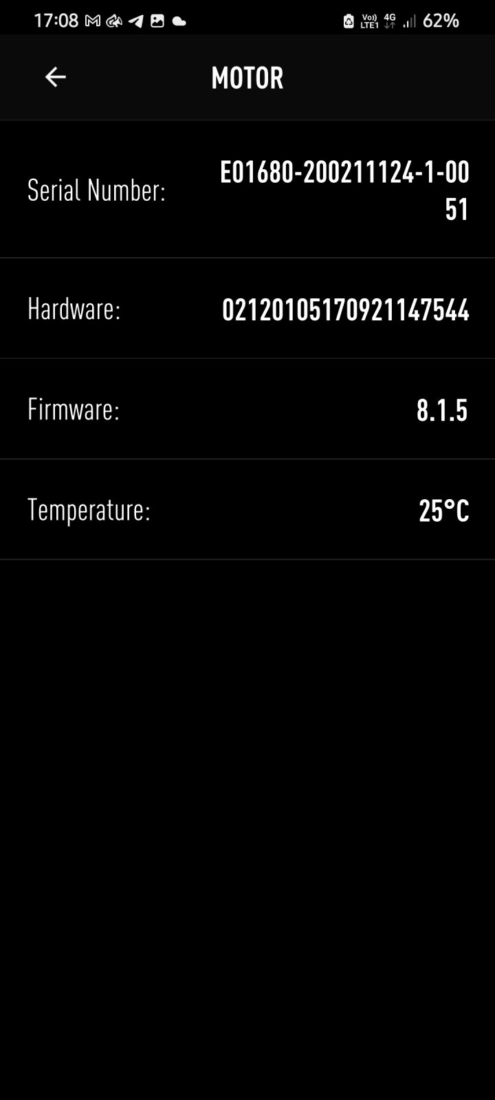

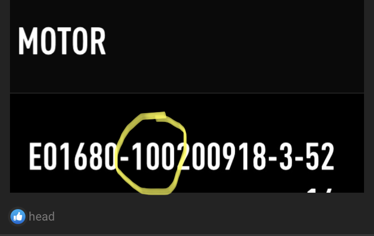

I looked at every possible combinations I could not see anything that remotely looks like 2019 20 or 21
My battery is in house not in bike so can't put on mission control and show you. If I remember it's not all the numbers just some. If i figured it out its not hard im sure there was pics on here showing it. I m out tomorrow will check if you are still struggling.
