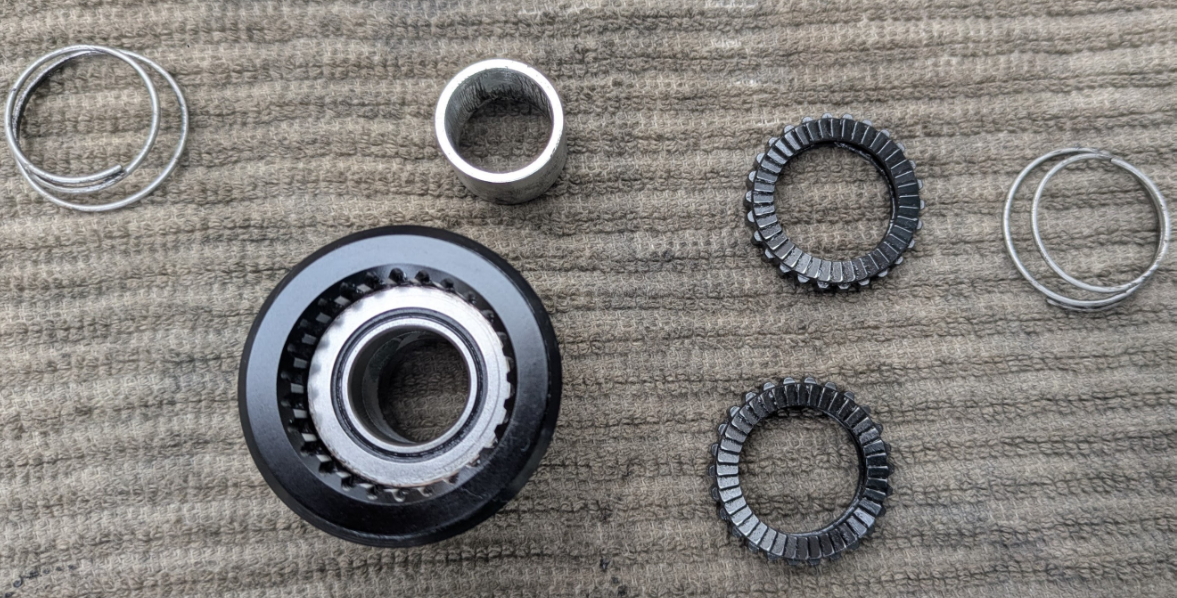

So sure they work fine. But I want a hub I can get parts easily and cheaply from an online store. I use the Koozer Hubs. The Koozer 350, is a DT Swiss 350 clone. I did a thread on them. They have been fantastic. All spares, (bearings and freehub) available on Aliexpress.
This is my Koozer 350 after 1000km on the Amflow. Everything in perfect order. Just re-greased and reassembled.
