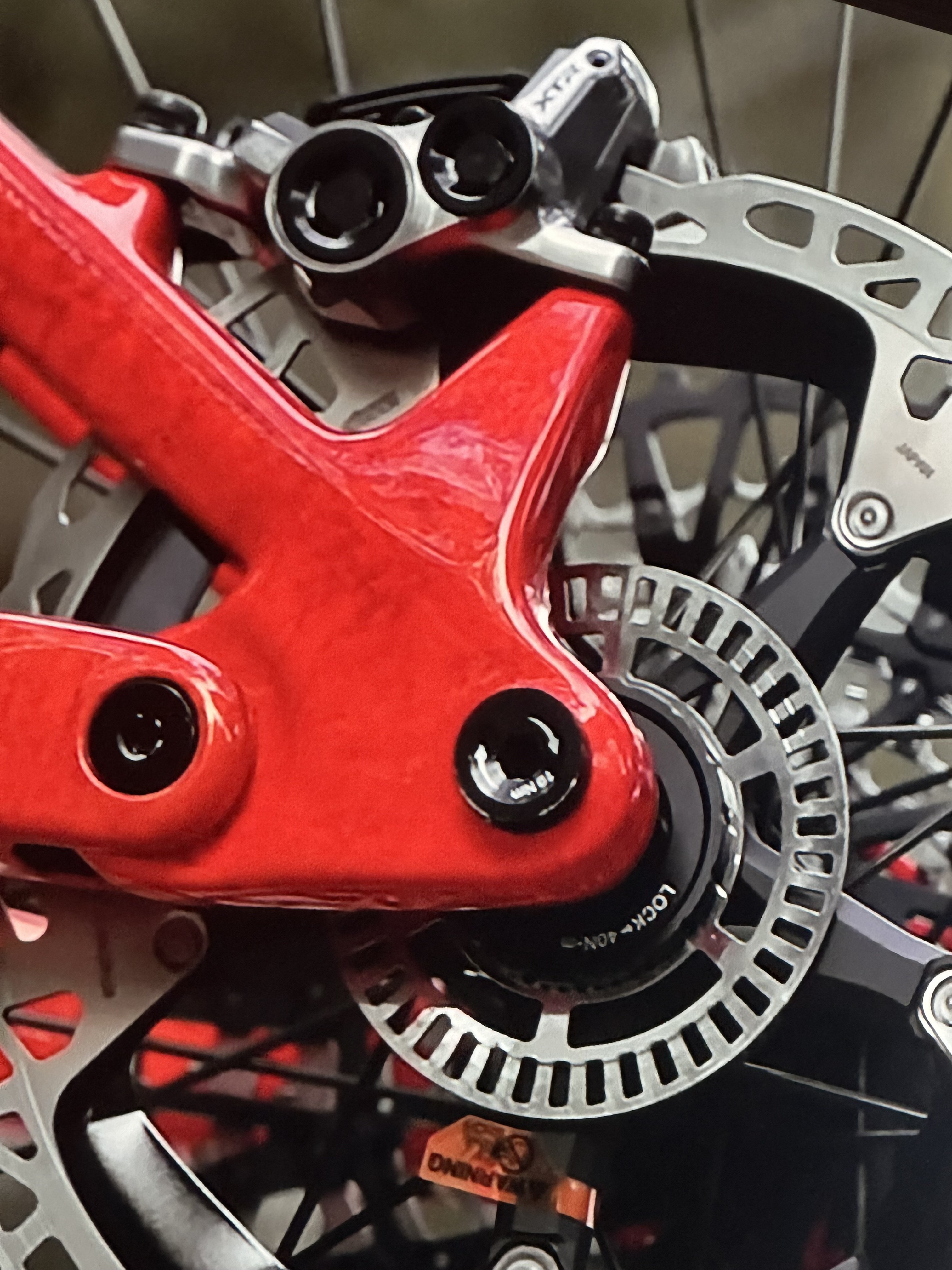

Hope you are well :) I’m getting a DJI bike soon (Rogue) and the wheel set I was planning on using has Centerlock rotors. Has anyone fitted the speed sensor disc to a centerlock rotor? I assumed it was 6 bolt only, but watching a Megamo video I see this;
Might just be sandwiched in?
Hey team,
Yes it is. The brake surface and socket of centerlock brake disc is planar (at least the left looking side) so a sandwiched sensor ring comes to rest exactly the same distance to the sensor as it would be if it is mounted on a 6-bolt disc.
It's not a magnetic plate. So as long as the distance to the speed sensor on the frame, is the same as a 6 bolt hub, which it should be if you sandwich it against the rotor. It will work fine.
