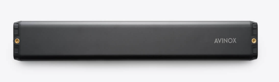

Interesting to see the battery pack out of the frame, they’re using some good 21700 LG cells there.
Does this assembly slip into some other kind of outer casing before going into the frame? Or does it slide into the frame as is?
Asking as it doesn’t look to be protected against moisture ingress, is the area where it sits in the frame weather sealed?

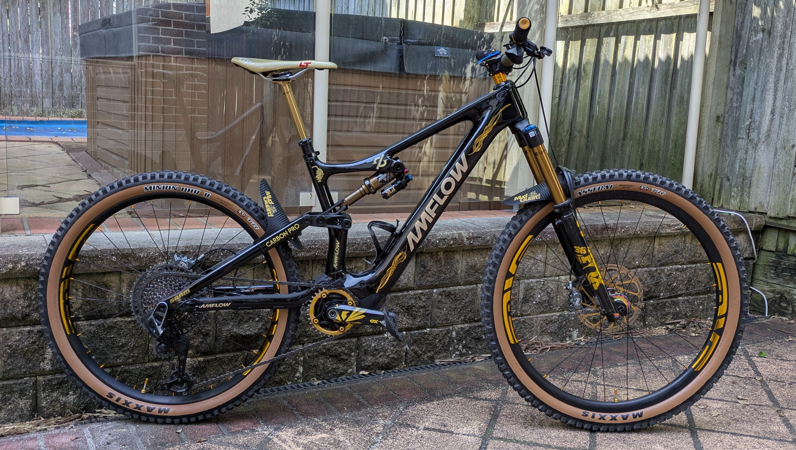

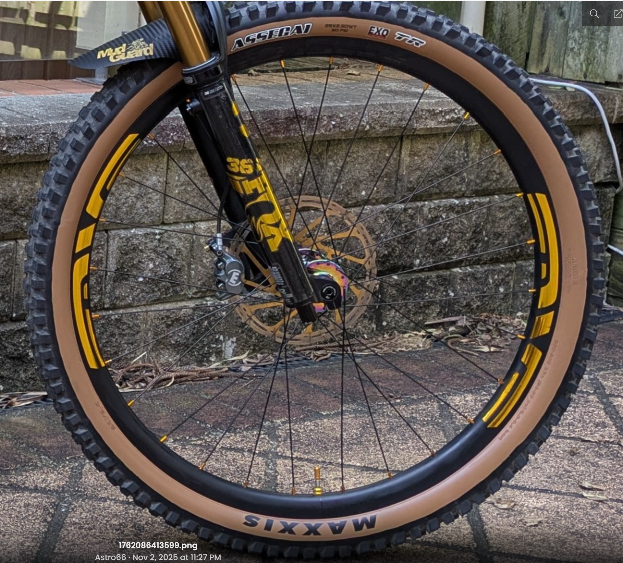

So I pulled the trigger on an PL Pro and will be swapping out the wheelset when it arrives (I have a spare DT 350/NOBL wheelset that I plan to use).
The carbon rims seem quite good quality. So I replaced the front hub, nipples and spokes and kept the rim. The rim was 28H so I got the matching hub. I used J type spokes. Just so much easier to source and replace.
I would have done the same with the rear rim. But I wanted to mullet it. So after too and fro-ing about carbon or alloy rear rim. I chose a Raceface 32H 27.5 alloy rim. Fitted a Koozer 490 hub. But didn't like the alloy axel. So I fitted a Koozer 350 hub with chrome moly axle and ratchet freehub. Didn't like the ratchet. So I discovered that Koozer make a 490 Pro version with chrome moly axle and a pawl freehub.
So after 4 different hubs. I'm finally happy with my wheelset. And even though I'm running different materials and brands of rims, front and back. I fitted matching decals, so you'd never know.
I also swapped to Tanwall light casing tyres, after liking the Tanwalls on the Velduro. . Assegai front and DHR 2 rear. I think I'm happy with the final package.

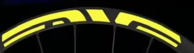

So you put Enve stickers on the OEM rims?
...but, We know! Also no gold rims, just decals? I'm pretty disappointed...
It's not actually the ENVE logo. It's similar to half that has been elongated. You cannot even join two to try and nearly form the Logo, because they are all the same shape, and would need to be opposites to join them. So they really are just gold decals that look similar to ENVE.
ENVE decal.
These decals.
My friends nicknamed me after an Australian Fashion designer, because I take graphic details to the extreme.
Each layer must contrast the previous layer ........ So .......
The tyre tread is black. Then the tyre walls are tan. Then the rims are black. So a top black rim gap to the gold rim decal. Then a bottom black rim gap to the gold nipples. Then the spokes are black. Then the hub is gold.
Every layer planned. Every layer correct. Is it OCD. Maybe. :ROFLMAO:

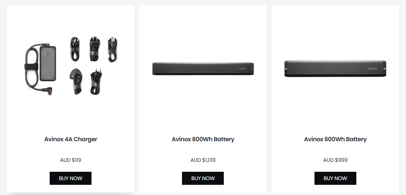

Hey. Not sure if it has been posted. But Amflow have updated the spare parts on the website. And you can now buy a spare battery. I'm tempted to get the 600Wh battery, as I'm rarely using more than half my 800Wh battery on most rides.
So I could fit the 600Wh, and drop another kilo of weight, taking the bike to 19kgs for most of my rides. Then fit the 800Wh for my adventure trips. Perhaps even bring the extra battery and exchange batteries if needed. I reckon I could swap them in about 15 mins. Motor removal is pretty easy.
Prices are AUD$

I don't yet see the links on the US sites?

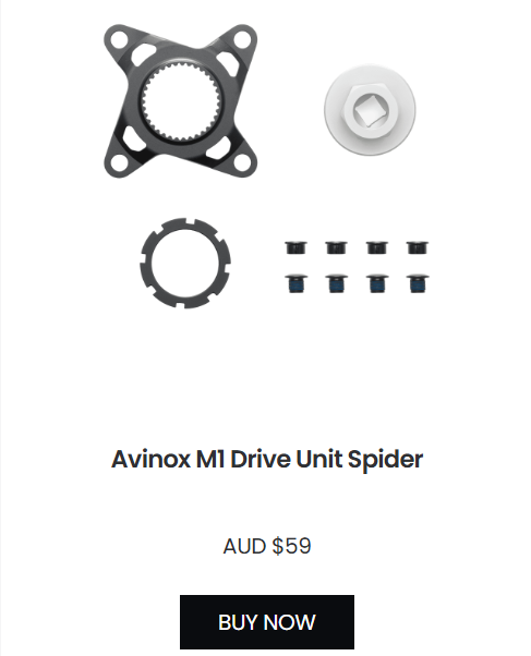

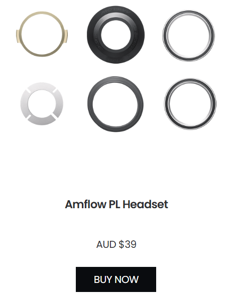

I'm very pleased with the spares pricing too. AUD$39 for a headset kit is nice. AUD$59 for the spider kit is so cheap. It includes the removal tool, and I paid $45 for just the tool at a 3rd Party site.
I have bent a spider arm, and just straightened it. It's not perfect though. If I didn't already have the tool. I would be purchasing for sure.

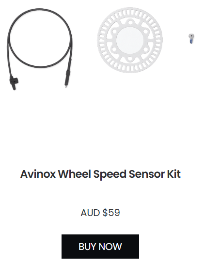

My bike arrived at my bike shopt today but not the extra speed sensor I ordered.
AUD$59 for the whole kit. Include the speed ring. Considering SRAM are charging more than twice that for the derailleur cable. It's crazy. As it's just a cable with a higo connector.
My dealer quoted $20 US for the speed sensor by itself which for what it is, is a lot, but in the bike world not bad. My buddy has an Amflow and I think was able to get one from the same dealer. Alas, the chainring tool is not available but at least Wheels Mfg is going to be offering on but $42 for chunk of Aluminum with simple CNC machining is a lot.
