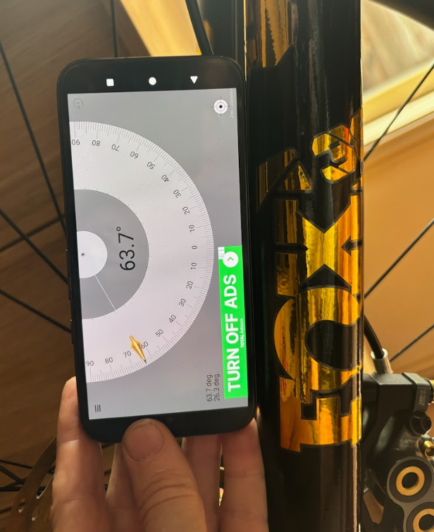

In an attempt to add a little extra downhill clout to my Amflow, without adding weight. I flipped the flip chip to 29er, whilst still leaving the mulleted 27.5 installed. The protractor measuring head angle, showed about 64.4 before, and 63.7 after. So a slackening of about 0.7.
The less desireable impact will be a lower BB, and the steering not feeling as sharp. I'll take it out on the weekend and report back on any noticeable differences.

I came from a mulleted Merida E160, so I mulleted the Amflow PL Carbon Pro immediately after purchase. I ran 150mm cranks on my Merida to help with pedal strikes, but the Amflow comes with 155mm, so I haven't changed them.
I snapped the frame of the pedal on the weekend in a rock strike, so I'm thinking the flip chip probably contributed, though I was using plastic framed SPD pedals to save weight. I have put my light-weight alloy SPD pedals back on, that don't really have a frame.
I am undecided about the impact of running the bike slacker at 63.7, as the group I was with, didn't really want to hit any technical downhill. But it didn't seem to impact the climbing noticeably.
