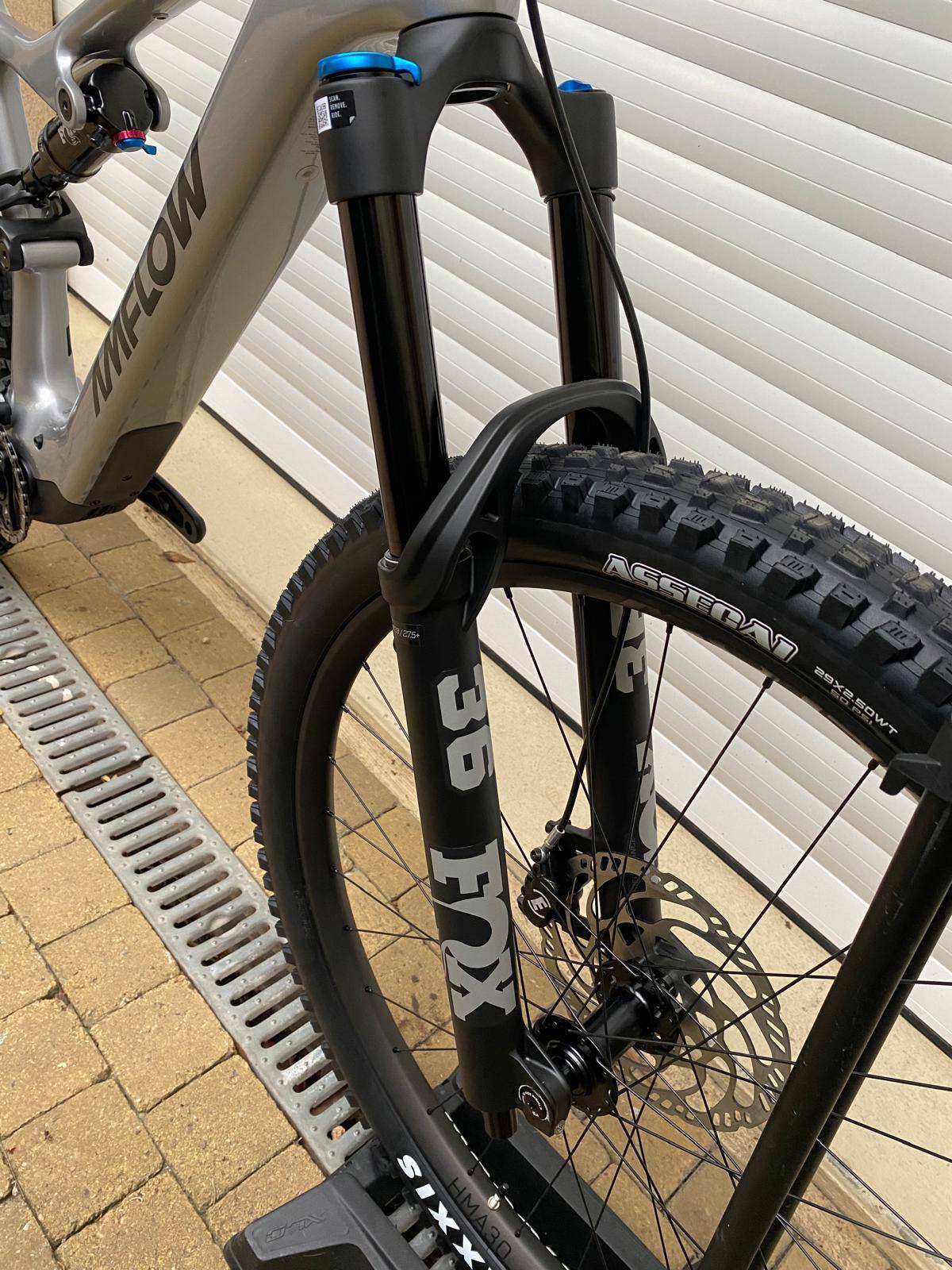

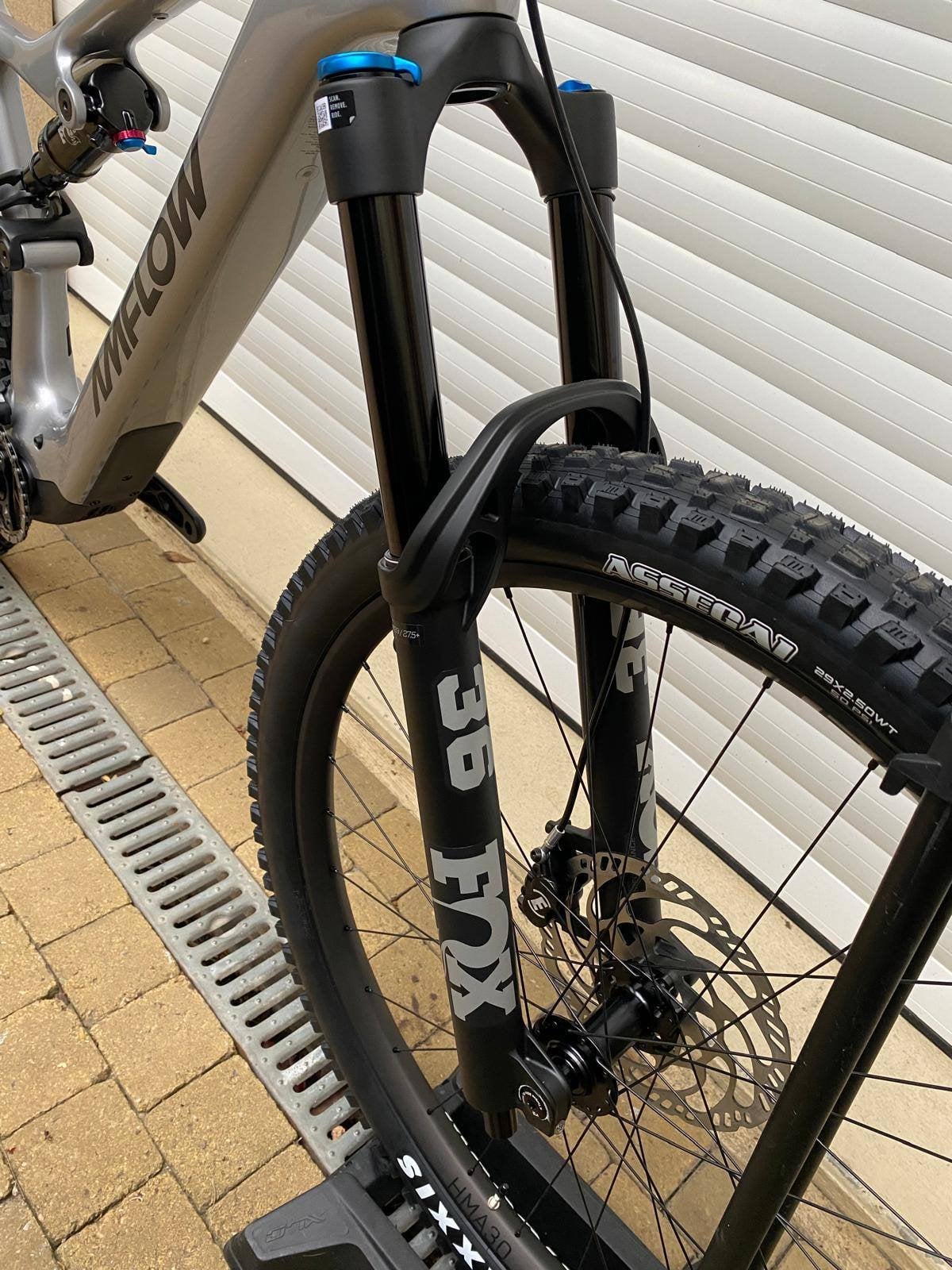

Amflow delivered now with T-Type 70 and new Fox Performance 36 :love:
499873977_10229302610291035_6096883504999454573_n.jpg 499929209_10229302610851049_5972745306700677968_n.jpg

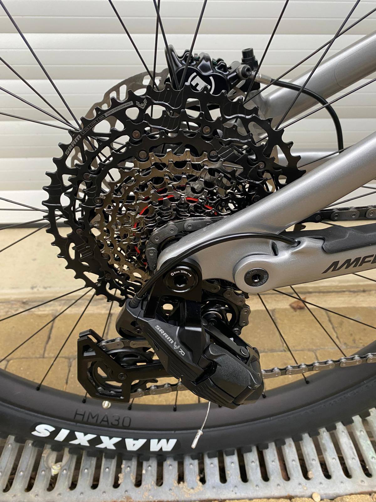

Niiiice! What else changed? Stem? Is the hub XD drive now?

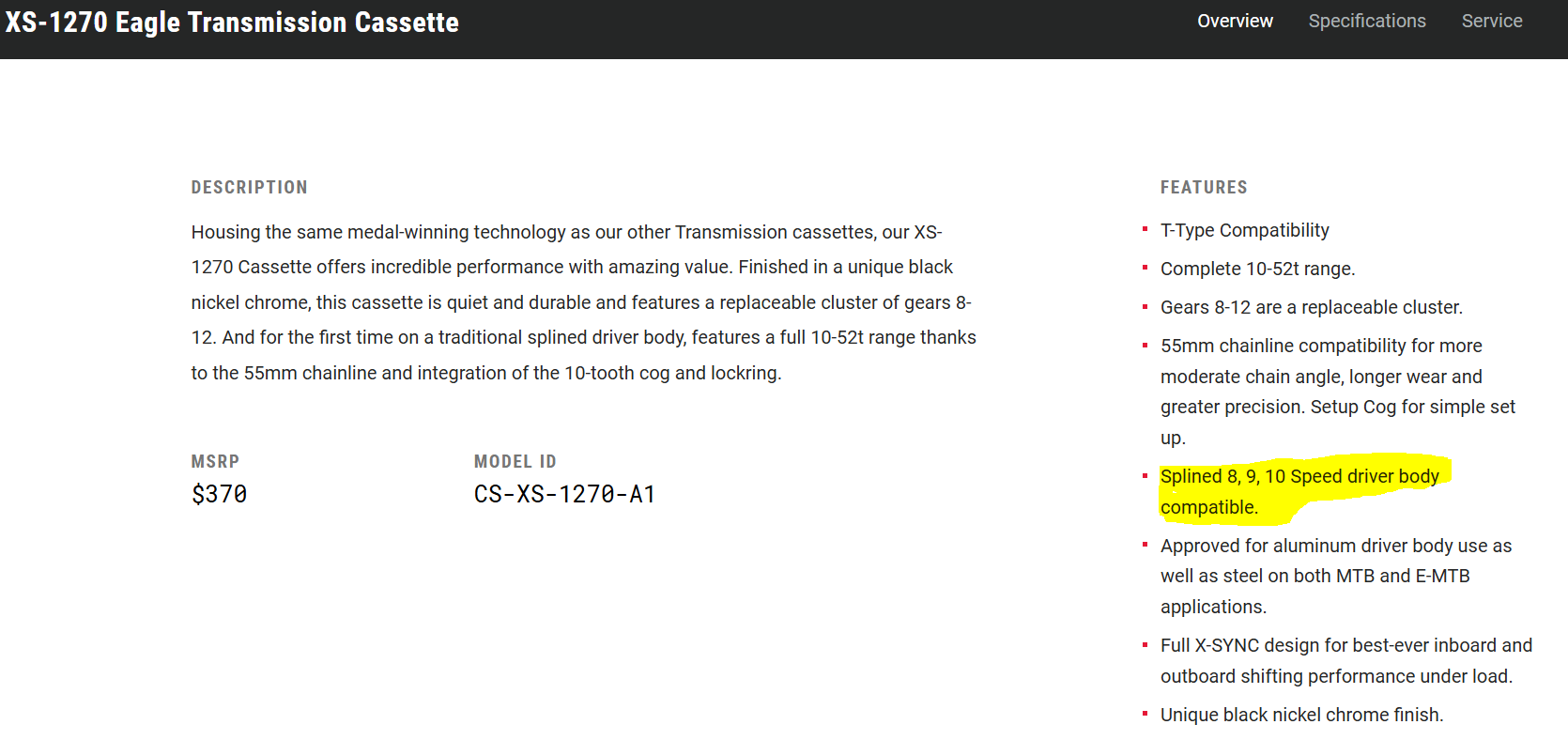

He won't know unless he removes the cassette. But I can see from the photo it is a XS 1270 Cassette which from the SRAM website I can see it is HG Hubbed.
I have looked at this cassette as a future cost effective replacement for my XO cassette. But unless I change hub. I cannot use it, so I'll probably just use the GX cassette.

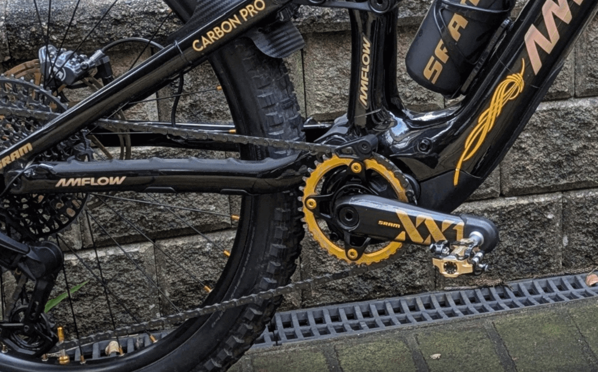

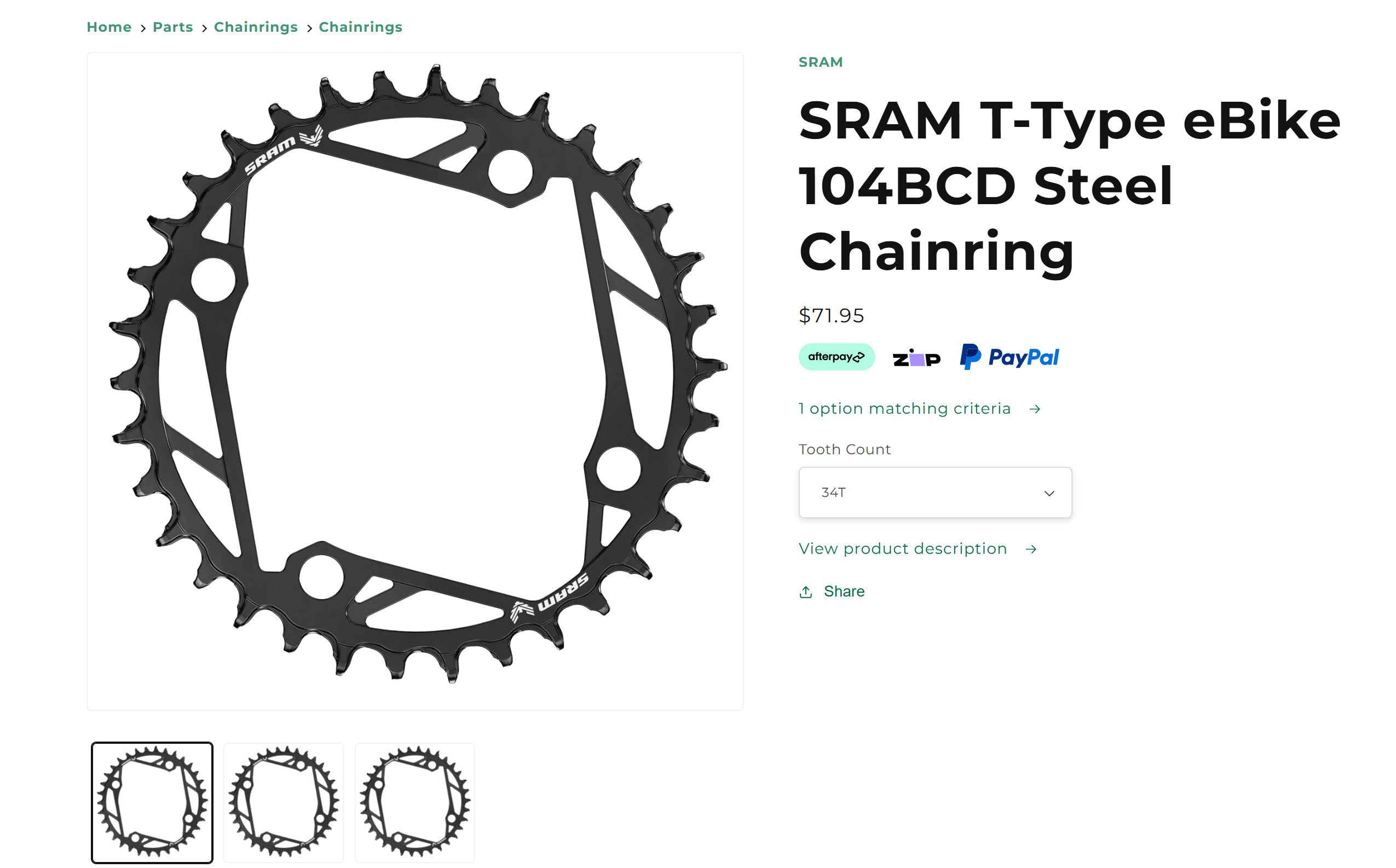

Dobrý deň Hello. I have an Amflow PL, I would like to upgrade to Sram Axs Transmission. Do I also need to change the chainring and which one?
I'm running a standard alloy 12 speed chainring on my PL Carbon Pro with the T-Type chain. The fit looked perfect and I've put 200km on this chainring. It has performed perfectly.
Qbviously SRAM will recommend their own chainring, which I removed. This is it here.
Alloy chainrings gets chewed pretty quickly on ebikes, especially on a high power/torque motors like Amflow definitely is ...
Hasn't been the case with this chainring. Put about 600km on it on my Shimano EP801 which is 85Nm. Then 200km on the Amflow. Apart from a bit of paint loss on the teeth. It still looks in as new condition.
And at AUD$10 a chainring which is about 6€. If I get 2000km from it. I'll be very happy.
That said. I keep my chain in perfect condition and cleanly waxed after every ride.
