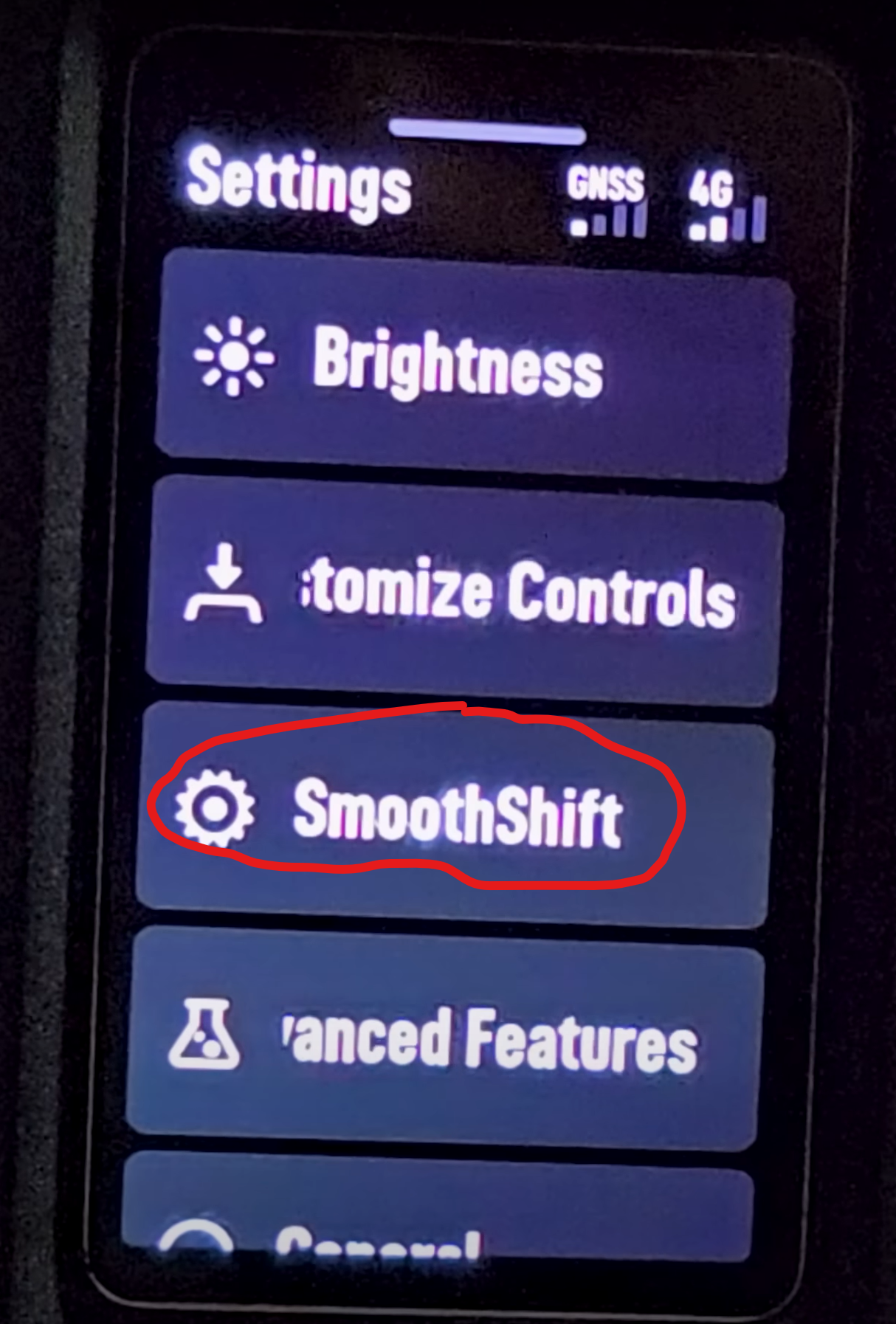

Stupid question but where do I activate AutoShift? Been looking up & down the app but no luck..

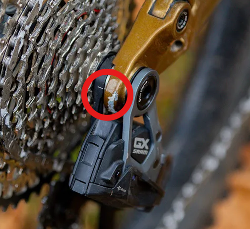

Also i have 2 gears that jump under high pressure - any settings I can change to improve this?
It's just Smoothshift and it's in the bikes touchscreen, when you swipe up from the home page. And it's more like a coast shift. So you index the gears up or down, and the motor spools the chainwheel without you having to pedal, so it automatically lifts the chain up or down on the cassette.
In Advanced Features. I also have chain protection turned on. This just dips the motor power when you shift. I had this on my Bafang Motor. And it really does help protect both the chain and cassette, when you shift under full power, which I sometimes do when climbing, or powering out of a corner.
In the SRAM AXS App, try adjusting the microshift setting. It should be on the default setting of 7. Try going 2 numbers up. Test it. Then try going 2 numbers down. Test that.
Also check your derailleur hasn't been bumped back. There are 2 lines on the derailleur connection to the frame. They should be perfectly in line with each other. My derailleur got bumped back and wasn't shifting as perfectly. I just pushed it back and shifting was perfect again.

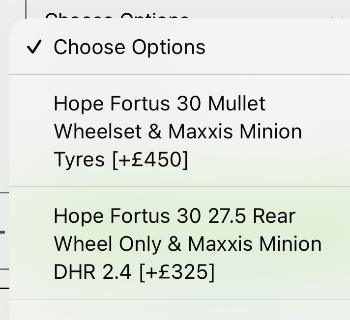

Mtb monster offering these wheel upgrades … I want to mullet it just not sure on this wheelset ..
I’ve been looking at this, but wondered if the bike came with the 29er wheelset and tyres as well? Was going to drop them an email as I’m likely to order one shortly from them. Unless someone is aware of an actual dealer somewhere between Brum and Bristol
As far as I’m aware with the short email exchange I’ve had with them, they would keep the original wheelset … so I’m guessing it’s an upgrade deal on the new wheels…
Thanks, I’ll pass on that then. I’m not bothered on the hope wheels enough. So I’ll just buy a different set or find somewhere that will do a deal
Going 2 down to 5 has done the trick, thanks a lot!! Man, this SRAM AXS setup is a serious game changer — smooth, precise, and totally dialed in.
