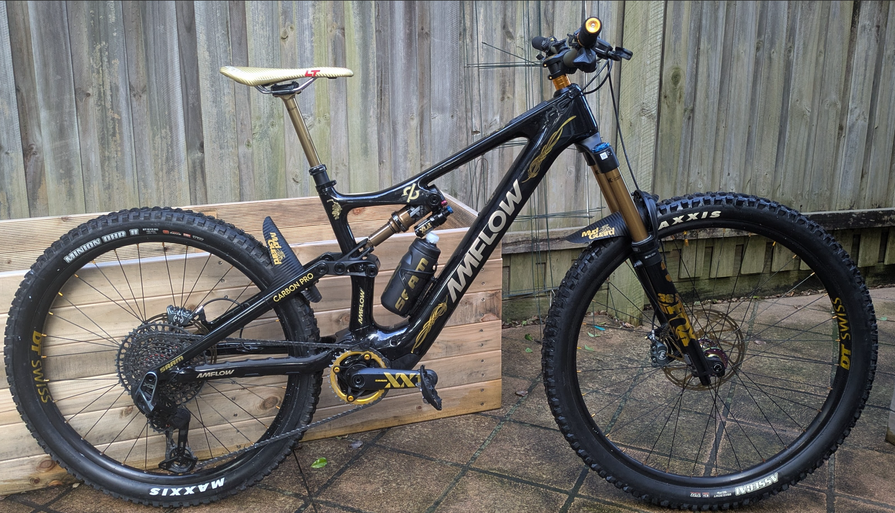

Clocked up 200km on the Amflow PL Carbon Pro today.
I went for a ride with my mates today, and I guess I'd kind of got used to how much faster I ride with the Amflow. It doesn't feel that different anymore. But having to wait 5 mins for my mates to catch me at each of the checkpoints, when I only waited about 30 seconds when riding the Merida E160, made me realise I've just adapted to the extra pace. It really is quite incredible.
The bike and motor has performed flawlessly. I did need to micro tune the XO Derailleur after fitting the 27.5 rear wheel that I built myself. Only 2 increments. From 7 to 5. I also have had to re-tension the spokes. But I'm loving the extra grip of the 2.6 DHR2.
I haven't scratched the bike yet, though I do have the invisiframe on it.
I have been trying to dial in the suspension. Trying to make it as plush as possible at the top end, then firmer at the bottom end. I'm fairly happy with the current tune, but I am going through most of the travel every ride.
The motor has been super quiet both up and downhill compared to my EP801 on the Merida.
I did change the gear shifter from the buttons to the rocker. It's so much better. And the Magura MT7s are just superb, enabling me to fully convert to single finger braking with supreme confidence.
So far. Extremely happy.
This is a photo from today after cleaning the bike after a ride. It still looks as good as new.
