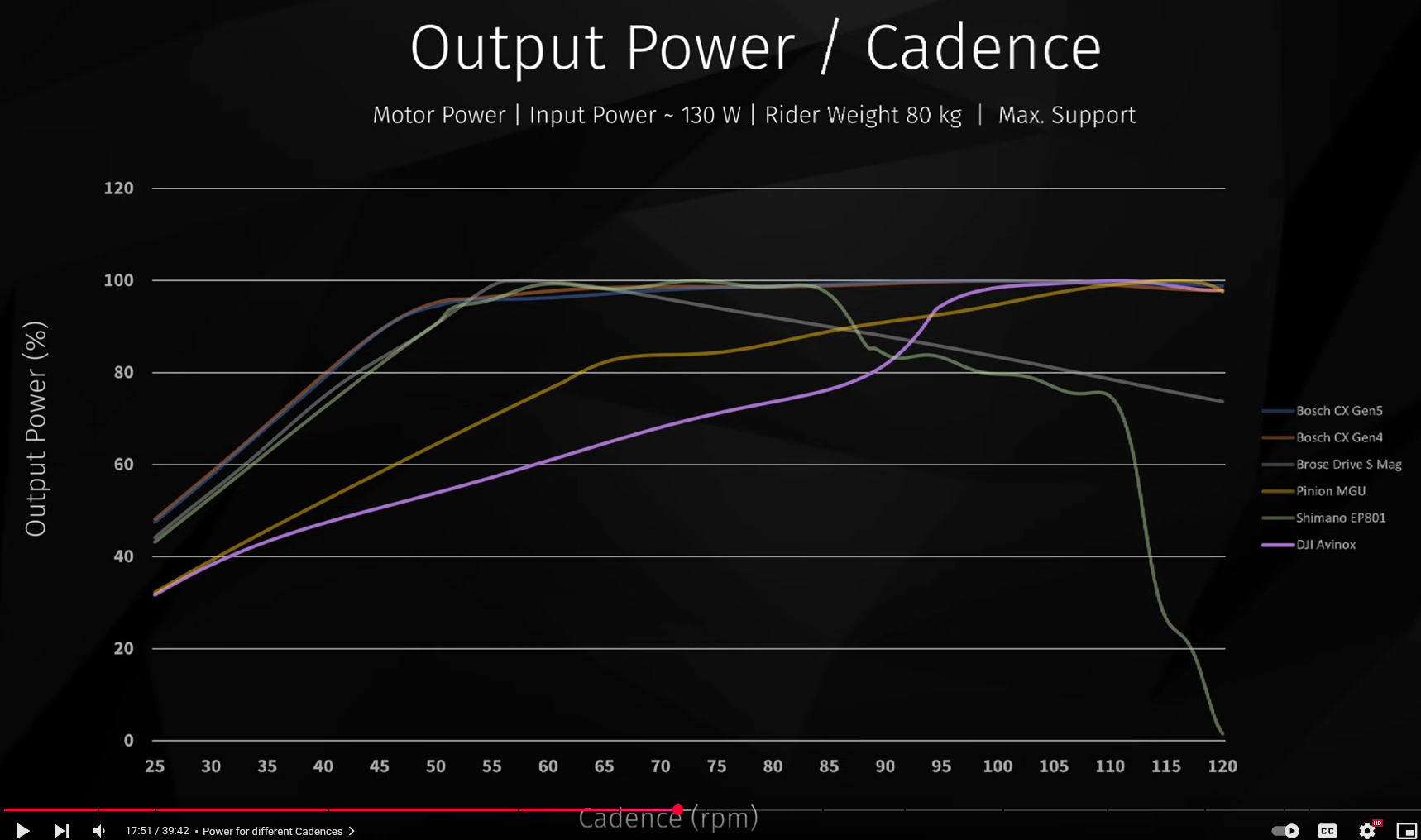

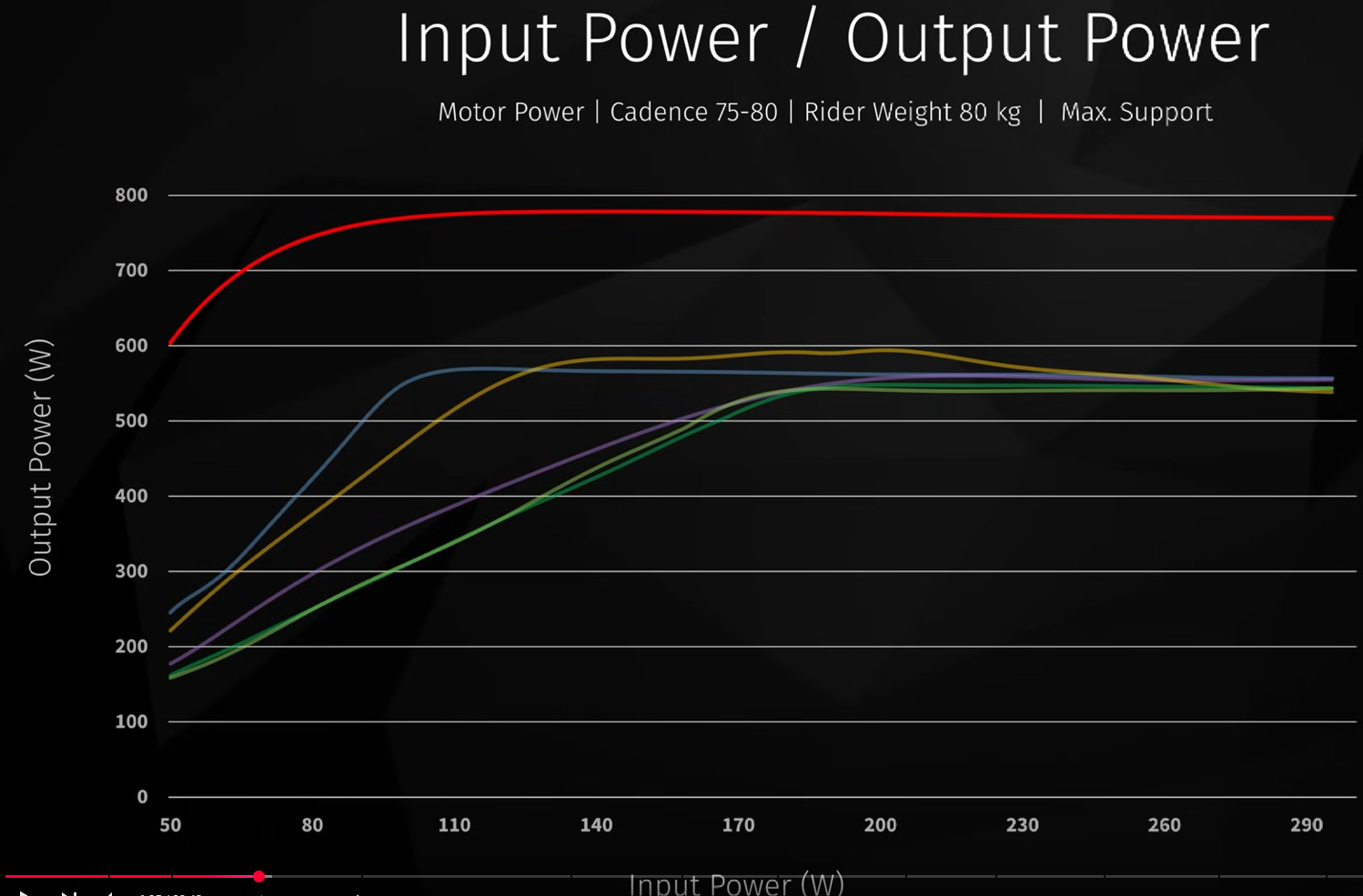

There's a channel called velomotin that does detailed motor tests, these are the results from a while ago, I think the firmware etc has gone through many iterations so could be different but they have a dyno.
You can see the motor behaviour is very differnet, in turbo all the power is at a lower input power
The avinox/bosch/specalized let you fine tune motor assitance so I wouldnt worry about that

I've been interested in the Avinox since it came out. Before buying my bike, I read and watched a lot of materials about them, but I couldn't find a reliable comparison of these two motors on various types of terrain. The only video showing a comparison of five motors on a steep climb in the forest was a video from Pinkbike, but it had a very short segment devoted to the topic.
What struck me was the presenter's opinion, which claimed that the Avinox was difficult to control and less predictable, which is why the Bosch received higher ratings for climbs. Here's a link to the video for those who don't believe me: https://www.pinkbike.com/news/5-emtb-motors-review-bosch-dji-shimano-sram-specialized-2025.html
And it may seem like a miracle to you, but I haven't been able to test this bike anywhere until now and I recently met someone who has an Avinox in my city, as proof of which I can also send photos of my bike and his if it is to substantiate my thesis, which can be verified by testing both engines which you probably haven't done :) That why I chose to describe me personal feelings after test.
I specifically tested the system based on my needs and the terrain I ride on, so that anyone wondering what the differences are between these bikes would have a point of reference and could try them both out for themselves before purchasing.
Mate ....... You are talking to Avinox owners. So we know exactly how the Avinox system performs. So ...... Give it a rest, bro.
This is further proof that, without comparison, it seems like an engineering marvel, but in reality, like everything else, it has its pros and cons. You have to test and compare to form an opinion. The question is, how many Avinox users have actually tested their colleagues' bikes with the Bosch CX5, not in a parking lot or fire road, but on forest technical climbs?
But when it is less steep and you have to slow and make turns in the climb. Trail is much better. You use the correct mode for the correct climb. It's not rocket science.
That was my point when i said that bosch is is incredibly refined and smooth when climbing any type of hill. Because You can have only one mode EMTB+ and it is so balanced that can give You any power You need at the right time. Avinox can't.
I would also like to know what your observations are after comparing both engines and I would be happy to hear your arguments for and against a given system.

But here's a comparison between the Avinox and Bosch CX motor on a technical climb from someone who owns both on the forum, and did it in Turbo. And it paints a completely picture to you and Alex. He finds the Avinox motor far superior in technical climing. This is because he set the EMTB up properly and has the MTB skills to regularly ride both technical up and downhill, on a more powerful EMTB. So can we put this to bed ???
"As I stated earlier 👆🏻, there’s a technical hill climb (down hill for mtb) that I was not able to quite conquer with my previous Bosch Race Crestline. (Around ten previous attempts in 1st and 2nd gear)
My FIRST attempt this morning with the RS181 I nailed it in 3rd gear!!! All the way up without taking a foot off the pedals, in Turbo mode."
Perhaps learn to ride better, then set the Avinox motor up correctly. Then you and Alex may enjoy riding a more powerful EMTB. Otherwise stick to the motors better designed for beginners. The Bosch sounds perfect for you two ...... :ROFLMAO:
It can just be personal preference ... not every motor is for everyone
I think the avinox has has a big advantage at a lower candence slowly over stuff, I dont know if its the torque or the speedsensor but I can keep moving when I would stall on other motors.
But at the same time if you are a higher cadence climber, any change in cadence/input gets amplified way more by the avinox therefore less control so you may prefer a lower power motor.
