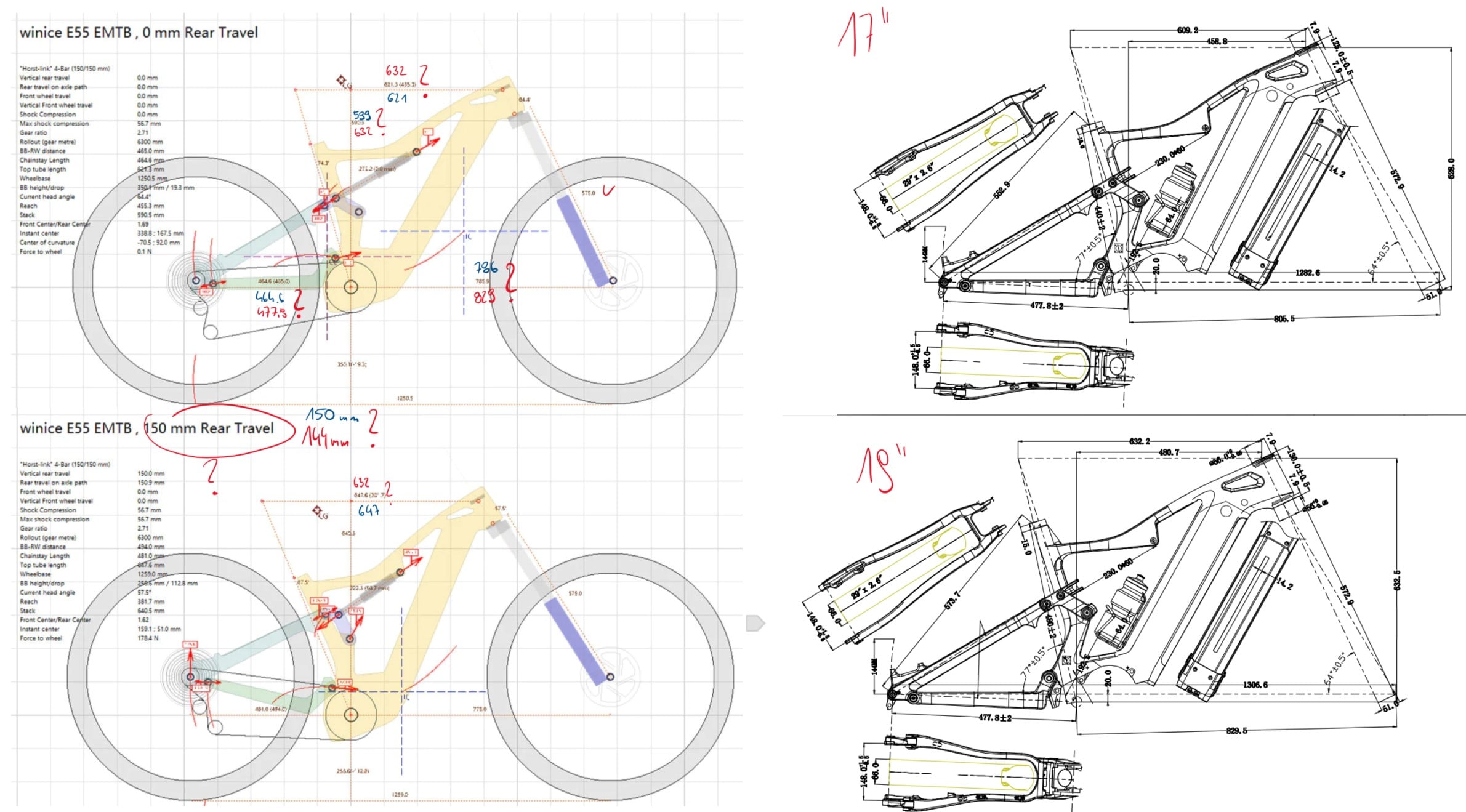

So for a custom project with this frame I am trying to figure out some stuff and maybe somebody can help me.

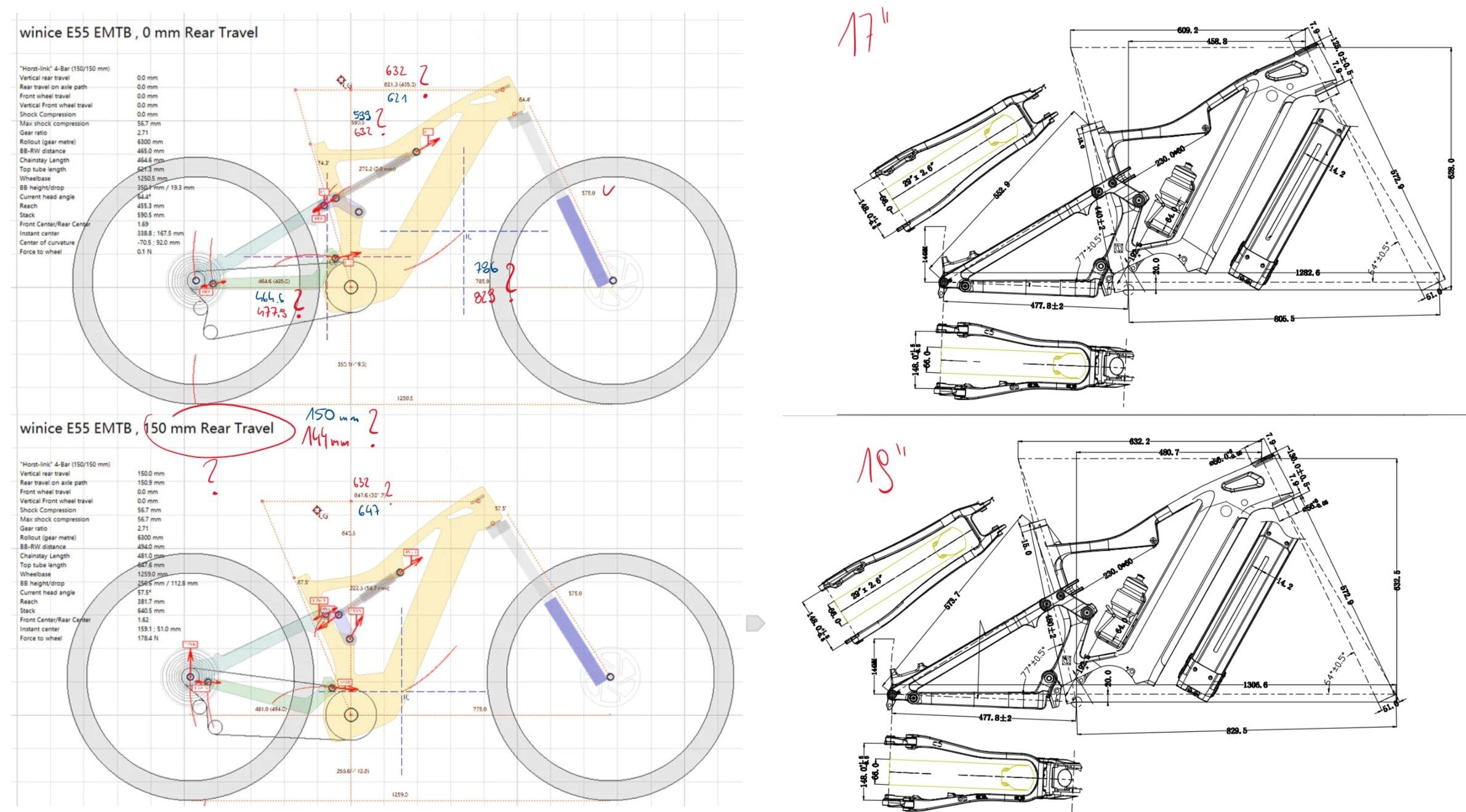

1. What is the chain stay growth at 100% travel? Dengfu posted this video, but the info is contradicting. At 0mm travel chainstay length is indicated as 461 but according to the charts it's 478
2. Need to figure out the width of the motor mounting part including the frame It self, not just in between.
I am planning to potentially have a custom motor made for this frame and it will be mounted on the outside rather than in-between i.e frame sandwiched between the outer motor plates.
Wrong video posted? :LOL: I see a 5 second video on "Estrella Crispers"
The suspension kinematics shown by Dengfu are false. The frame geometry does not match the frame drawings. It's weird that they show false information.

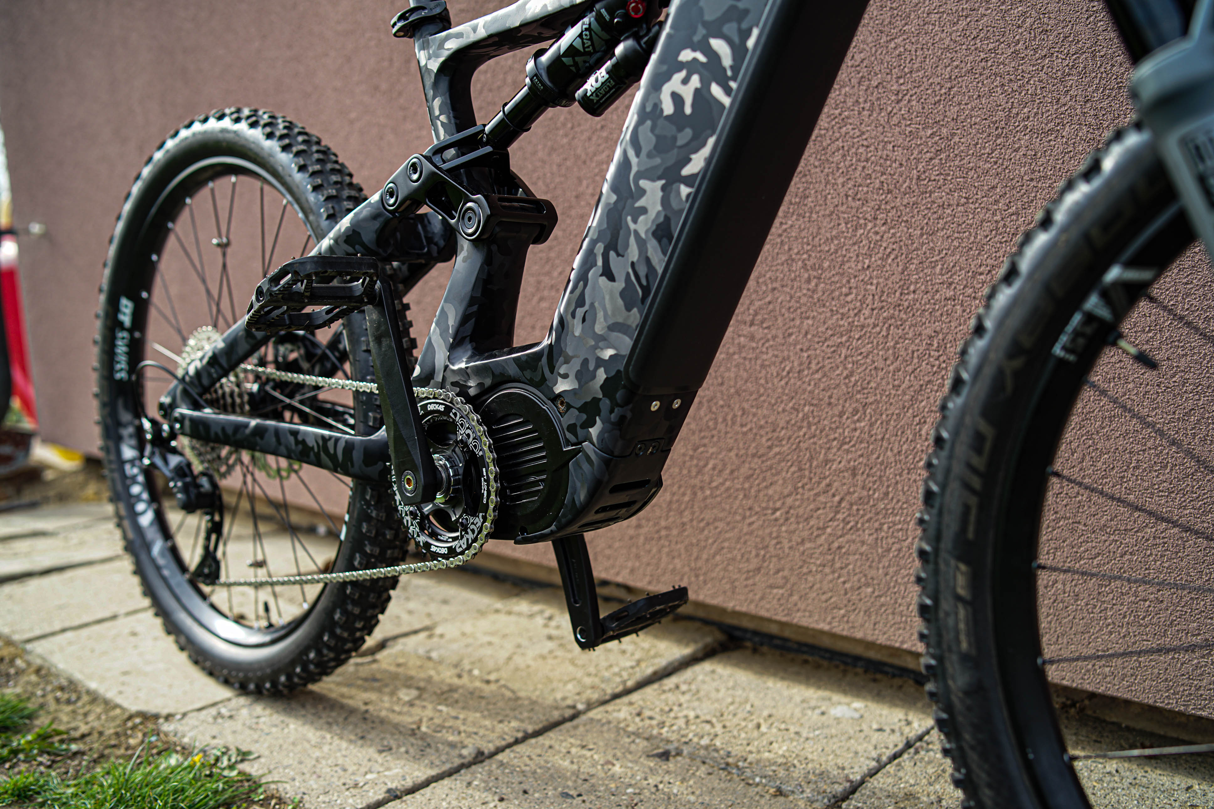

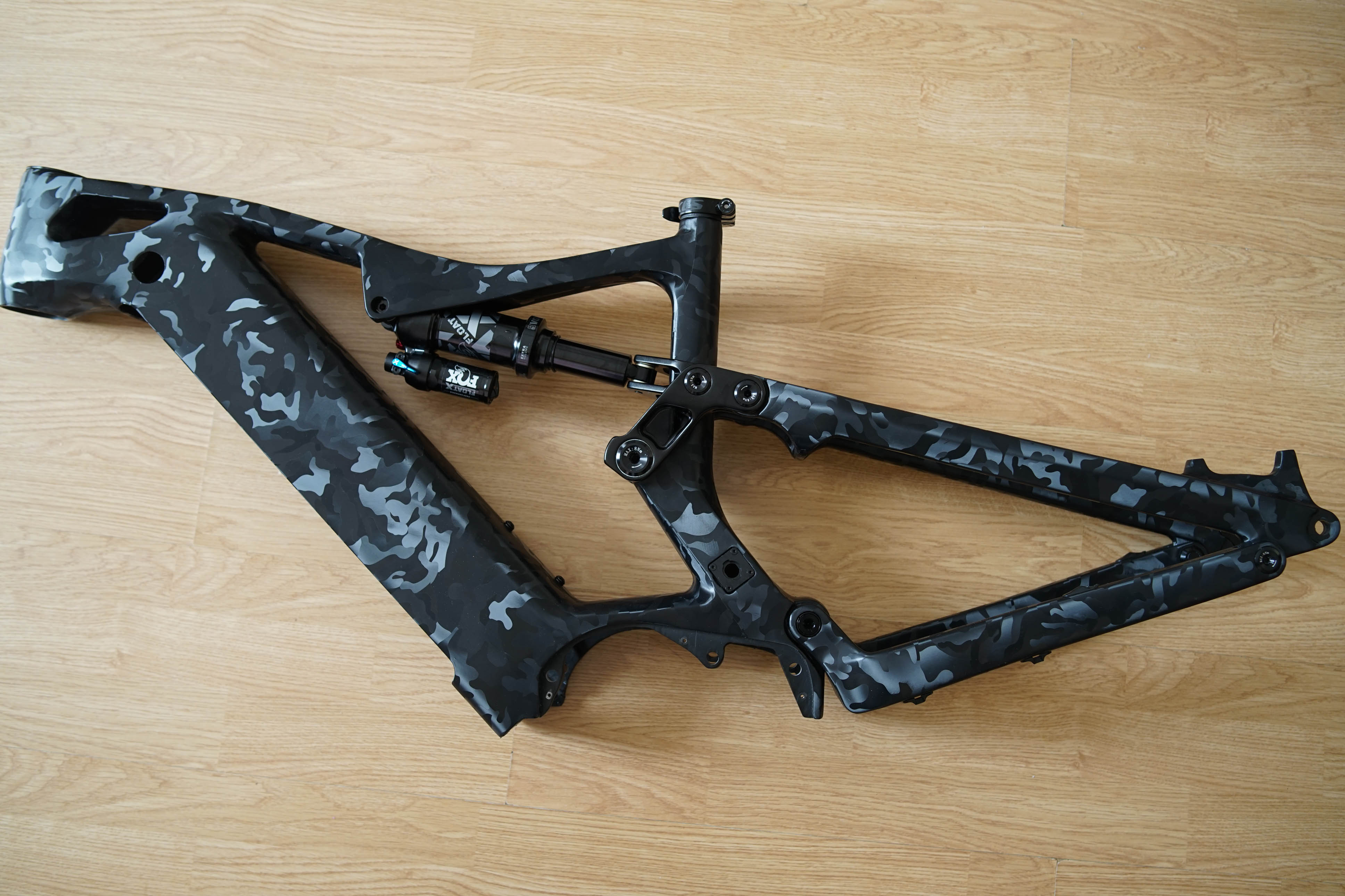

Have you assembled the frame already? Perhaps I could ask you to measure the width of the mounting brackets? You can check the previous post for more explanation
70,7mm

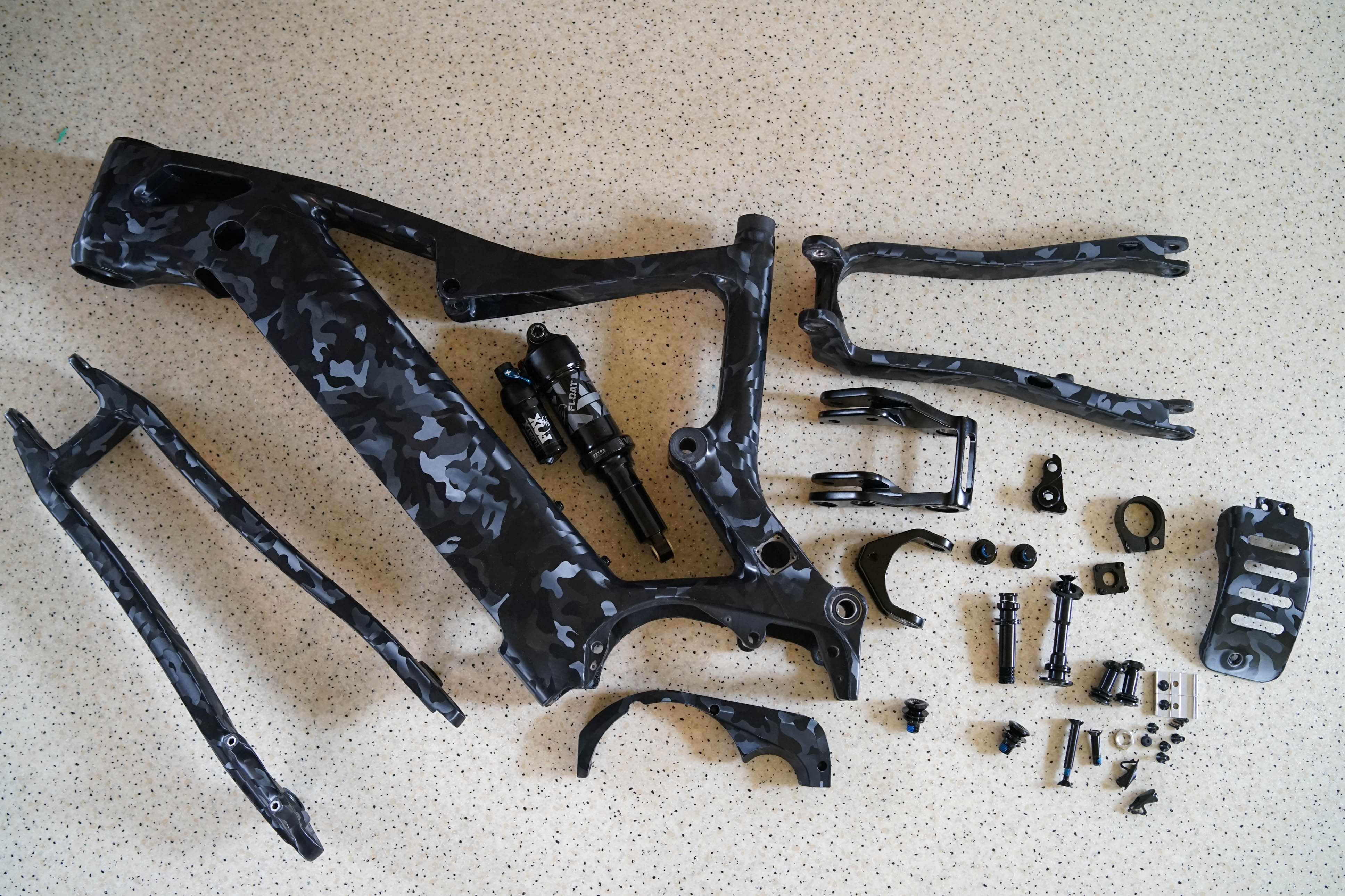

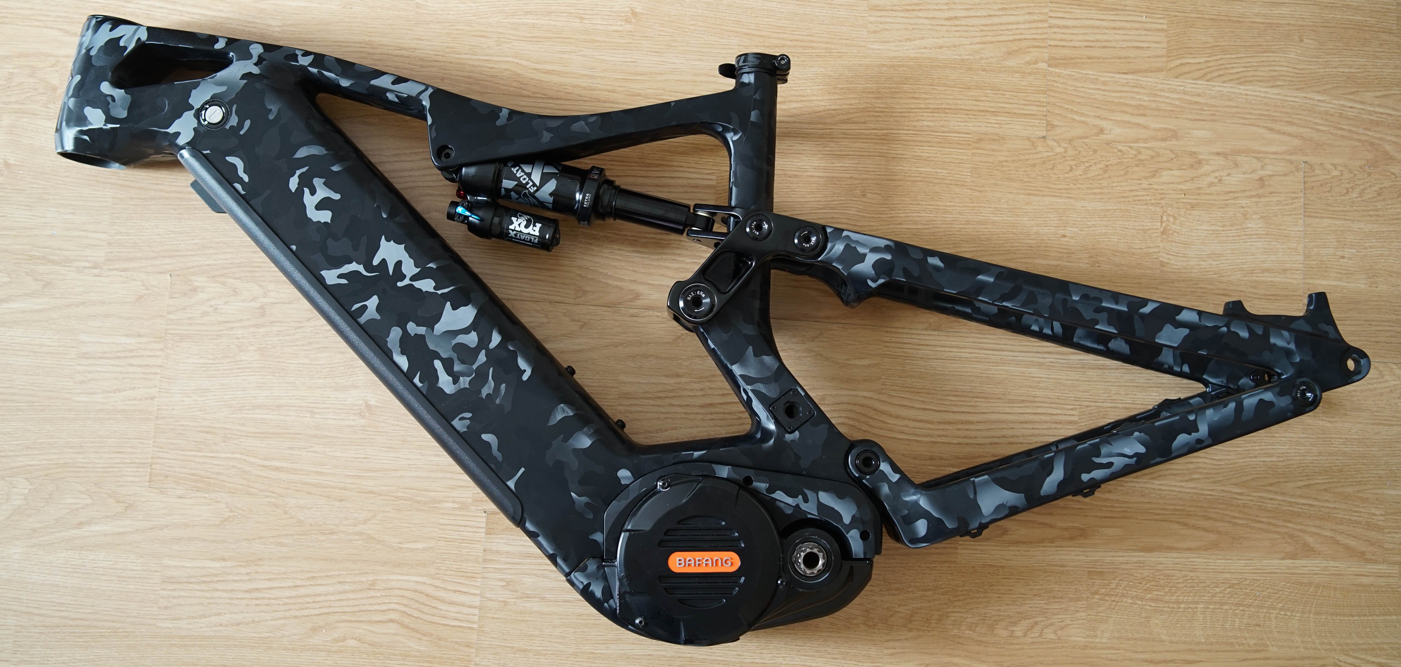

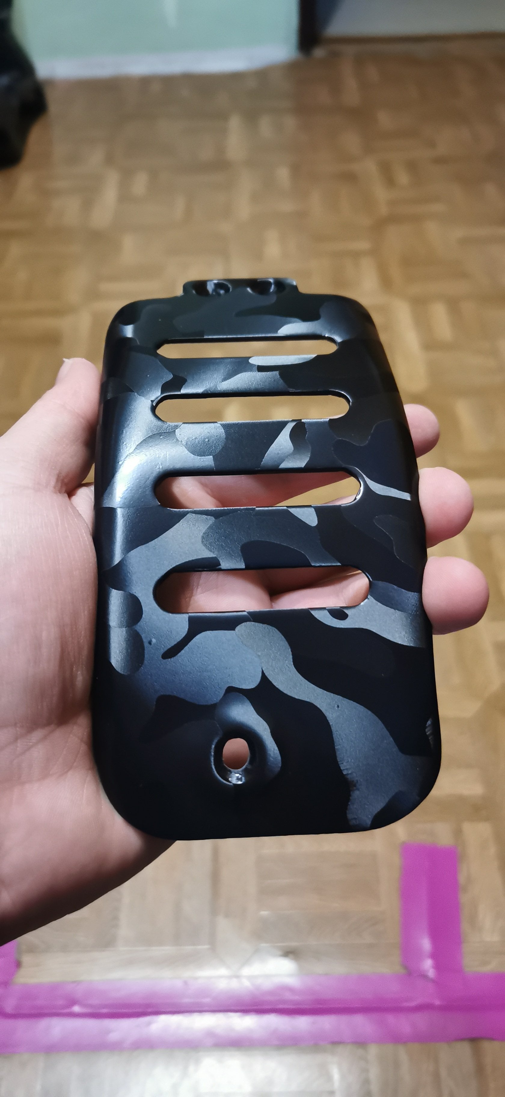

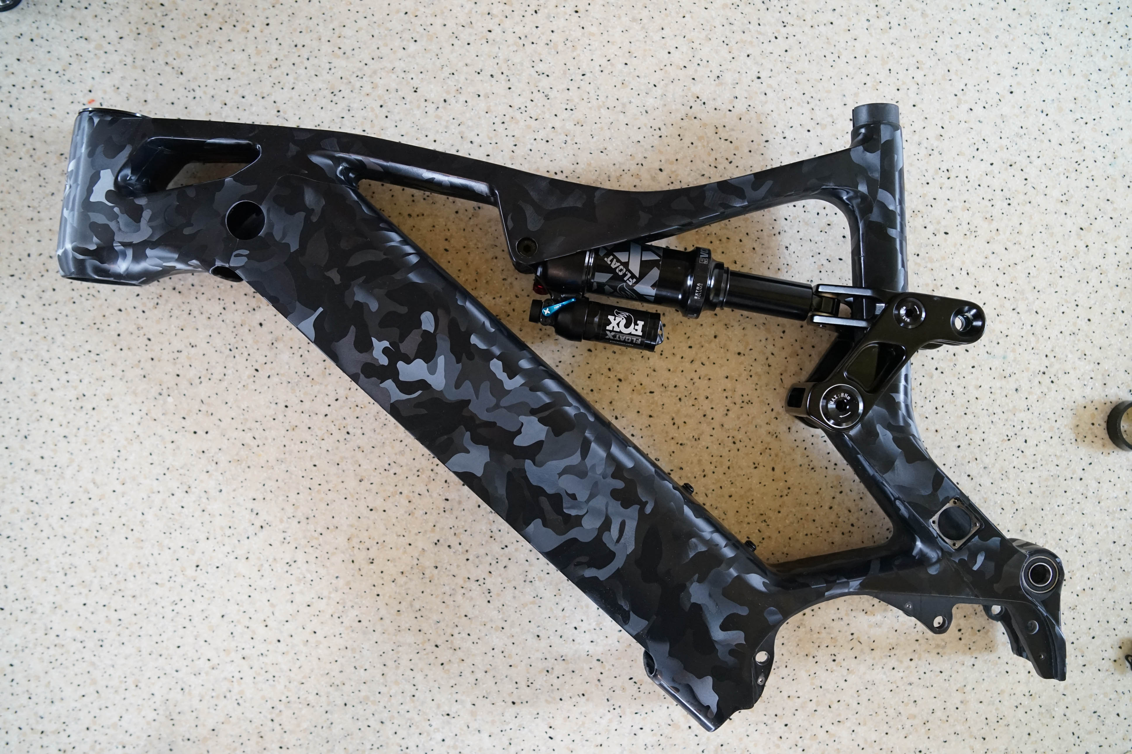

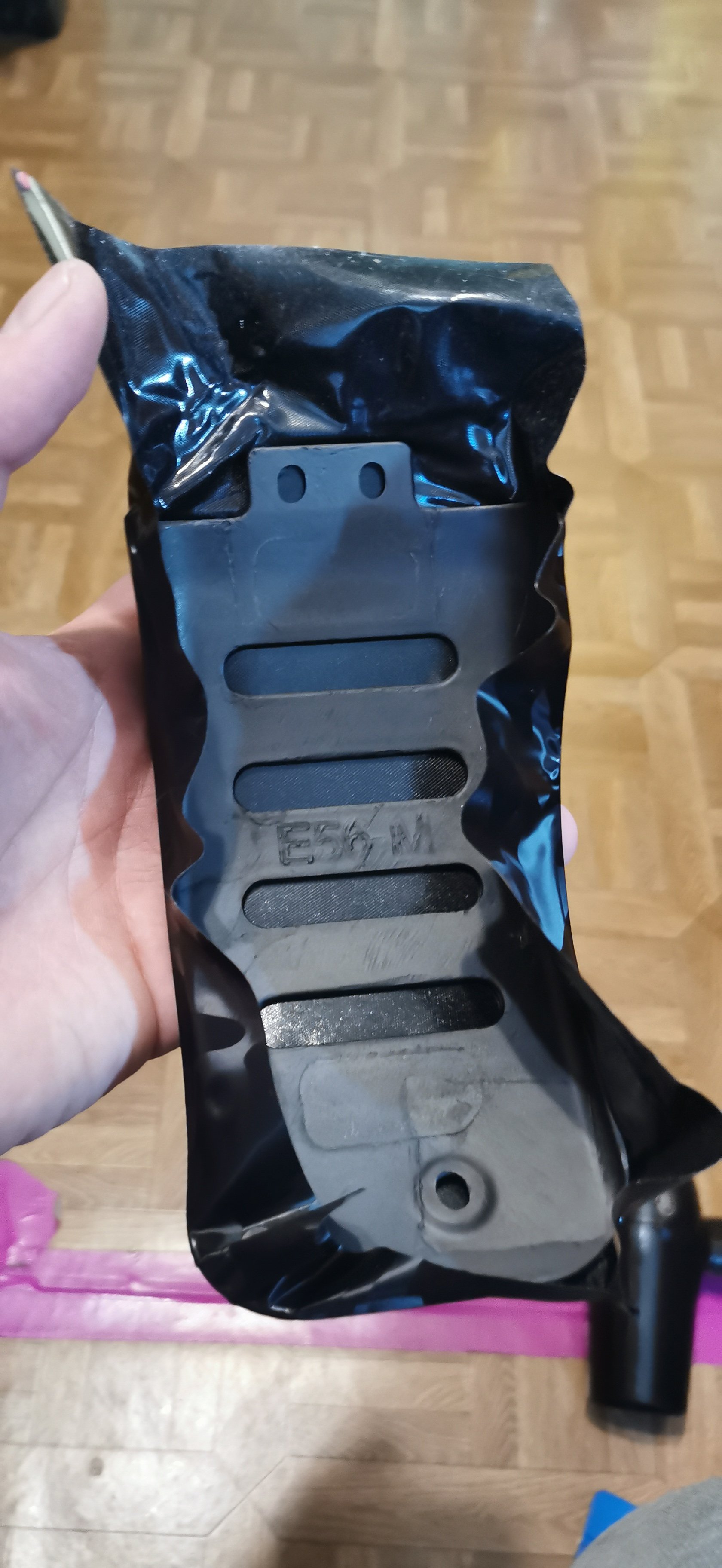

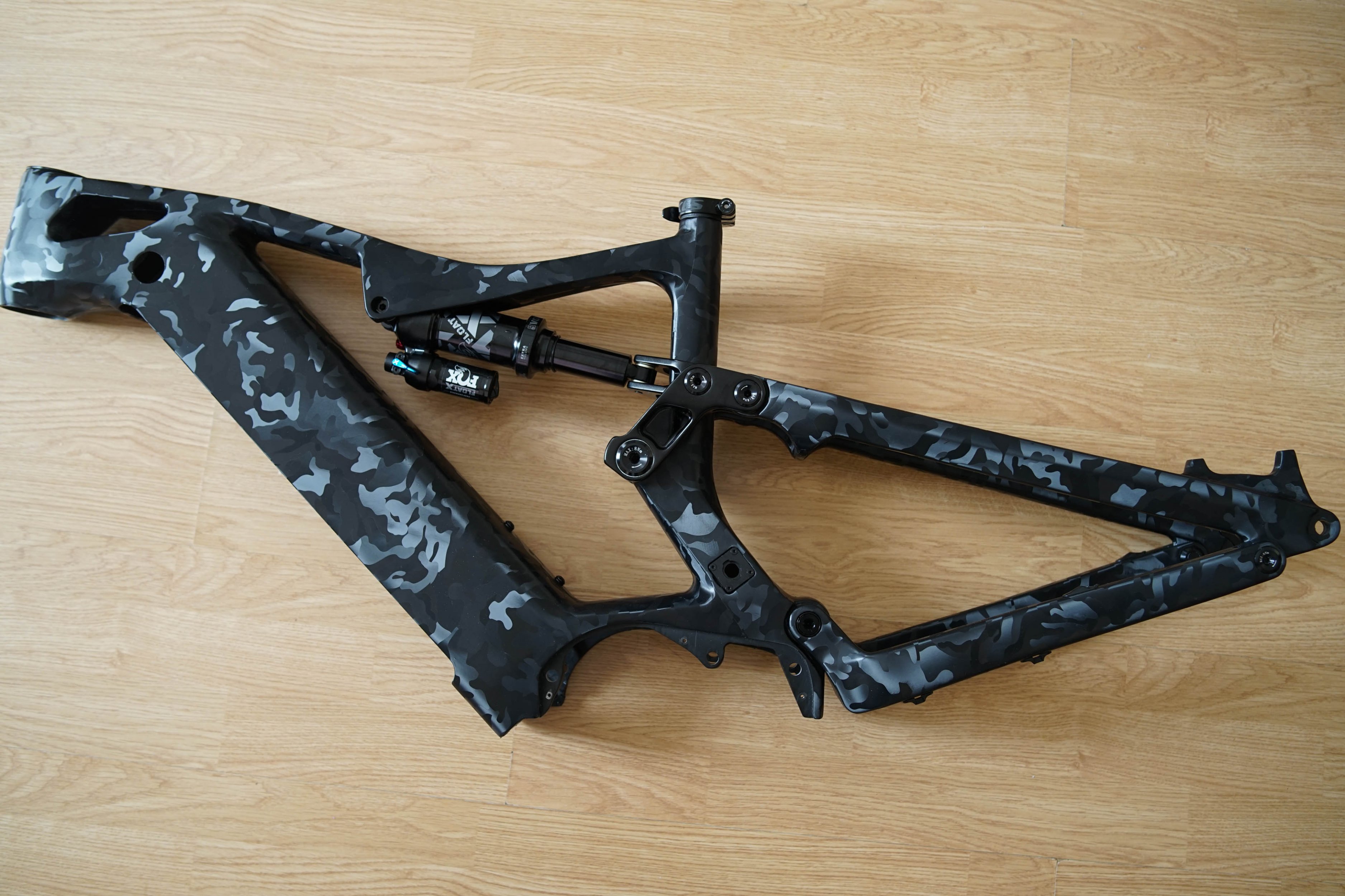

Not yet. The "UD" paint job is low quality, working on the surface finish now. The engine cover was missing, dengfu sent me I got it last week.
70,7mm
Thanks for taking the time! So 70.7 is on the distance between the external surfaces of the mounts?

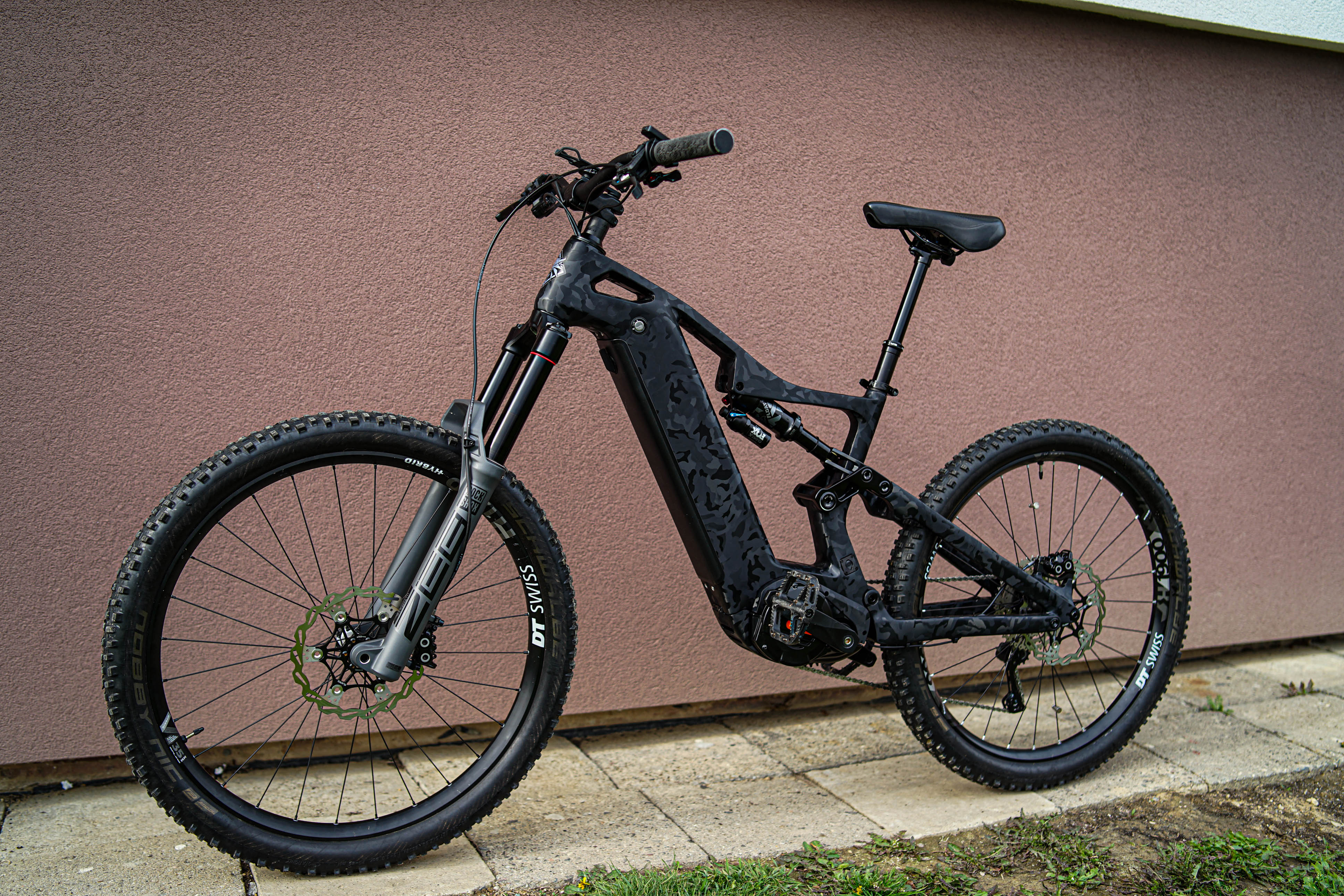

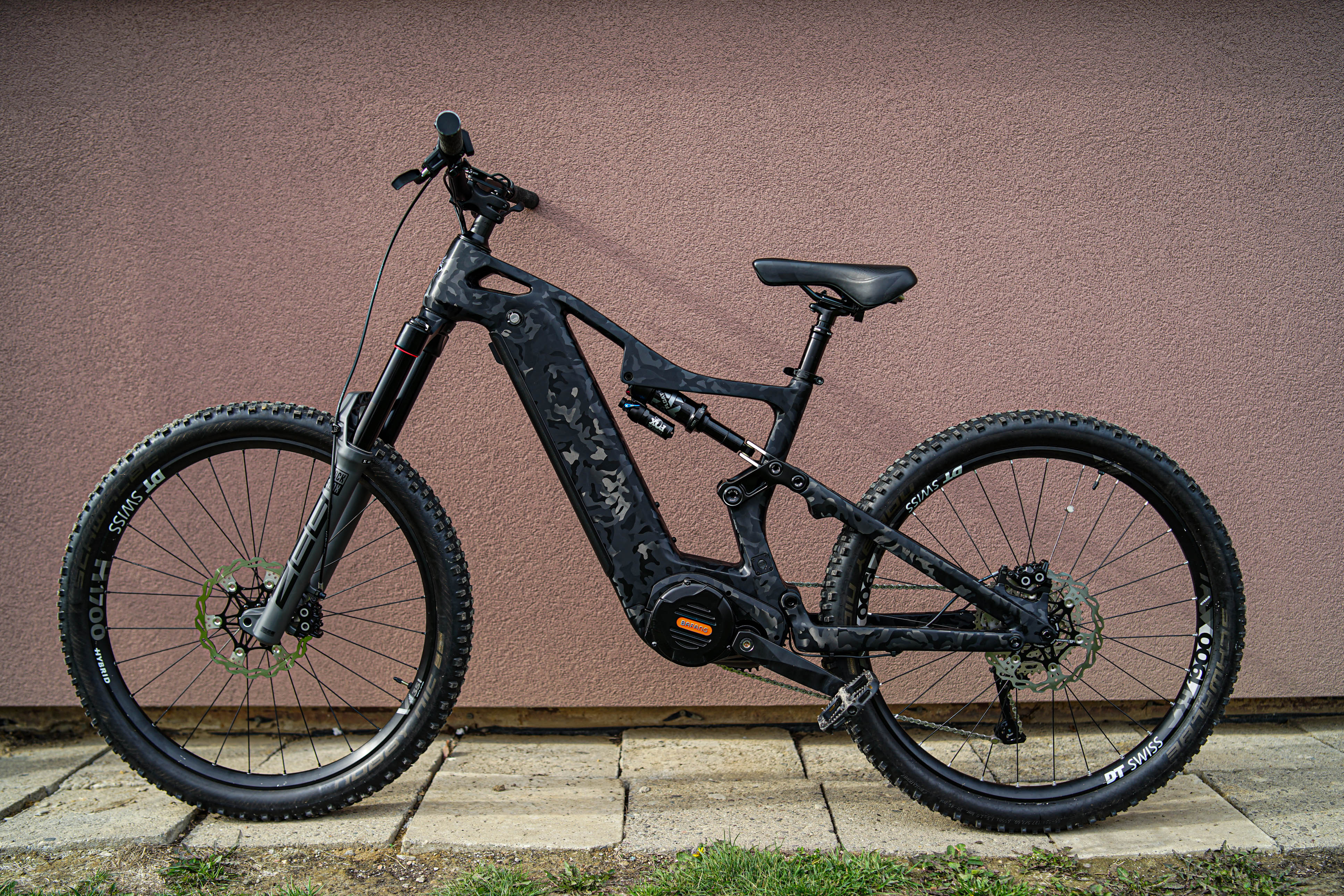

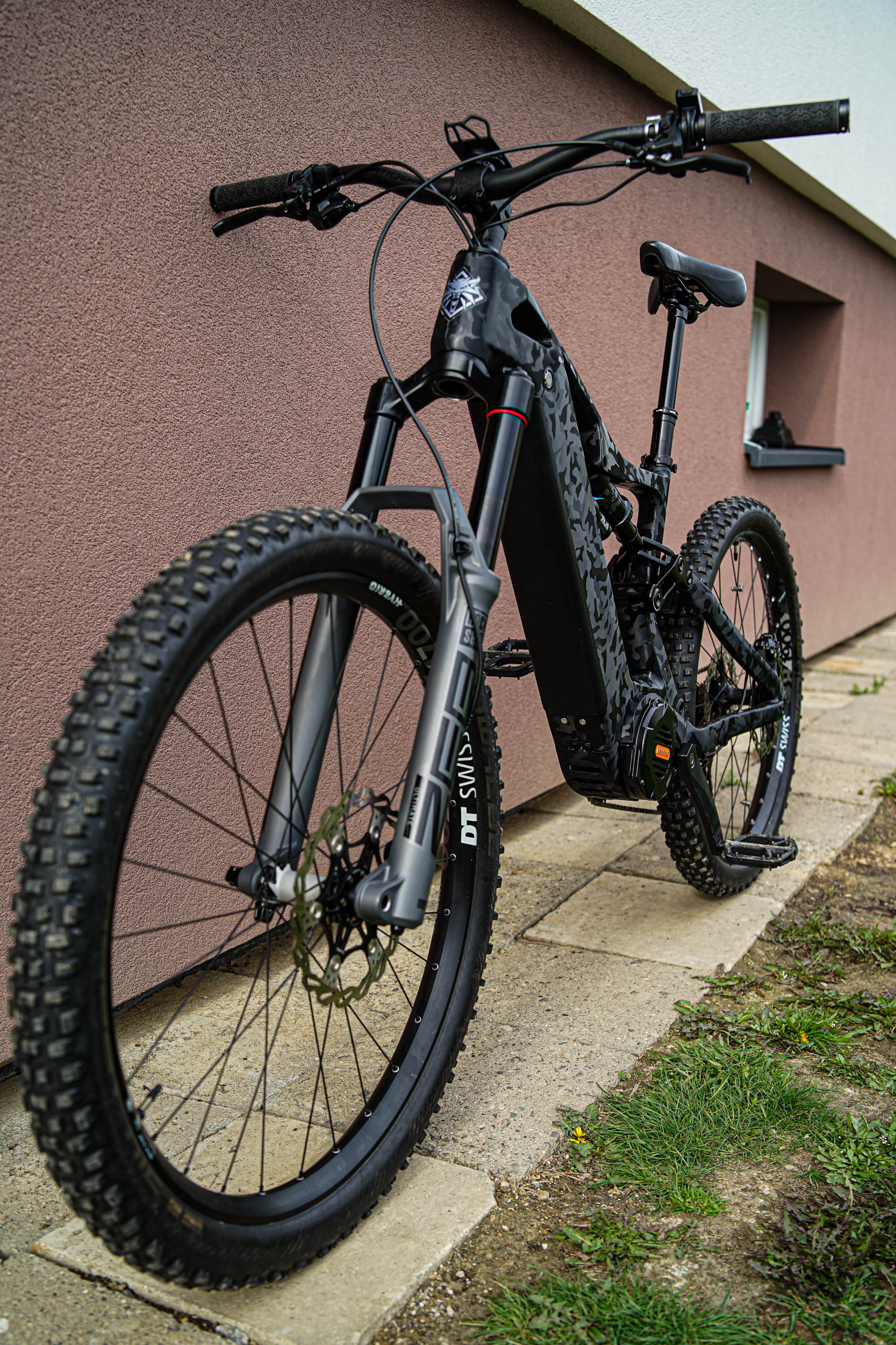

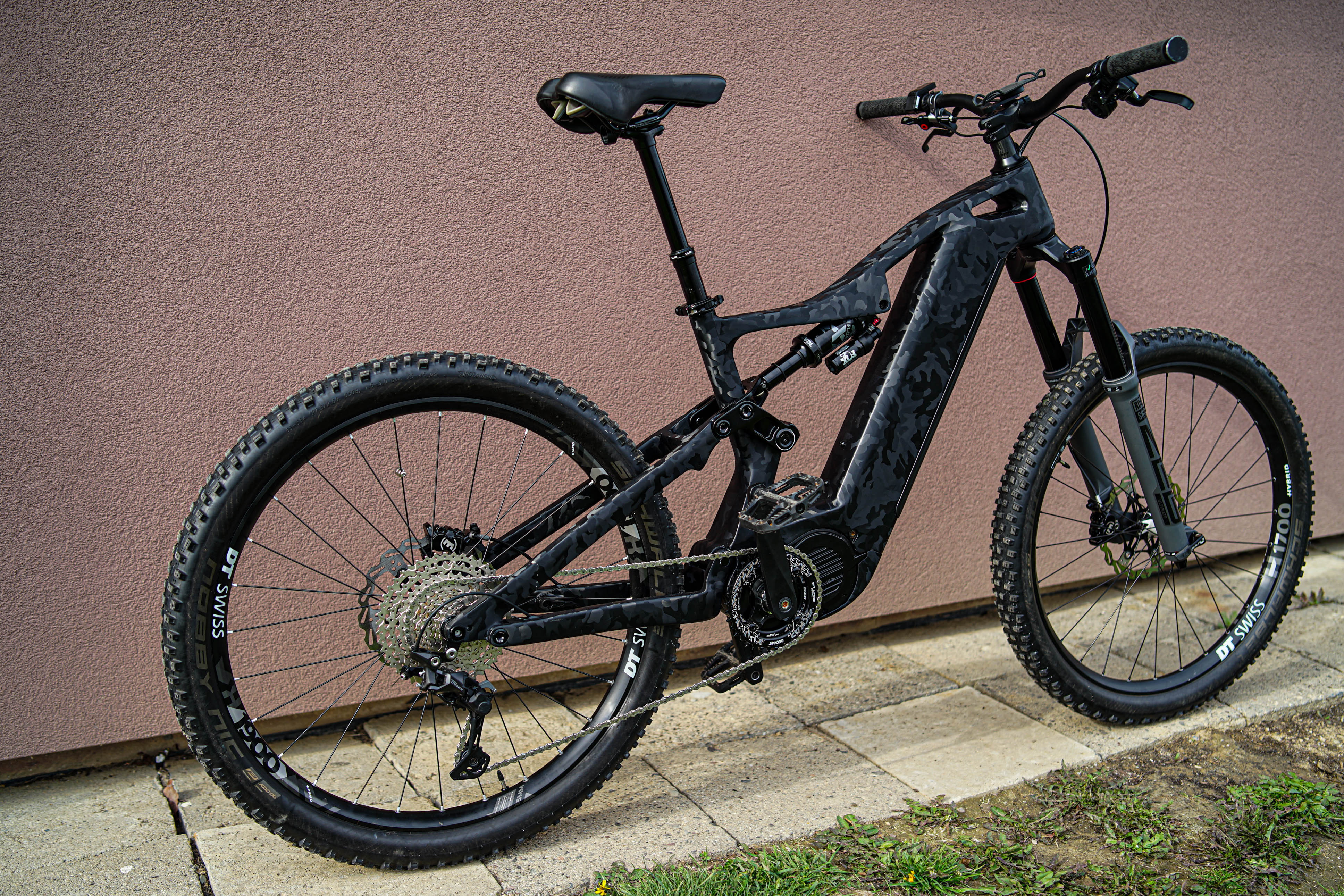

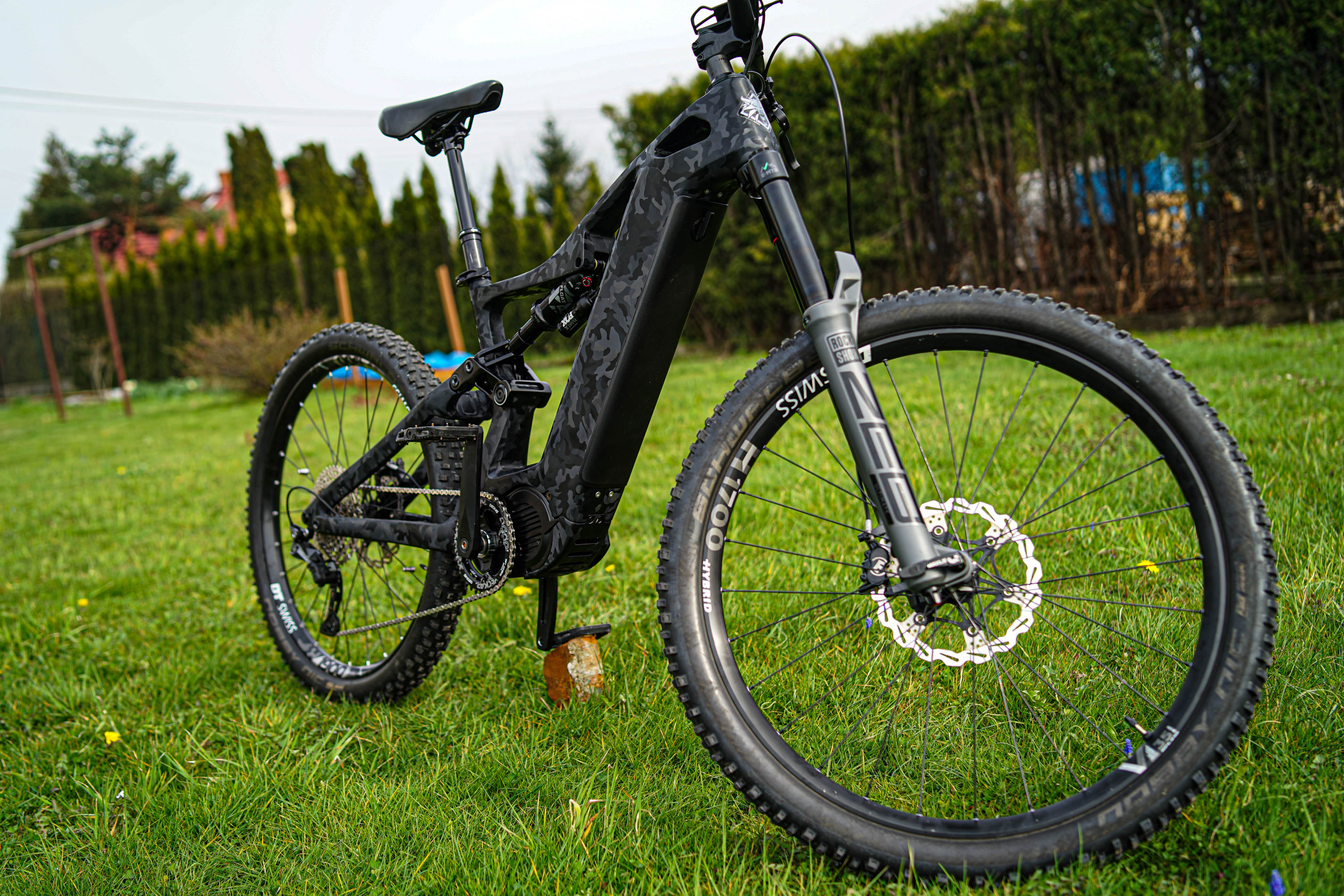

Specification:
Engine
Bafang Ultra G510 UART- 48V (52V)
Battery
14sx4p -1000Wh (LG INR21700-M50LT)
SmartBMS ANT BMS
Display
EggRider V2.0
Frame
Dengfu E55 17"
Handlebars
Dartmoor TORNADO HI 31,8
Grips
DARTMOOR Icon 145mm
Steerer
DARTMOOR TRAIL V.2 50mm/31,8mm
Headsets
ACCENT HSI-EXE
Seatpost
Kind Shock Rage-i 150mm 31.6 / 442mm DD144886
Pedals
OneUp Composite
Fork
Rock Shox Zeb Ultimate Charger 2.1 RC2
Shock
FOX performance FLOAT X 230x62,5
Brakes
MAGURA MT5
Discs
BDSNAIL Front -203mm
Wheeks
Rear - DT Swiss H1900 Front - DT Swiss H1700
Tires
Schwalbe Nobby Nic 27.5x2.6 Addix
Derailler
SHIMANO RD-M5120 SGS MTB 10/11S
Shifter
Shimano Deore M6000 - 10sp
Chain
KMC e10
Cassette
Sunrace 11-46T
Chainring
Deckas 38/32T

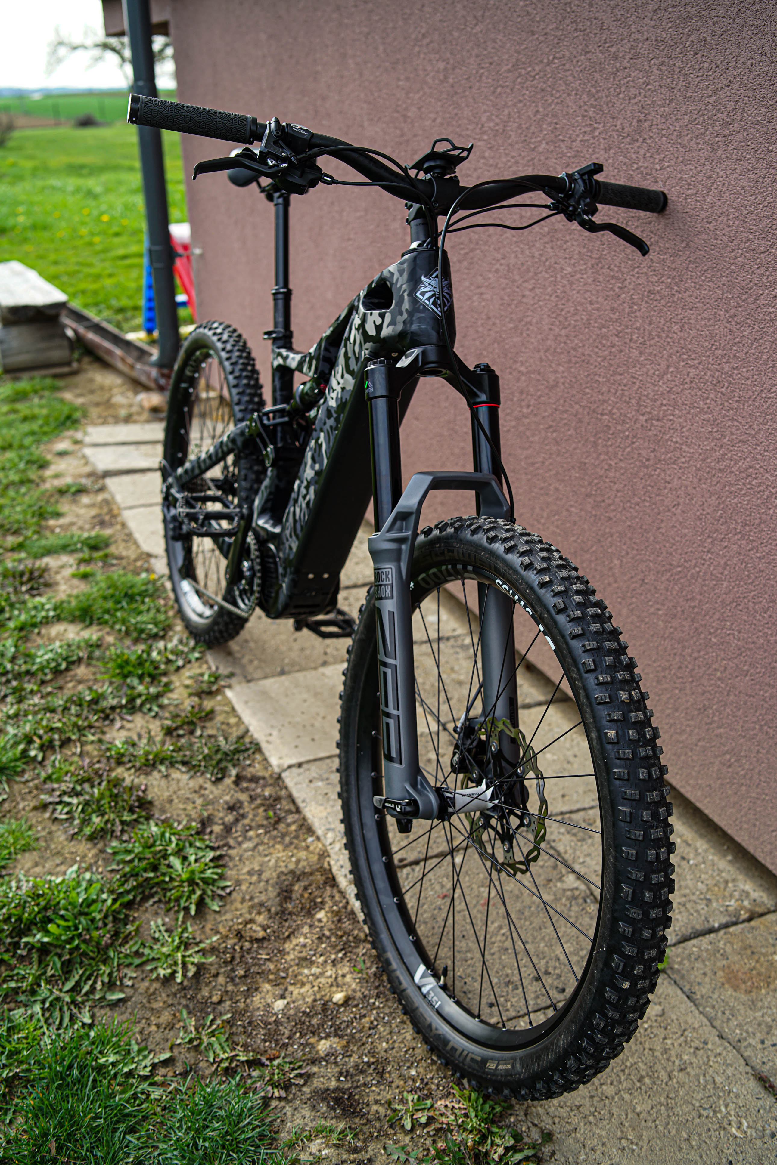

DSC00683.jpg DSC00685.jpg DSC00691.jpg DSC00692.jpg DSC00694.jpg DSC00695.jpg DSC00699.jpg DSC00703.jpg DSC00708.jpg DSC00712.jpg DSC00716.jpg DSC00723.jpg DSC00727.jpg DSC00729.jpg DSC00732.jpg

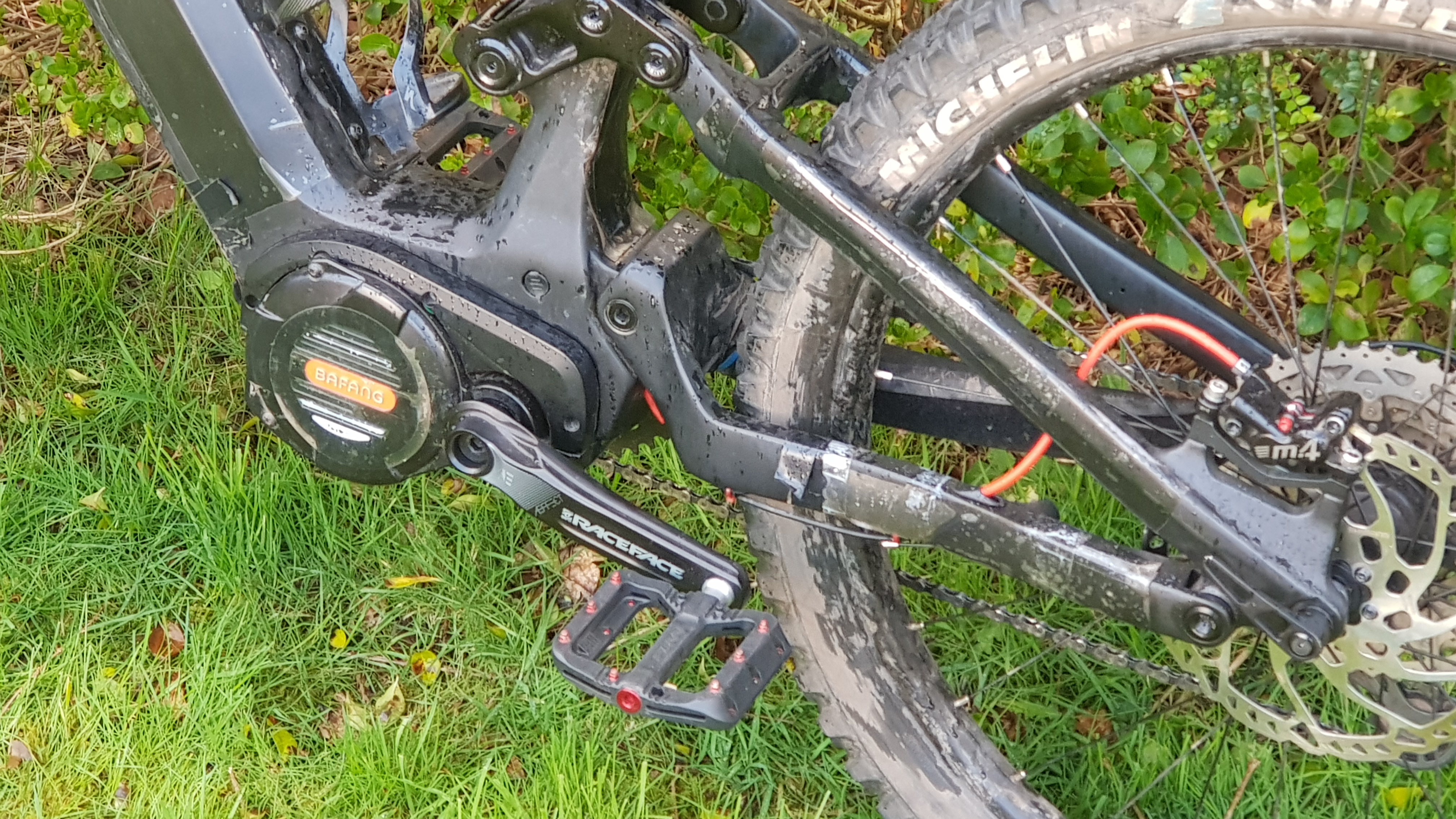

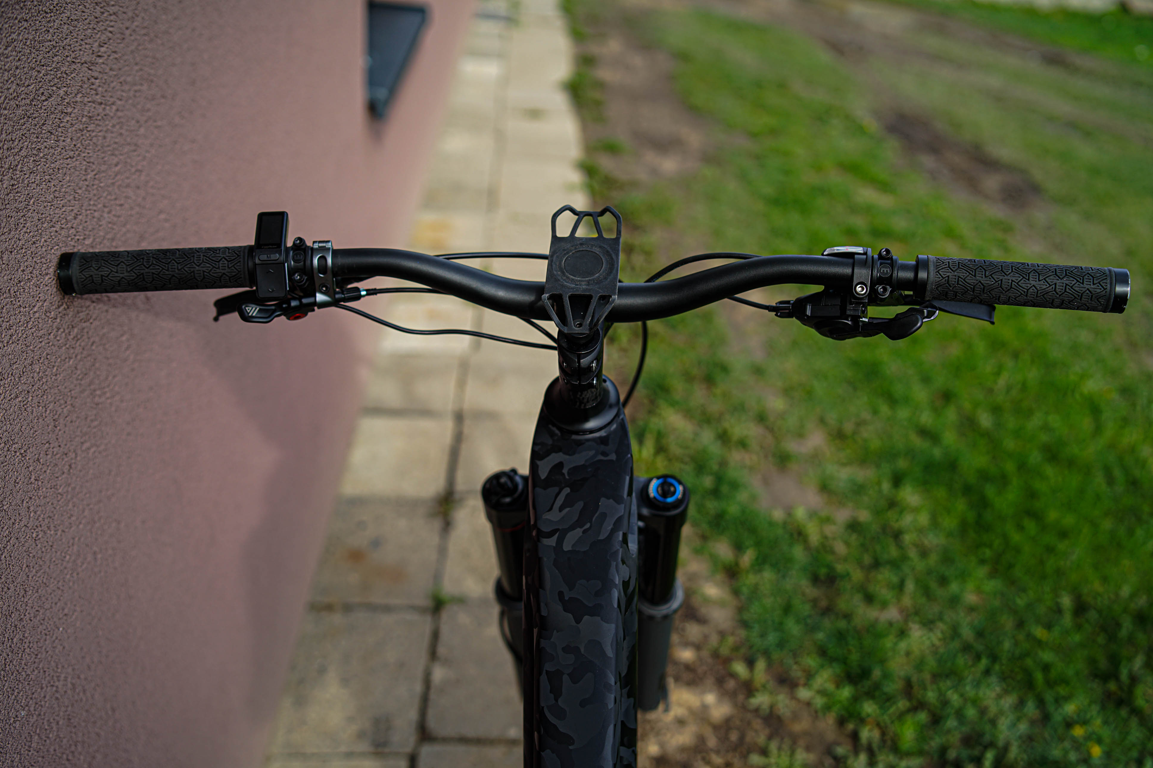

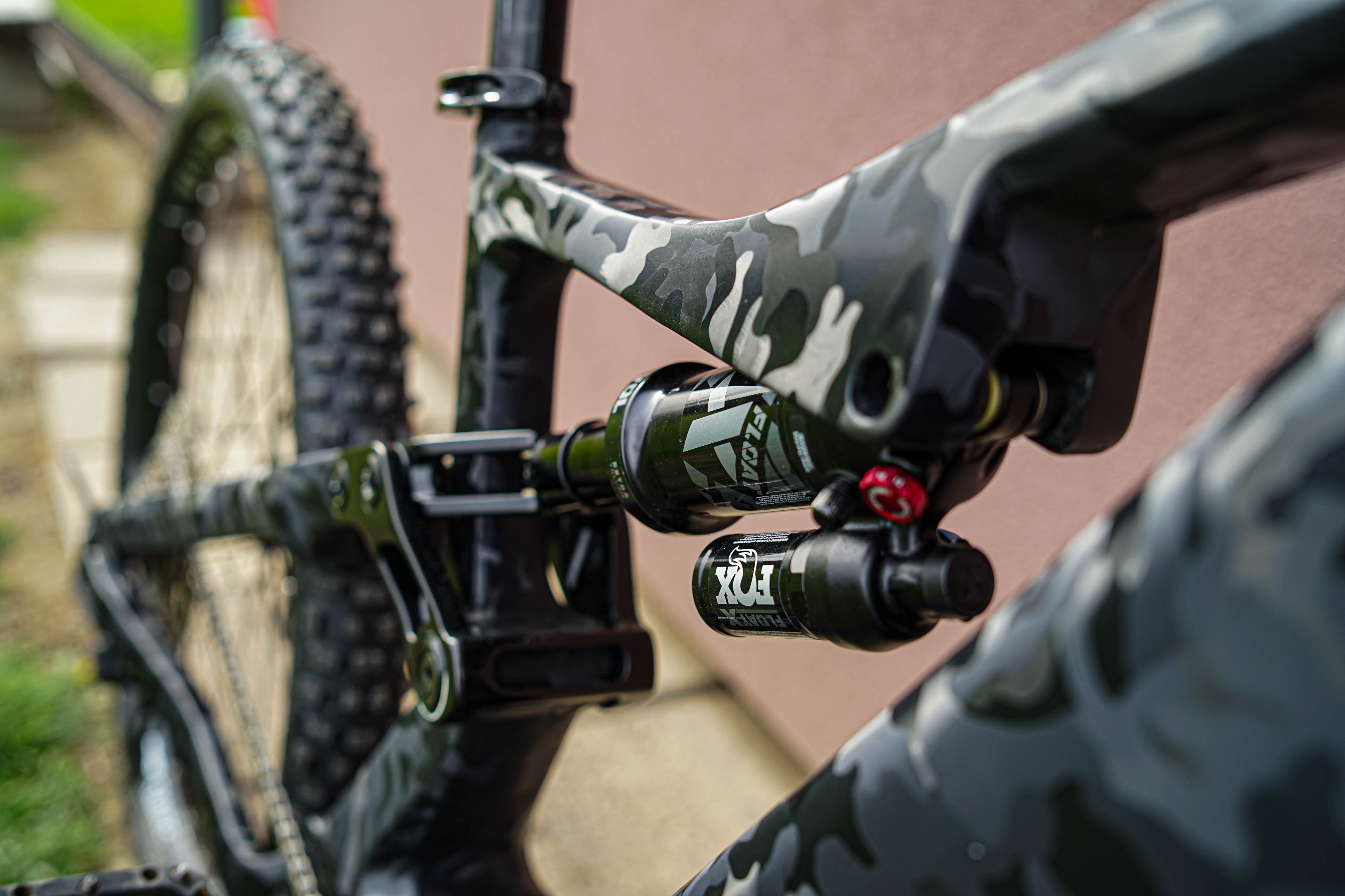

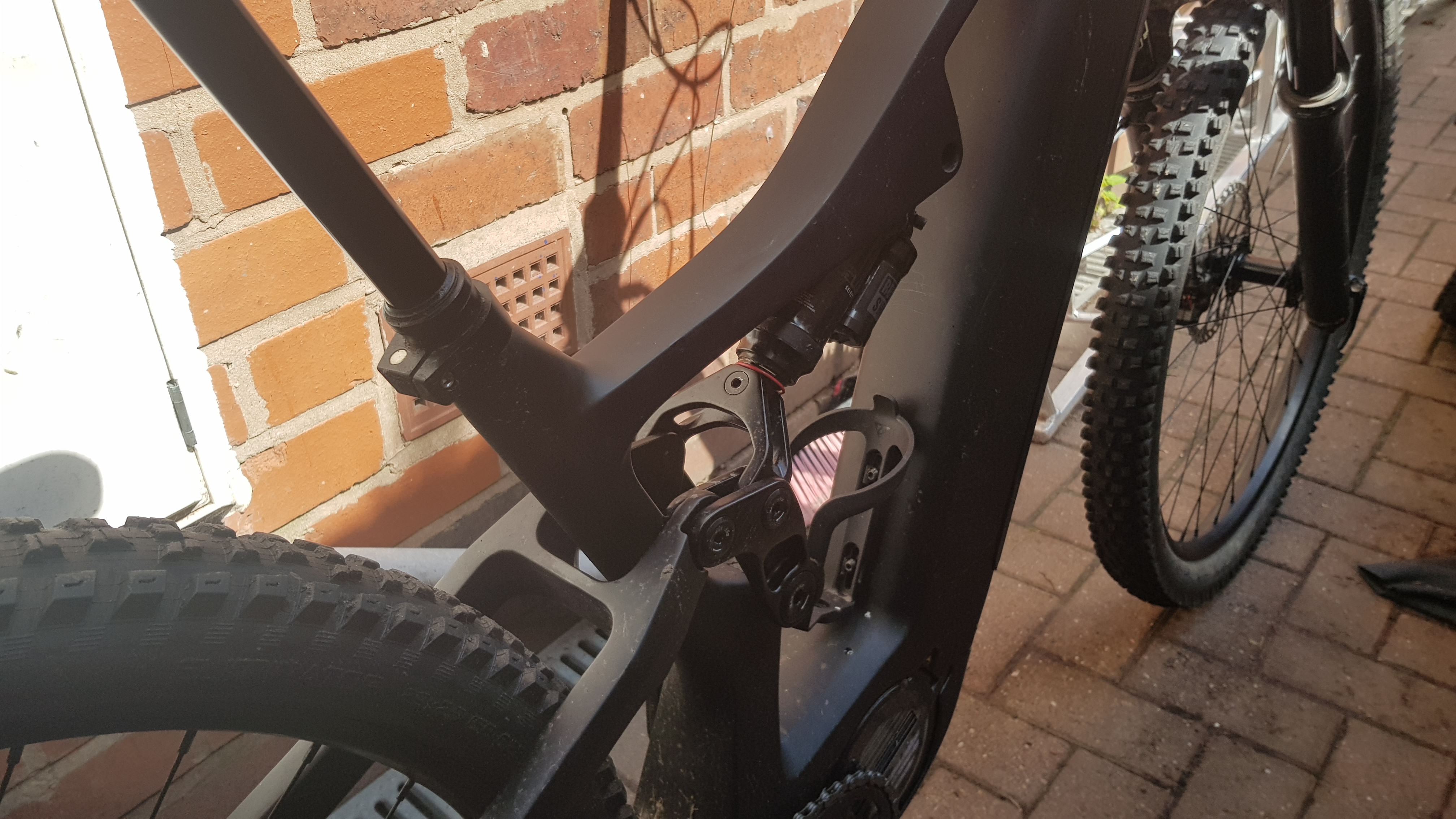

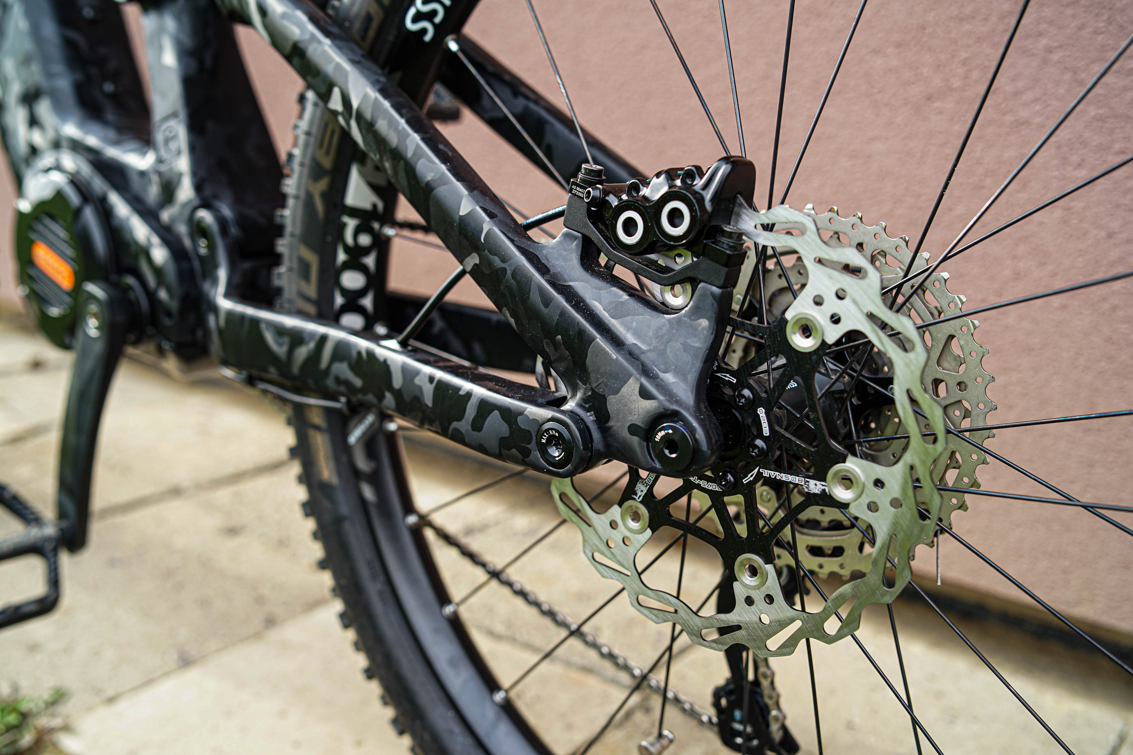

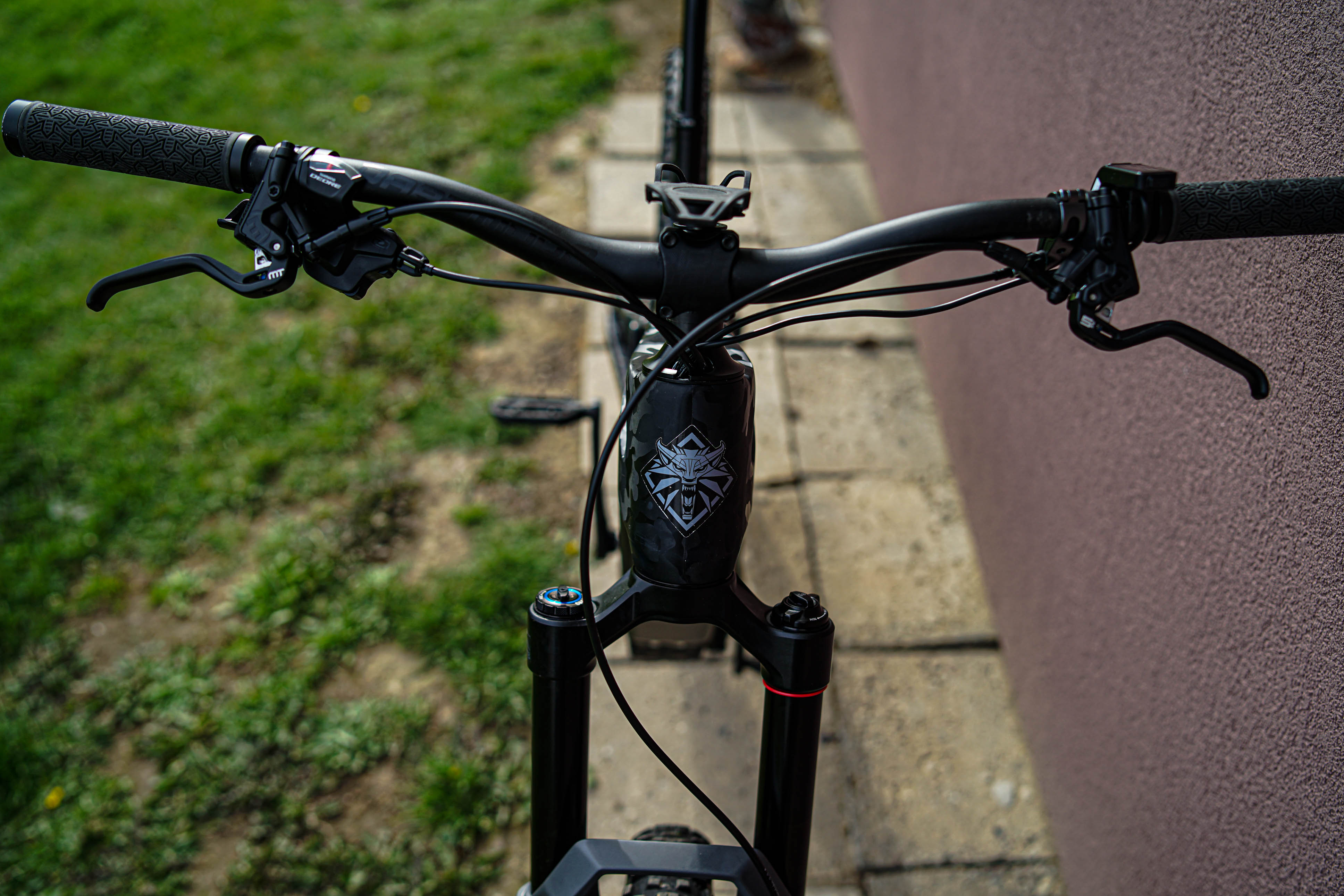

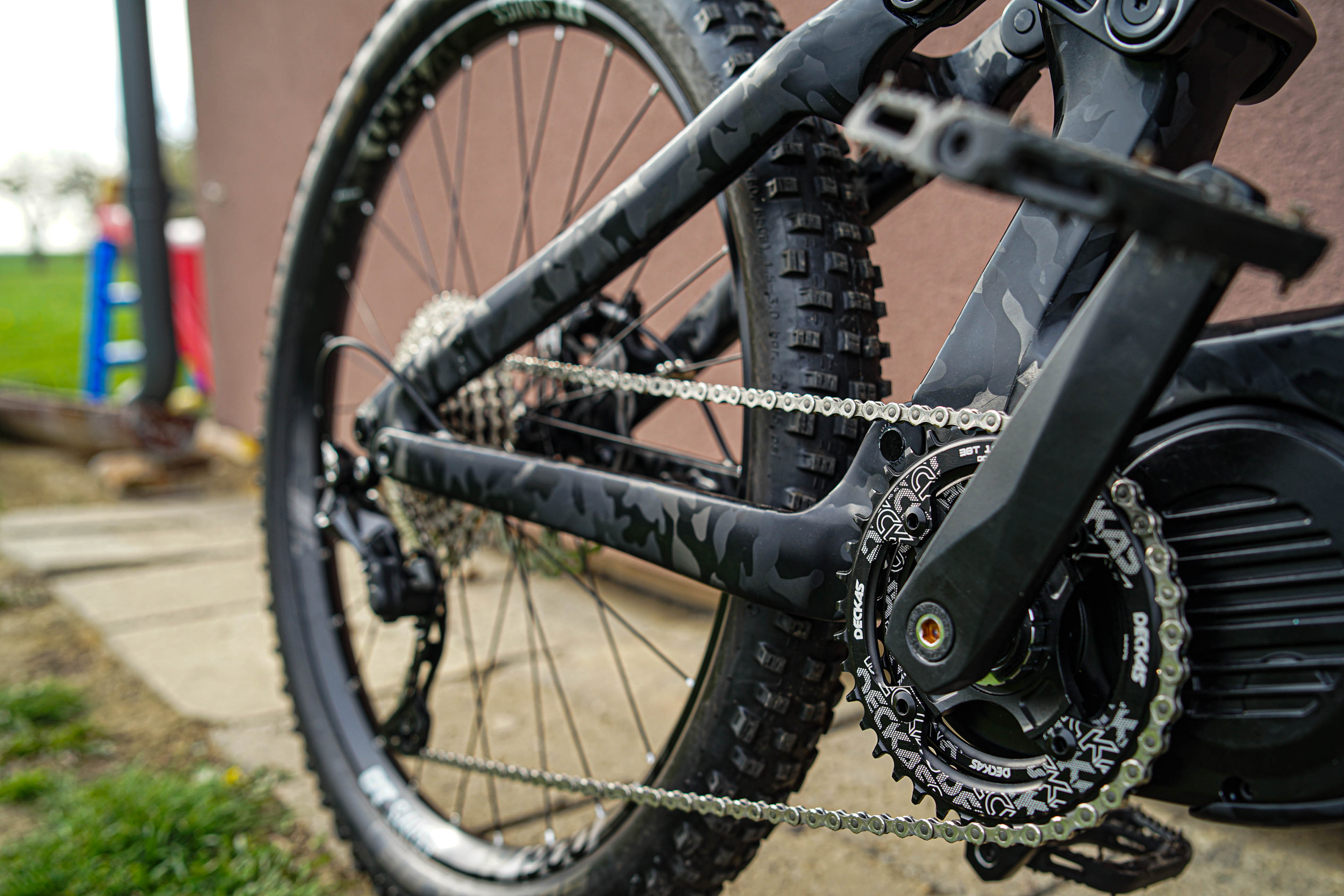

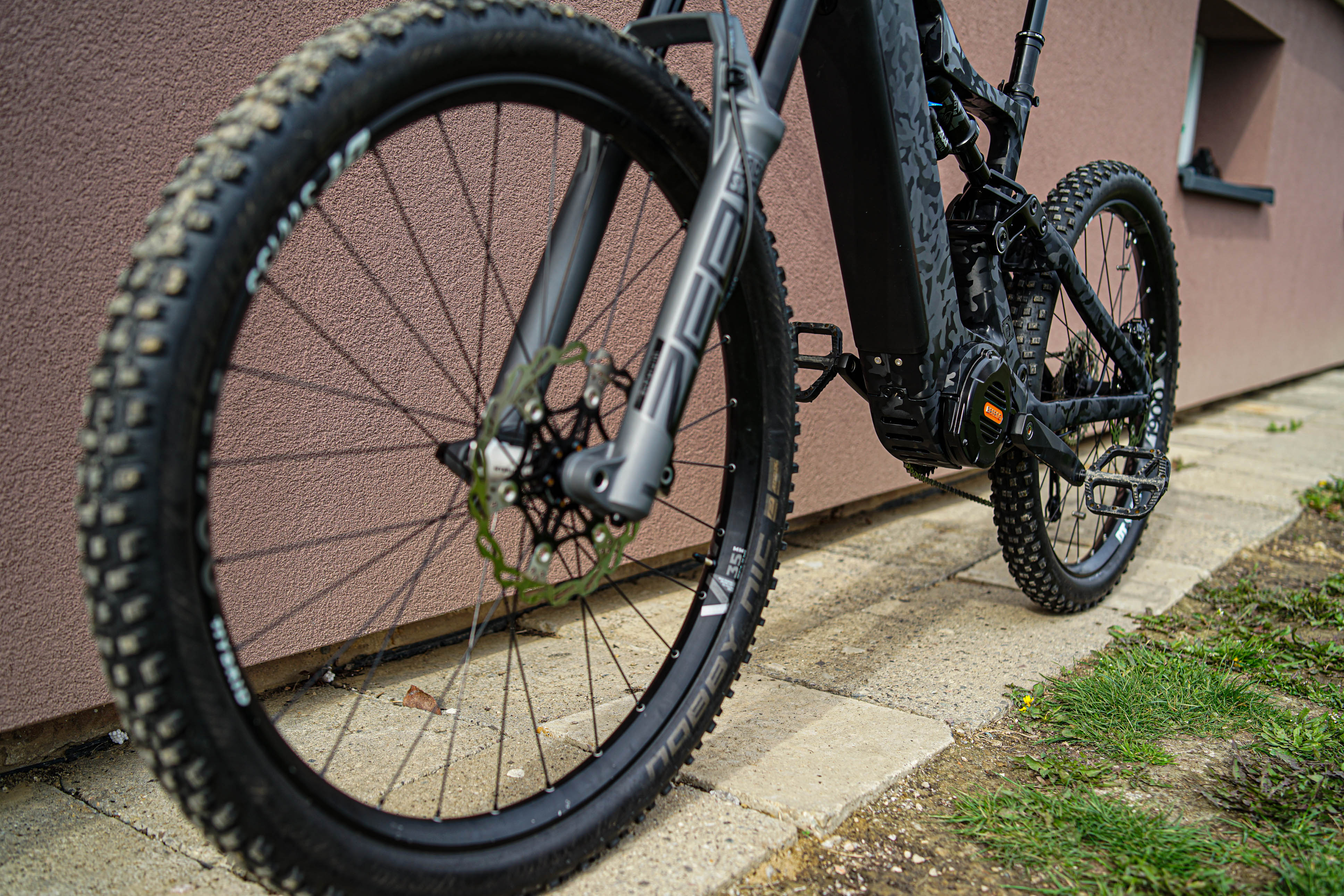

The hydraulic line at the fork is not laid correctly.
The hydraulic line at the rear brake should be with a margin and a small loop, because. when the suspension is activated, the distance between the feathers lengthens. Over time, you will break it.
It is really time consuming to lie down it by hand.

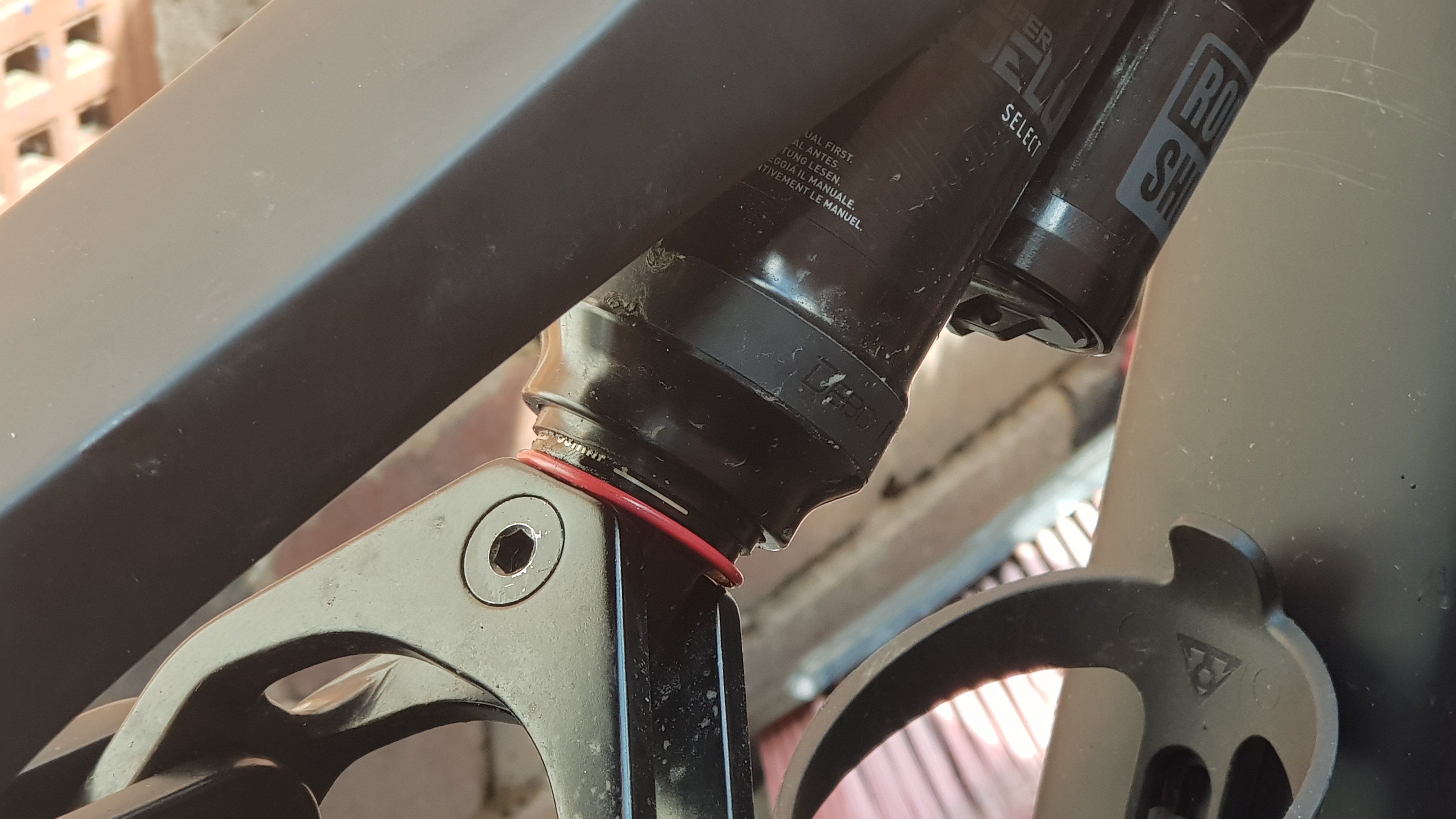

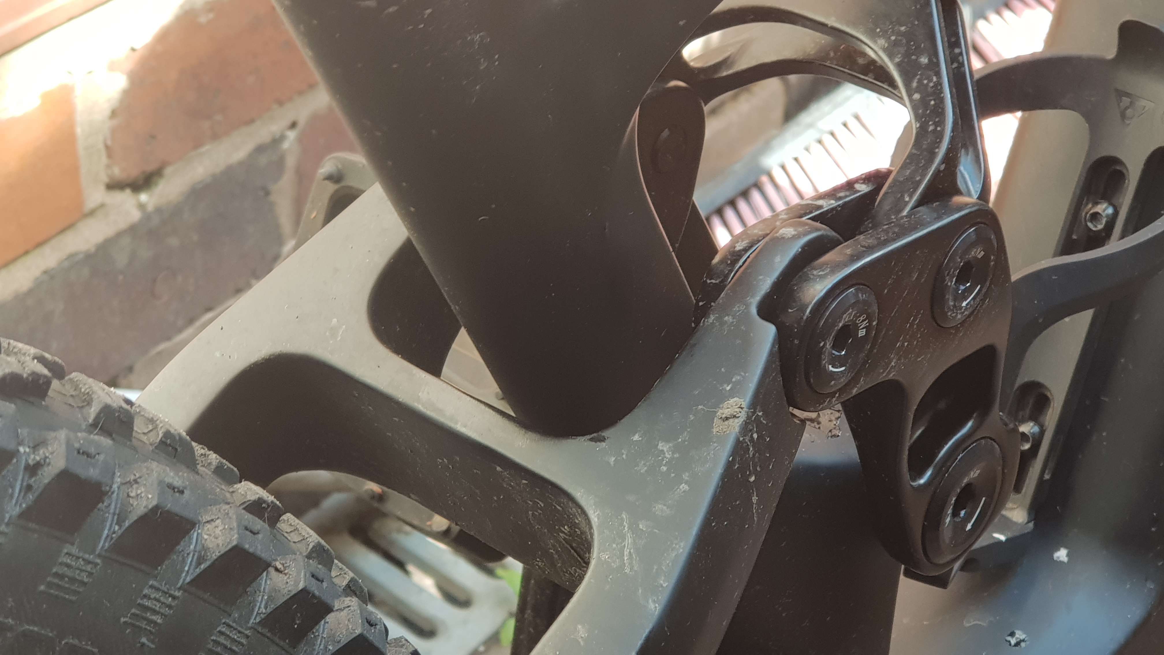

162mm of rear wheel travel according to my suspension chap with a 230x65 rear shock.
It is impossible. This frame has a suspension travel of 144mm with a shock travel of 60mm. The gear ratio is 144mm/60mm=2.4 so 2.4*65=156mm.
I've received the same message on the Dengfu Facebook community group. But that's what we're getting. Granted, we've not measured the axle path with a 230x60 shock.
However, it is funny that you're quoting the leverage ratio of the Dengfu E22. Which coincides with the very first post I raised on the Dengfu E22 frame thread. I.e. this frame cannot be over-stroked.
The rear end of the E55 is different to the E10 and E22.
The collate design of the chainstay of the E22's can only move up to a point with an equivalent rear shock and stroke.
In other words, this frame does have more travel than the E22.
