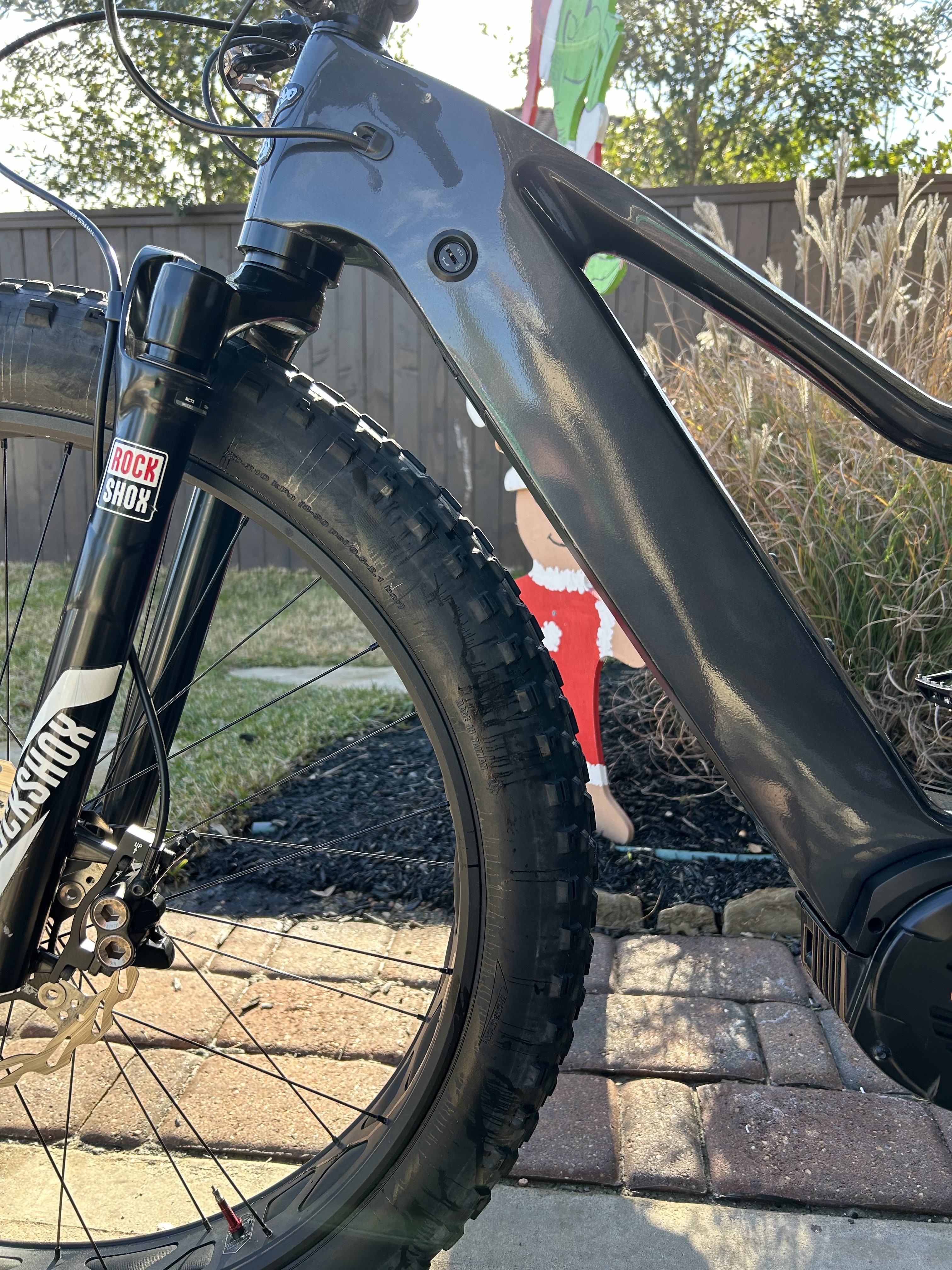

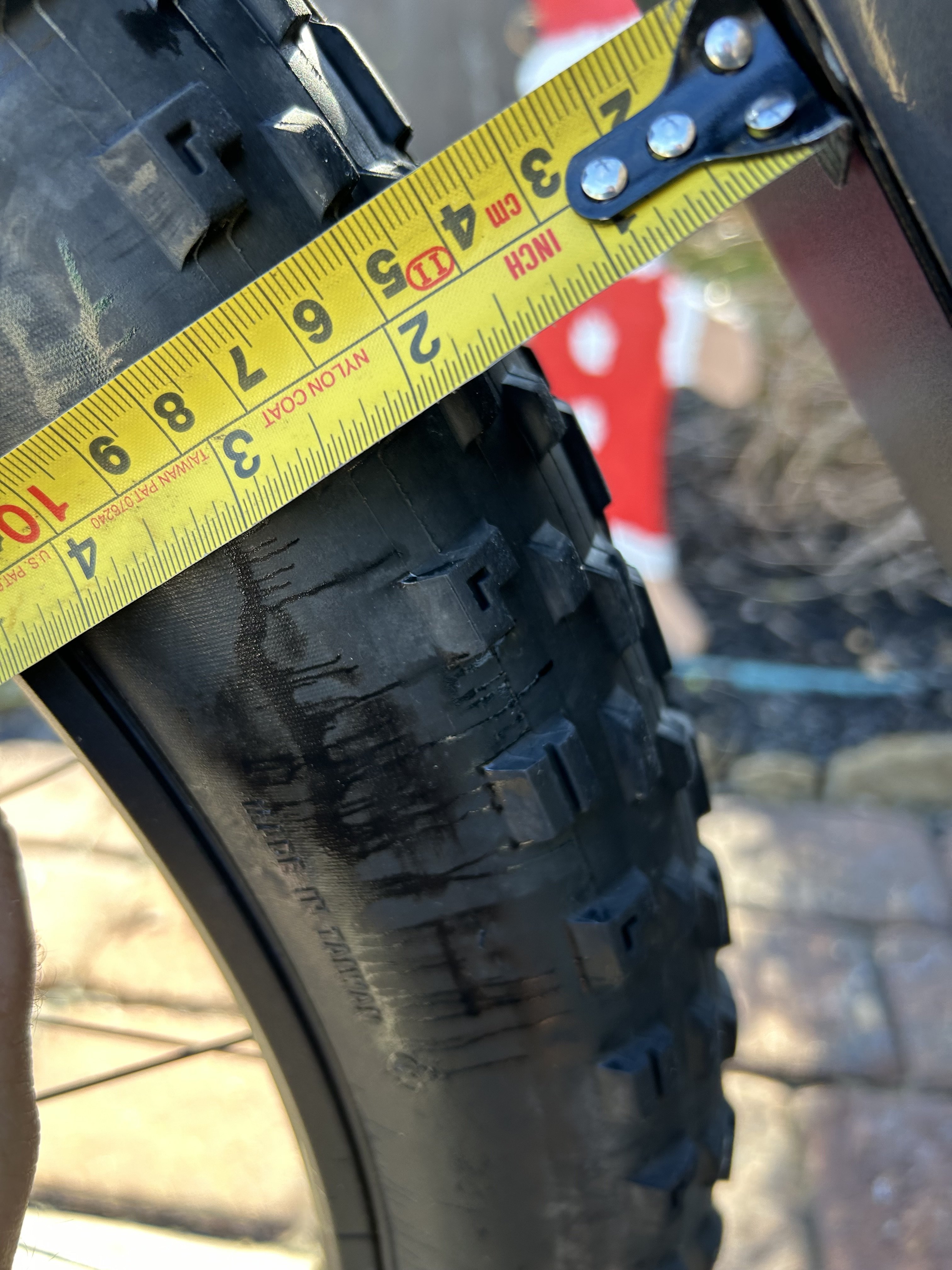

One other thing for TCFreak, would you have any interest in building a custom battery for the e-06.
You can see from the pictures there is about 1-1/4” clearance from the front tire when the suspension is fully collapsed.
I was thinking could add more cells that protrude outside of the frame.
Thoughts?
Thoughts?

I noticed the same thing!!!! I think the dream way to go about it would be to stuff ~500wh permanently built into the frame behind the battery and build a 1.5Kwh pack that sticks out like you mentioned... That way you could have a lightweight setup for ripping/storage and pop in the pack for the long haul with !!!2KWH!!! ...can't say it's made it to my project list quite yet tho.

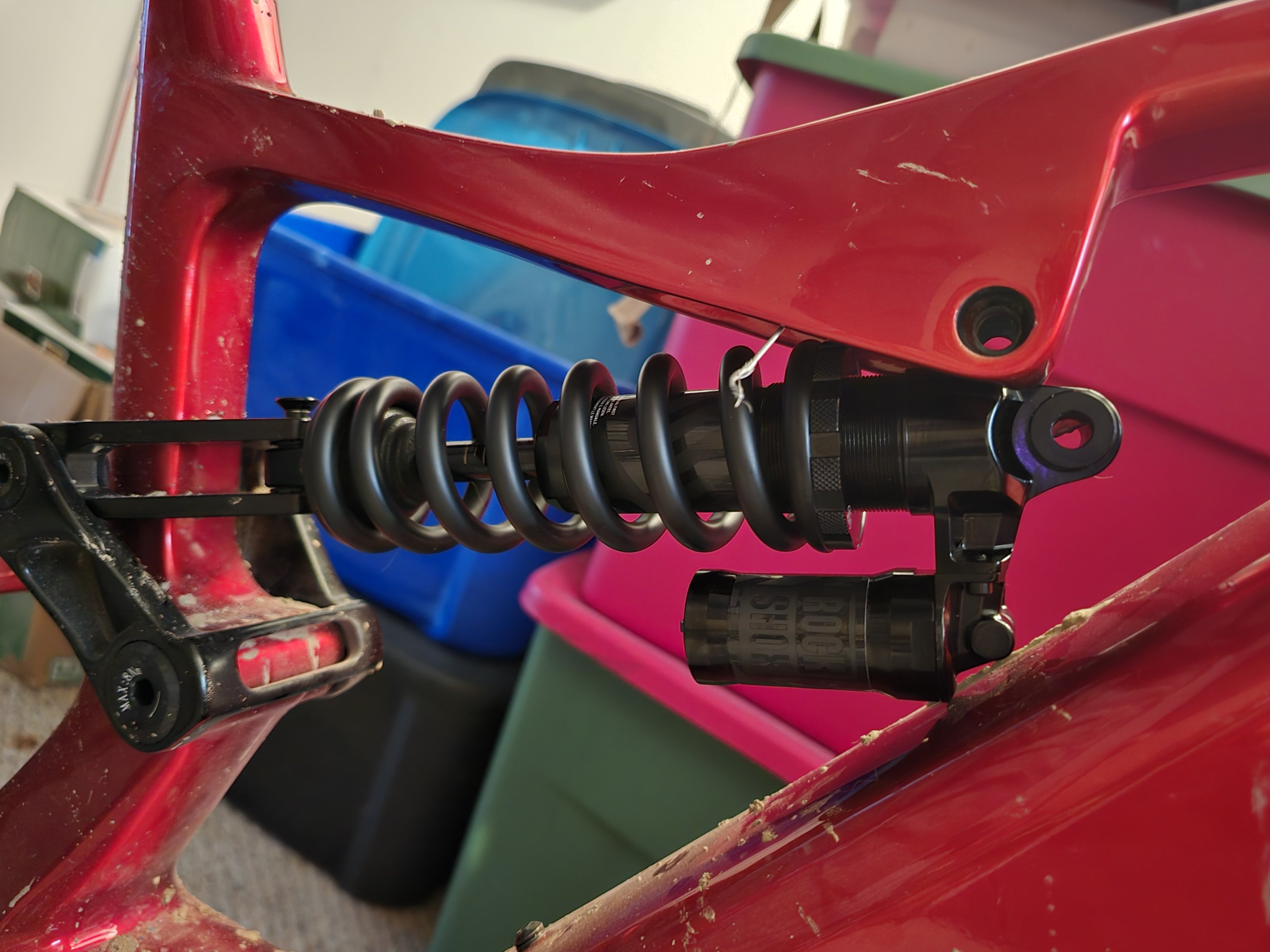

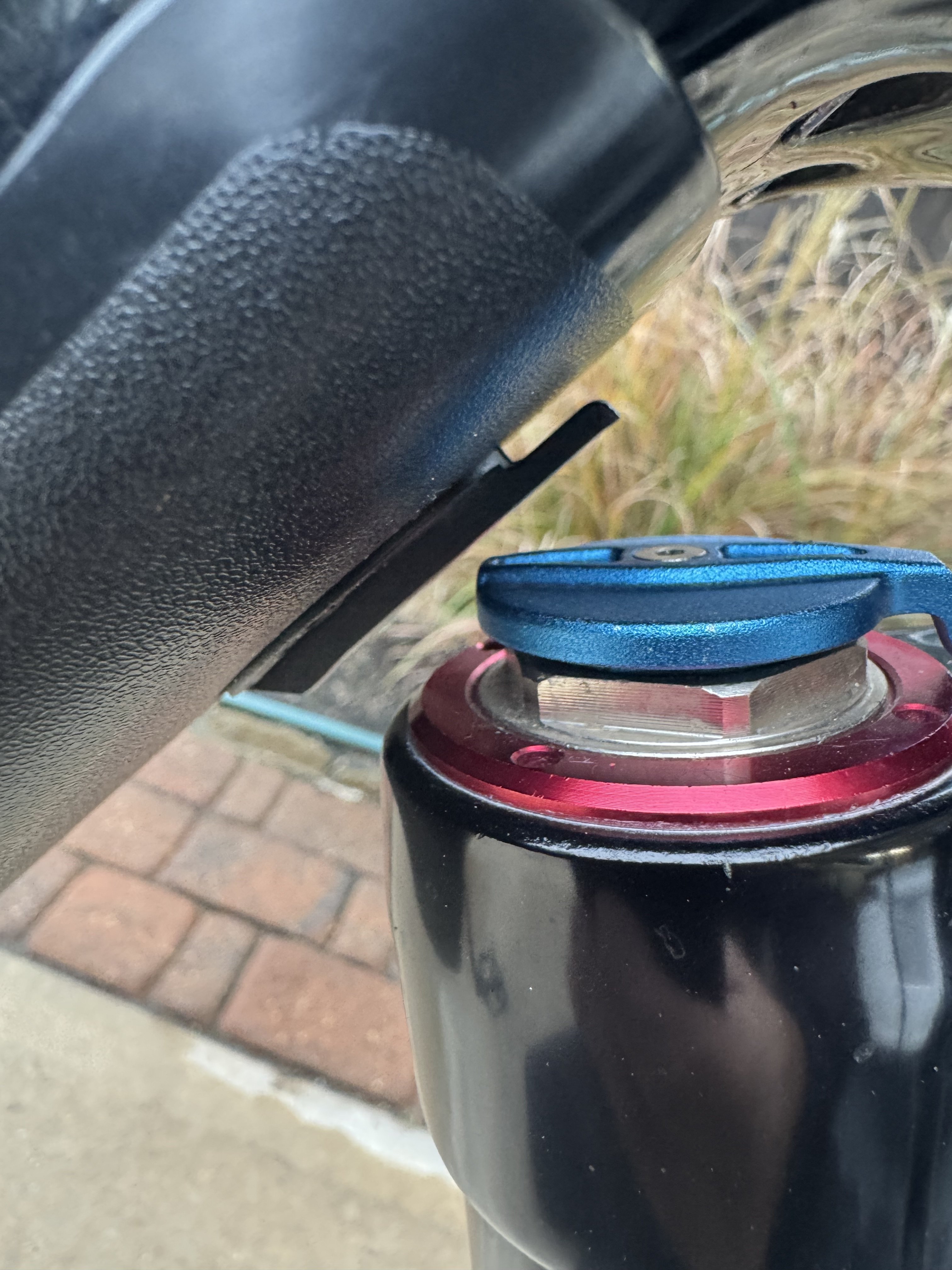

How are people getting the 230x62.5mm shocks to fit on the E55?
Has something with the linkage recently changed?
When my wheel is fully drooped it only has about 215mm between the eyelets.
looks like you got the (70mm) instead of 50mm extension nozzle (lol thats what its called on winice website)
was your bike a prebuilt model?
in any case you'll find them for sale on the winice website. long delay ship from oversea.
if you are a very crafty individual you'll be able reshape the nozzle and redrill.

Is the backside (seat tube clearance) the same between the two nozzles, or will that need to be clearanced as well?
Even fully compressed it looks large? I know absolutely nothing about suspension at this time (I just ride on tarmac) but mine went right in. It's a bit off topic but I once had a DNM shock like yours and it felt more responsive than my Rock Shox deluxe select+. I have only ever tried 2 different shocks but that is was what I noticed. Suspension really isn't my kind of thing but even I could feel the difference. I might try one of these at some point in the future.

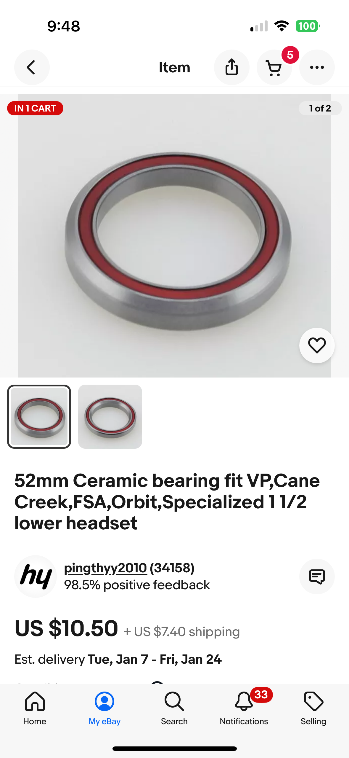

I purchased the bearings off ebay. Picture attached. This bike is too much fun, I’m suprised more people don’t purchase them as they are a great value.
Did you ever get a coil shock in there for the rear suspension?
Dang, just now realizing I'm in the same boat...after having ordered a pricey 230mm shock. Winice/Denfu is showing no stock...
