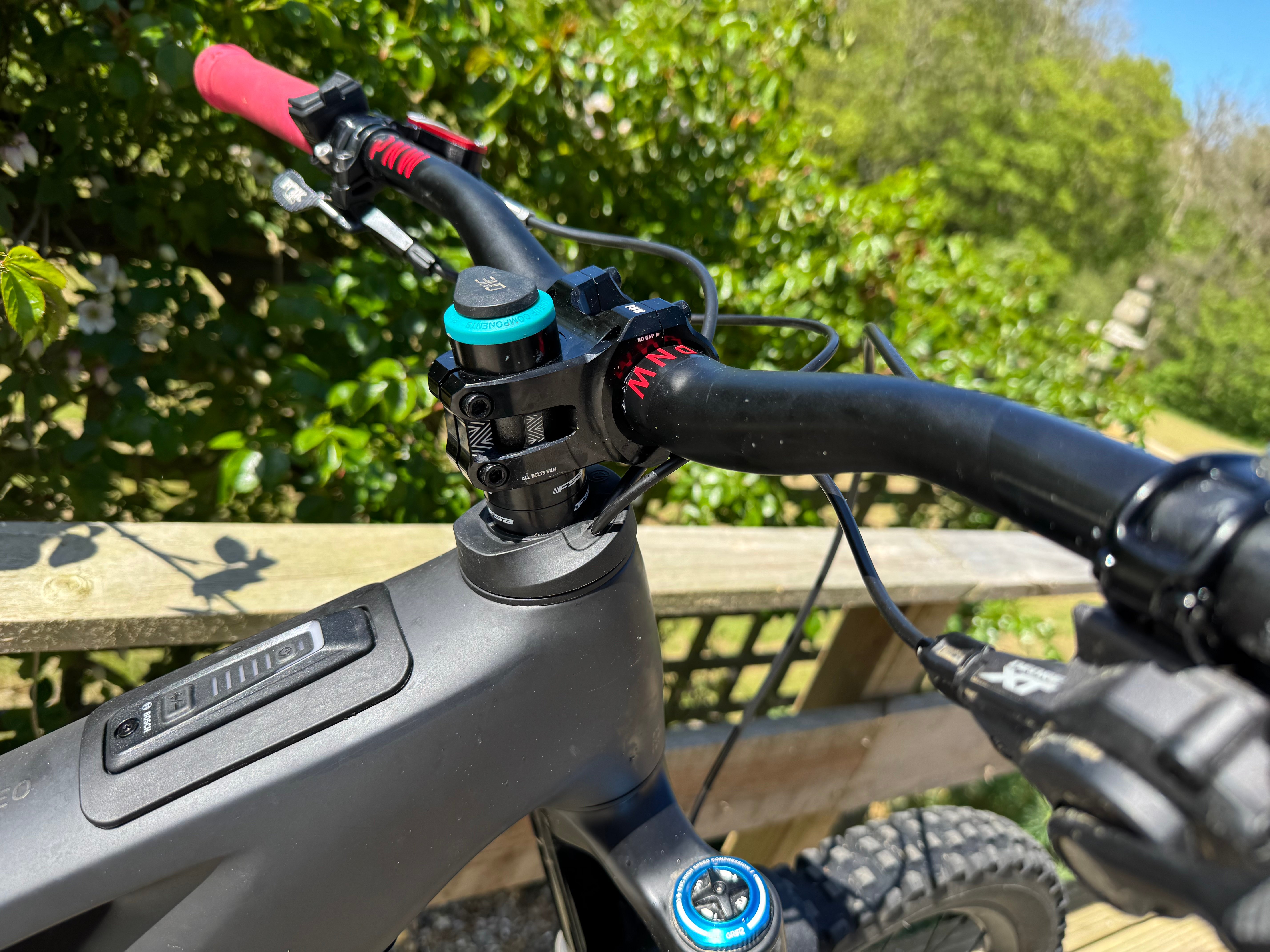

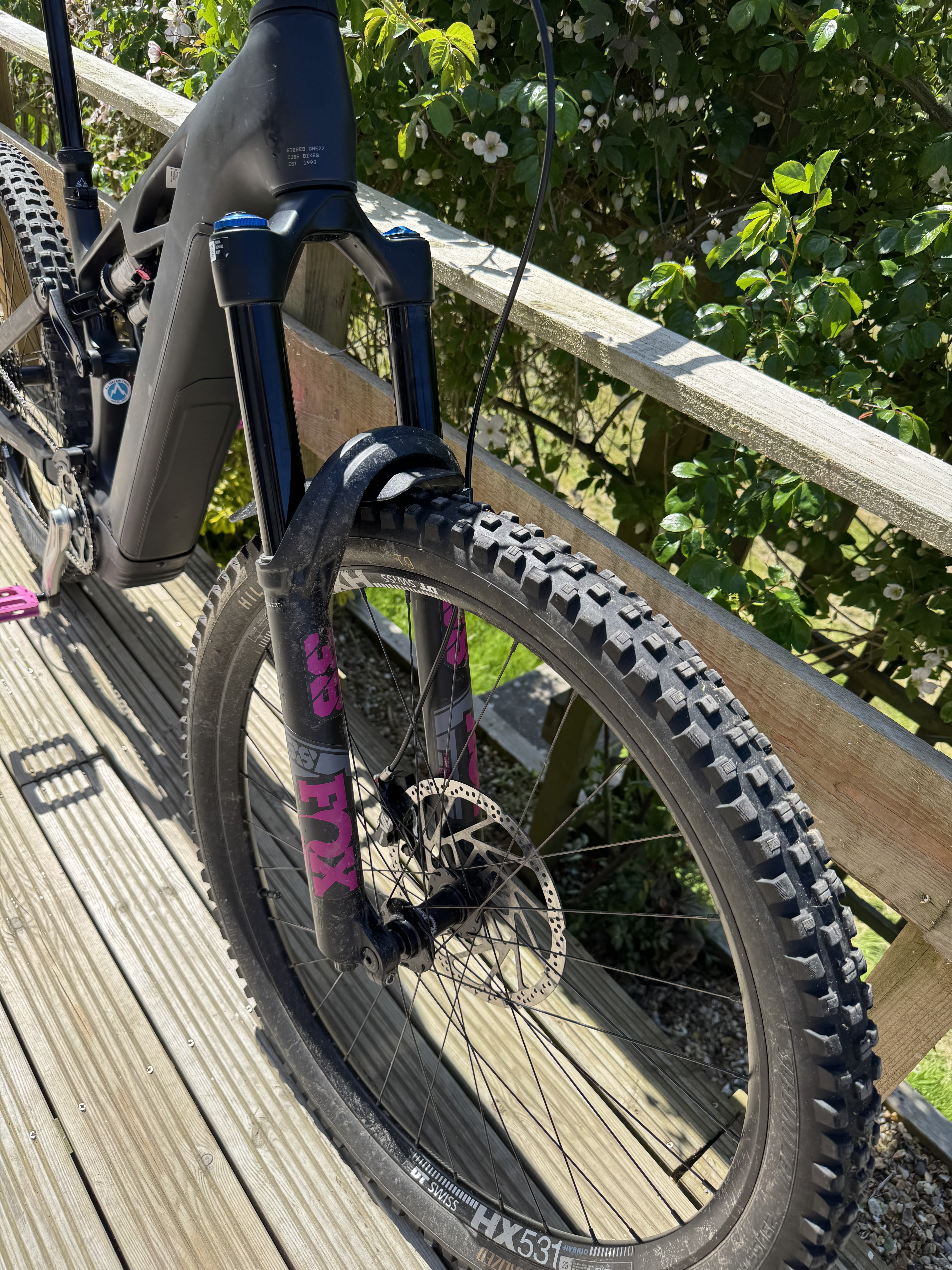

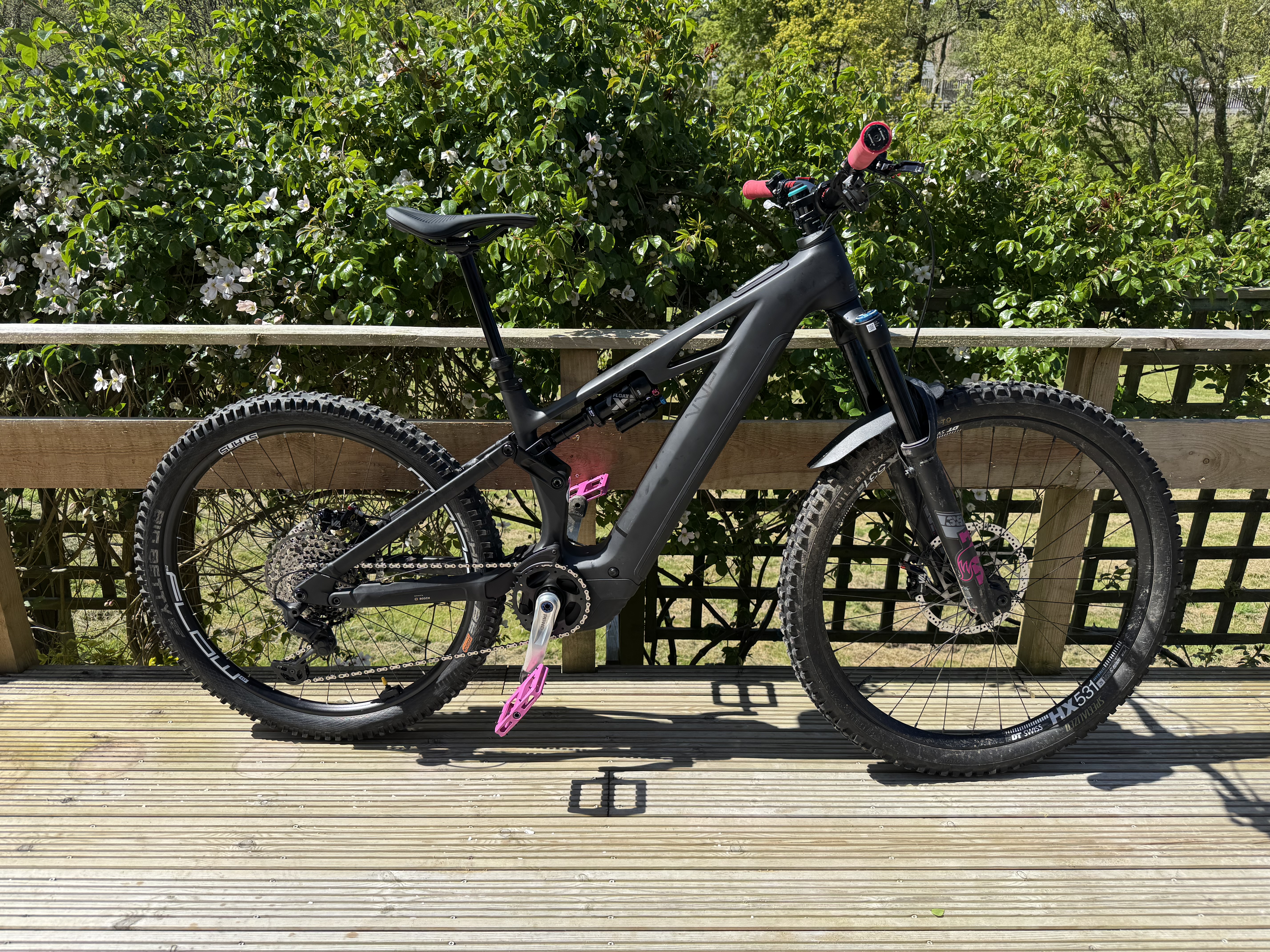

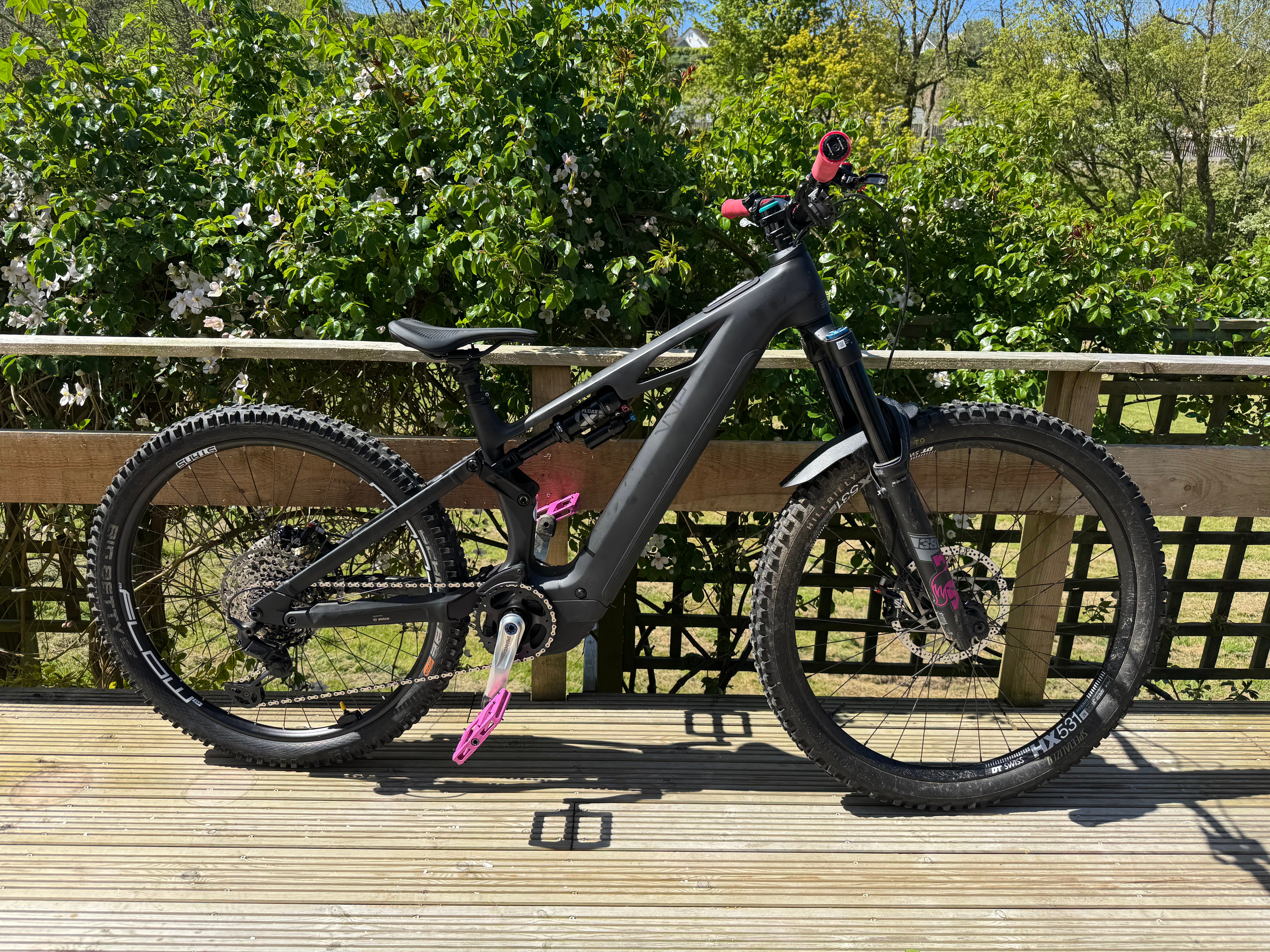

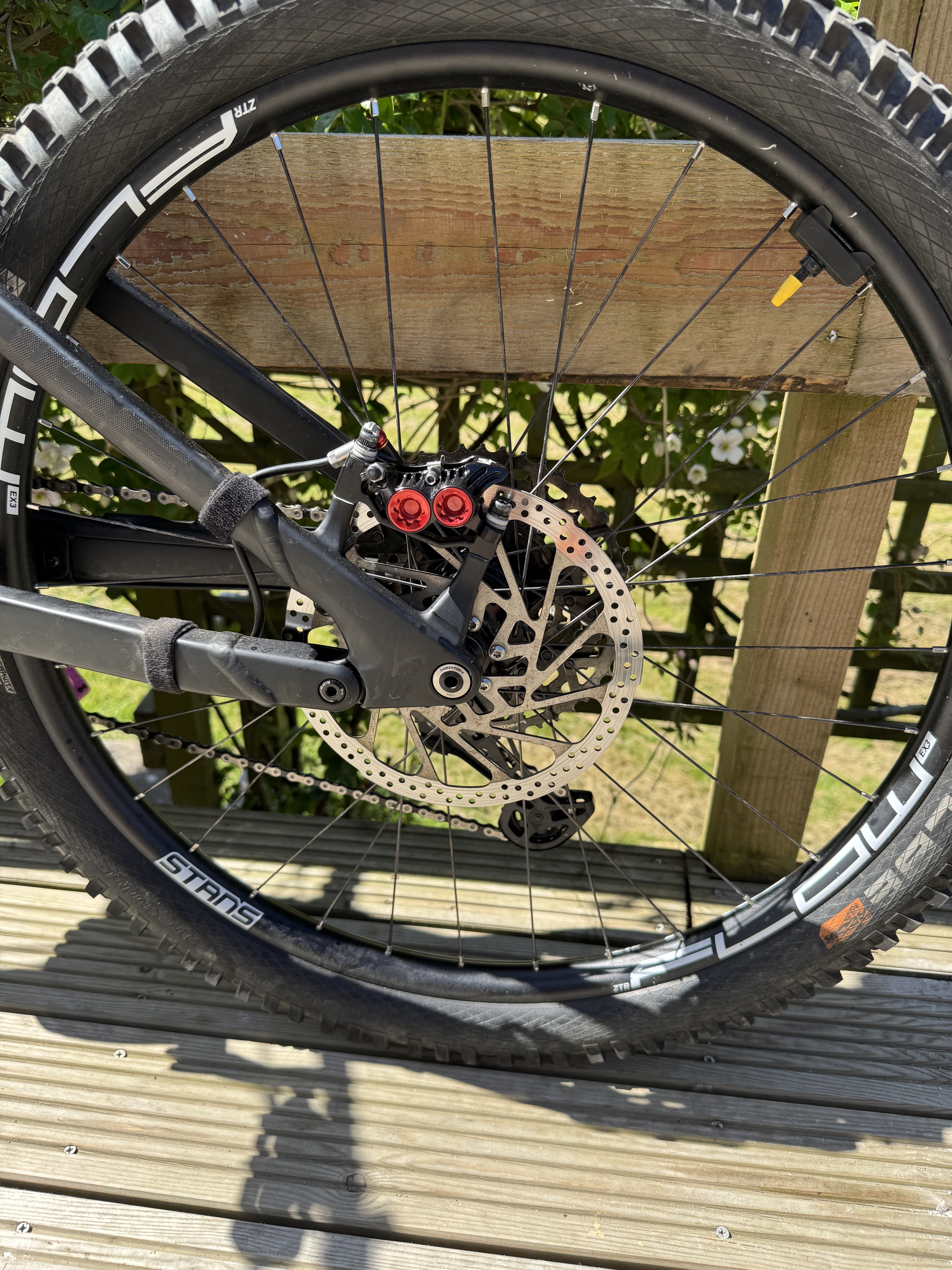

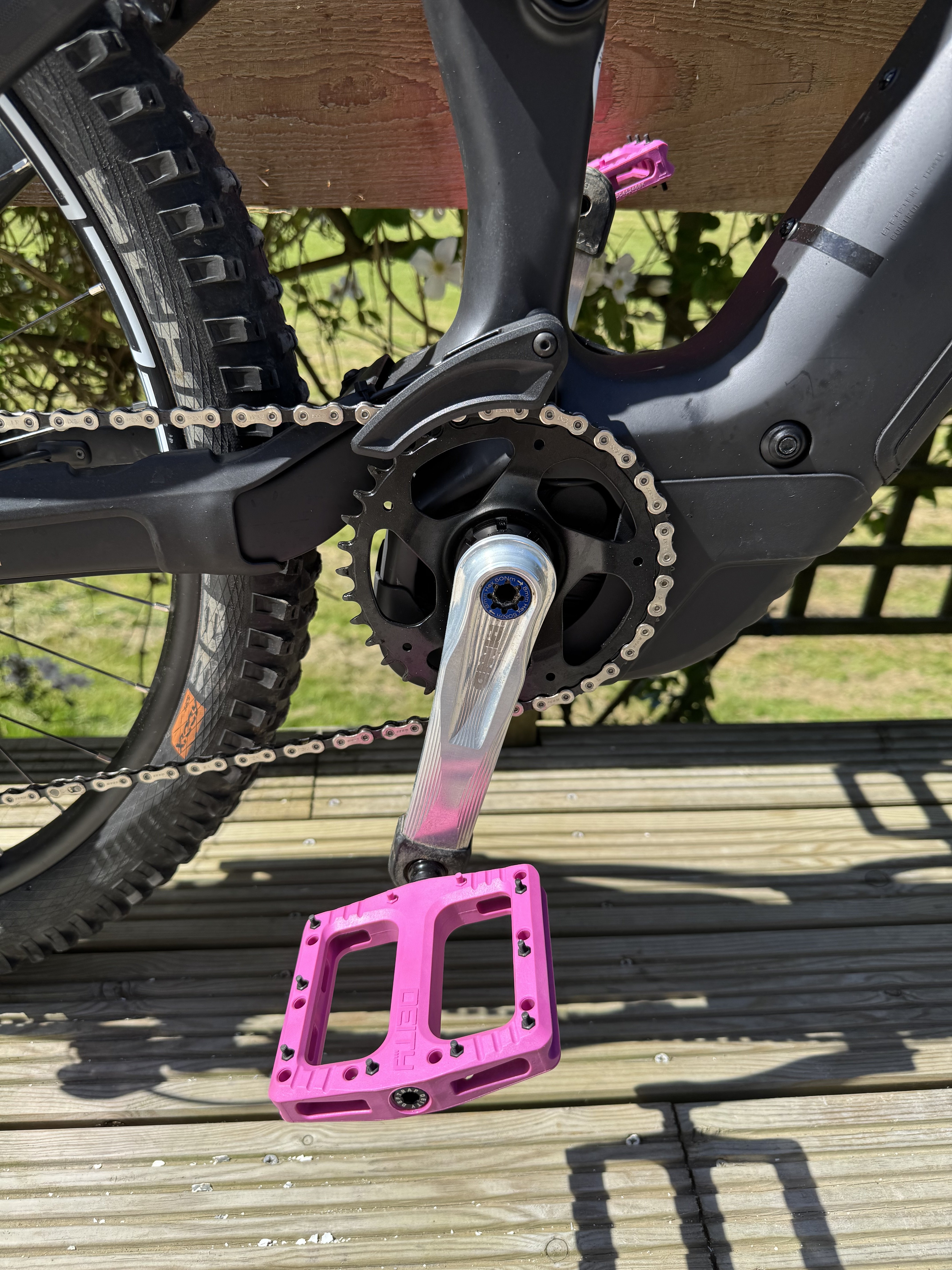

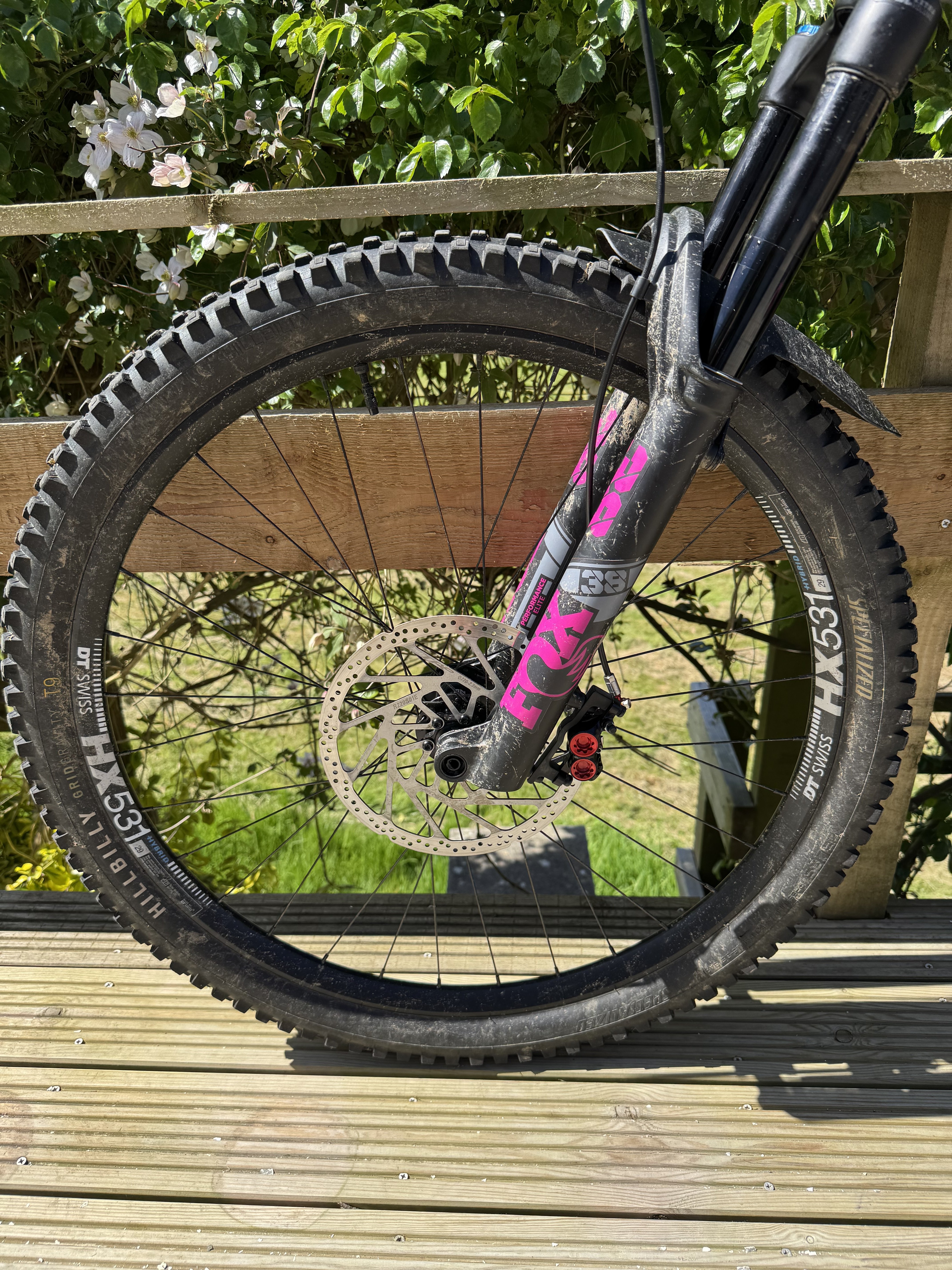

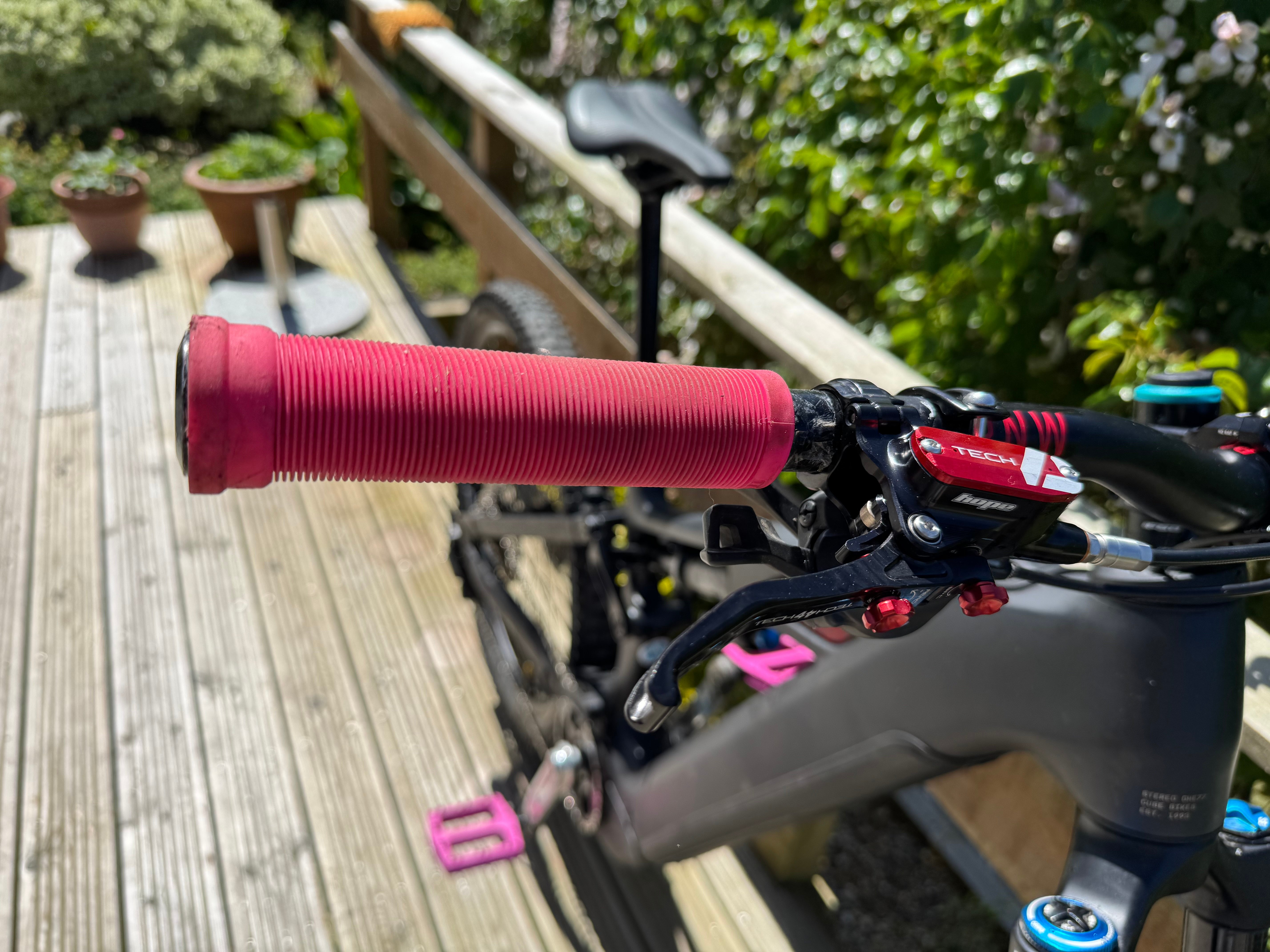

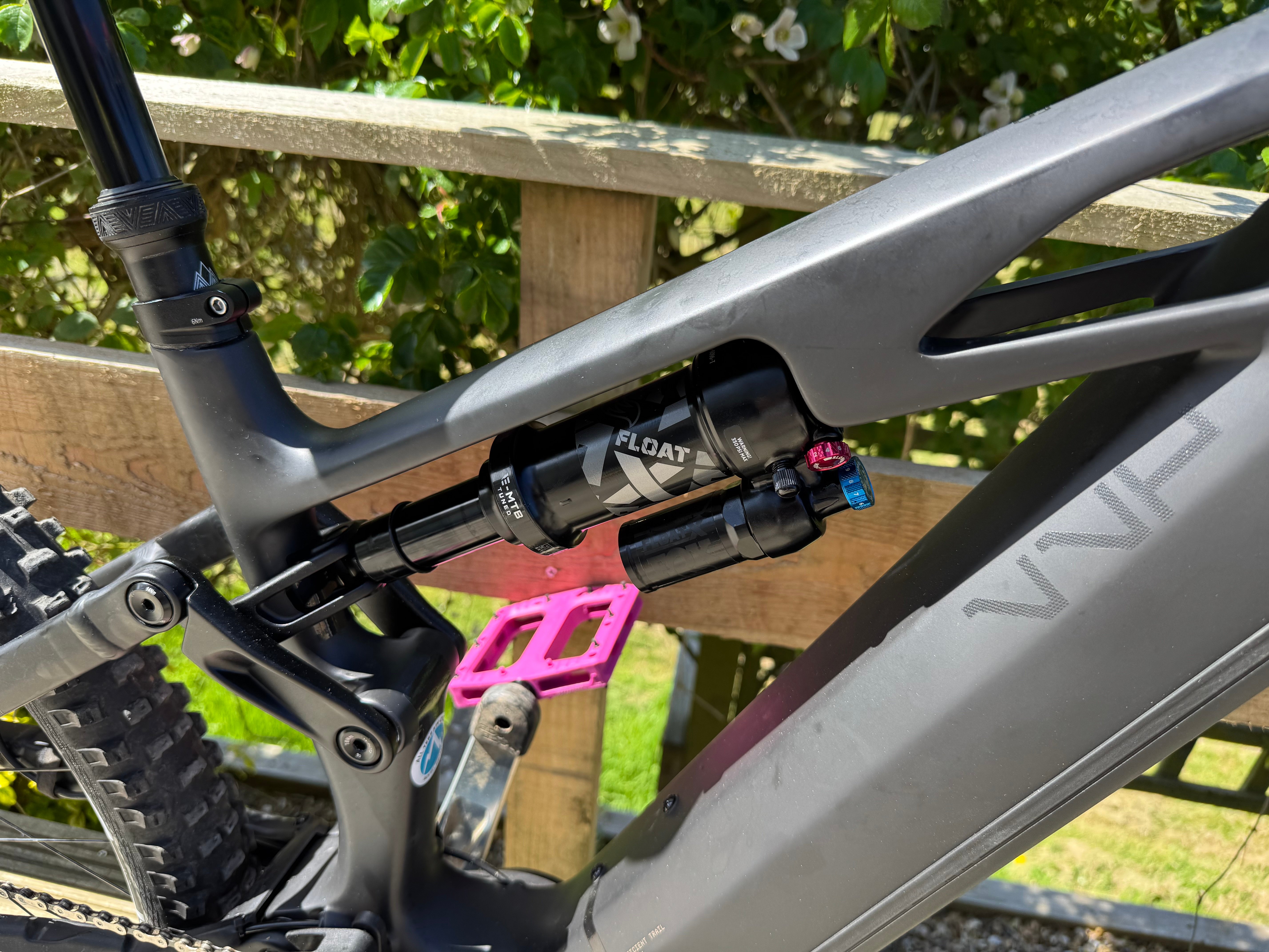

Swapped the forks for my existing Grip2 damper, new Hope Tech 4 V4 brakes with TRP 2.3mm rotors 220/200 front/rear, shimano XT 11S Linkglide, PNW bars, stem and 170mm dropper and added low speed adjuster to the rear shock. Finally PINND 140mm cranks and pink Deity pedals that the bike shop gave me for free.View attachment 159793View attachment 159794View attachment 159795View attachment 159796View attachment 159797View attachment 159798View attachment 159799View attachment 159800View attachment 159801

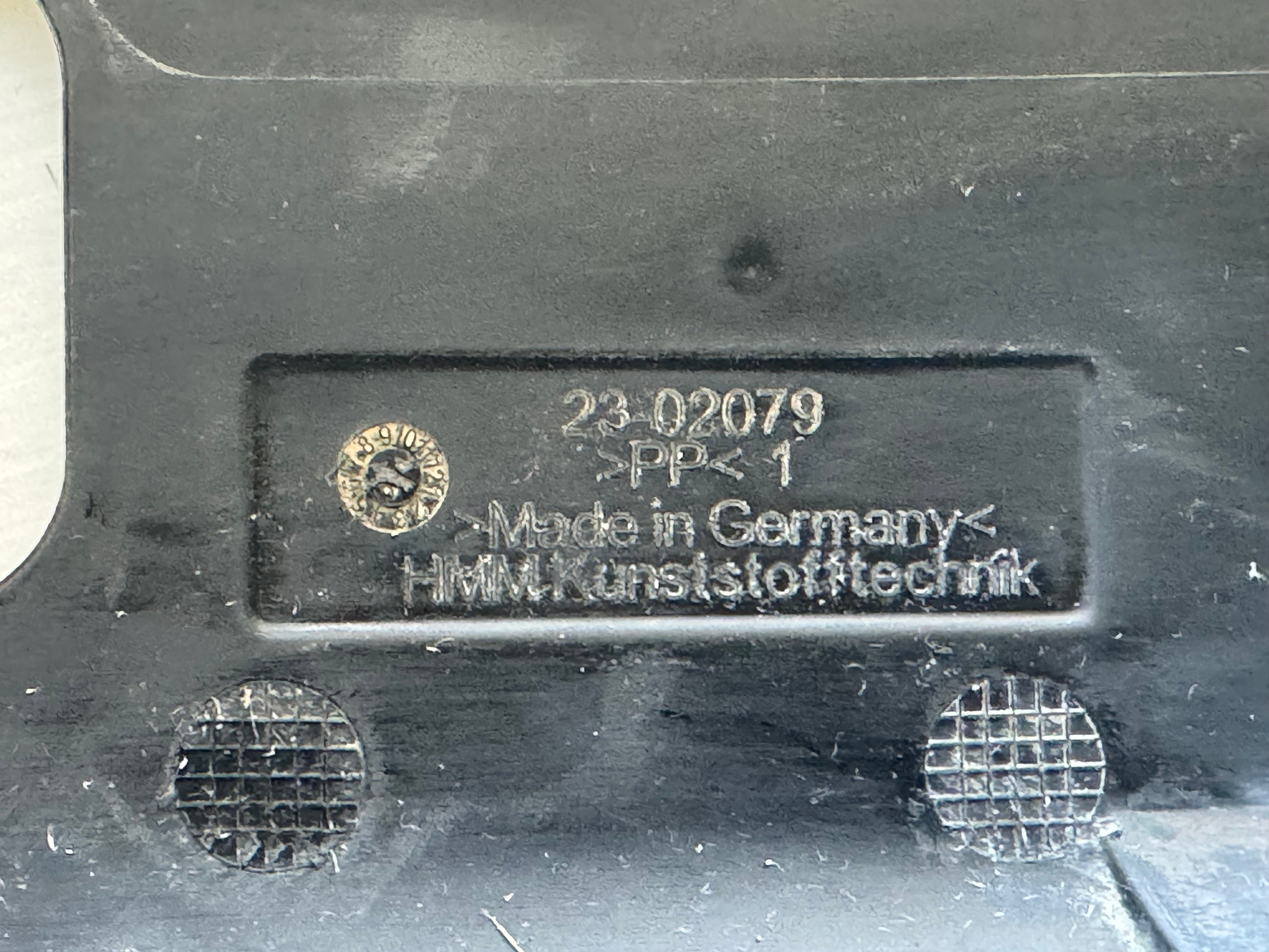

Does anyone have a part number for the one77 motor guard? Yep mine has gone awol on a trail last night and I've only just noticed it gone (duh!)
Hi there,
See attached! 😁
It’s a standard T40, I don’t know the torque, sorry.
I only removed the front bolt and loosened the rear to pivot the motor out of the way with my V4’s.
Just be careful with the chain stay “guide”, it has a back piece that lives inside the chain stay. Silly design.

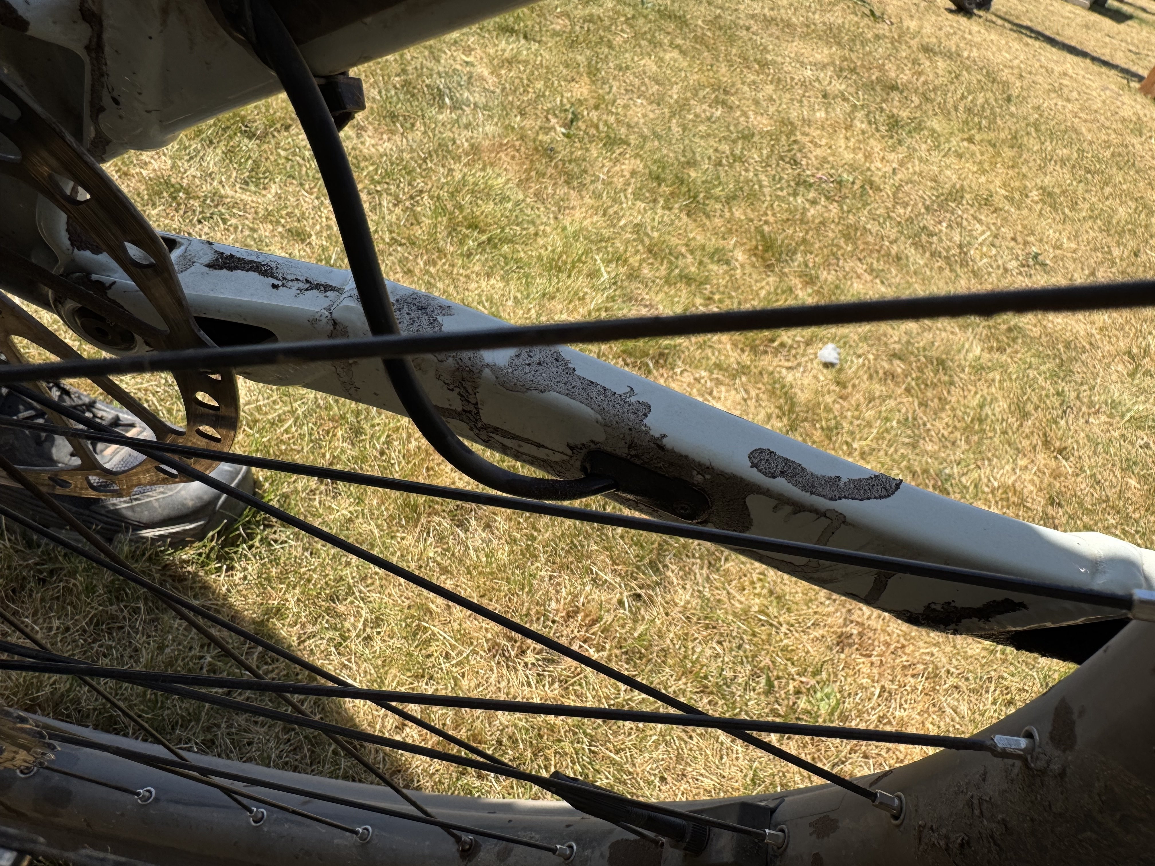

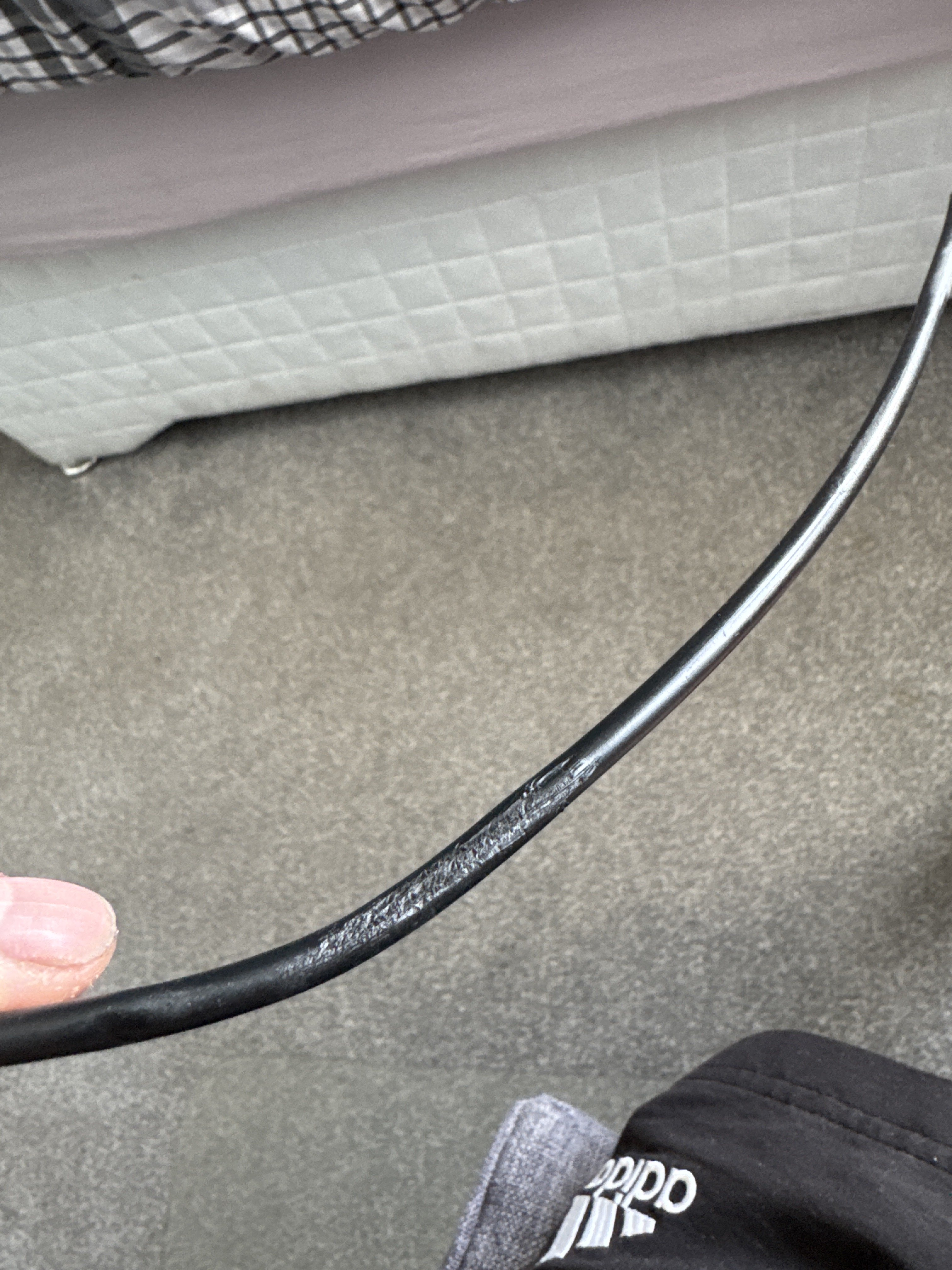

Yeah it’s original. I believe it was set up wrong from when I bought it. It did rub on the wheel from the start and I had to cable tie it to the frame to stop it rubbing. Going to try warranty for a new cable disk and pad. Otherwise I’ll look at upgrading it.

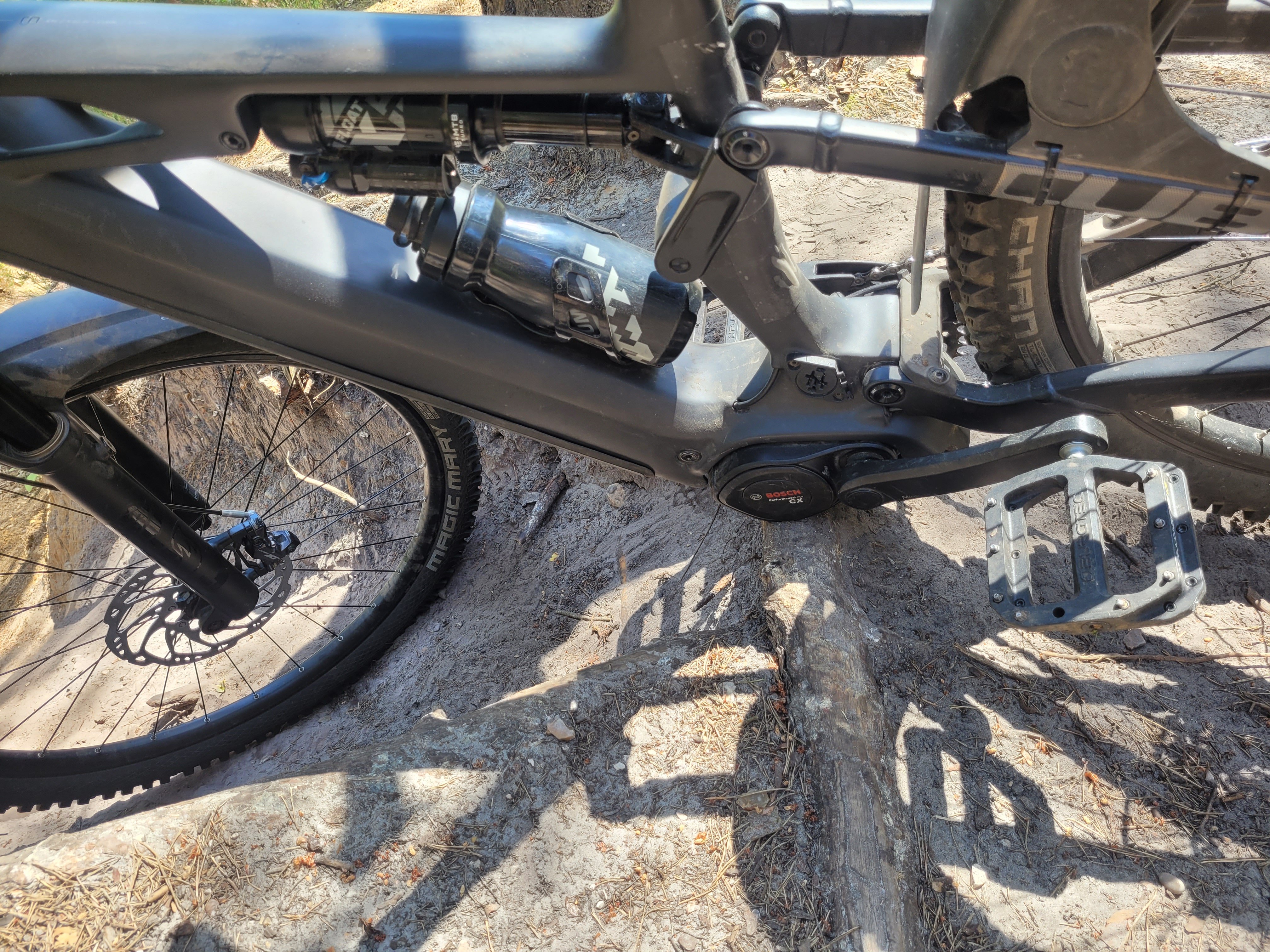

After some rides my bike creaks like an old wagon ... :devilish: .Shop says they have to disassemble shock linkage and grease it.
Mines creaking as well so I shall be removing bolts and adding assembly grease. It creaks like its dry which is very poor for a new bike.

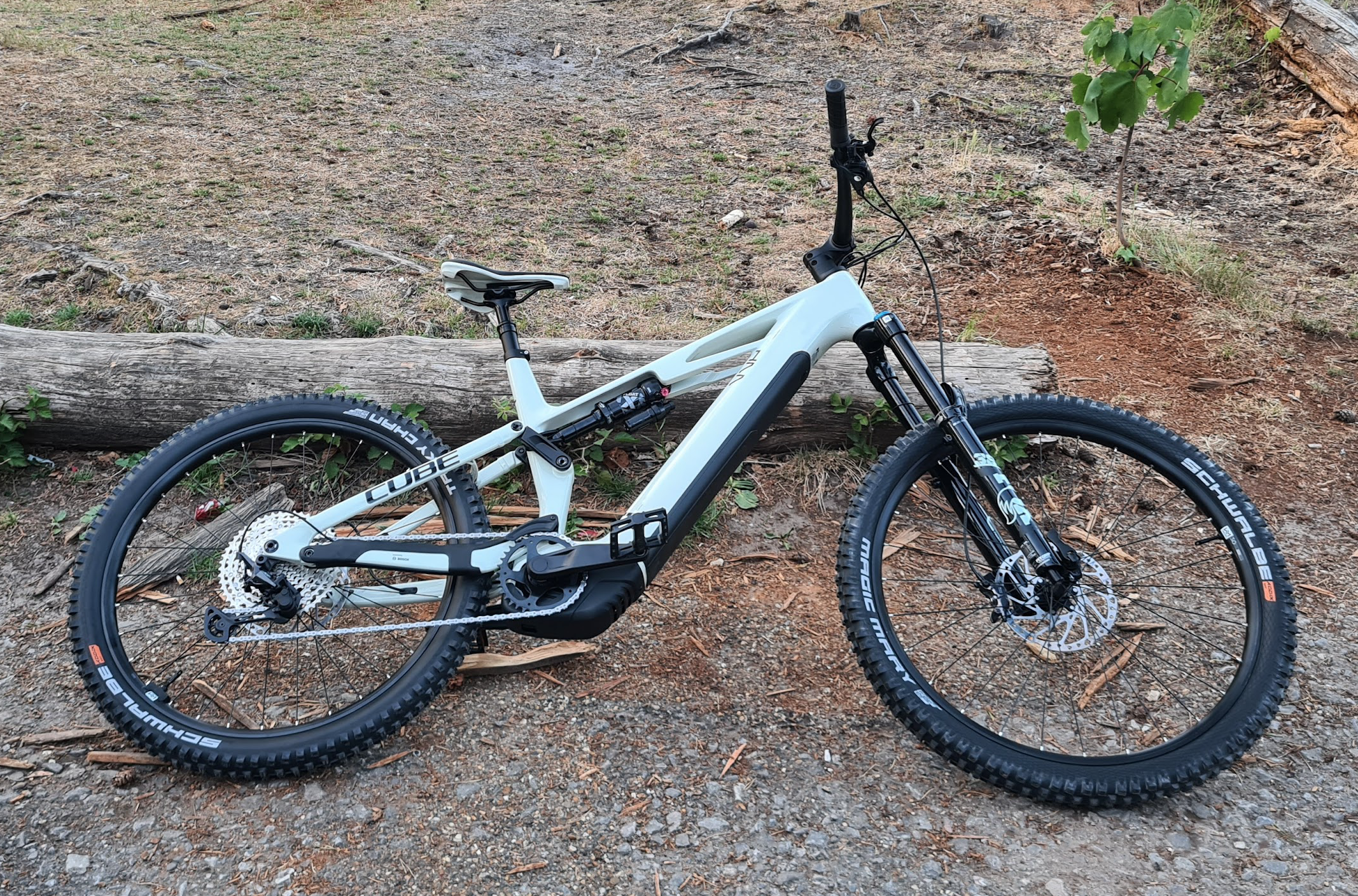

I've just joined the club with a white (Desert Stone) SLX, which will replace a Gen2 Levo I've had for 5 years. Decided I'd give it some frame protection, usually use Invisiframe but they don't seem to be offering a 177 kit yet, so I went with RideWrap, more expensive than a typical Invisiframe kit, otherwise seems much the same.
Converted to tubeless and took it out this evening for a shakedown ride, first impressions are very good, except as others have said, it needs shorter cranks. I'll get some ordered.
