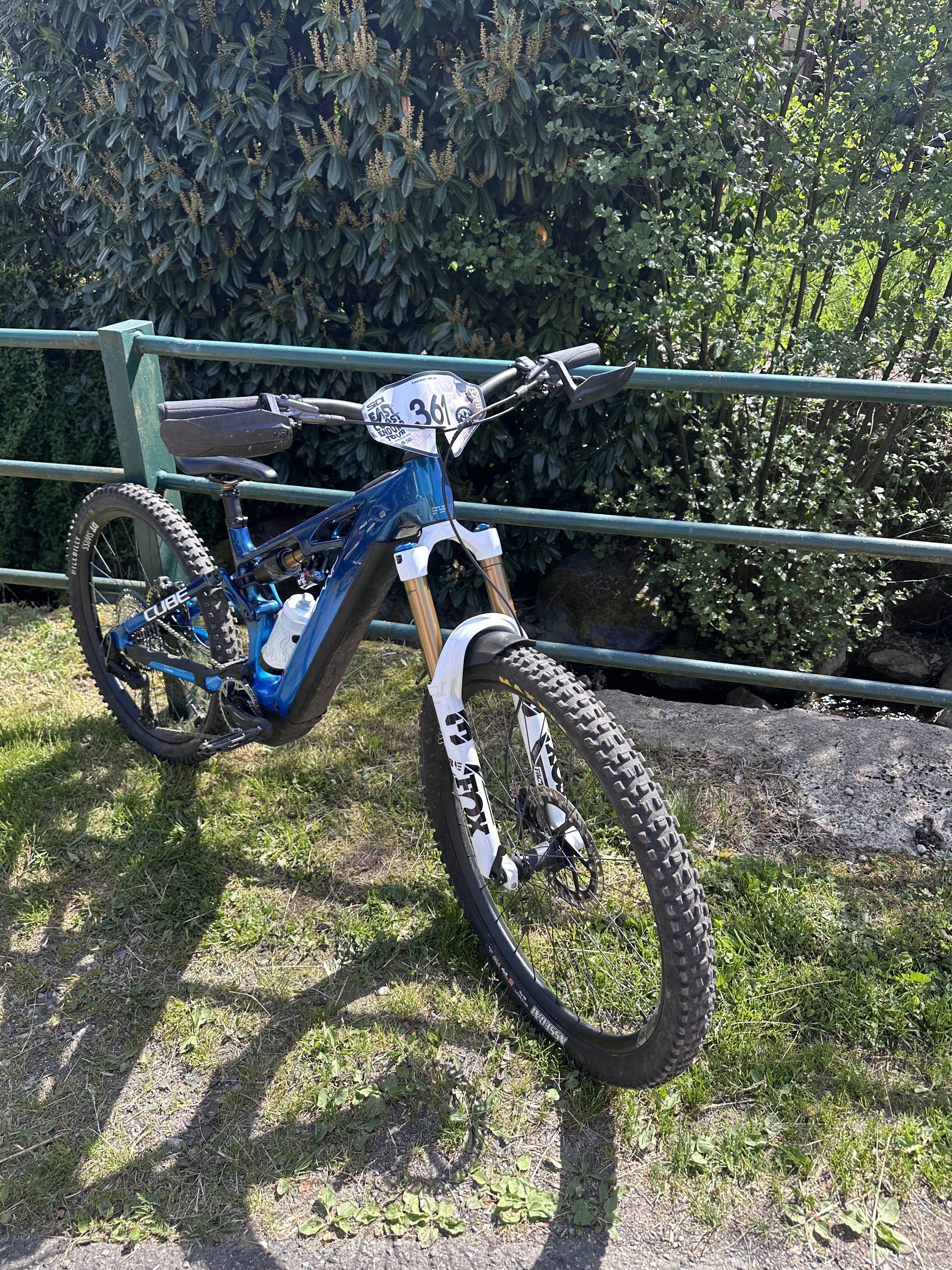

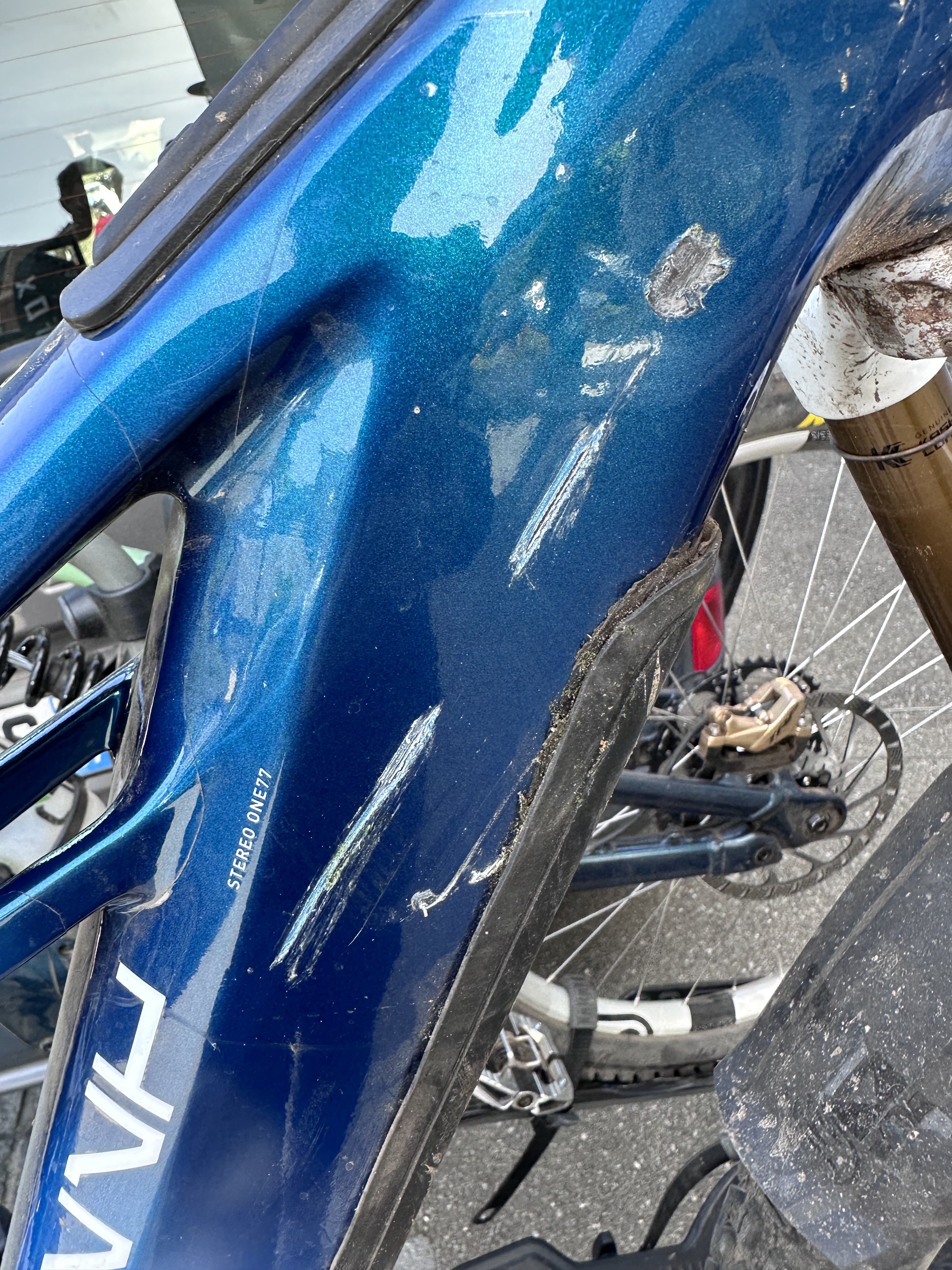

Hello Guys,

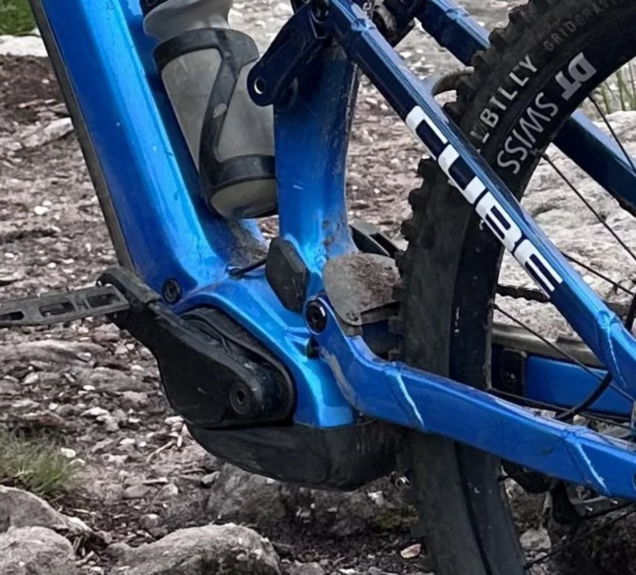

The Bike is quite Nice but I think i Will put a dhx coil shock.
It's really really.low in term of bottom bracket event with the 140 mm cranks I had a lot of issues
I destroyed the engine cover in plastic do you know if we can find a stronger protection ?
And I had a bad crash (I'm ok) but the Bike is damaged 😞
View attachment 159832 View attachment 159833
I also joined the crash club today, first high speed crash of the season 😁 luckily no casualties and even the bike is ok, except the derailleur hanger, new + spare ordered already.. People, wear your protective gear! Luckily I had full face helmet and upper body protection + neck brace.

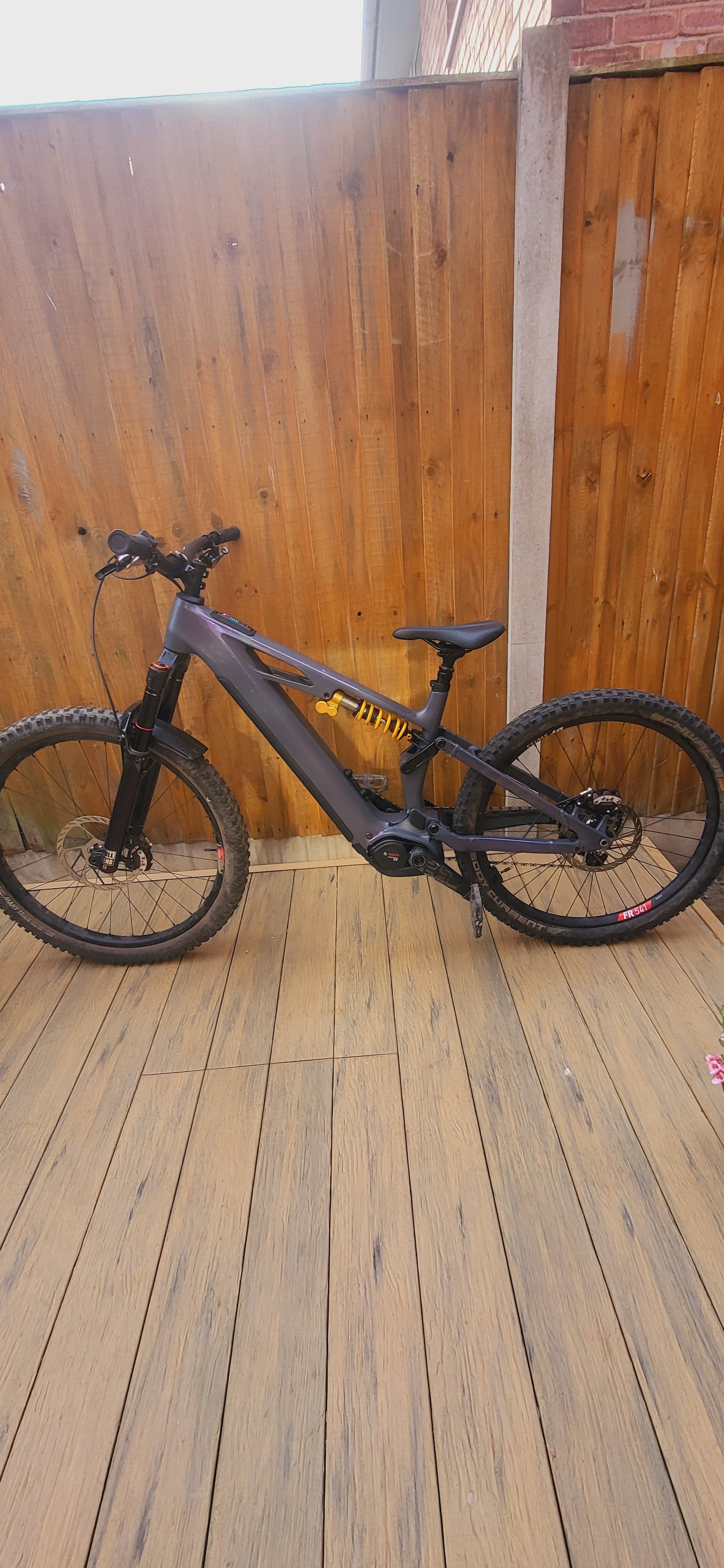

Done mine today, changed almost all the parts for itbut got it lowest pces becauseof that. Question: anyone know what size rear shock bushings do i need ? I want to change because removed from stock one just want to get newones for ohlins coil, just need to play with setup had first ride rear felt a bit flexing not sure if i like that, but definitely jumps better and more playfull than my old trek rail, well tomorrow proper of piste ride will put it to the proper test. So far i like it. Nonoises from battery or frame maybe because i just rebuild it :D
View attachment 161176Done mine today, changed almost all the parts for itbut got it lowest pces becauseof that. Question: anyone know what size rear shock bushings do i need ? I want to change because removed from stock one just want to get newones for ohlins coil, just need to play with setup had first ride rear felt a bit flexing not sure if i like that, but definitely jumps better and more playfull than my old trek rail, well tomorrow proper of piste ride will put it to the proper test. So far i like it. Nonoises from battery or frame maybe because i just rebuild it :D
Nice setup 👍
Maybe a few words about the selected components?
Yeah, yoke is not a friend of coil shock.

Thanks, i have chamged to from Zeb ultimate 3.1, with rmp cartridge, sram maven ultimate brakes, sram x01/xx1 11speed setup because of weight also carbon wheelset just rear changet to this i had it, carbon cranks, tyres MM radial front rear ill use provably different than eddy current just heavy and not so much of roling my liking. I mainly ride of piste trails, steep technical DH tracks, jumps, fast trails etc. Bike handles good everything apart maybe not having momentum as 29er had i bit missing that but maybe because of coil setup, so thinking maybe to go and try air shock maybe like vivid ultimate...
