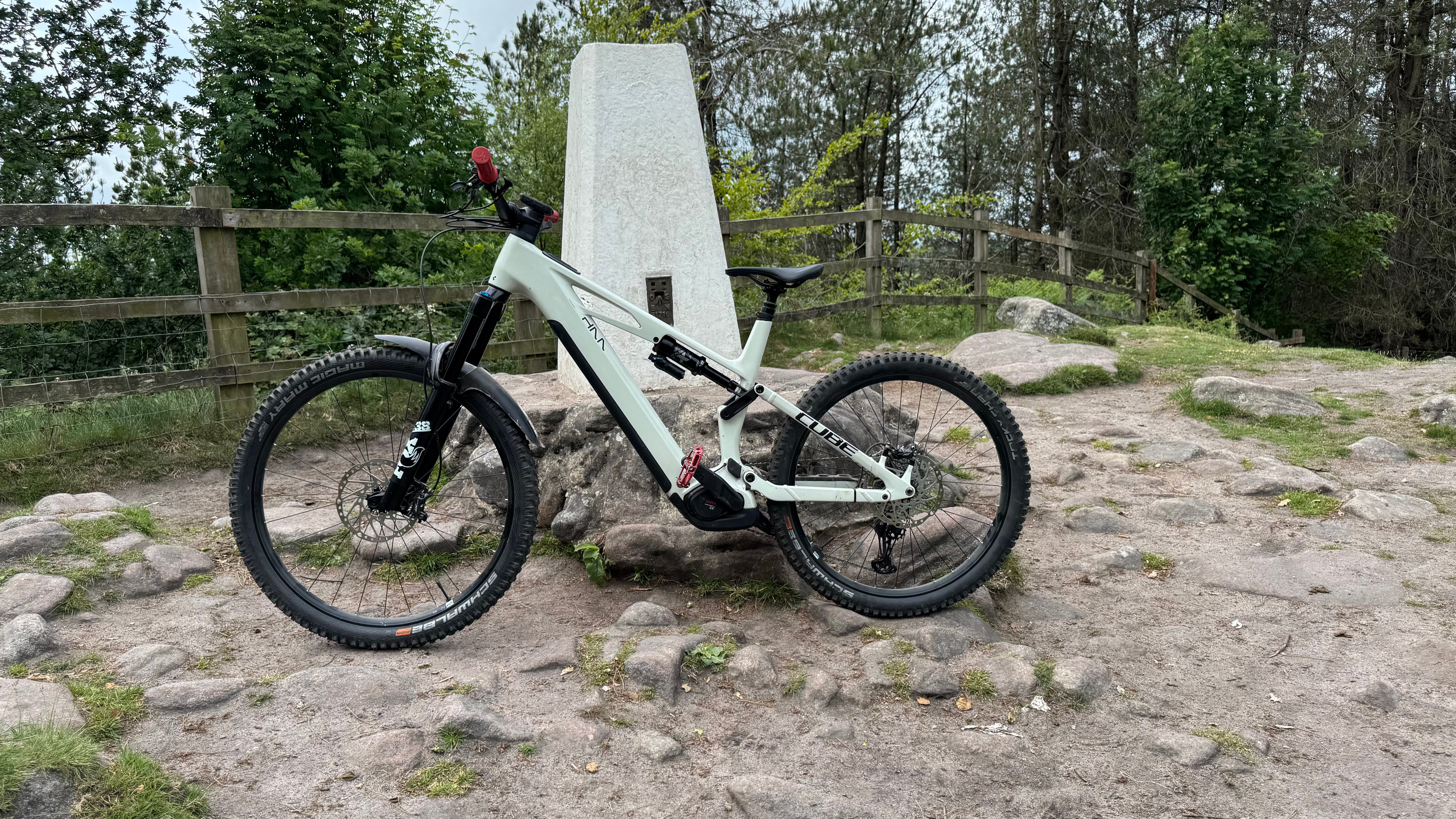

These are my favourite type of trails and it rocks.
I use 145mm cranks and dh sidewall tyres and I’m very happy.
A handful of KOM’s on dh biased trails but, more importantly, having an absolute blast.
Where do you ride?
My common haunts are off piste Risca, Brechfa bike park, Nant Yr Arian, Afan Masts and Coed Y Brenin.
A lot of natural, hand cut, gnarly, tech stuff.
No videos though, sorry!

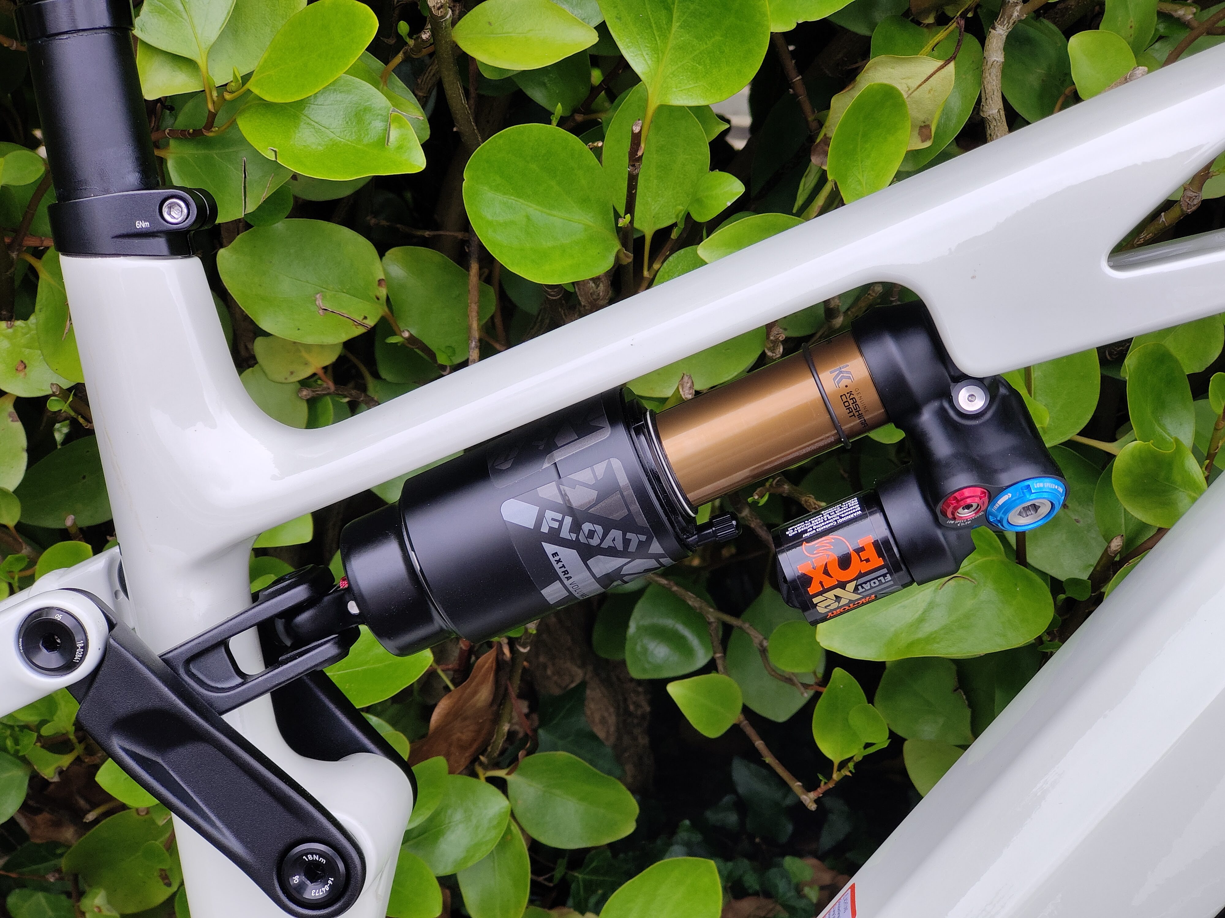

Hi, I'm having a noise coming from the shock absorber bolt. After greasing it, the noise goes away, but when I go out for a bike ride, the noise starts again.
What could be happening? Could it be that it loosens a little? I give it the Torque of 14nm.
Use thread lock and torque to spec. That’ll do the trick
  • Like
Reactions: JVC
Think I did mine to 14nm and the noise went away. It’s been fine since.
I also use a Torque of 14nm. But the only explanation i can find IS that the perno comes loose and that's why the noise come back
It's the one above that's making noise
The bolt is under pressure when the shock has air in it essentially. Take all air out so that it’s not exerting any force on the bolt and then torque it. You get a false torque reading on any bolt that has lateral load applied.

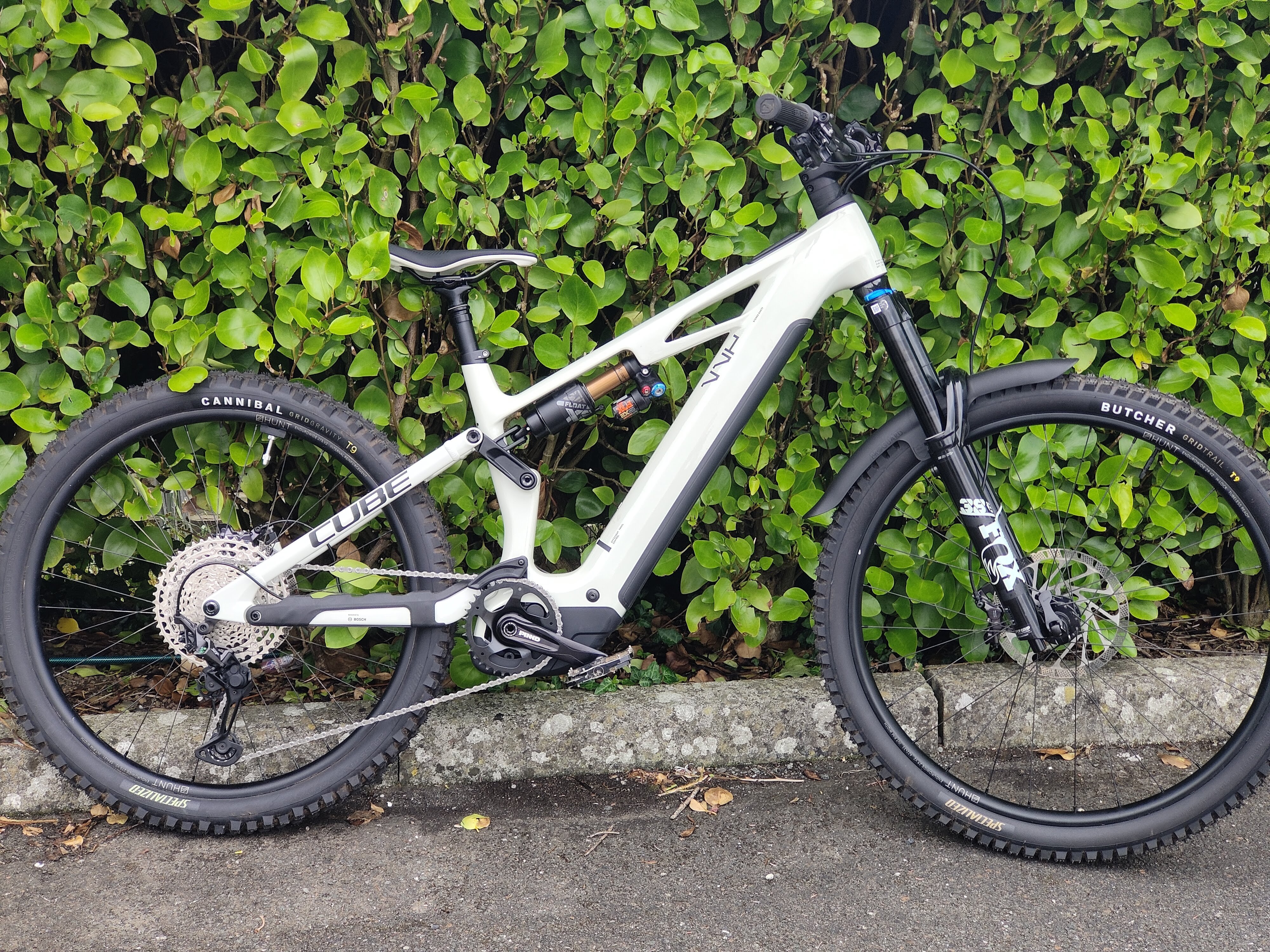

Hi everyone

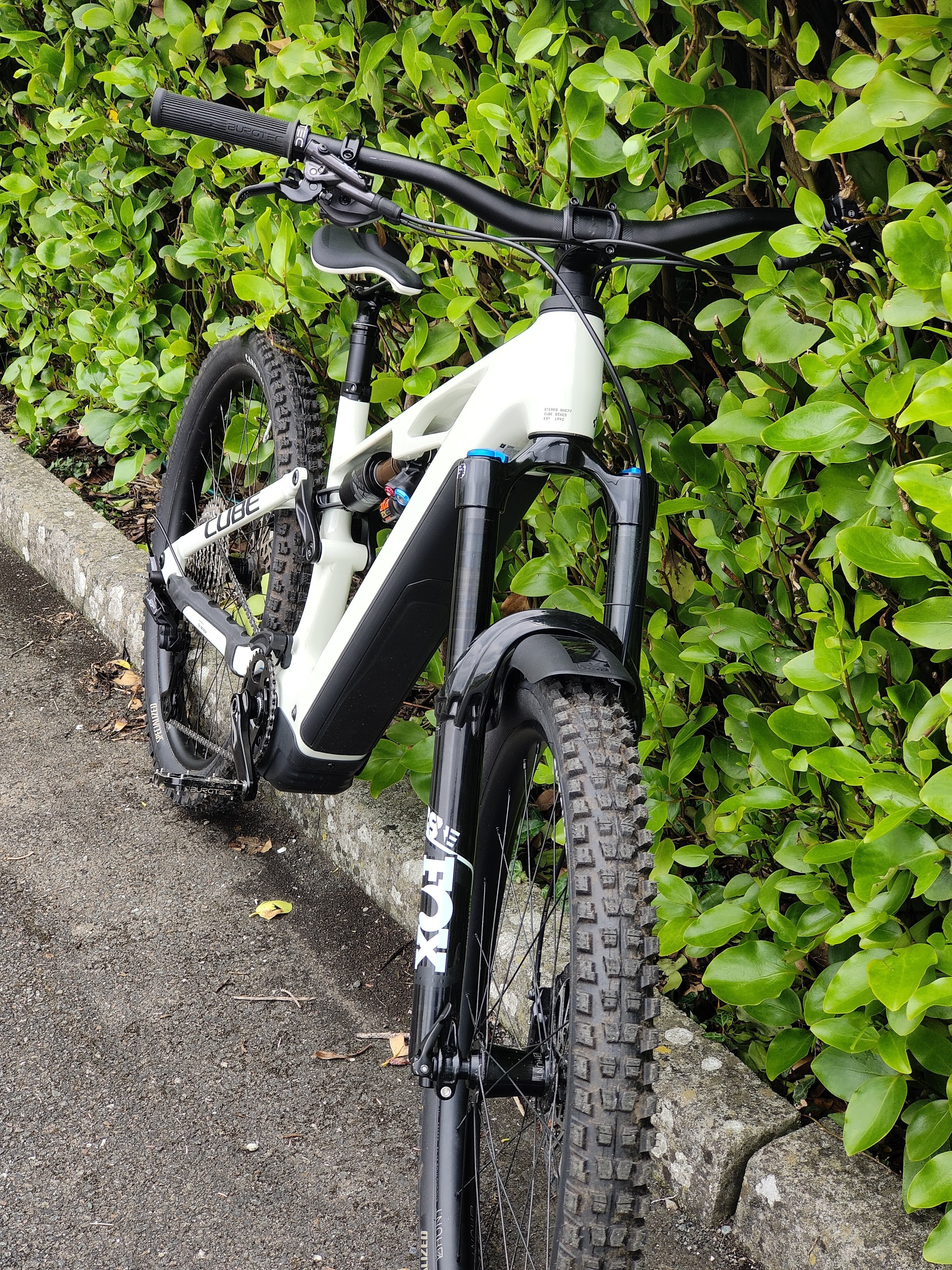

First time post here. I've been lurking in this thread for the last two weeks & want to thank everyone for sharing their experiences of owning this bike.
I've pulled the trigger & got myself an SLX model which is my first E bike. Been riding a Specialized Status for the last five years.
Got my bike delivered on Friday & have spent the weekend setting it up.

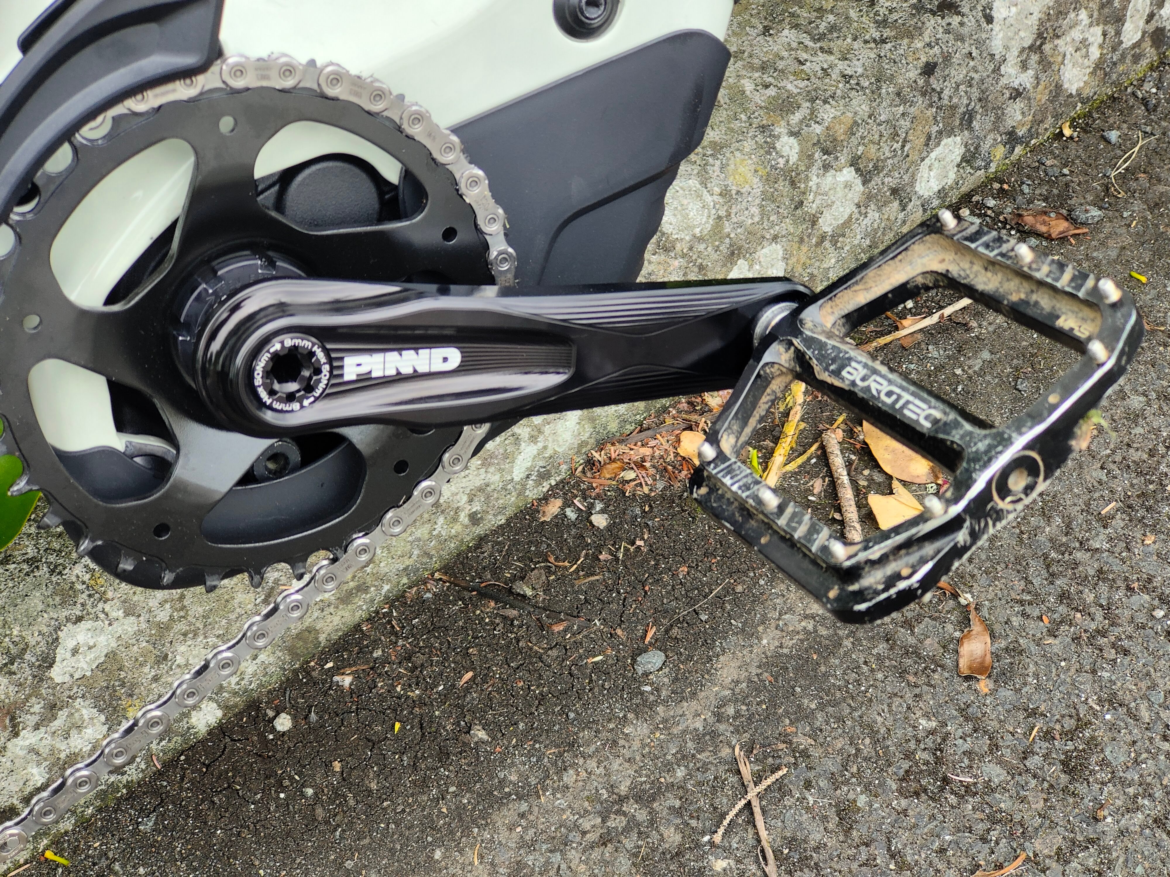

Based on frequent comments about the low BB, I have fitted a pair of Pinnd 145 mm cranks & I've upgraded the shock to a Fox X2 which was originally destined for the Status.
I've not ridden it yet as the weather has been dire for the past week & the trails are minging. Got Ride Wrap on order so will get that applied to the frame first.
This spec of the bike is excellent value considering the cost of most E bikes nowadays.!
Here's a few pics. Can't wait to ride it.
IMG20250615154701.jpg IMG20250615154715.jpg IMG20250615154737.jpg IMG20250615154757.jpg
Does it feel weird riding with short cranks? Can you still pedal properly to the top?
