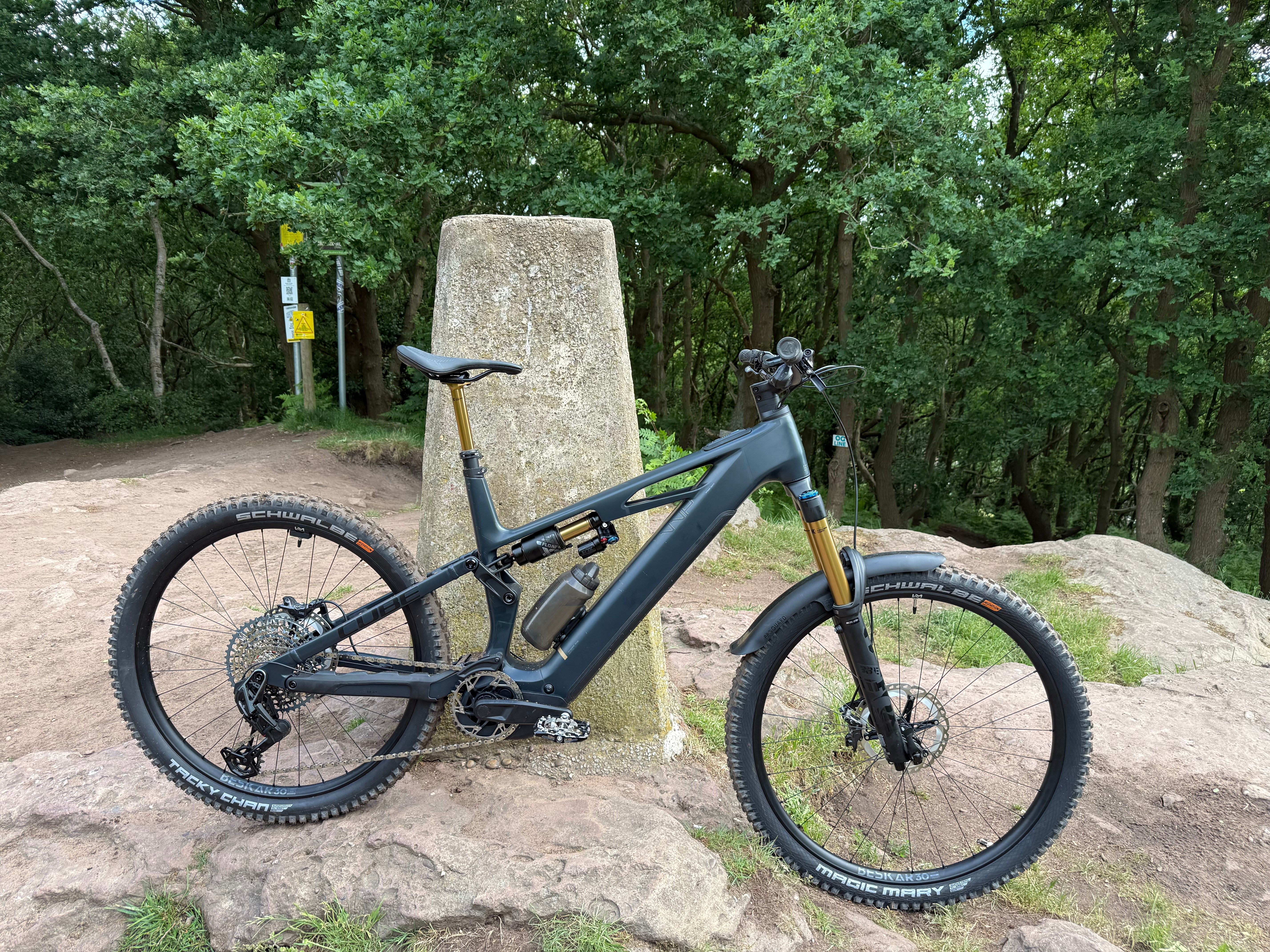

Finally got my AT variant in XL this weekend (having reordered, as the L I originally ordered felt a bit too small). I’ve only managed to do a few laps at my local trails and feels good so far; definitely happy with my choice. There’s definitely a ‘sit in’ the bike feel now I’m on the XL, and it handled the steep off piste side of the hill with ease. The jumps weren’t completely squashed either. There’s definitely more tweaking of the suspension settings needed though; the Fox recommended start points are OK, but I know things can be better yet (I have borrowed a Shockwiz, so will tweak things later).
Reflecting on some of the idiosyncrasies already mentioned in this thread., the creaking from a loosening rear shock mount bolt was alive and well after 45 mins of riding; that feels like it will need some thread lock in due course. A fallen thick branch across a return trail was a good test for ground clearance. BB height measured at just over 330mm, so it is 8-10mm lower than my Sommet 290 CRX, but the One77 seemed to be a similar ‘feeling’ clearance over the log. I only ever noticed hitting cranks on some corners on climbs, but I think that’s largely just my lack of skill on an eMTB. The battery securing bolts seemed solid; so maybe someone in the factory or my LBS adjusted things before I got the bike. All in all, minor niggles only.

I’m very lucky, Hemlock is genuinely my local at only 1km from my door. I’ll keep an eye out for another One77 up there!
Finally got my AT variant in XL this weekend (having reordered, as the L I originally ordered felt a bit too small)....
that looks really nice. I think the AT in XL has a 210mm dropper, whereas my SLX in XL came with only 170, and I'd like to go longer. How are you getting on with that 210 - is the outer at your chosen position, or is that as low as it will go? Oh, and what's your front mudguard?
I think it’s a pro guard xl. Could be wrong tho. I’m 6ft6 and find the 170 just right for me, I might try a longer one when I upgrade.
I am also thinking of 'upgrading' the dropper post to a PNW Range 200mm on my large SLX so I can have the dropper all the way down when I need it. Currently I have too much of the outer base raised to fit me properly (I'm 6'1" 32 inside leg). I need to check that the base will fit all the way down first.
Yes, the Fox Factory Transfer that comes with the XL sized AT is 210mm drop. In the picture it’s not fully extended, as aesthetically the seat looks better when it’s kept roughly level with the top of the bars. The AT in a L comes with the 170mm FF Transfer, so that was a definite plus when I found I needed the larger size (although I’m very used to 170mm, as that’s what was in my Sommet 290). Is 210mm better than 170mm; of course!
Aesthetically the bike would look better sat on flat ground but in reality it would show how slack the frame geometry is and nobody really wants to see that....😄😁
Yes, this one is a bit closer to flat and things do look way slack, even if the iPhone has otherwise distorted things in the shot; I’m fairly sure the wheels are still round :D.
I guess what most of us see is the bike when we ride it, so maybe this short video I’ve added to YT, from some quick laps at Hemlock today, is of use. Btw, the creaking sound riding up is my helmet’s mips layers rubbing rather than the bike - I did add some grease and thread lock (not in the same place obviously….) to the lower shock bolt, which has sorted the noise I got yesterday.

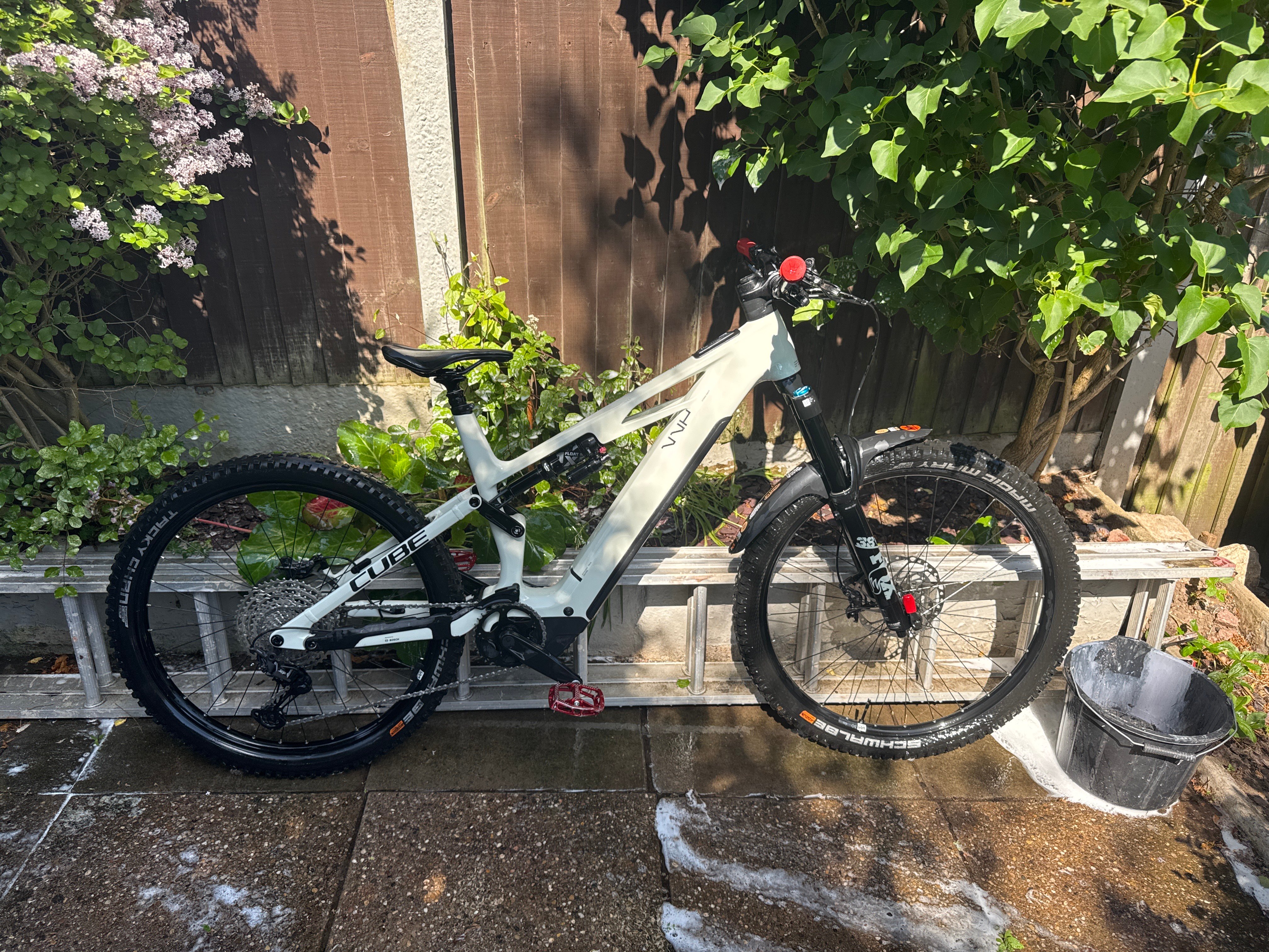

Lovely bike. I’ve spent the morning over at the Goyt valley, bike was mega, even on the bigger drops.
Definitely not as high spec as yours but still a cracking bike Looking forward to my upgrades being fitted
No, that white SLX model looks good too; I was very tempted by one of them. The decider for me was that I knew I’d want to upgrade the suspension and dropper post, so when I added that together the AT version made sense.

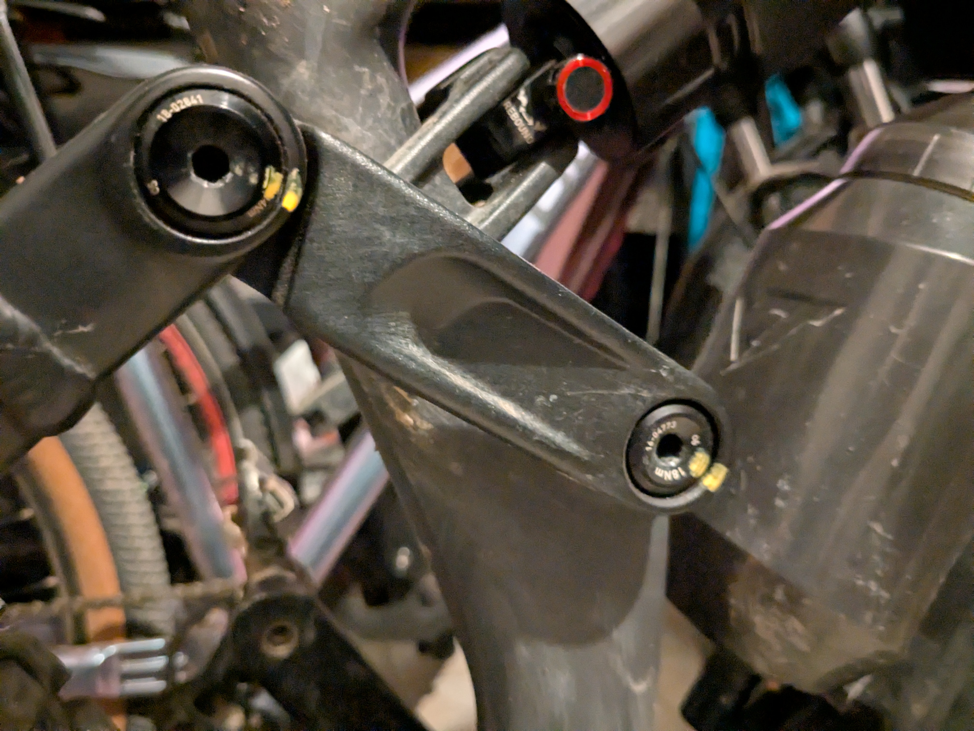

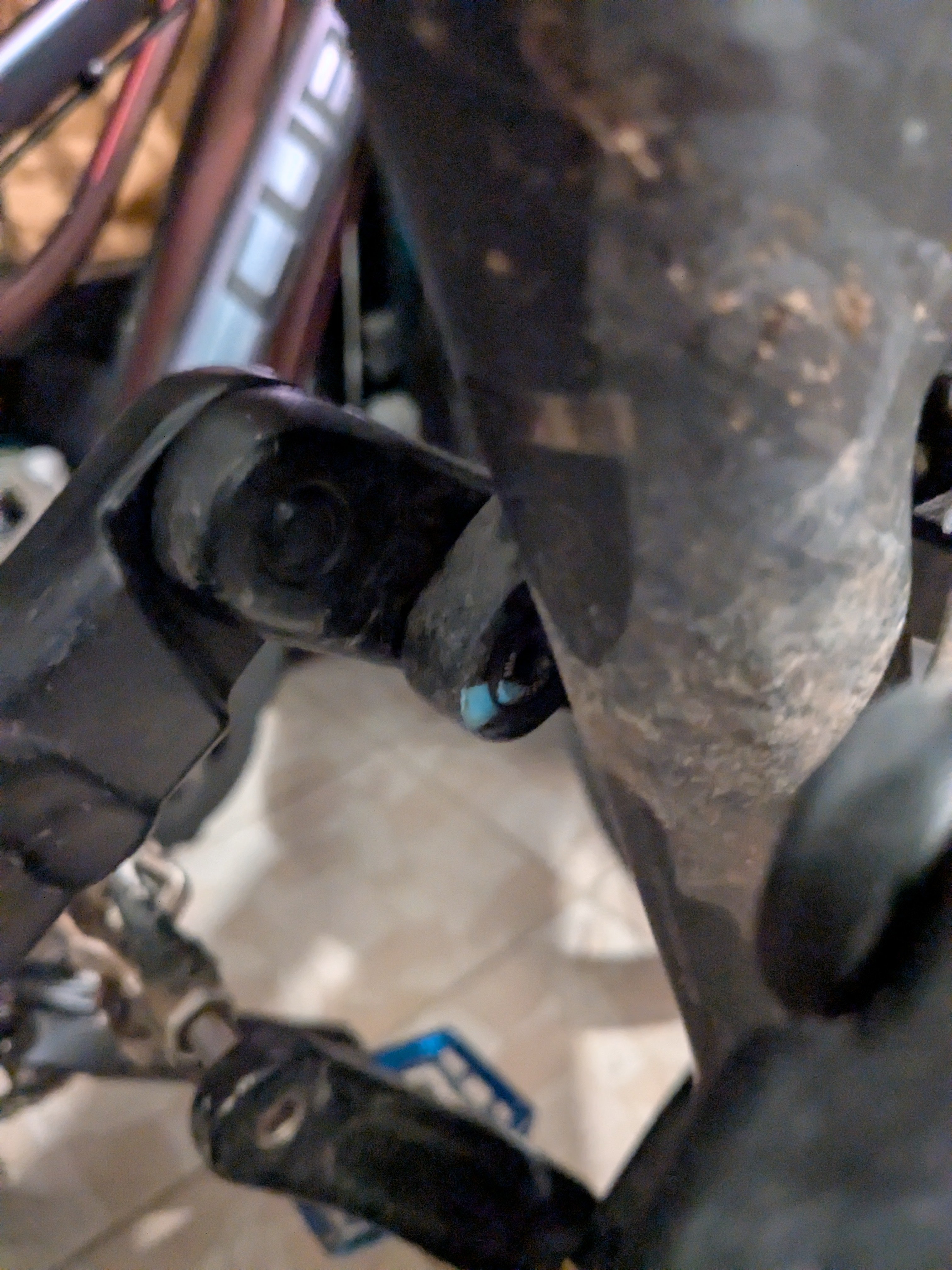

Caught it just in time I think wow
T
How come Cube say the bikes made for a coil and air shock?
You’ll just need to check. The DHX2 stancion is thin and they don’t work well with a yoke. If it gives way it’ll break the frame, that’s a coil that wouldn’t be covered, the DHX however probably would be.

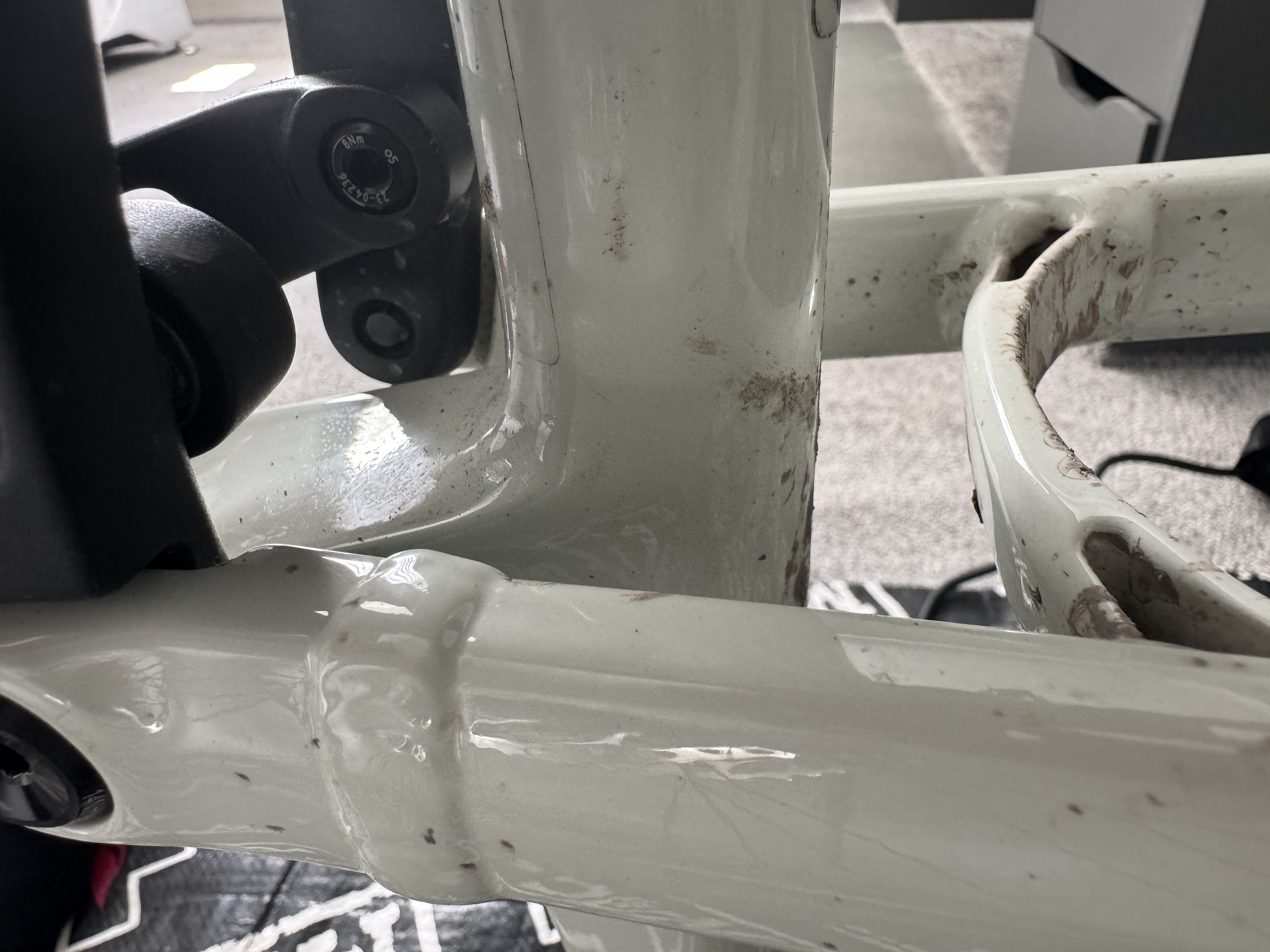

Gutted at the damage you guys have had.
That bolt came loose on my bike 2 weeks after checking it, within the first 3months of ownership. If you have a creak, and have tightened the rear shock mount, it could be one of those bolts hidden by the seat tube.
I recommend marking all your bolts on the bike with a small paint mark to easily check that the bolts are lined up and not coming loose:
