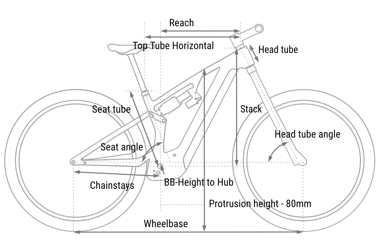

What really matters is BB height from the floor, which Cube does not quote.
Manufacturers quote BB height in order to be more accurate when accounting for tyre variations, however this has become a problem due to different wheel sizes, especially MX.
Cube quote a 13mm drop which we assume means from the rear wheel 27.5 axle and based on other bikegeo charts should result in a roughly 340mm BB height. This would be borderline but ok.
My bike stock out of the box was closer to 330mm, the other issue is that this is a 170mm bike, so at sag and full travel it will be even lower than a lot of the 150/160mm bikes quoted above. A 2025 orbea wild is 2.5cm higher unweighted.
That said, yes there are other very low bikes out there: giant reign, canyon torque and strive on, recently announced forbidden.

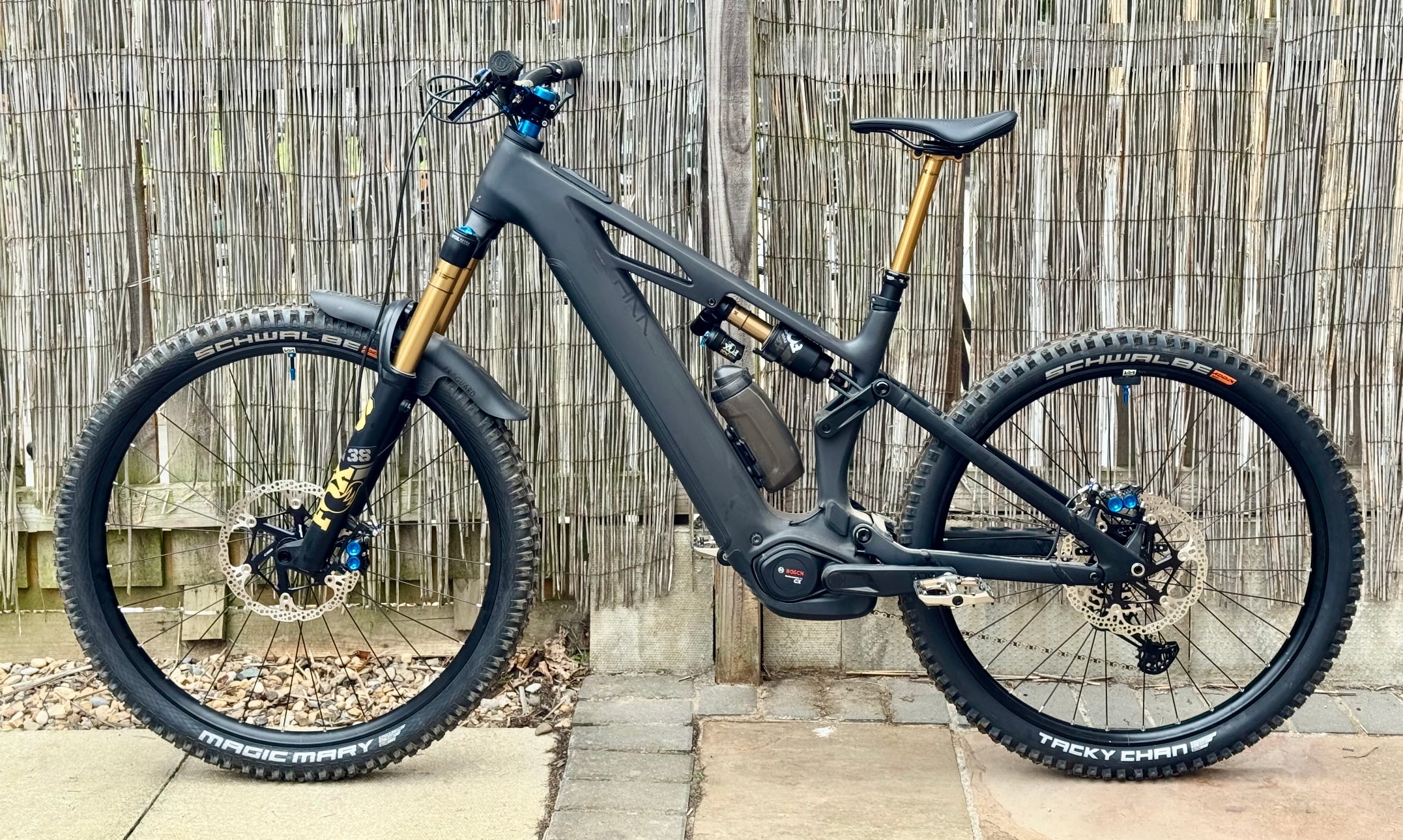

I left the tyres that were already on my replacement wheels, however I definitely prefer the latest Hillbilly on the front to the Magic Mary.
Currently running the Big Betty on the rear until it’s dead then I’ll fit the Tacky Chan but I’ve also got a radial Albert waiting on the shelf and another part worn Big Betty.
Pretty spoilt really.

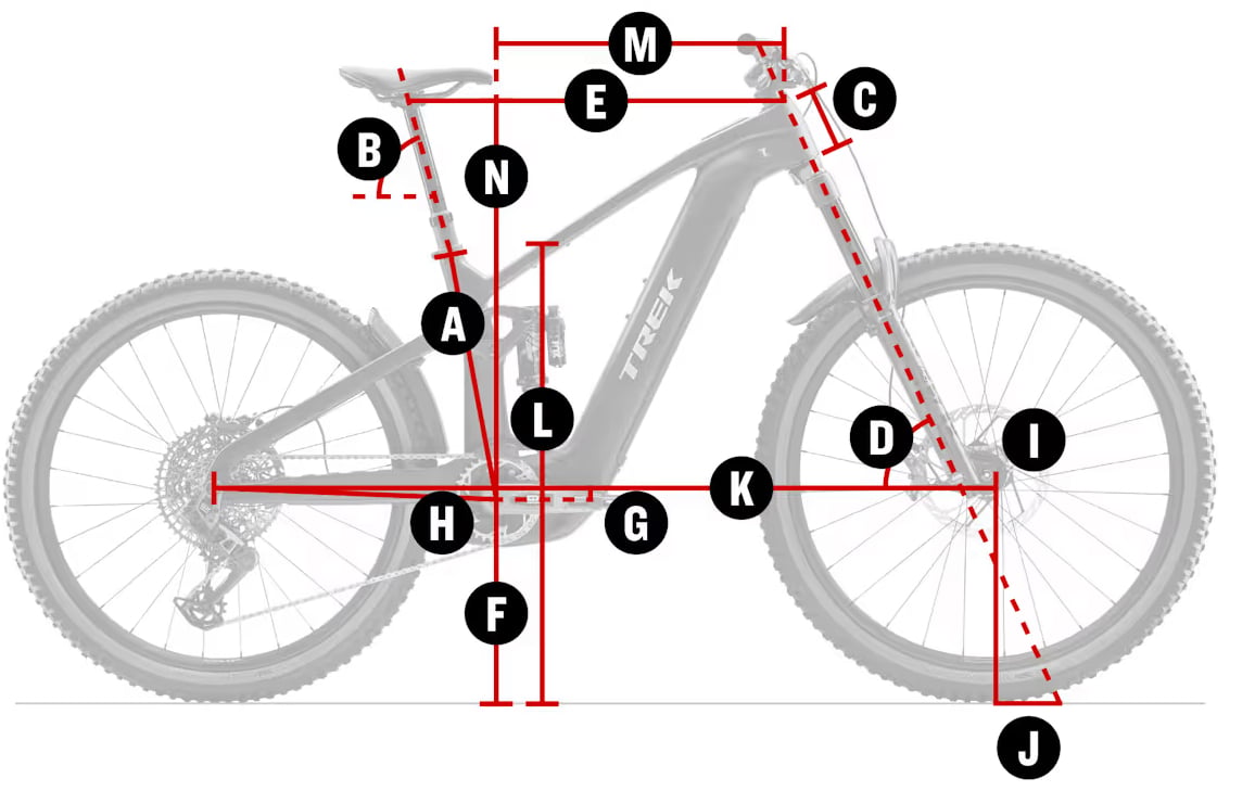

From all of the geometry charts, the BB drop is measured from a line through the front and rear axels, so with an MX that line rises from 27.5 hub height at the rear to 29 hub height at the front, so where the BB is along that line should be slightly above the height of rear axel. With the nominal height difference between the hub on the 27.5 rear to the hub on the 29 front being about 19mm, and the axels are the wheel base distance apart (1269mm), and the BB should be the chainstay length (443mm) along the line, then the line where the BB drop is measured from should be 19 x 443/1269 = 6.6mm higher than the rear wheel hub. Not massive, but every little helps.
The extra travel (front and rear) on One77 vs the others mentioned is certainly another factor that will add to the lower real height once loaded.
I’ve also replaced the cranks to shorter ones, but IMO the biggest change one can do is the way you ride and line choices.
I realise the low BB, way lower compared to my hardtail, but just observe the trail ahead and it shouldn’t be too much of an issue.
From all of the geometry charts, the BB drop is measured from a line through the front and rear axels.
I am curious about this: I have never seen any geo chart that specified this method of measurement, and anytime something is specified they refer to the rear wheel, or give the drop from both wheels.
If they were indeed measuring the true BB drop, then based on your numbers we would expect the stock BB height to be around 346mm high, which is quite a bit above what most of us are measuring.
As someone above mentioned, every mm matters, simplifying quite a bit (travel and crank length ignored), over the past 15 years racing enduro bikes, personally:
Hmm, that does seem the specs from Cube are off, if we assume the rear wheel diameter to the outer edges of the tyre are actually 27.5”. ‘Theoretically’ 27.5” is 698.5mm, divide by 2 and that’s 349mm from centre of rear hub to edge of tyre. Subtract the 13mm from the 349mm gives 336mm. But given we ‘should’ be able to add 6.6mm as the height to the line between hubs, that gets us to 343.6mm. Thus 330mm actual is lower than expected.
The Cube and Trek geo diagrams show this slightly differently (not super clear), so I am probably wrong in adding the 6.6mm:
The Giant had something like 325mm BB height in "low" flip chip, and 330mm in high which is what you had to use. I broke 3 sets of 155mm cranks on it in rock gardens despite running 2.6 tyres and 180mm fork, last one resulting in a massive crash and concussion, so baby cranks for me from now on until I find a bike with reasonable BB height.
Copy pasting from myself in another thread:
Out of the Box: BB height 334mm
2.6 tyres front and back: +3mm, BB 337mm
+ Headset cups in steep mode: +2mm, BB 339mm, HA 64.4
Theoretical numbers as it will void your warranty:
+ 190mm fork: BB 345mm (head angle 64degrees with steep cups)
2mm Offset bushing "the wrong way": +4mm at the BB, this would be perfect, plenty of clearance, but they rotate in a single DH run ending up in the -4mm position. This confirms to me that a +3mm clevis or yoke would fix the entire bike.
My bike shop said the giant was still under warranty with a 180mm fork, but Cube are pretty clear on their website that you can't use a longer fork without voding the warranty. So if you were going that route, might as well go all the way to 190mm. With the cups in steep HA mode, you will be pretty much at stock geometry up front so no additional constraints on the frame.

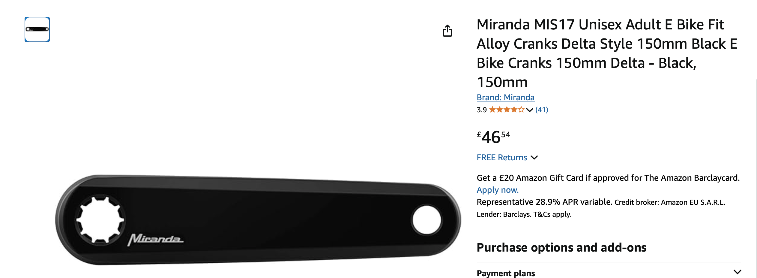

I've got some miranda 150mm cranks on my one77 and definitely have less pedal strikes on my usual trails compared to the stock ones
have you got a link for the ones you bought please - or would these be the ones?
