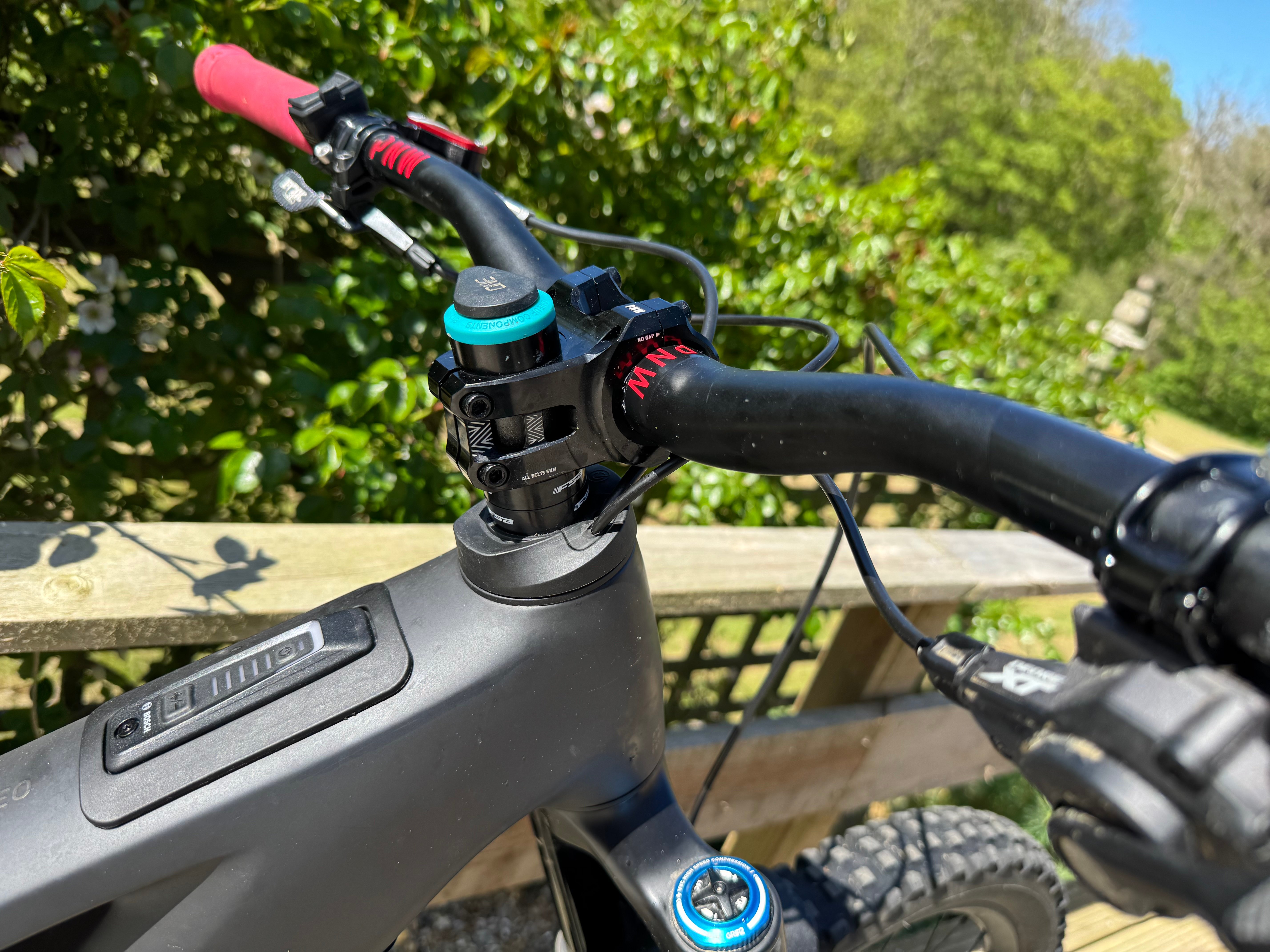

Wondering if I will get some advantages to change stem from stock (50mm) to 35/40 mm...? ...
Maybe twitchier steering? Do you actually need shorter?

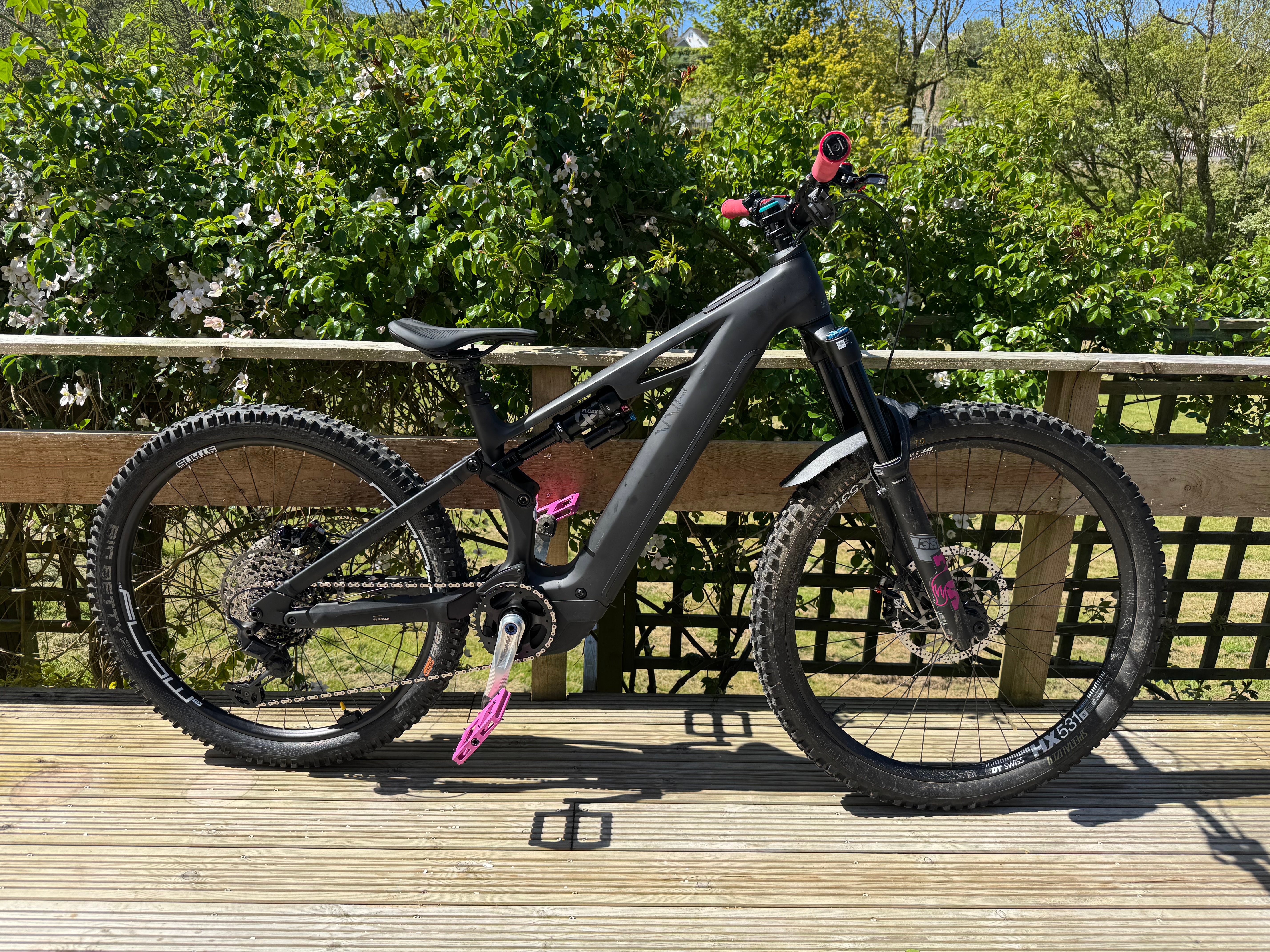

Hi all, help needed. I picked up my new One77 yesterday and straight away stripped it to change forks, brakes and gears.
I’ve also re-routed the rear brake cable to exit on the RH side of the headset because I’m in the UK and run rear brake on the left.
Anyway, the headset is total pain in the arse, no surprise there, but I’m trying understand which way is steeper and if both dimples should face the same direction.
There’s conflicting information out there. Please can someone check if their factory installed, unmolested, bike has the dimples facing the same direction please.
Also, is the steering a little stiffer with integrated headset. Seems to be when wiggling the steering on the stand.
Thanks!

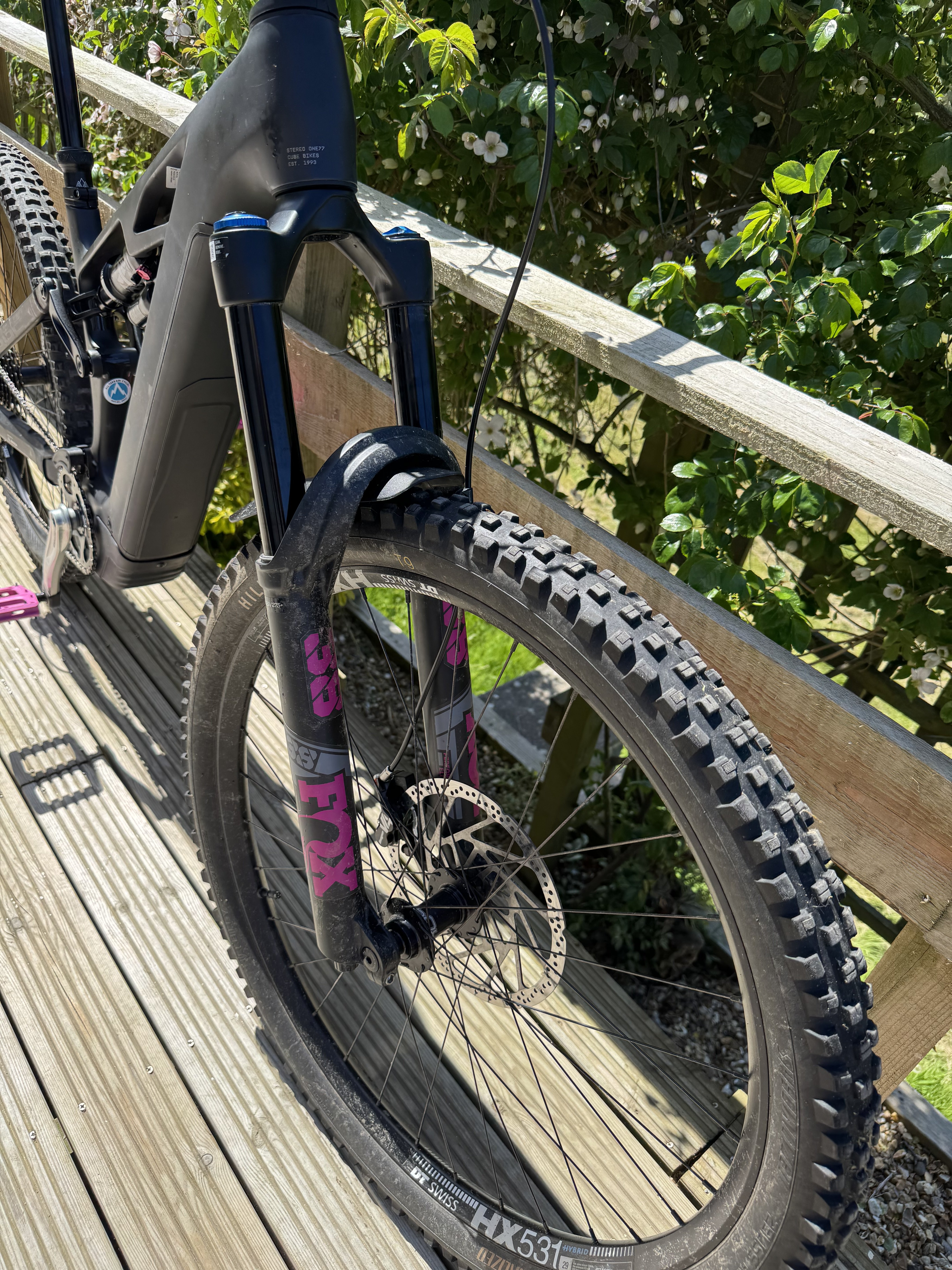

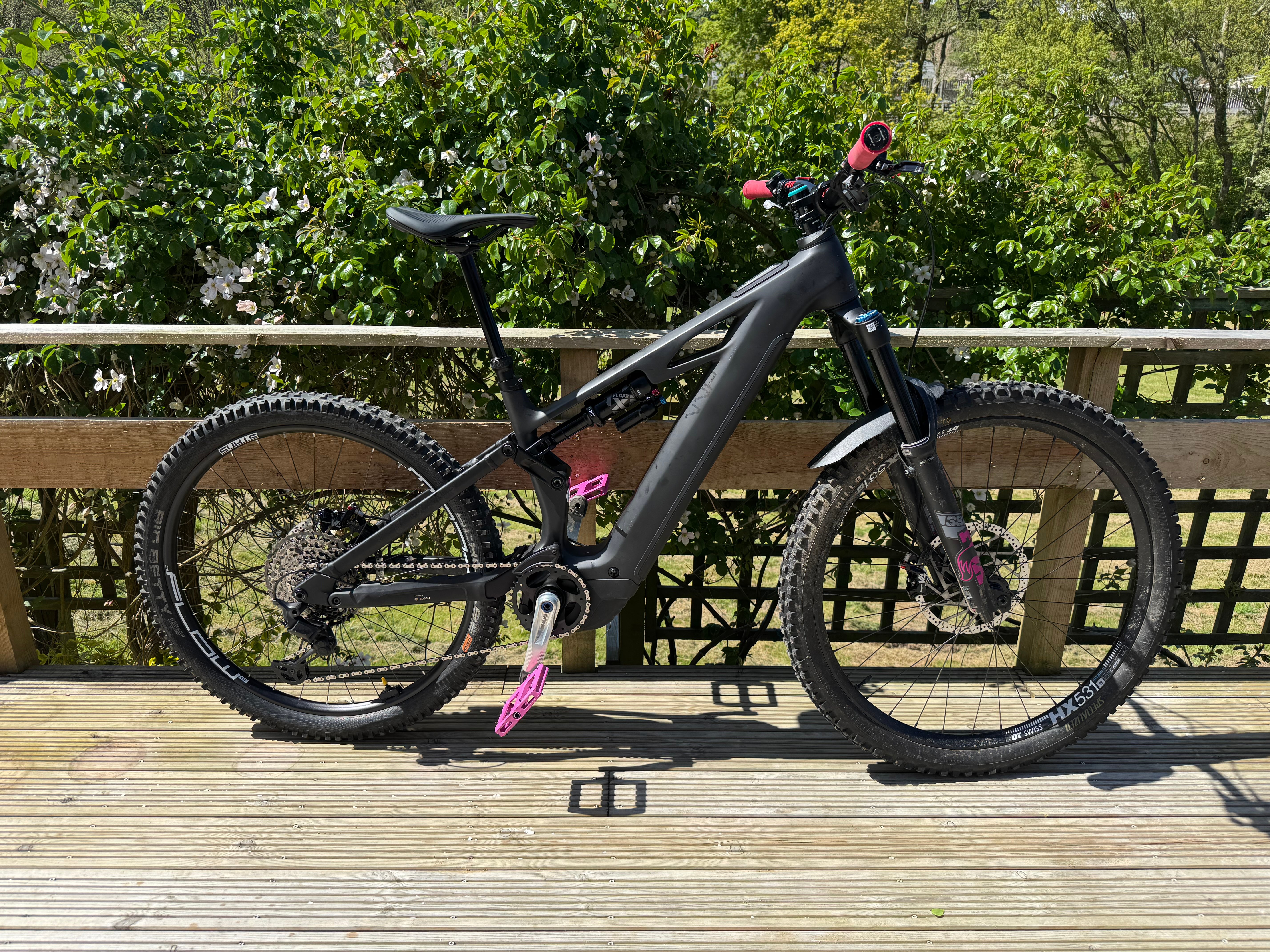

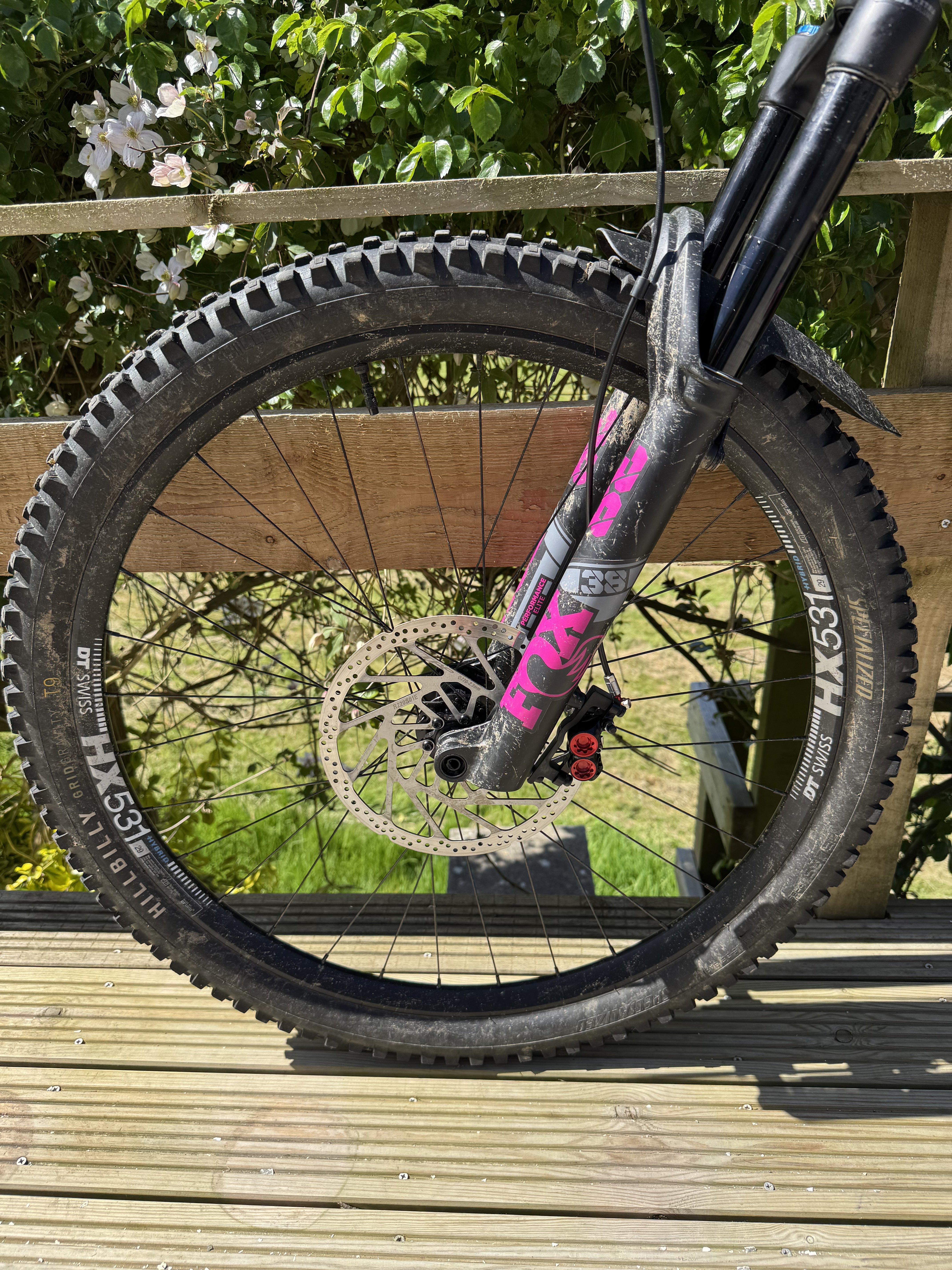

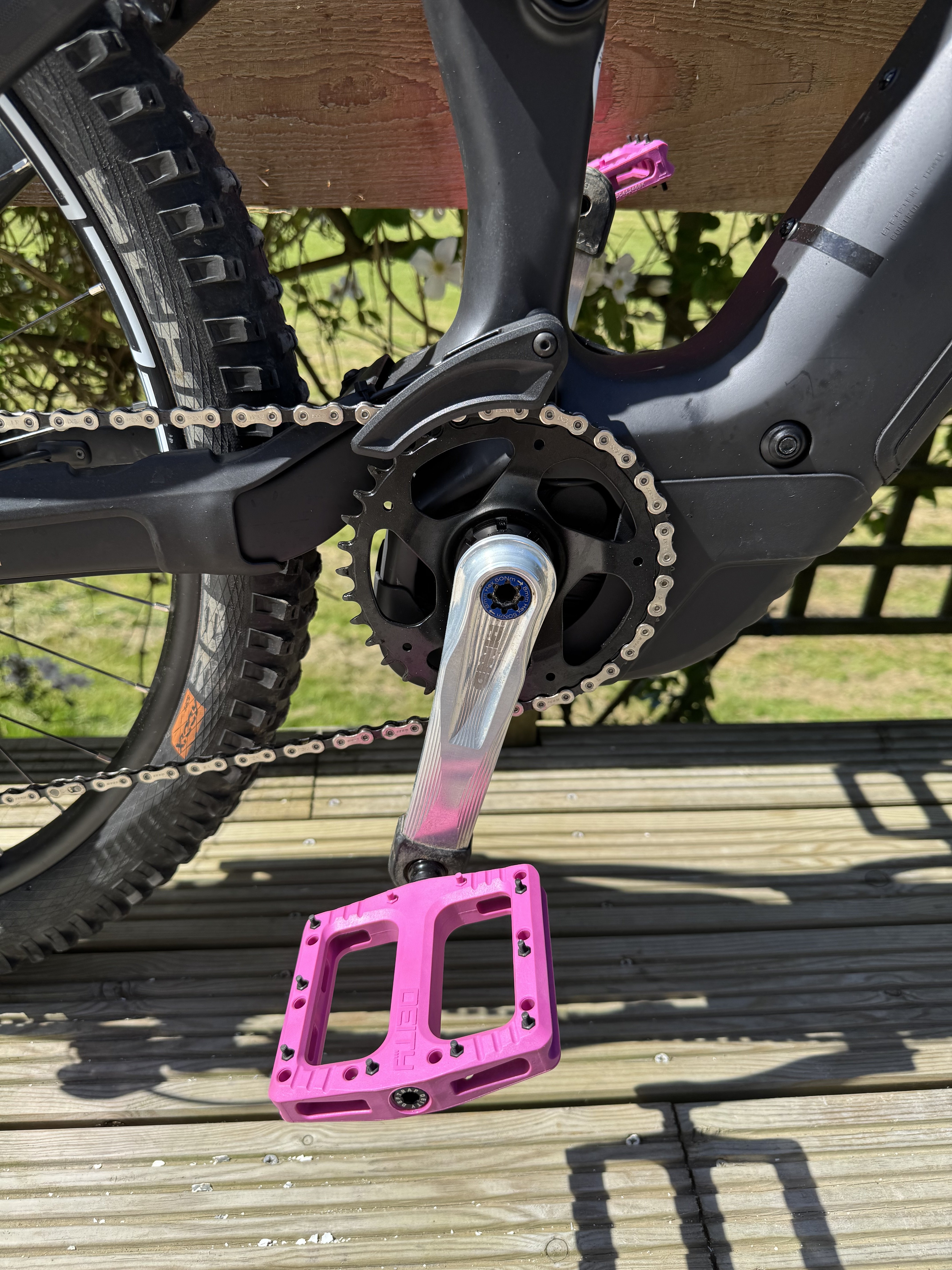

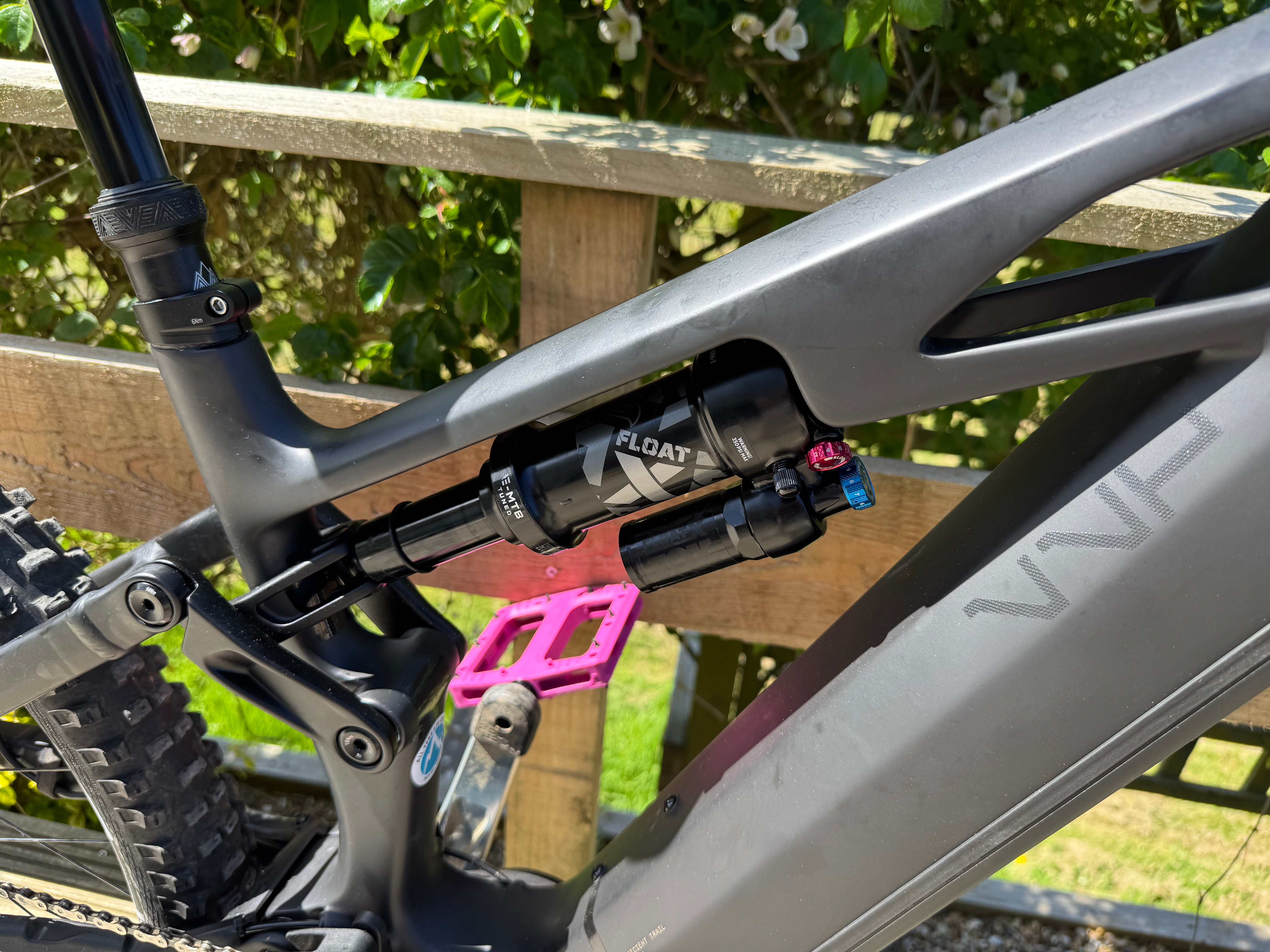

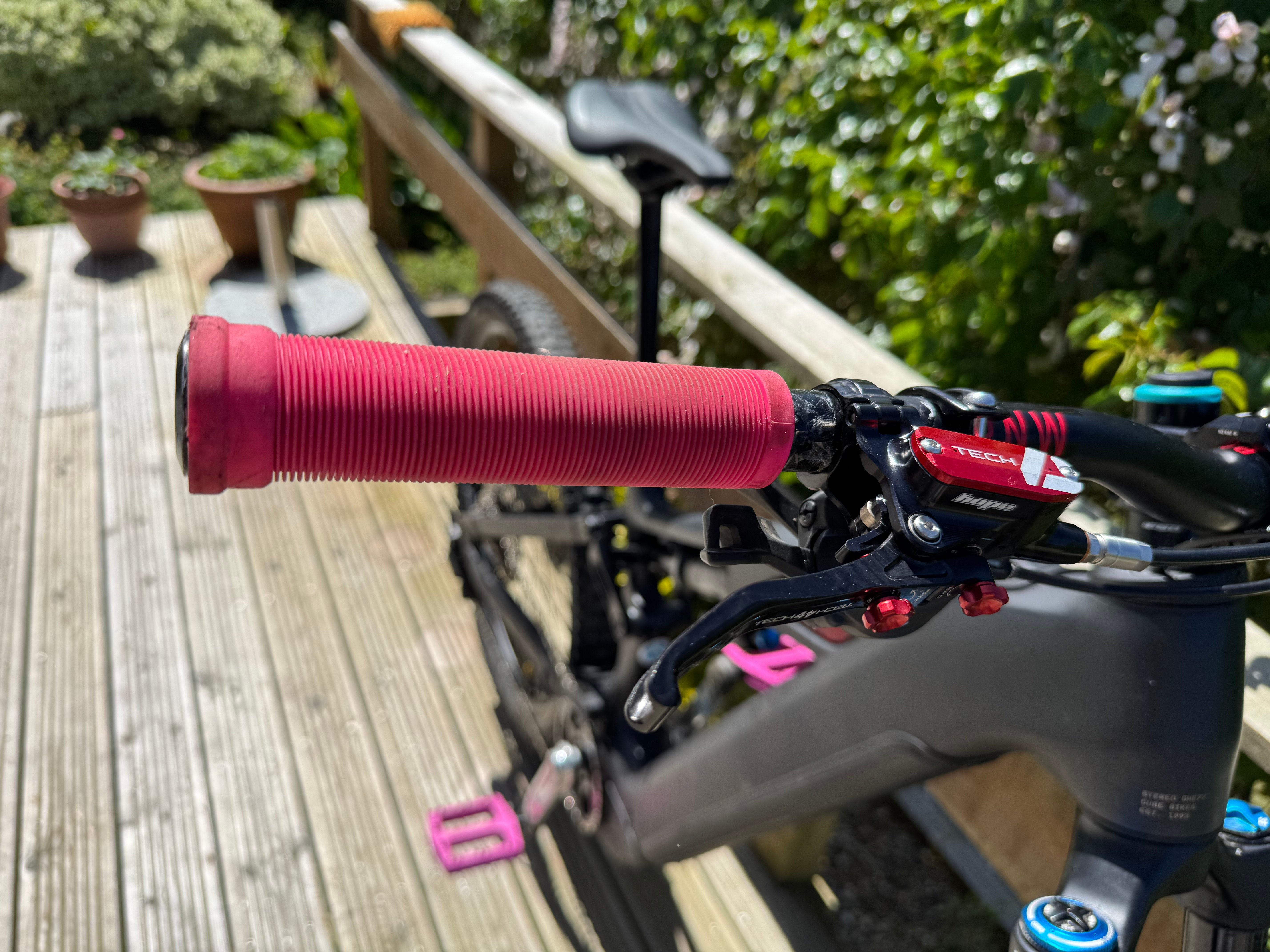

Swapped the forks for my existing Grip2 damper, new Hope Tech 4 V4 brakes with TRP 2.3mm rotors 220/200 front/rear, shimano XT 11S Linkglide, PNW bars, stem and 170mm dropper and added low speed adjuster to the rear shock. Finally PINND 140mm cranks and pink Deity pedals that the bike shop gave me for free.
And a different set of mullet wheels that I built. Stans Flow EX3 rear rim and DT Swiss HX531 front with Hope Pro 4 hub. Tyres are just what I’m currently running.
Only been round the block to bed the brakes in but it’s got plenty of pop and loving being able to run a 170mm dropper on a medium frame. Gets the seat nice and low, together with the mullet I can’t wait to hit the techy, steep, off piste that I love.
Brakes are very impressive, enjoying the modulation compared to my on/off Shigarus.

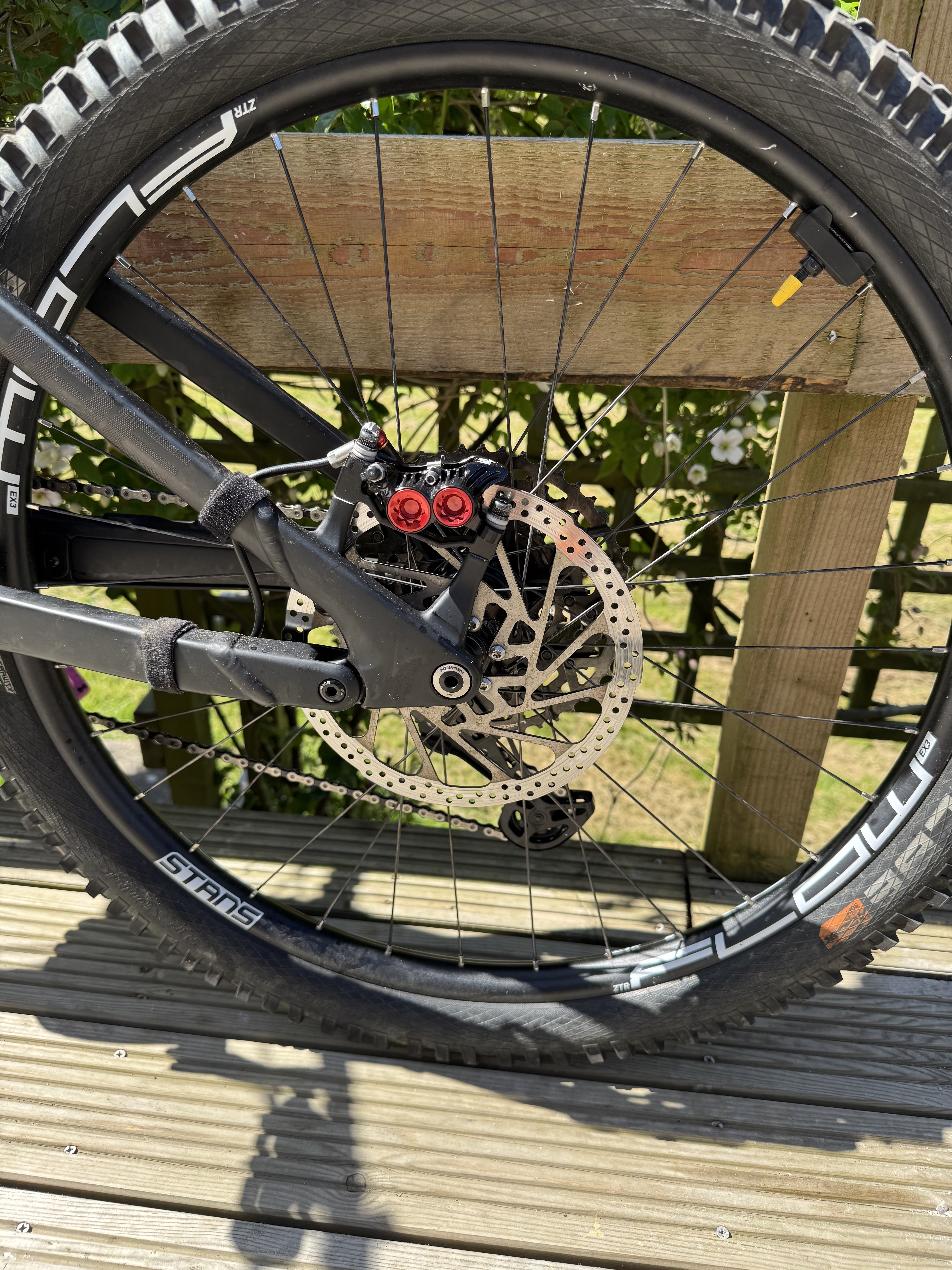

Anyone know how easy it is to replace the rear brake hose? Do i have to drop the motor?
Fairly easy. I removed the front motor mount bolt and loosened the rear which allowed the motor to pivot out of the way.
Obviously remove the battery and motor guard first!
If you’re leaving the routing the same through the headset then you’ll get away with the sram/avid connectamajig thing or whatever it’s called.
The Cube’s high tech internal routing solution is a crappy fabric sleeve!
I changed the rear brake line to exit from the RH side of the headset because my left lever is the rear. As a consequence I run the cable out of the sleeve and it was easy enough.
Be careful when you loosen the cable guide exit on the LH chain stay, don’t completely remove the small bolt because there’s a rear part that lives inside the chain stay. Stupid design.

It's really really.low in term of bottom bracket event with the 140 mm cranks I had a lot of issues

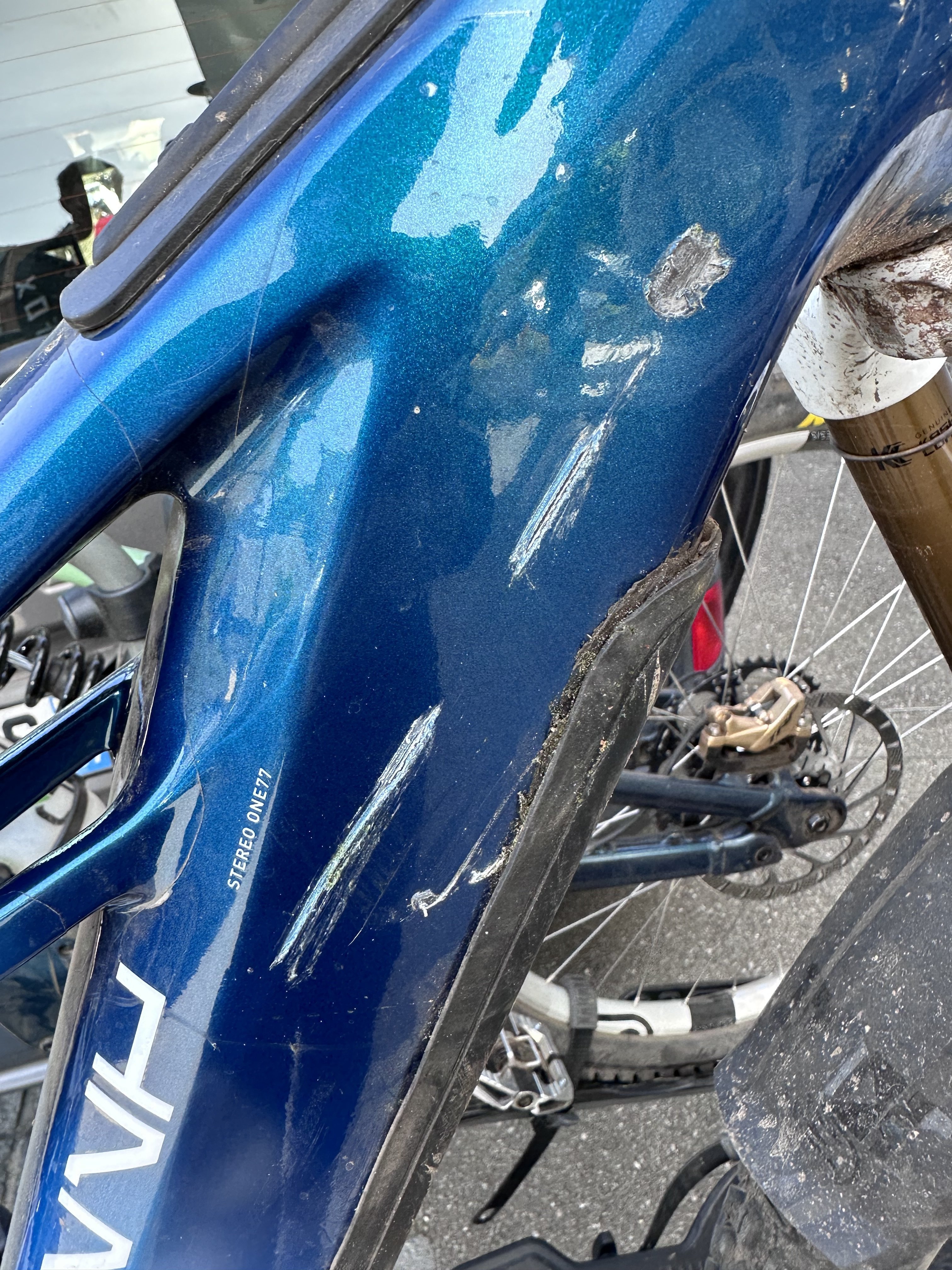

I destroyed the engine cover in plastic do you know if we can find a stronger protection ?
And I had a bad crash (I'm ok) but the Bike is damaged 😞
Check this: Schwarzburg GbR
This month they should release skidplates for the 2025 Cube bikes. I have one for the Stereo Hybrid 120 and is pretty good.

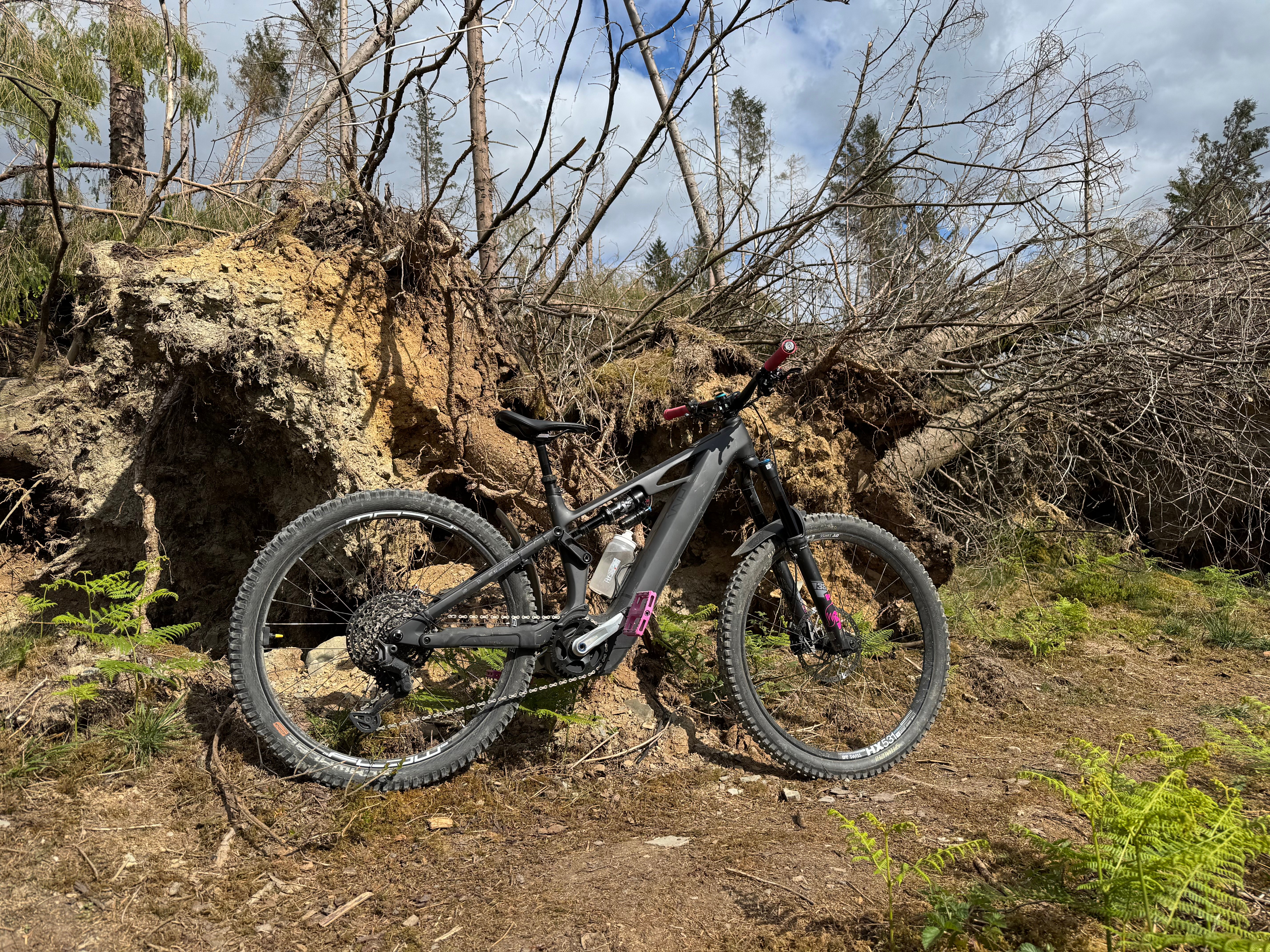

First ride yesterday and…. Interesting.
The bb is definitely too low. I fitted 145mm cranks and had one pedal strike but I was never totally at ease pedalling up technical climbs.
I’d just like another 10mm quite honestly.
To compensate I added more pressure to the rear shock. I’m circa 80kg and was running about 220psi.
However, I absolutely loved the ride. Incongruously it gobbled up rock gardens and gave me great pop off jumps, I had an absolute blast!
I really appreciated the ability to run a 170mm dropper on my medium (I’m 173cm) and reckon I could probably fit a 180mm OneUp dropper as there’s 290mm of space in the seat tube.
Also, my little legs and arse enjoyed the fact it’s a mullet and it ripped corners and I didn’t get buzzed on any steeps.
Final bonus for me was the ability to remove the battery and comfortably get the bike in the back of car for my hotel stay last night.
The ride was a mix of trail riding, flow and older school dh tracks.
So far so happy. Happy to answer specific questions if you have any.
