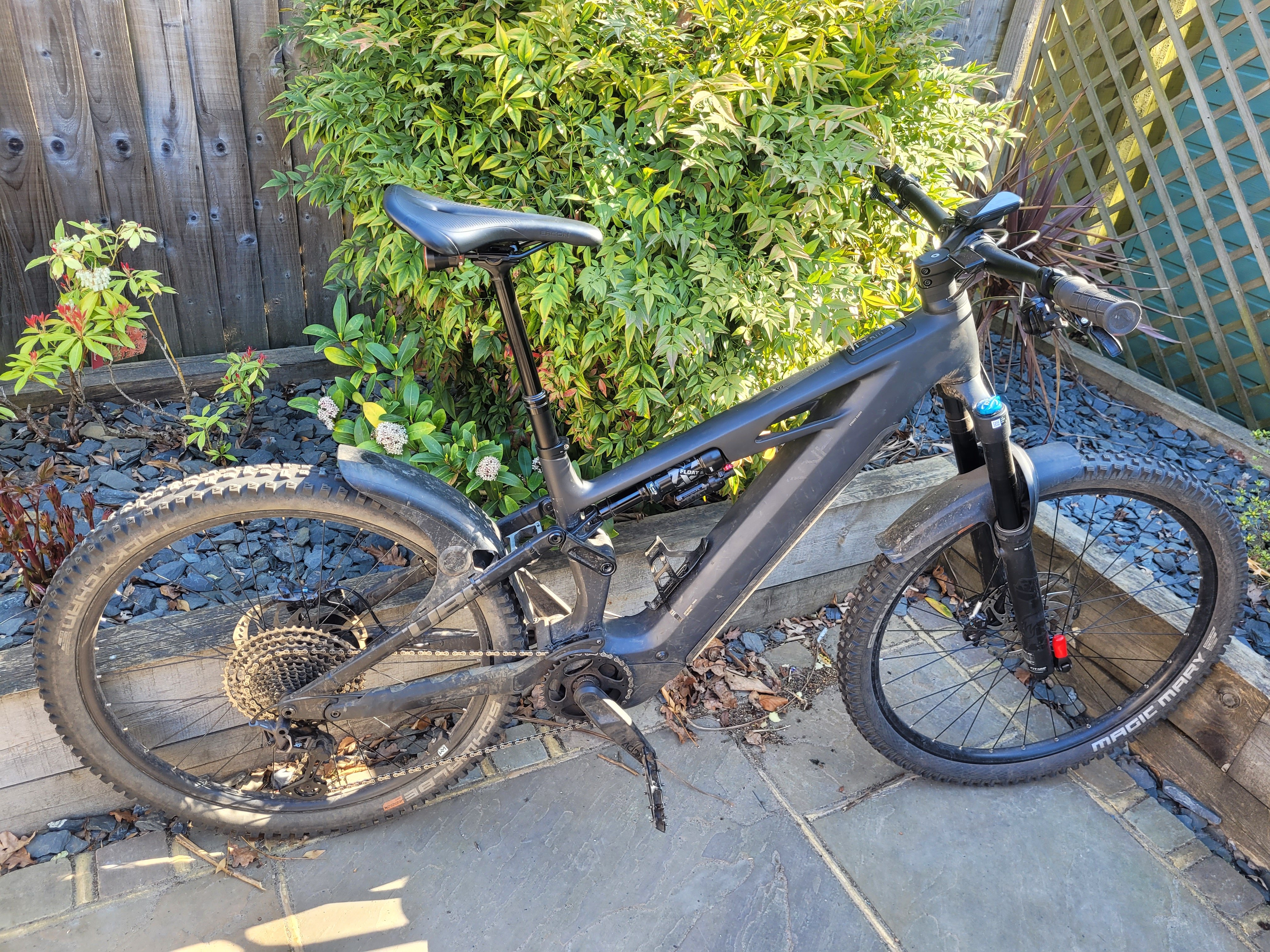

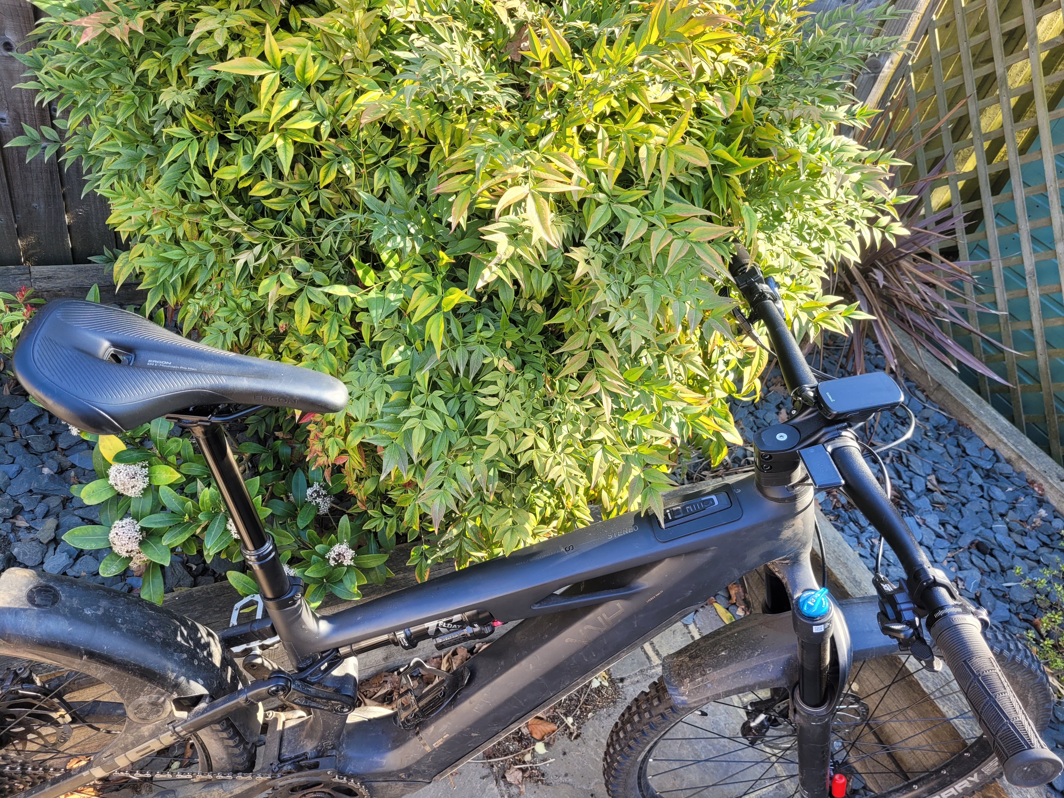

Another UK 177 SLX owner here (Deepcut. Surrey). Had the bike now since early December and just done over 300 very enjoyable miles on it. Only mods done are retrofit Purion 400 display, ergon saddle, icetech discs and ematrix pads.
Great bike and my first full suspension bike too. So playful and has given me so much more confidence on familiar trails around here.
Only niggles I'm having is the shock bolt wasn't done up tight (rattled like hell) and the bike sits a bit too low for me with constant pedal strikes (90kg weight, 6'1" height on a size large).
Oh and I'm having a constant battle with the seat post - frightened of overtightening the screw but getting the post creeping down inside the frame!

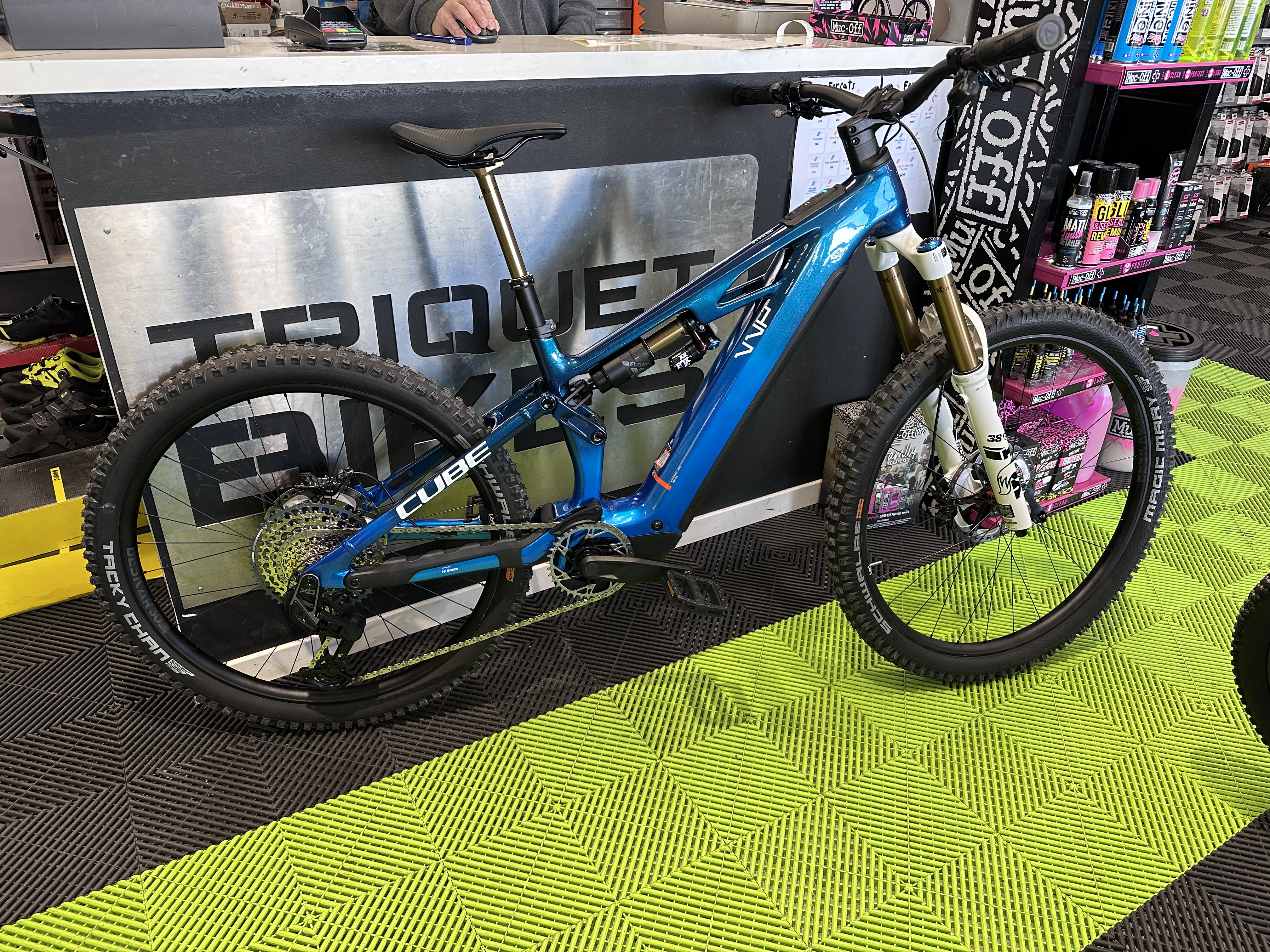

Starting to enjoy it now it’s not creaking. Forks bedding in nicely but I’m still tempted with either a damper upgrade or a red zeb 🥱. Got some burgtec stuff coming soon (bar, stem).
I'm considering the MRP lift damper as I'm 16 stone and I've watched some good reviews
Also works out around £250 direct from MRP .

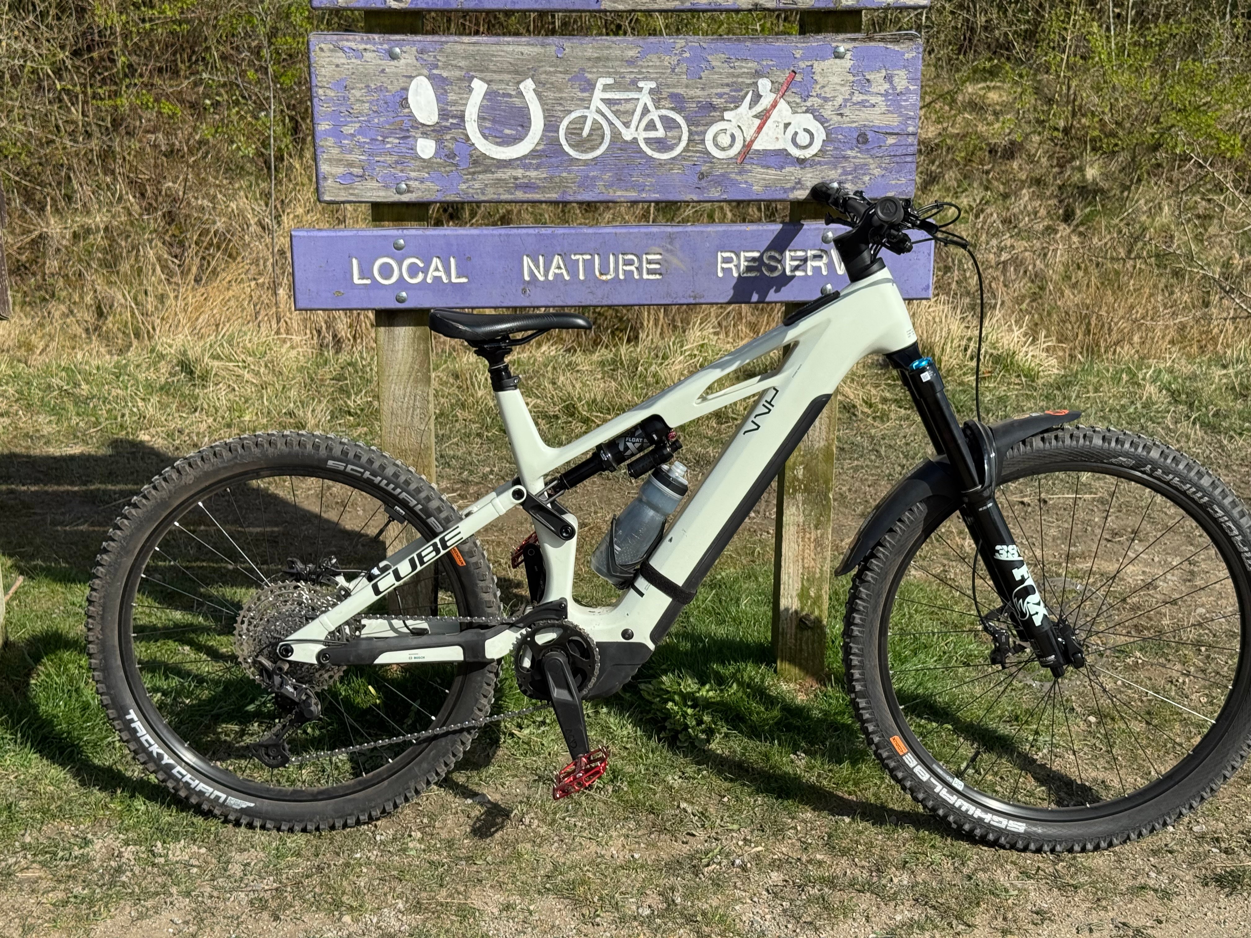

Hi, I'm 177cm on a size L, it is a bit longer than my previous bikes.
I'm using a 40mm stem, with the steeper head angle setting and a longer fork you will reduce the reach by some mm, towards 465-470mm. You could run shorter stem than me also. I am about to replace my +35mm rise bars with +10mm but with some extra spacers underneath which will also reduce the effective reach by 5mm (this is to allow a macride seat, not because I specifically want to affect the geometry further)

You can see my video and comments in previous pages: I find it quite agile because of the short chainstay, stiff frame and quite stiff/poppy suspension. I don't find it that plush in rock gardens despite a RS vivid Ultimate Air (high air pressure but low compression settings), which could partially be explained by my previous 2 ebikes being coil sprung and my preference to run the bike with very low sag to minimise pedal strikes completely.
Note my last 2 ebikes were around 450mm reach and I didn't have any issue with those, I specifically wanted to size up, as I liked my 465mm reach YT Capra position the best.

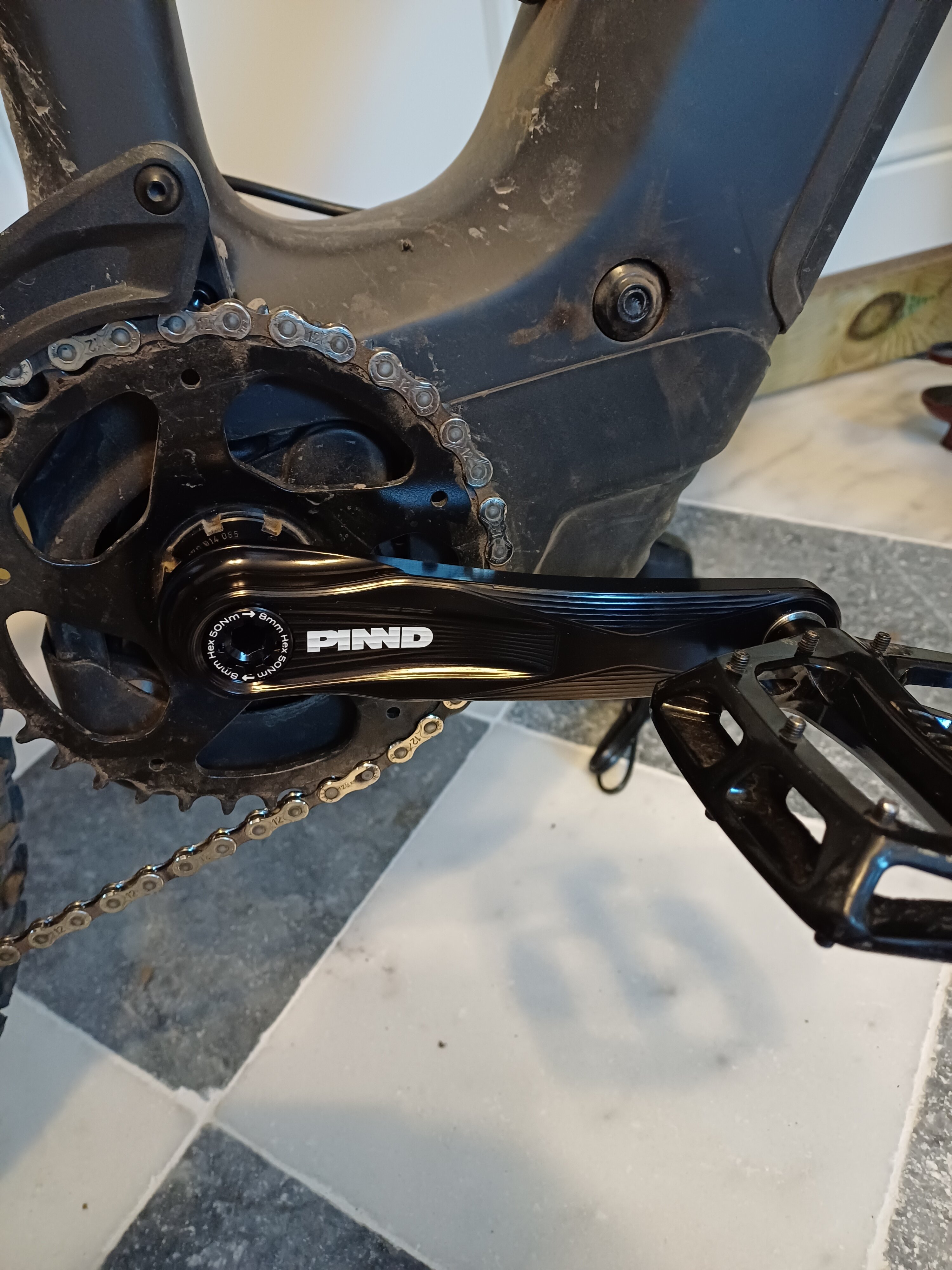

First ride today with 145mm Pinnd cranks - absolute game changer for me. Have been struggling with some really nasty pedal strikes on every ride since getting the bike, and not a single one today, so much better.
Great to hear. Could you link to which ones you fitted please?
Has anyone tweaked the motor settings yet? I’ve just got +1 on each in tour+ and rest in default.
Sure thing mate, it was these ones:
These look pretty nice 👍 though a bit pricey, especially for us non-uk.
I’ve had two rides with 150mm cranks. Initial feeling: weird. But the second time it felt better and I didn’t pay too much attention to it. Extra ground clearance is nice, but I’m not 100% if I’ll stick to these or revert back to longer ones. We’ll see.
