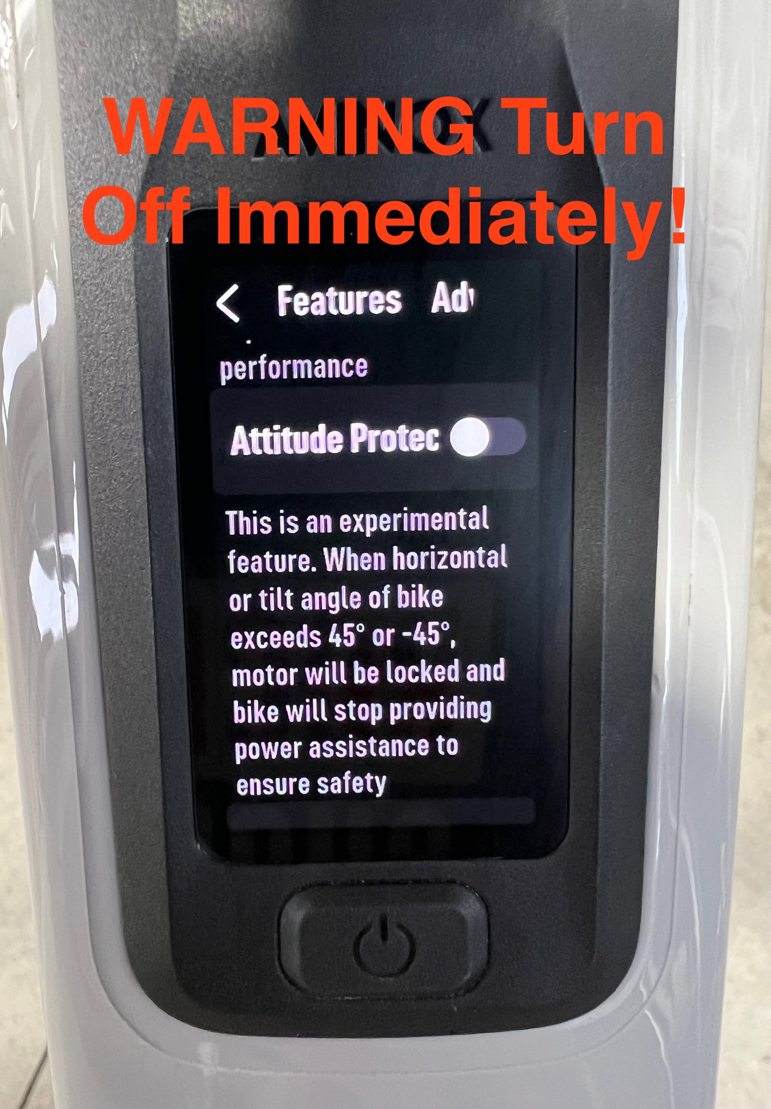

So I knew this DJI experimental setting was turned on(Extreme Attitude Protection) but I didn’t think it would almost kill me!
I went up a very steep lava rock face, as I was half way up, body positioned over the bars, confident I was going to make it, the motor locked up and the screen said the motor had locked up due to a 45deg incline angle!! This almost sent myself and the bike falling over and sliding down the solid lava slab. Luckily my saddle wasn’t fully extended and I was able to rapidly release from my pedals and step off, this is all happening on a supposedly 45deg angle! This could have been very ugly, all due to an experimental setting I left on. My ride report showed a max 31% angle, either way it was f*cking steep and slick and really sucked having the motor lock up mid ship with no warning. If you’re into steep climbing please turn this setting off.

So I knew this DJI experimental setting was turned on(Extreme Altitude Protection) but I didn’t think it would almost kill me!
I had the Avinox motor before they added these new features in a firmware update. So I went through and checked all the new features, after reading the release notes, after every firmware update. And this was one I turned off right up front, for the exact reason you found out.

The Extreme Attitude Protection (was something lost in translation when they came up with this name?) is the one feature that seems like it came form someone who doesn't do a lot of slightly intense riding. I appreciate the thought from Avinox but it doesn't seem practical to most.
Makes it impossible to wheelie too! That setting is not good...
But they could add auto wheelie hold to perfectly adjust the power and let anyone enjoy that infinity wheelie 🤣

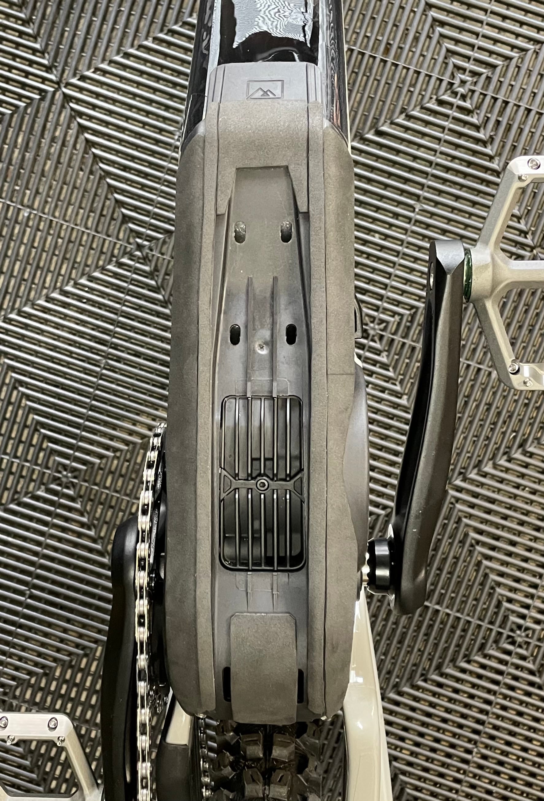

Just noticed extra bash guards are available to order…..Order placed. I’ve bashed mine a few times and it’s holding up much better than my previous Crestline. Better material and better design for sure, but I always like to have a backup to throw on if need be.
Cool! Until there’s more robust solution, I’m using high density foam tape.
