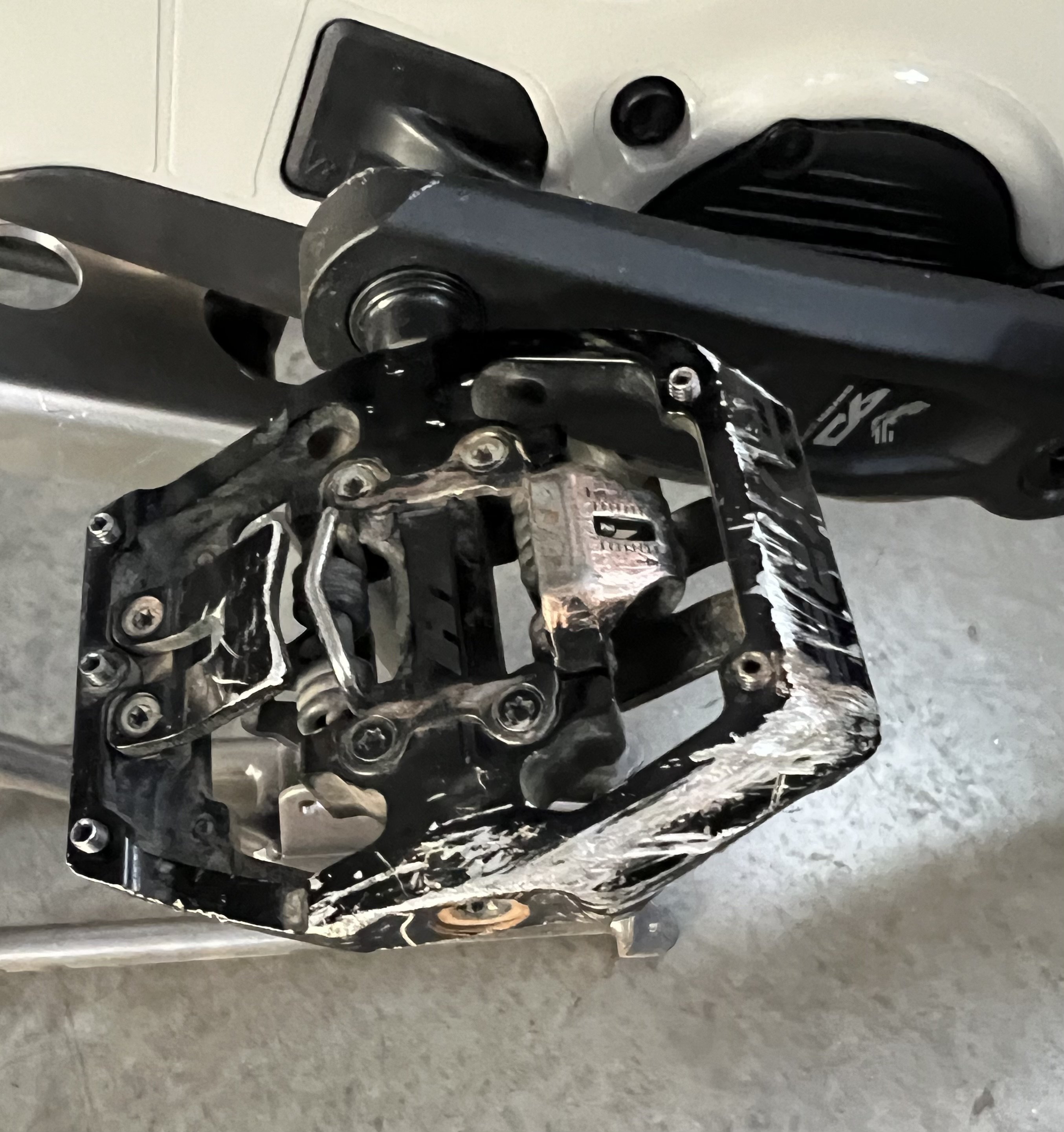

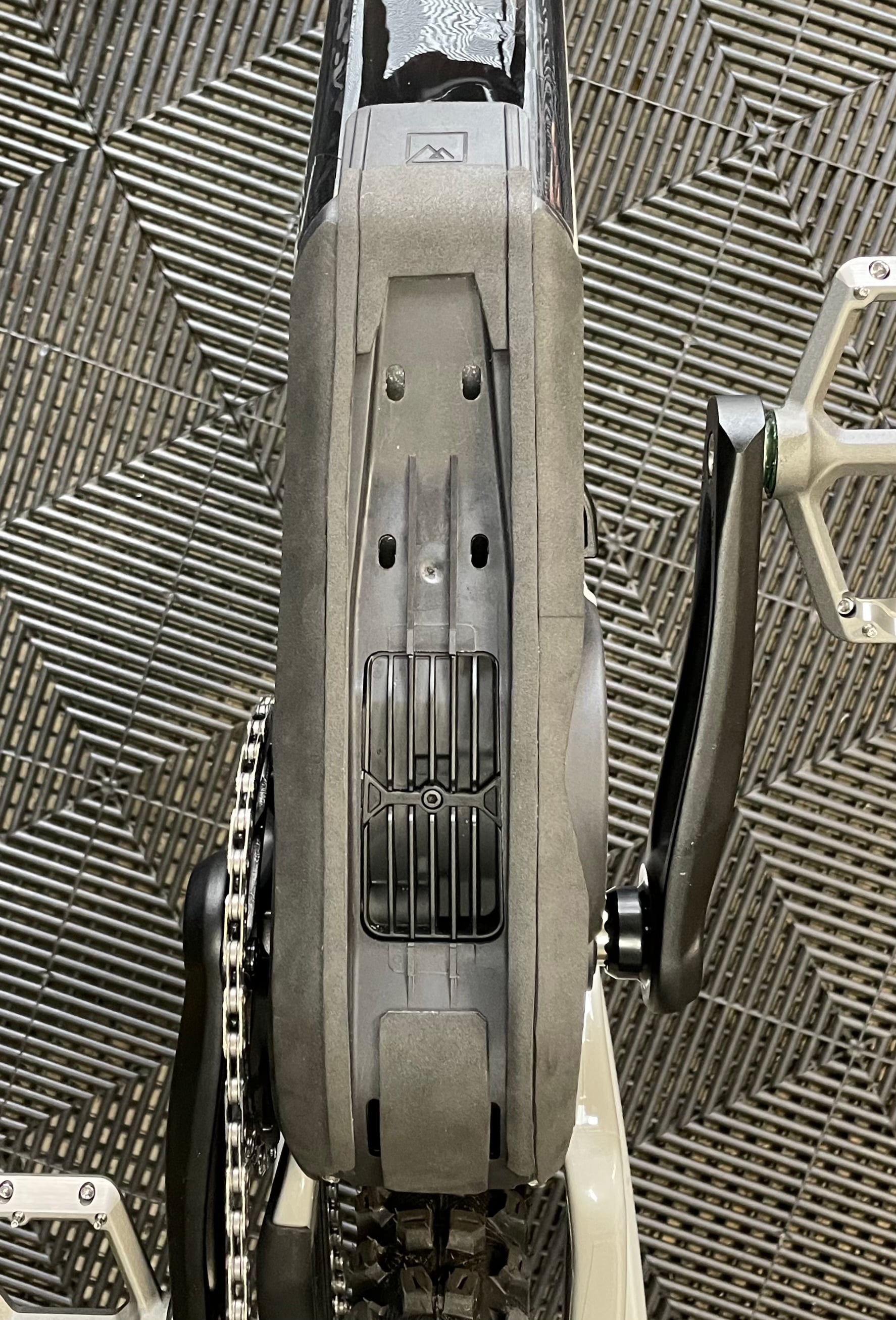

Cool! Until there’s more robust solution, I’m using high density foam tape.
That wouldn’t last 15min into my rides, but everyone’s terrain is different. I hope it helps for you.
I would need mine wrapped with thin stainless, as aluminum would just dig in and not deflect.

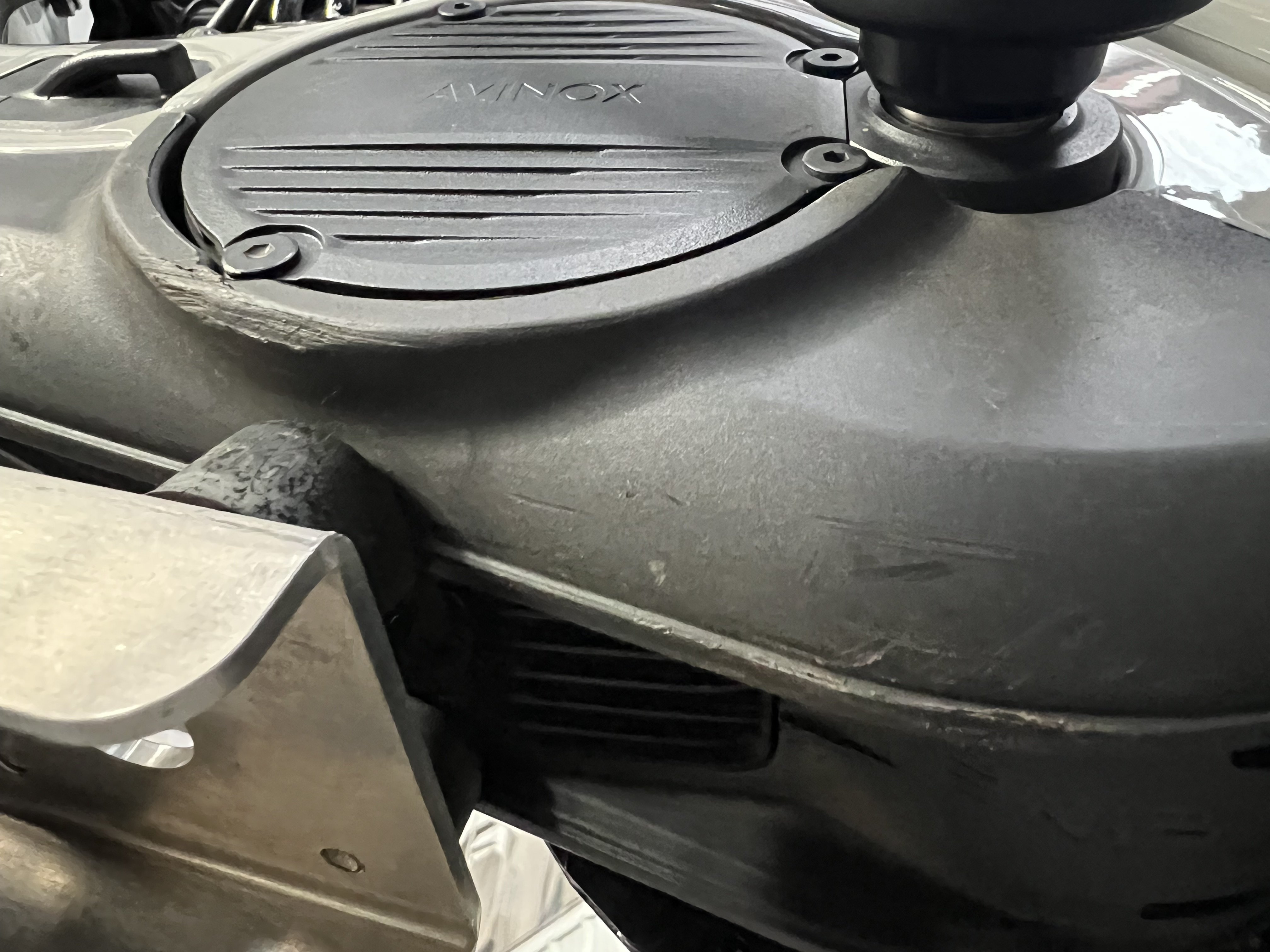

Ouch, that looks painful. I also considered 3M taping neoprene rubber sheet which is much stronger and impact absorbing but it‘s significantly heavier compared to dense foam. 1st ride tomorrow.
Plastic will slide and deflect, but it'll crack. It doesn't seem that brittle compared to some other covers I've seen so it may last. Similar but different, I've been using OneUp campsite pedals for the first time and I really do see the advantage to aluminum pedals in the same way. It's been almost a year and they're still running strong.and currently on sale for $35!
Nice battle scars 🤙 I’ll get some tomorrow…

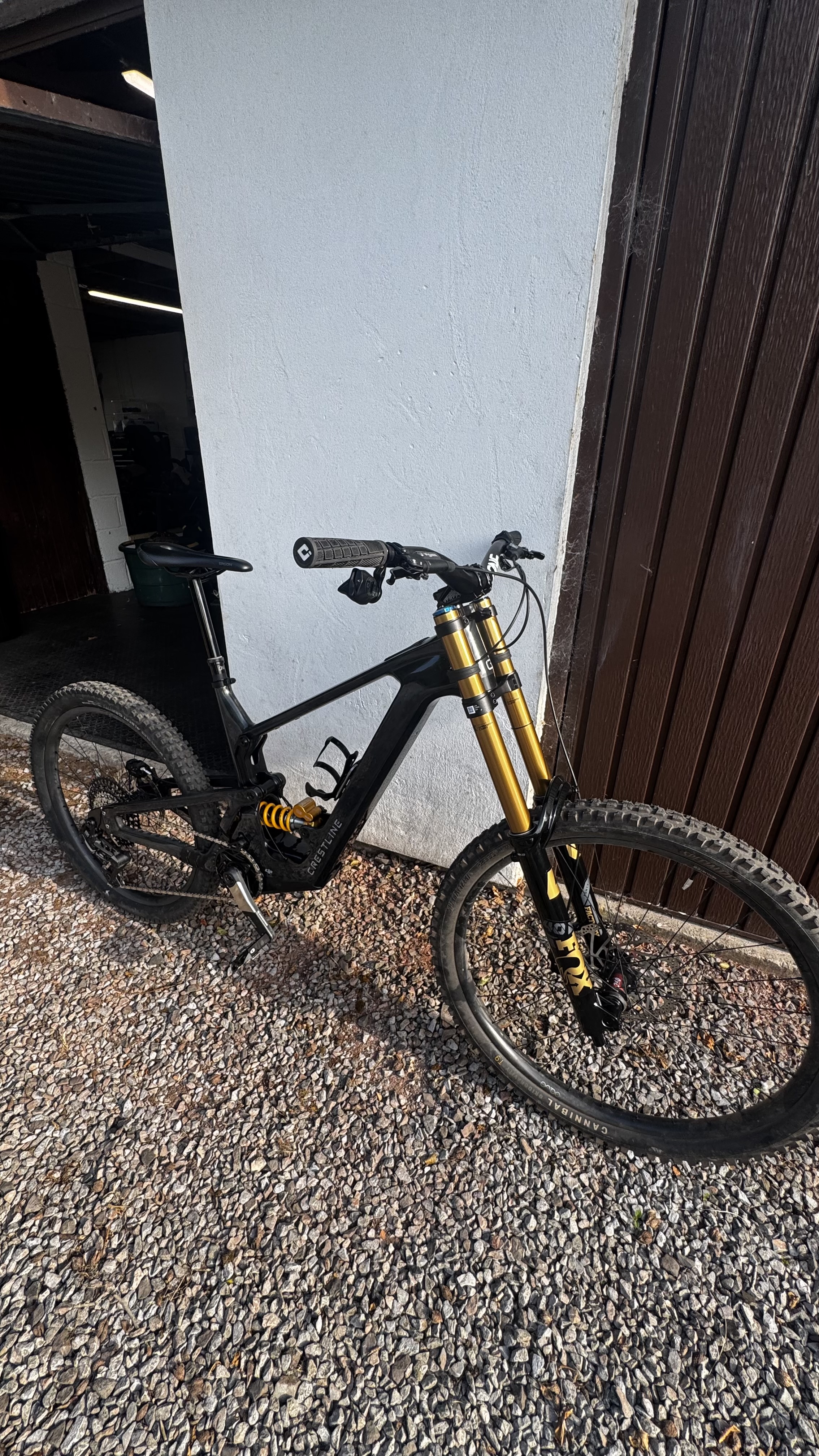

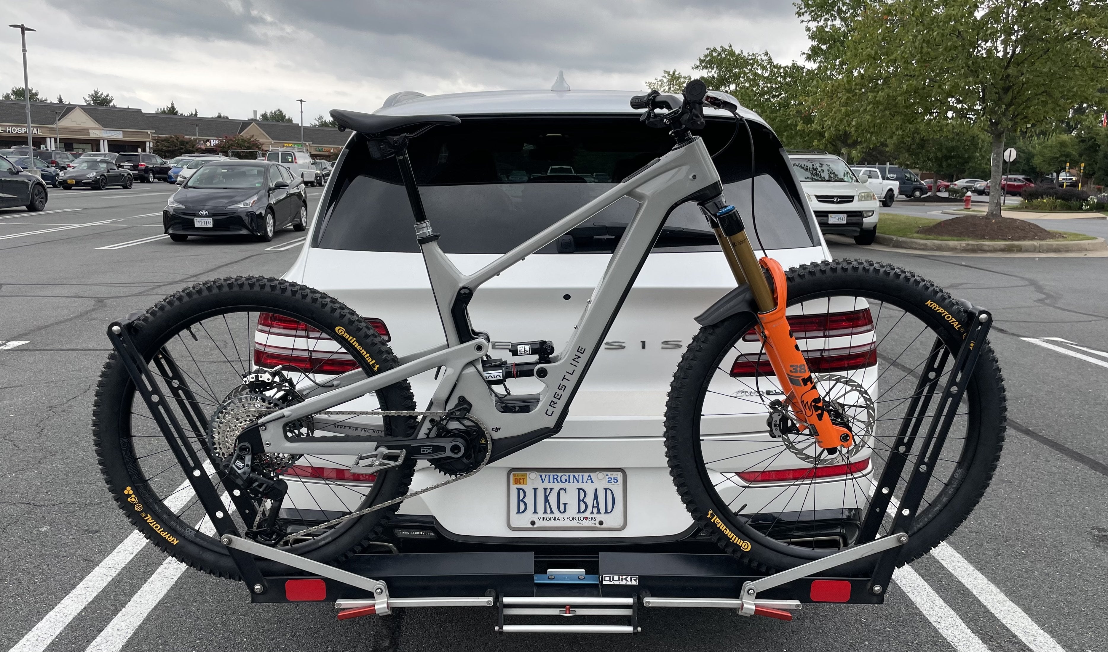

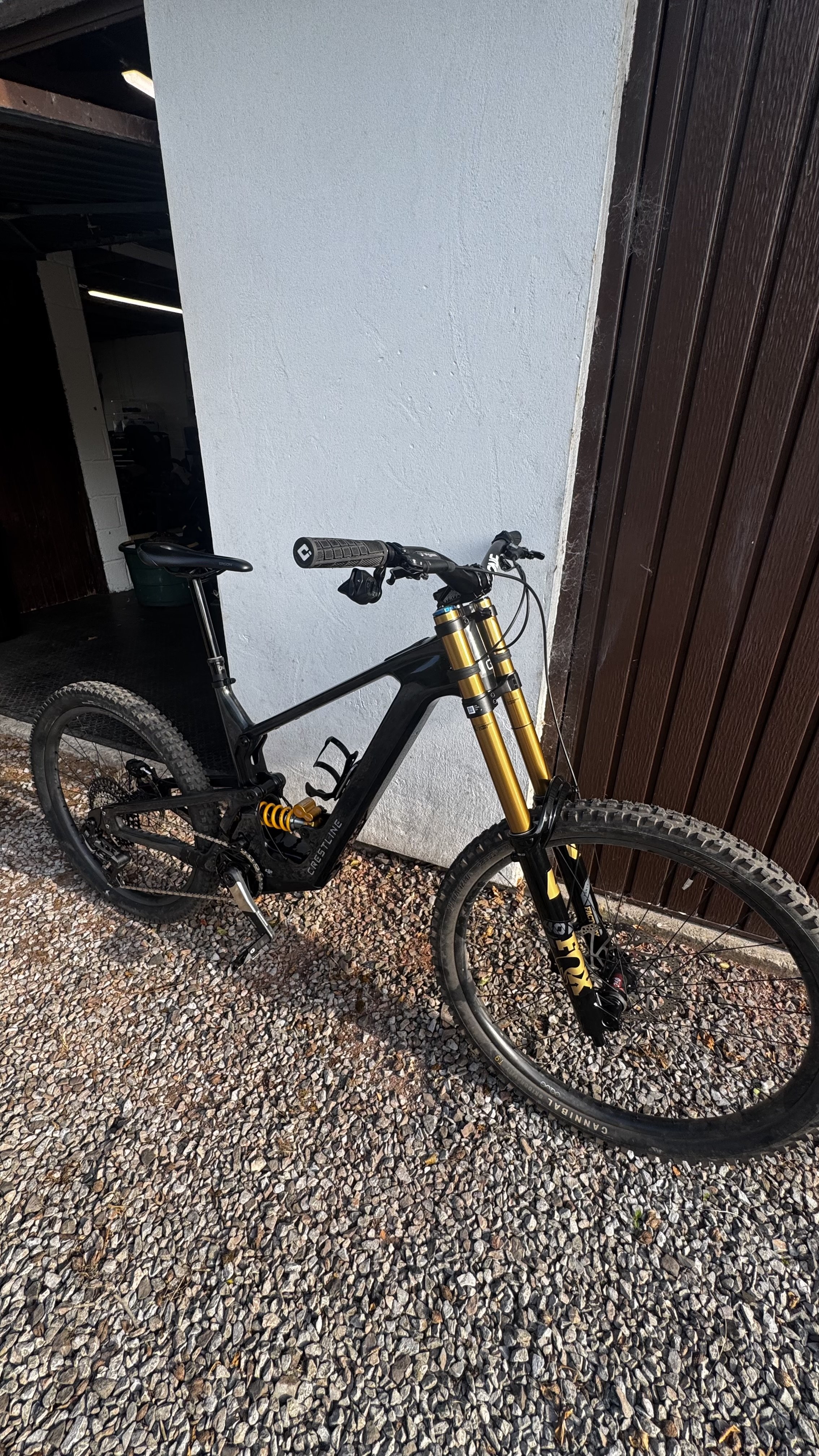

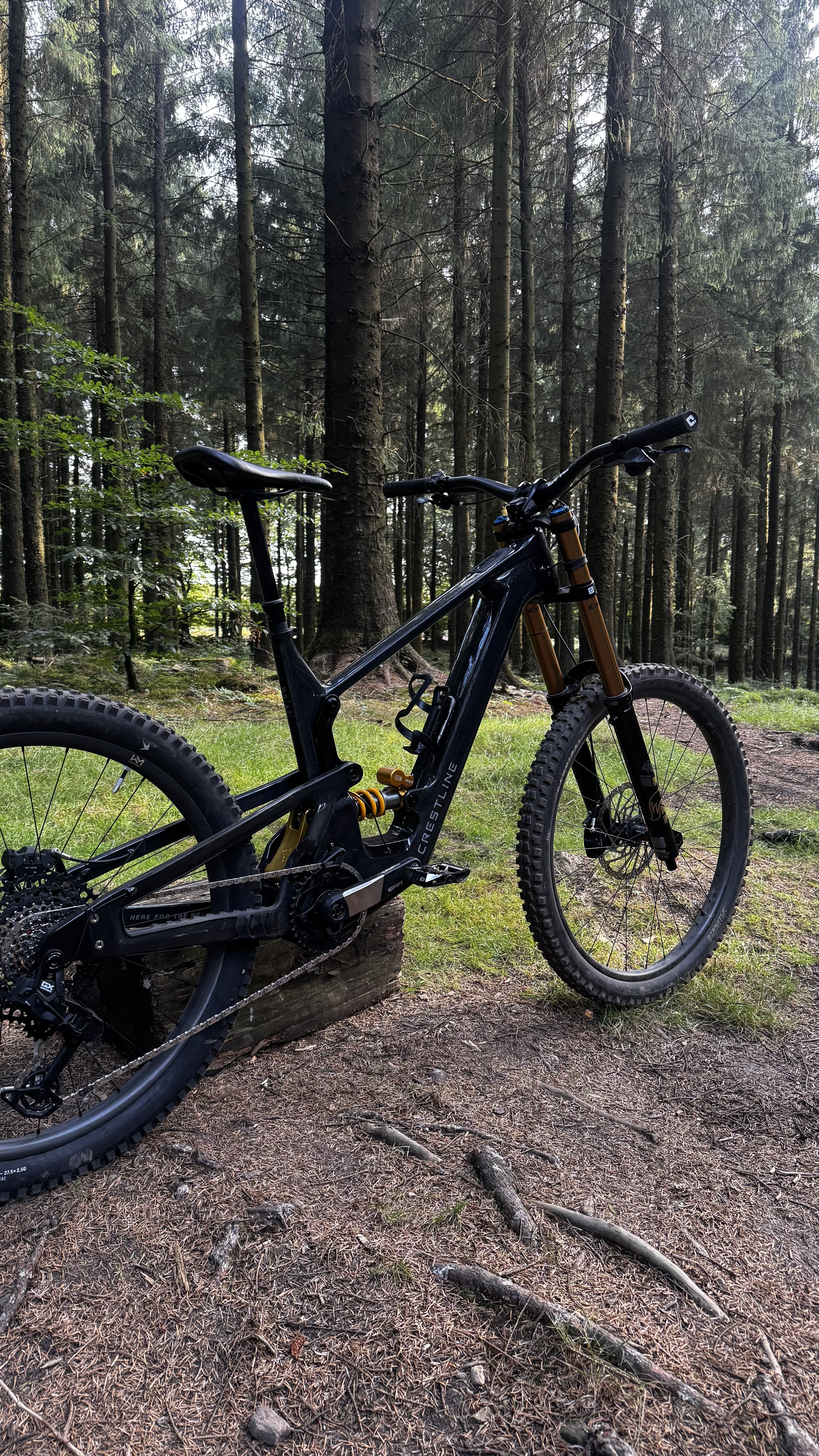

I’m all about keeping my bikes 2 colors; frame color and black components, but damn! I’m digging the orange fox contrast with the frame color! That thing looks fast just sitting there.
And I see the derailleur power cable fastened to the dropout 🥰. I also like that the derailleur power wire is more tucked with a GX derailer. I have the XO derailleur and the wire hangs out past more for the battery location.
I like the XO cranks too. I really wanted those but couldn’t find the 150mm in stock and Troydon recommended the SRAM 90 cranks, so that’s what I went with.
You should go with a FOX orange coil for the rear to tie it all together, and so the current FOX and RockShox don’t rival fight each other, that’s the worst!

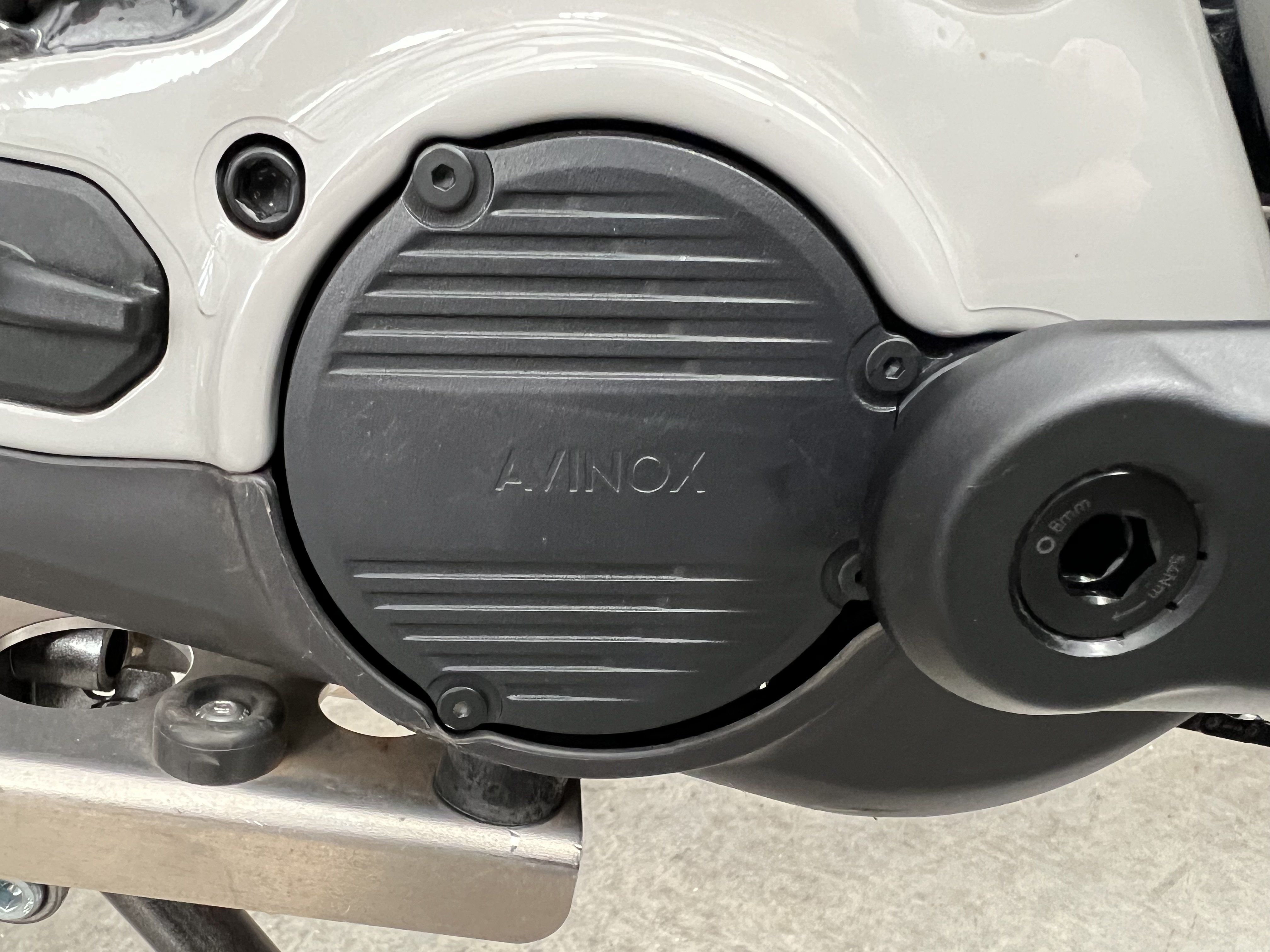

Does your amflow rattle like your crestline? Mine sounds the same 😞.
Not as much. The Crestline (VPP) rattles way more than the amflow. I suspect its not just the Avinox motor, it’s the suspension kinematics. VPP has more chain growth, so when the suspension compresses it tugs on the chain/chainring, which makes the motor’s internal gears chatter louder. The amflow is a 4-bar Horst link with less pedal kickback, so the motor still makes some noise, but nowhere near as much as the VPP.

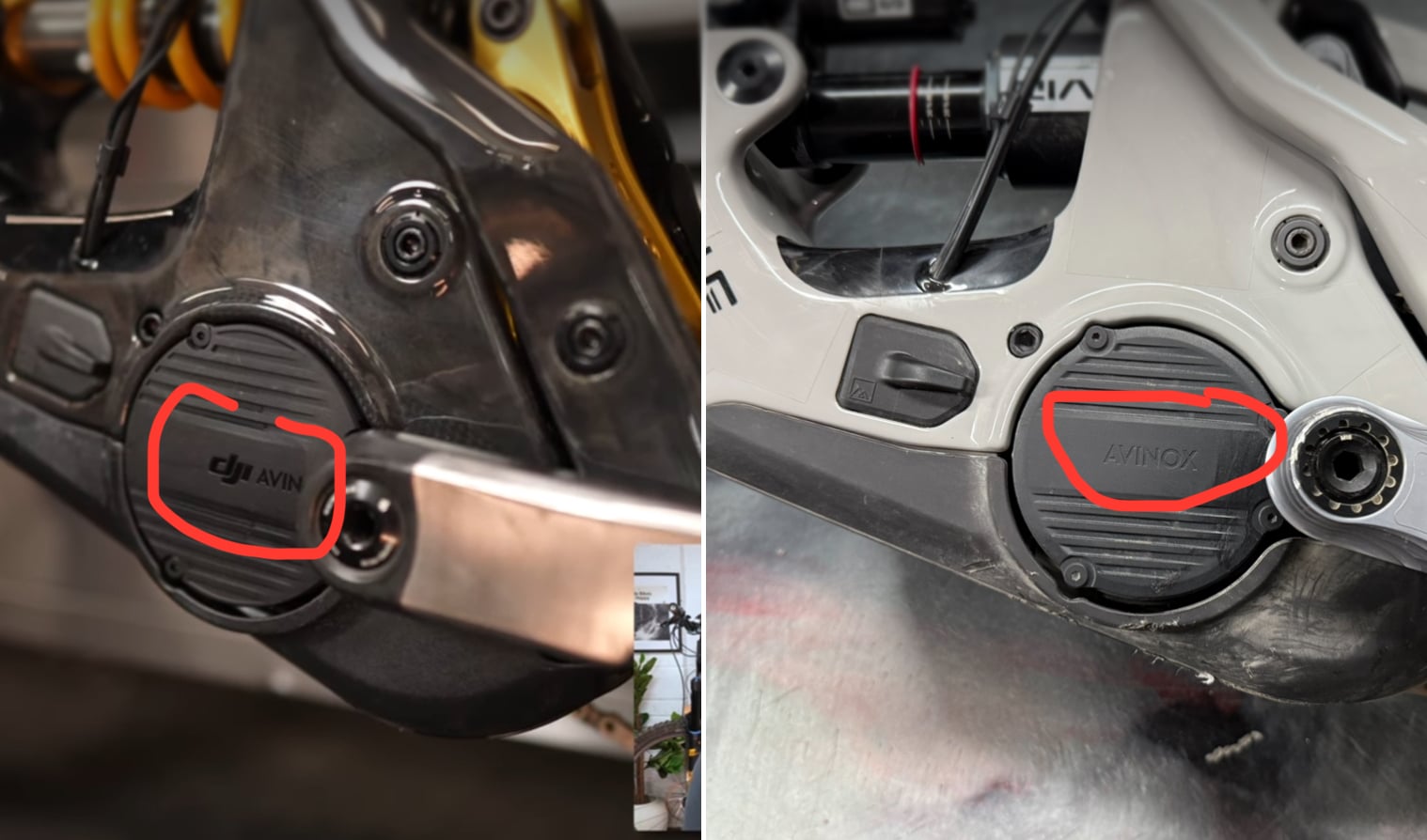

My motor is a later revision motor and has no rattle. I’ve included a YouTube short showing two Crestlines (1 with rattle and one without). DJI really messed this up by mixing new and old inventory. I have a sidekick hub (18deg of float) and the suspension feels superb. BTW, my BB is chewed up after 2 rides…. I didn’t even bash it into anything, just lots of rocks/shale shooting up at the bike, I think it’s made of cheese
I have the same motor cover and a sidekick hub as well and still have rattle. Agreed mixing motors is ridiculous. Amflow Owners have the same issue.
Edit: i tried pulling on the chain as well and my resistance seems similar to yours. Really mind boggling.
New video.... Interested in the rattle mine has compared to your guys bikes... let me know!
The Avinox rattle is a mystery. I have an Amflow and the motor sounds like a bucket of bolts - just like your video.
I got it in March so it's DJI branded - however looking at facebook groups/forums there are early adopters who have both quite and rattly motors.
I've also met owners who have quite motors and spoken to others over SM who also have quite motors.
YouTuber Ian Richard says his is silent and he got his last year.
Doesn't make any sense - it would be great if DJI could clarify.
Interesting. Just watched, thanks for sharing. It seems the silent one is quieter because the motor freewheel/chainring won’t actually rotate backwards. I wonder if as a result of this there’s more drag in the system because the gears are meshed tighter together. I bet it’s really hard to rotate the chainring backwards on that one?

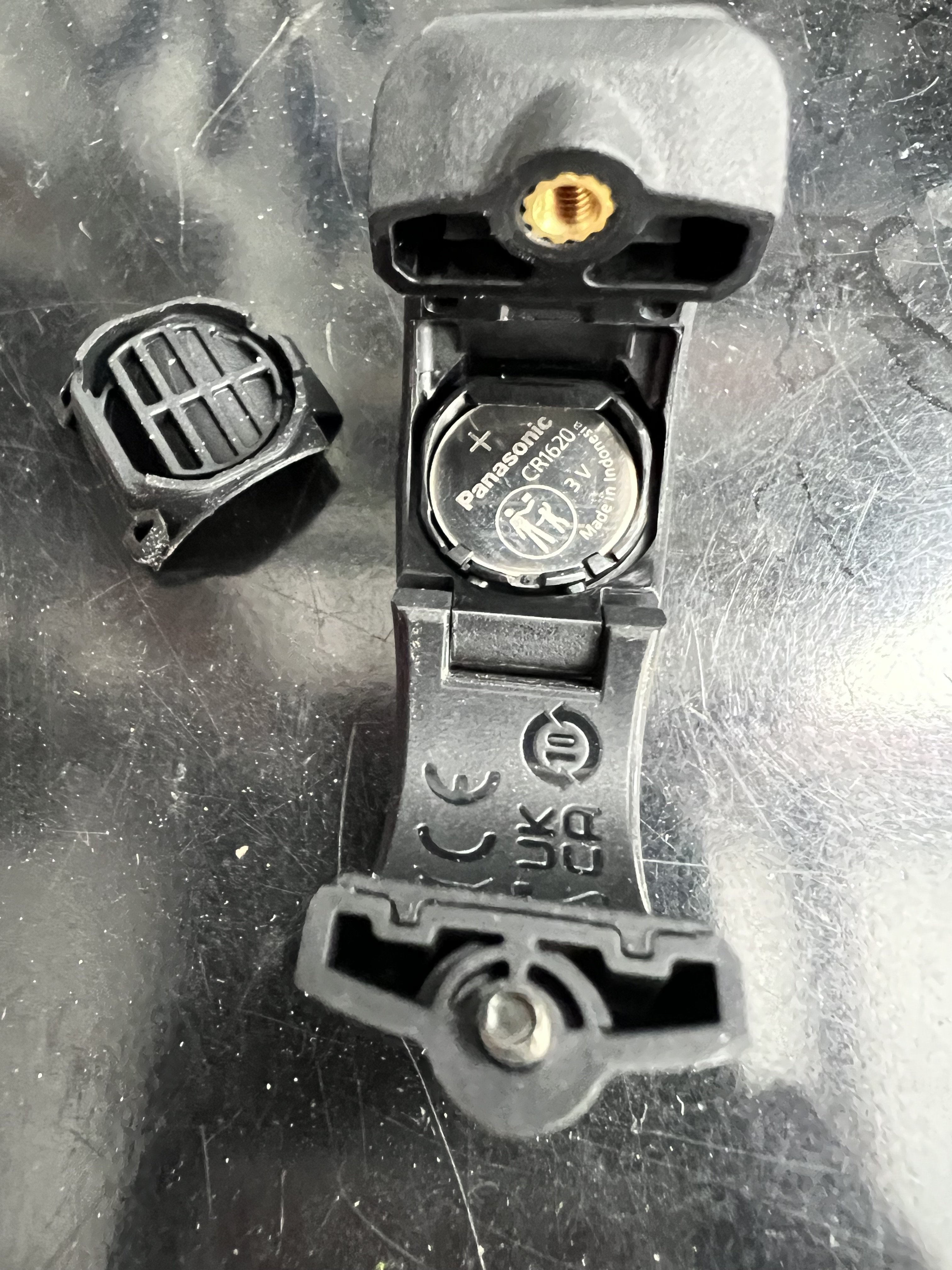

FYI the remotes use the same coin battery as the Bosch 👍🏻
I like having an extra battery for the AXS remote and drive system remote in my pack just incase one dies on the trail!

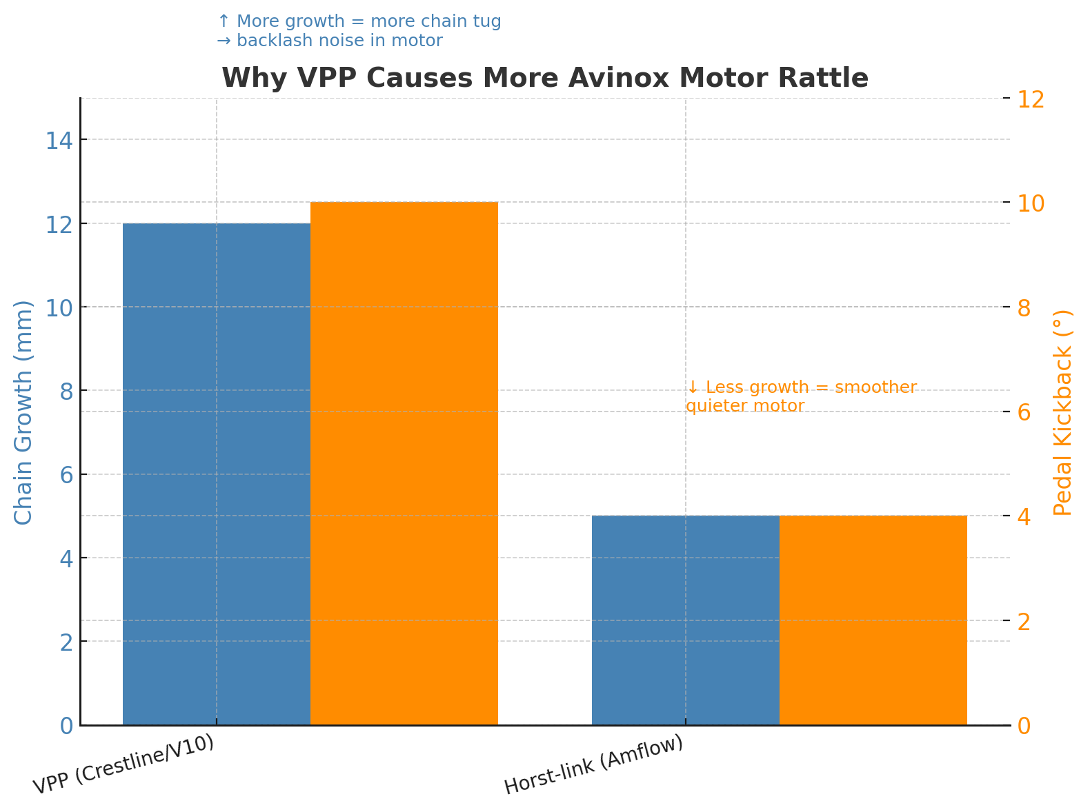

Chat GPT answer:
  • VPP (Crestline/V10) → around 12 mm chain growth, which works out to ~10° of pedal kickback. That extra tug feeds back through the chainring into the Avinox gears, so you hear more lash/rattle when it’s rough.
  • Horst-link / 4-bar (Amflow) → closer to 5 mm growth / ~4° kickback, so the chain isn’t dragging on the motor as much. Result = noticeably quieter.
The motor doesn’t care if torque comes from your legs or the suspension — VPP just delivers bigger spikes, so it sounds rowdier
  • Blue bars → chain growth (mm)
  • Orange bars → pedal kickback (°)
  • Shows why VPP tugs harder on the chain, making the Avinox motor rattle louder than on a Horst-link.

@MTB_MIKE had kickback at 32 degrees way back on pg 10. Doing that type of math ain't mathin' for me, so I'll take anyone elses word on the subject. I guess the answer depends on what rear chainring size we're measuring at.
Thats exactly my experience. My push fork is fairly loud so it kind of drowns out the rattle lol.
A Timber Bell also helps drown out the rattle. It also helps get hikers out of your way too but without the bell they hear the motor rattle coming and wonder what pile of shit is barreling down the hill and also jump out of the way 😂
Little do they know we are actually on one of the most expensive bikes money can buy….what a surprise to them.
32 degrees on gear 34/51
On 34/10 it’s way lower like 10-14
On a 36/10, around 8-12 based on data from a Santa Cruz Bullit
