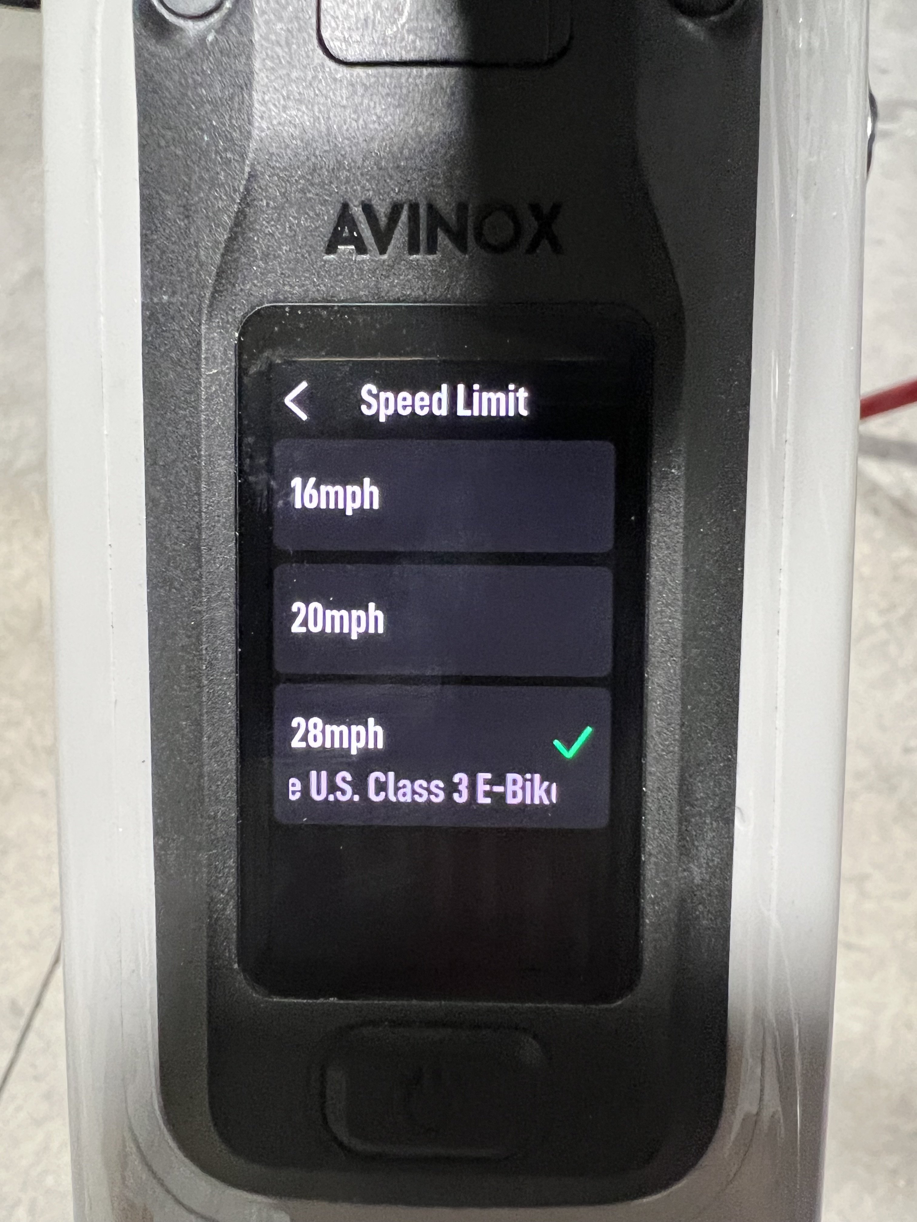

Im missing the speed limit option too. Pretty frustrating. I was texting with Troydon on Thursday about it. He said it should be there based on the current software. He said he would email dji (avinox). I haven't received an update yet.
hi did you ever find the speed limit option for 28mph in the u.s mine is missing as well my amflow has it but on my crestline its missing any help on this topic would be apreciated .
That’s right 💡…..swipe up on the screen! For more setting options…..no more beeping when I push buttons.

How did you find the speed limit mode ? I swipe up and its not there at all , i have a amflow and swipe up and its there on my crestline its not there at all and all software updates are complete i tried emailing avinox and no return email yet and troydon didnt get back to me yet if anyone can help on this it would be appreciated, thanks
This is an unsolved mystery. My SPECTRE has Speed Limit option while my friends’ Amflow and Teewing do not. We are all on exactly same software/firmware.
Having said that, if wanting to increase the max assist speed to 28, it’s better to do so with vpn as it’s set once and it’s done. It does not change when bike is powered off/on.
Using Speed Limit to enable Class 3 mode, it’s changed back to Class 1 when bike is powered off/on.
Avinox just got back to me and said my display might not be for U.S and consult with crestline , so strange every other new feature is there from the software update just no speed limit selection , troydon shot me a text saying he will call me today maybe he has a solution if he does i will update the forum , its kinda frustrating because my friends that have the rs181 all have the speed limit selection and we all take the road to the local trails and they are flying by at 28mph lol
this is the correct answer

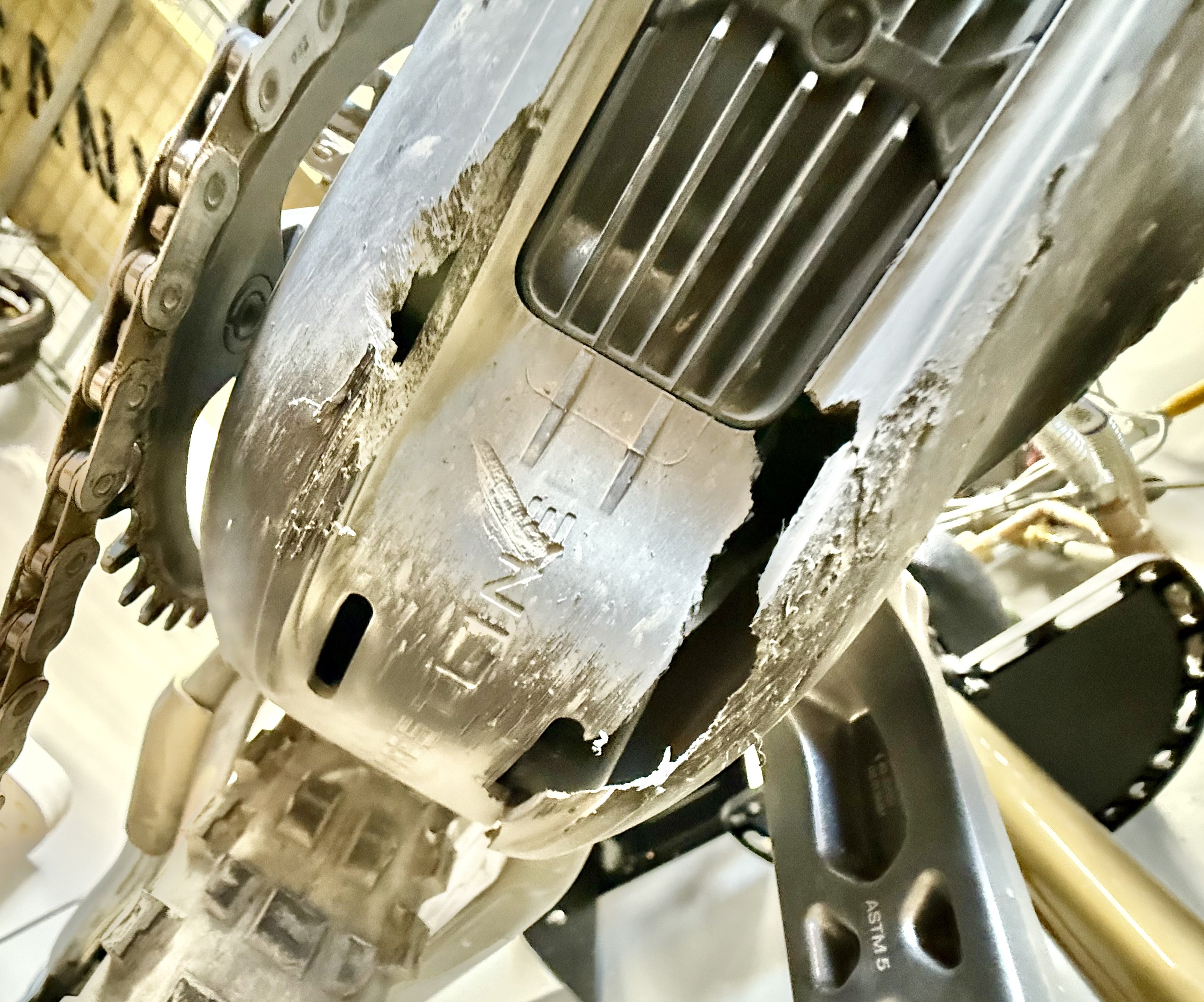

I wish the BB cover was made of a tougher material. It’s super brittle and cracks very easily. I’ve hit lots of stuff with my other bikes and the plastic deforms or shears, it doesn’t chip. It appears to be glass filled nylon. 10% is the most I would go but this looks like it’s 30-40% glass filled which actually makes it chip a lot easier.
I would love to get the 3D model so I can 3D print something myself that a bit beefier and also protrude more to protect the 36t chainring (ABS filament). Or make a metal bashguard.
This damage is cumulative, after 4 rides, 90 miles 😆.
Don't like to think about the load on the motor if the chainring crunches into stuff that can do that level of damage.
I grabbed a pair of needle nose pliers and was able to break off a bunch of little pieces (kinda like when Thanos snaps his fingers).
Too much glass fibers in the material. Need to use 100% Nylon, ABS or PP instead of 30-40% glass filled material.
Using the right material, the plastic would just flex/bend instead of break off
Is your rear shock set to spec for your weight?
While accidents happen, damage like that shows either you're using your bike as the slider on the rocks, or your rear shock set way too soft.
Or do you just roll over jump lips?
Some of the damage was from loose rocks/shale flicking upwards and removing chunks of material off the BB. The loose shale I ride over sounds like I’m riding over broken glass at times.
I’ve never smashed into anything hard. Just climbing up and over steep rocks at very slow crawling speeds and occasionally grazing something.
My 3 other Ebikes (1 I’ve replaced with the Spectre) I’ve ridden hundreds of times in this same terrain with even lower BB’s (338mm on an 170mm Timp Peak mullet setup) only have scratches and gouges. I haven’t had to replace a single BB cover yet. Their BB’s don’t chip away, they bend and deform instead of cracking and chipping.
