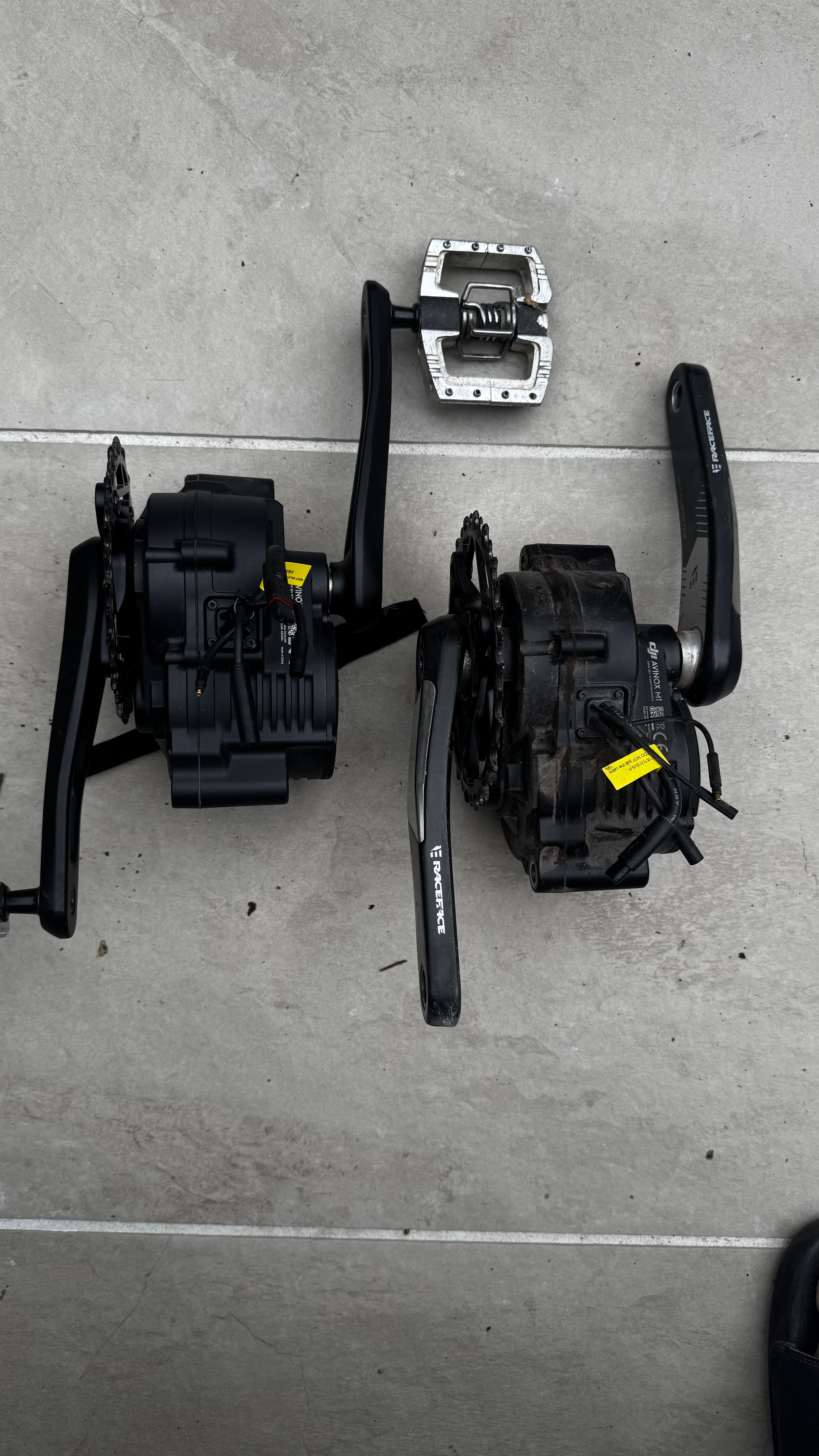

Testing a fresh Avinox motor to see the rattle difference. The original (rattle monster) is noticeably easier to turn the chainring backwards. It’s also easier to make it rattle by moving chainring back and forth by hand.
The fresh Avinox motor that I borrowed from my new loan Amflow bike is noticeably stiffer to move the chainring back.
I suspect that its gear mesh inside is much tighter. I also reckon that over the limit it might be a bit more draggy.
Going for a ride to listen to how much quieter it is.

Is there a noticeable difference in pedaling/crank resistance rotating forward or backward between the two when powered off?
Testing a fresh Avinox motor to see the rattle difference. The original (rattle monster) is noticeable easier to turn the chainring backwards. It’s also easier to make it rattle by moving chainring back and forth by hand.
Mine back spins extremely easily, no drag whatsoever. Bumping the cranks forward with the bike in a stand I can hear the gears mesh/clank together.
Back spin on the cranks is very free. But rotating the chain ring back is very stiff

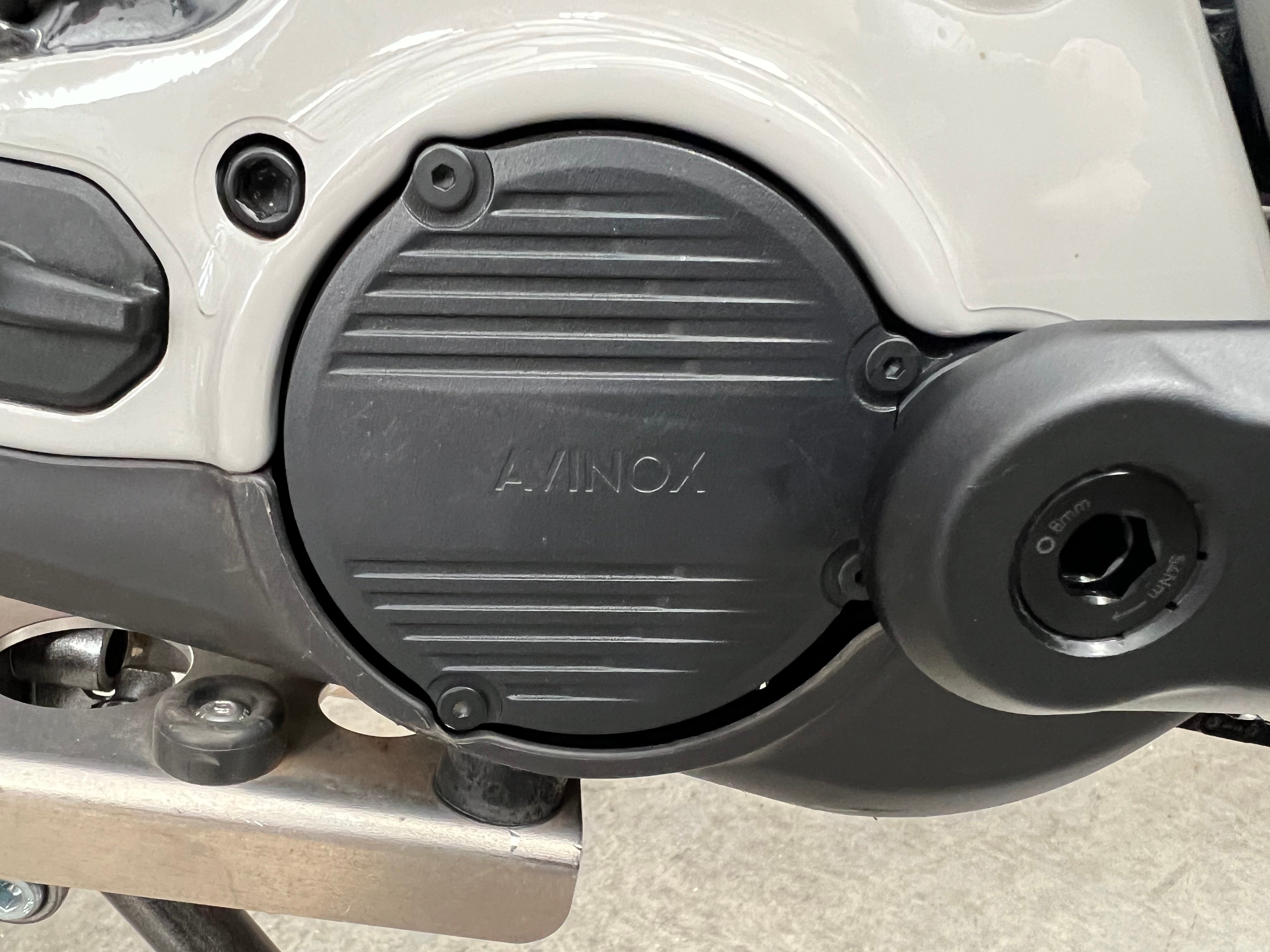

I also have the “newer” AVINOX cover and SideKick hub and have rattle. BUT as I stated; the rattling was definitely reduced when I turned OFF the Freehub Pre-Engagement and Quick Start settings. I’m sure the Freehub Pre-Engagement setting was the main cause for obvious reasons with a VPP platform.
I have my SideKick set in the middle (I believe 13deg) As the 18deg I felt was too much float for technical rock shelf climbing.
This helped my rattle a little bit. I have the Avinox branded motor, and have tried to combat sounds from the bike since day 1. Sidekick didn't help and I was wondering why until I saw your post. I turned off the freehub preengagement and to my surprise I believe I made a difference. I didn't even know it was on until I had a look through all the settings.
