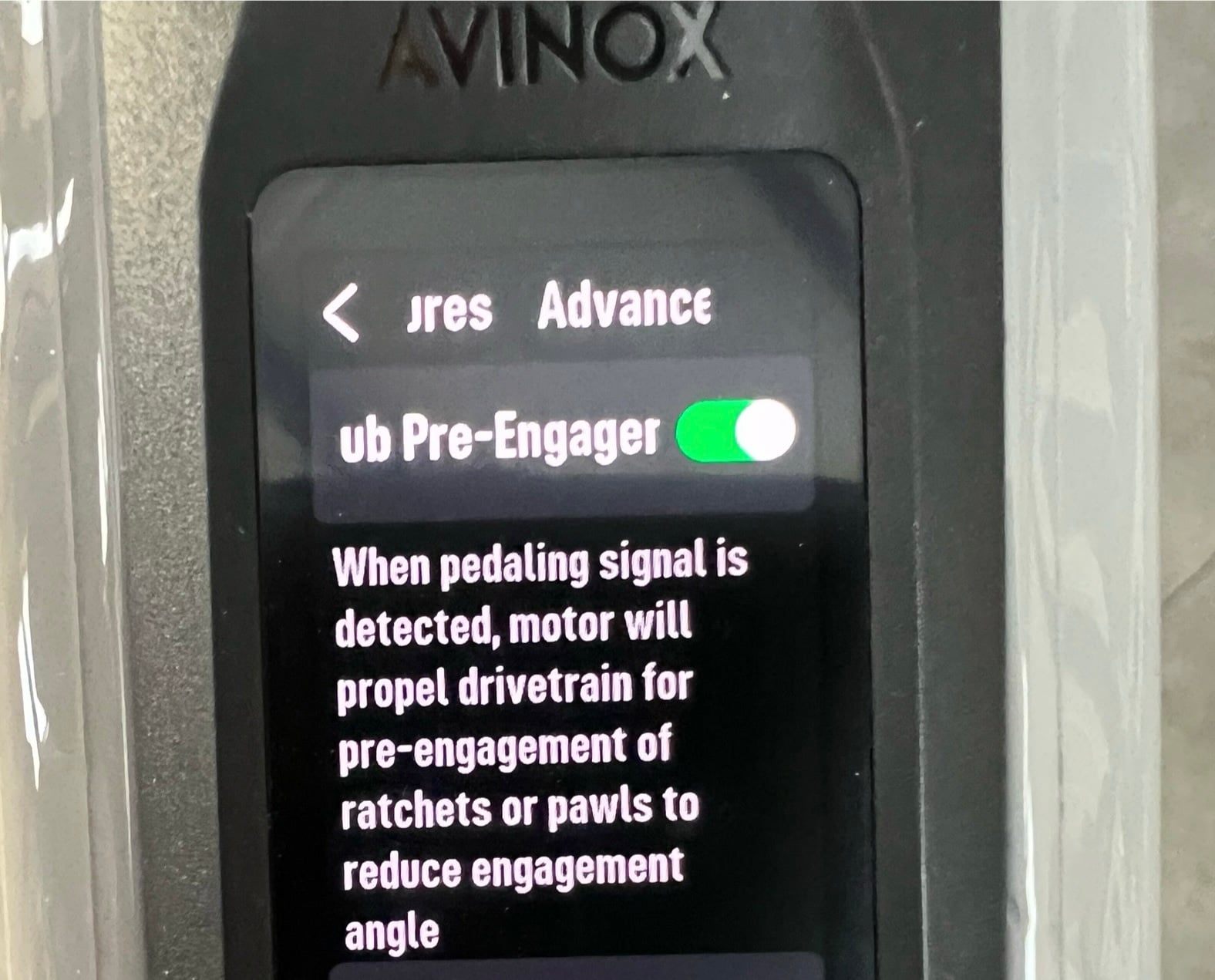

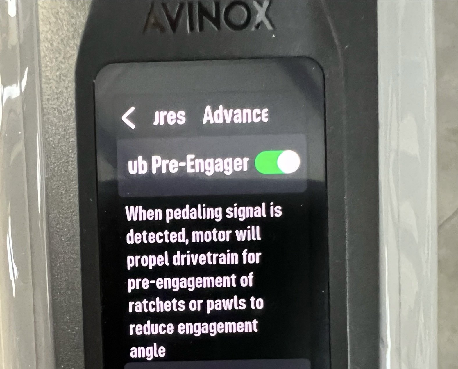

I’m not yet familiar with the hub pre-engage features. ?
It's in the Advanced Setting menu. I read it as a setting to take up the engagement slack in the rear hub when you start pedaling so you don't feel it when starting to pedal, or something like that.

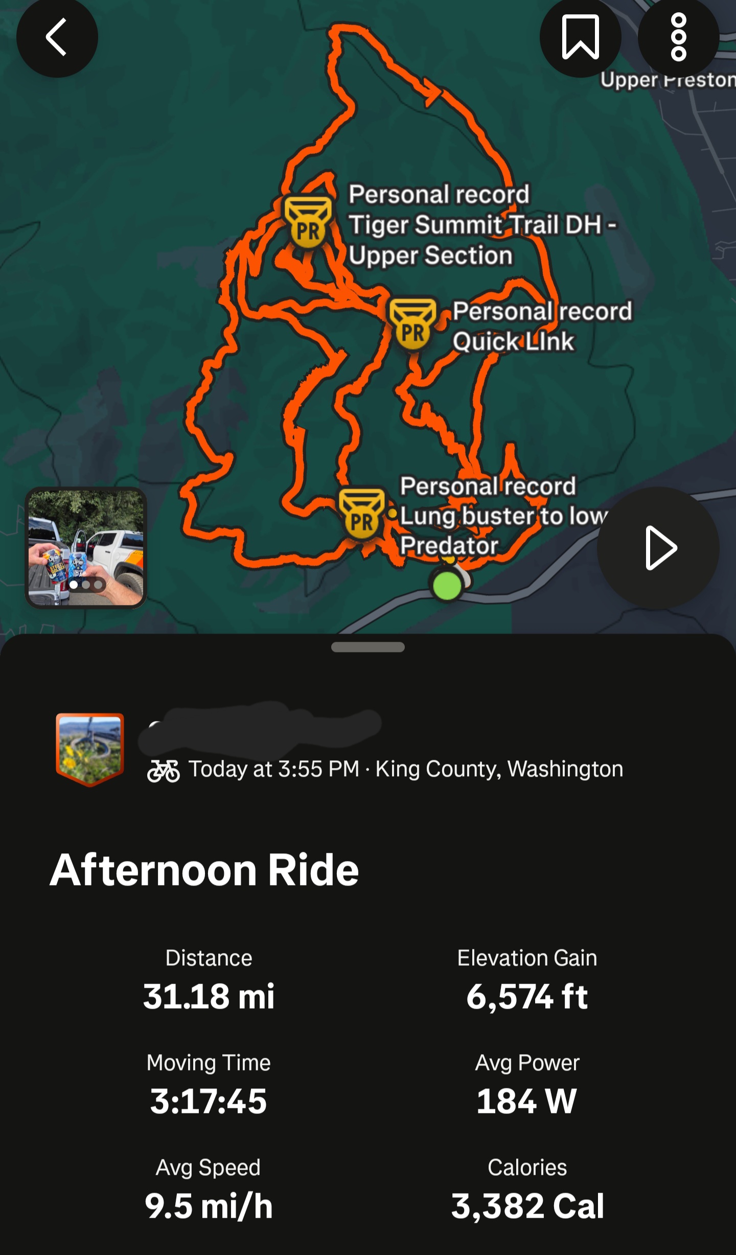

Does anybody know when will spare batteries be available? Don't tell me you don't do such rides for +2k meters (6,5k ft) with high assistance :LOL:
I was thinking the same thing, but did that yesterday one 1 battery. My other emtb is a santa cruz bullit with ep8 and 630wh battery. Now im convinced those batteries are functioning at like 400wh each after a few years of use. I regularly do 2 battery rides, but seeming 1 might be sufficient with the dji 800wh. I am 220 lbs with gear and was using power levels equivalent to the EP8 on trail mode. If you leave the power assist at the default levels you'll be going through way more battery, but it will have way more power than necessary imho.
I found a 400wh bottle cage range extender for avinox offered out of Europe, but have not received a response. I think with 1200 wh, theres no need for a 2nd battery ever.
What Avinox setting(s) did you do this ride in? Care to share screen shots of you assist level settings?

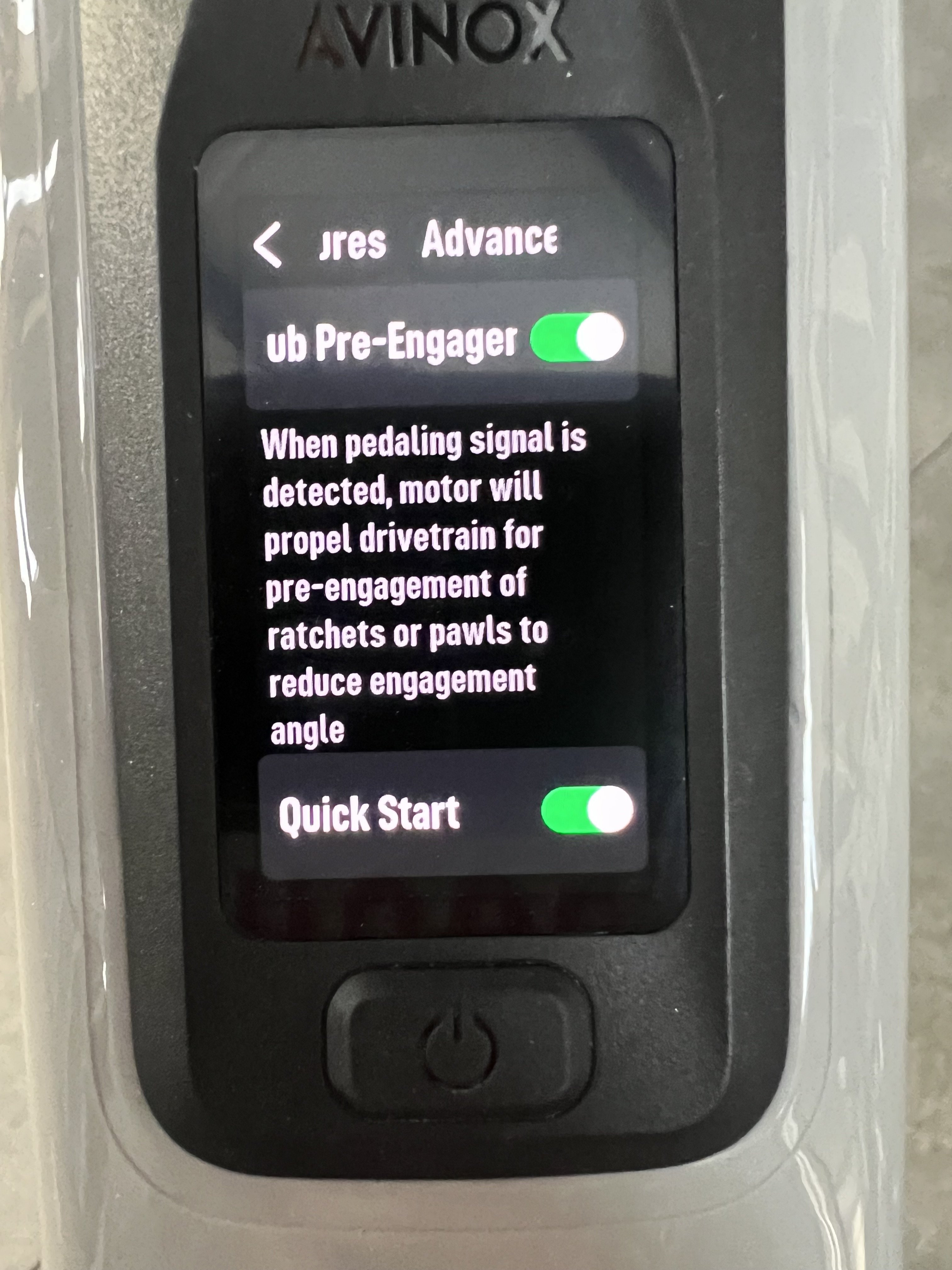

Mine was already set on.
I wonder if this would cause more motor rattle, sounds like the motor would be taking up my SideKick hub slack?!…..but only when I’m pedaling it states. 🤔
I think I’ll be turning this off for my next ride to listen to the difference.
UPDATE: holy crap this feature drastically changes how the assisted power comes on!! Put your bike in a stand with the rear tire off the ground, change the setting and push the pedals and see what you notice! Wow
This is fascinating. I really want to get back on the trail now and try it without this setting on.
That's intriguing actually. Although it might be increasing rattle and pedal kickback.

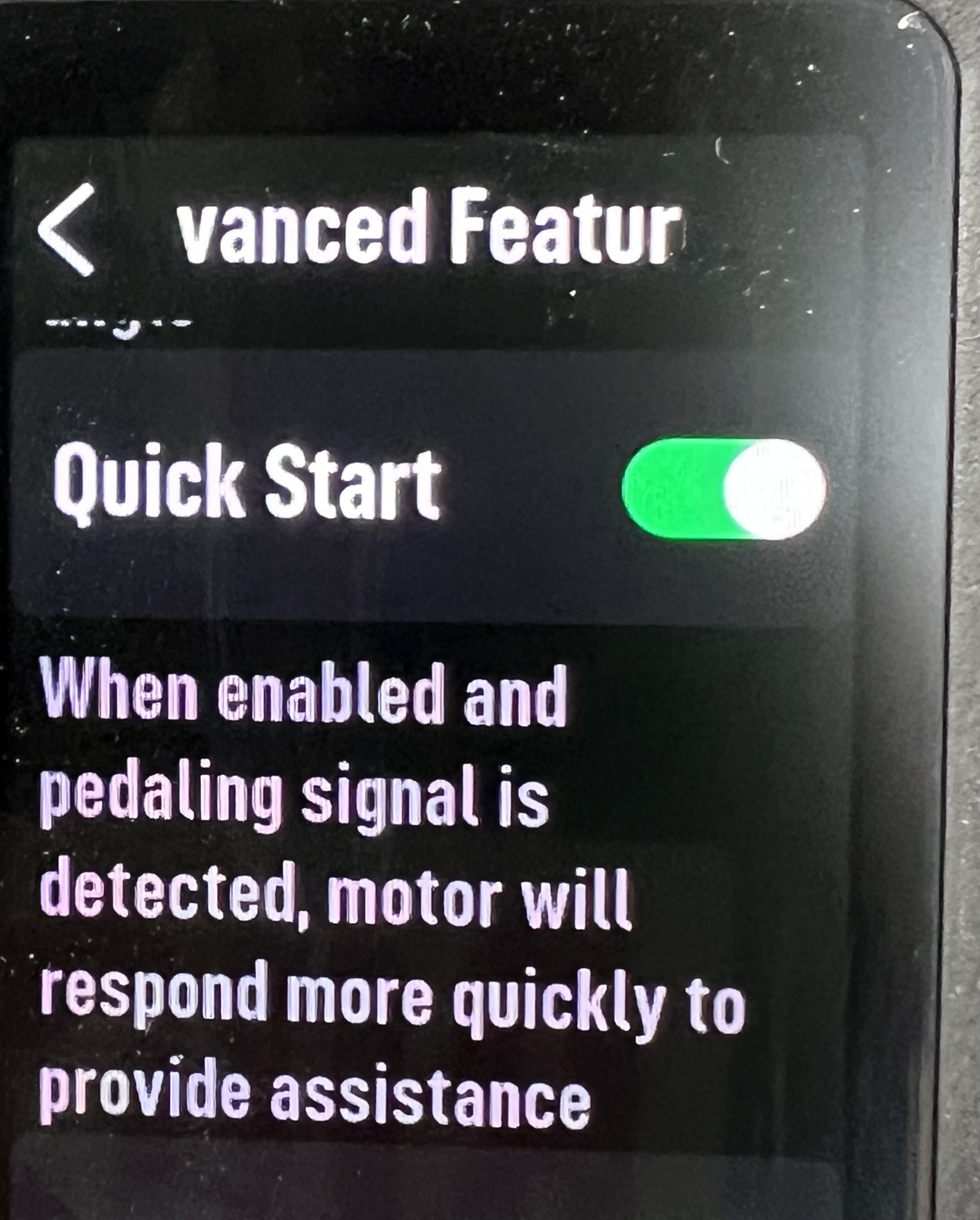

If you’re replying to what I’m talking about, I wasn’t talking about QuickStart. QuickStart is the option below the Freehub Pre-Engagement in the menu.
But both of these options turned ON may be the reason I felt the sensation that all the rider has to do is rest there feet on the pedals and away you go.
I’m definitely turning these off for my next ride to feel and hear what I prefer.

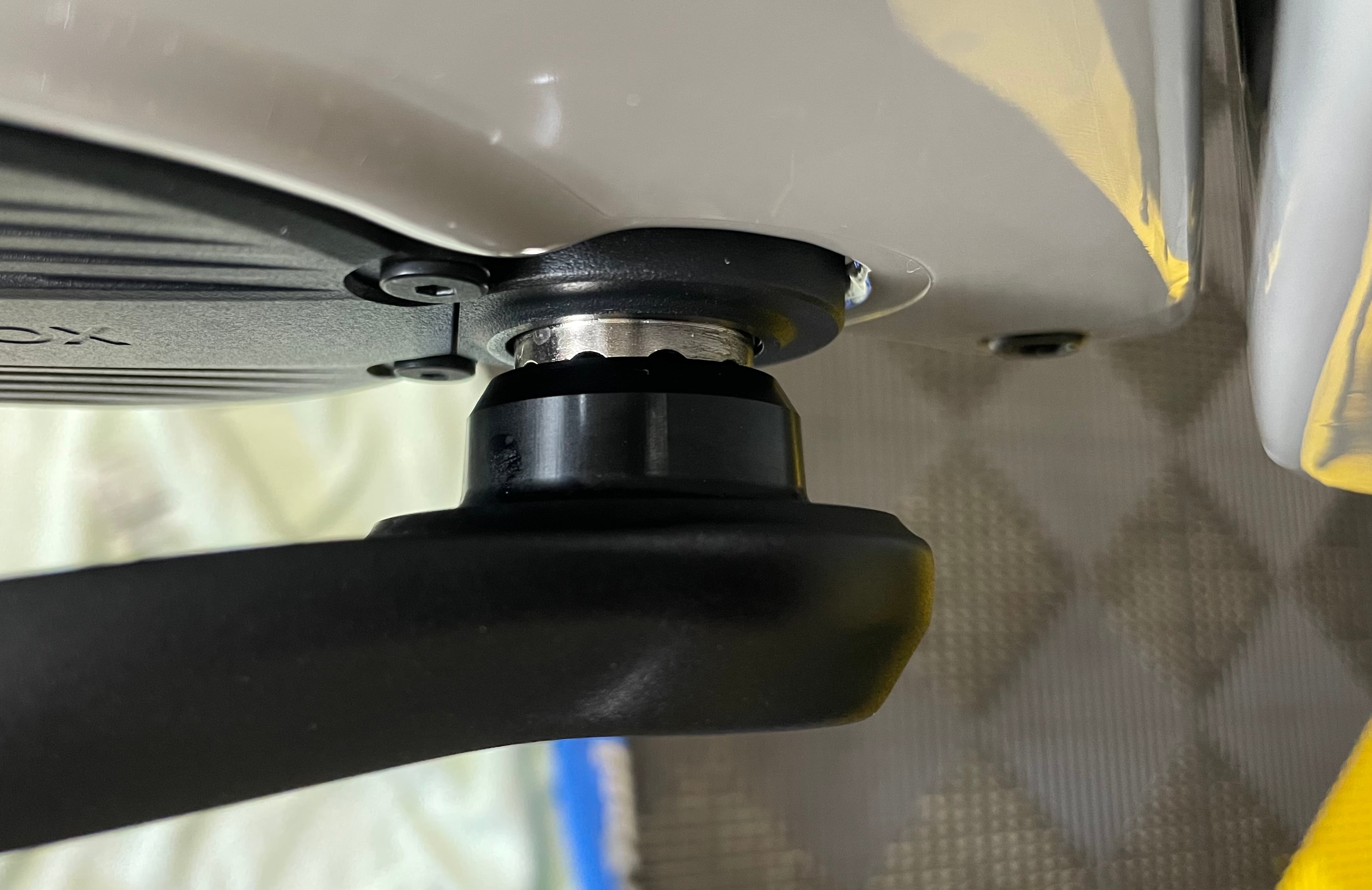

For those who installed the AXS derailleur battery cable, does the motor need to be dropped to get to the connection?
Only had one cup of coffee at the time... in regards to Quickstart, I can see that function feeling very unnatural and odd.
For those who installed the AXS derailleur battery cable, does the motor need to be dropper to get to the connection?
As I mentioned in the past, just remove the forward motor bolt. The motor will rotate down on the rear bolt, giving you enough room to access the cable.
Blue loctite and torque motor bolts to 15Nm.
