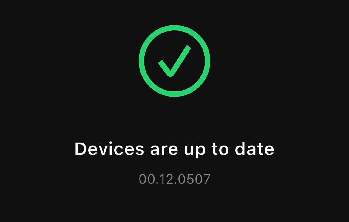

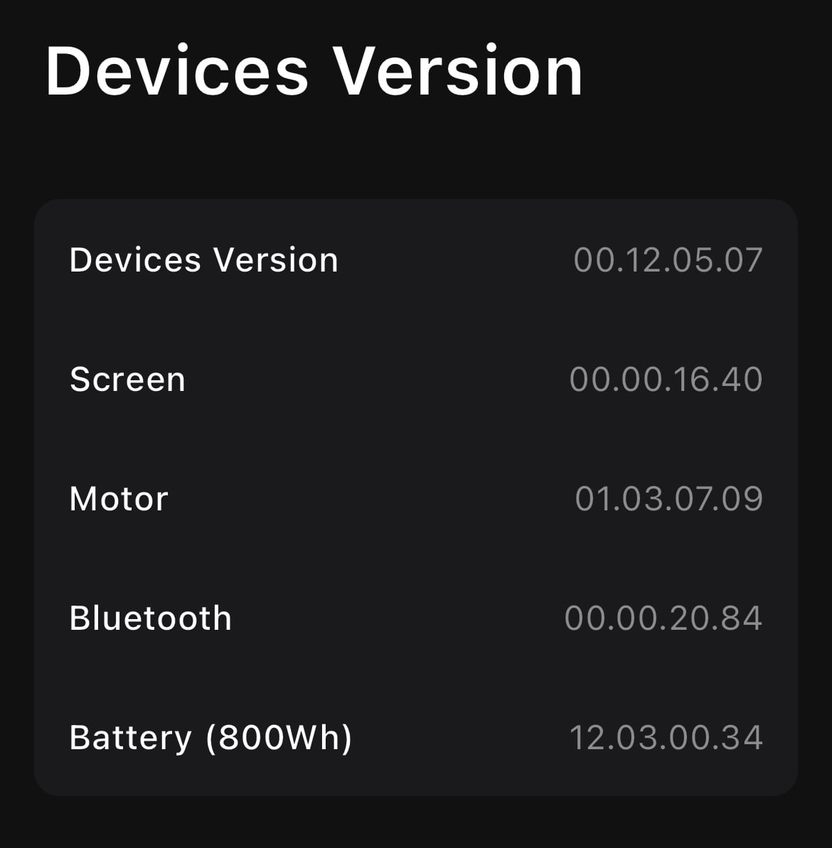

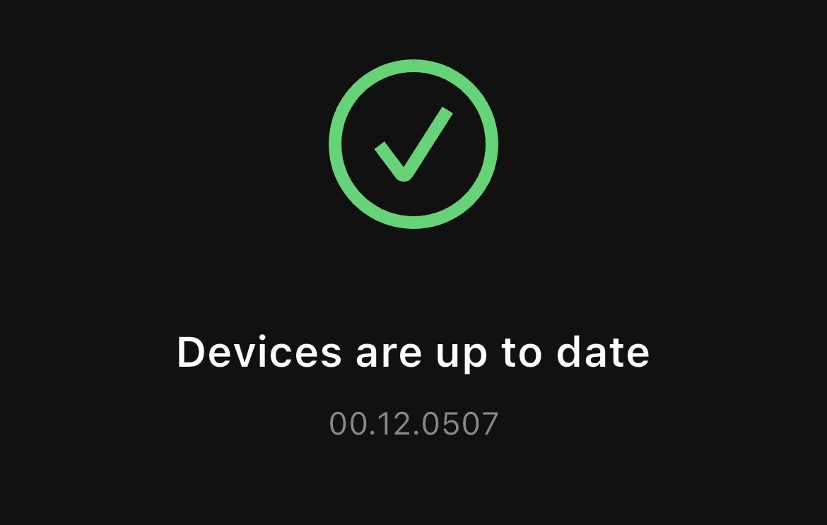

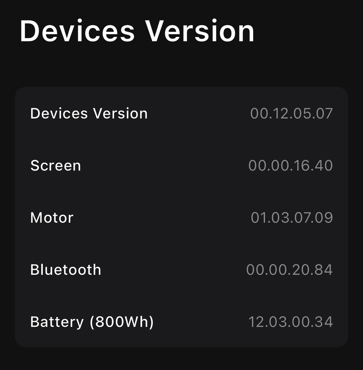

It doesn’t make sense to me why a 99 count frame batch from the same manufacturer would have two different versions of motors. If this is even the case.
I would expect the next batch of Crestlines to have a different version.
I think it's very speculative to say there are different versions of the motor. Manufacturing variances are more likely and the video of the two motors isn't exactly conclusive. It would be interesting to hear what Avinox has to say.... the Amflow customer support thread might give an answer since it's all the same motor????
View attachment 166139 View attachment 166140
Don't forget motors came independent from the frame and then they were installed. If there are indeed two versions of the motor out it's roulette which motor you received.
