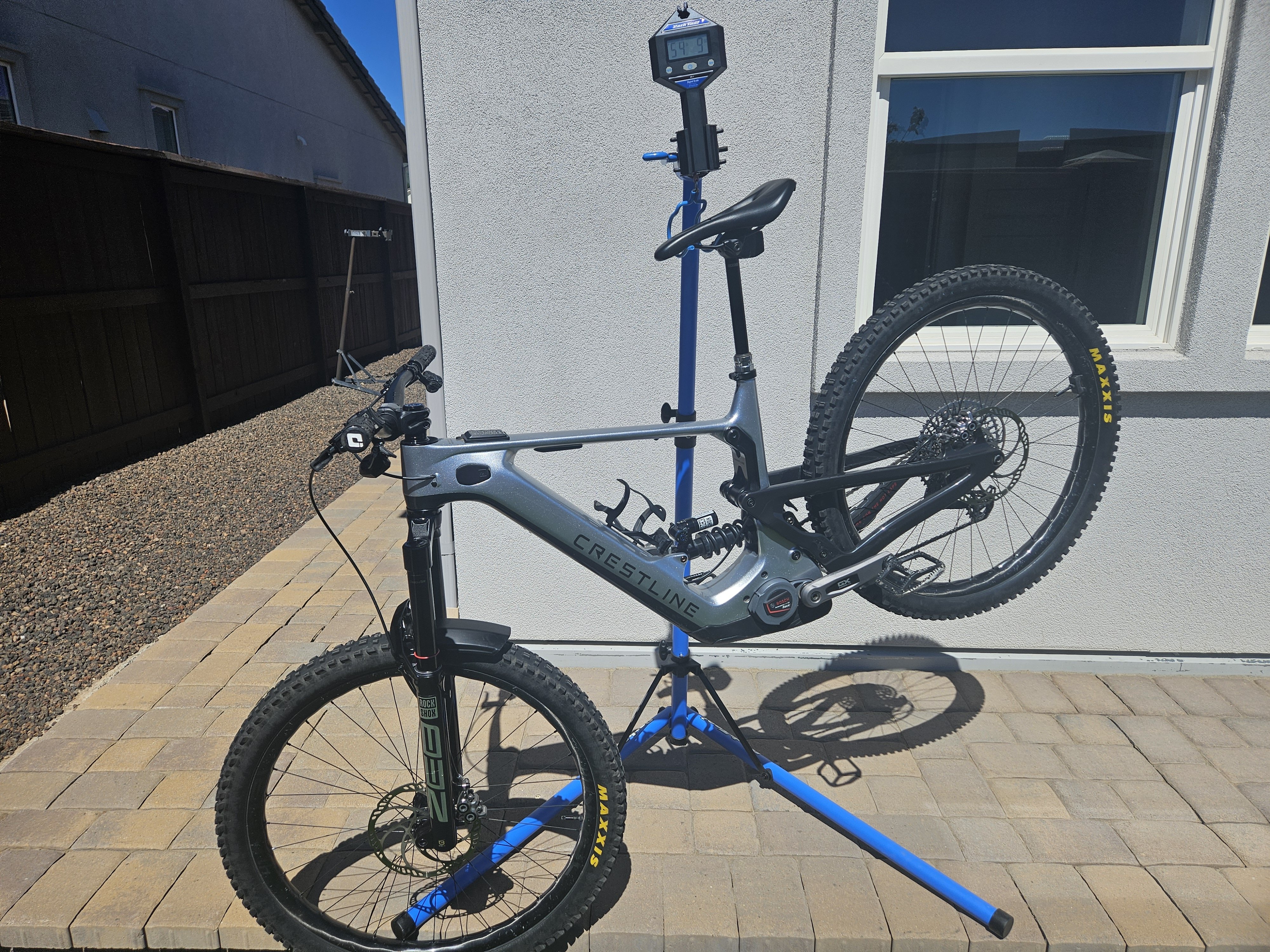

Installed the chainring and cranks and turned the cranks on the bike stand and notice a good amount of resistance on the motor. Even back pedaling was a lot of resistance.
I haven’t turned the bike on yet since I don’t have a fork or wheels setup for it yet, I was just spinning the cranks. Do u guys notice this also? I have had an EP8, Bosch Gen 4/5, Specialized motors and none of them have any resistance when backpedaling and had very little resistance pedaling forward.
Please let me know if you guys experience the same thing or perhaps there’s something wrong here.

My cranks back pedal freely. Check the rubber boot on the back of the Helix-R crank arm. It can rub the surface behind it. Seen this on another DJI Crestline.

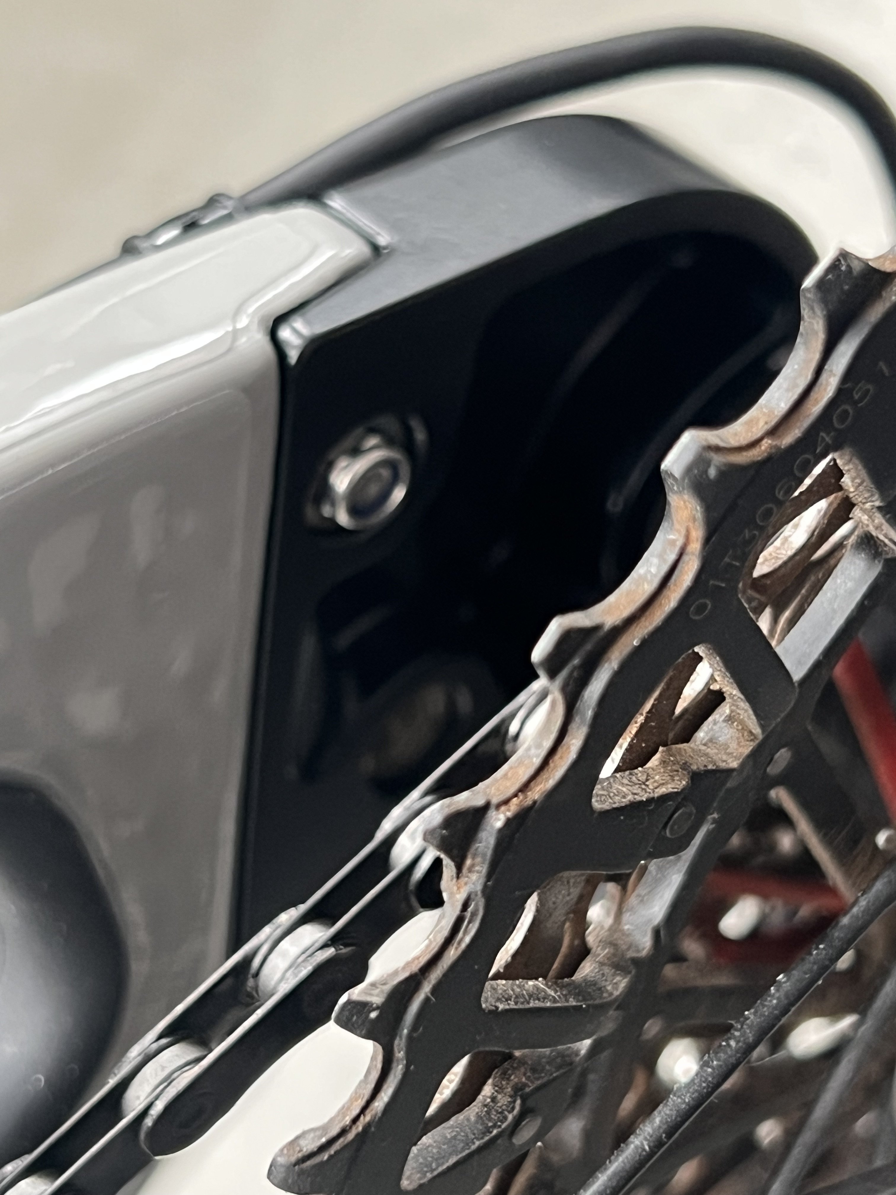

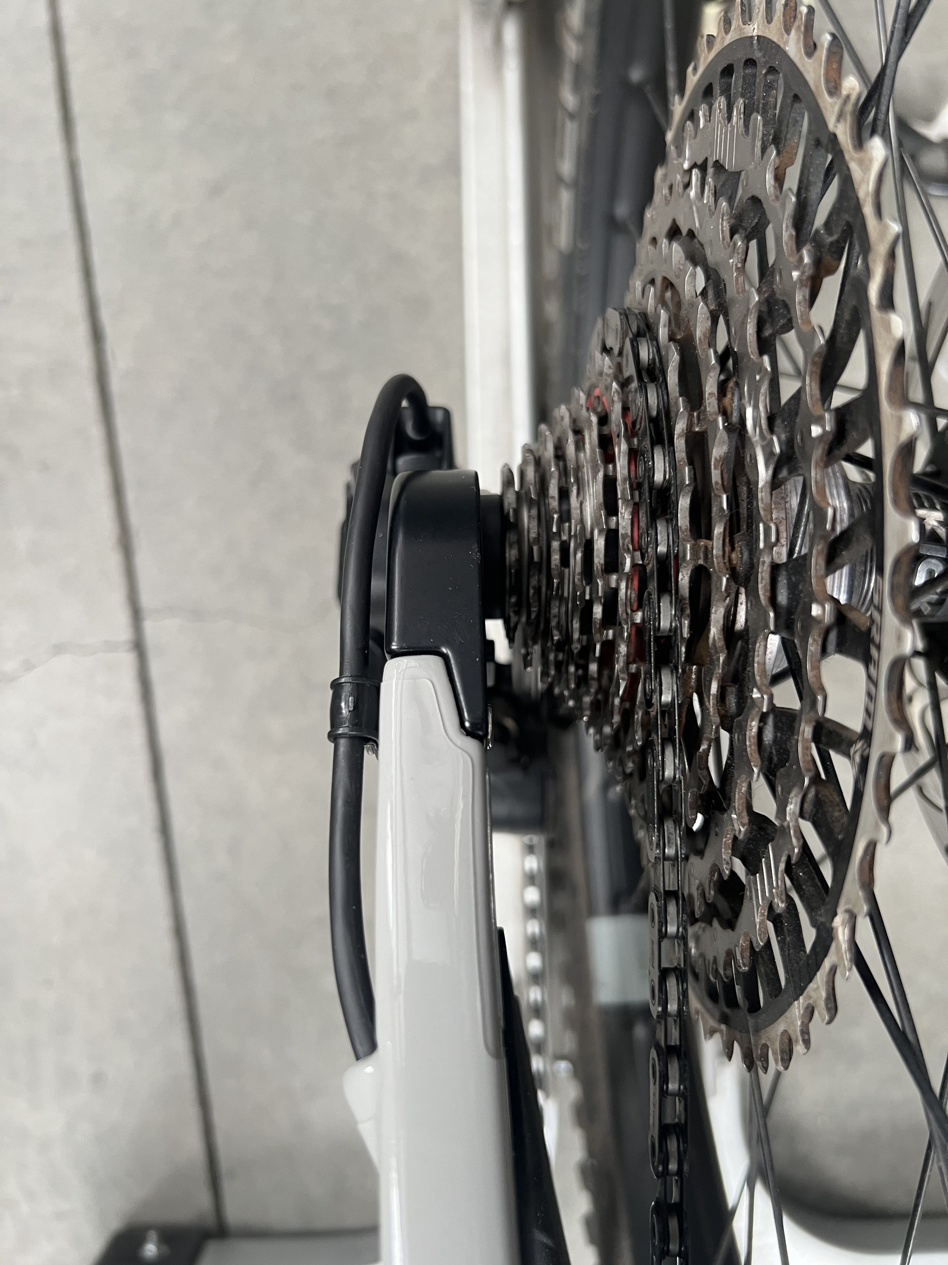

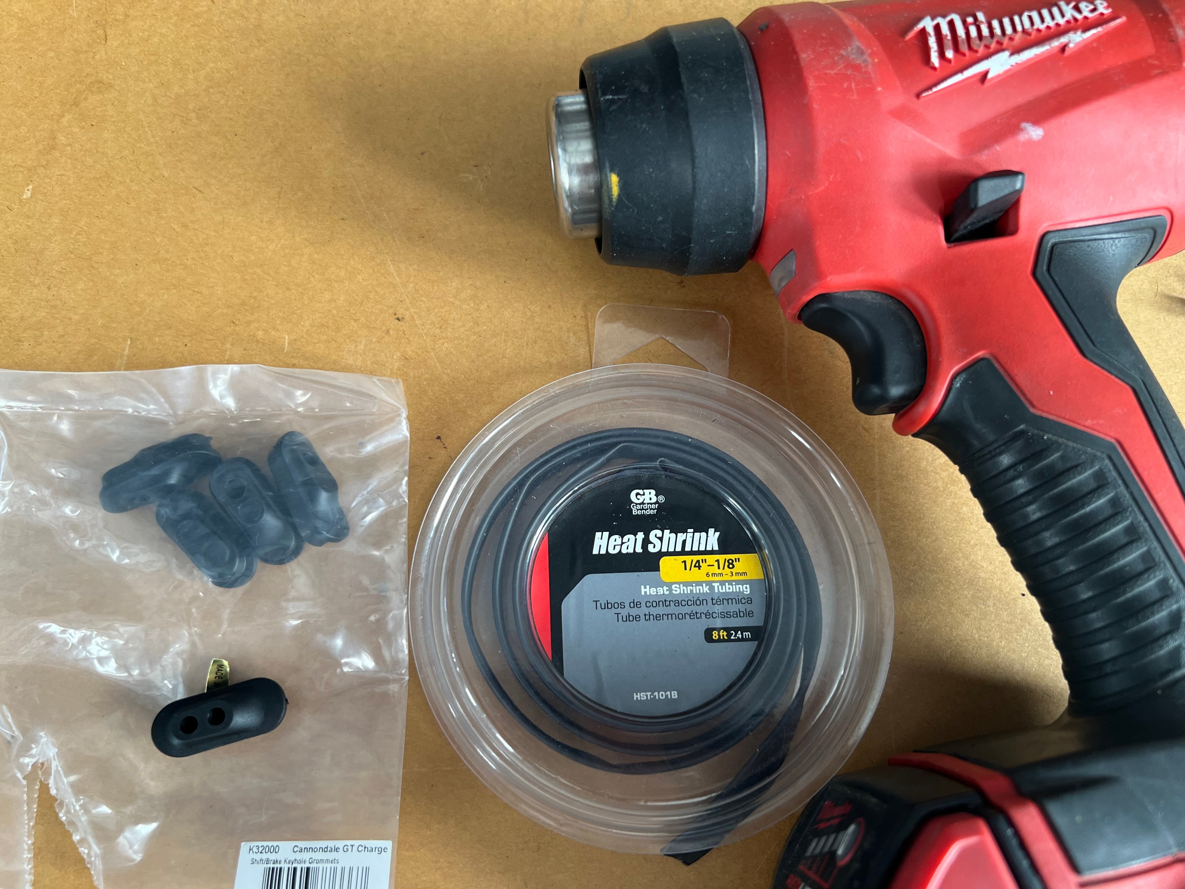

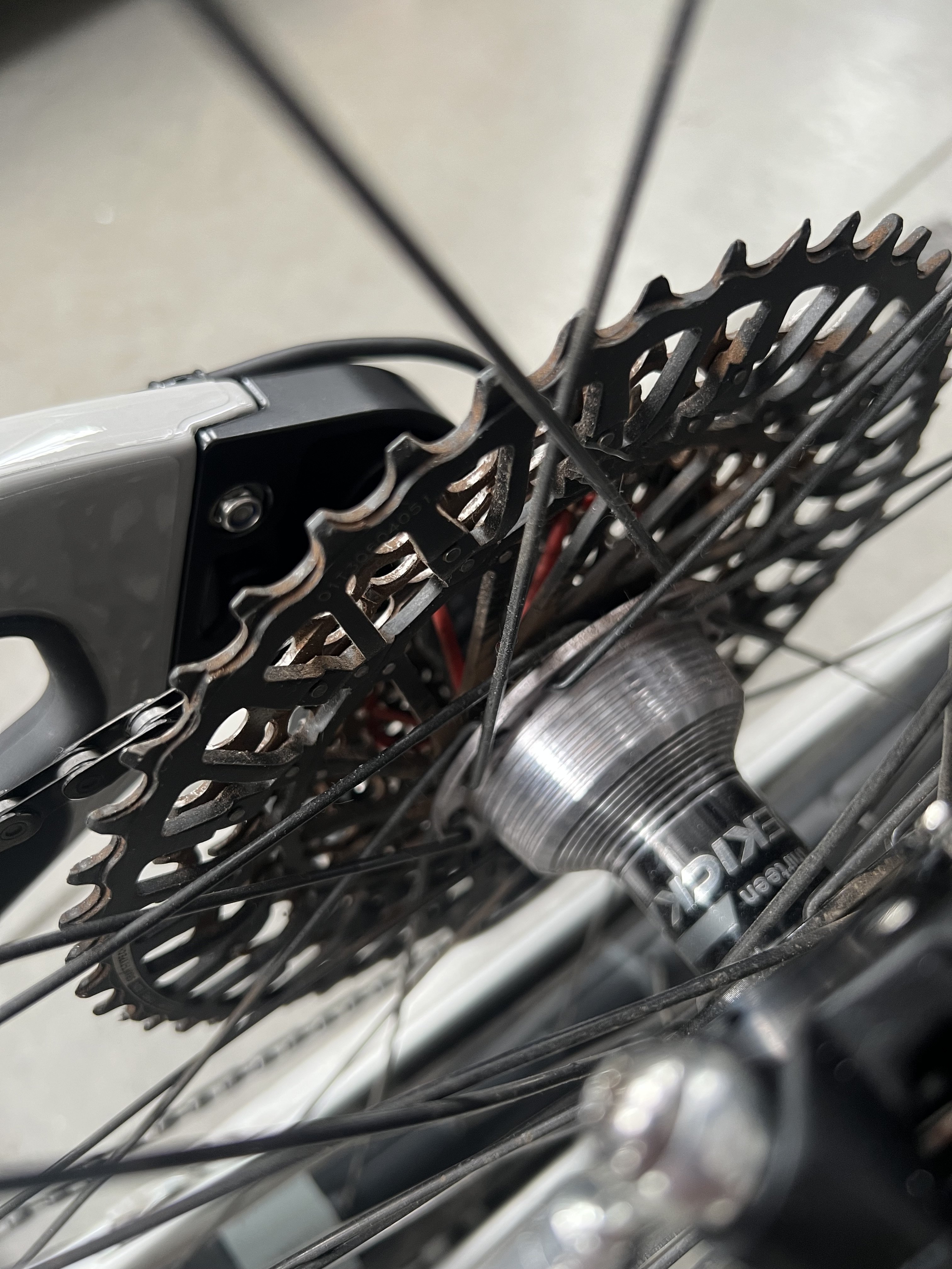

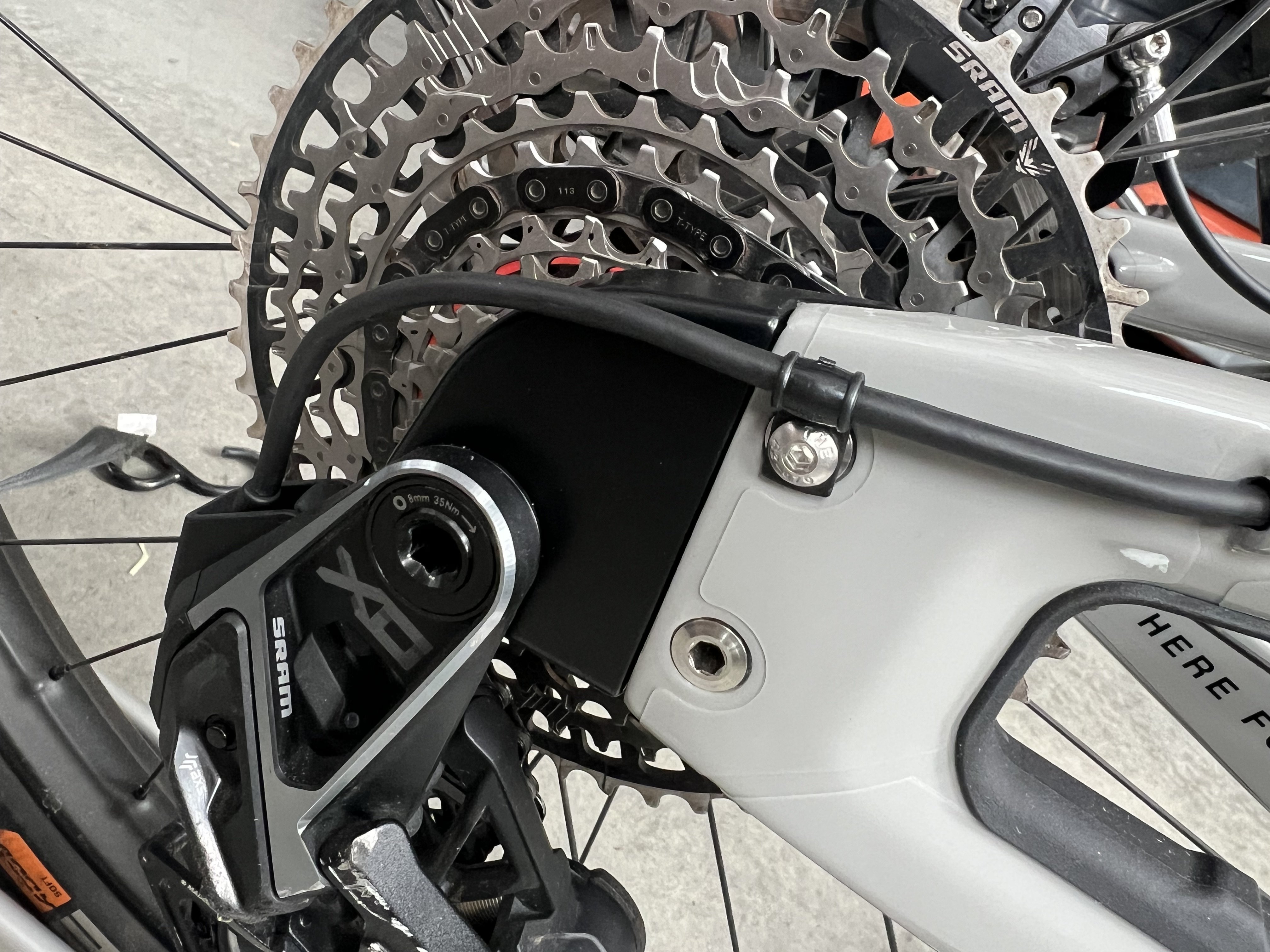

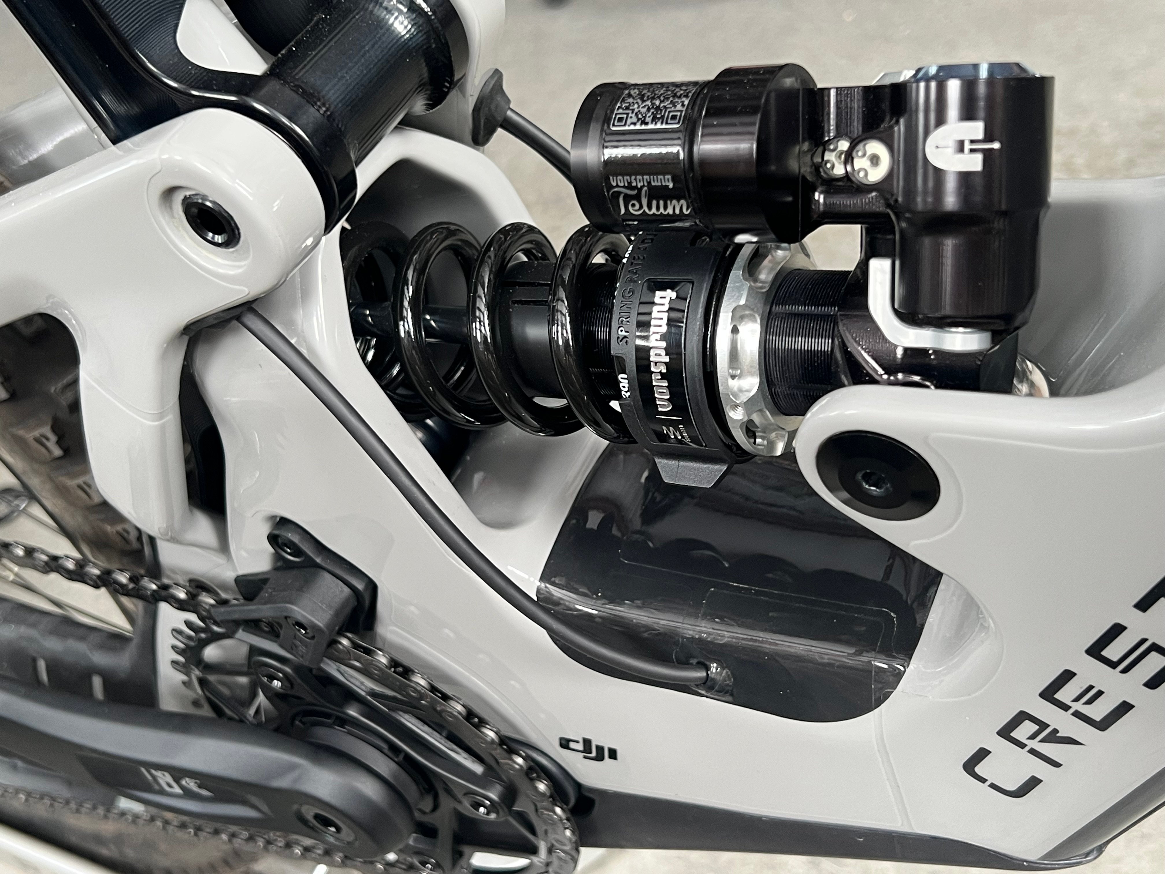

I added two layers of shrink tube to the exposed areas of the derailleur power cord because I didn’t like how dainty and vulnerable it is! The two layers of shrink tube in the two expose areas make the wire much more stiff, and obviously thicker, which makes it almost the diameter of a brake line. (Not flopping around in the wind) It looks much better in my opinion and fills the frame pass through hole better as well.

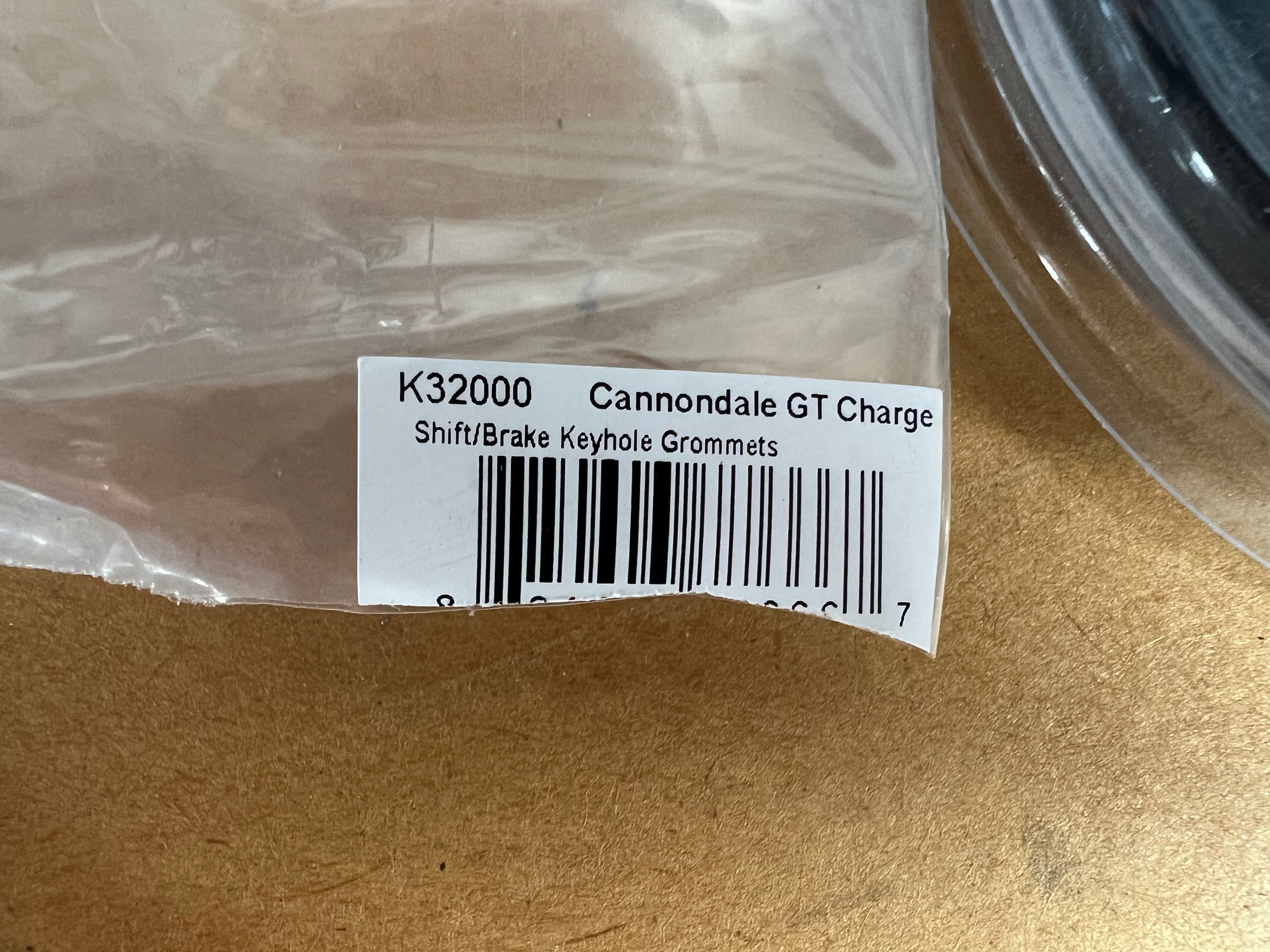

I also installed Cannondale frame cable grommets as they are much higher quality than the ones provided and I had them from a previous build.

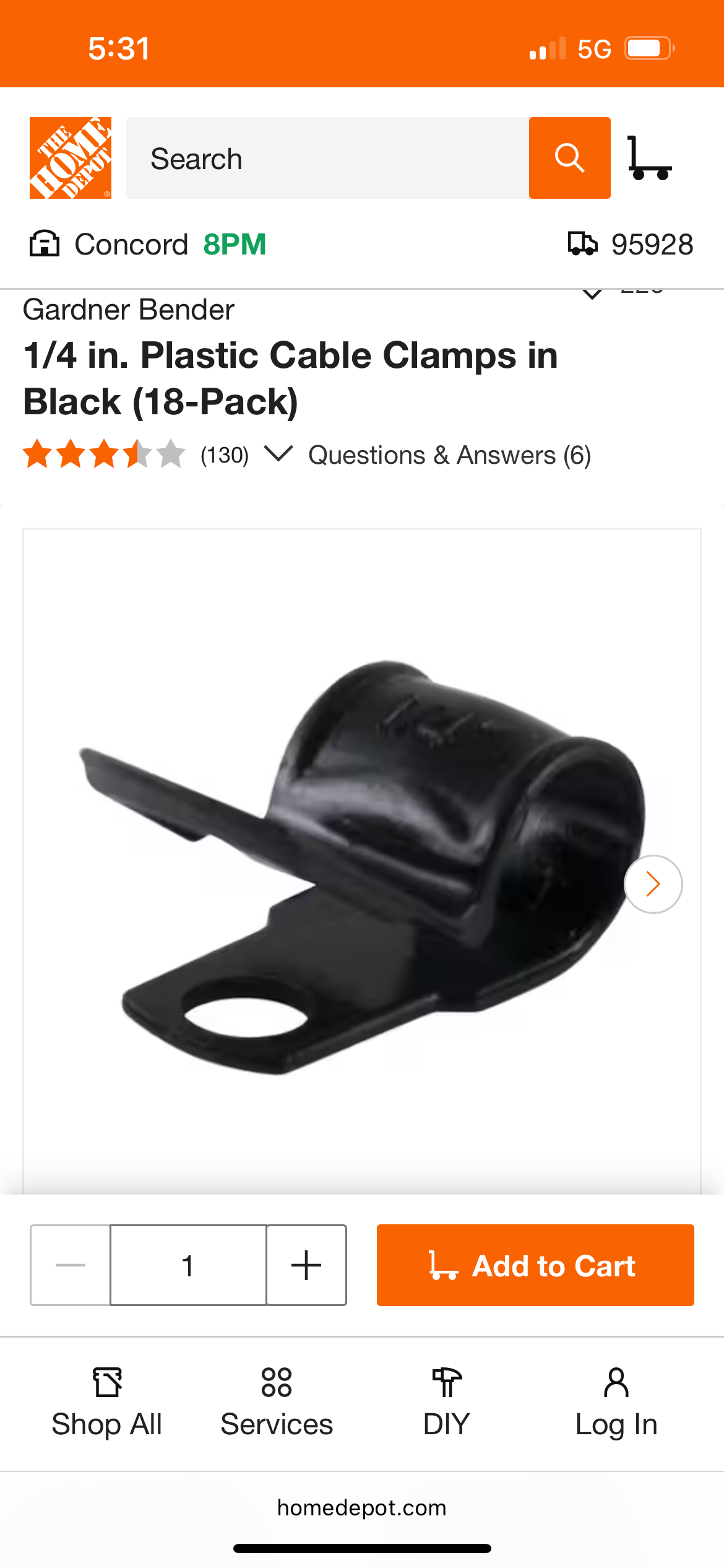

I also didn’t like how the derailleur power wire stuck out by the drop out, which made it very vulnerable for getting snagged. So I installed a plastic cable hold down using a stainless M5-0.80 x 20 bolt that goes through the factory hollow dropout fastener, and the nylon lock nut fits perfectly inside the drop out allen fastener on the inside so you only have to tighten the bolt on the outside, while the inside dropout allen holds the nut from rotating.

Thanks for that idea !

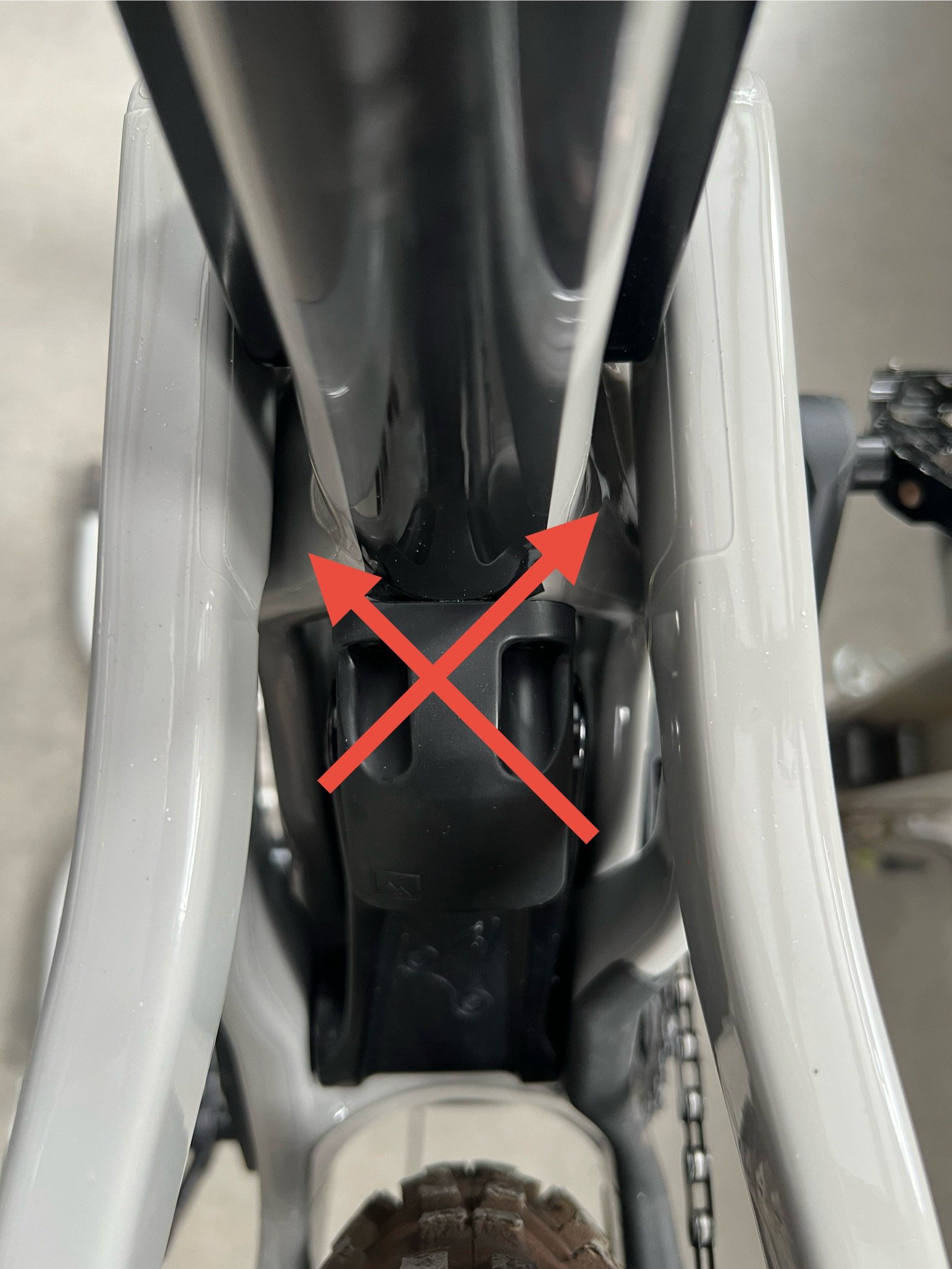

And for anyone that doesn’t like the crank arm small gap on the drive side, I took my crank gap cap to my bench belt sander and sanded it down until it would fit without rubbing the chainring lock ring.
You can see it in my previous pic.

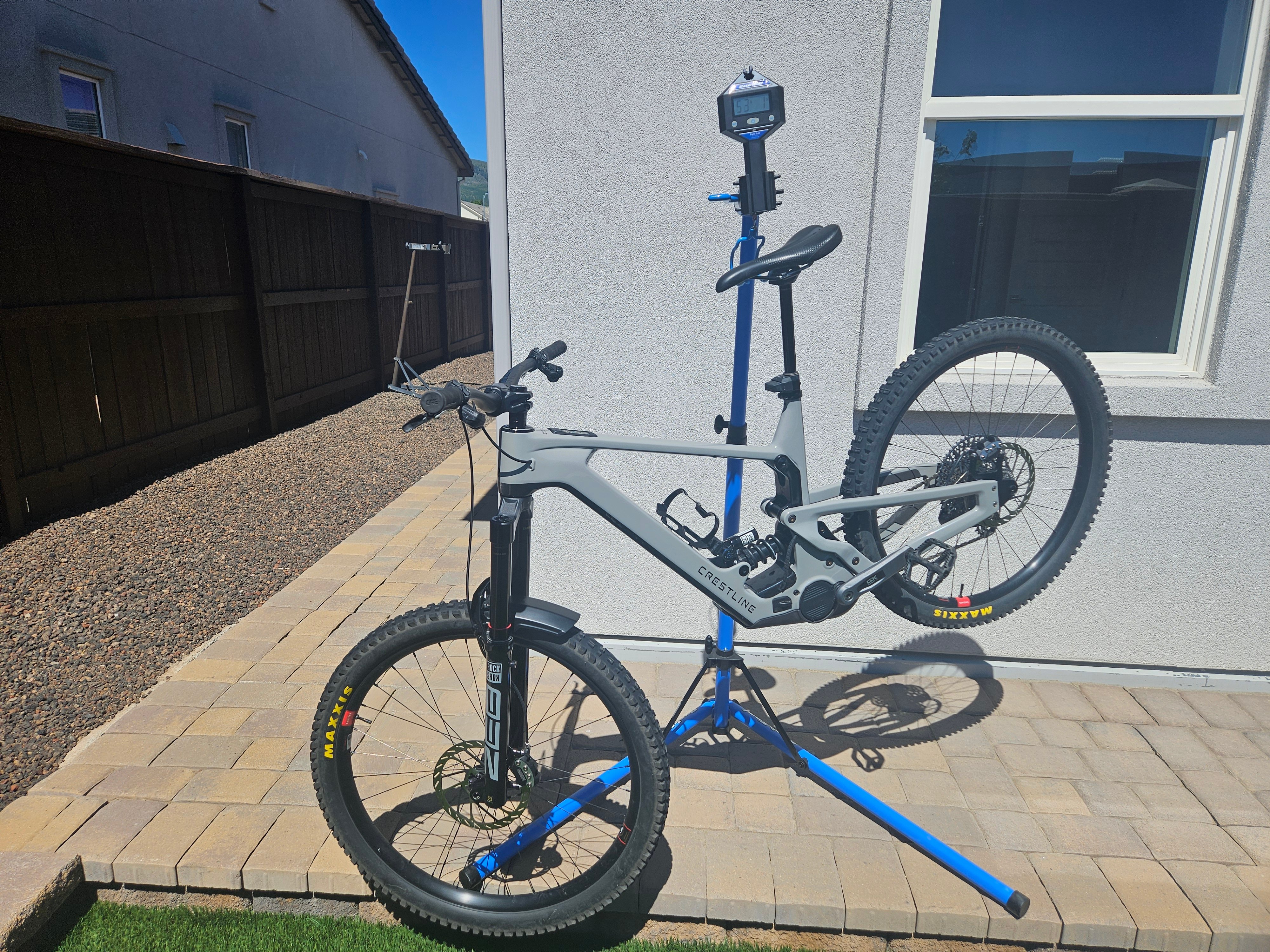

Quick rip today, ~2200ft, little over 6 miles, mostly all boost with turbo a couple times to make the steep climb cake. Used about 32% battery.
First couple rides were 160/160 configuration. Today was 180/170 as I don’t have a 180mm airshaft at the moment. I definitely prefer the 180 setup, the 160 feels like you’re hitting a limit that shouldn’t be there. The bike just feels like it has more to give but it’s locked out.

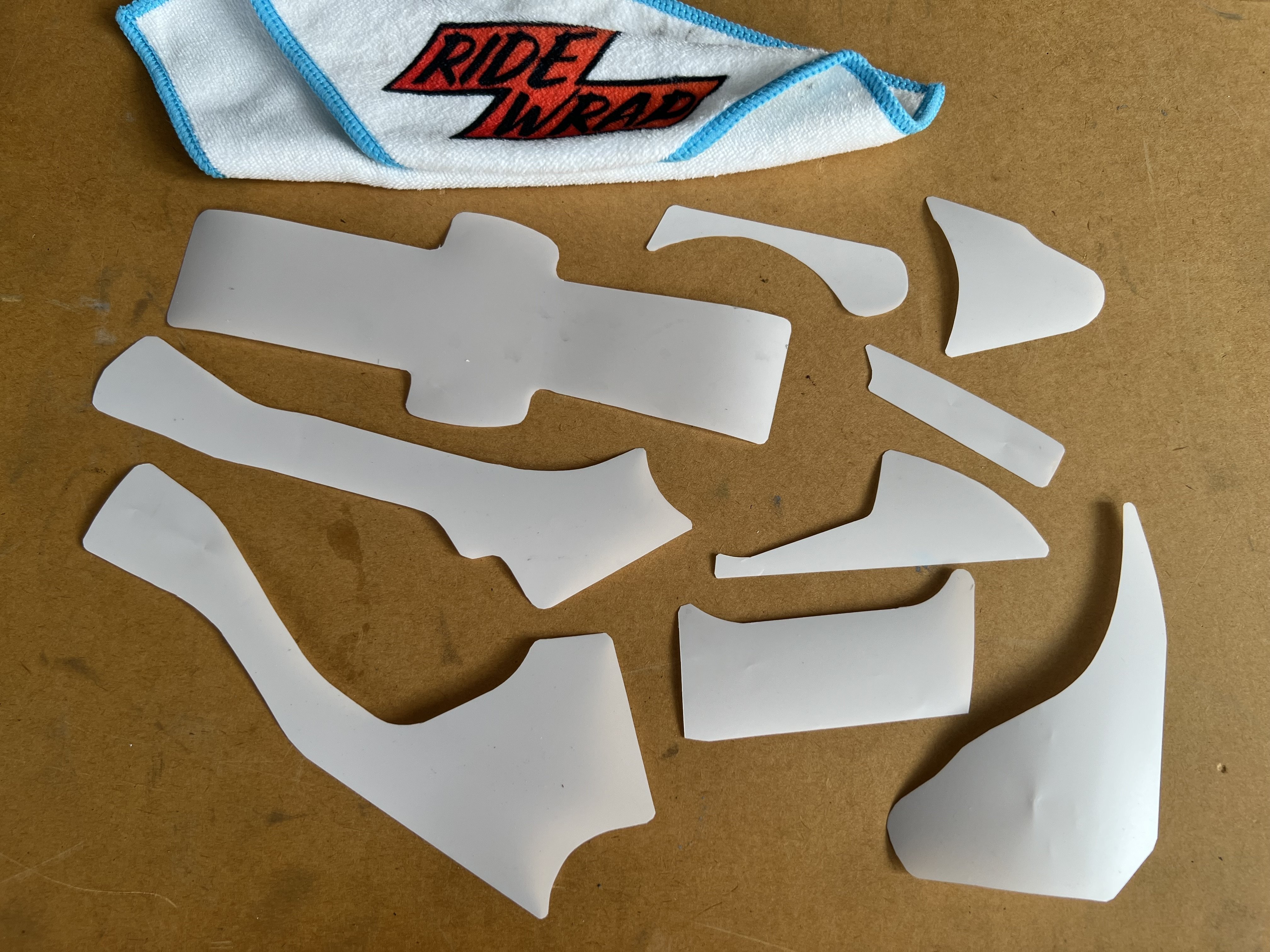

For those of you installing Ride Wrap. They designed this kit without the chain stay guard installed, so the chain stay drive side Ride Wrap piece has to be cut into three different pieces and resized to accommodate the perfectly designed Crestline chain stay protection.
I also designed and cut several custom pieces for other places on the frame that Ride Wrap didn’t provide because they make their kits so you can install all the pieces without disassembling anything. I discovered on my last Crestline that due to the VPP suspension layout and the swing arm being extremely close to the shock tunnel, on a few occasions I had small rocks come off the rear tire and get jammed in between the inside of the swing arm and the outside of the shock tunnel. While the suspension is cycling the little rock will sit there and chew into the paint primer without you knowing! (It requires the perfect size little rock for this to happen) So I designed and cut Ride Wrap pieces to go on the inside of the swing arm and the outside of the shock tunnel in the hidden areas, it requires removing the upper suspension link bolt to swing the swim arm away to gain access to these areas. This proved successful on my last Crestline.
I keep the Ride Wrap backing paper from the custom cut pieces so I can recut more if need be later on.
Suffice to say none of the 2 gap caps fit out of the box? The derailleur power cable saver is a good idea, that looked problematic flapping in the wind!
I only had the one gap cap that came with my SRAM 90 cranks. Which was know where near large enough to go over the chainring lock ring. But after sanding it down a lot, it closes up the small gap. Which doesn’t really bother me but I had the gap cap so I figured why not.

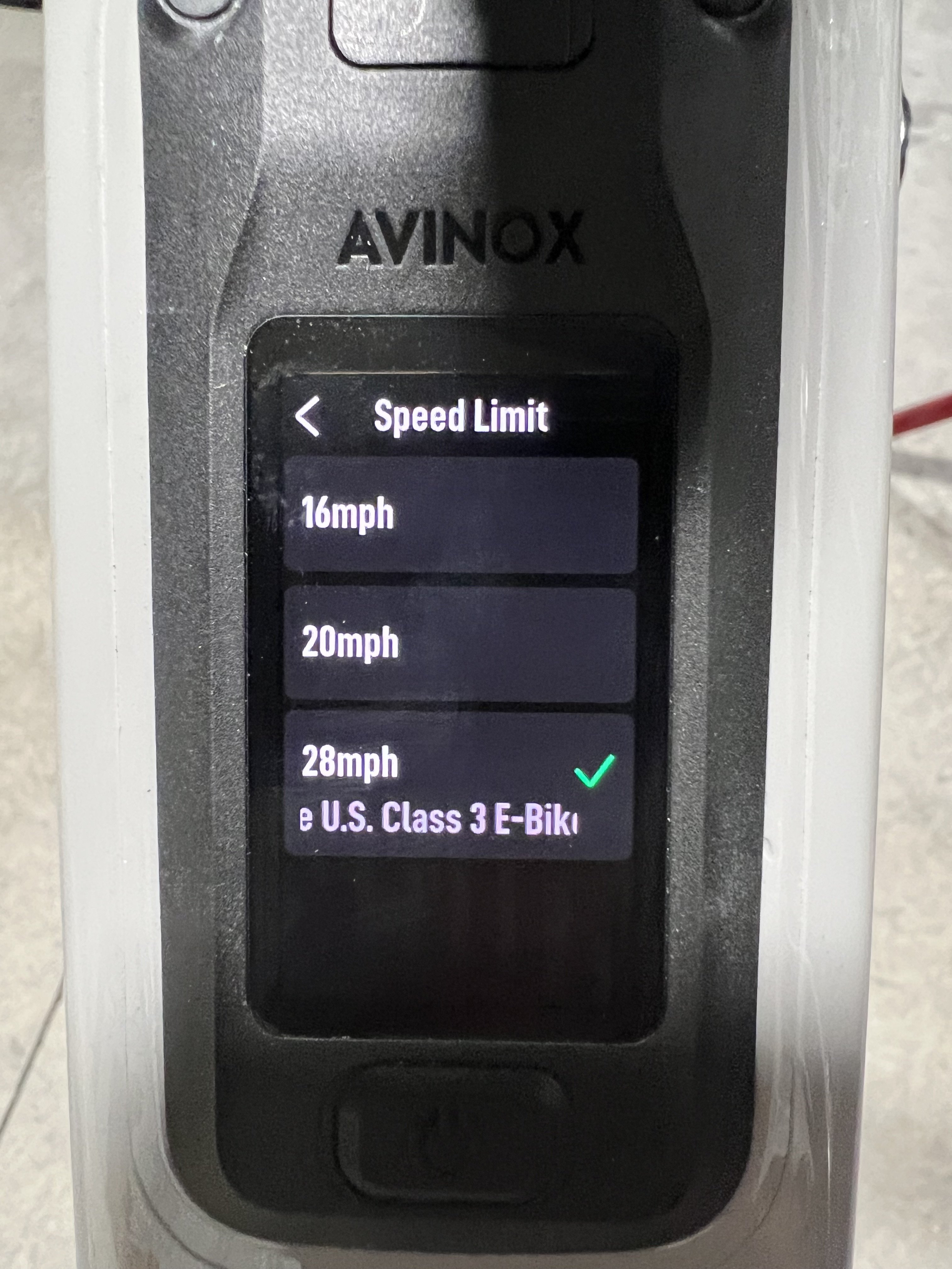

Anyone, especially those in US, figure out how to enable Class 3 mode? Based on couple friends who also have DJI Avinox system bikes in US, Class 3 mode isn‘t there in the app.
Thanks! This is very helpful, much better than bike shop build would do. Do you mind sharing detail on the plastic cable hold piece?
Im missing the speed limit option too. Pretty frustrating. I was texting with Troydon on Thursday about it. He said it should be there based on the current software. He said he would email dji (avinox). I haven't received an update yet.
I set up several things in a previous menu, one being the 28mph. But now I can’t seem to find that settings menu. Even on the phone app.
