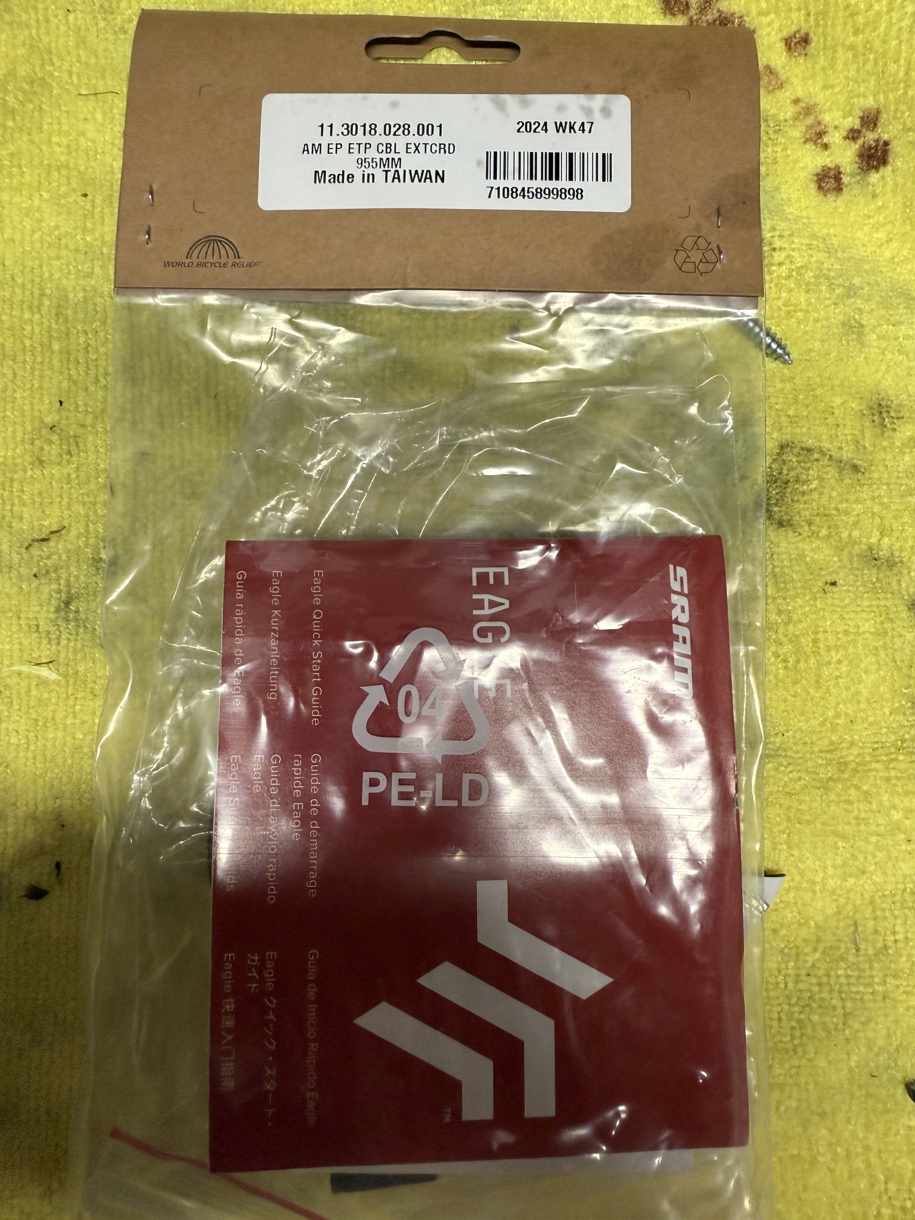

Sorry, been on heavy meds. What length cord did you end up with? I need to order
955mm was what @Rob Rides EMTB mentioned in a post so that’s what ordered.. If only going to the motor, seems like it will be quite long.. They make a 780mm wire too. Stay tuned, keep ya posted..
Apparently, they are discontinued and I can’t find them anywhere for the USA.
They’re not discontinued, just sold out everywhere in U.S. Pro Bike Supply had gotten some in stock last week, briefly, they were sold out lightening fast. I bought one, or I thought, got an apology email saying it was over sold. Search continues…

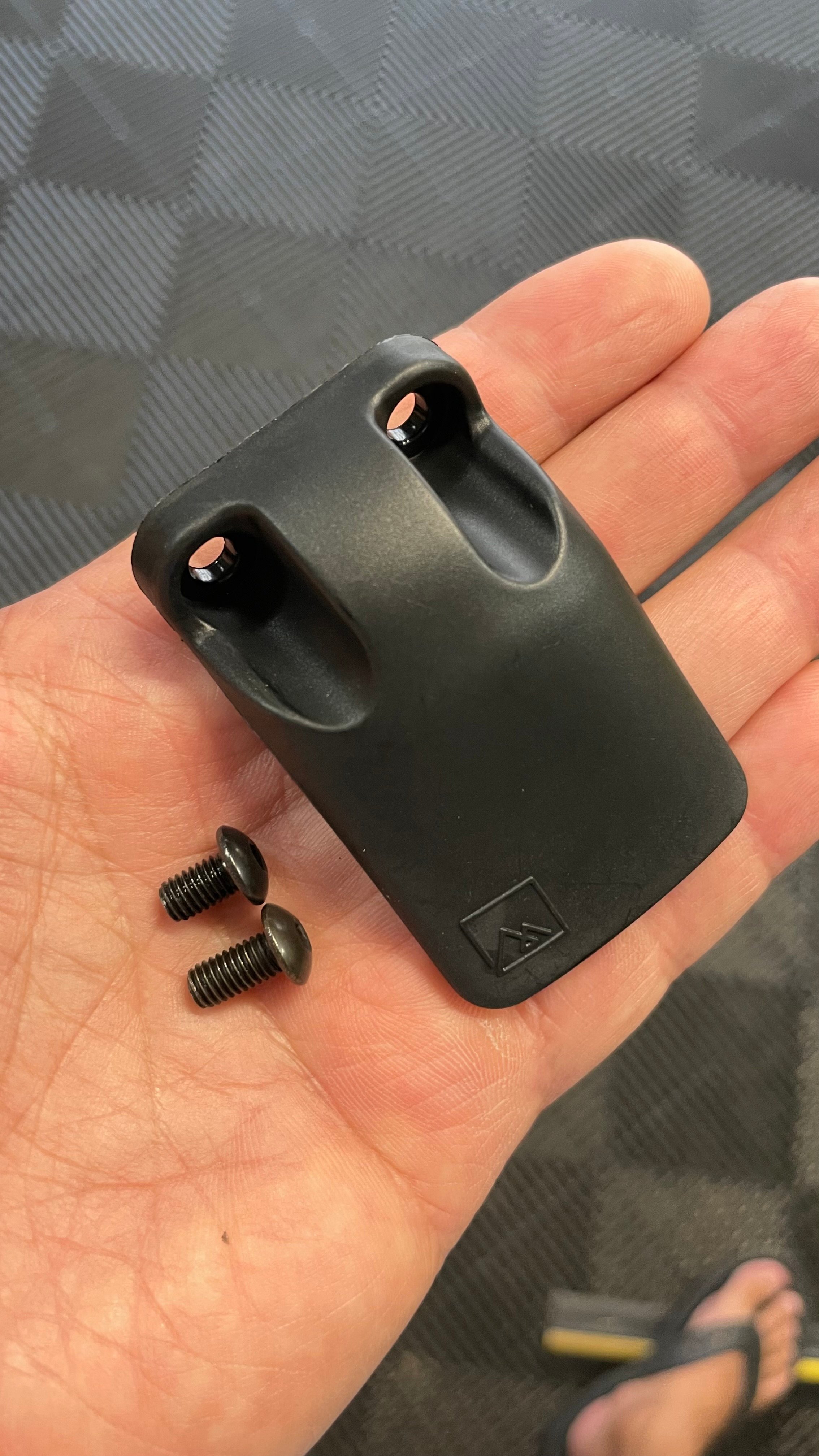

I added two layers of shrink tube to the exposed areas of the derailleur power cord because I didn’t like how dainty and vulnerable it is! The two layers of shrink tube in the two expose areas make the wire much more stiff, and obviously thicker, which makes it almost the diameter of a brake line. (Not flopping around in the wind) It looks much better in my opinion and fills the frame pass through hole better as well.
I also installed Cannondale frame cable grommets as they are much higher quality than the ones provided and I had them from a previous build.
I also didn’t like how the derailleur power wire stuck out by the drop out, which made it very vulnerable for getting snagged. So I installed a plastic cable hold down using a stainless M5-0.80 x 20 bolt that goes through the factory hollow dropout fastener, and the nylon lock nut fits perfectly inside the drop out allen fastener on the inside so you only have to tighten the bolt on the outside, while the inside dropout allen holds the nut from rotating.
Did you bundle the rear brake hose and speed sensor cable into one shrink tube? Speed sensor cable is flimsy and vulnerable.

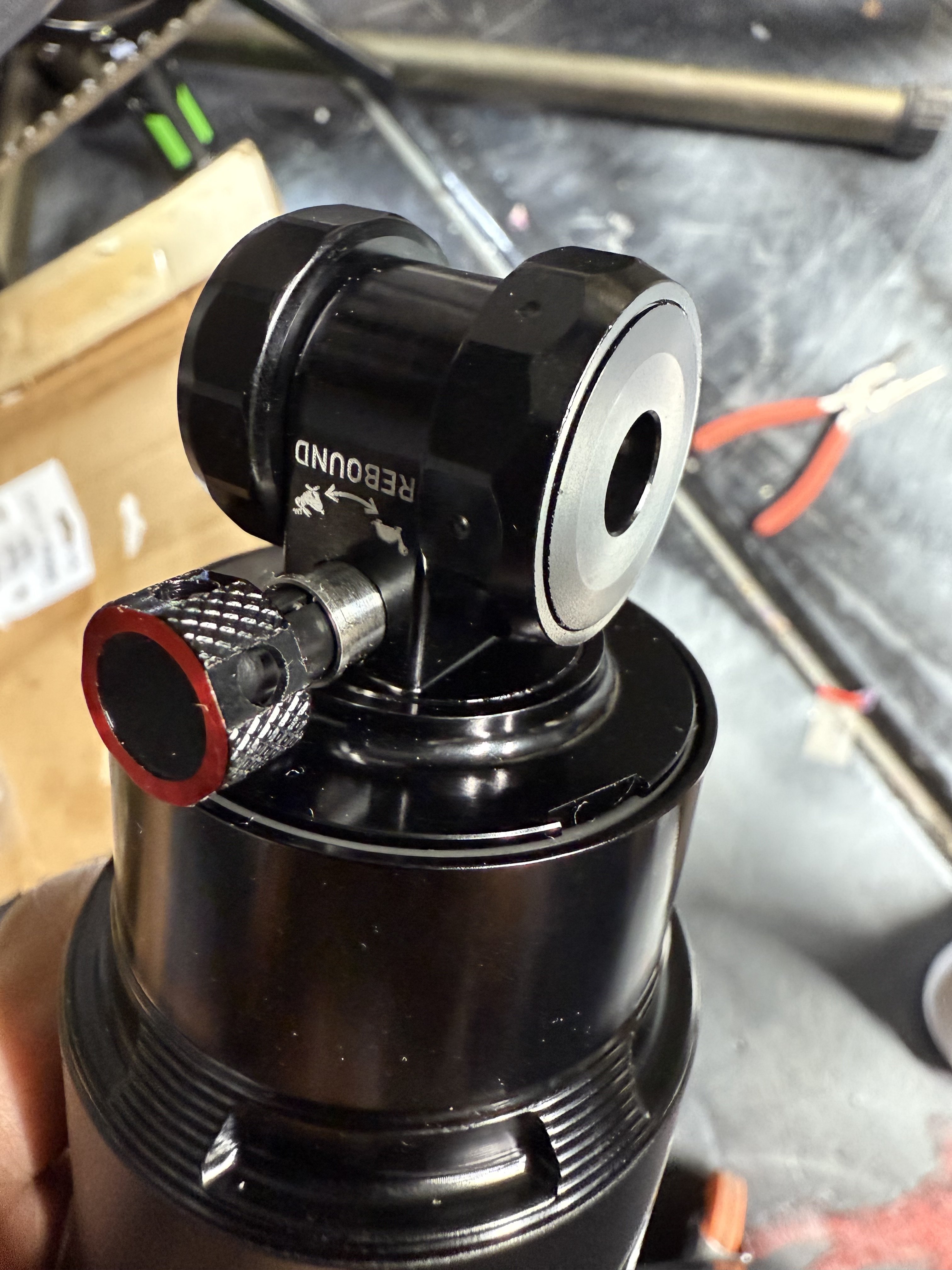

Never seen this style of bushings before on the Vivid Air.
How do you remove it? I’d like to reuse the hardware if possibly on a Fox DHX2 Coil shock. Do you just use a big crescent wrench and loosen it? It’s got little dimples on one side and none on the other.
Leave it and buy new hardware for the new shock.
