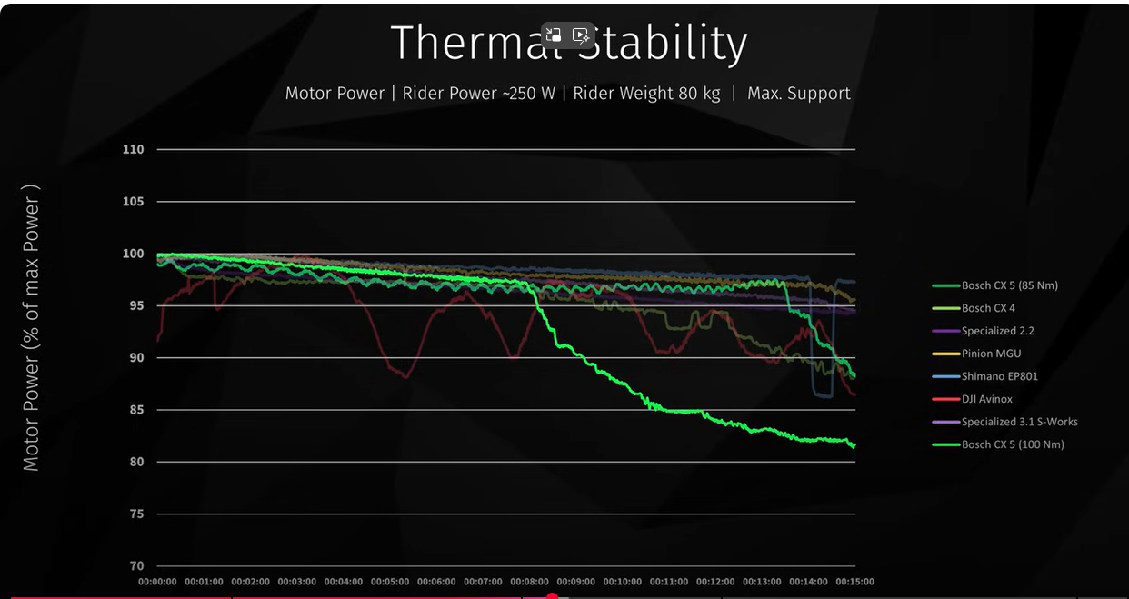

Review this test: 30 eMTBs in Our Huge 2025 E-MOUNTAINBIKE Comparison Test: What’s the Best eMTB of the Year?
The section titled "1. Vertical Range Test".
They utilized power pedals to normalize power input (150w) and cadence (75rpm). I think the DJI has two issues: 1) it produces way more power at low cadence & low input, which isn't relevant at the numbers used above, and 2) it overheats and can end up with lower average power production on a long warm climb as shown by the Velomotion dyno results. Screenshot below. (I also acknowledge that there is a problem with this chart as it shows the 85NM Bosch at nearly the same 100NM peak as the new 100NM version!)
But the gist of it is that the Bosch bike tested (which was an anchor of a Haibike btw and about 2-3 kgs heavier than the 2 DJI bikes, the Mith & the Amflow)) climbed both faster (22 kph) AND more efficiently (44w/ 100m) under these particular circumstances than the DJI bike (Mith 50w/ 100m & Amflow 47w/ 100m, both at 21 kph). So, the Bosch bike had a higher average speed and a longer run time too (because it's 800w battery lasted longer).
It's just something to consider. The DJI powered HP bikes in particular seem awfully power hungry to me and it's left me feeling like a Bosch with Sidekick hubs instead of a DJI HP (I know the Crestline is not an HP bike) is going to get a lot more range and be a lighter package to boot. So much so that a 600watt Bosch in a 48# Regulator, might be faster and climb just as far as a 52# DJI with an 800w.
I'm just trying to figure out if I spring for the DJI, did I just add 3-4# (because it needs the larger battery) just for more streamlined looks, while also gaining significant rattle?
These thought experiments are for my own purposes as my divorce just got signed this very morning :) and I'm either buying a Spectre Crestline, or a CX-R Regulator as soon as they are available, as my Relay replacement. Yes, I obsess over this stuff!
This High Pivot Avinox used .70watts/ meter (27m/ km). I guess DJI power (some in turbo mode) mode combined with HP drag will do that.
He also said repeatedly that the pedals were sort of to pretend pedal and that the bike, even in the lower settings just rocketed off.
There IS a pattern forming here. I'm not 100% sure yet, but I think that a Bosch with a 600watt battery with no high pivot idler BUT instead Sidekick hubs (which also roll great, further assisting in efficiency), is going to give me the right combination of <50#s (w/ coil suspension, DH tires, pedals & tools), no engine rattle, long range, built in bash guard, exceptional suspension behavior & still have a distinctly bicycle like feel for my AM trails. Still would like to see a definitive efficiency test between the upcoming CX-R vs the Avinox to know for certain.
I thought what this tester said in his comments was really interesting: "The sync phase of the power support on the Bosch is more in sync with the rider. The DJI and GoBao have a motor that sits ahead of the pedal input, so turning the power down probably won't do much. Not the Asian manufacturing style at this point, they like assistive ebikes not bikes that are assitied. I've tried enough now to say that Bosch have got the power syncing right. DJI not yet, which gives it that motor bike feel."
* worth noting is that he only used 40% of the battery, and the DJI has been known for showing less watts used at first then usage accelerating later just like Tesla does to impress the user, in a nonlinear manner.

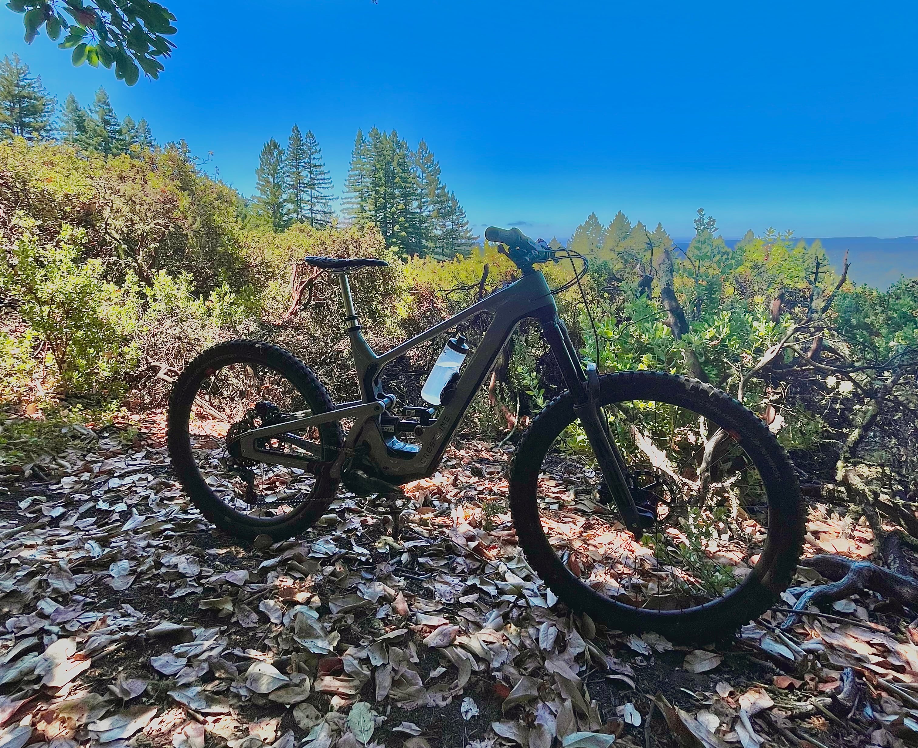

Quick rip today, ~2200ft, little over 6 miles, mostly all boost with turbo a couple times to make the steep climb cake. Used about 32% battery.
First couple rides were 160/160 configuration. Today was 180/170 as I don’t have a 180mm airshaft at the moment. I definitely prefer the 180 setup, the 160 feels like you’re hitting a limit that shouldn’t be there. The bike just feels like it has more to give but it’s locked out.

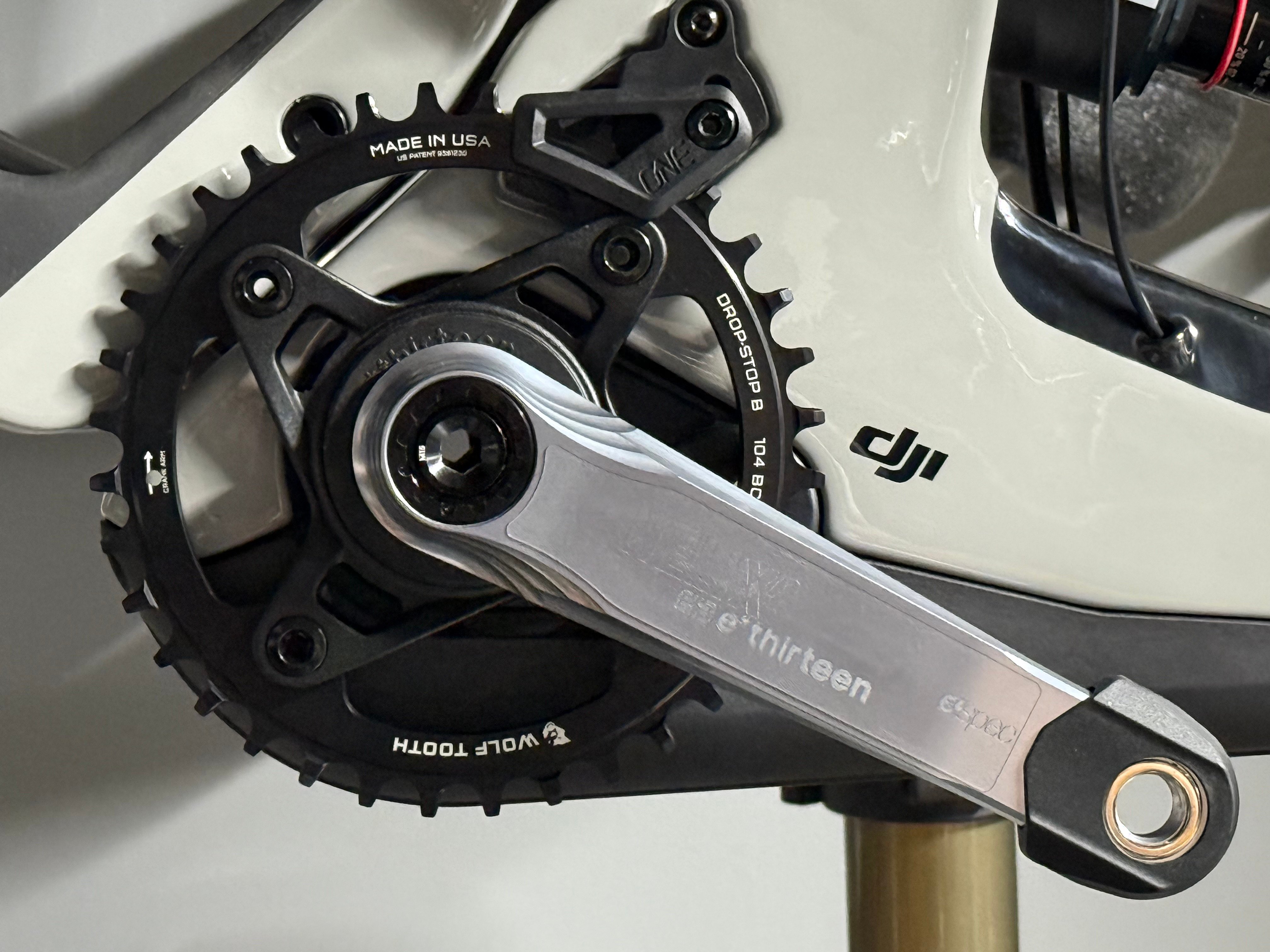

Installed the chainring and cranks and turned the cranks on the bike stand and notice a good amount of resistance on the motor. Even back pedaling was a lot of resistance.
I haven’t turned the bike on yet since I don’t have a fork or wheels setup for it yet, I was just spinning the cranks. Do u guys notice this also? I have had an EP8, Bosch Gen 4/5, Specialized motors and none of them have any resistance when backpedaling and had very little resistance pedaling forward.
Please let me know if you guys experience the same thing or perhaps there’s something wrong here.
PS, installed the wired battery, perfect fit but I haven’t turned on the bike yet 😂, hope it works

After a ride or two the stiffness should change dramatically.
Cool, hopefully this is the case…

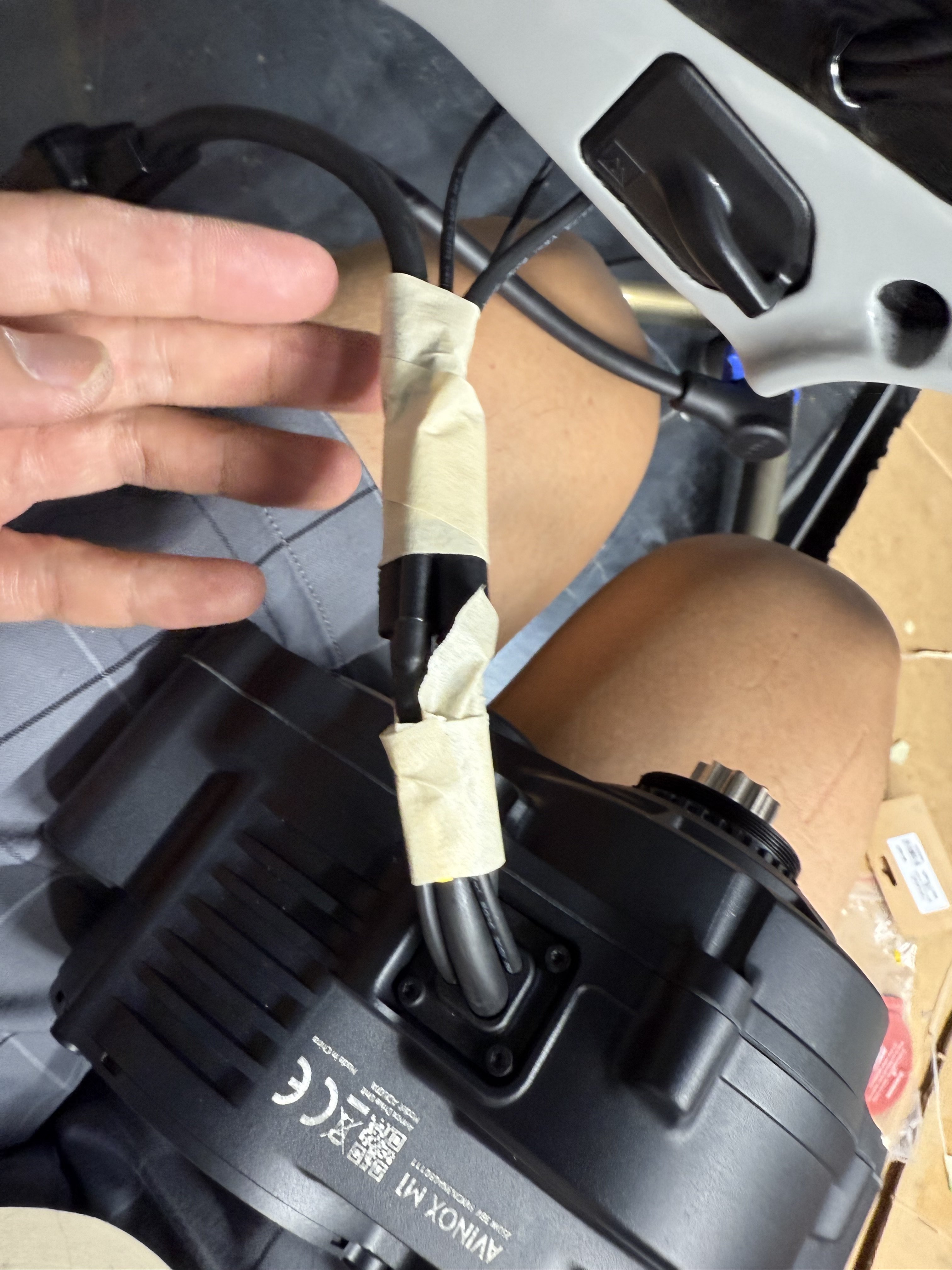

BTW, there’s so much opportunity for cable rattle by the motor after dropping the motor and having a look around. I ended up just taping some of the wires together and installing some wire foam (not pictured) to mitigate any potential sounds.

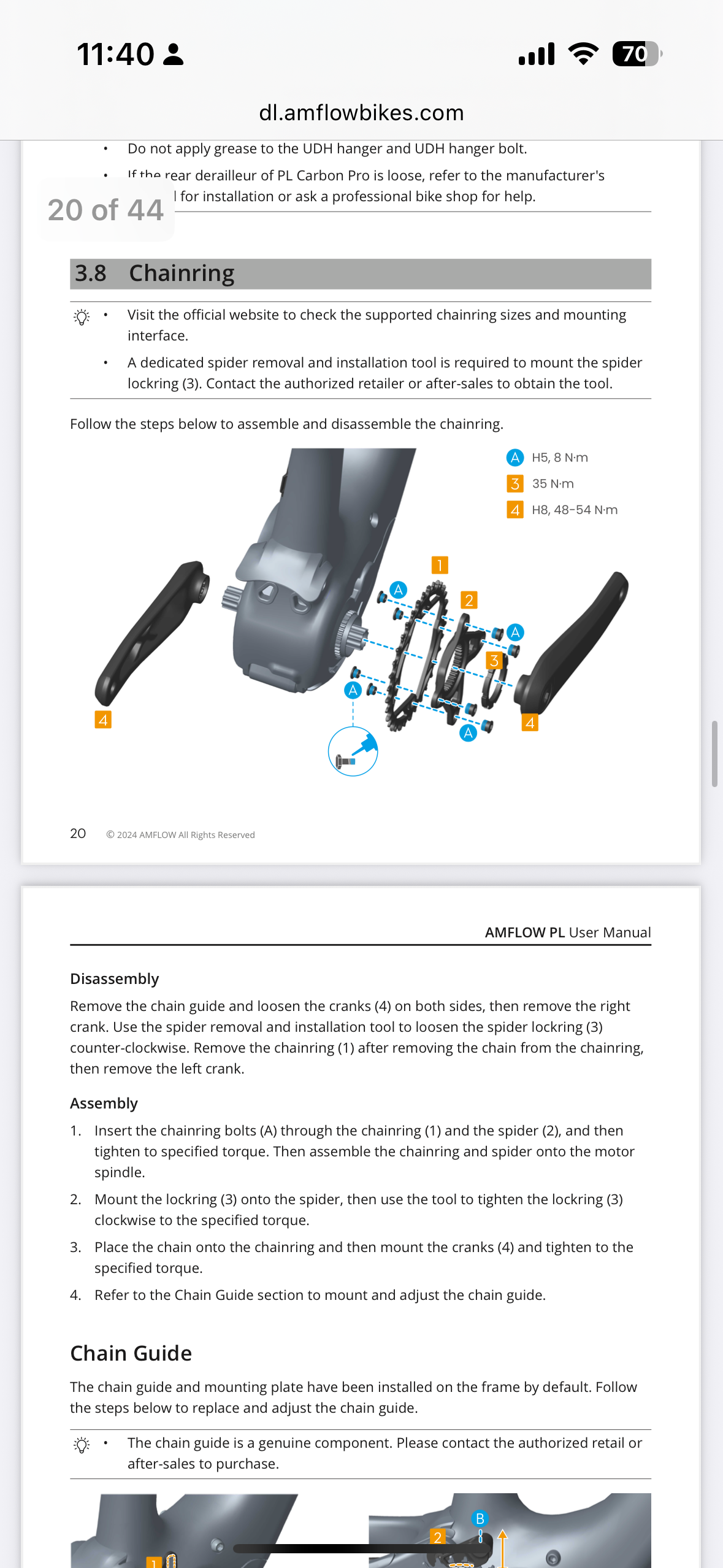

I am a bit bummed that a 36t chainring is going to protrude past the bash guard.
Lots of rocky technical climbs where I live and the #1 cause of snapped chains is lightly scuffing or smacking the chainring on something and not noticing anything until one day the chain snaps for no reason.
Well the reason is you’ve compromised the chain when you lightly smacked something.
I think I’m just going to install a couple bumpons down there to hopefully take the hit.

I thought several people said a 36t is safe? Dumb question but since I bought a 36t as well, what is a bump on?

I think I'd go to a 34t for the same reasons.

As Rob said, I've read that they loosen up significantly.
That said, some resistance always remains from what I've read and I suspect that accounts for lower efficiency.

Mine were/are stiff as well. I also had an ep8 and they spun pretty freely. The dji feels a lot more stiff comparatively, I was questioning myself like you are.

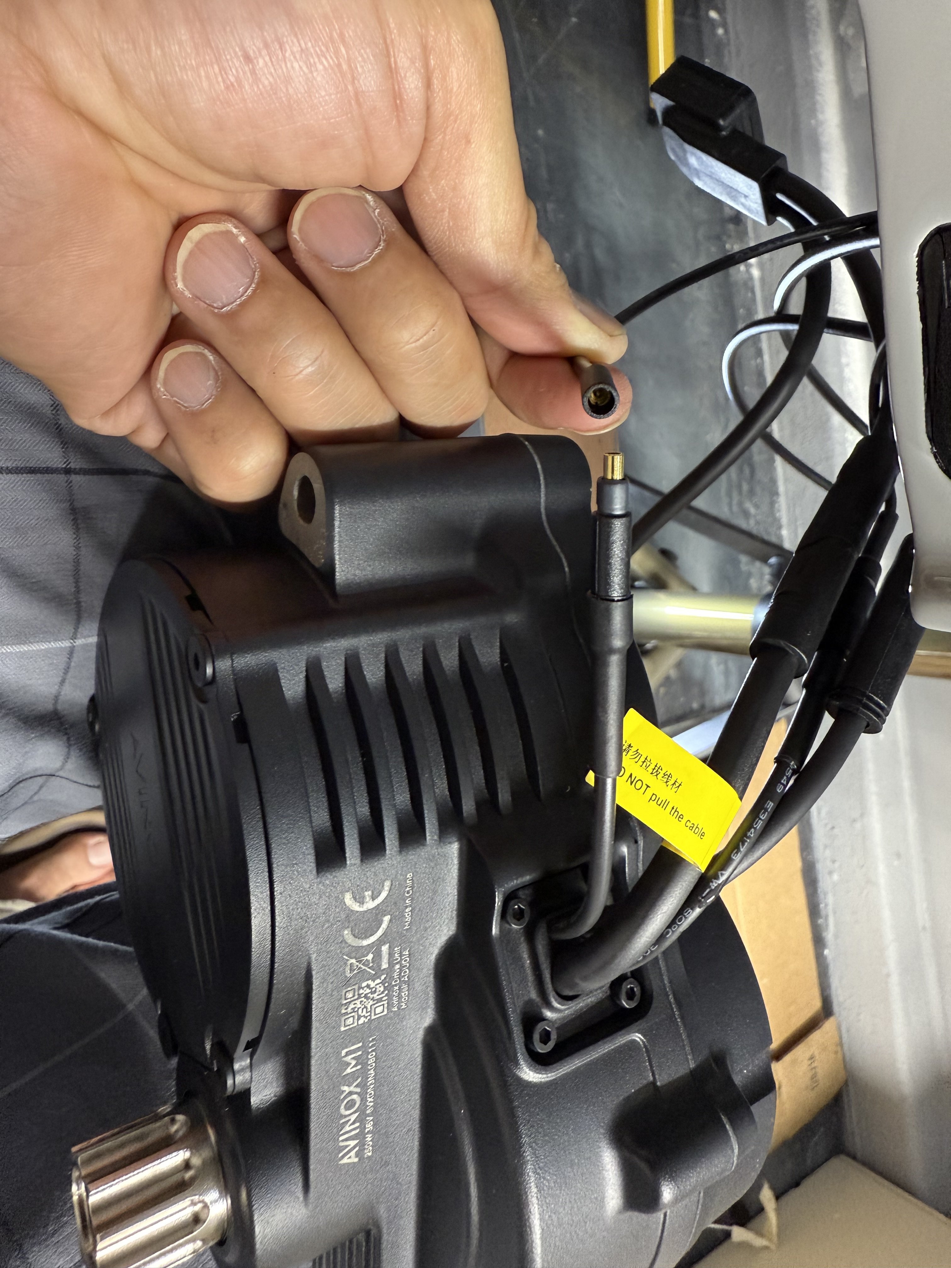

There’s also two spots for zip ties built into the inside of the carbon fiber frame to secure cables from rattling.
