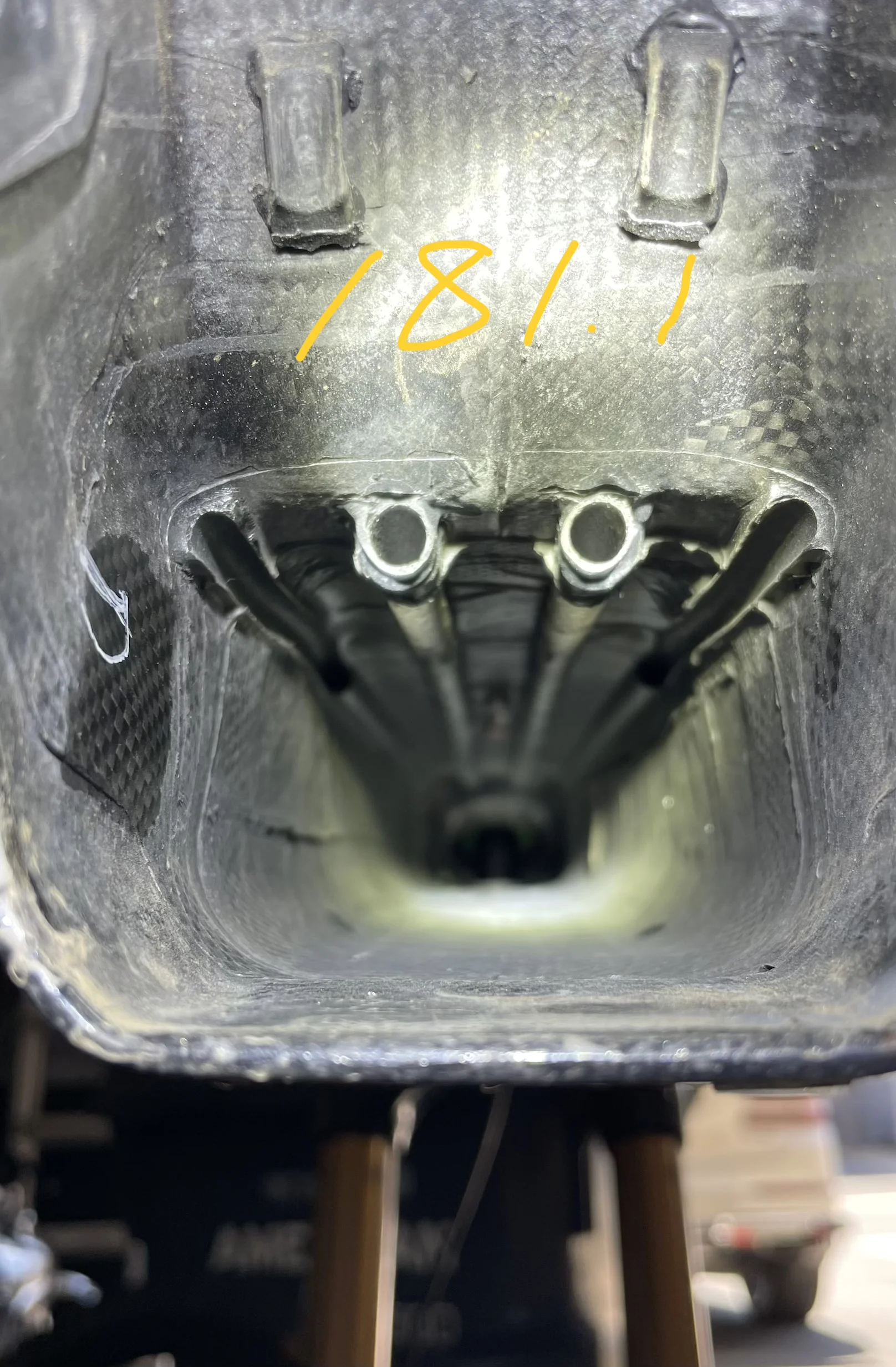

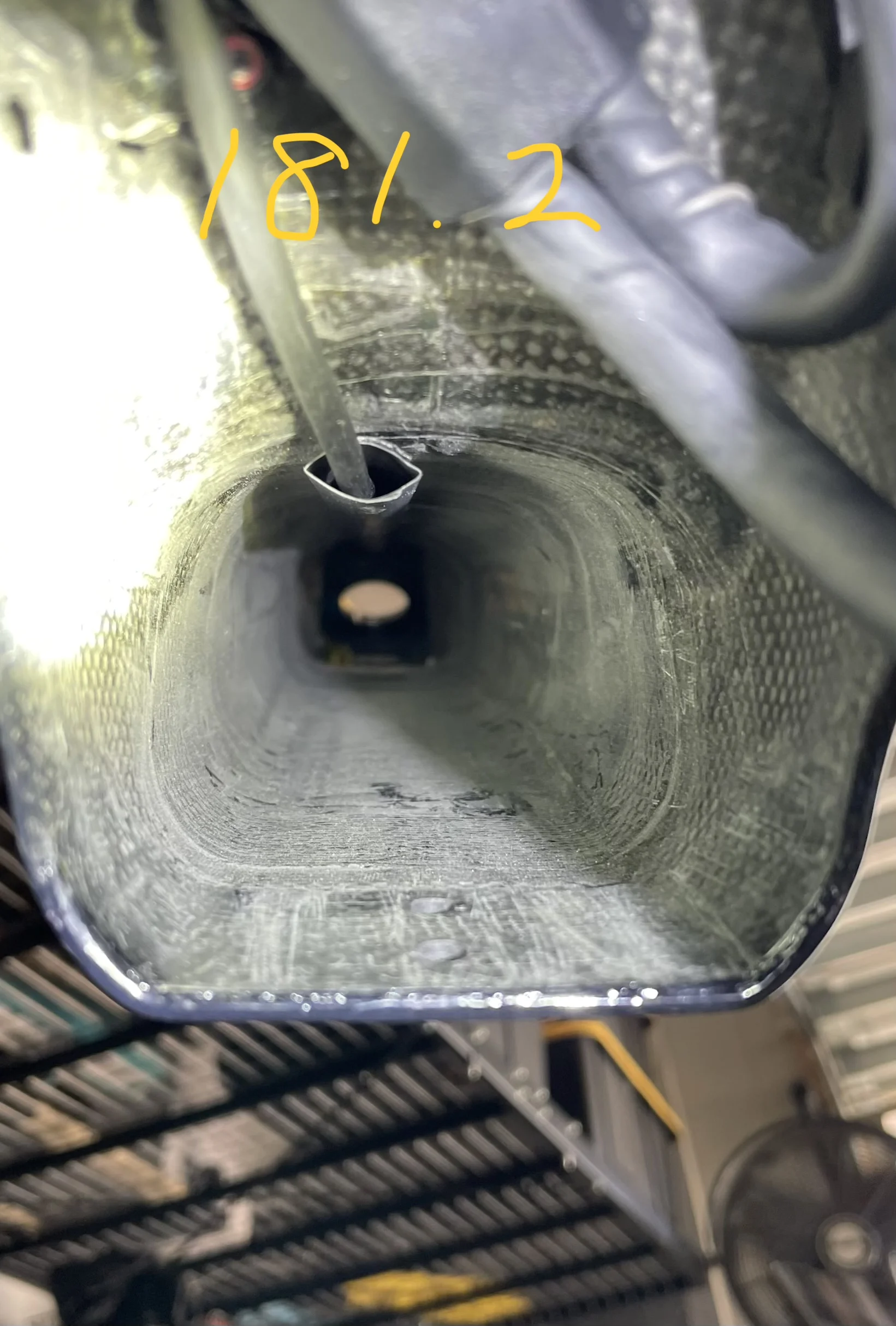

Inside down tube comparison. 181.2 (RH3) is smaller & rounder with one cable management rubber hose tubing vs 4 in 181.1 (RH3).
That’s weird, my 181.2 has 2 cable tubes in the down tube and 2 more in the seat tube that go to the top tube.
Size RH2 for Plaid has 2 in the downtube and 2 in the top tube. Pretty sure RH3 and 4 do not so it can fit a round 700wh battery.
My RH3 does not. It’s very annoying seems a bit cheap.
Doesnt the 700wh give more room in the downtube though? Seems odd to leave it out on rh3/4. It’s round battery so I’d think it wouldn’t be a problem having the 2 in the downtube as the battery will just be biggest in the midline. So if you can have one on the left of midline why can’t you have the other side as well? Pretty interesting. I’d love to hear the reason for that and if it’s because of the 700wh
The 700wh has vertically higher than the 800/600wh. So it makes sense that Crestline had make room for the the taller 700wh. Can't put two 700's side-by-side because then it would be far too wide than the 800/600 cavity would allow. Only one column makes sense with the 700 cell form factor.
maybe I wasn’t making sense. The 700wh is vertically higher in the center (it’s a tube). But the cable routing guides are offset from center. So if there can be one cable guide why can’t there be the other? Like right and left of center. The single cable guide isn’t dead center. But idk could def be something with the battery that I’m not getting
