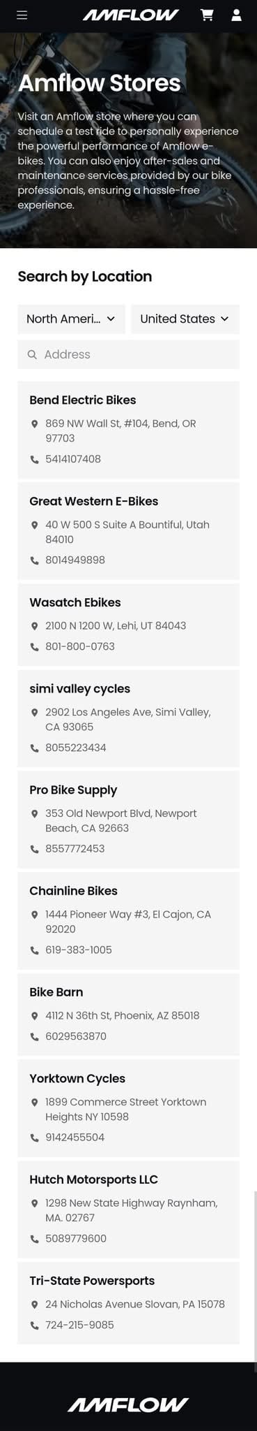

Here are some local shops. More on their way….. wait, just realizing you’re in NZ

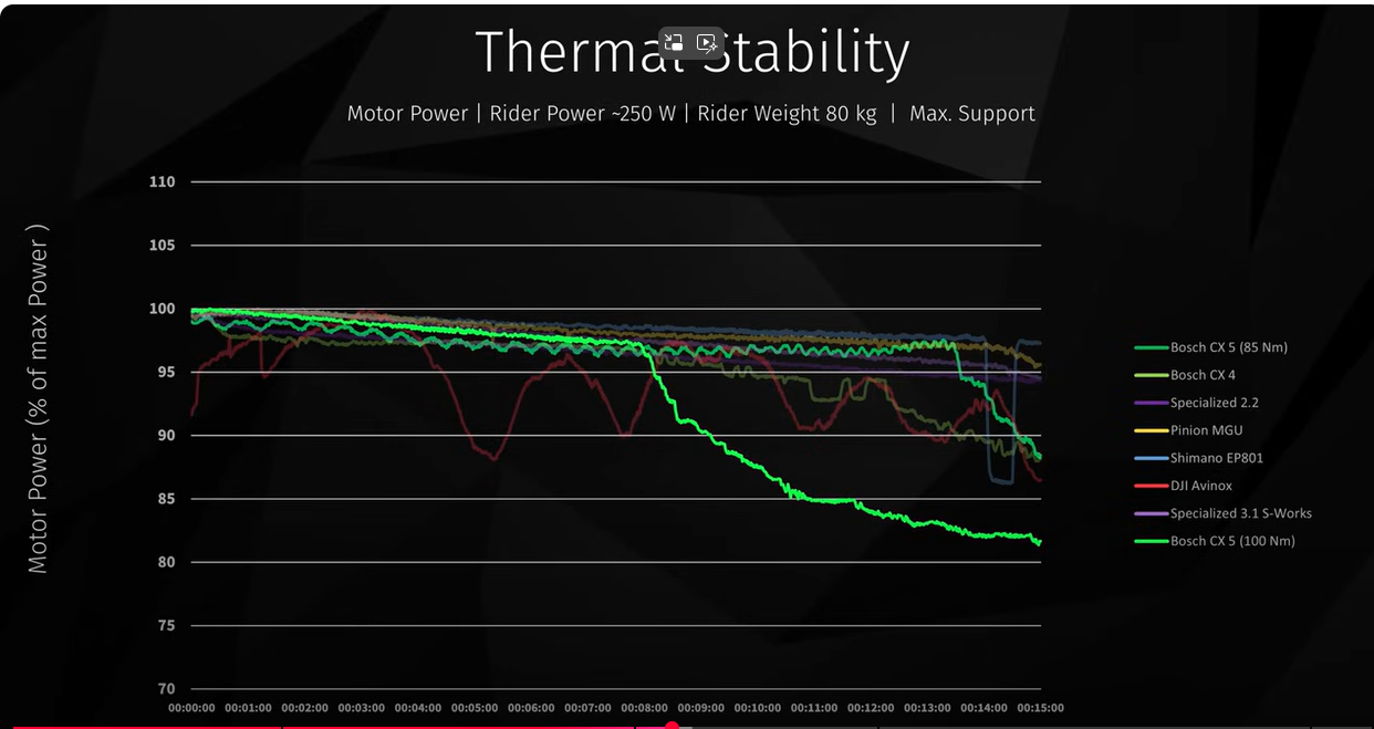

Review this test: 30 eMTBs in Our Huge 2025 E-MOUNTAINBIKE Comparison Test: What’s the Best eMTB of the Year?
The section titled "1. Vertical Range Test".
They utilized power pedals to normalize power input (150w) and cadence (75rpm). I think the DJI has two issues: 1) it produces way more power at low cadence & low input, which isn't relevant at the numbers used above, and 2) it overheats and can end up with lower average power production on a long warm climb as shown by the Velomotion dyno results. Screenshot below. (I also acknowledge that there is a problem with this chart as it shows the 85NM Bosch at nearly the same 100NM peak as the new 100NM version!)
But the gist of it is that the Bosch bike tested (which was an anchor of a Haibike btw and about 2-3 kgs heavier than the 2 DJI bikes, the Mith & the Amflow)) climbed both faster (22 kph) AND more efficiently (44w/ 100m) under these particular circumstances than the DJI bike (Mith 50w/ 100m & Amflow 47w/ 100m, both at 21 kph). So, the Bosch bike had a higher average speed and a longer run time too (because it's 800w battery lasted longer).
It's just something to consider. The DJI powered HP bikes in particular seem awfully power hungry to me and it's left me feeling like a Bosch with Sidekick hubs instead of a DJI HP (I know the Crestline is not an HP bike) is going to get a lot more range and be a lighter package to boot. So much so that a 600watt Bosch in a 48# Regulator, might be faster and climb just as far as a 52# DJI with an 800w.
I'm just trying to figure out if I spring for the DJI, did I just add 3-4# (because it needs the larger battery) just for more streamlined looks, while also gaining significant rattle?
These thought experiments are for my own purposes as my divorce just got signed this very morning :) and I'm either buying a Spectre Crestline, or a CX-R Regulator as soon as they are available, as my Relay replacement. Yes, I obsess over this stuff!
Man that's a detailed analysis with the emphasis on ANAL.
In a Lab, I agree this graph is accurate. In reality, trails are undulating and your pedal input changes all the time.
Real world riding, nobody complains of a loss or drastic dip in power or motor derate with the DJI
