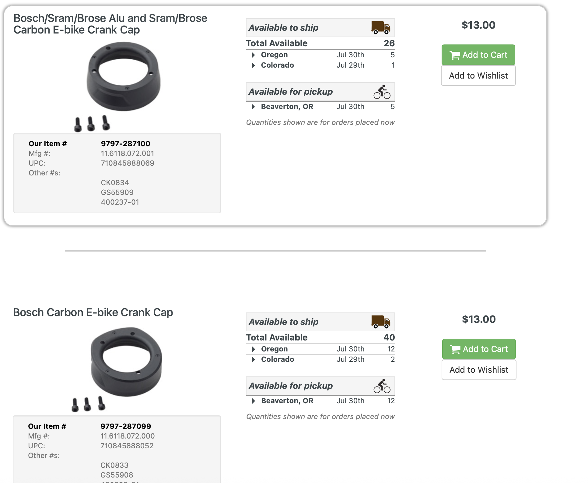

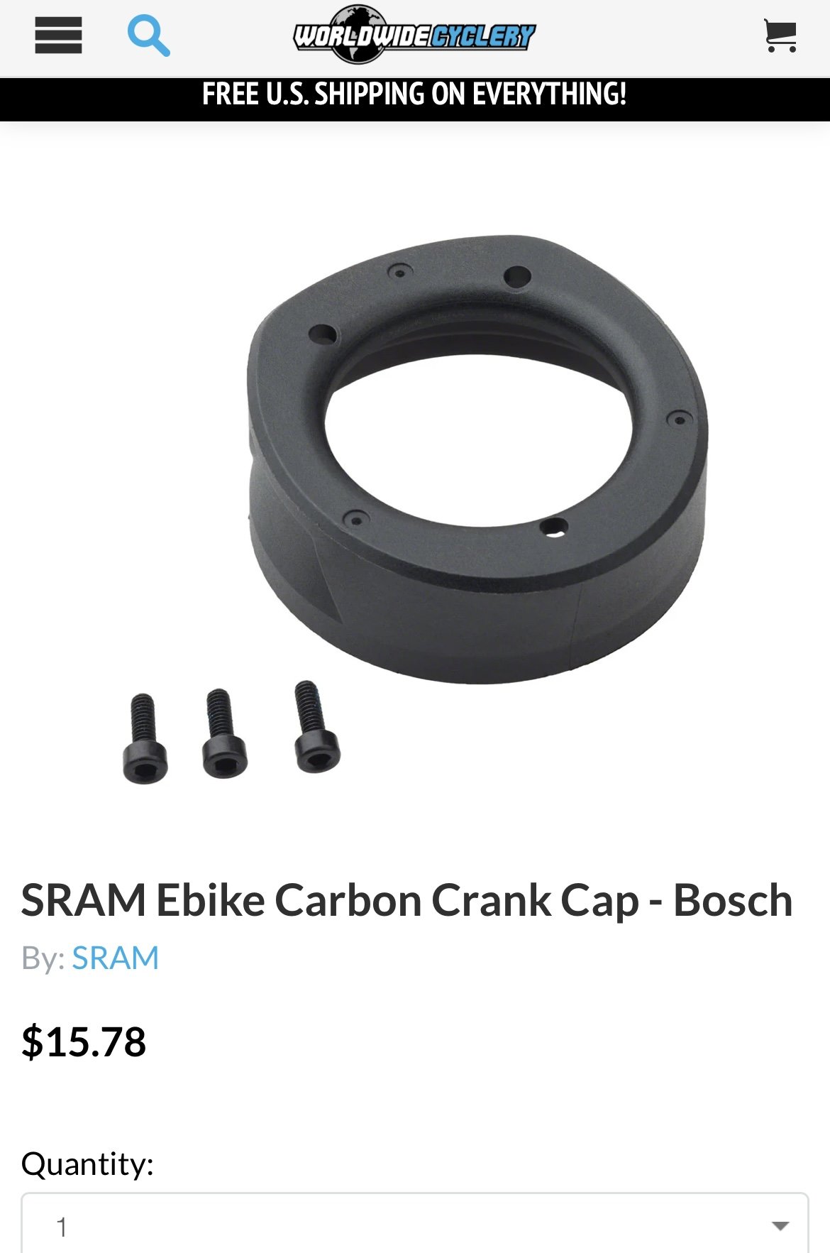

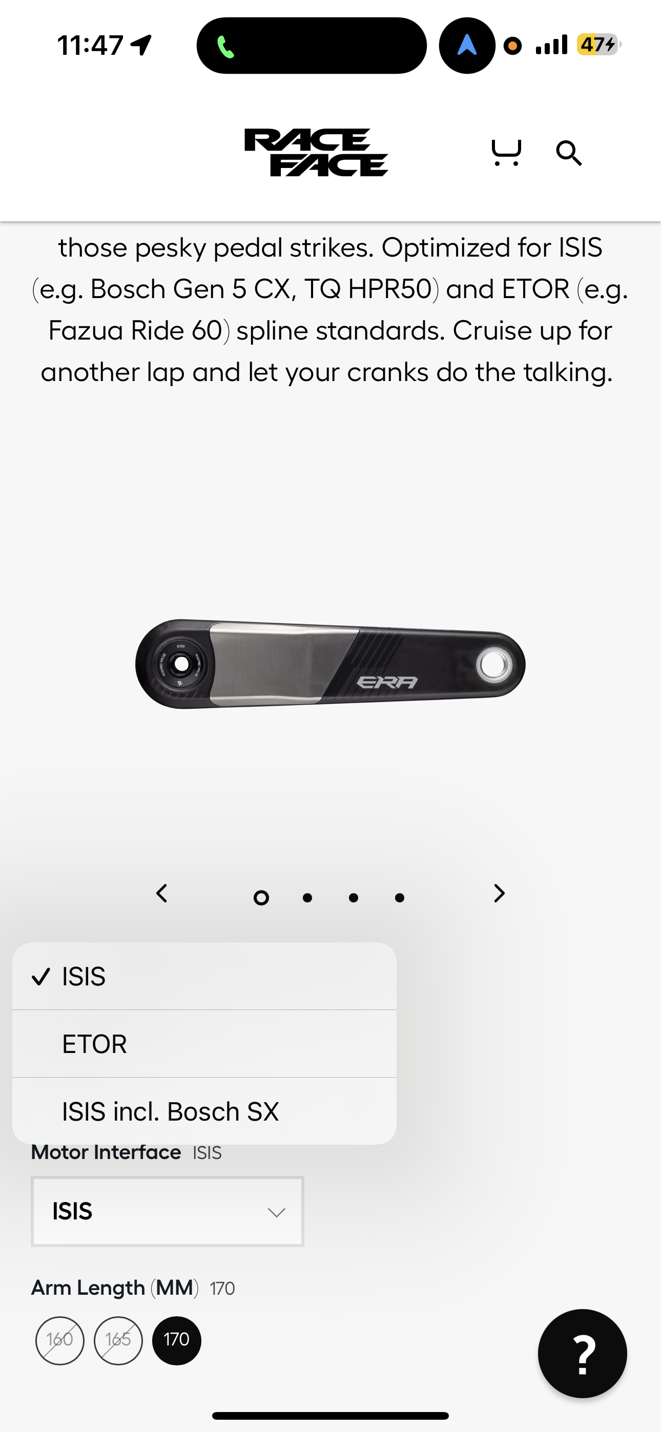

I noticed you ordered cranks with GapCap Type: “Bosch BDU38” instead of “Bosch”. Did it fit properly? I need to purchase GapCap separately (going with XO cranks), trying to buy the correct GapCap. Thx.
I've been wondering this too or if it's even needed/fits. No mention of Avinox compatibility that I can find.

The crank cap did not fit my GX cranks. I don't see a need to run one either.
Interesting. Which one of the two crank caps do you have? I assume most installing GX/XO/XX cranks on this frame set either don’t know about crank caps or not installing one because they’re not bothered by how it looks.
The one for Bosch/Sram/Brose. The top one.

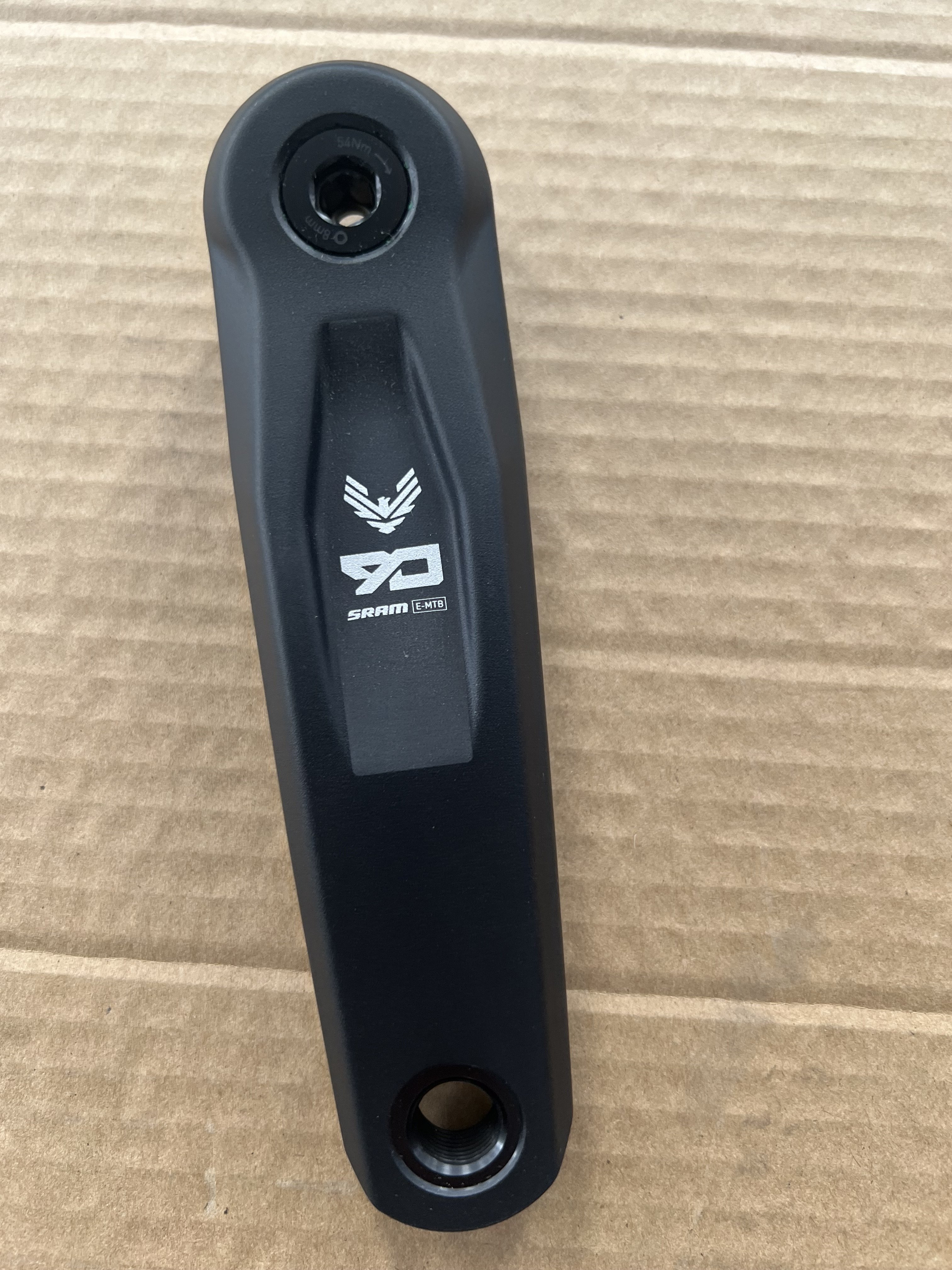

I purchased the SRAM E-MTB 90 cranks which is what Troydon recommended to me.

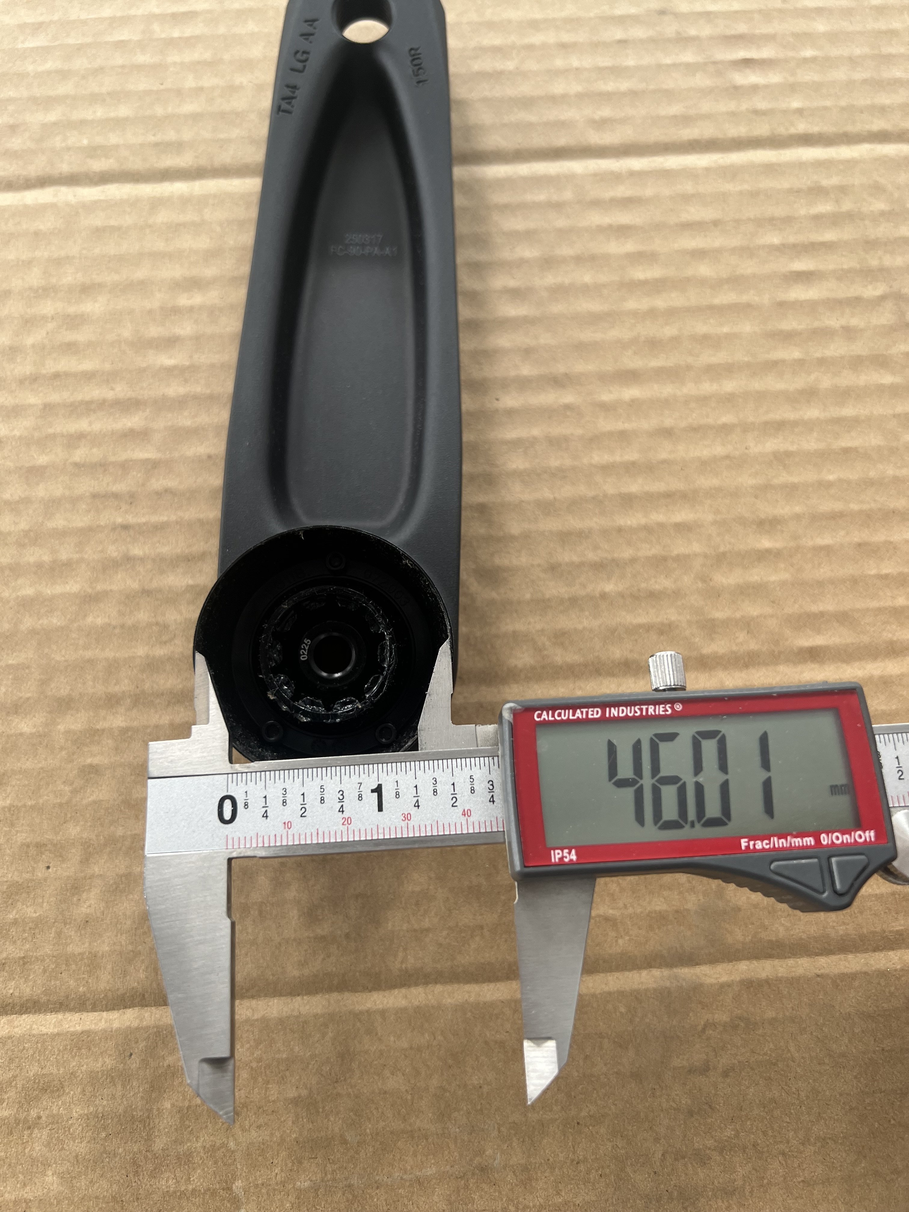

They come with the beauty/dust cap, they do fit but then again I don’t have a spider ring nut to check if the cap fits over it. I’m guessing the issue is the cap not fitting over the spider ring nut?

Troydon responded, kind of 😊, to my inquiry regarding which Gap Cap to purchase if not buying Eagle 90s.
His Response:
I think this cap is only for Bosch, I’ve just removed it on the eagle 90’s I am using, Its super easy to take off.

So no need for the gap cap? I plan to reuse my x0 cranks from my previous crestline
Aesthetics is nice but I do want to prevent dirt from getting in to hard to reach and clean spots. I bought this to try. 11.6118.072.000
