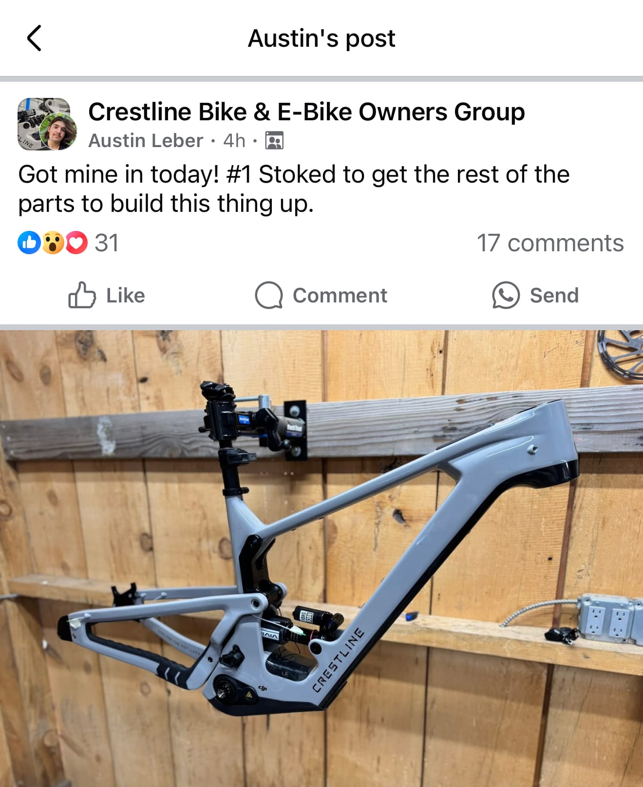

Any have an RH2 in hand and can comment on seatpost insertion depth?
Here’s a RH2 with a 175mm AXS slammed all the way

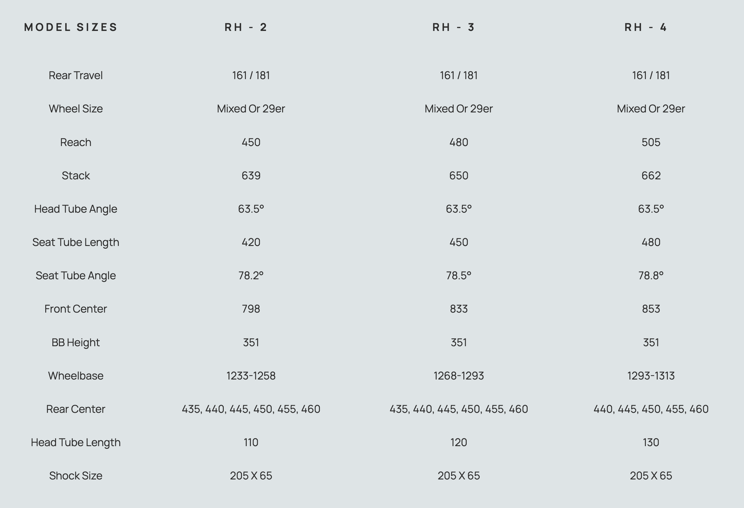

On this weight distribution topic in general, I've been thinking about the best chainstay length to start with on the Spectre RH3. The best handling bike I ever rode had a 452mm CS length. But importantly, it didn't have a DH front tire, a Podium fork & and an 800w battery (not to mention a motor) all weighting down the front end of the thing.
So, I'm left wondering if all of that weight added up front allows me to shorten the CS length while still getting that desired insane front wheel grip?
My RS181 is a RH-4 (505 reach) MX, with 440mm CS drop outs(shorter than recommended on the website) and a 190mm ZEB
My Anakin V2 is a XL (500 reach) MX with about a 430mm CS (no forward battery weight), and a 190mm ZEB.
Every one is different and likes what works for them. I’m 6’-2”, prefer 500mm reach. I’ll move the saddle forward a bit on the RS181 to get my 500mm reach. And still have the option of a WORKS -5mm reach adjust if I want my saddle moved back closer to center.
Here’s a RH2 with a 175mm AXS slammed all the wayView attachment 164785
Thanks, yeah I saw that post on FB and asked him. My current frame seat post is 25mm longer than the listed 181. On that I can slam a A1 170mm reverb. I'm thinking I might be able to do that and get the same overall seat height. I asked this guy the measurement from the bottom of the seat post collar to the crank spindle, that'll tell me for sure. We'll see, or I wait until I get mine.
I'm going to run an RH4 mullet with 440mm drop outs. Looks like 440mm is actually the lower limit (and within) recommendation for size RH4, per the website.
I''m going to run my RH2 as a full 29er, with a 450mm CS. My current bike has +8mm rear but about the same wheel base bc it's has a steeper HT. My Crestline should be balanced and roll fast. I can't get away from a 29" rear and to have 180mm travel on a full emtb, it's the holy grail for me.

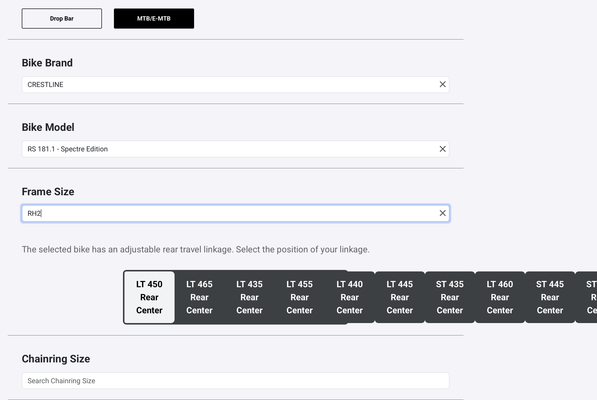

For those with transmission, SRAM updated the chain length setup guide. Not noted is what other Crestline owners have talked about, do you set up the derailleur at sag?!?!?
My bosch gen 5 RH2 had to be set at sag and was 2 more links than what the app had suggested (122 vs 120 links). I know other folks who did not have to set their transmission at sag and were 120 links.
