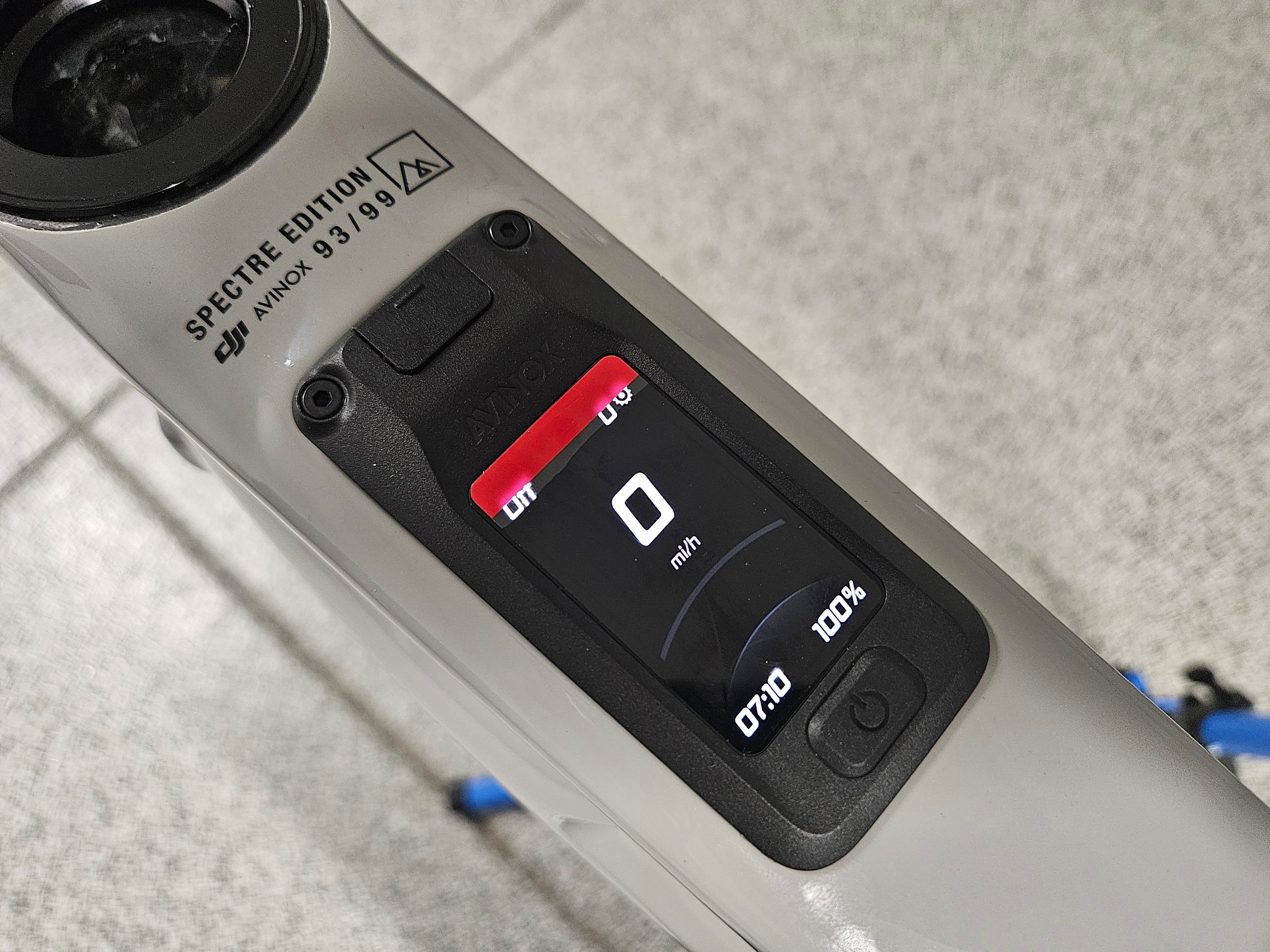

The real burning question is who's getting frame number 69/99?!?!?
I was surprised to see GeorgesEBike frame is number 93…..how does this frame numbering work🤔
My previous 2023 Copper Crestline wasn’t numbered at all.

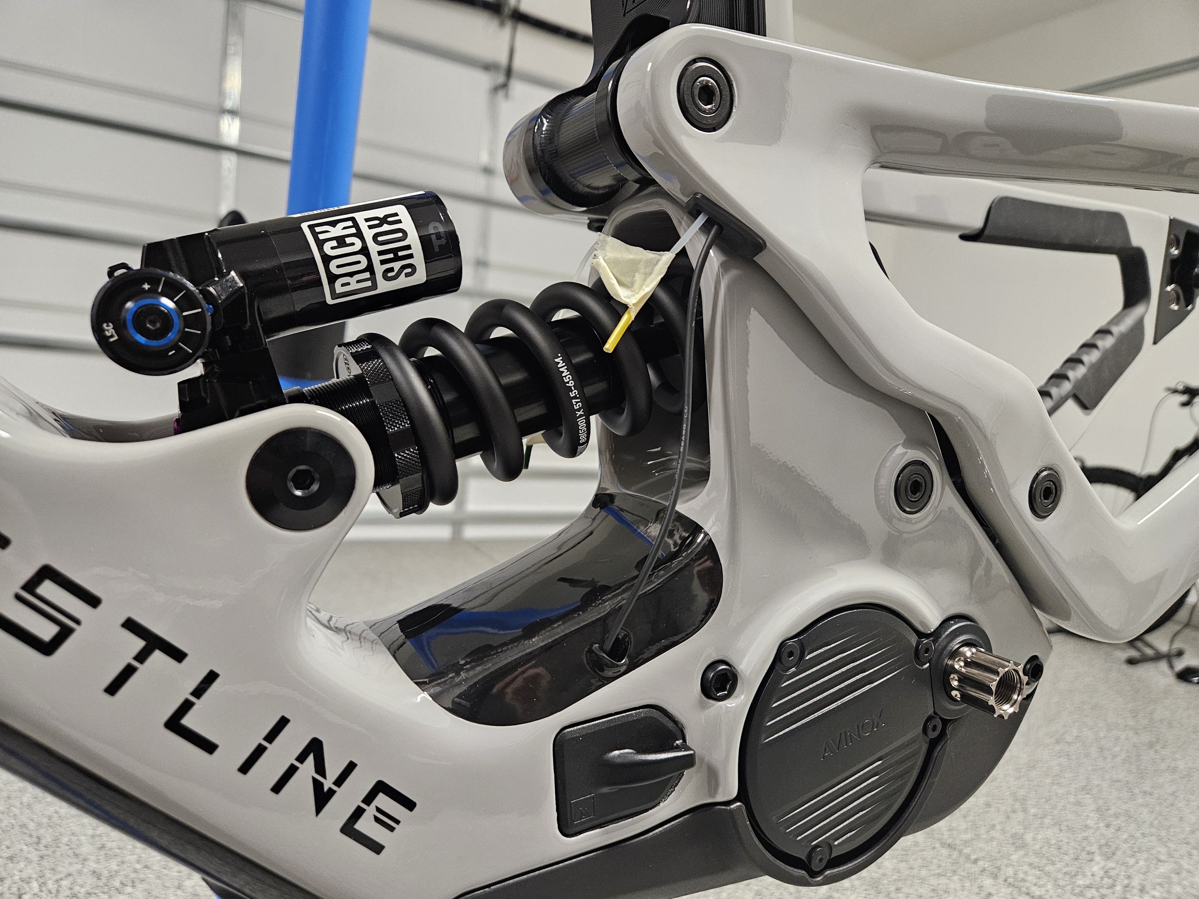

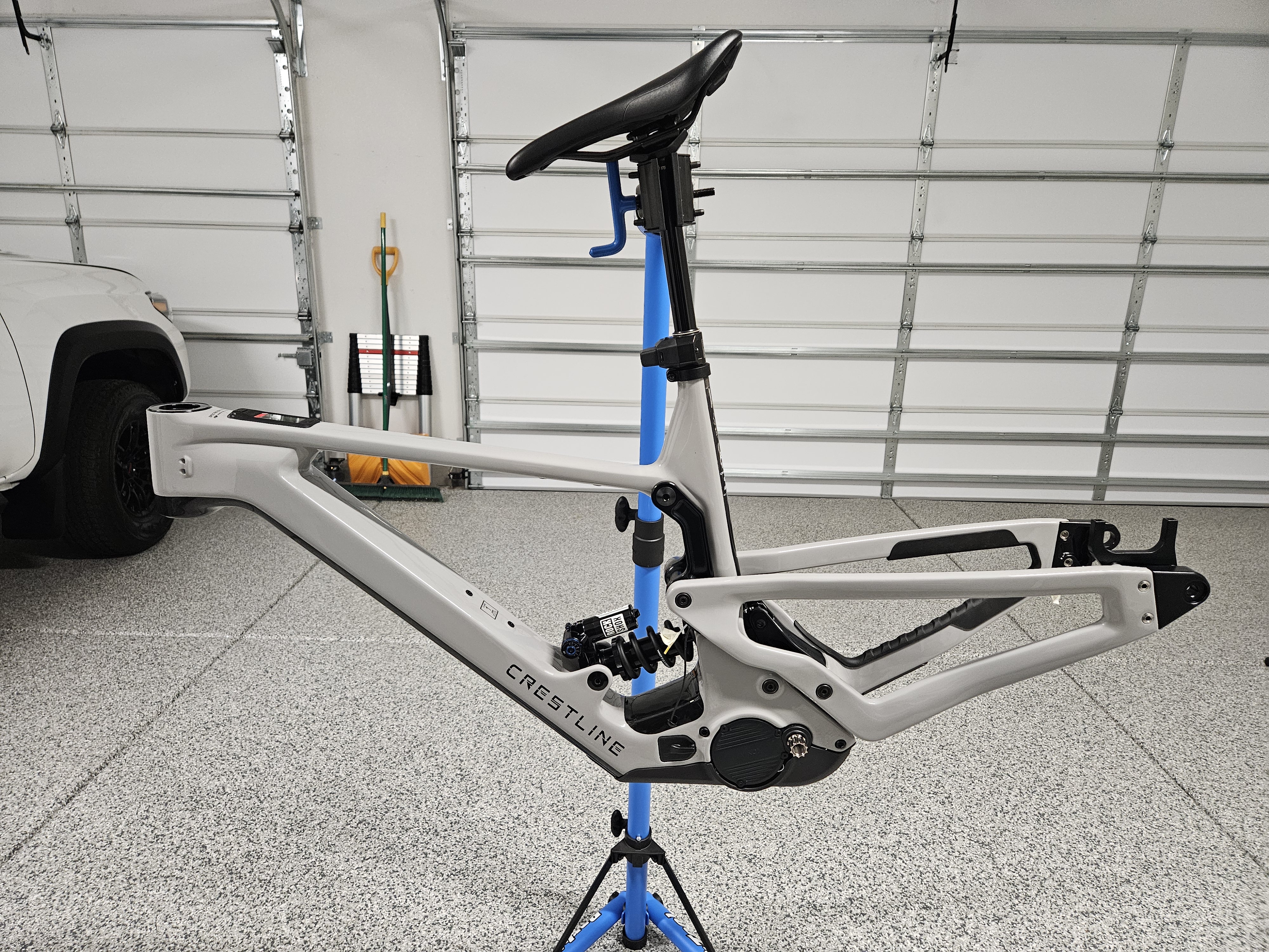

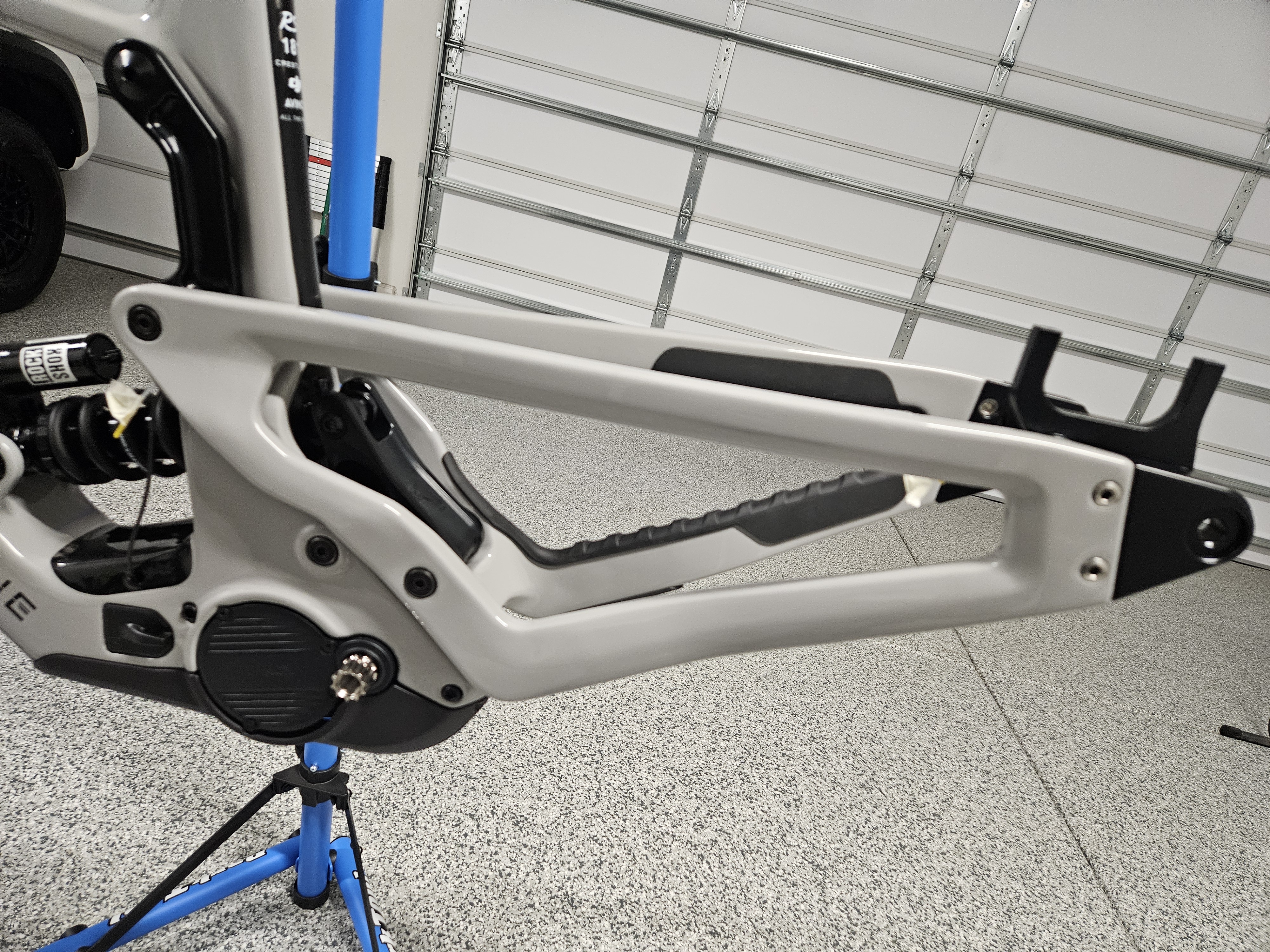

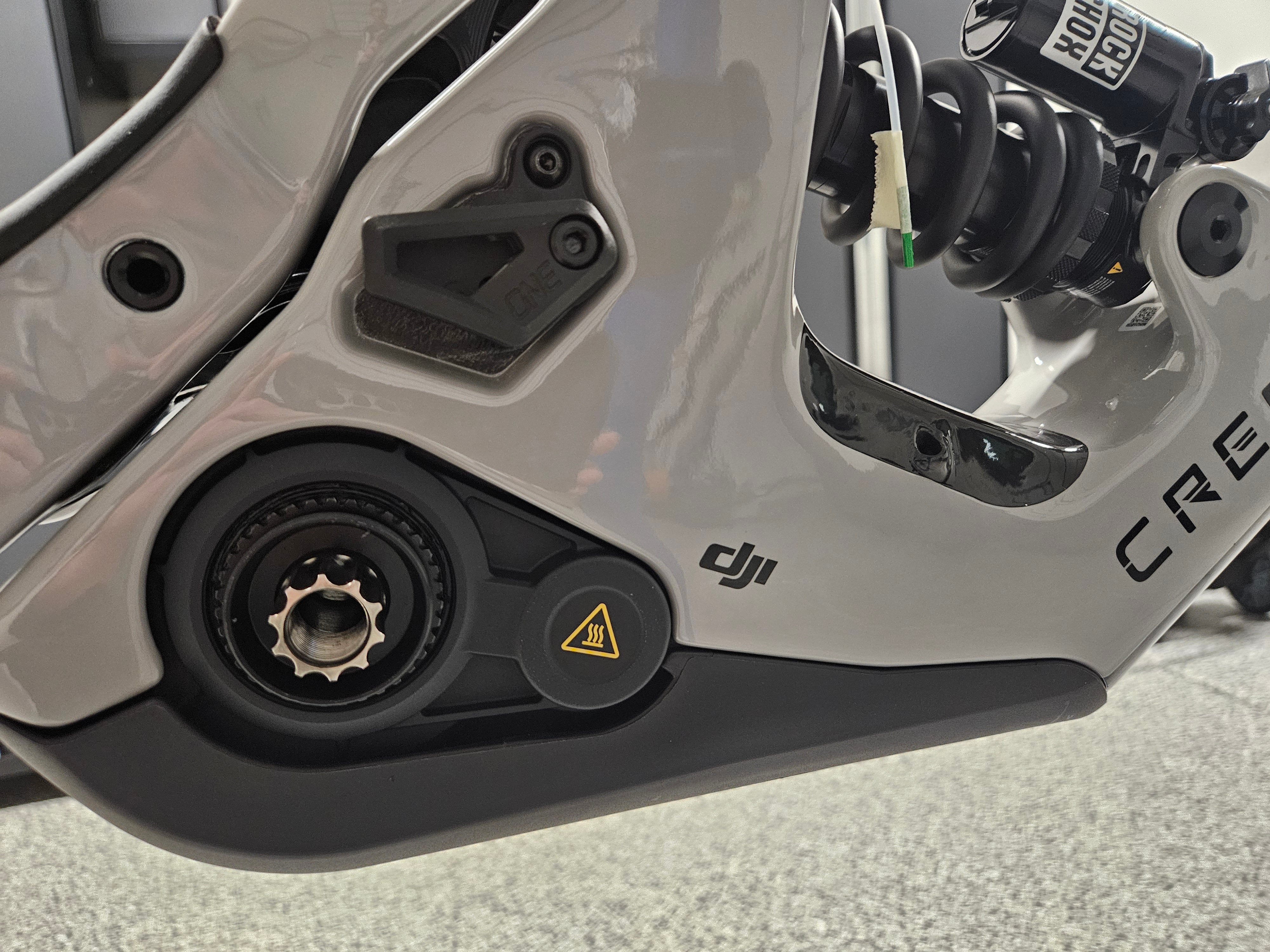

More photos! Good news is that the rubber chainstay protector is finally solid! They have peeled off on my last 4 Crestlines. I don't care for the DJI speed sensor cable but do prefer it to the Bosch valve stem sensor. Super easy to pair it to the DJI app.
View attachment 164710 View attachment 164711 View attachment 164712 View attachment 164713 View attachment 164714 View attachment 164715
I’m not sure what I like more, the bike or the garage/workshop! 😊👍
It’s a serious looking piece of kit even unbuilt. I wish there was a Crestline dealer here in the UK. It would be far too much bike for me and my riding, but I’d just sit and look at it if necessary! 😂
I could have the Crestline on one wall of my lounge, and the Unno Mith on the other! 🤔🤣
